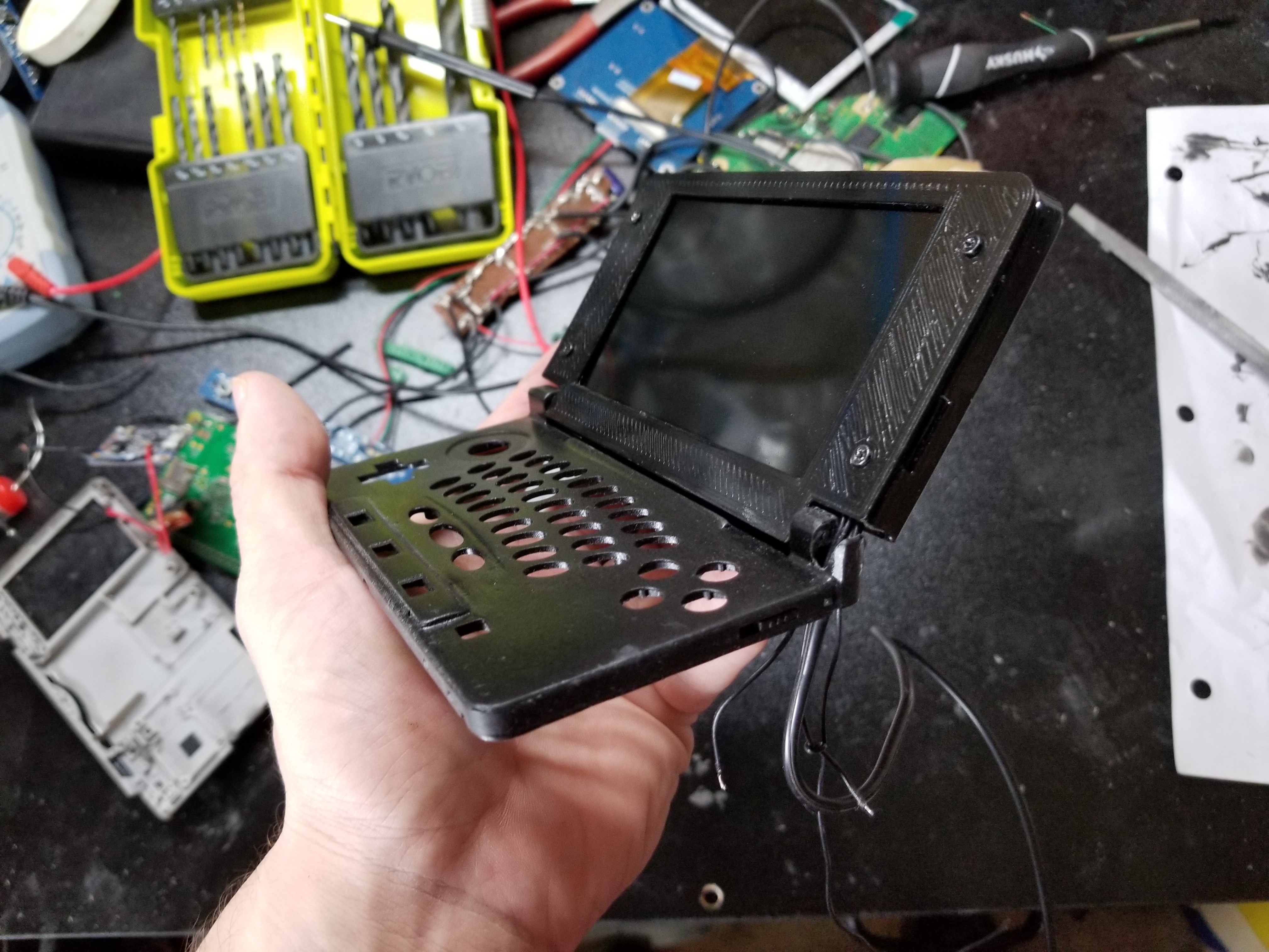

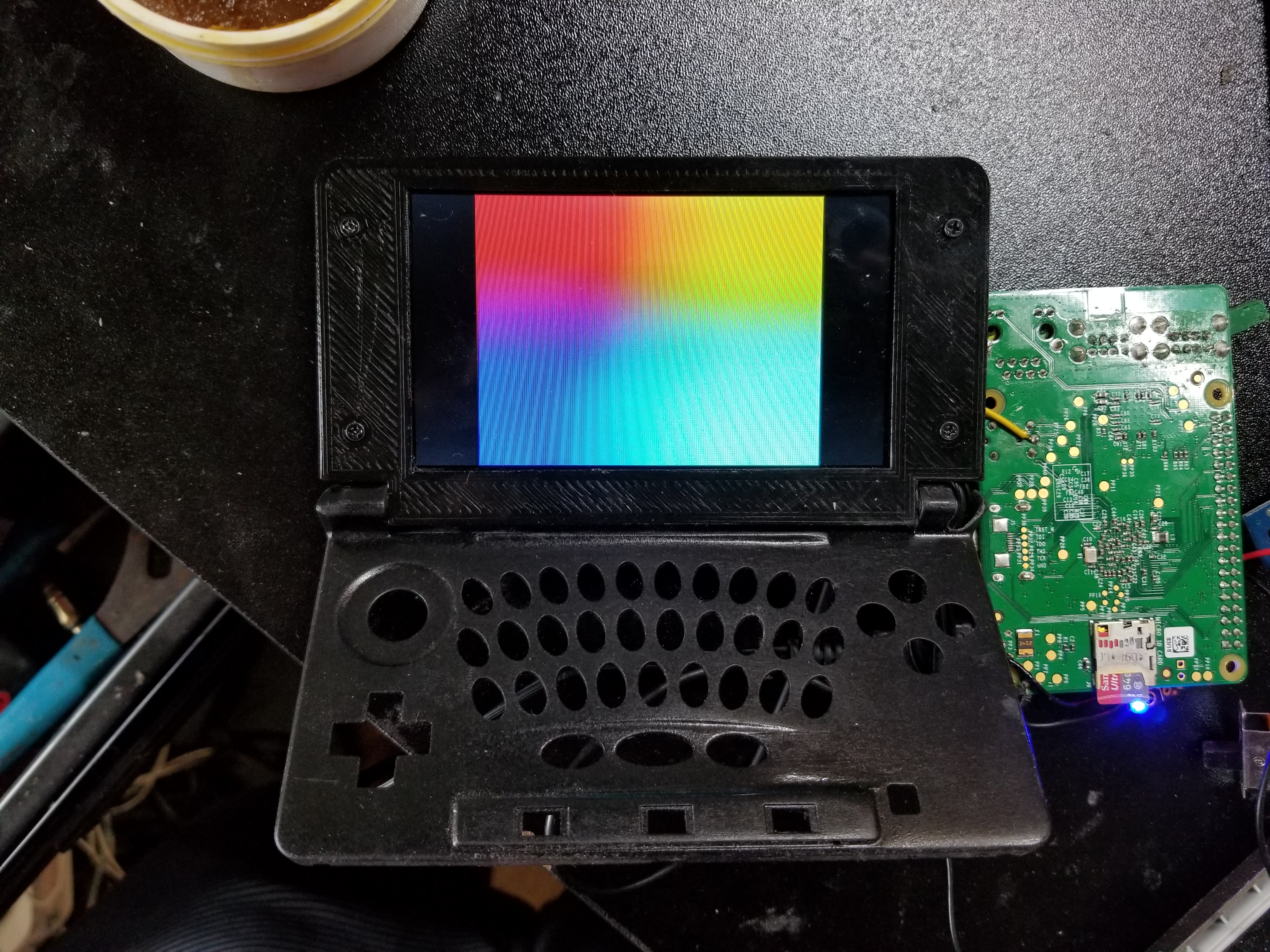

Okay guys, I did a thing.
If anyone remembers, the thing that was holding me back was I was attempting to fit a 4.3" screen and its driver board into the top half of a standard 3DS. Well, I trimmed the driver board pretty well but it still wasn't fitting and even if I did get it to fit, the hinge system sure wasn't going to fit.
*close to a year goes by*
@Fruity_Grebbles shamed me over in his keyboard thread, and it inspired me to continue (though I have been somewhat inactive, I have been in wii modding land for quite a while). I spent several hours today designing and printing the top half of the top half of the case (if that makes sense), since the original piece just wasn't going to allow everything to fit. Two great things came from this: I have a semi-elegant solution to my screen-fitting problem, AND, because of the dimensions of the lower part of the print, the friction alone is enough to hold at a perfect viewing angle. So once complete, this will fit perfectly into the bottom half of the 3DS, without the need of hinges.
Expect more progress in the near future (and I mean it).

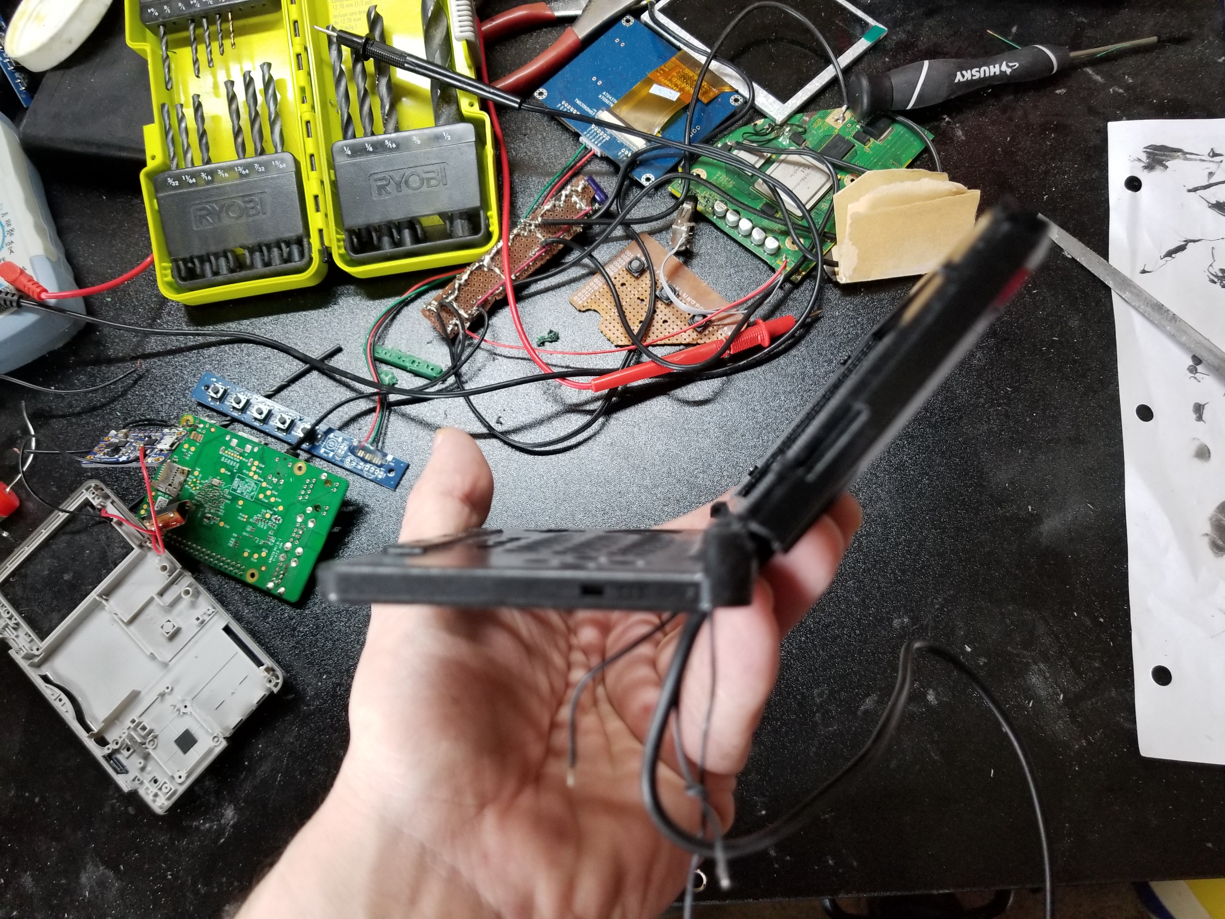

The screw posts that I epoxied in our mostly dried, so I fully assembled the top half of the project. I'm running the wires through the hinge on the right side, as you can see. The wires are... 5v, gnd, shielded composite, and the button signal. In order to make the screen controls operational again I need to ground the button wire through 3 different resistors as was originally done on the screen driver board.
That being said it appears that I left the screen in 4:3 mode so I can't demo widescreen until I rewire the buttons. But man am I happy with the size of the screen. It's amazing how close it was to not working out.
Things I still need to do:
Wire up all 3ds buttons and slider to teensy, and get it coded to work with the pi
Wire up internal wifi module (maybe?)
Mount USB ports (1 or 2?) and charging to the side of the case
Figure out a way to easily interchange micro sd cards (only thing that has me stumped at the moment)
