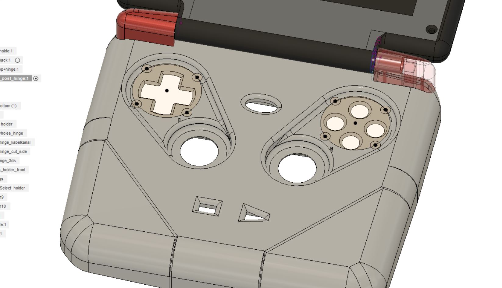

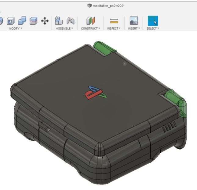

I was thinking alot about the final design the last days.. I know i want to make the whole case out of carbonfil , so it will be mostly dark-grey/blackish. No paint.
But I also wanted to use the awesome color print technique i learned from nobble!
WARNING: Post may contain traces of memes! Suitable for vegetarians.
Anyways, me and my brother reggie were getting baked earlier & he approved my latest [h]i[gh]dea.
He also came up with a genius name! Since it's basically a "PS2-SP", why not call it "2SP" for short. Also it's PS2 backwards which is kinda cool...
Here are some more tasty renders:
But i'm still not sure about the color of the hinges/inlays.. i have a real nice dark red, which might look nice. Oh, and i got dark purple prusament incomming, too. :rothink:
Good thing is, if i ever want to make a wii clam, i can just recycle this..

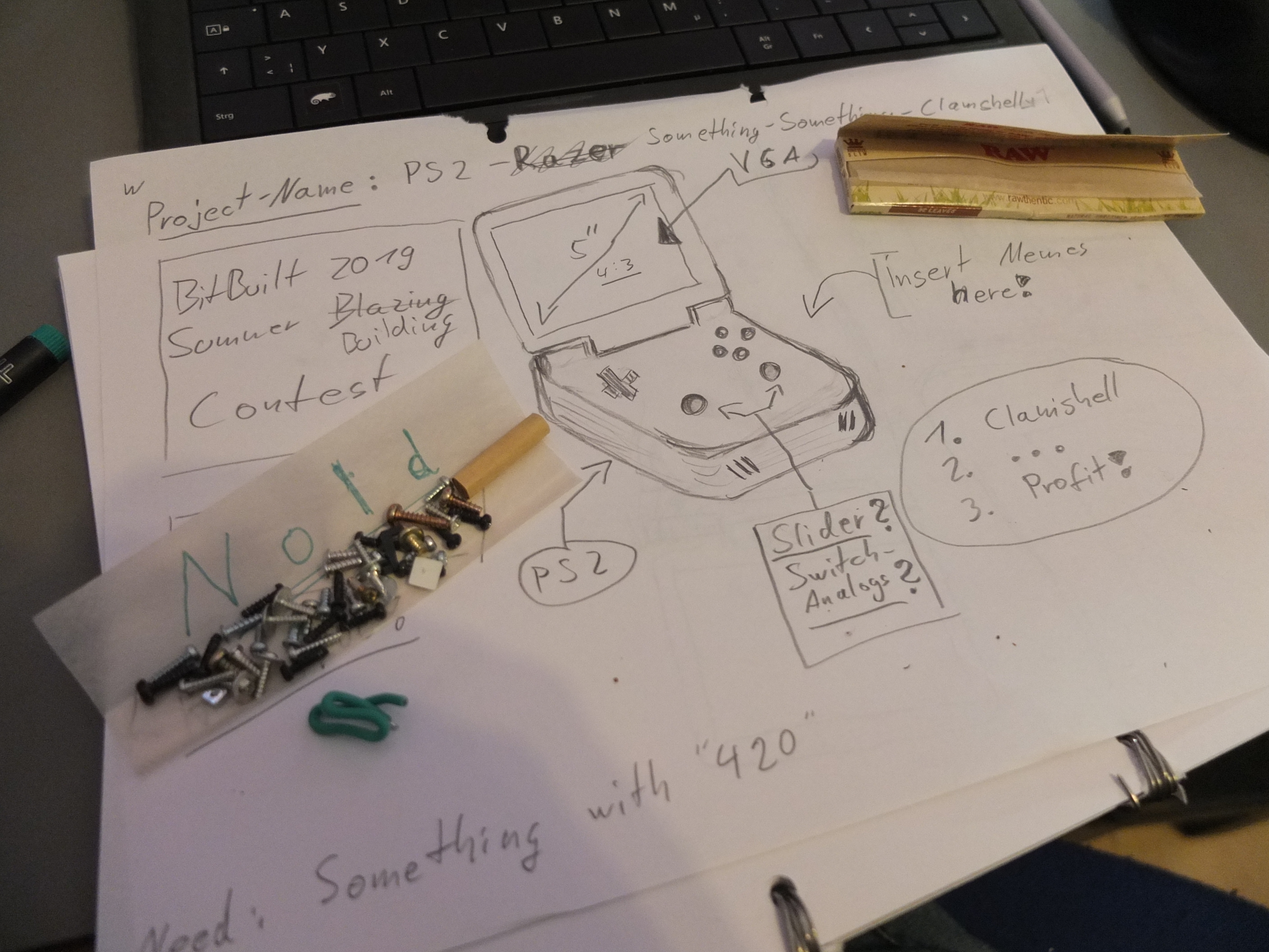

Btw.: This was my first idea:
A portable from hell! :devilish: Now you might get, how angry a clamshell design can make you - lol[/h]

So, the DSL hinge is not able to hold the display as nice i want it to... i needed to change a lot on the display & bottom part, to fit another hinge in there <.<'' ...
It's a little tricky to put in the dsl hinge now, but the prototype seems promising, tho..
still need to fix some things on the screen-frame, but at least the display fits in.. also i'm waiting for the last missing parts to arrive & then i hopefully get this thing done... and working >.<''

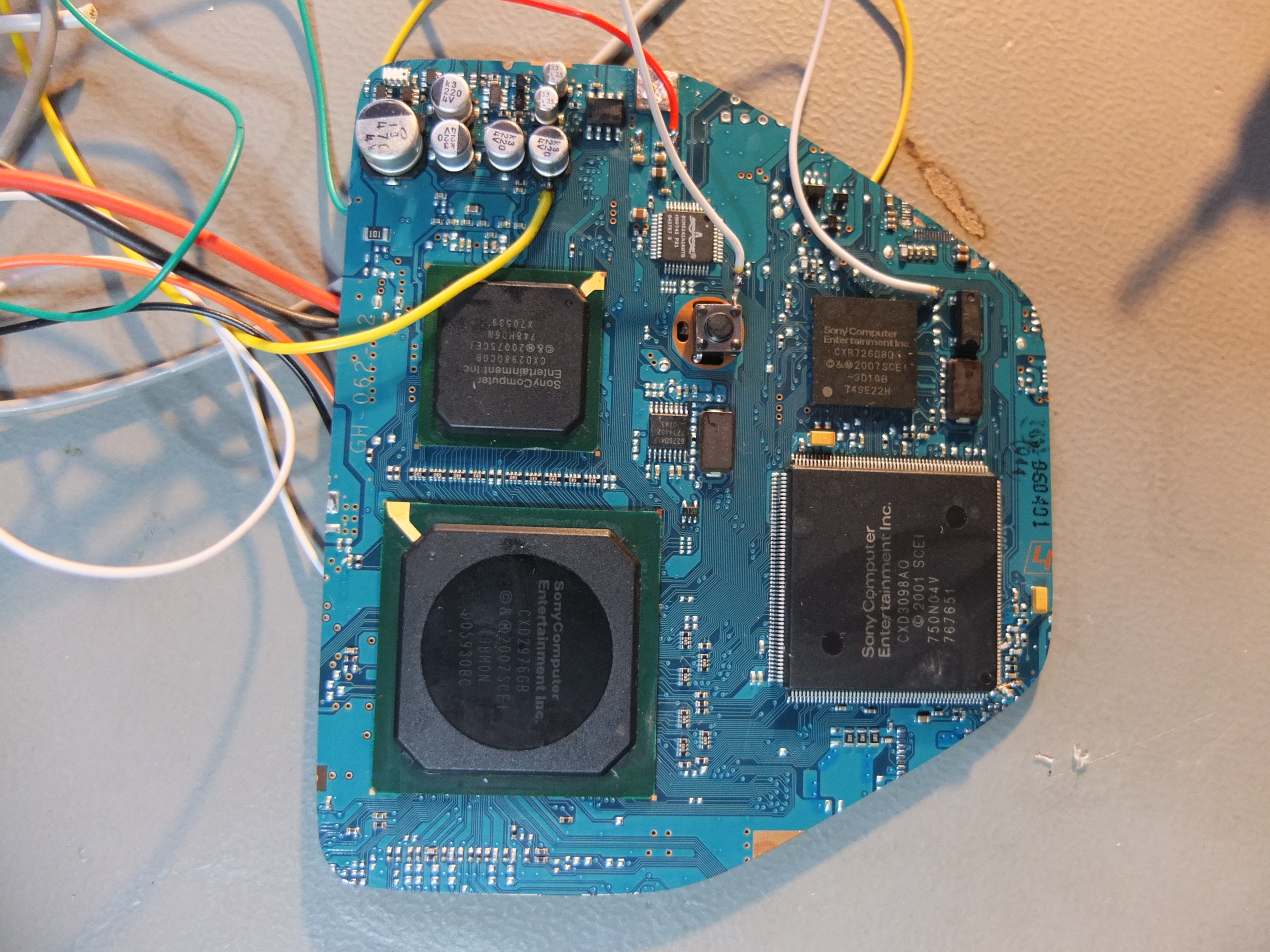

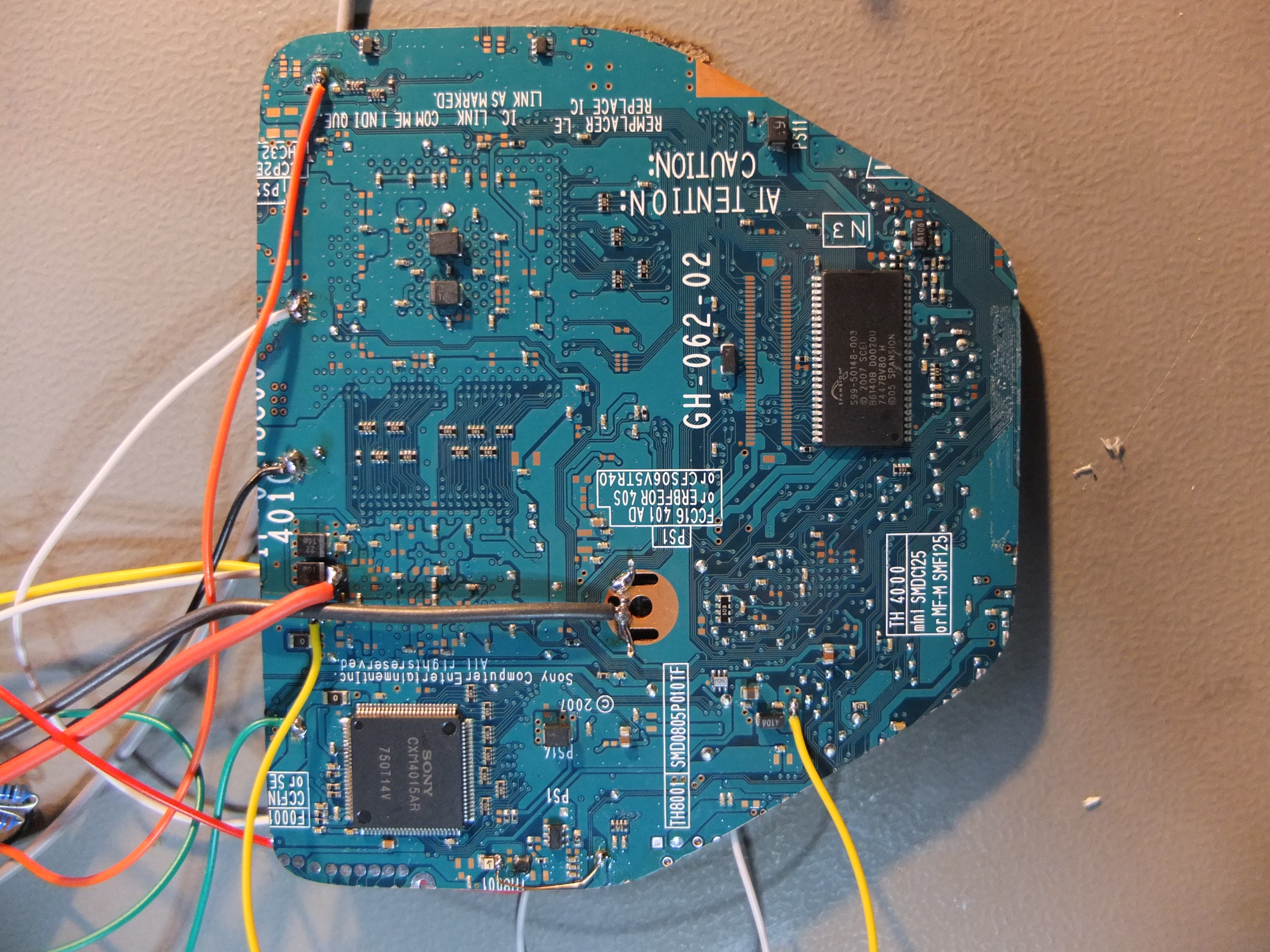

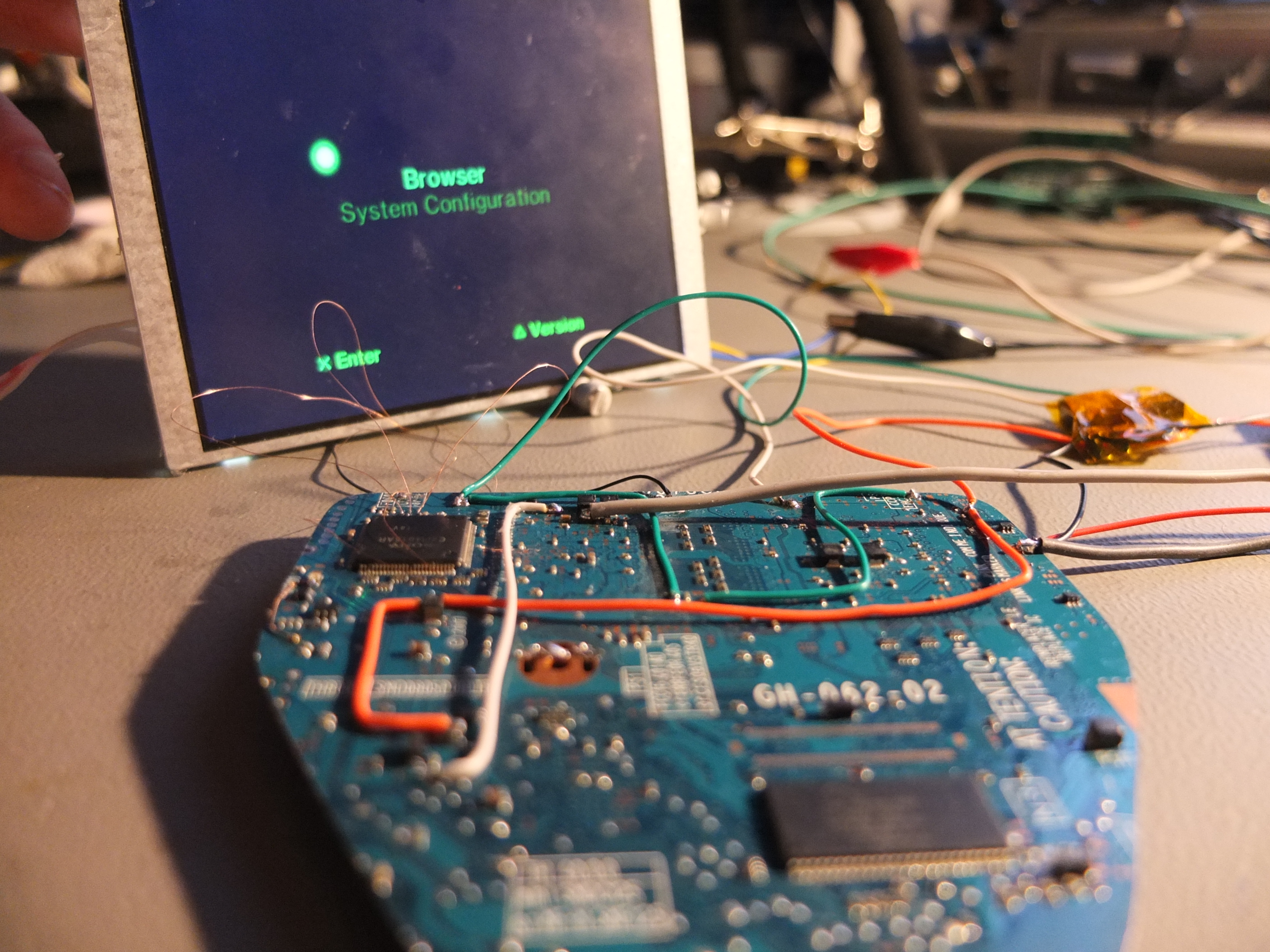

Alright, not much happend the last days.. did basically finish/test the reloactions. Board is working fine so far. At the moment I'm just waiting for the last parts to arrive.. like this big boi, that looks like it comes straight from the 90s!
So after downloading a 1GB IDE, to program an 8bit MCU.. i flashed that guy with the PS2+ firmware.
Since i was to lazy to make some jumper wires, i soldered it directly to my trimmed board. Sadly i couldn't make it work. With the help of Chaos i tried everything to make it work.. but it didn't want to...
[ guess he was super happy to have me as a test candidate, in that moment - lol ]
Even tho it seems like they are communicating (MISO/MOSI - idk which is which)
[ I know you guys love CRTs ;-).. ]
So i removed the chip, made some jumpers, hooked it up.. still the same :(
Tomorrow i'll solder the PS2 controller slot back in, see if it works & hook the PS2+ to the slot.. Hopefully it'll work.

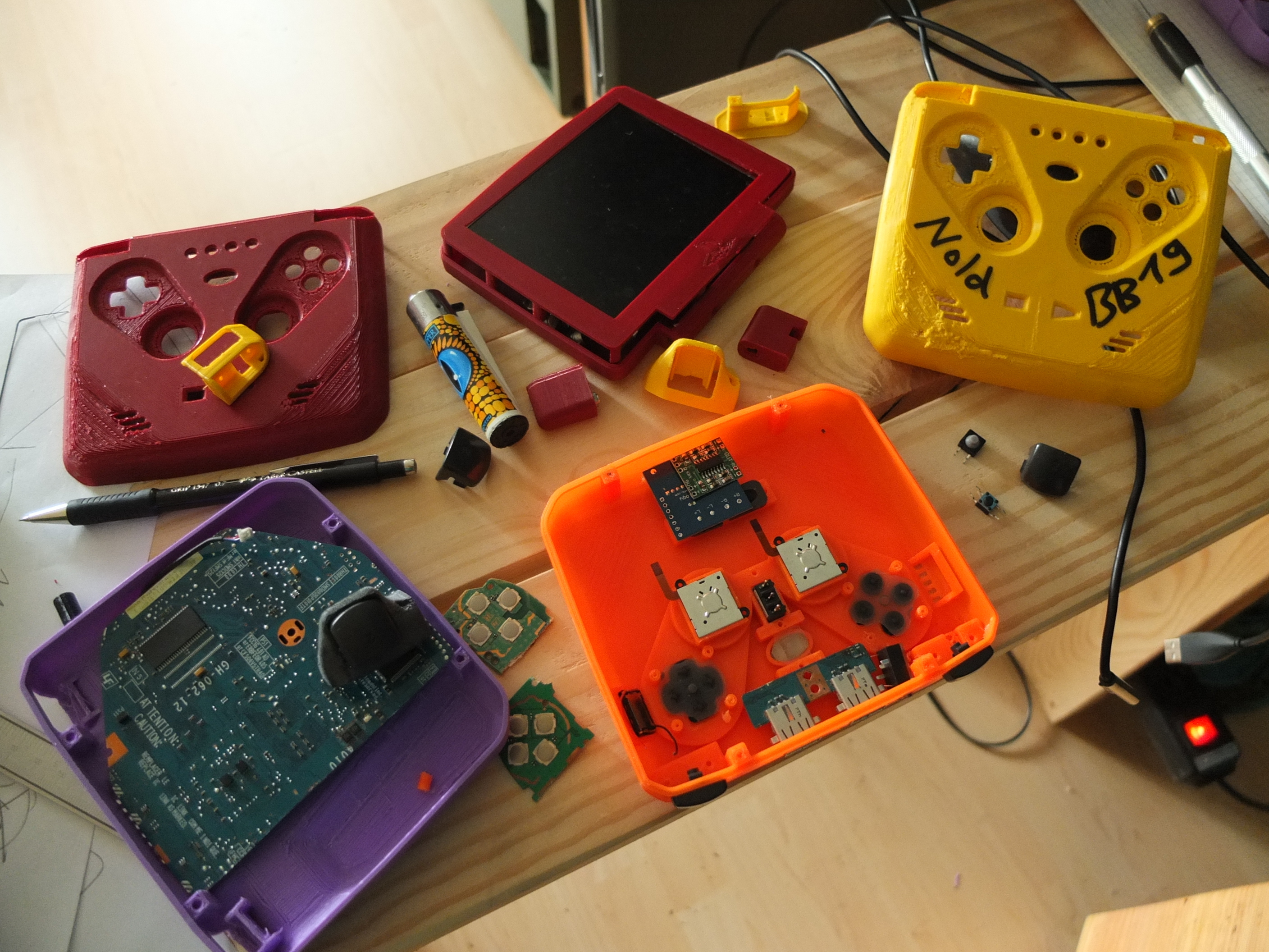

Whatsoever, today was my personal deadline for the case design, so i did a lot of test prints the last days, like the logo. It printed nicely, the case will not become purple tho...
Besides that i decided to try copperfil for the hinges & found out, that post-processing that is a pain in the a**.. Been sanding & polishing for hours today, only on these two hinges:
Still not very happy with the end result. I want it to look like a pcb, damn it! >.<'... ordered some brasso, hope that helps a little. But they feel just so smooth. And i'm still everytime fascinated by the pure weight of this filament..
Actually I wanted to get at least the upper bottom half printed, but the feeding gear ate the filament, so it stopped extruding at some point. Hope this print will work out!

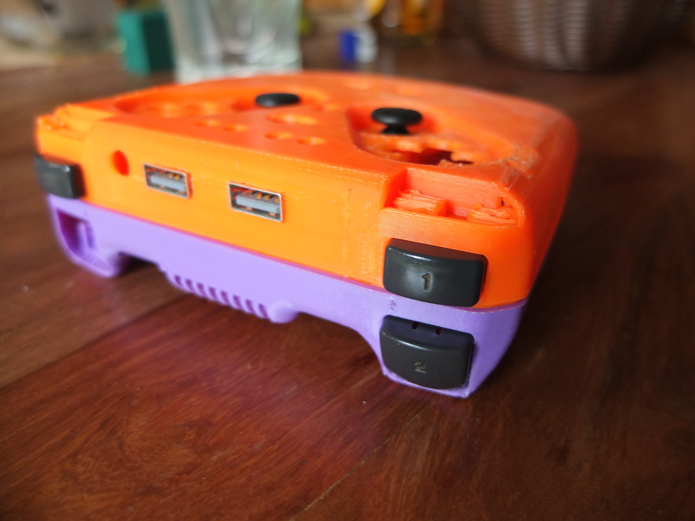

Looking at it again it looks like it's in Pain.

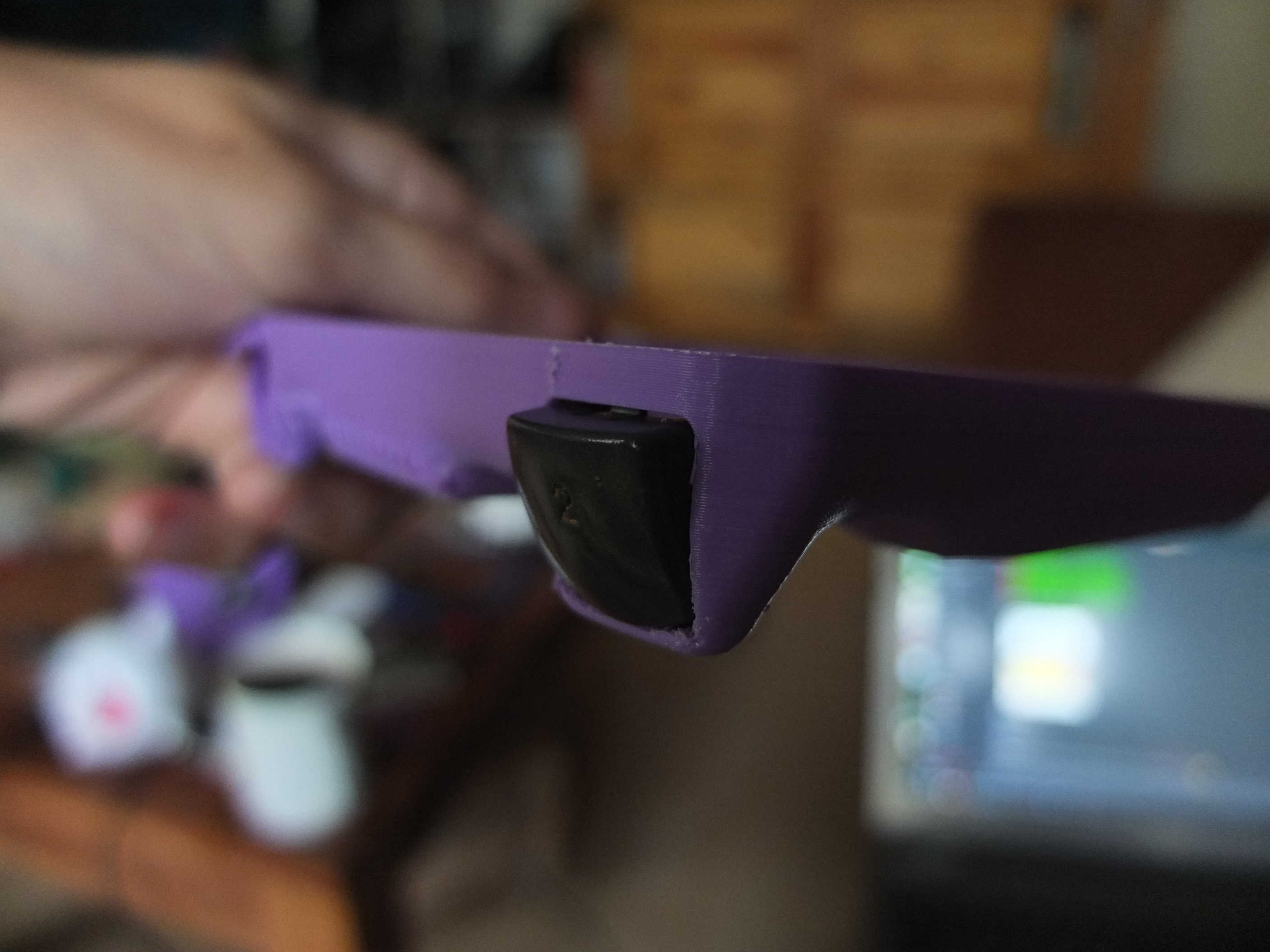

How does it feel to hold? it looks kind of bulky
are these things the speakers?
they aren't gonna get muffled by your hands when you are playing?

Also what type of joystick are you using?
Switch Analogs. Wanted to use sliders.. but L3/R3 >.<''

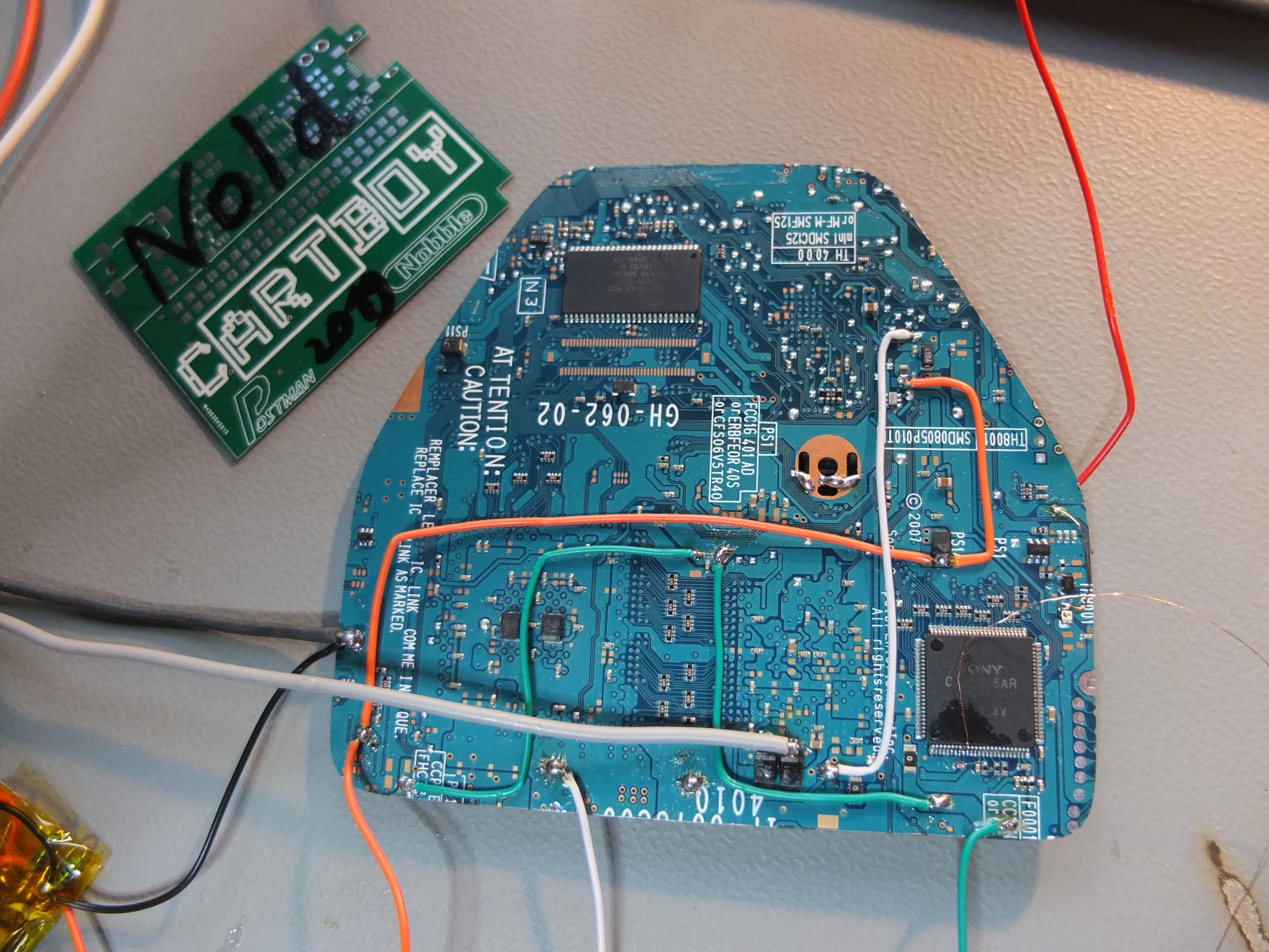

View attachment 9134 [ I know you guys love CRTs ;-).. ]
