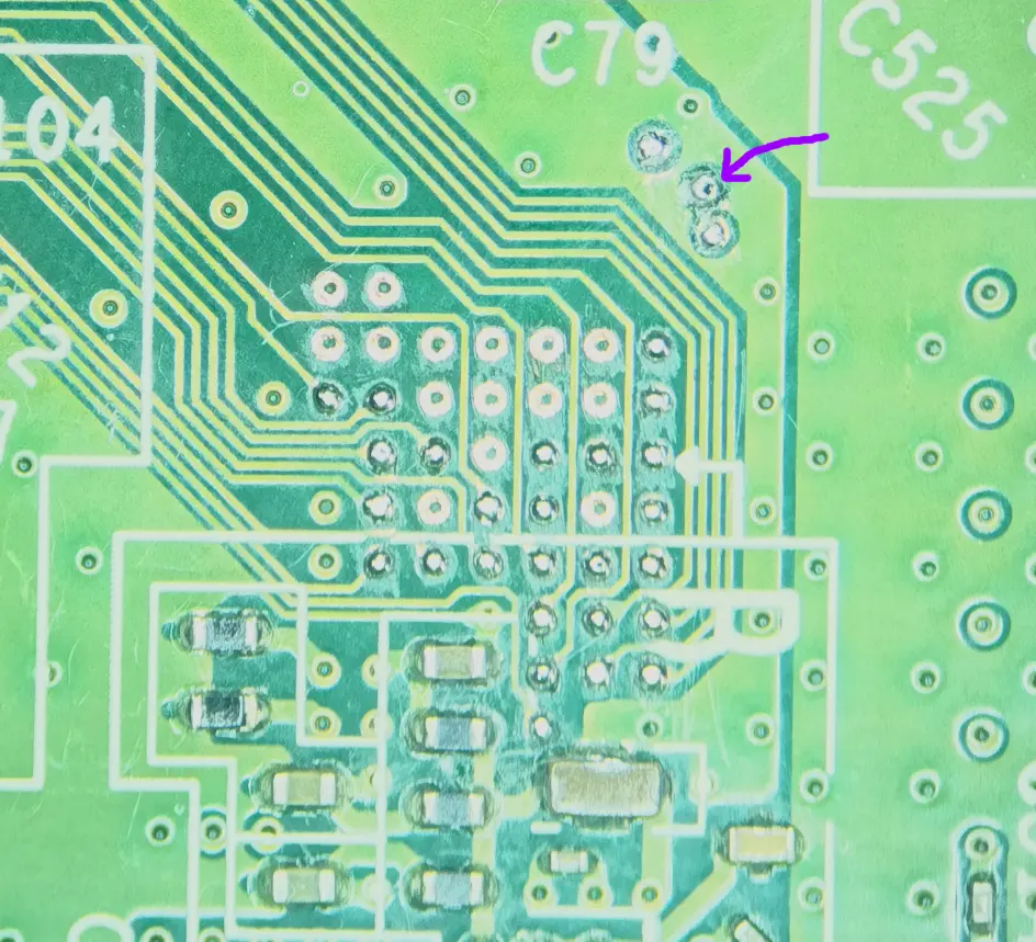

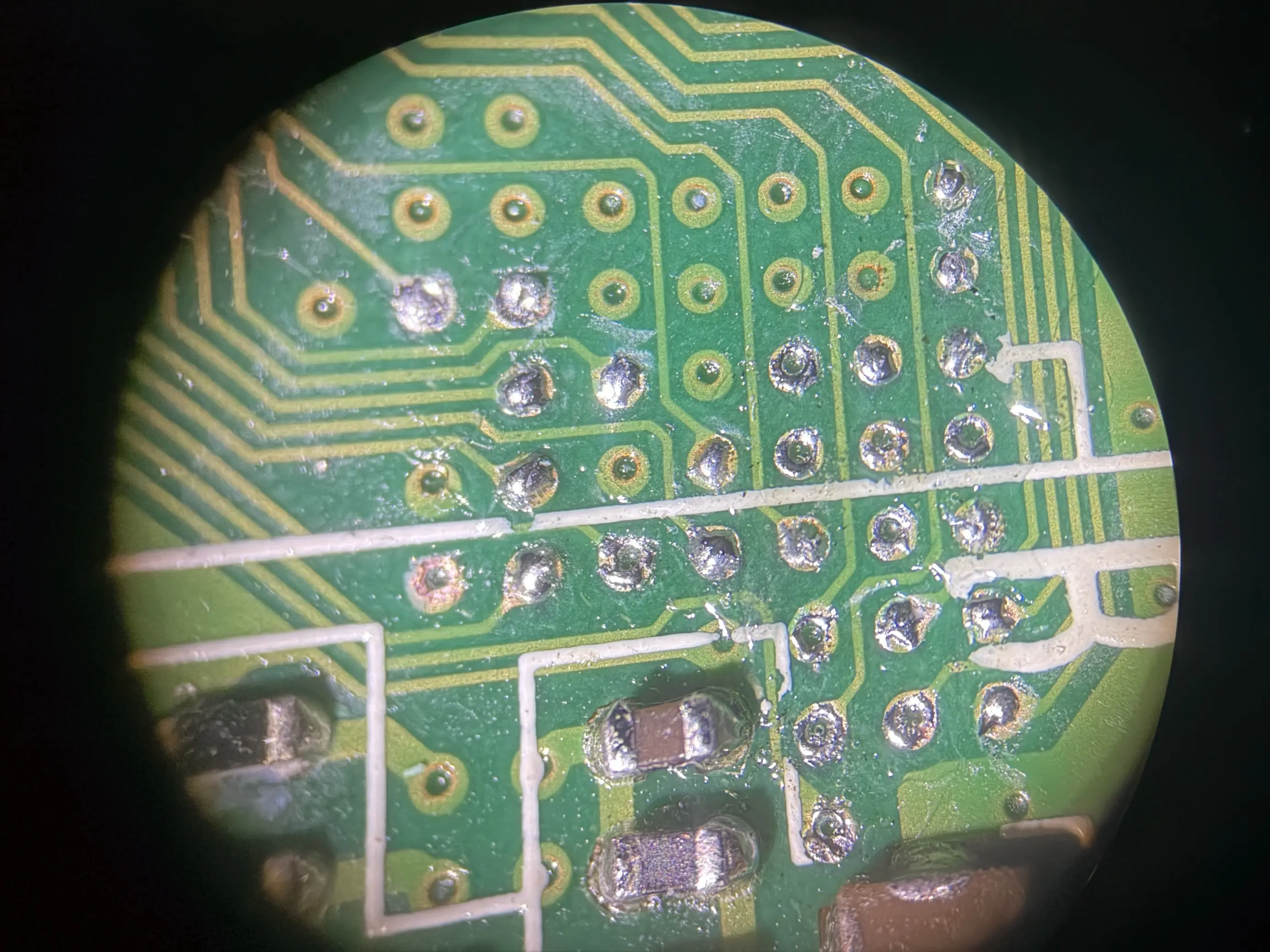

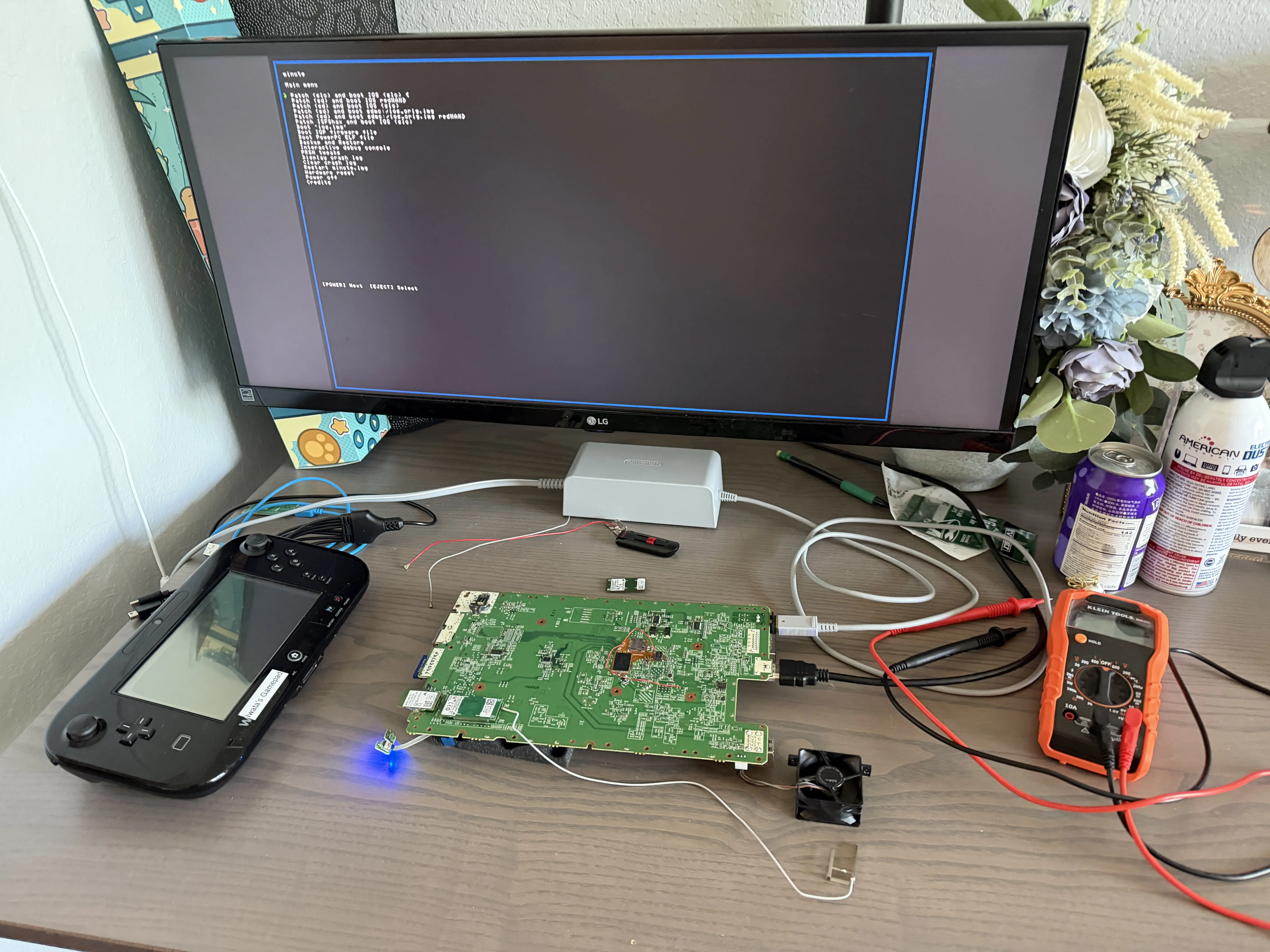

The good news is after getting the SLC onto a Caféflex, I got it to boot into minute after messing with the vias on the flex. The bad news is, it only worked briefly.

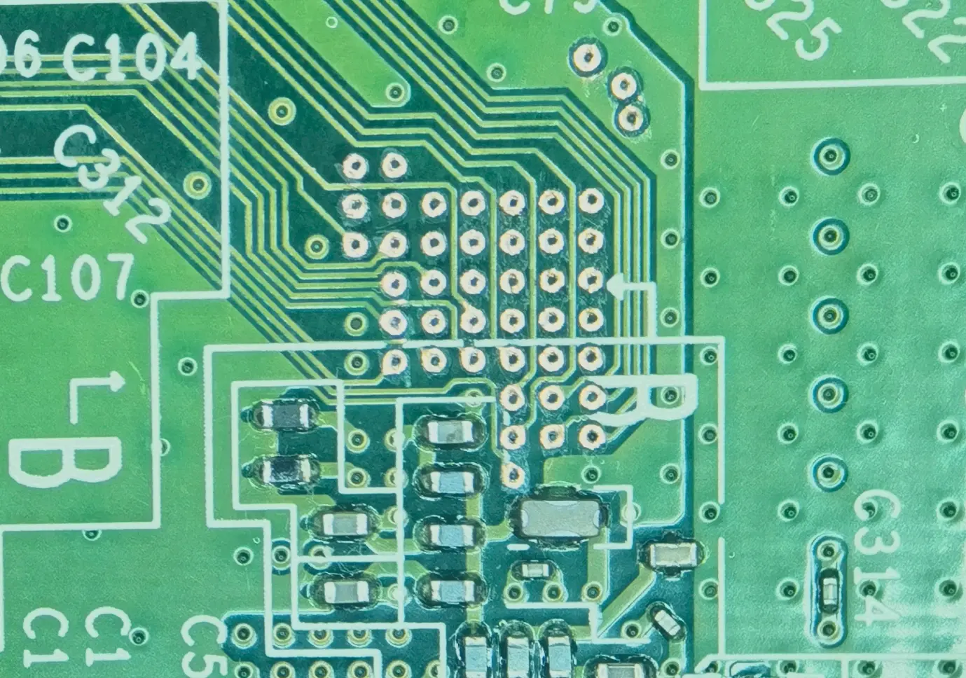

Here lies one of the big hurdles of the Wii U: I'm 99% sure that this was because of the plugged vias on the WUP-50. If you're not familiar, the Wii U revision that's been the hot topic is the elusive "WUP-50" which features a die-shrunk SoC. It's superior to the other revisions thanks to lower power consumption... but the downside is it has its vias filled up with solder mask. Why is that an issue? Have a look at this:
Notice how some of the vias have those nice, complete "bubbles" of solder and others are doughnut-shaped? That's because the solder just refuses to ball up nicely over the plugged via. They're all supposed to be perfect in order for this to work. And I know I could've done a better job scraping mask off some of these points, but every time I come in with a knife I risk permanently damaging the board.
I know from my last build that ordinary vias are much easier to do this trick on. (I had to do so for RVL-DD, and that worked perfectly.) I'm not the best board mechanic in the world, which is why this is bugging me from a future reliability standpoint. I think I'm gonna get ahold of a different motherboard revision to experiment with. It's the "worse" choice for a portable, but it may be the one that ends up working.

While the WUP-50's plugged vias are more difficult to deal with, they're definitely not finicky enough to warrant the ~11W hit of using a WUP-01/30/40. That's two whole Wiis worth of additional heat you have to dissipate, not to mention way more voltage drop over your 1V wires, lower regulator efficiency, ~30% worse battery life, etc.
Based on your picture, you didn't scrape enough mask off the vias before you tinned them. If you look closely in this pic, you can see deep scratches in the motherboard around each via. I use a sacrificial pair of sharp tweezers to do the scraping; it's a lot safer and more controlled than an X-acto knife.
The goal is to get ALL of the mask off, forming a little 'well' or divot in the mask, which encourages a solder bubble to form.
The term "solder bubble" is very literal because when you tin the via, the air trapped near the soldermask plug will expand and burst out, popping the solder bubble. You can see how that looks on the marked Wi-Fi via below.
When this happens, you must keep your iron on the via and feed more solder in. Eventually all of the trapped air will bubble out, and the solder will completely fill the pocket above the soldermask plug. If you remove the iron, don't feed in more solder, or don't have the entire annular ring completely exposed and tinned, it won't work well.
Also, flux is key to getting solid joints. After you've tinned all the vias with convex solder bubbles, use your finger to rub a thin layer of tacky, high-solids flux (Chipquik SMD291 / SMD491, Stirri-V2-TF, 759-ASX, MG Chem 8341) onto the board. Then tack the flex down on top, solder each via while applying surrounding pressure with tweezers to ensure good contact, and finally feed more rosin-core solder into each joint.
I know that was a little handholdy, but I hope it helps. I really want to see you utilize a WUP-50, cause they're sooo much better than A5X boards! Good luck on your build!

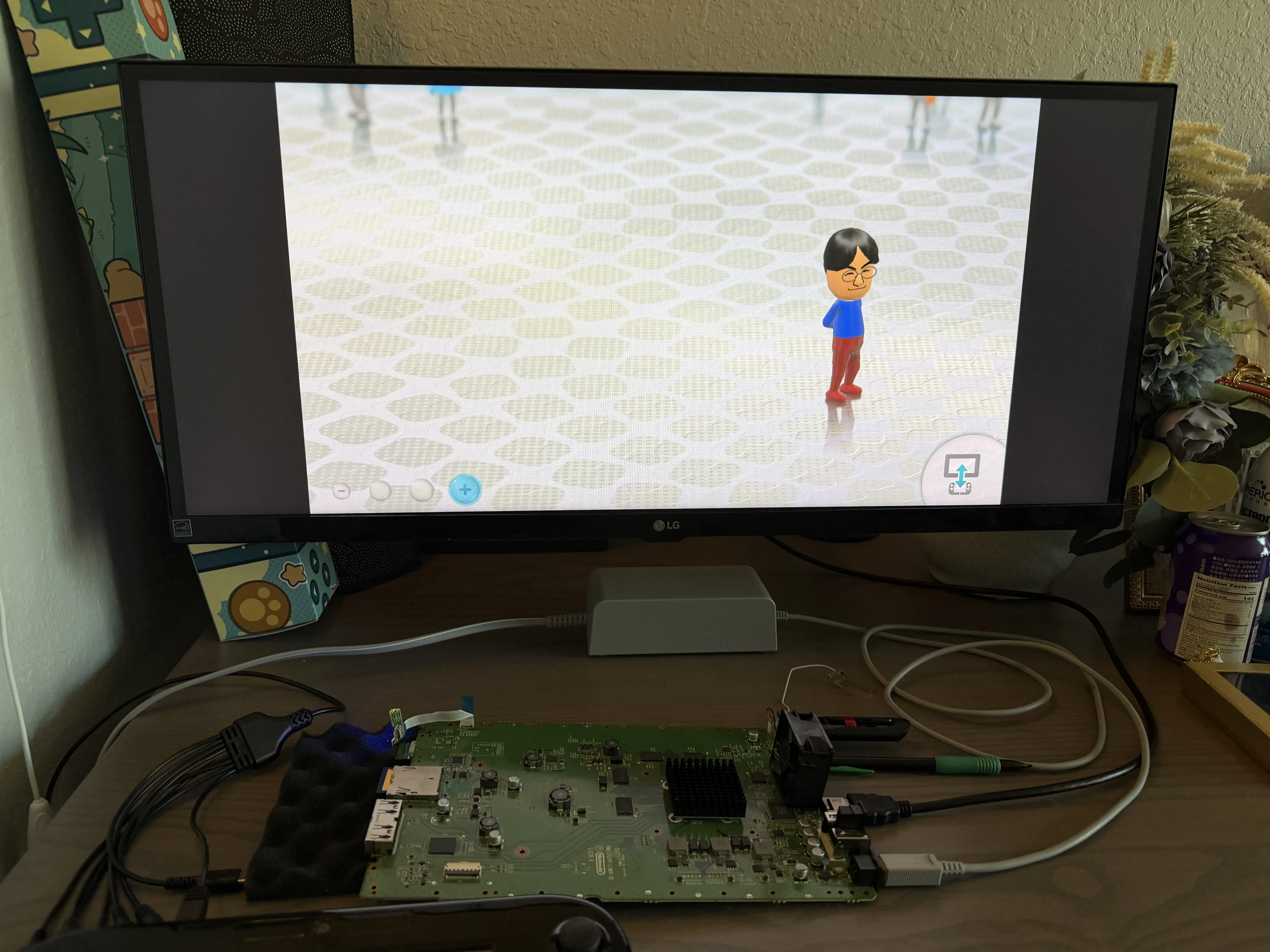

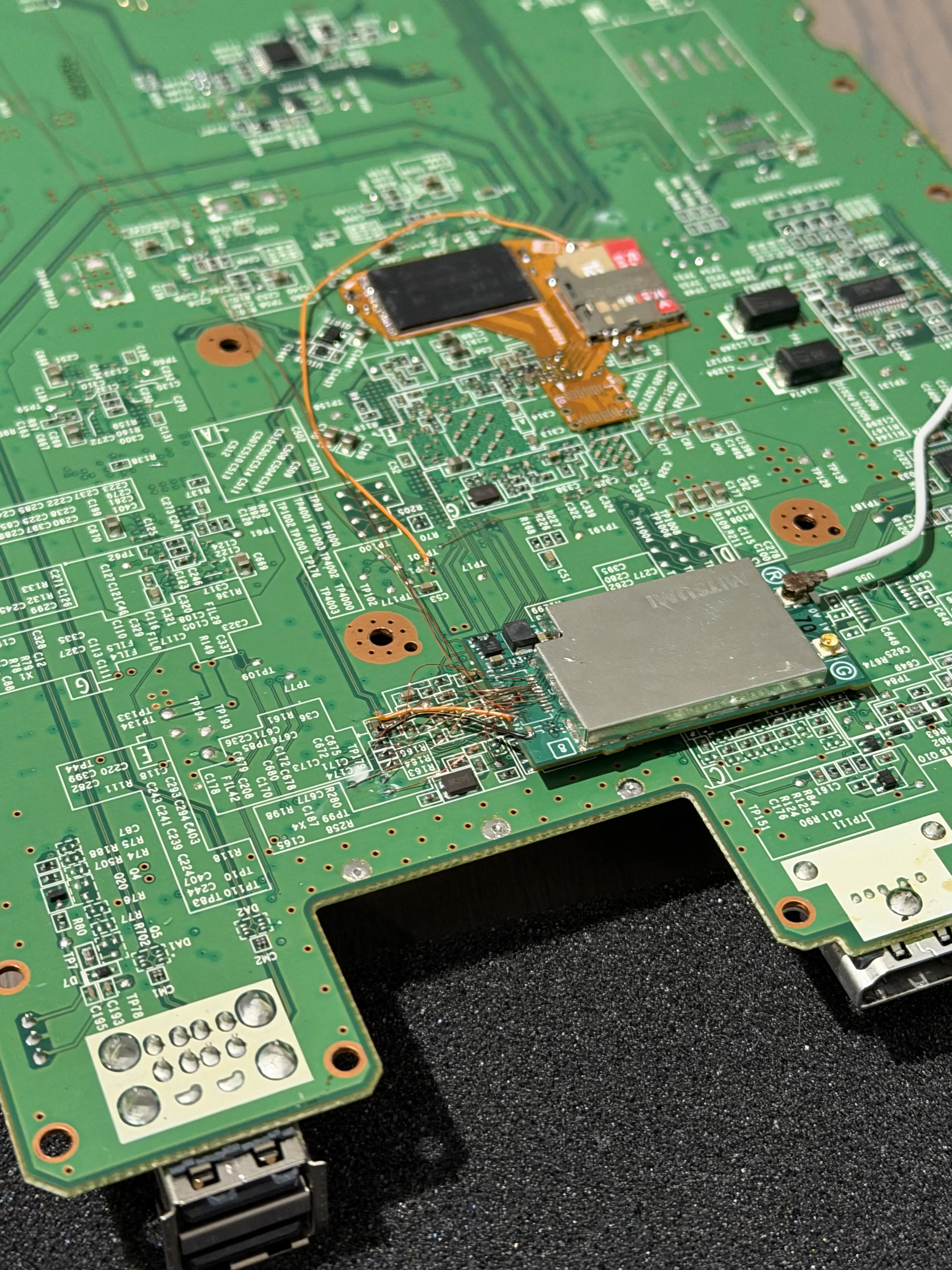

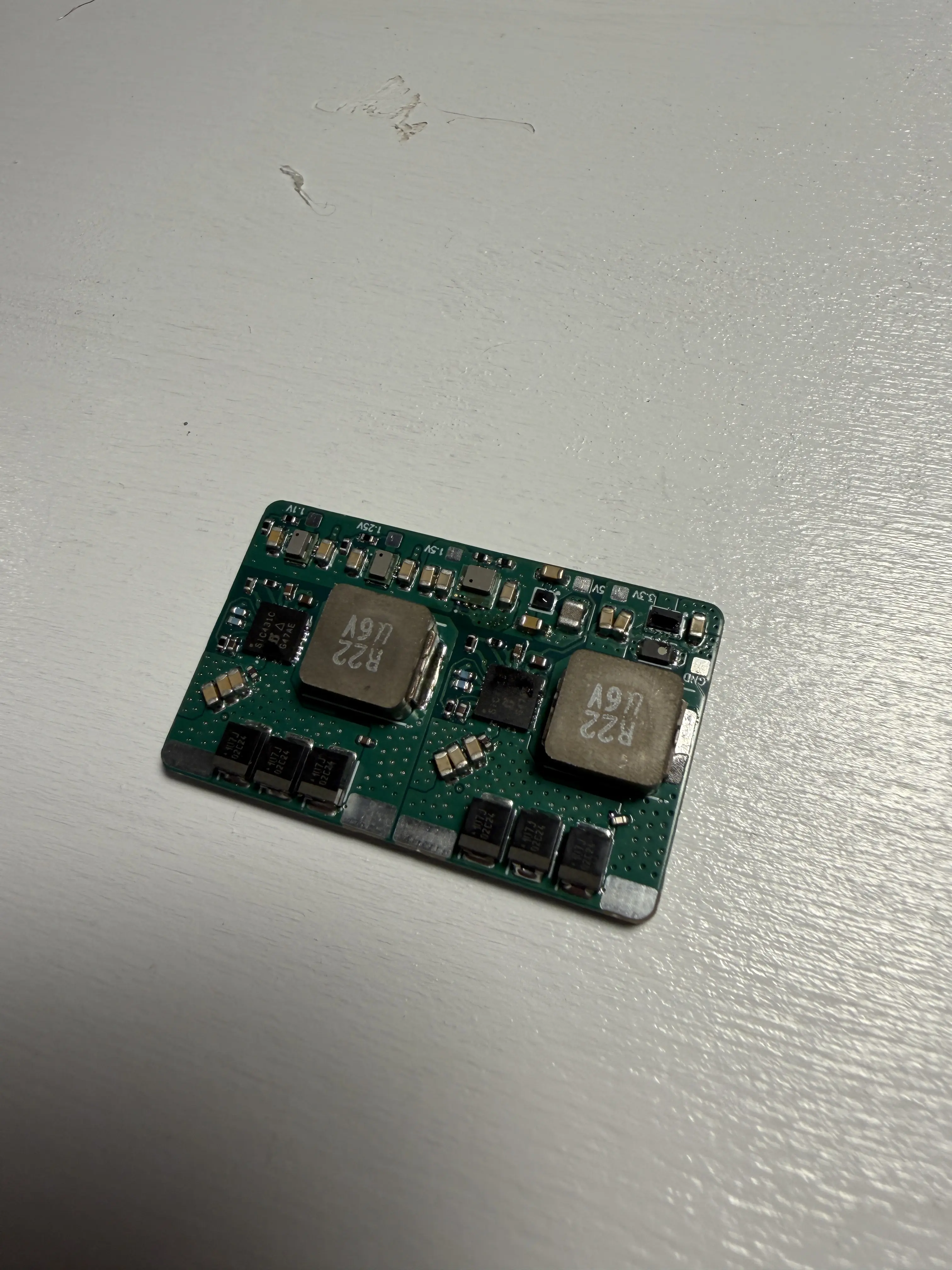

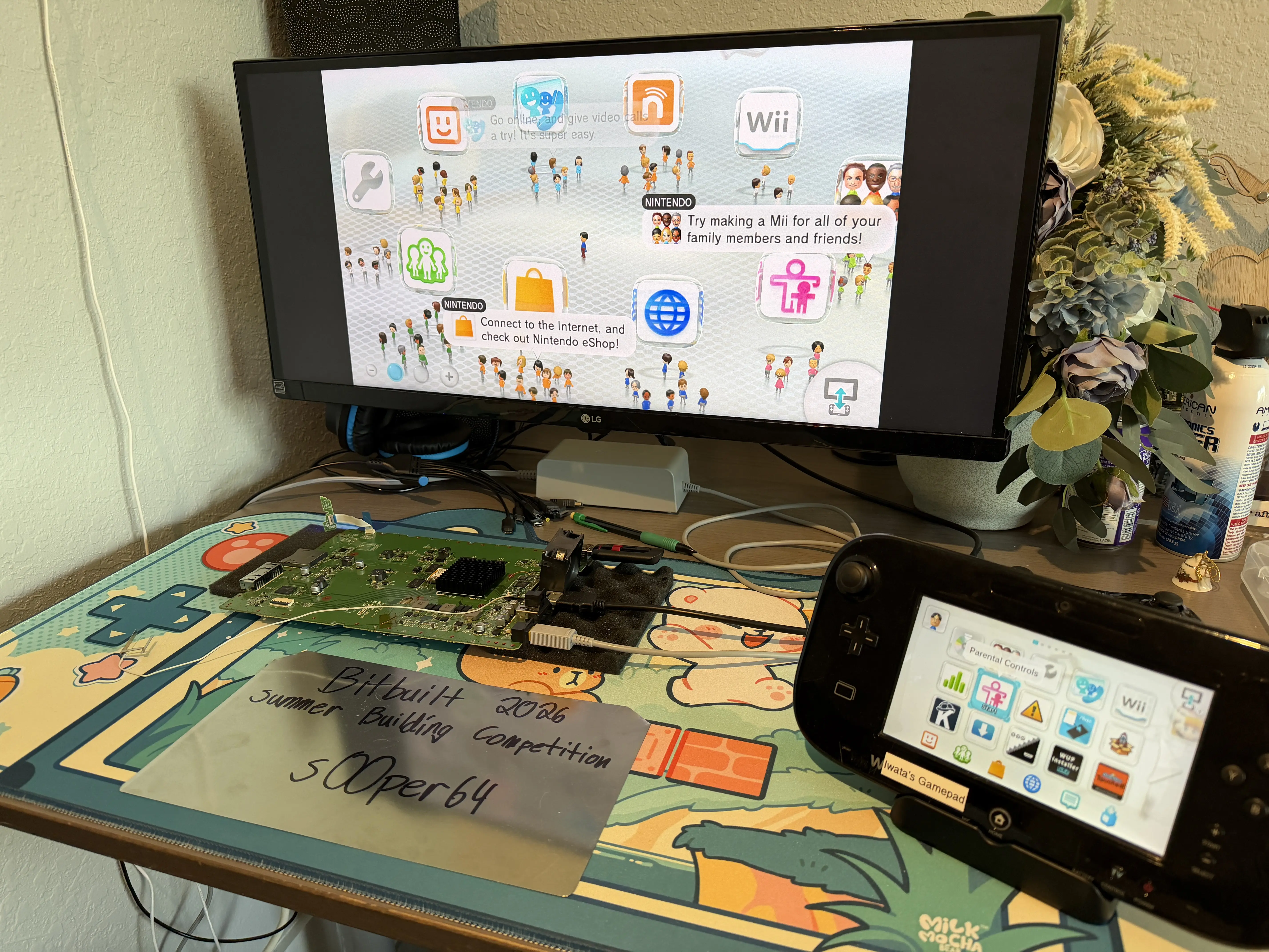

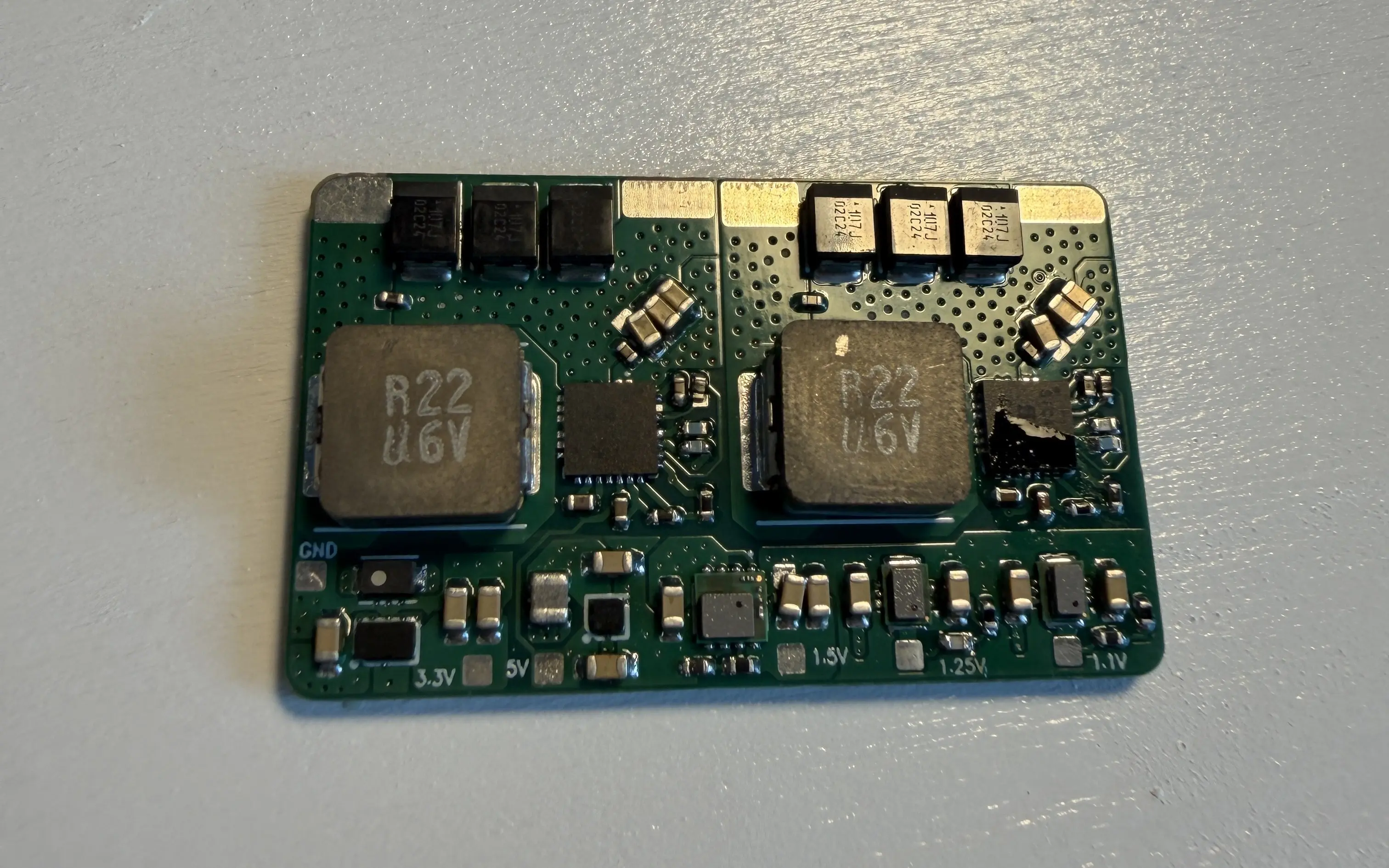

I'm back with an update! While waiting on extra Caféflexes, I tried my hand at assembling a Bistro. It went alright. I need to retry the two BGA-package regs, they both have shorts. But this isn't necessary until I trim and that's still a step or two away.

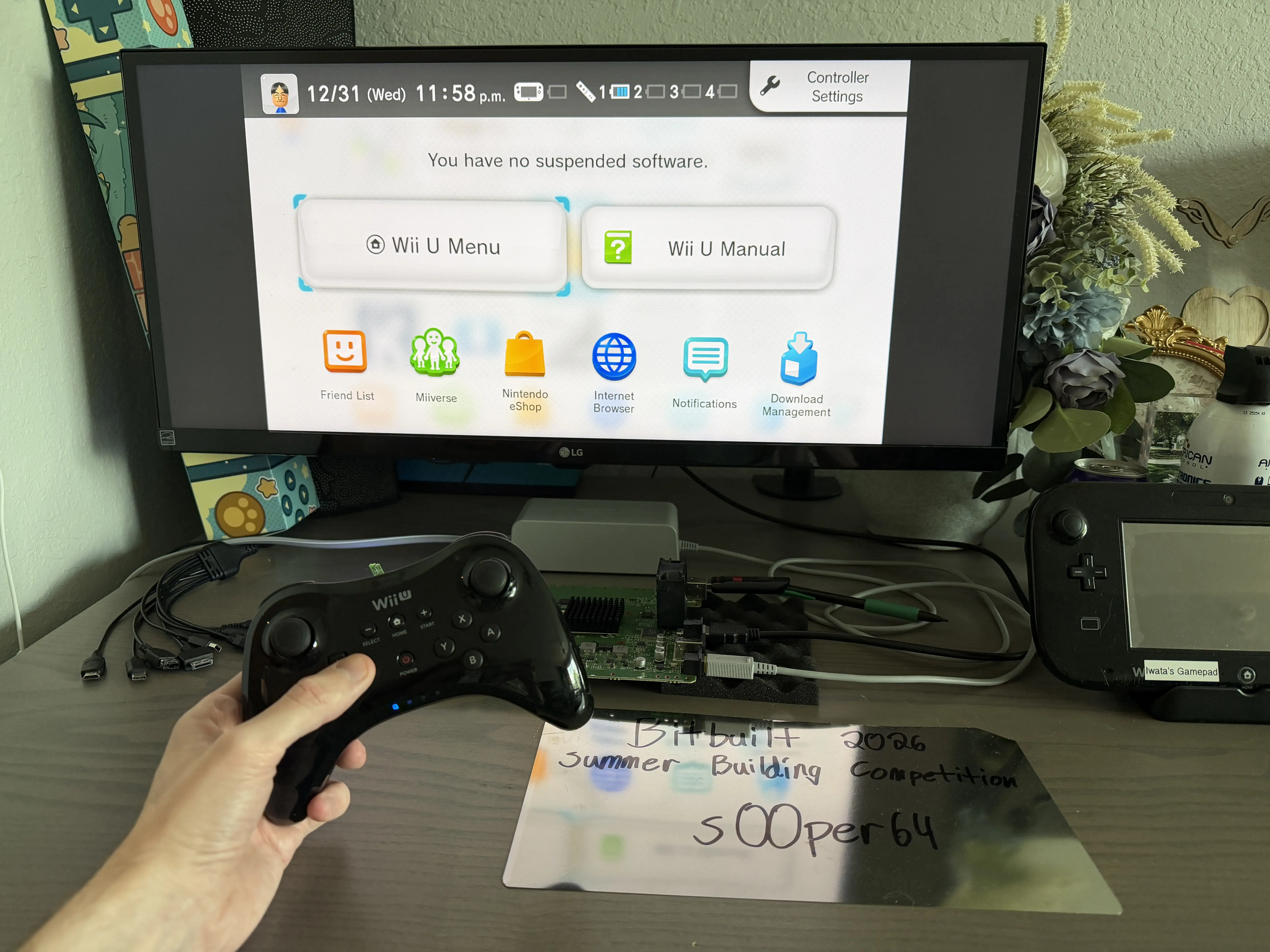

With an extra flex and some advice from @YveltalGriffin, I managed to get the memories relocated! I opted to skip WiFi this time around, I burnt up a ferrite bead during the last attempt. But the board still works! Relocating the two memories and reinstalling the OS was a big hurdle, but it boots reliably now!
Be back soon!

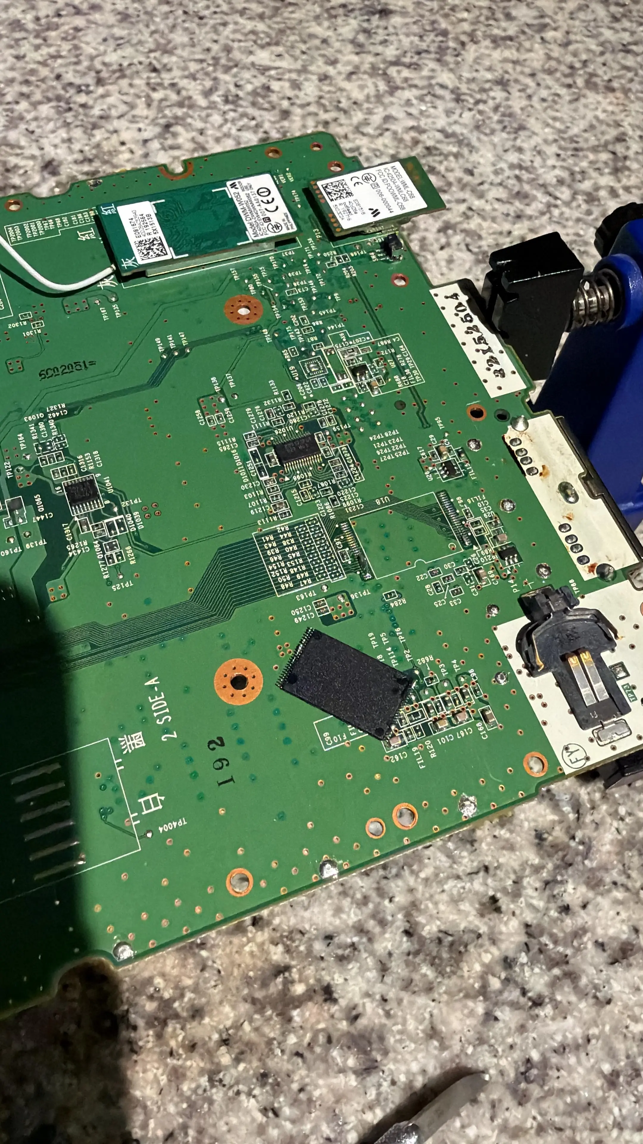

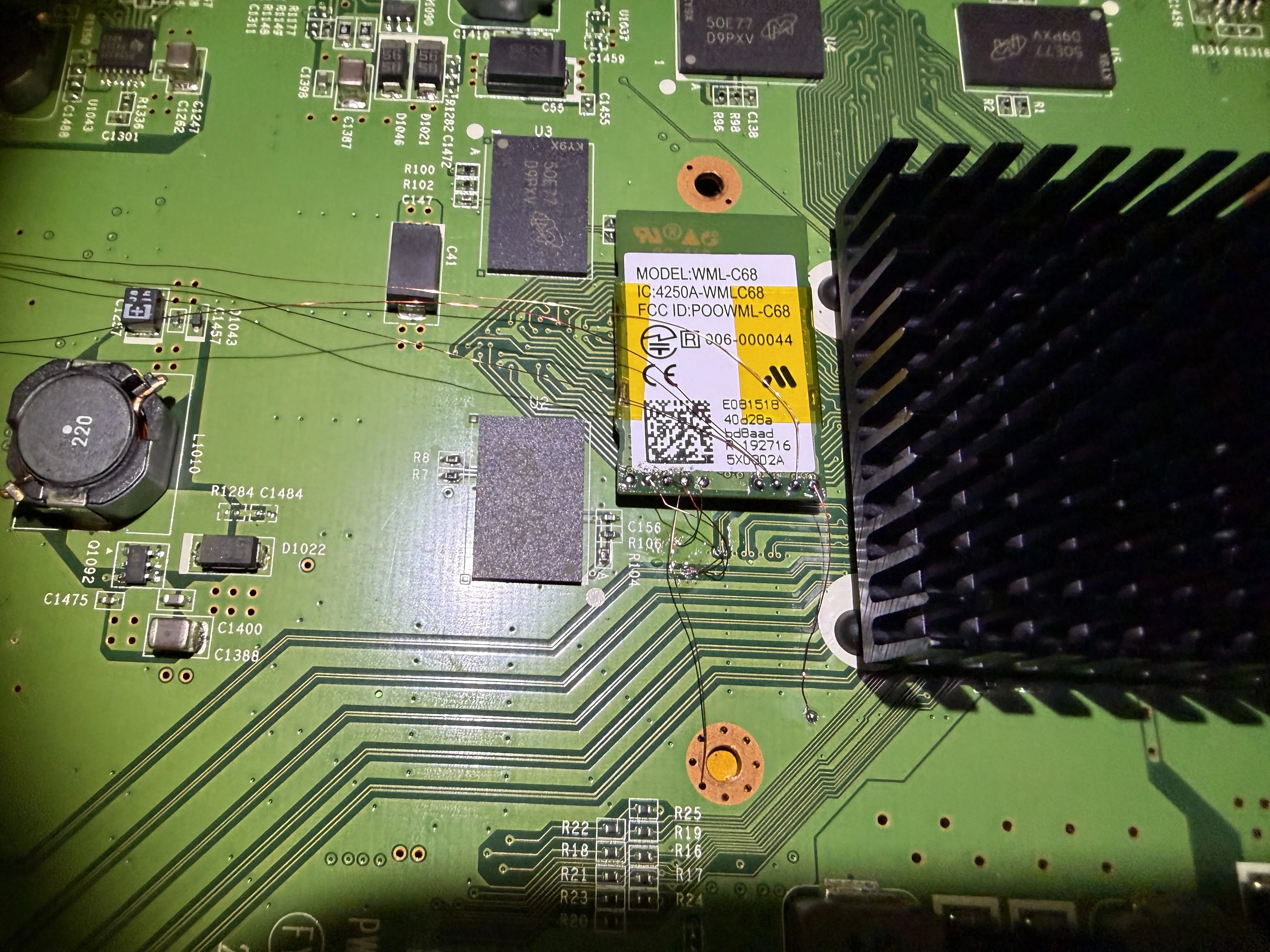

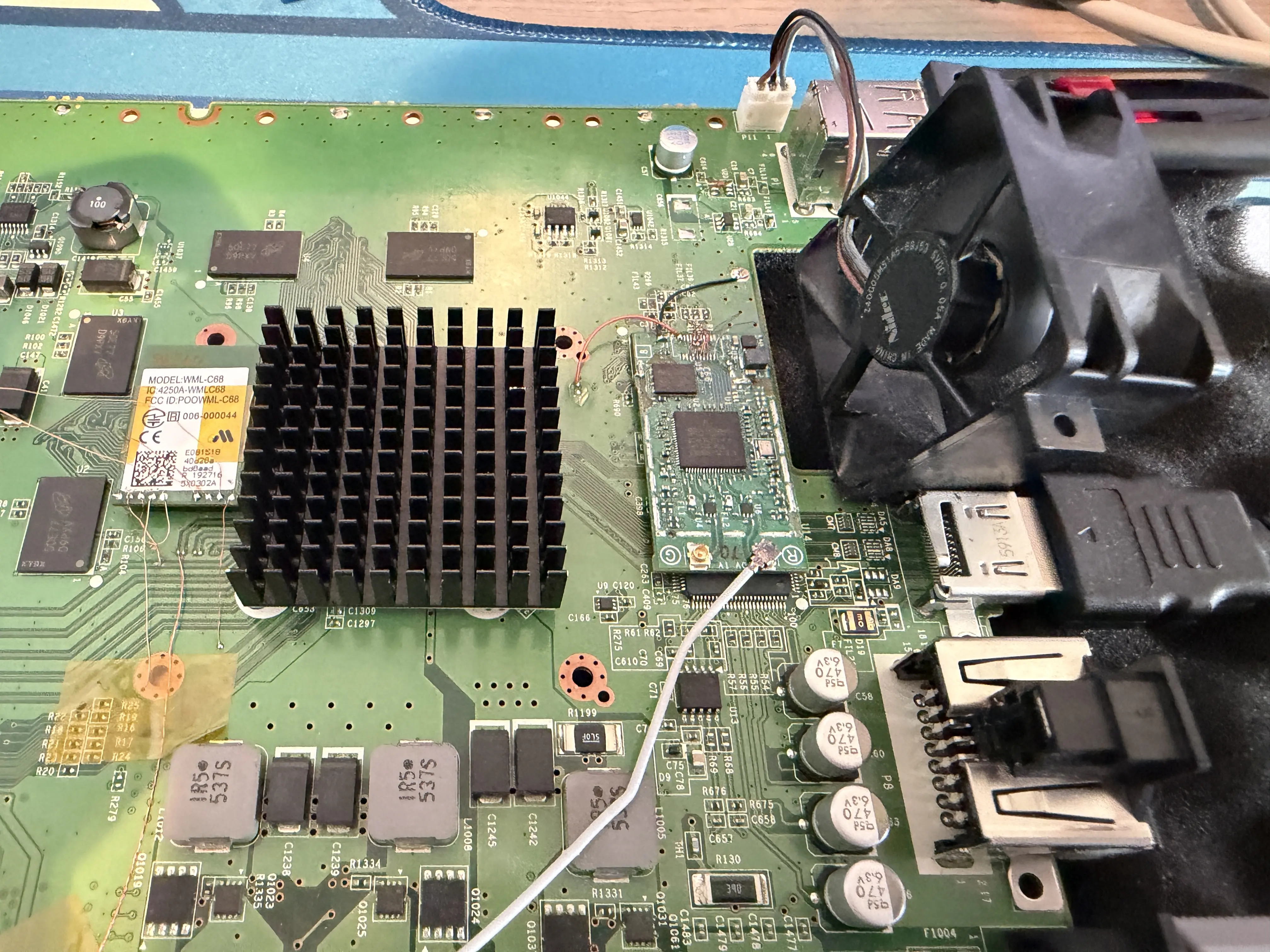

After getting the memories relocated, the next item on my agenda was to relocate the two wireless modules. (WiFi was successfully patched out.)
The Bluetooth module worked on the first try, but the 5GHz module sent the power management into panic mode. To be clear, I didn’t find any shorts or signs of burnt parts. I admit my lines to the SMC are not neat, so there’s a chance of interference. Removing the module brought the console back with no issue. After reading the WURD a little more, it looks like 5GHz relocations have only happened after power relocations or board trimming, so I’m chalking this one up to some unknown SMC confusion. NBD, I can try again later and I have a spare lying around somewhere.

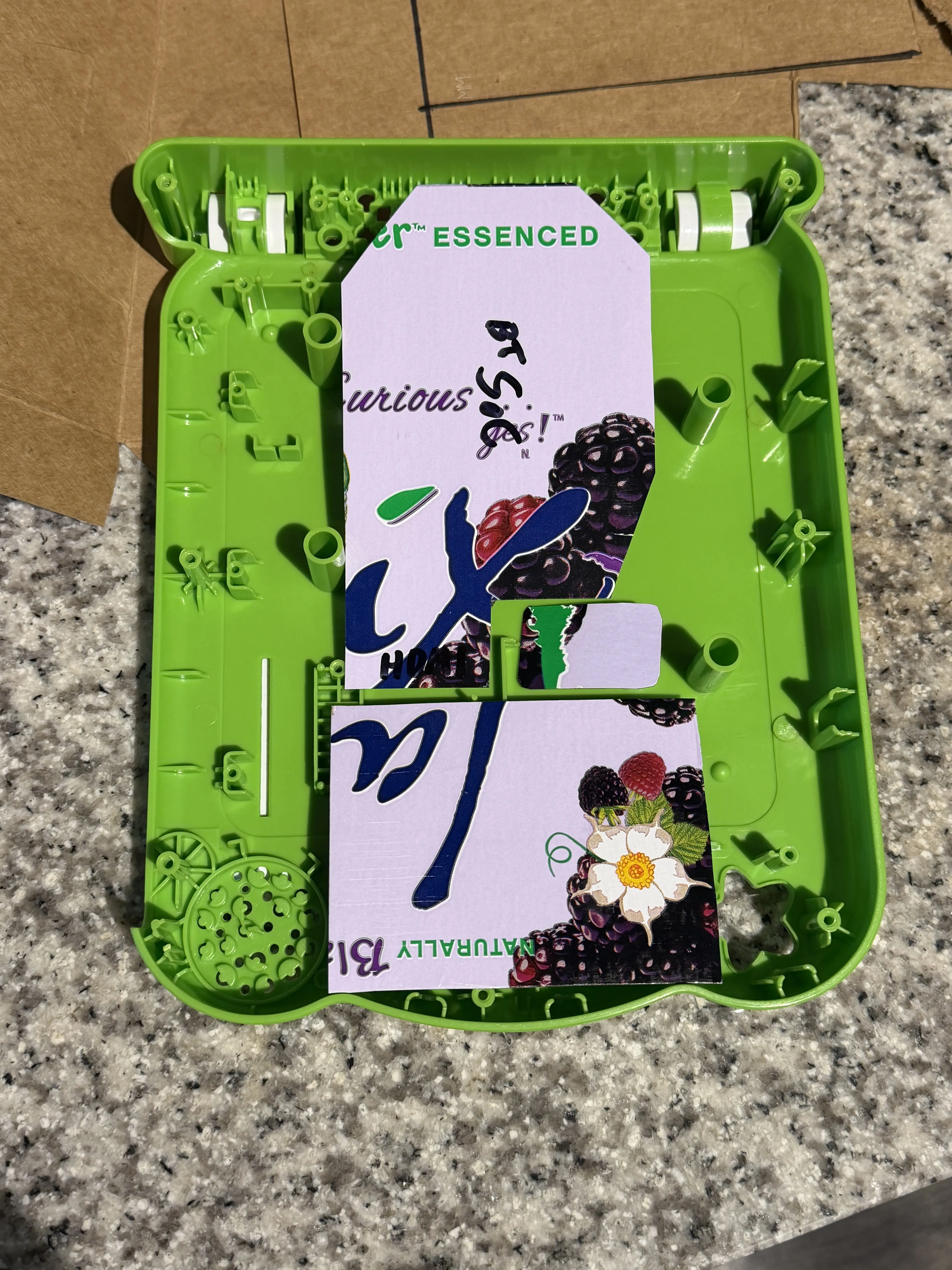

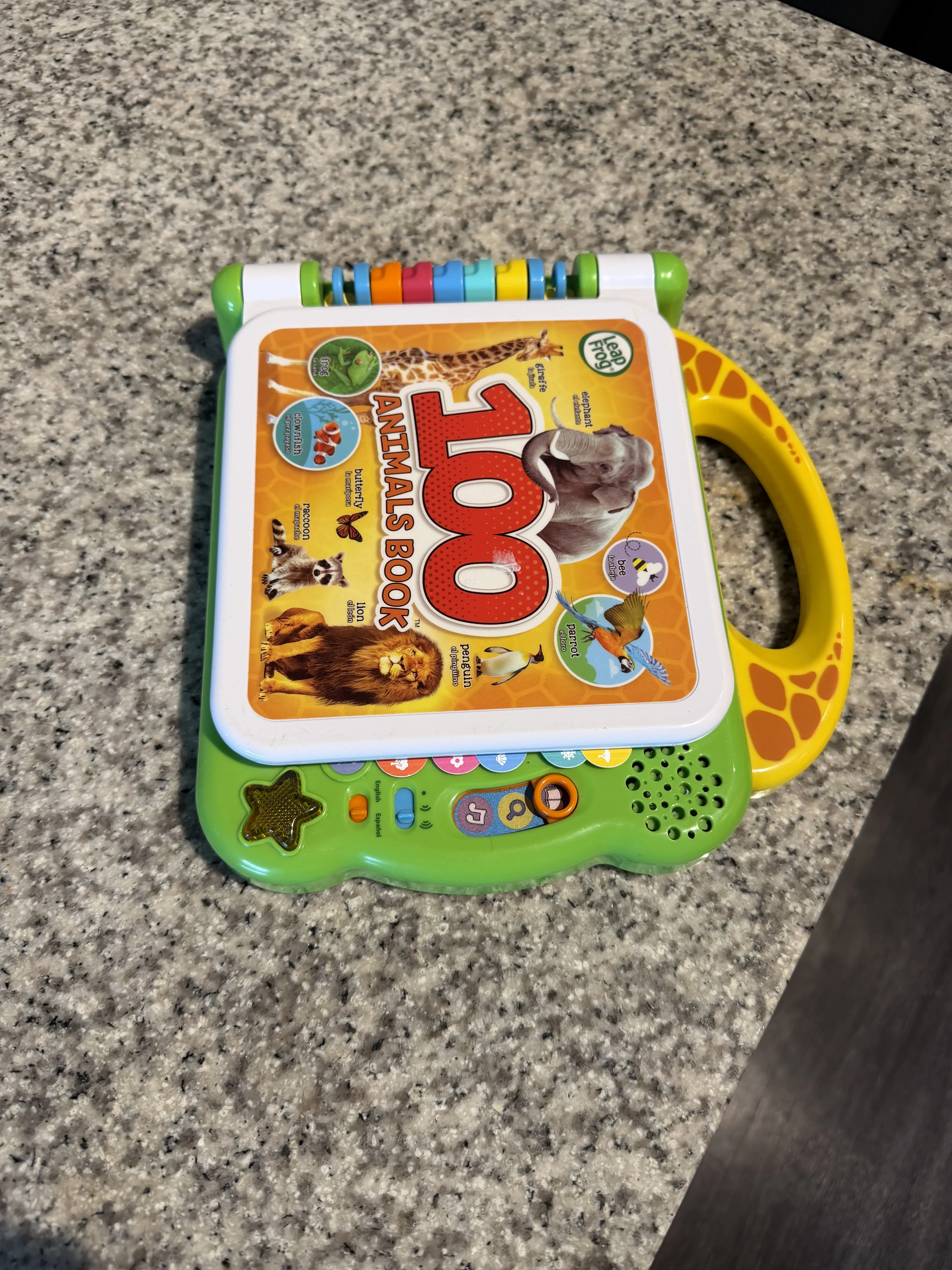

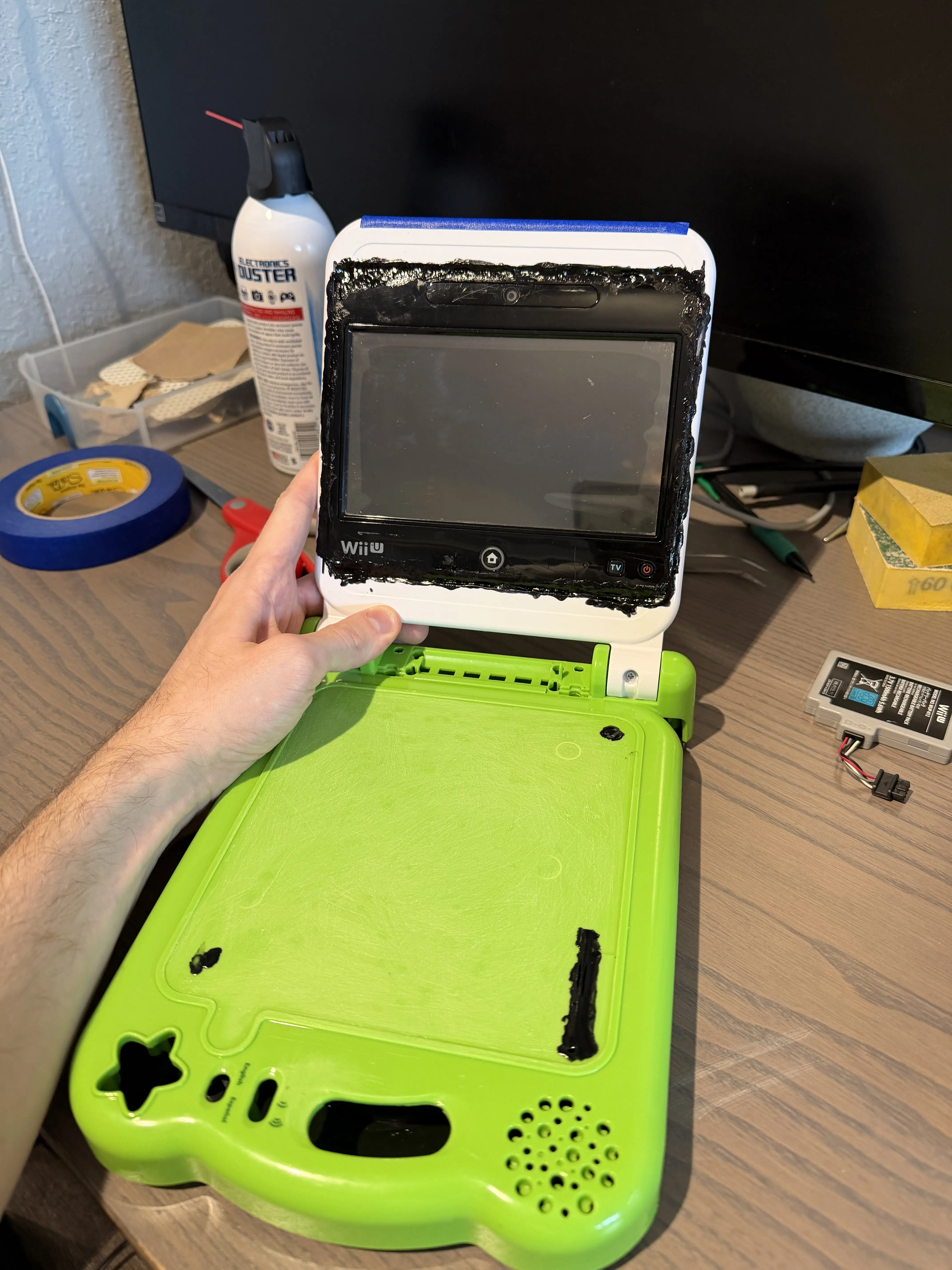

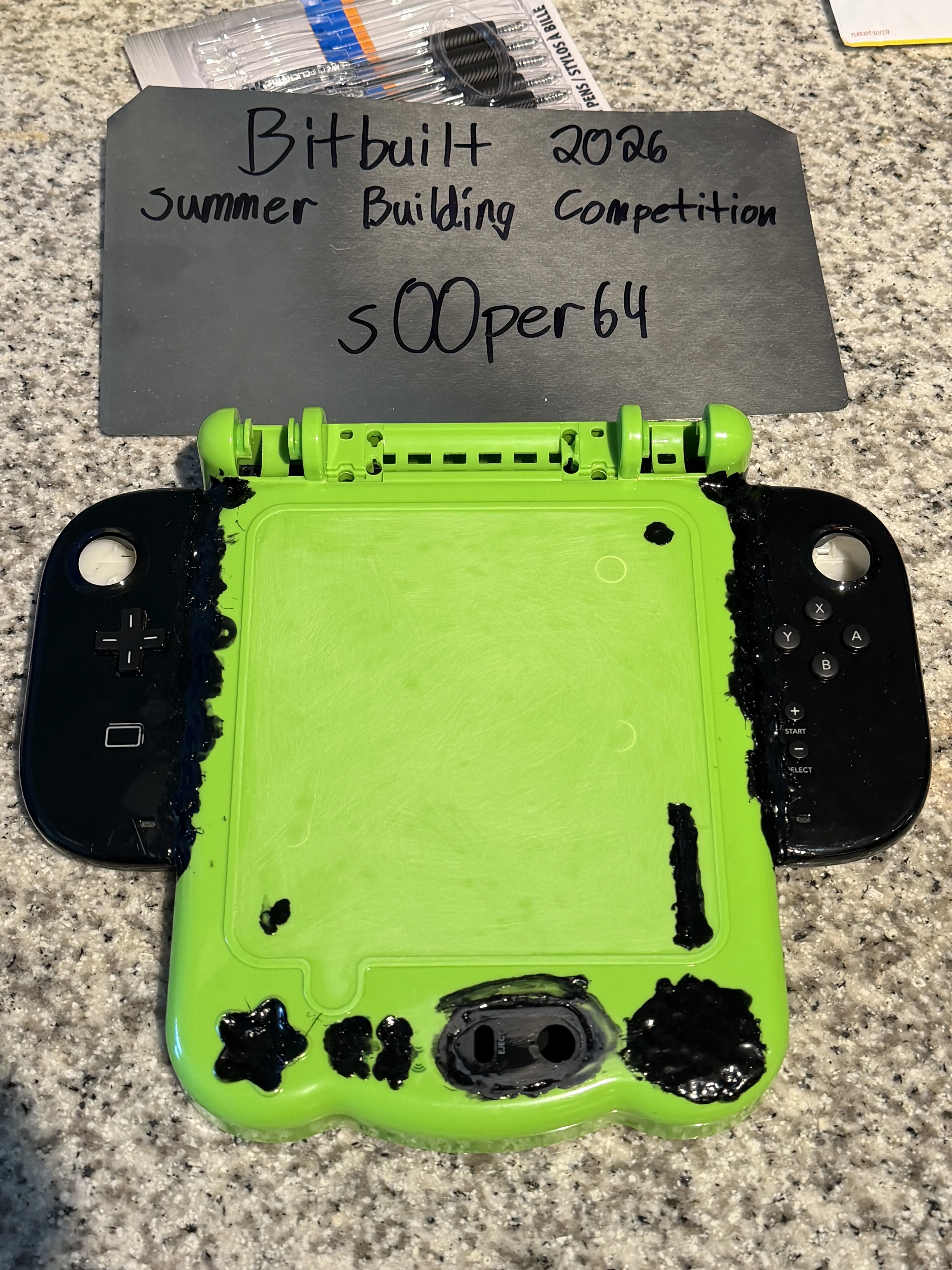

Meanwhile, I’ve also been deciding on the case. I want this case to be *comfortably* large enough to hold everything, but after doing some rough sketches in 2D and 3D I realized that might be too large for my printer. So one trip to the thrift store later:
I came back with this GBA SP-like Leap Frog book. It’s big, but there’s no arms race for size here, at least for now. :awesome: I’m thinking of sticking the whole Gamepad into the upper clamshell. It’s not very thick, but I can make cutouts in the top of the lid if I need more room.
There’s clearance between the lid and base to make room for the pages, but I’ll probably leave that for the controls. The controls are gonna sit adjacent to the board as you see it laid out. I anticipate I’ll go with the Switch/XBox style of offset sticks rather than the parallel Wii U style since most games use the face buttons more than the right stick. I still plan on just the one screen for now, but if I add a second it’ll go wherever a big 16:9 screen will best fit in the base.

For the 5GHz module, I wouldn't bother with wiring to the SMC at all (i wonder if the module is 'pulsing' TP146 when it gets powered which the SMC REALLY doesn't like..), just the pulldowns/TP99/SDIO. i've gotten the relocation working like that w/o any custom regs.

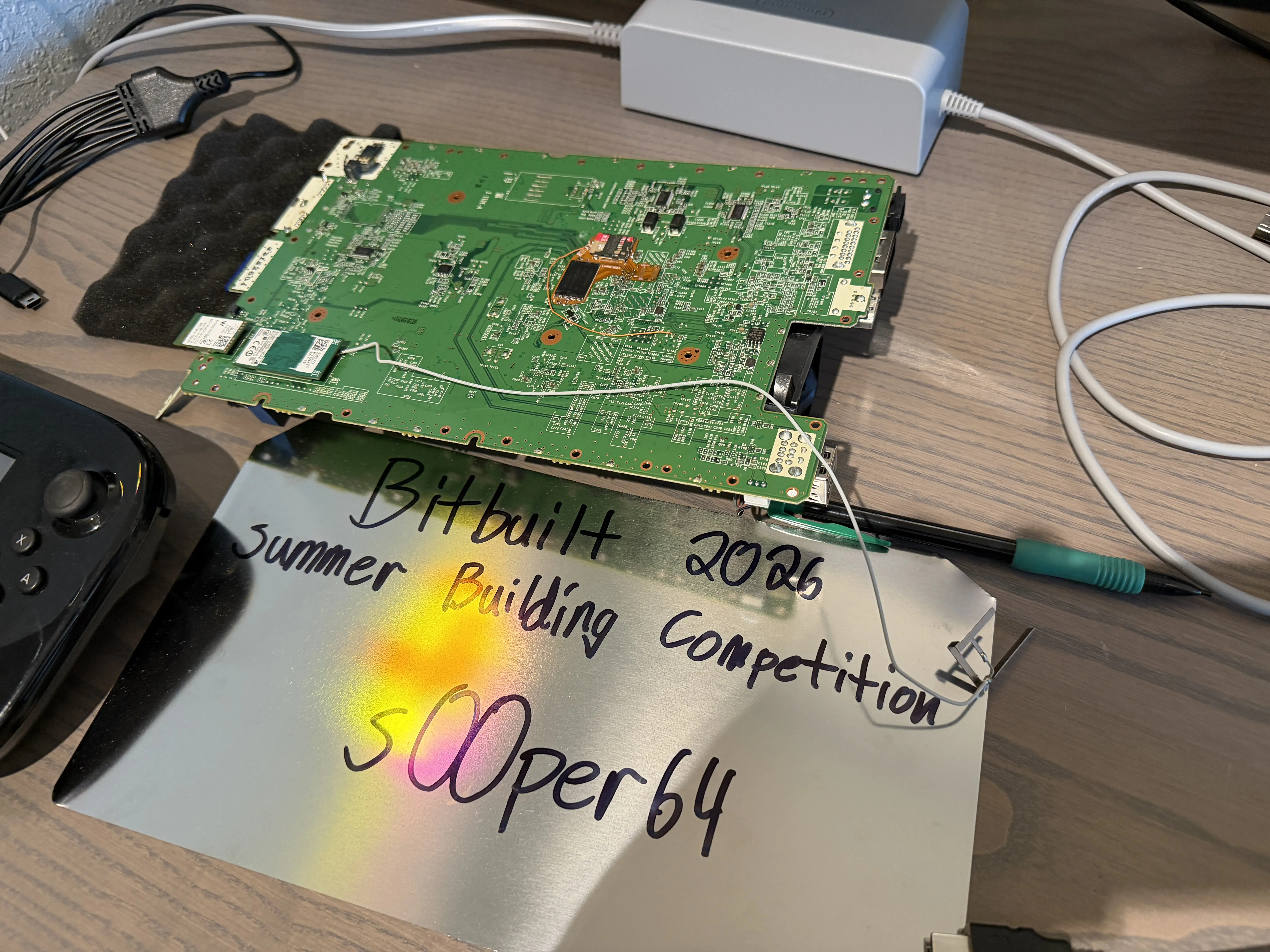

I've been busy with other things the last two weeks so I haven't had much to report. But the July fourth weekend gave me a chance to make some progress.
When I last posted, I was struggling with the 5GHz module. Two things helped me resolve that:
  1. @Lazr suggested getting rid of the lines to the SMC
  2. @YveltalGriffin suggested depopulating the series resistors (to disconnect the traces to the original connector)
With those two suggestions, I got it to work! (Thanks guys!) As soon as I get the power situation worked out, I'm good to start trimming!

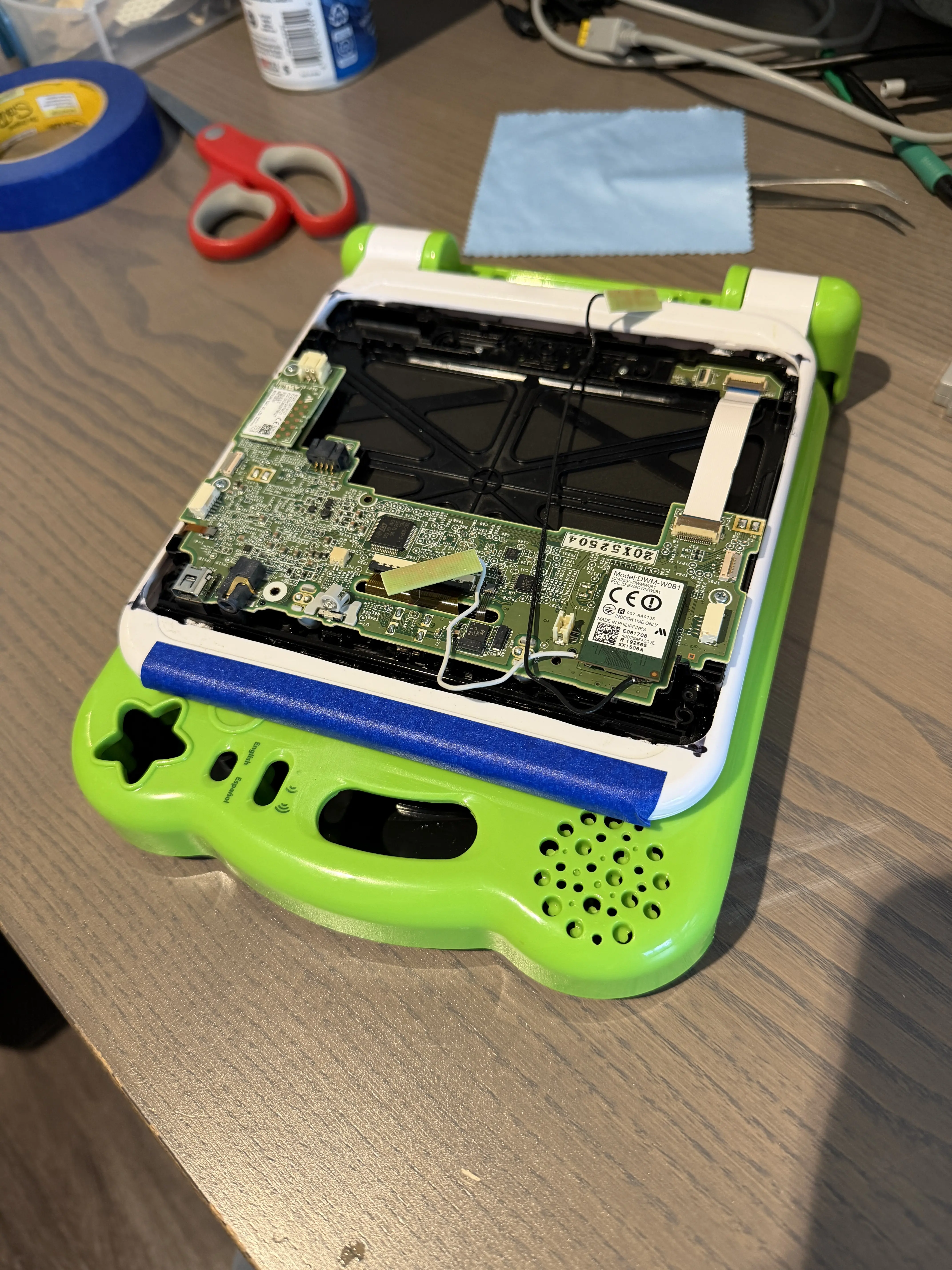

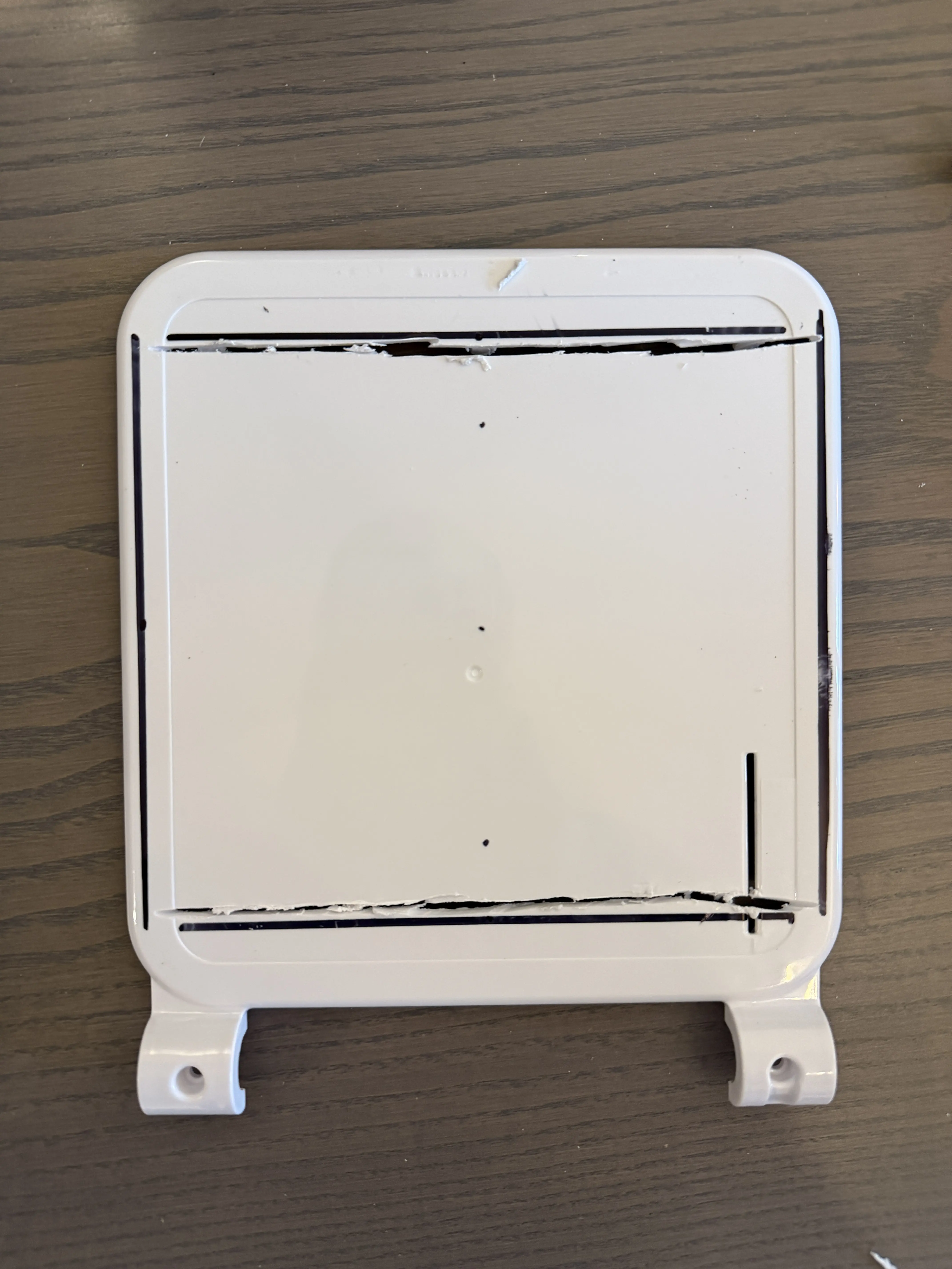

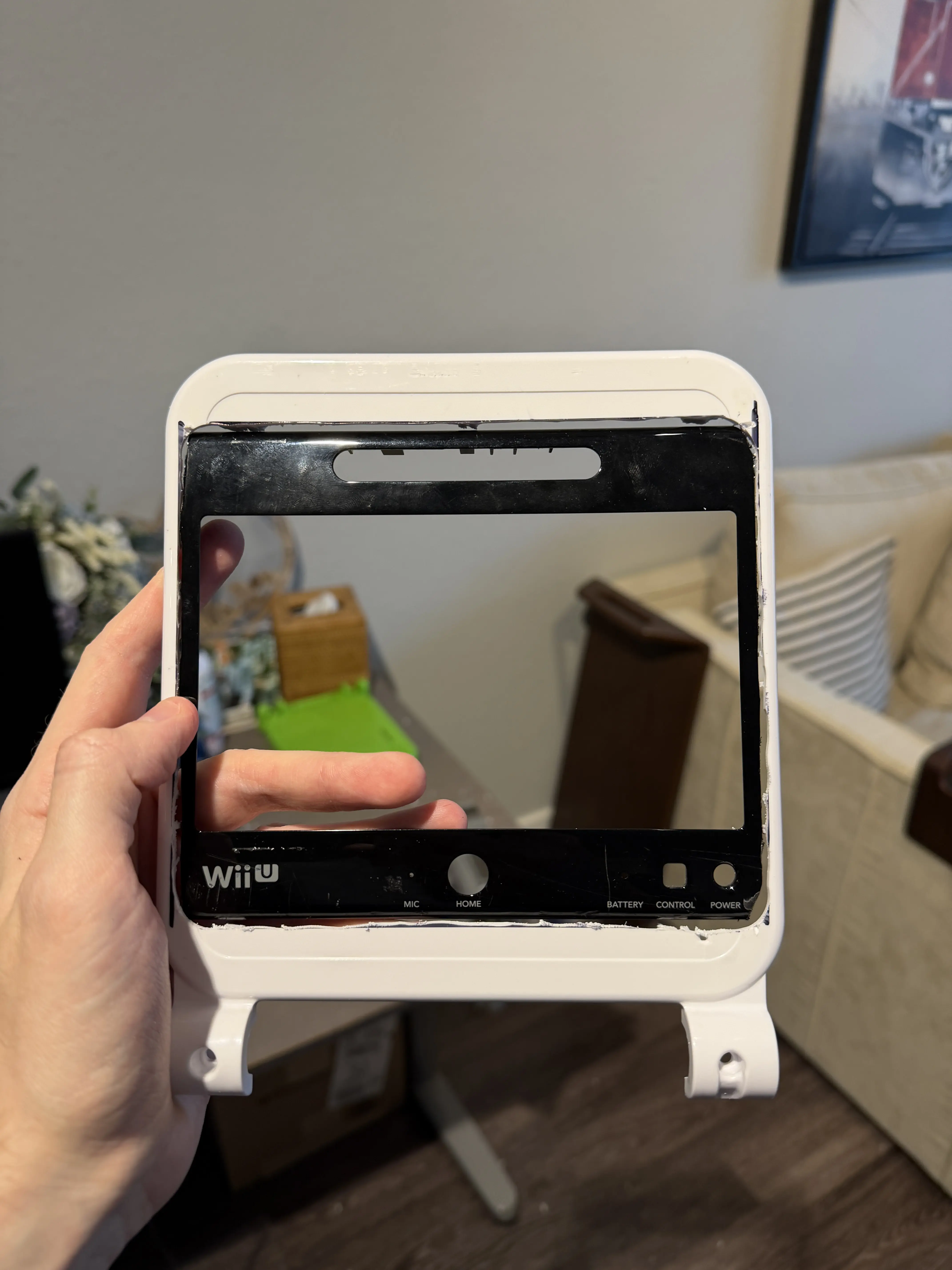

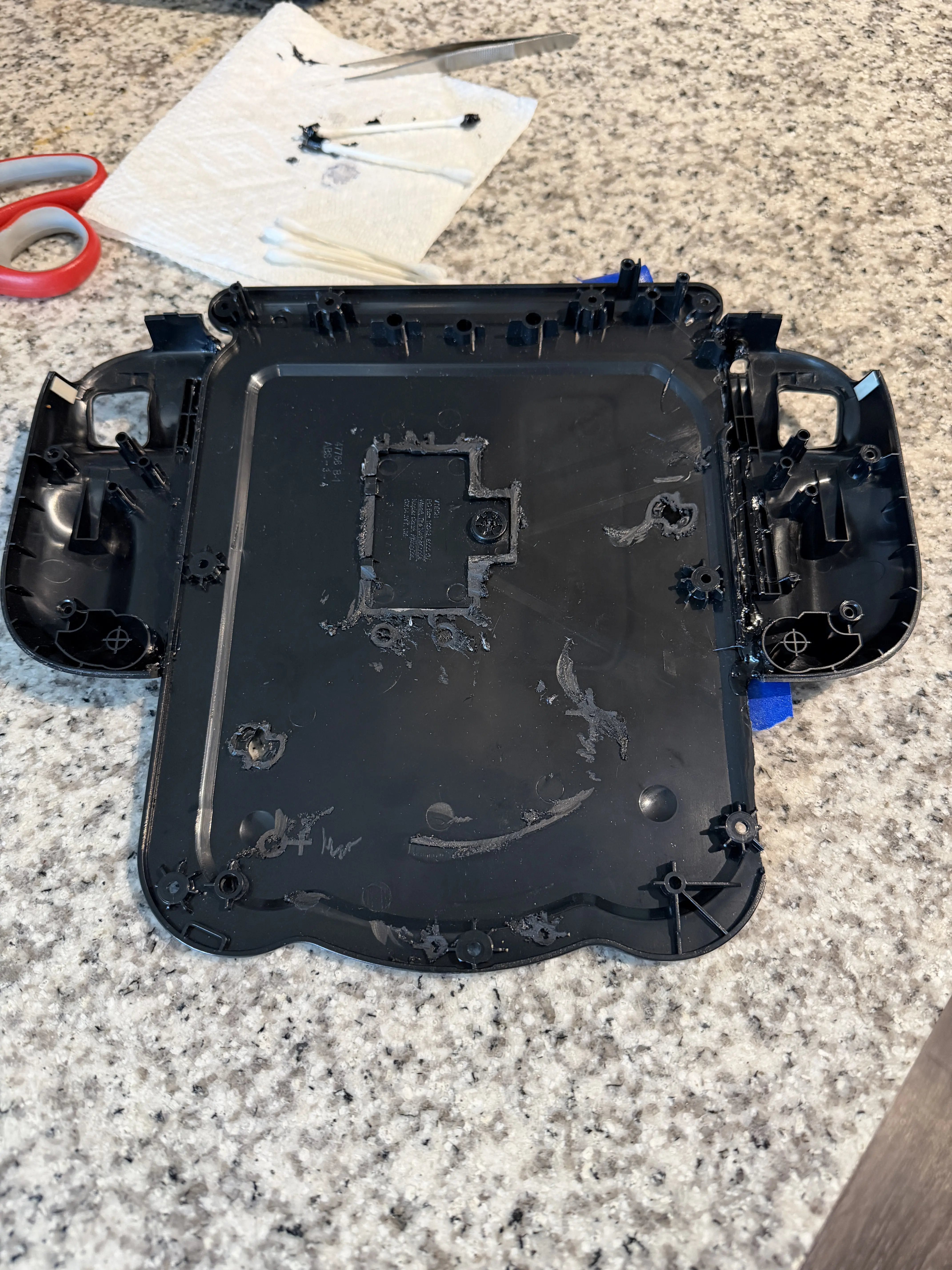

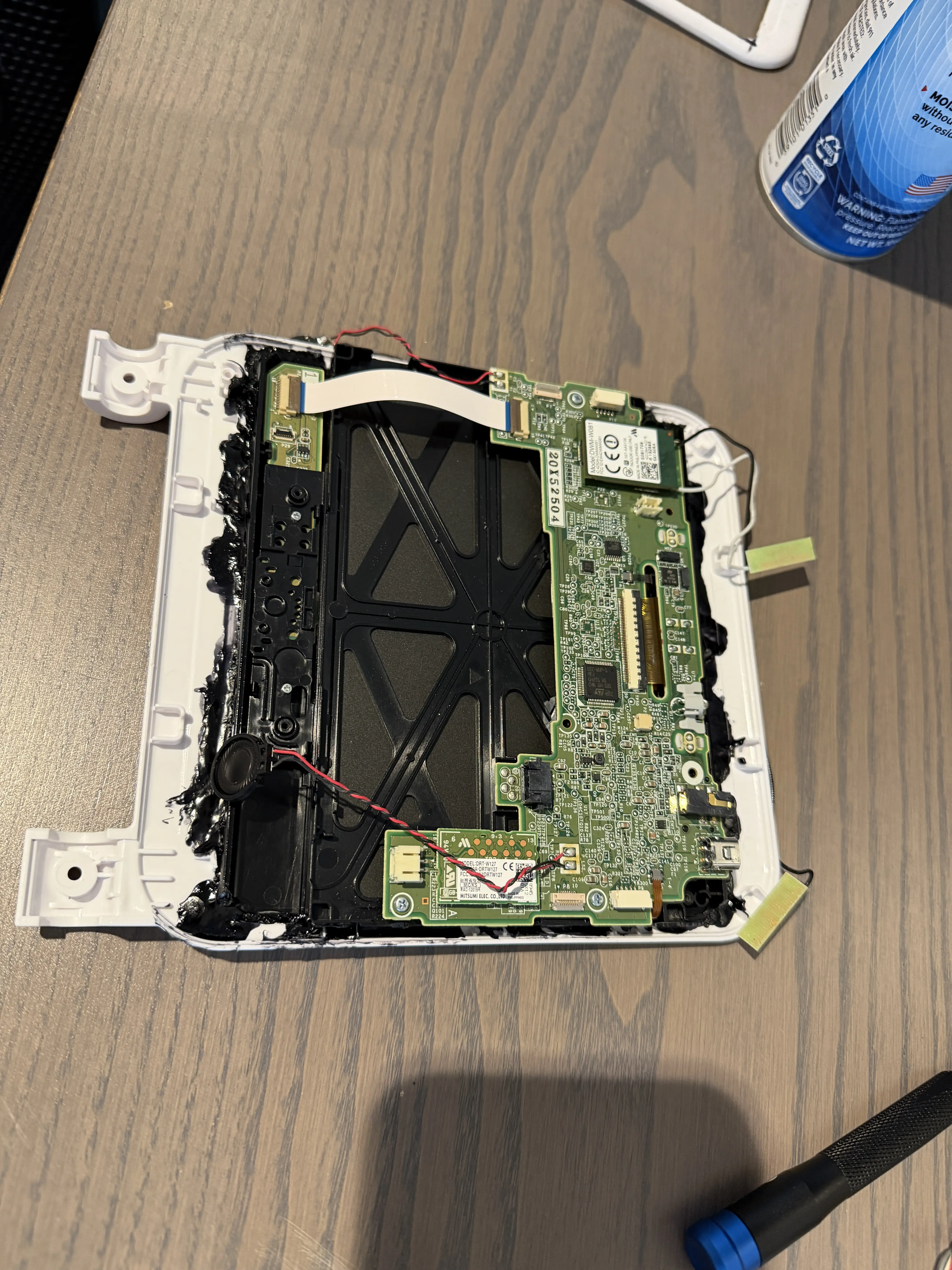

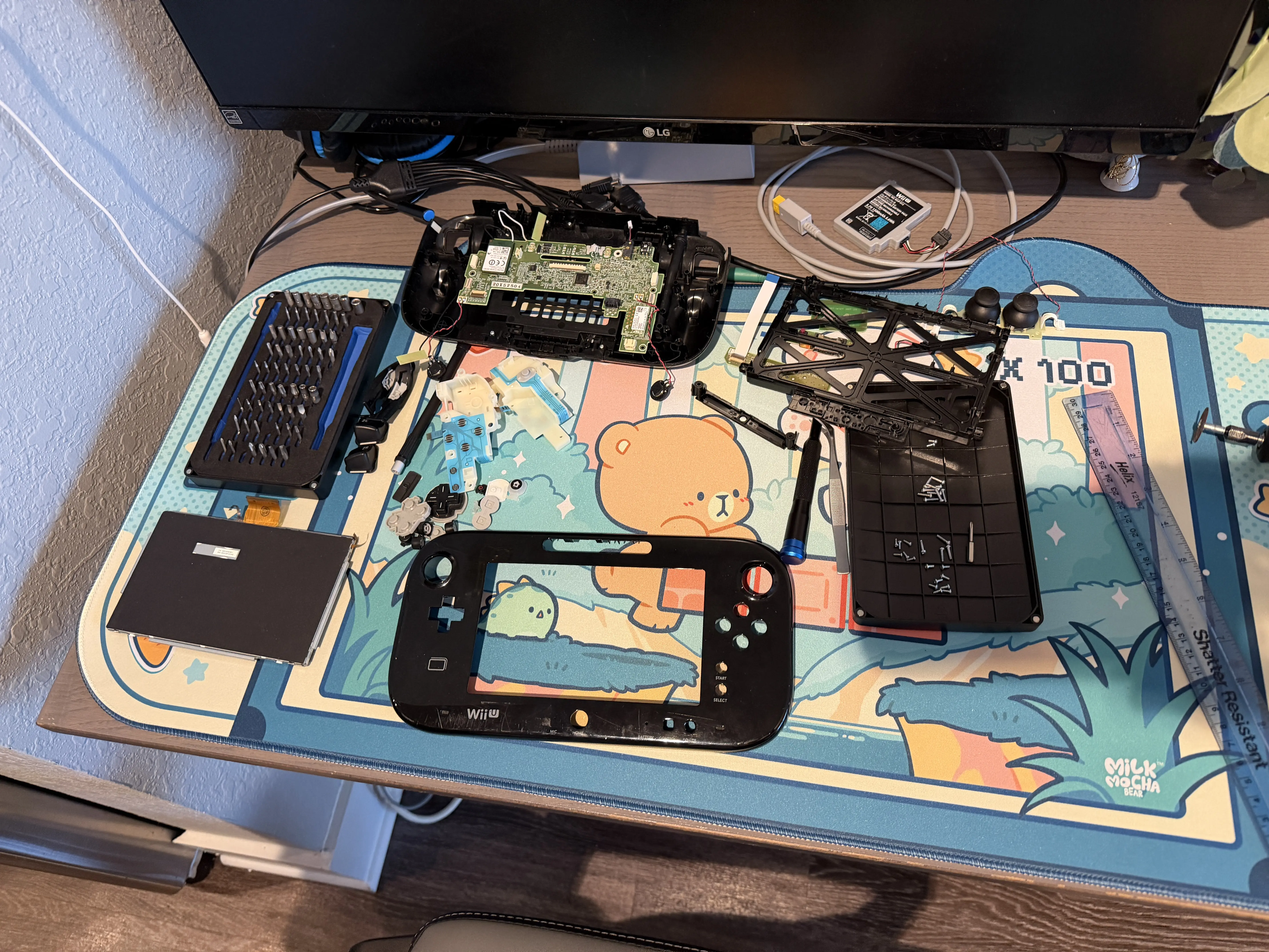

I looked into the case this weekend as well. Now that I know I can use a real Gamepad, I was comfortable butchering this one. (Note: This Gamepad came with the console untested and turned out to have a cracked screen. It also was in bad shape cosmetically. No pristine Gamepads are being harmed in this project, don't worry.)

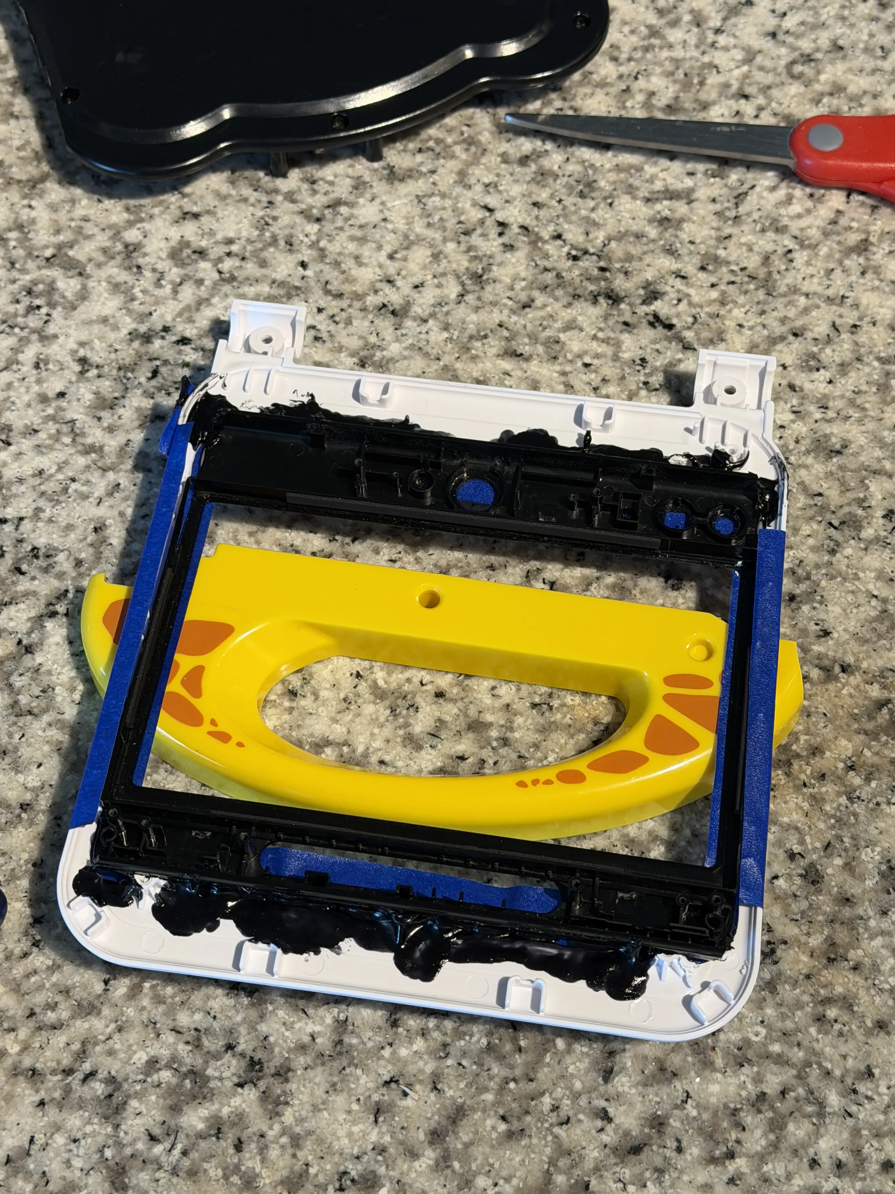

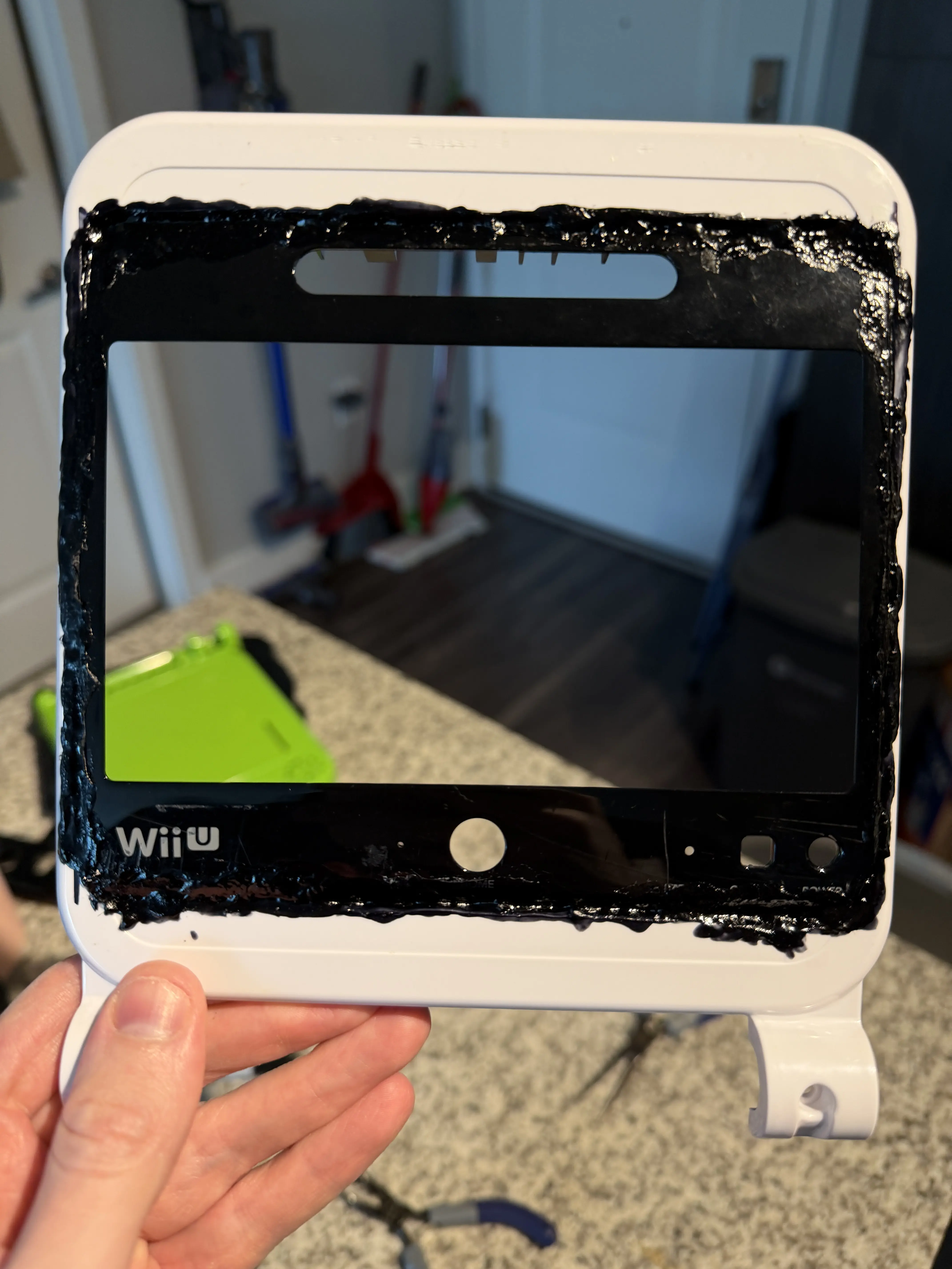

In light of my case revelation (see last post), I've been spending some time doing some good old-fashioned frankencasing! It's intensely satisfying in a way I just don't feel with CAD. This is gonna take some time but I think I'll be happy with the result.
My idea here is for the Gamepad to be placed pretty much as-is into the upper clamshell and still technically be treated as a separate device. This will tick a LOT of boxes all at once, like audio, touch support, and all the non-critical toys. The important parts are just narrow enough to fit, although I will need to trim the main bracket that holds everything. The controls are going to have to sit flush or even below flush with the bottom clamshell. I may give it 3DS sliders like the prototype Gamepad and sink the buttons like the DS phat.
Later!

I HAVE THE POWER!
My first Bistro that I built a while back had too many issues, mainly from reflow (imperfect stenciling, not enough heat). It's long overdue that I tried a second attempt, so I did it this morning. After assembly plus an hour or so of troubleshooting, all seven rails are working!

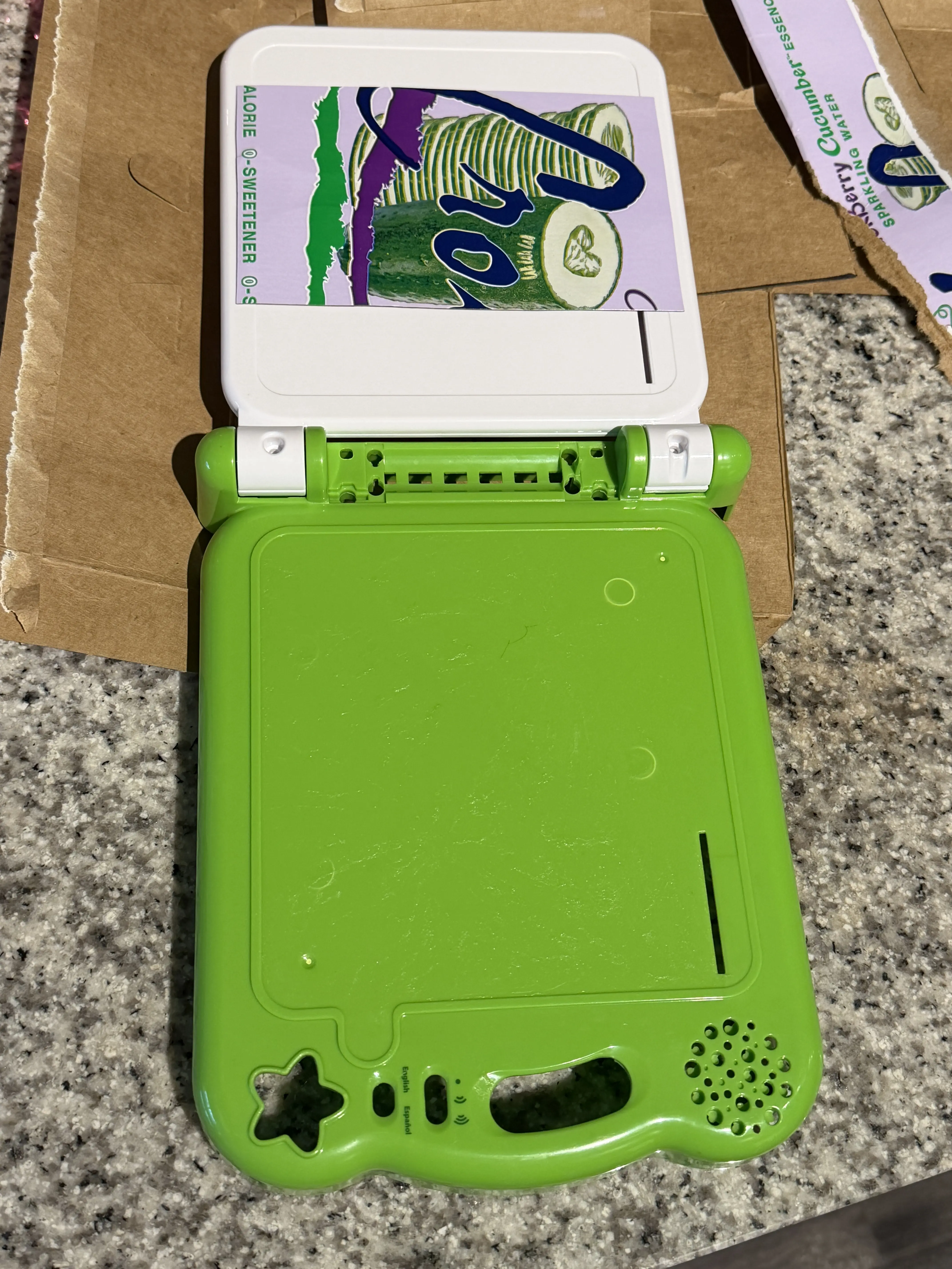

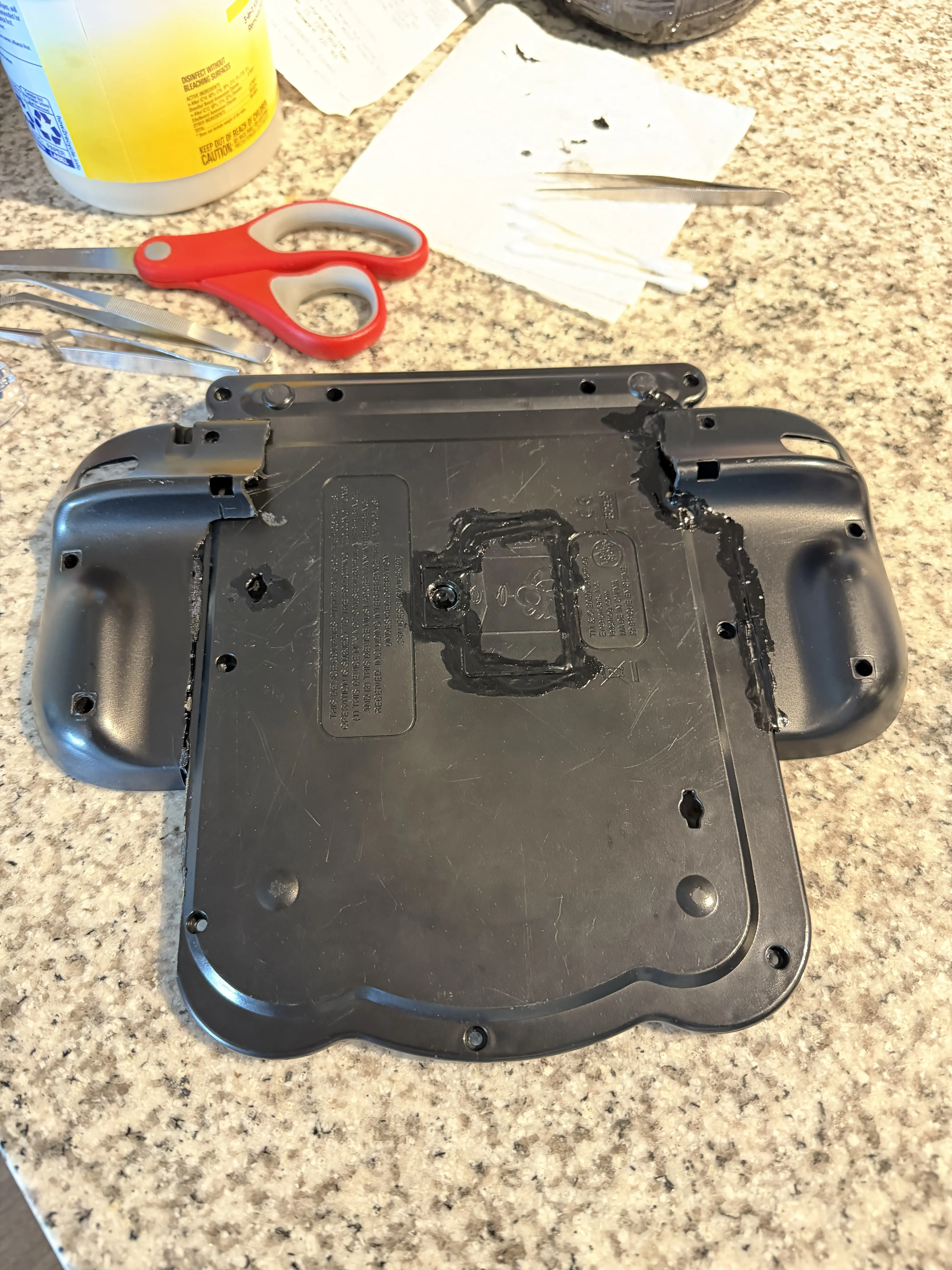

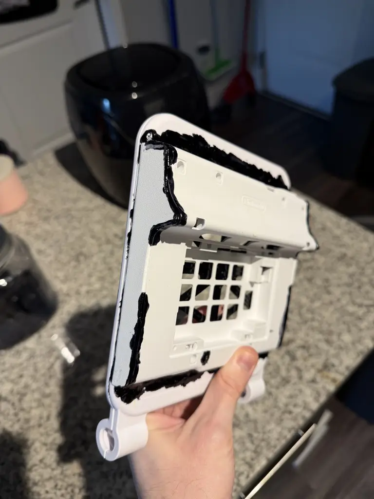

Between then and now, I've been making slow, steady progress on the case. I decided to take the edges of the Gamepad and graft them onto the sides a little bit like Joy-Cons. Trying to fit the controls under the lid was gonna cause too many problems elsewhere. Speaking of the lid:
It's not finished, but you get the idea. I need to find a way to get it to "snap" into place, these hinges don't have any stop points in them. I also need to rebuild the back half. But aside from board trimming, the rest of the project is basically just finishing the case. I'm now seriously considering a second screen, I know I said "I'm not really feeling a big DS" but the opportunity is right there.
Anyway, I'm gonna keep at it. Later!
