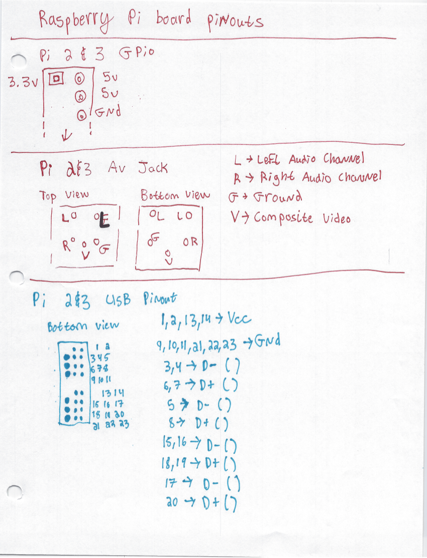

I have the pinout of the audio / composite jack.
Edit: The pinout listed is relative to the position of the board, with top being ports side up.
I literally never use a pinout when wiring composite on a Pi. I just start by wiring ground to whichever pin appears to be the logical ground then poke around the other pins with the video wire until I get a picture on my screen. ¯\_(ツ)_/¯
That's how I tested video with my rpi b+ before putting it into a case with a HDMI LCD.
Can confirm blue wire is composite +. Find ground on your own, Sista!
