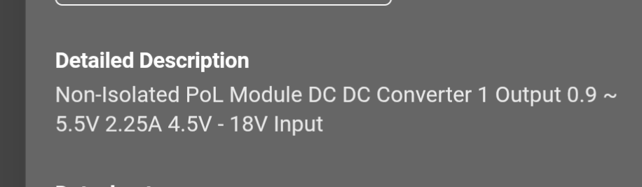

Forgive me if I'm wrong but I thought the PTH08080 has an input of 4.5v minimum, which means I couldn't power it off the ldo's pads.
Yeah you'd have to use 5v from the PMS
