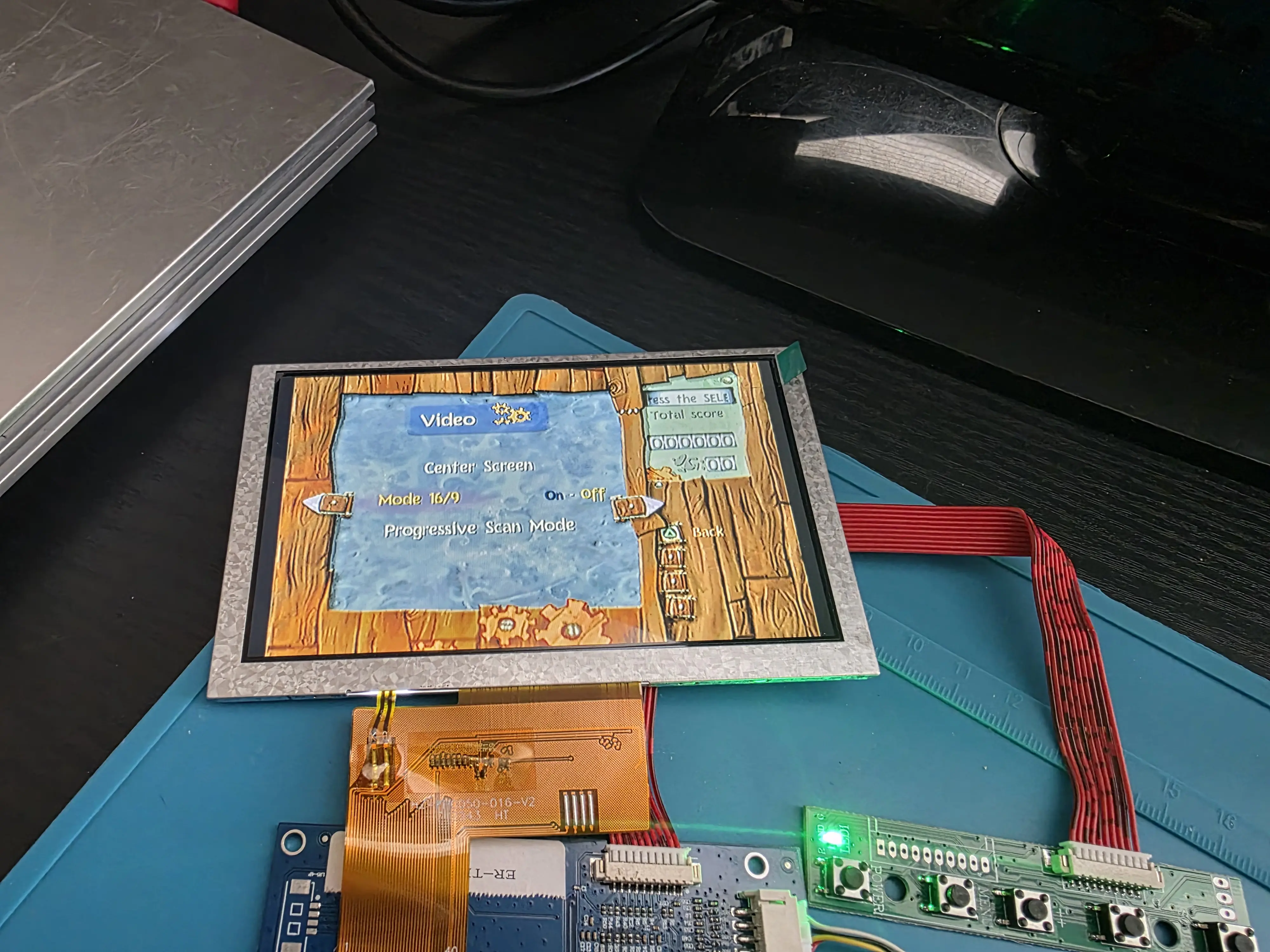

Quick update!

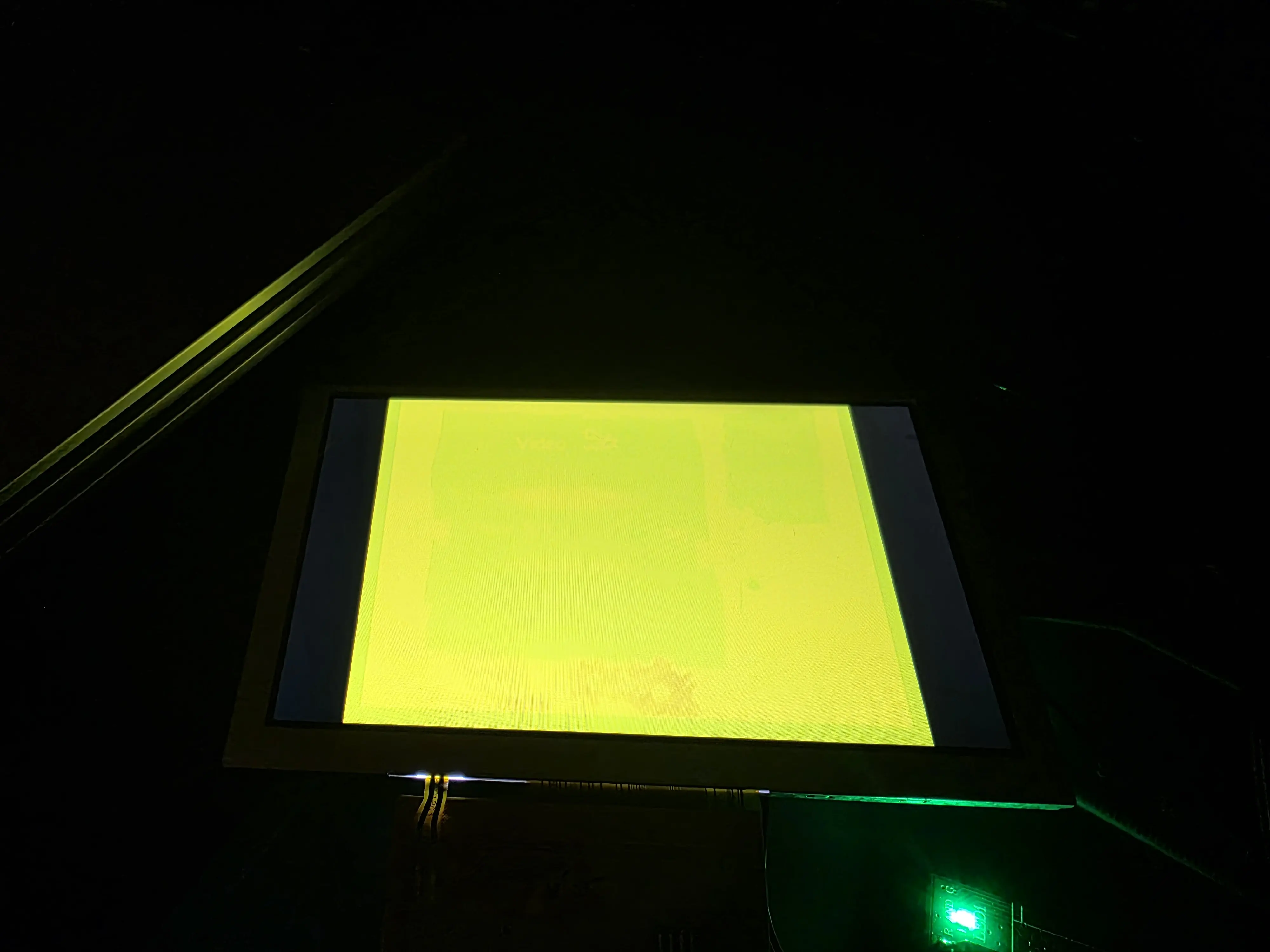

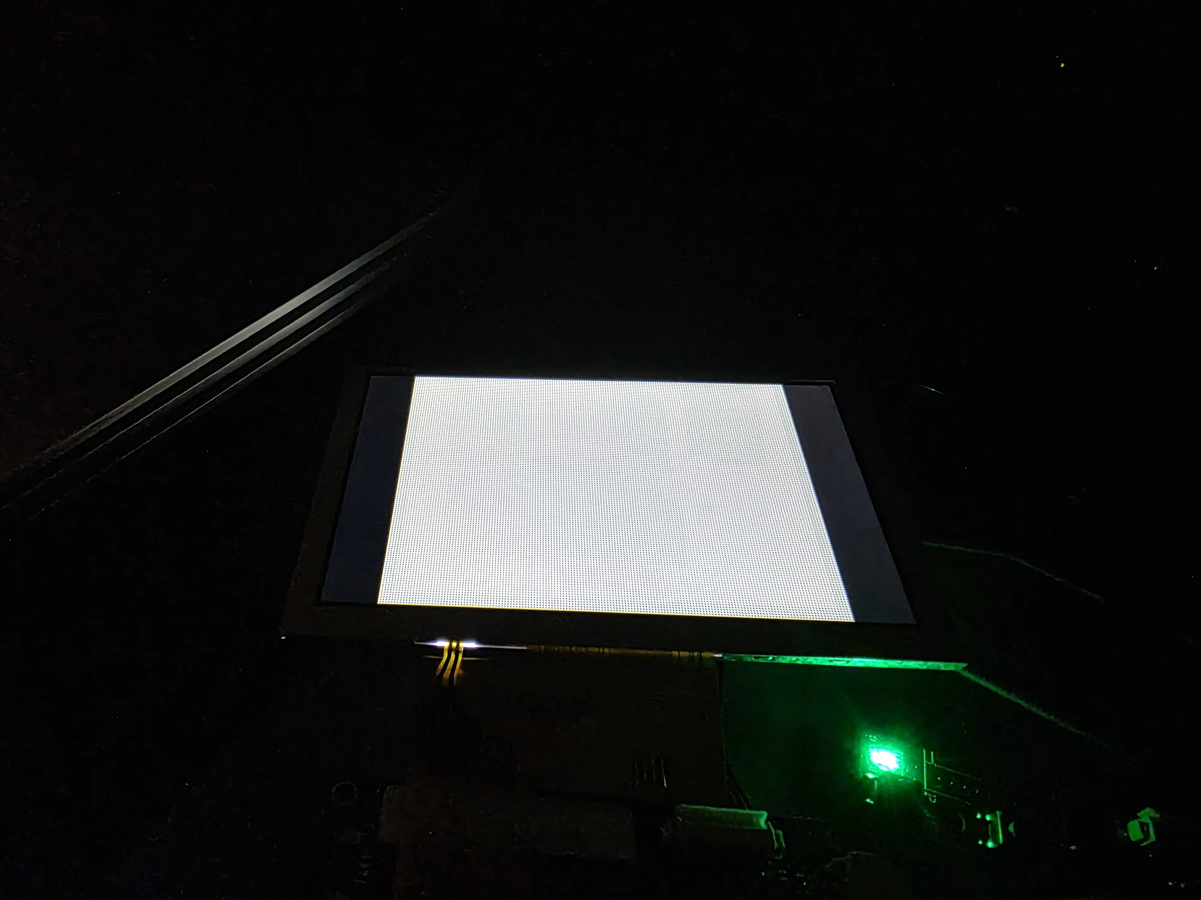

I revisited YPbPr 480p last night to try to get it working and spent a decent amount of time messing with it but wasn't getting anywhere.

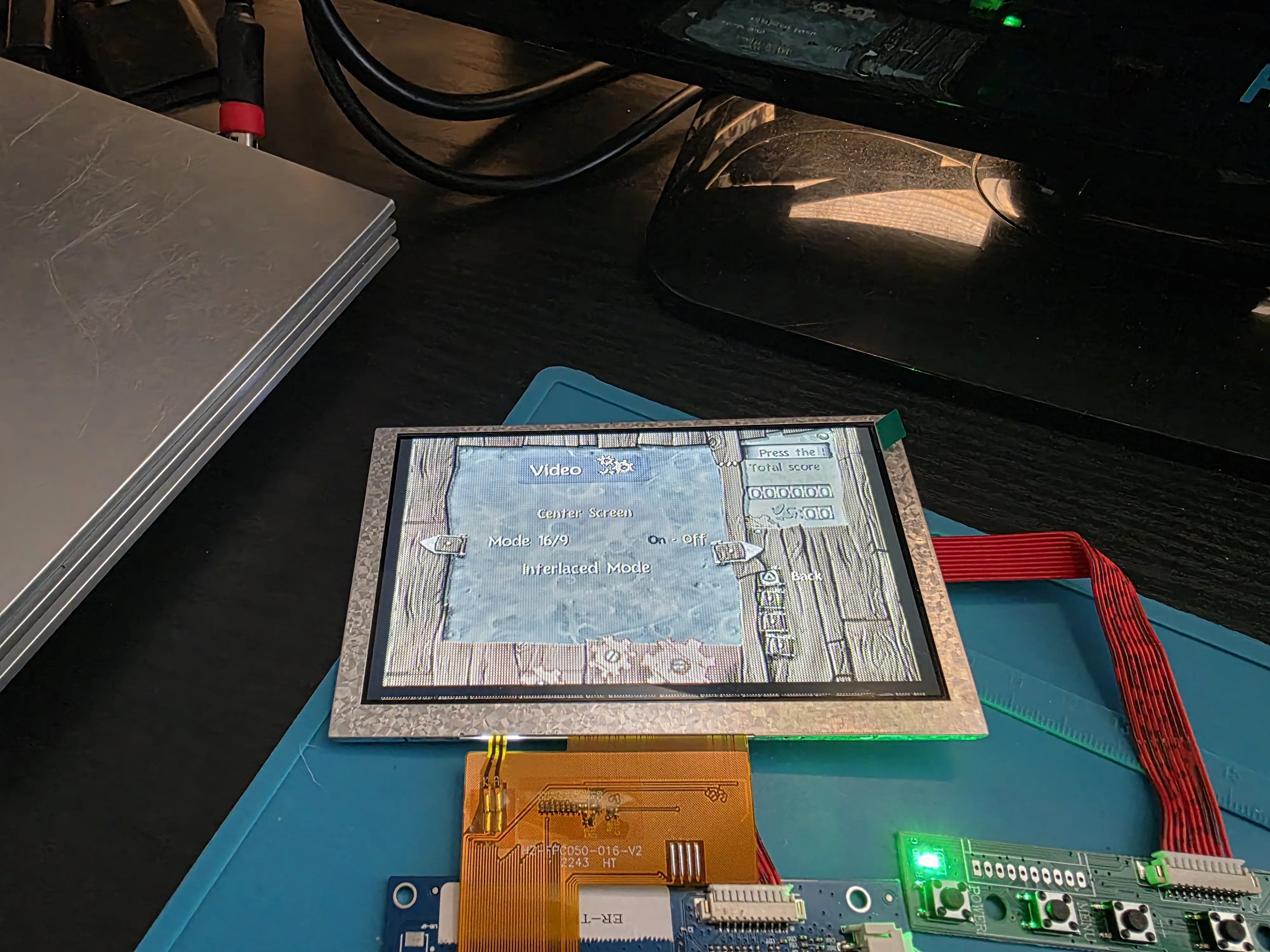

I then had somewhat of a realization that I was trying to display it in a 16:9 aspect ratio then had a thought about when I was trying to code 480p VGA in last year. When I was trying to display 480p VGA in a 16:9, the screen would turn black indicating it was trying to lock onto sync, but I would never get an image. It wasn't until I switched to 4:3 that I would get an image (although it would flicker every few seconds).
Upon realizing this, I switched to 4:3 and it worked perfectly! No washed out colors or grid of dots as shown in my last post, but there were the 4:3 borders that I wanted to get rid of as that was a big reason for starting this in the first place:
Now knowing i had a scaler issue and not a resolution issue, I turned my attention to the scaler and how it stretched the image to 16:9 as that's was where the issue was.
I tweaked and tested and wasn't getting anywhere, so I went back and implemented a slightly different, softer method of scaling to 16:9 and once again, we have a working 480p over YPbPr!!
This time you may notice that it doesn't have slight borders on the side like 480i does. When making all of these changes, I only applied settings to Mode 3 (which was 480p) so I plan to go back and see if I can apply the same changes to Mode 1 (480i) in order to eliminate those borders and call that good!

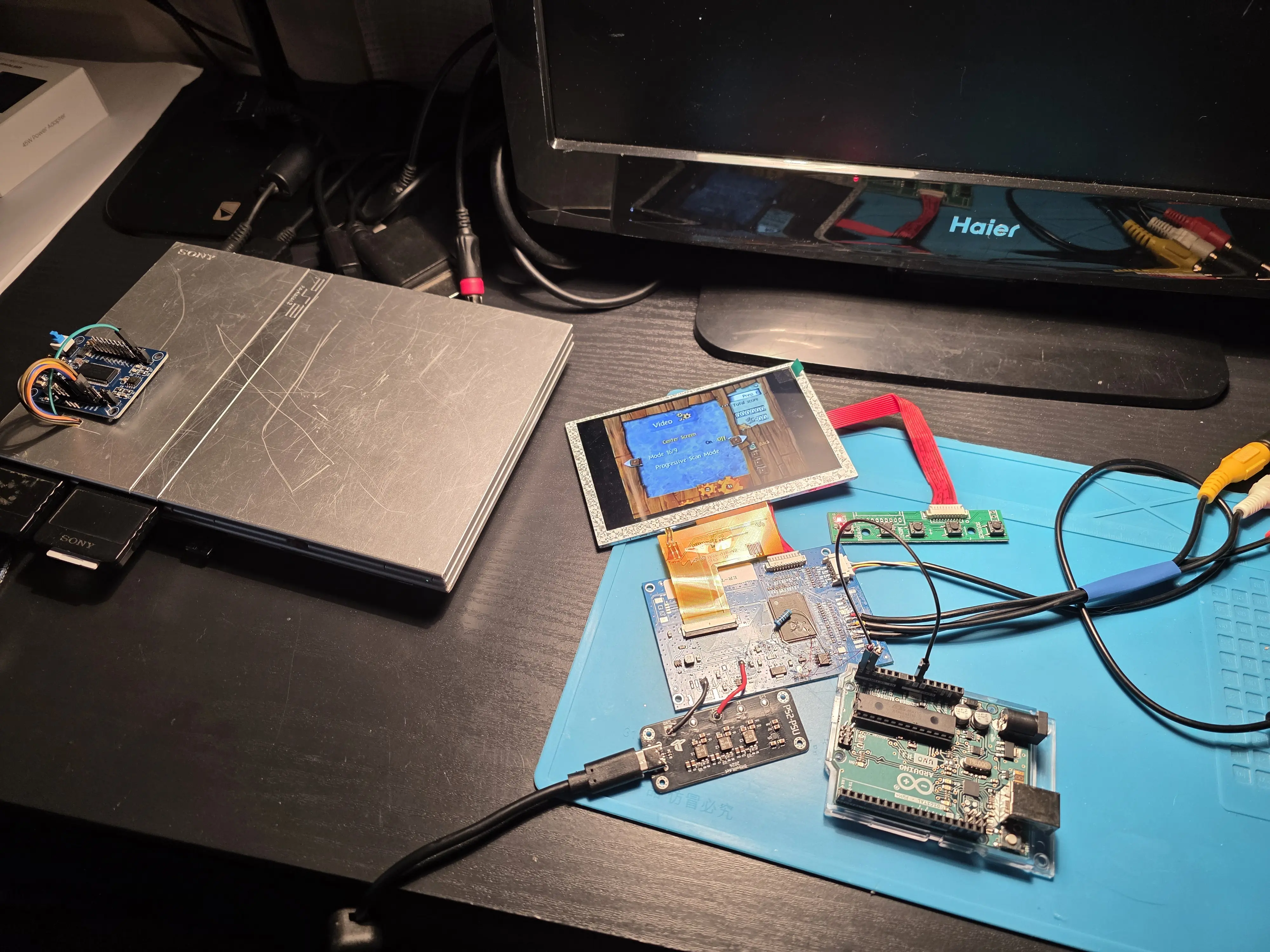

Its been a minute so here's an update.
I had been continuing making strides in getting things working with the original firmware base I had, but I've had a daunting realization that I'm working with a firmware I can't do anything with. I mean, sure I can use it for my own benefit but even if I polished it fully and got everything working, I can never release it publicly or make a product out of it that benefits the whole community, so I decided to stop working on it for the time being and shift my focus.
Some of the fellas and I have been talking about creating a new firmware for a while but none of us have pulled the trigger due to the sparse documentation on the RTD2660, as well as the method of how we want to use it (i.e using the internal 8051 MCU, or trying to control it with a more robust external MCU). There was also the question of whether to use Keil uVision or SDCC as Keil is shite, however SDCC uses different data types etc. And most of the firmware bases we can use as a reference have keil specific linker, and obj files that can't be reverse engineered easily, If at all.
With all of this being said, I recently took on the task of trying to create a sort of proof of concept new firmware using SDCC, and I was able to at least initialize the 8051 MCU and somewhat show its boot cycle using the on board LED (essentially a blinky project lol) amongst some other things. I was successful in doing this however what I eneded up doing was breaking "In System Programming" using the DDC I2C lines so once this new firmware was flashed, i could no longer flash newer firmware back to the chip using the same methods I was using before.
I thought I was cooked so I called it a day and decided to order a new board and reverse engineer my current driver board as I want to make a custom PCB anyway (although I havent peeled the board apart yet). I also managed to rip off the Write Protection pin off of my SPI flash by accident because of the THT 10k resistor I had on it so I thought it wouldn't work anyway.
In a last attempt before peeling my board apart however, I ordered a CH341A programmer to try to flash the old firmware directly back to the SPI flash, and after messing around, I was able to get it working again! After all of this though, I realized what an absolute mess my driver board looked like, and I really want to change that if I'm going to take this new firmware seriously, so I decided to make a sort of "dev board", and thats my primary focus as of now.
Here is the sad state of my current driver board for anybody wondering lol:
The plan is to create a new driver board for development that has an arduino nano implemented directly into it for flashing as ive been using an Uno R3 externally, I plan to also add headers, and a small variety of different footprints for different SPI flashes as I'd like to switch from the Zbit ones to something like winbond, and the headers will be for having a removable flash for the CH341A in case I break ISP again lol (also the 8 pin clip that comes with the programmer doesn't like to work of the flash is in circuit), we looked into a few different panels we want to add support for such as 40pin, 50pin, and 54pin, so I'll be finding a way to implement each connector on there if possible. This also gives the chance to add newer backlight circuitry to replace the cheap Chinese components that are currently used on all the available driver boards. And I'm sure there will be more features I'm not mentioning here at the moment.

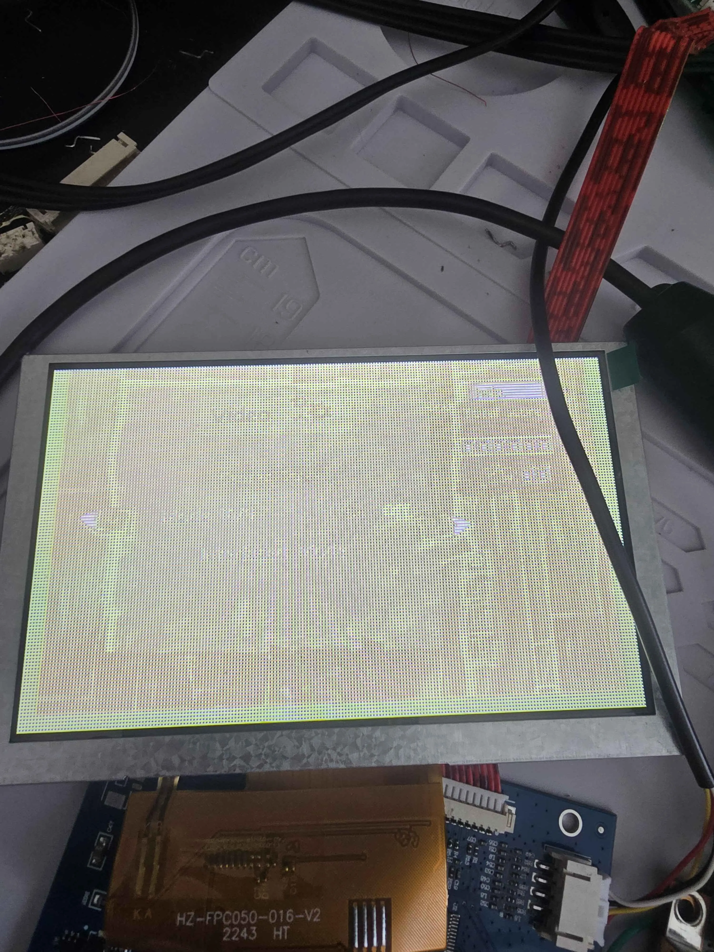

Thank you for your reply. I have successfully lit up the LCD screen on the PCB800099 (RTD2660H) LCD driver. However, the YPBPR input is currently in a no-signal state. I have also tried using the VGA port for signal input. Below are some of my configuration files and PCB flying lead diagram. I am using an HDMI to YPBPR converter as the signal source (VGA signal R connected to PR, G connected to PB, B connected to Y). If possible, could you share how you configured it?
Thank you for your reply. I have successfully lit up the LCD screen on the PCB800099 (RTD2660H) LCD driver. However, the YPBPR input is currently in a no-signal state. I have also tried using the VGA port for signal input. Below are some of my configuration files and PCB flying lead diagram. I am using an HDMI to YPBPR converter as the signal source (VGA signal R connected to PR, G connected to PB, B connected to Y). If possible, could you share how you configured it?View attachment 42210View attachment 42211
I won't be at my computer for a while, but in the meantime, could you show me a detailed picture of the front of your PCB, specifically the connections coming from the RTD2660?
Of course, here are the PCB flying wire diagram and the actual circuit diagram I created later. Since there was an issue with the previously designed RTD2662 PCB, I directly flew wires to the A0_PORT input port of PCB800099
