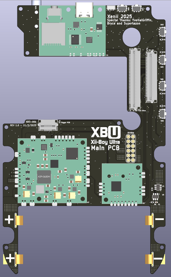

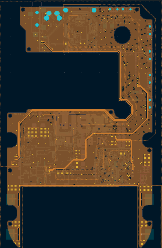

A day after the latest worklog episode, I mentioned I had issues with JLC due to some mistakes in the PCBs and the shell.

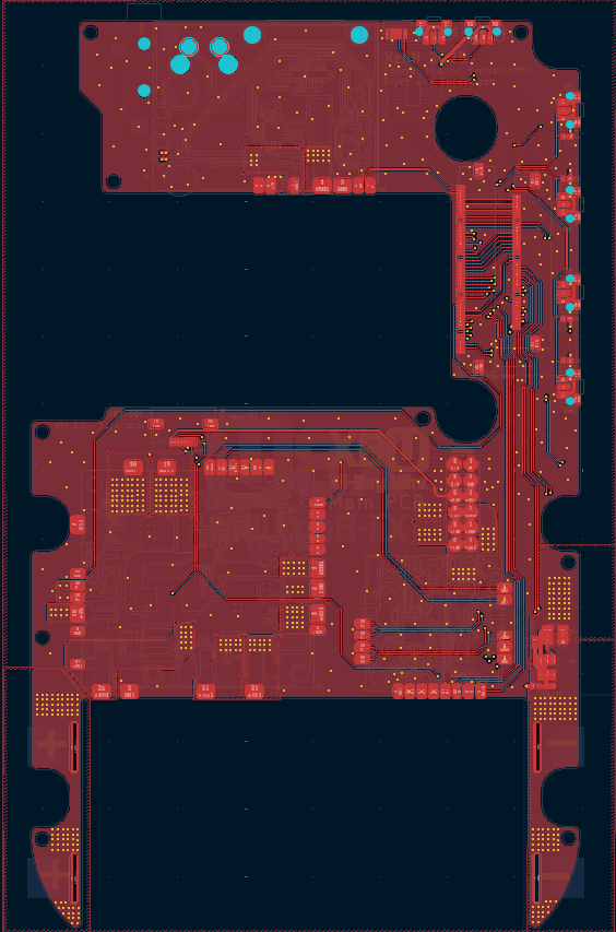

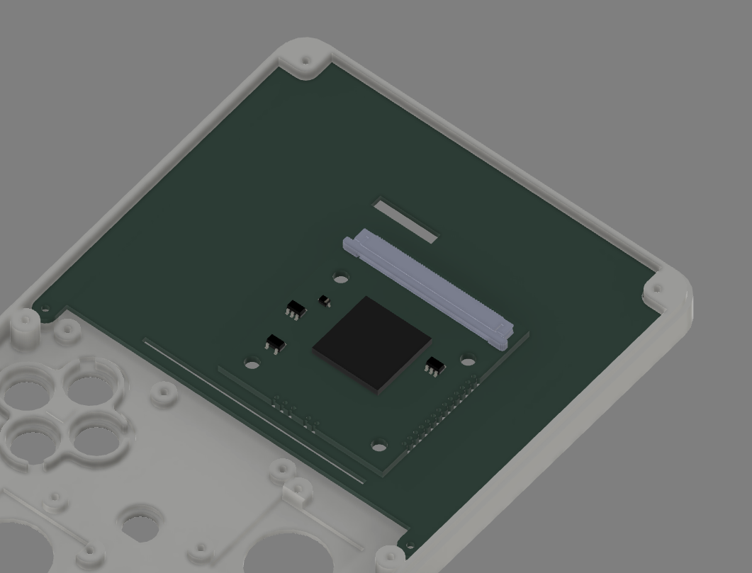

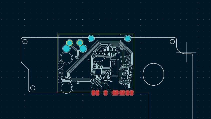

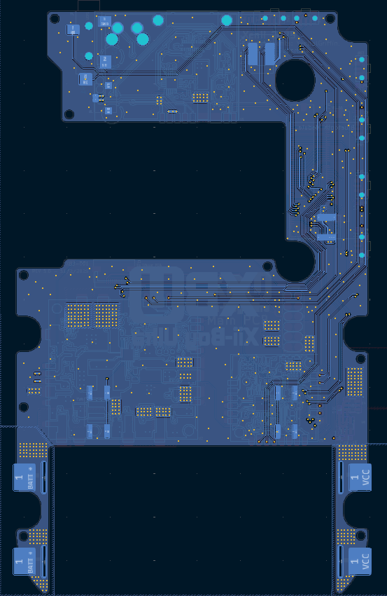

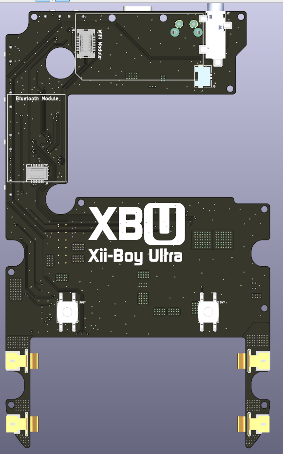

I realized that the way I've designed some of the new parts of the revision 2 were done wrong. So I decided to change half of the JLC order and start over, with well-designed parts.

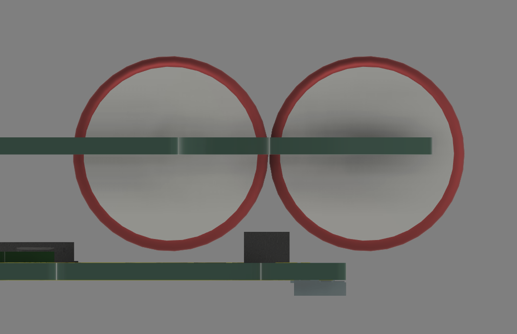

The Main PCB for instance was designed to be 1mm thick instead of the traditional 1.6mm. This might sound like a stupidly small change, but it means a lot. Some parts with springs elements (especially battery tabs part) would easily break when inserting the batteries, or by dropping the console. To avoid this, I decided to change the shell and some PCBs to avoid this issue.
The changes were really stressful to do, but I had no choice. I was grateful JLC was really patient about the situation, because it was a kind of mess.

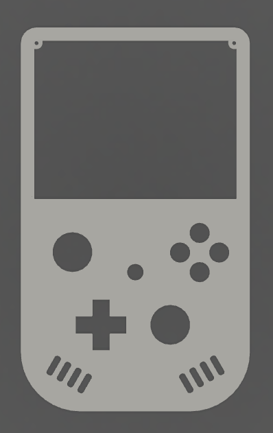

In the meanwhile, I decided to work on the final touches of the kits! The first one I wanted to do was the kit's box! Just because to be frank, it's the prettiest part, and probably the most exciting things you see when you receive the kit.
After some time spent in Gimp, this is what I ended up with. It was really simple, but did the job. I'll later talk about how my colleagues at the Xii-Boy Team helped me making it much better.
Orange is my favorite color for some reason, and I thought Beta Revision was cool, so I wanted to make the box the same color as my favorite one.

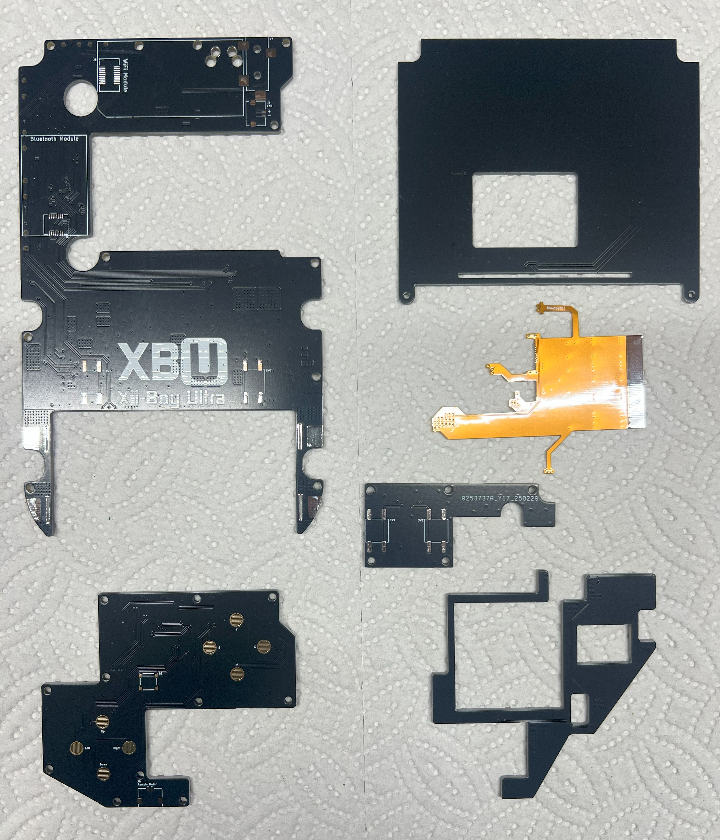

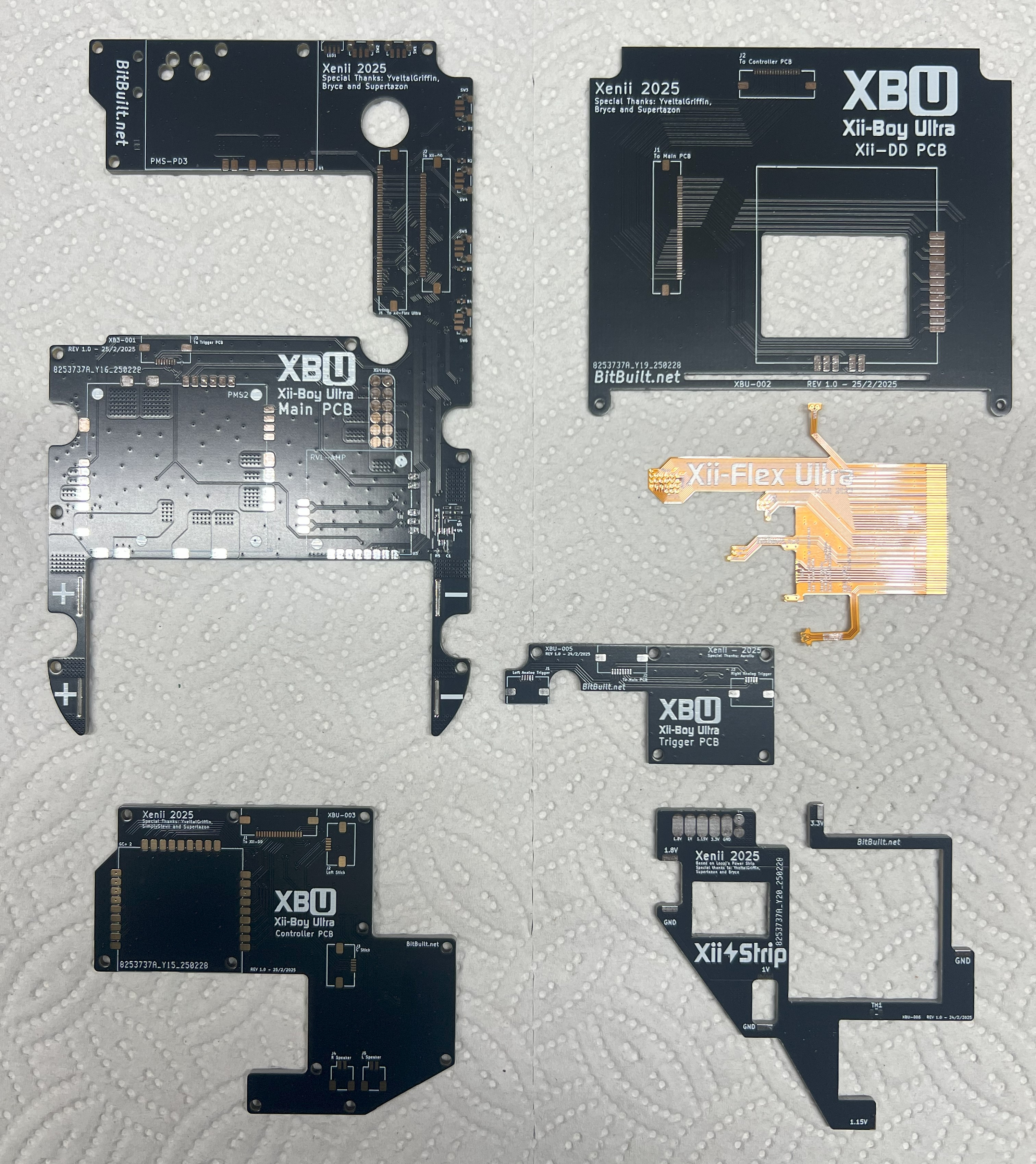

17 days after the JLCPCB payment, I woke up with a great news: PCBs are done producing and have been sent to my way!
I was really excited, but was honestly really scared of receiving a huge invoice of custom fees.

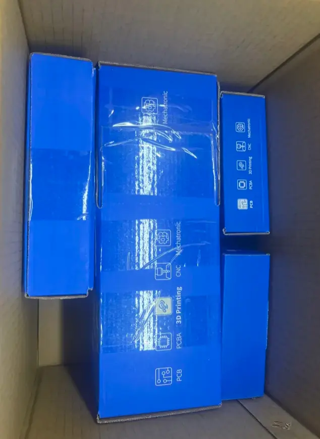

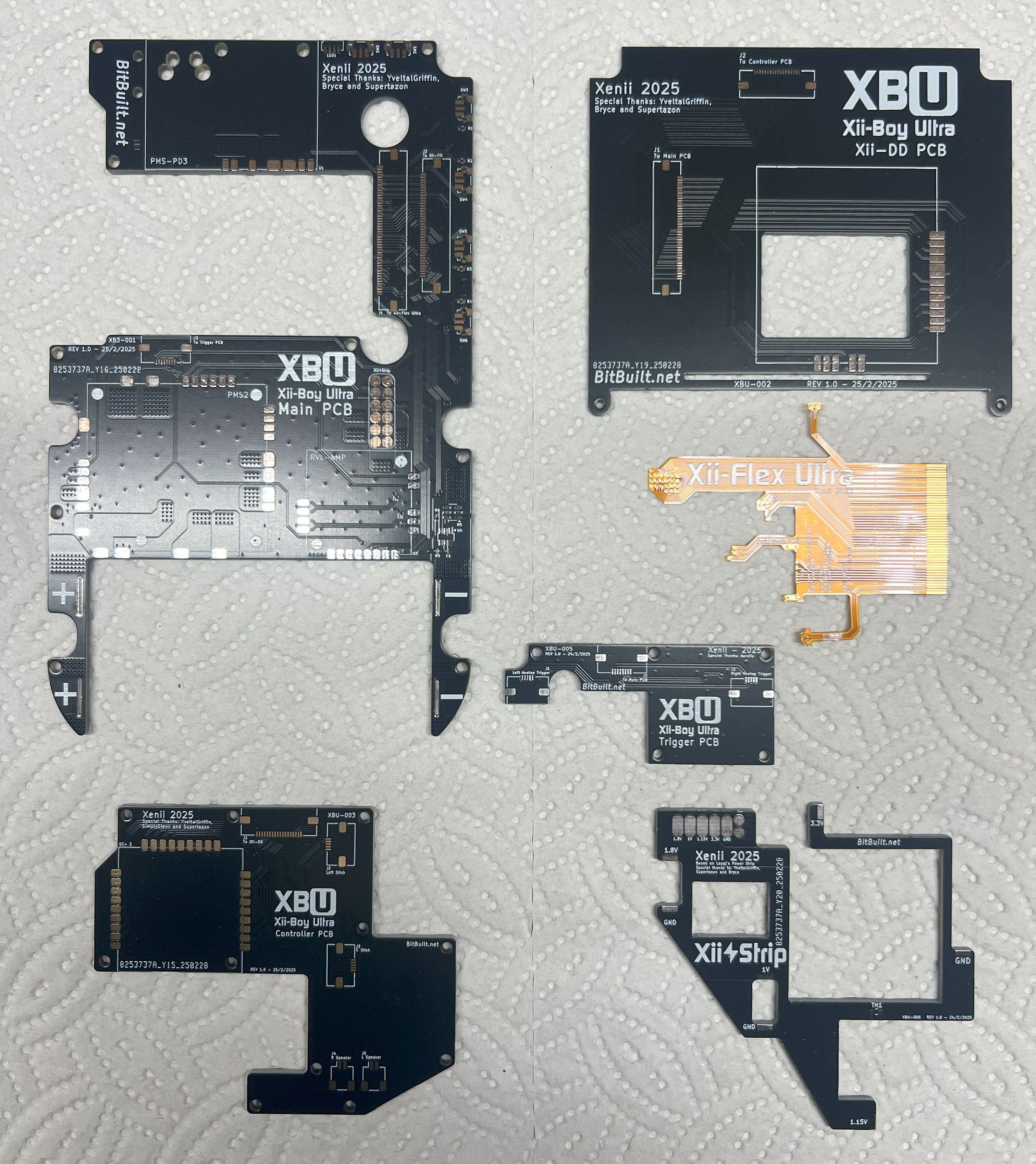

Third one was JLCPCB! OHHH YEAH! >:)
I think every modder on the BitBuilt community enjoys those blue boxes. Well I actually got 4! Three of them were full of PCBs, and the last one was the shells and 3D printed buttons!
Even though time flew, even though I needed to go to bed, I wanted to unbox those packages. So I did!

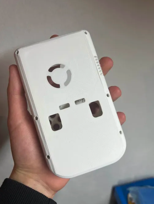

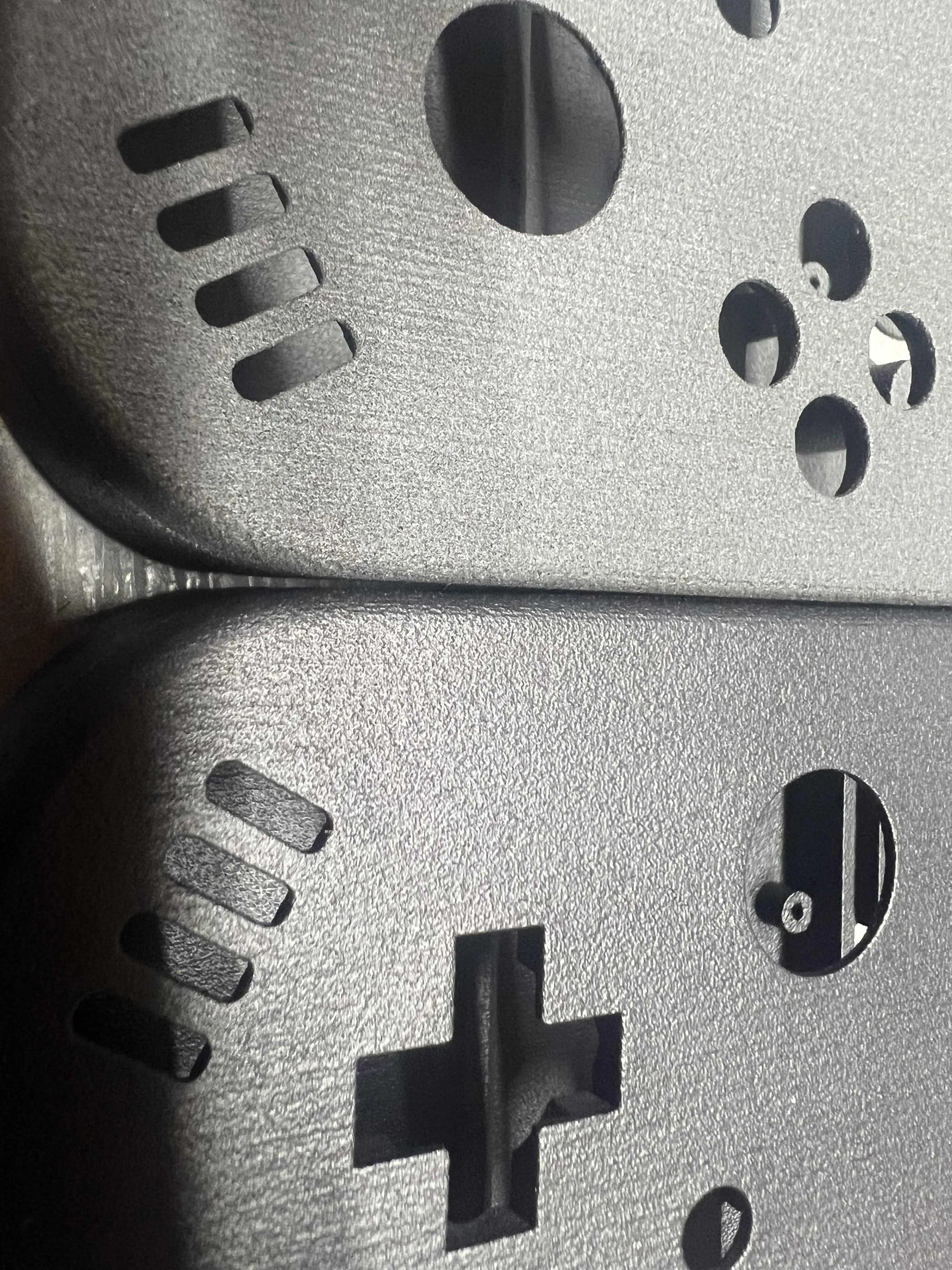

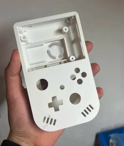

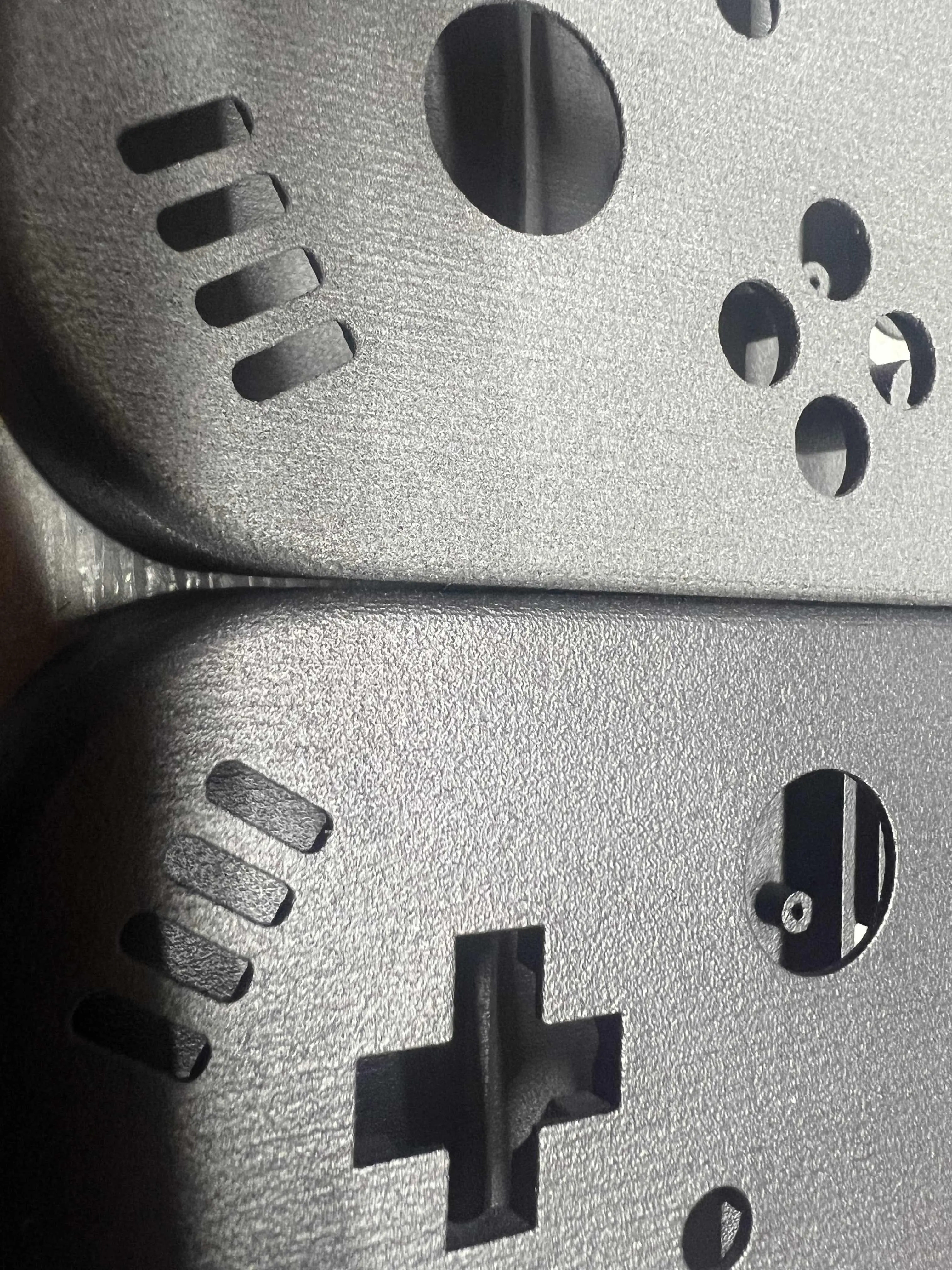

Here is a picture of the new MJF shell I've ordered from my own revision 2 build I've showcased here: Xii-Boy Ultra Revision 2 - BitBuilt.net
You can see compared to an SLS shell. MJF has bigger grains, which sounds worse, but they are actually way less sharp, which gives a general smoother feeling.
^ SLS on top, MJF on bottom

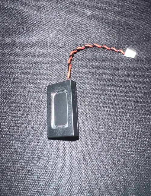

Anyway, I got some really high quality speakers from Alibaba! Those were the same I was used to, but they came with a custom cable's length and connector. No more issue with the constantly changing connector @Bryceshaw06 and @Hili had.
This time it's reliable, always the same, and fits just well in the console! You can find a picture right here!

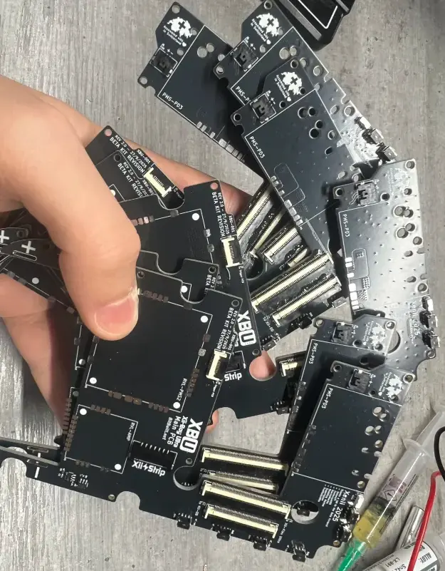

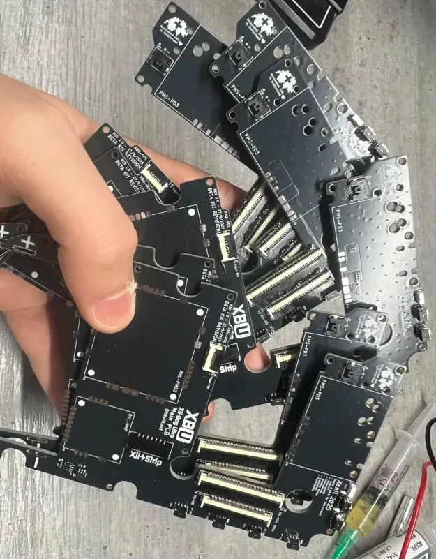

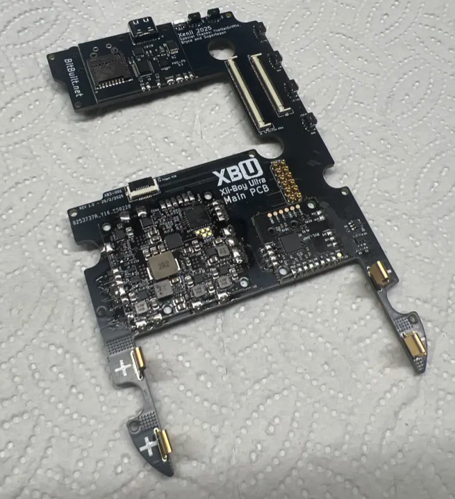

I finally find some this day to start assembling the PCBs! I first wanted to mention that I assembled those board to test the new revision 2.

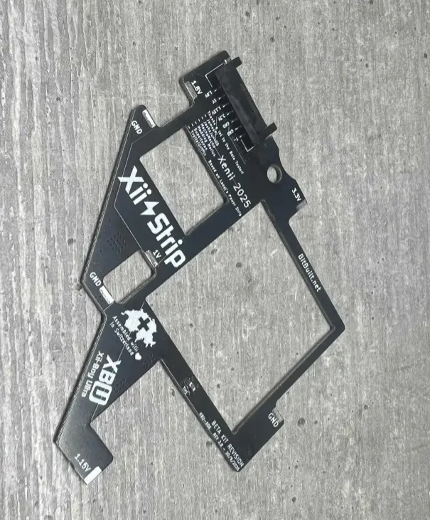

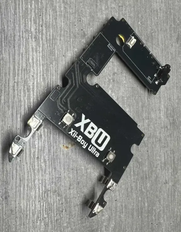

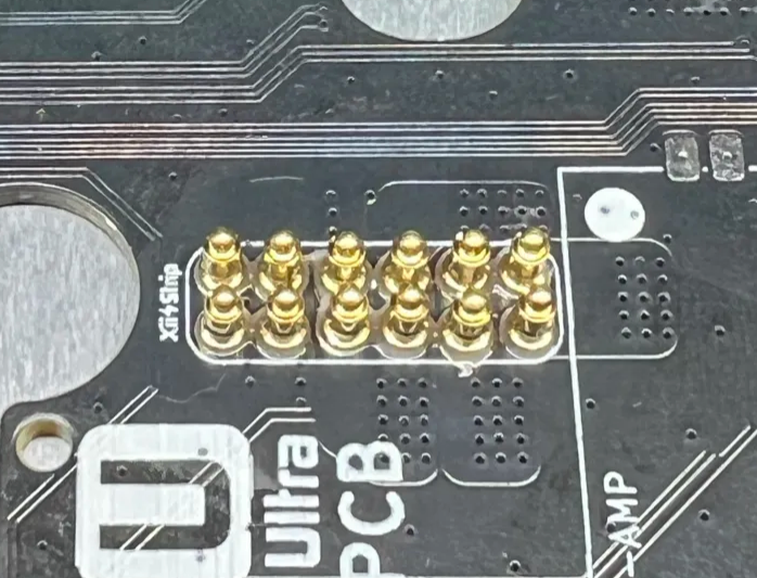

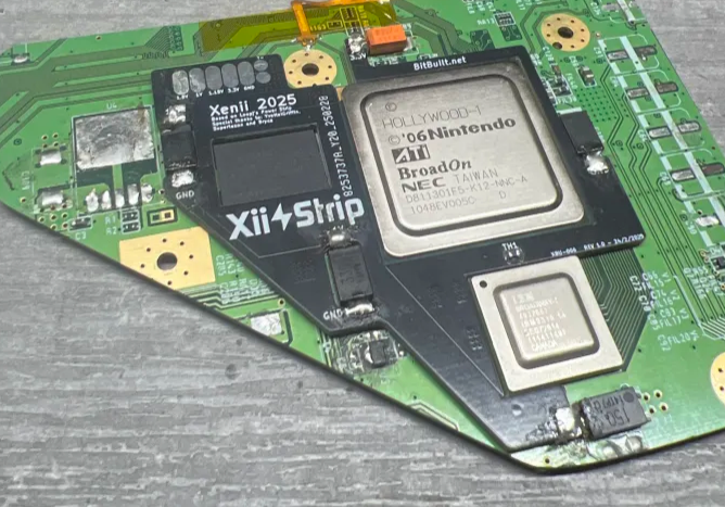

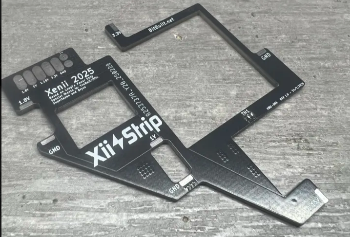

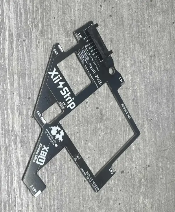

I started with the easiest; the Xii-Strip!

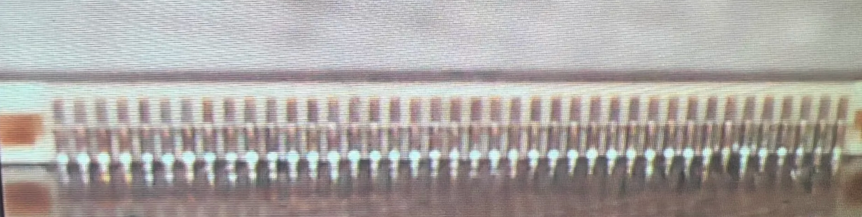

This big PicoLock connector can be bit tricky to solder properly due to the big GND and voltage polygons there are on this board.
With a decent and thick tip and a bit of flux, I was able to solder it pretty decently I'd say!

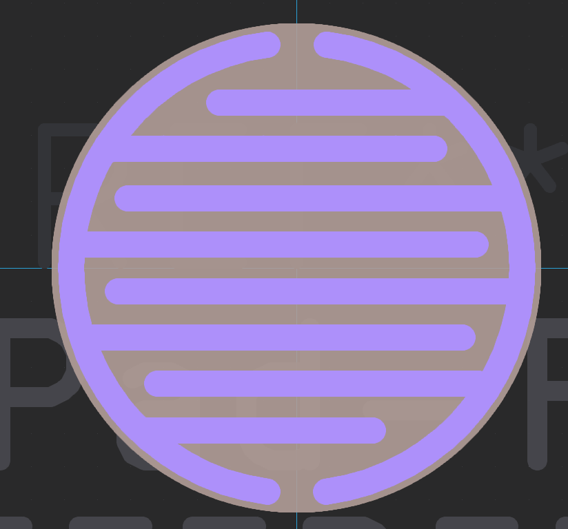

The thermistor is also pretty big. 0603 is about 2x1mm big. Even though it sounds small, I swear those are big compared to 0402 or even 0201 :XD:

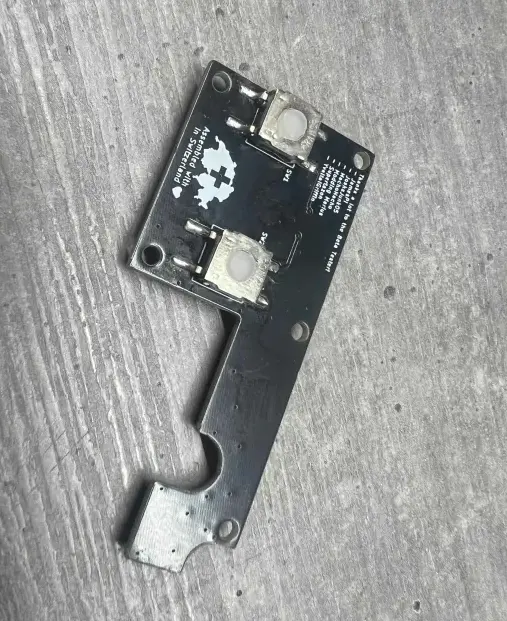

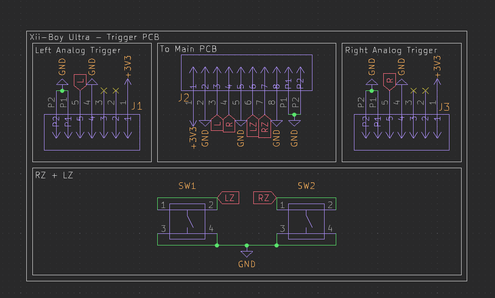

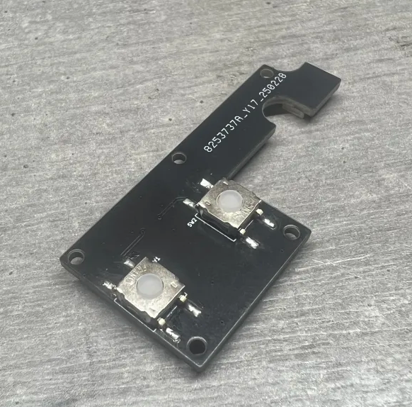

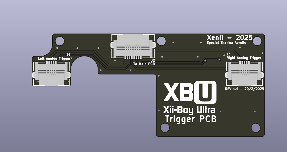

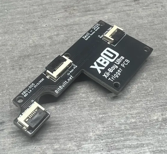

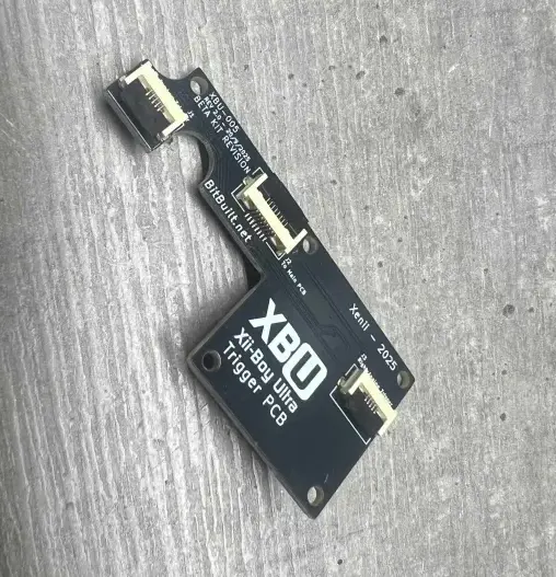

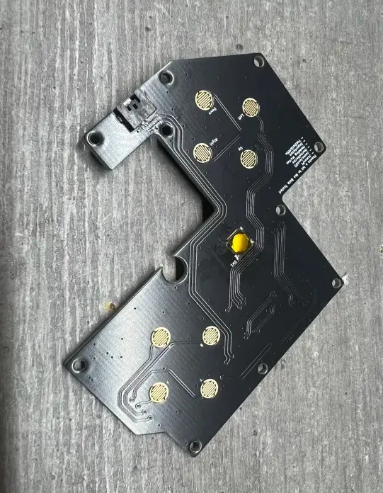

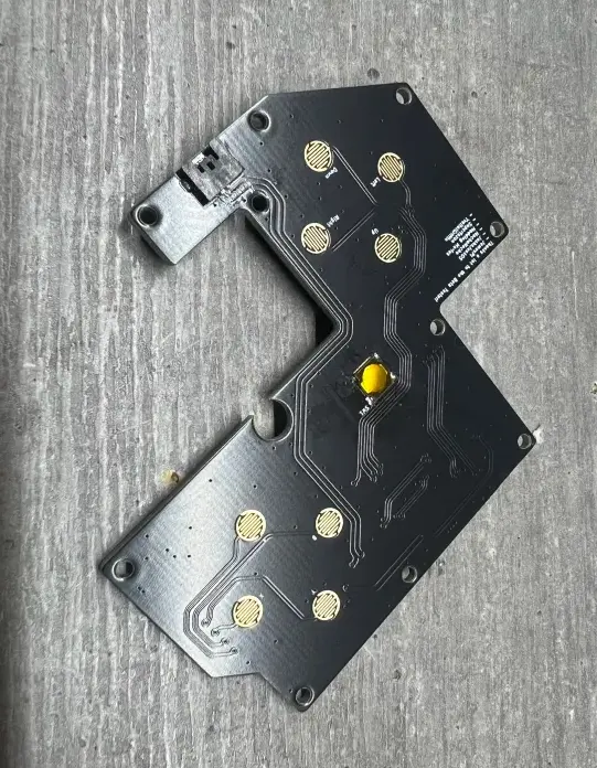

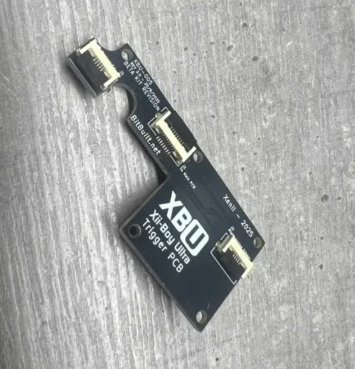

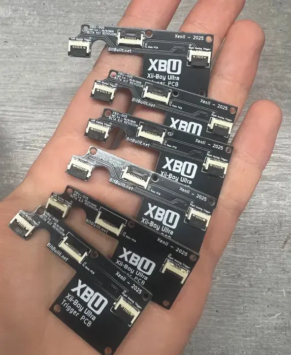

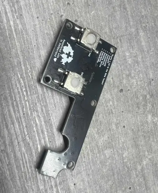

Next up; Trigger PCB!
This board is pretty simple. 3 connectors, 2 buttons, and it's done!

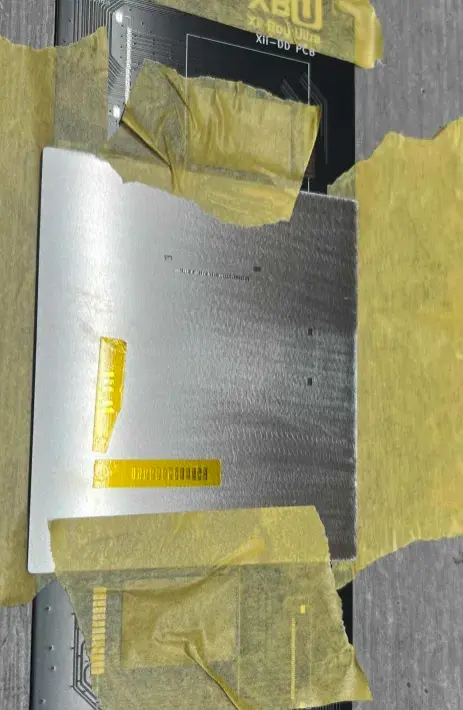

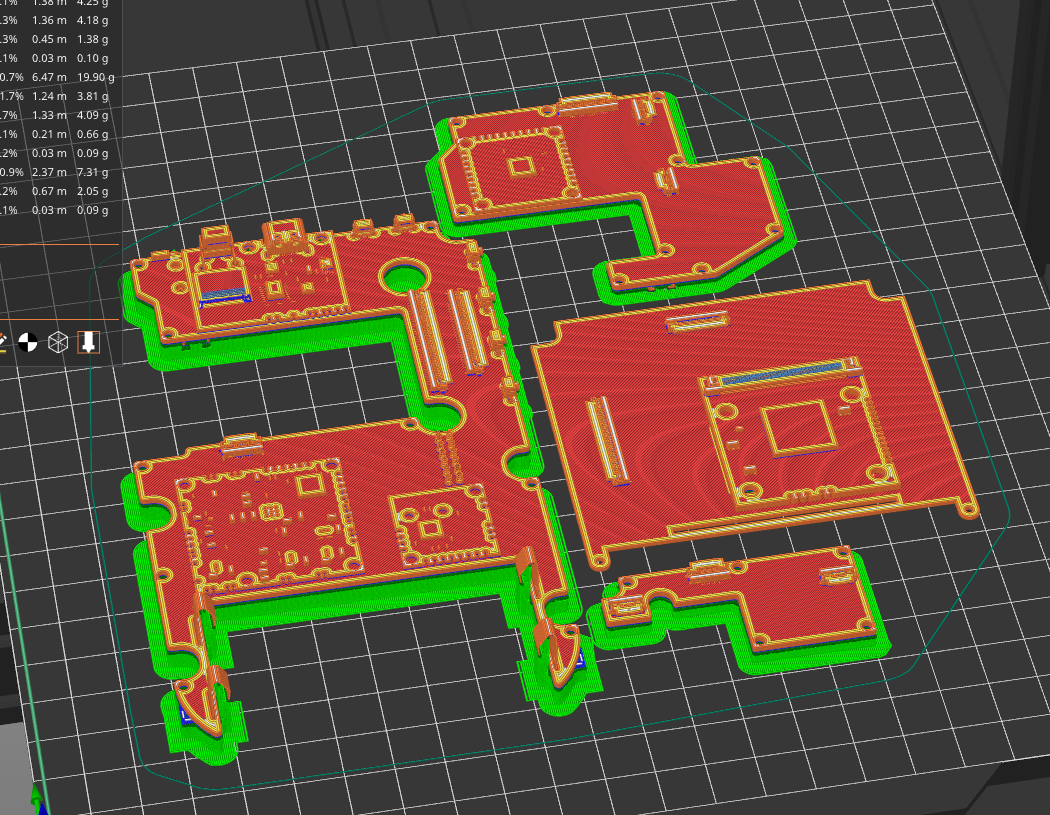

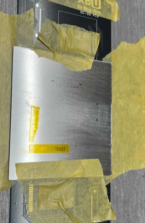

First time I took use of my stencils. To use them, I first used the good old technique of taping multiple boards to my desk to get one properly placed and safely secured.
The result wasn't good, and pretty time consuming, so I ended up modeling jigs in 3D. Took a bit of time, and adjustments, but it was really worth it. Made the whole thing easier.
After a few minutes, the trigger PCBs was done!

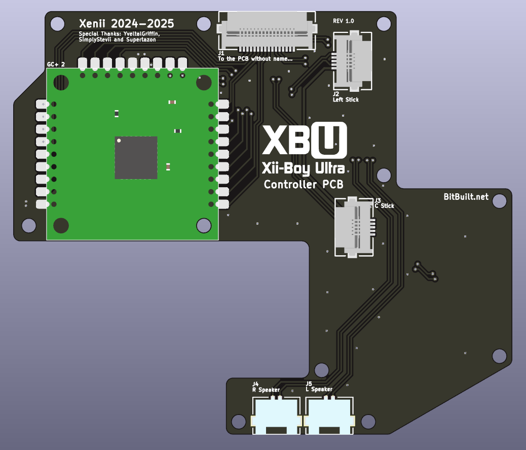

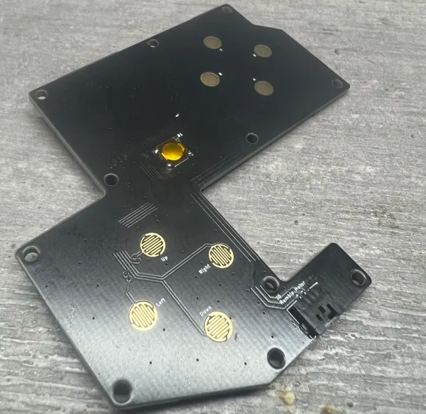

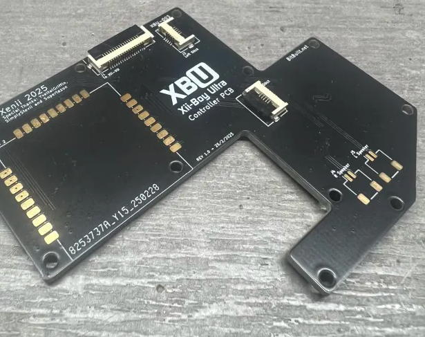

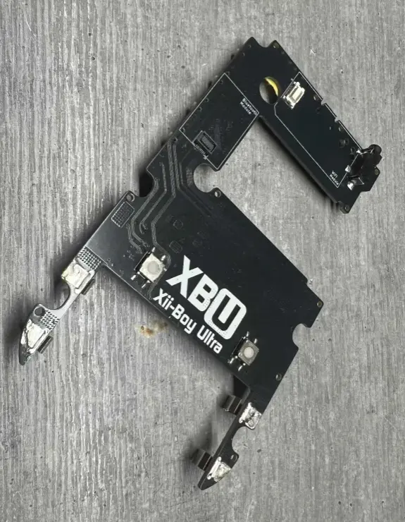

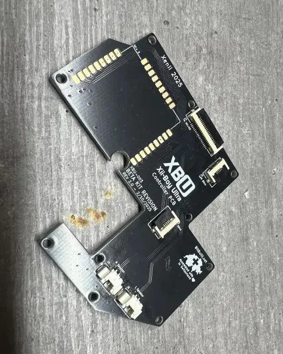

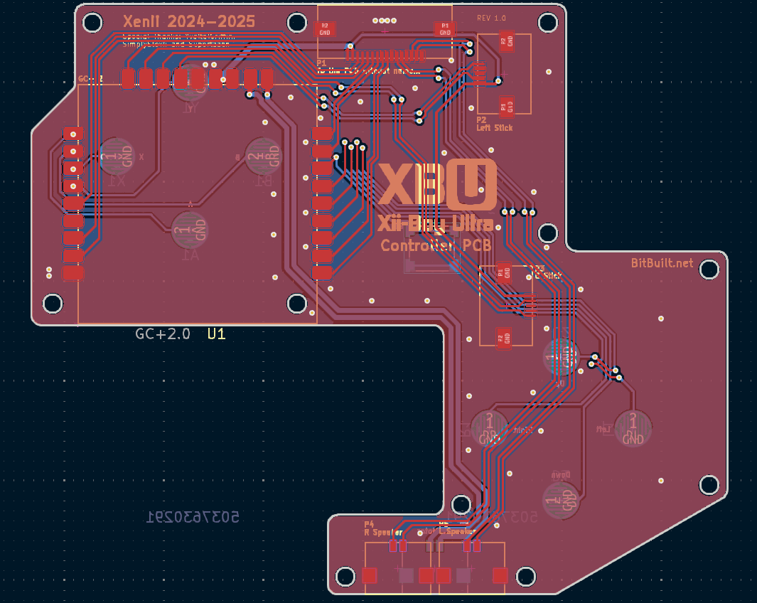

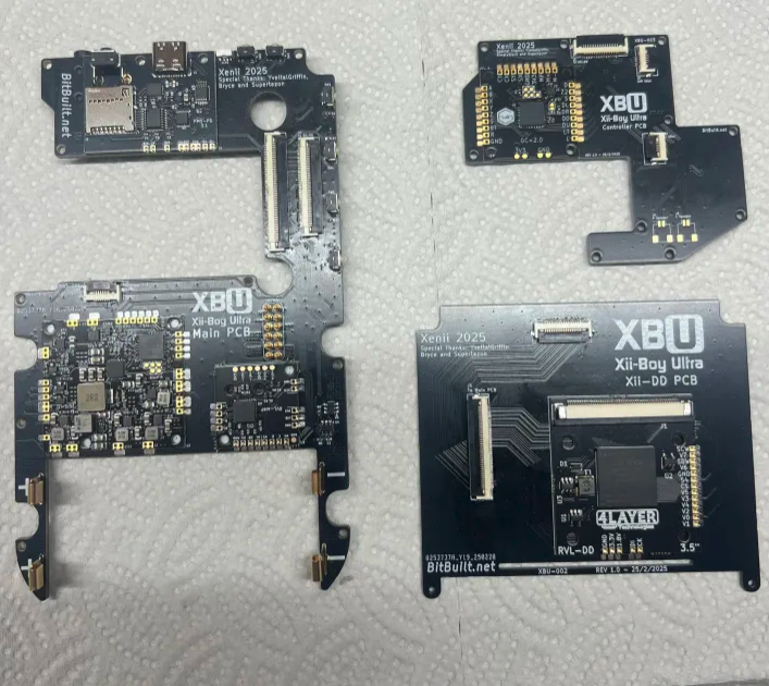

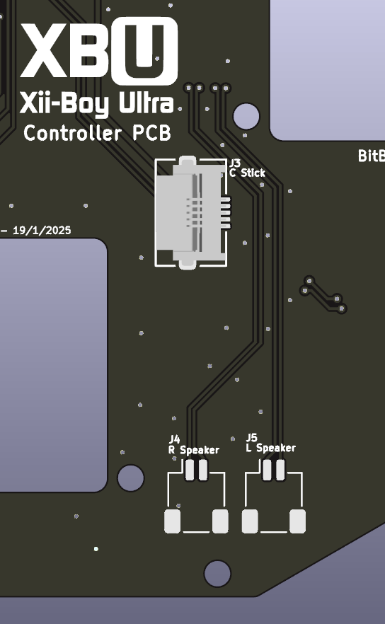

I then continued with the Controller PCB:

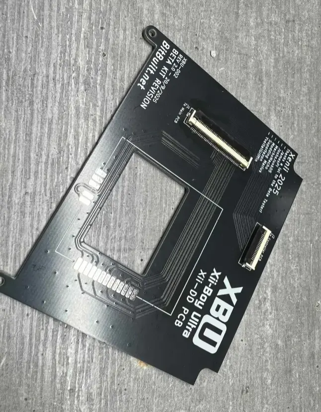

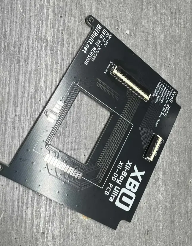

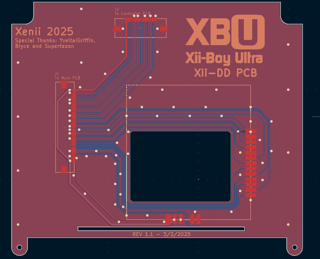

And then the Xii-DD:

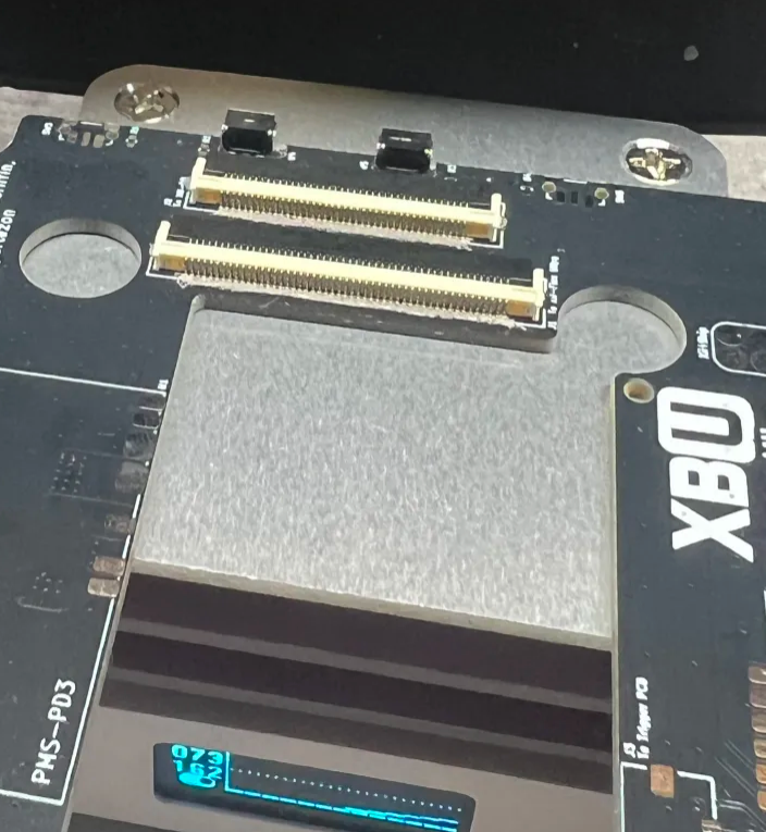

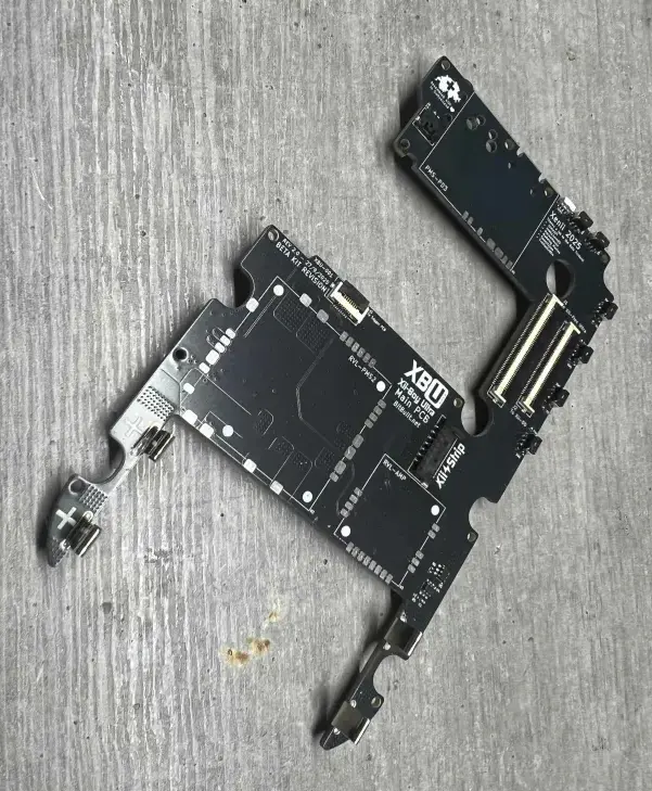

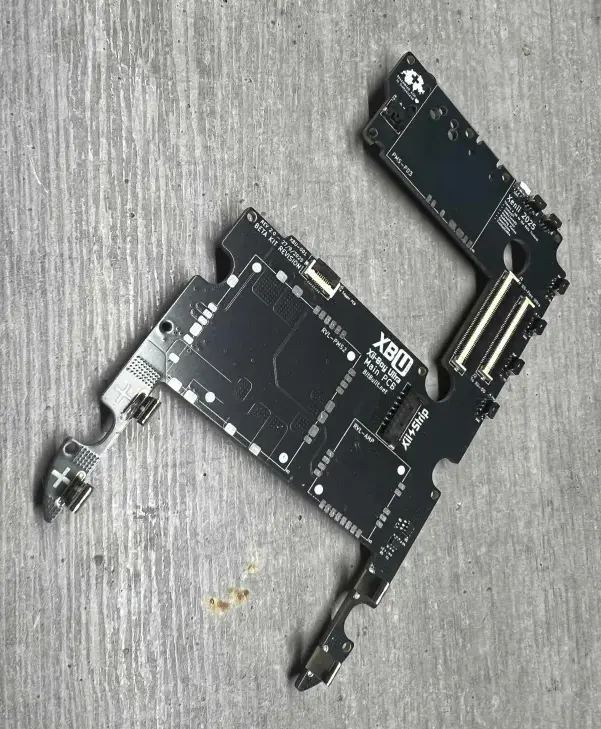

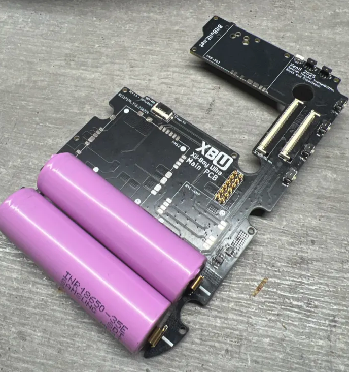

And to finish smoothly, the Main PCB!
After some quick shorts tests of shorts, continuity and visual checks, the boards were completed!

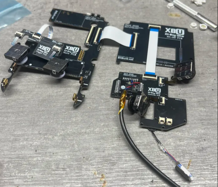

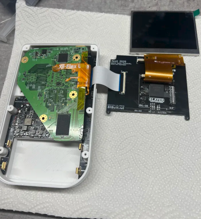

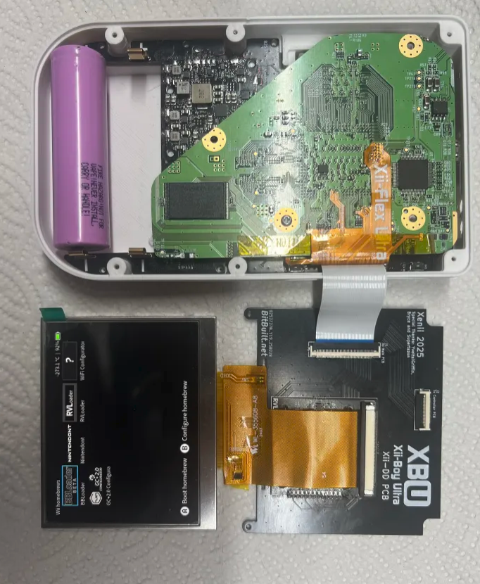

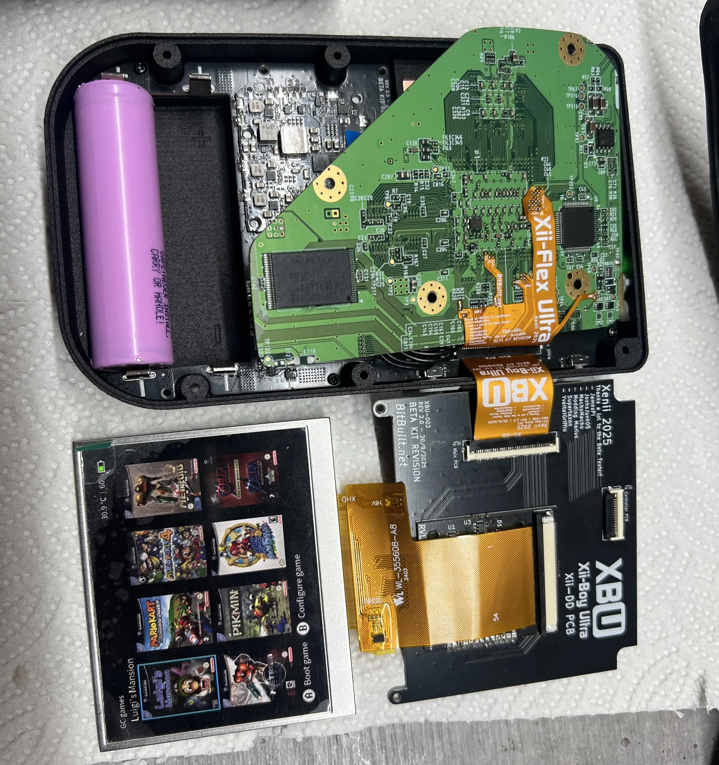

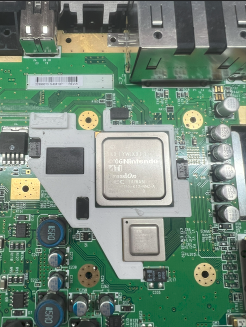

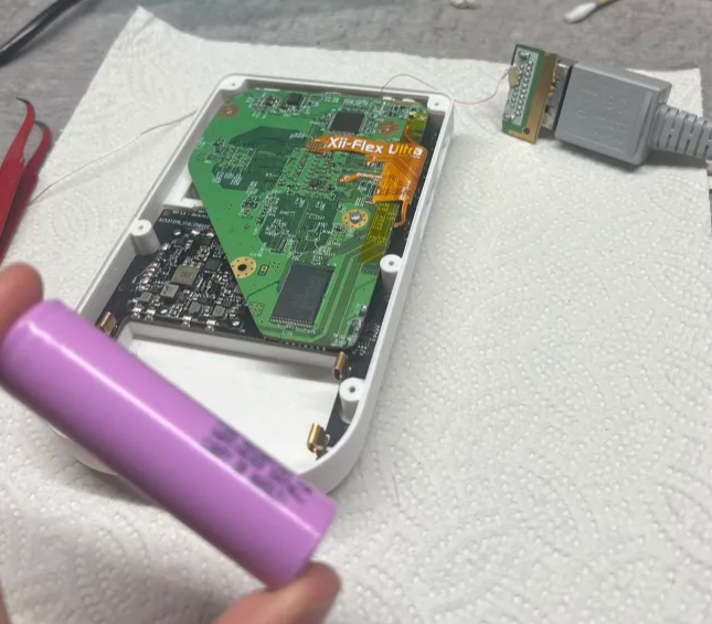

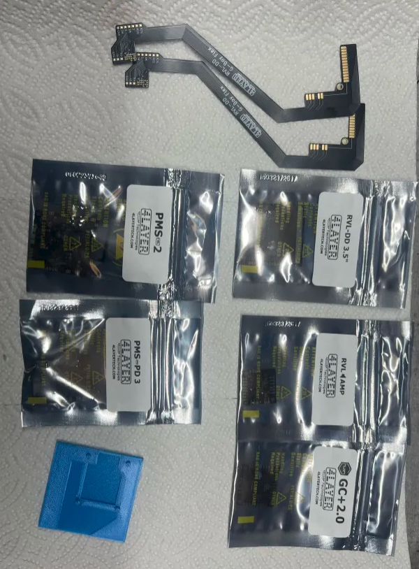

The next step was to play the Xii-Boy Ultra for the last time before it's final disassembly. When time came, I removed each board at a time. Slowly removing the screws, the boards, the parts, and all the parts inside the Xii-Boy Ultra.

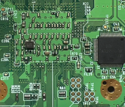

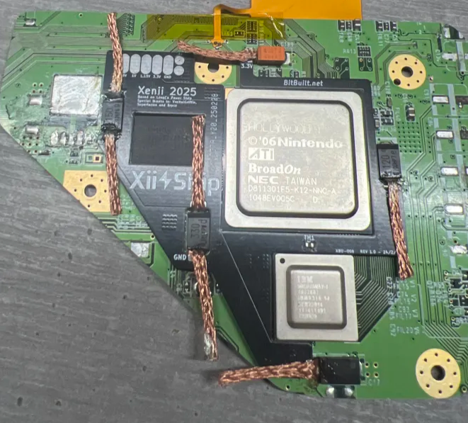

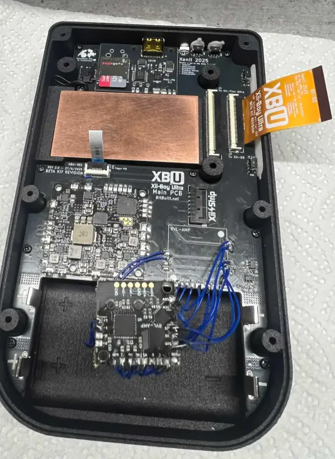

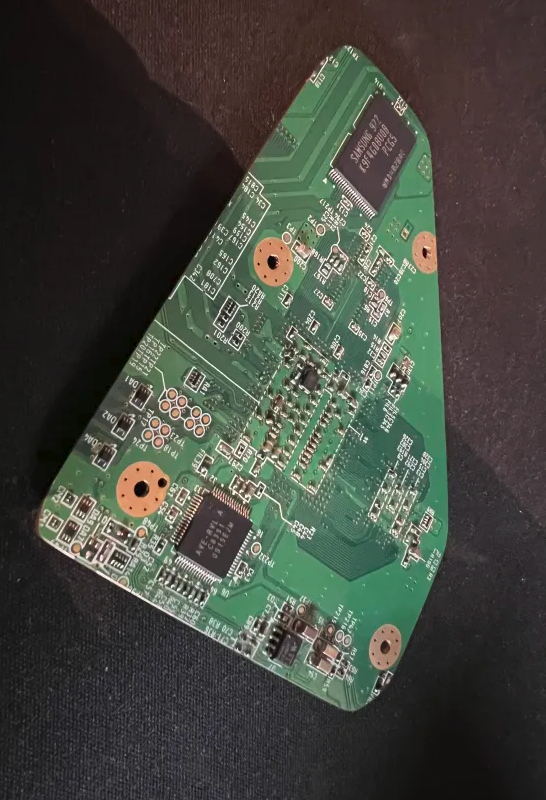

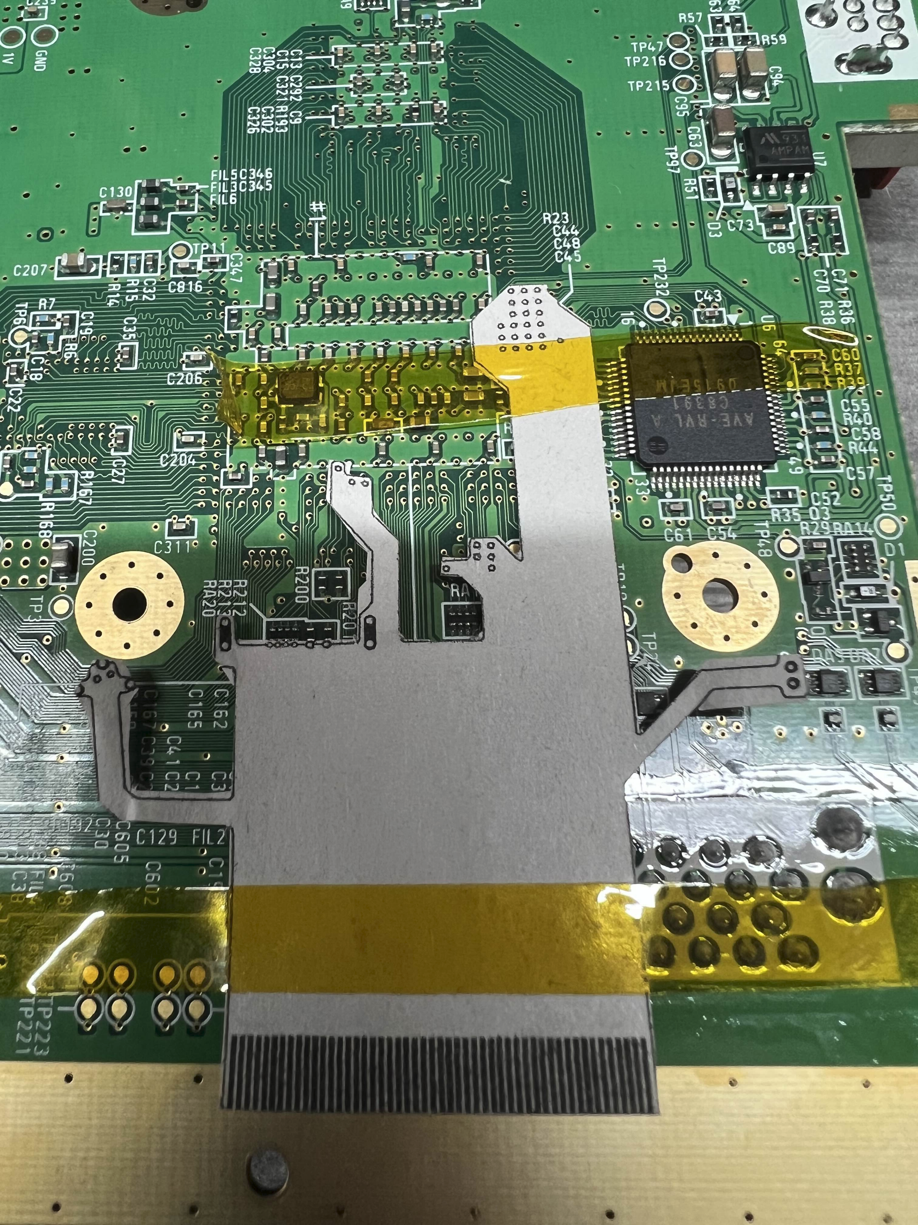

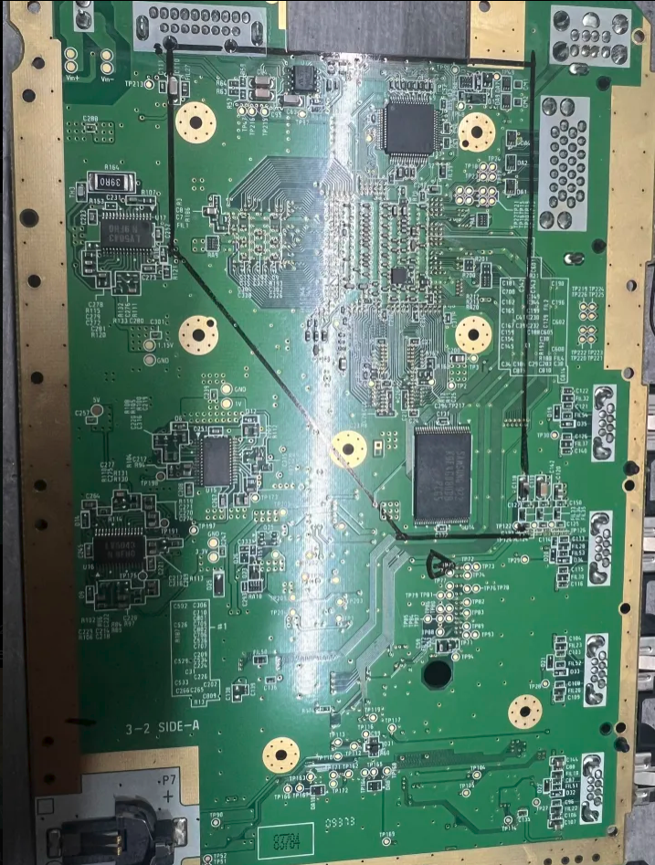

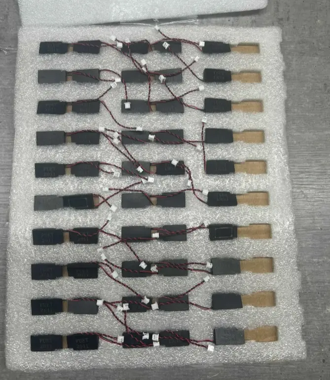

Then a tricky thing: moving the 4LayerTech modules to the new boards. Even after removing all the solder I was able to remove, they were still too strongly attached to the boards. I had to slowly cut the old solder with an X-Acto knife.
It was a real mess, but I ended up removing all the components safely, even though my excess heat bent some of them. Oooops!
I then spent countless hours removing and reinstalling parts from the old to the new Xii-Boy Ultra. Xii-Flex was a pain. Not because the design is problematic, but mostly because it was the third time I changed, which really damaged the board in some places. Unfortunately, I wasn't able to solder Bluetooth back; the tracks were just broken. To avoid wires, I didn't use magnet wires to get things back on track; I decided to get rid of Bluetooth. I don't really use it in the end, and I got pretty upset with this part, and I really didn't want any wire in this console.

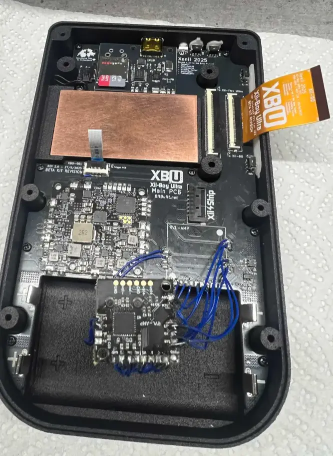

Anyway, it was almost midnight, I was tired, but I got the console to boot better than it ever did.

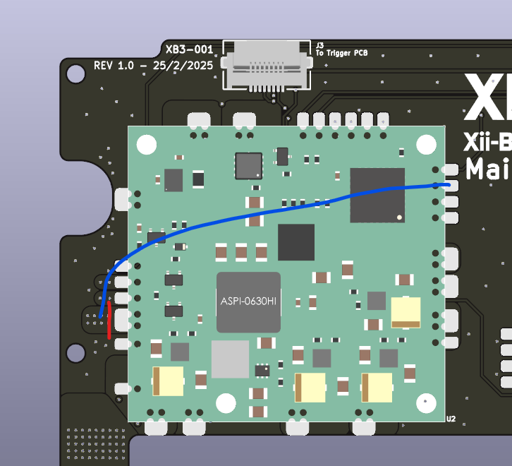

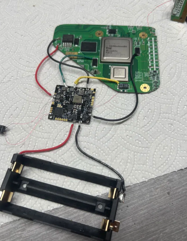

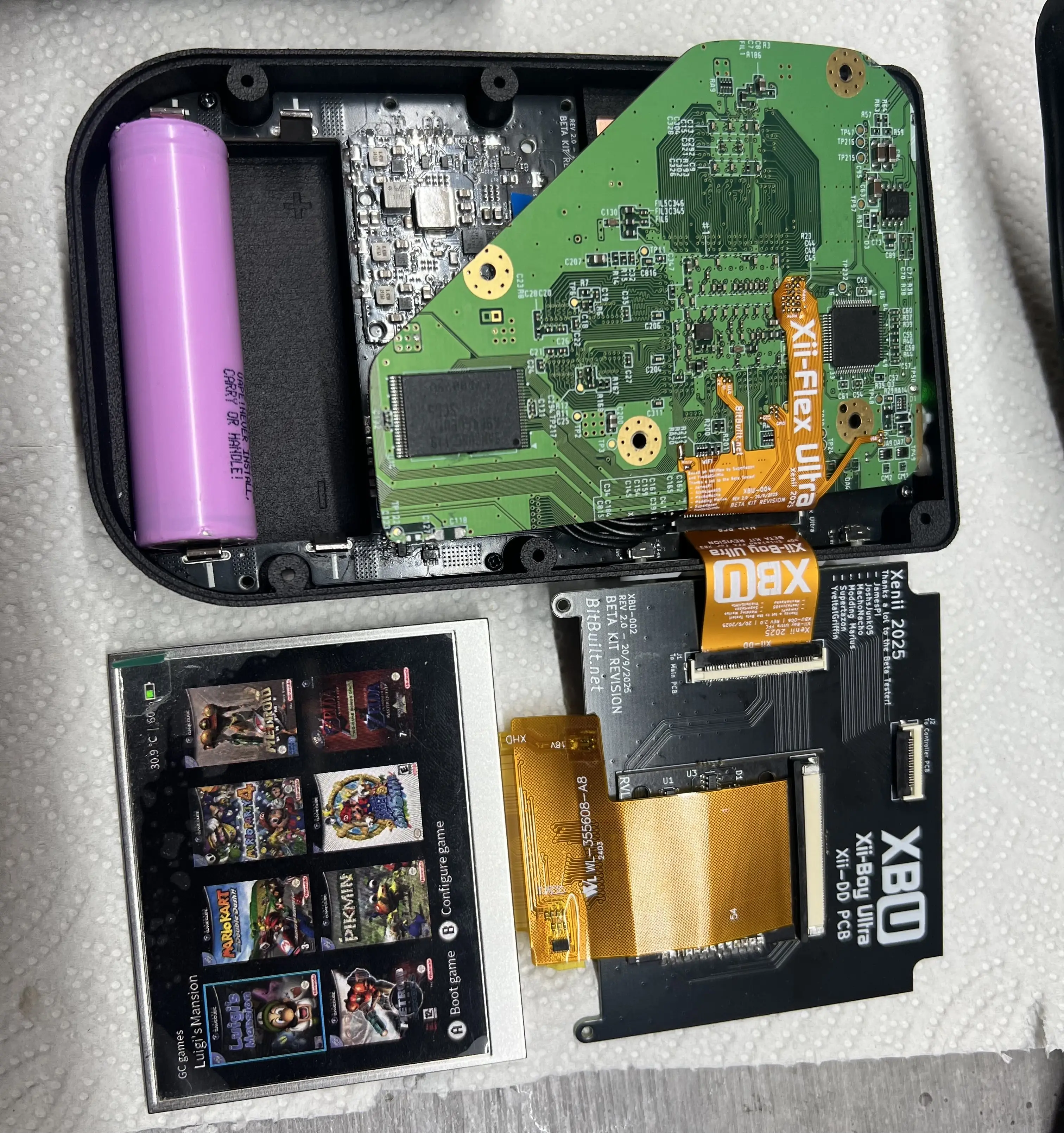

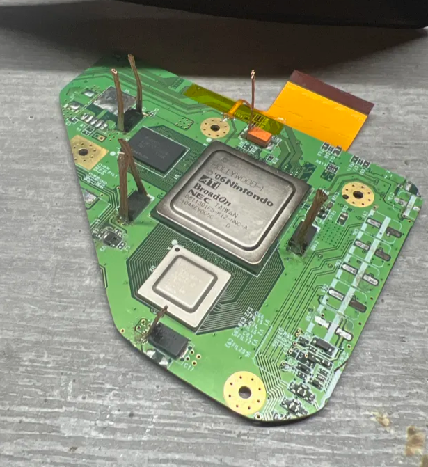

Due to the "technique" I used to remove the 4Layer modules, I created a short caused by an old trace stuck underneath the RVL-AMP. Removing it without breaking the pads again was a real challenge. But the short was gone!
I then attached wires (TEMPORARY) to test if the board was still working.
After all this heat, the RVL-AMP was a bit bent. Hopefully it wasn't a huge issue in the end, I was able to solder it back, even with this little issue.
Great news, RVL-AMP was still working. I was able to remove my wires (for God's sake) and finally install it the way it should have been. It's not flat, but at least it doesn't have wires anymore, which is what matters the most (don't argue with this). I took some sleep and ended up finishing the console the following day.

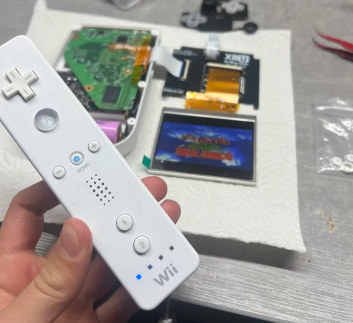

26/10/2025:

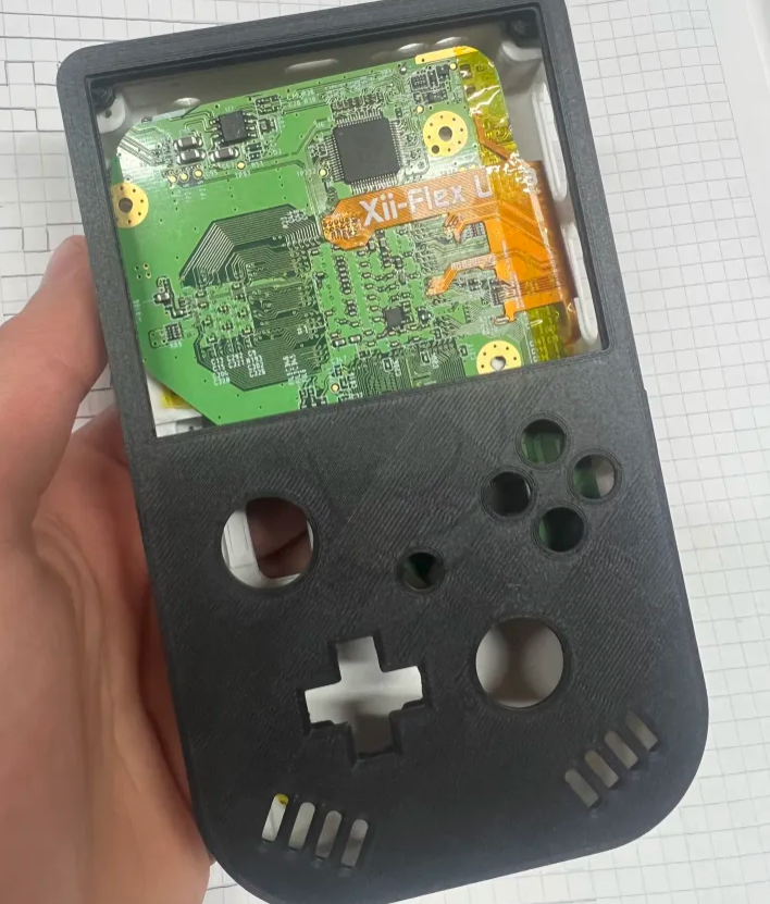

The console was done! It was working!
Pretty much everything I wanted to fix was fixed! I still had some little mistakes, but nothing as bothersome as what Bryce and I were used to with the first REV0 :XD:
I also made a cutting-edge post; I'm not sure if it was this date, probably not, but at least this is when the console was finished.

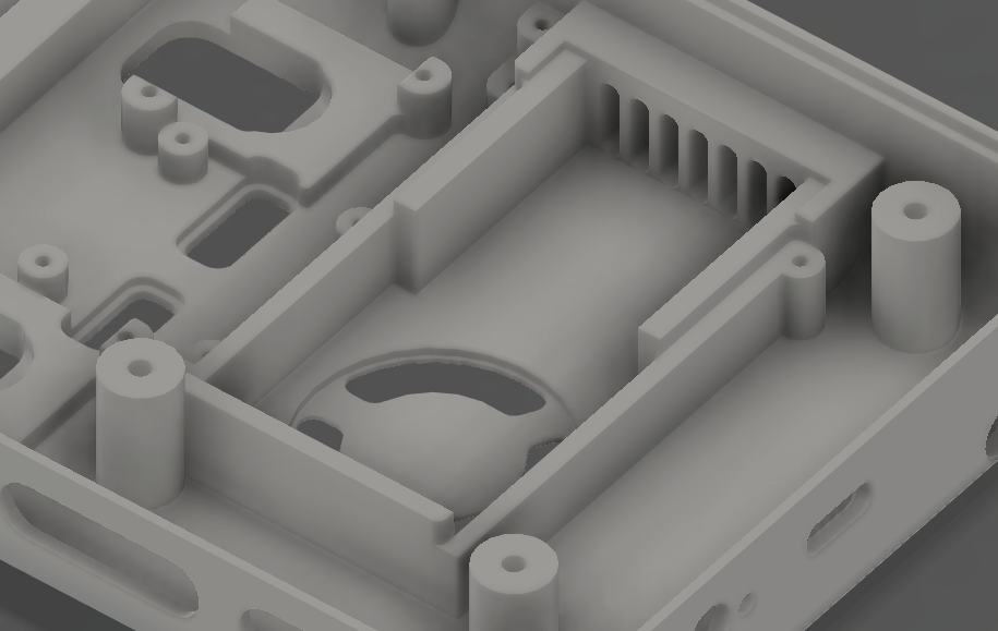

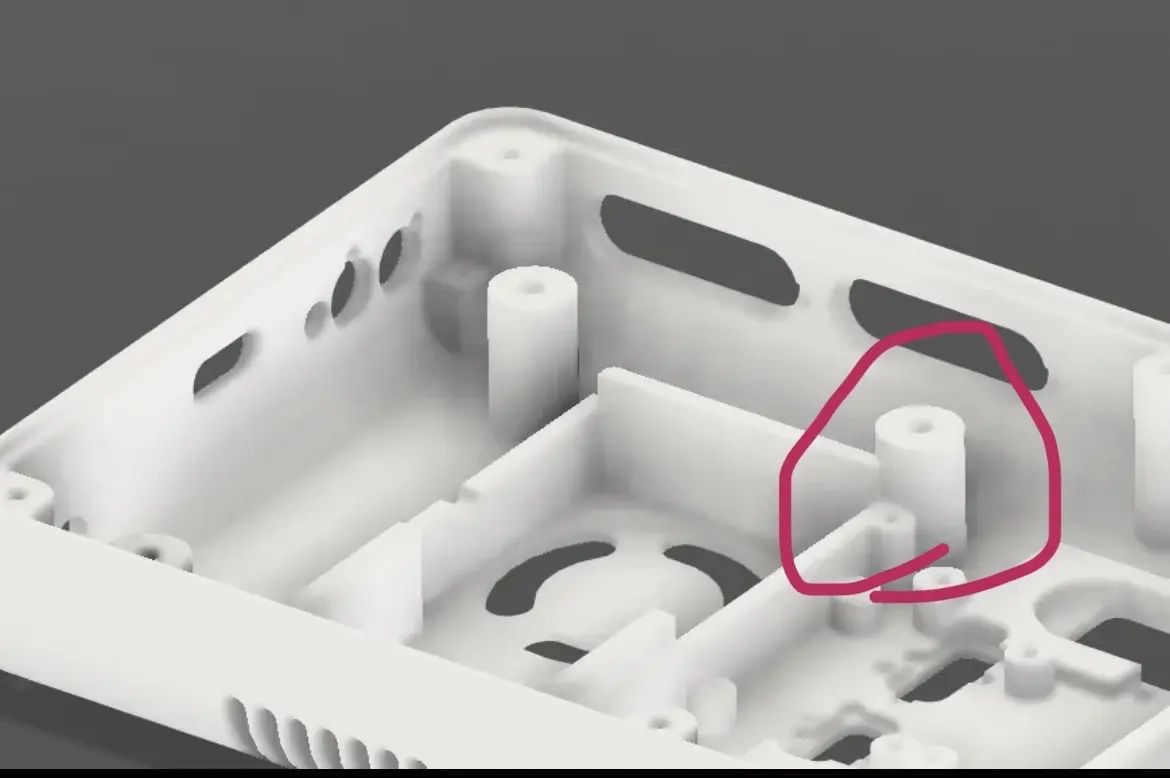

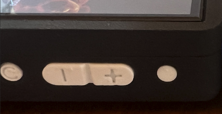

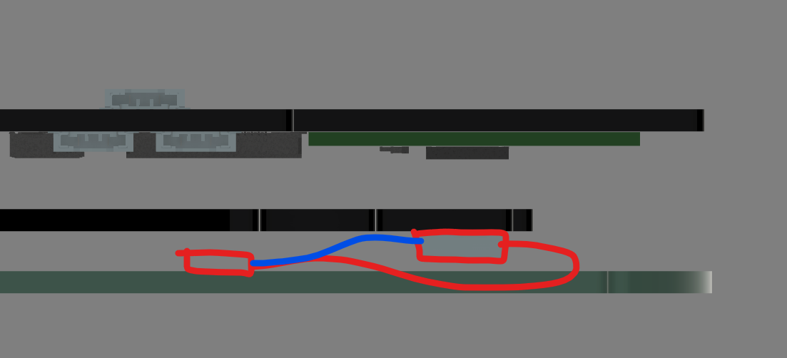

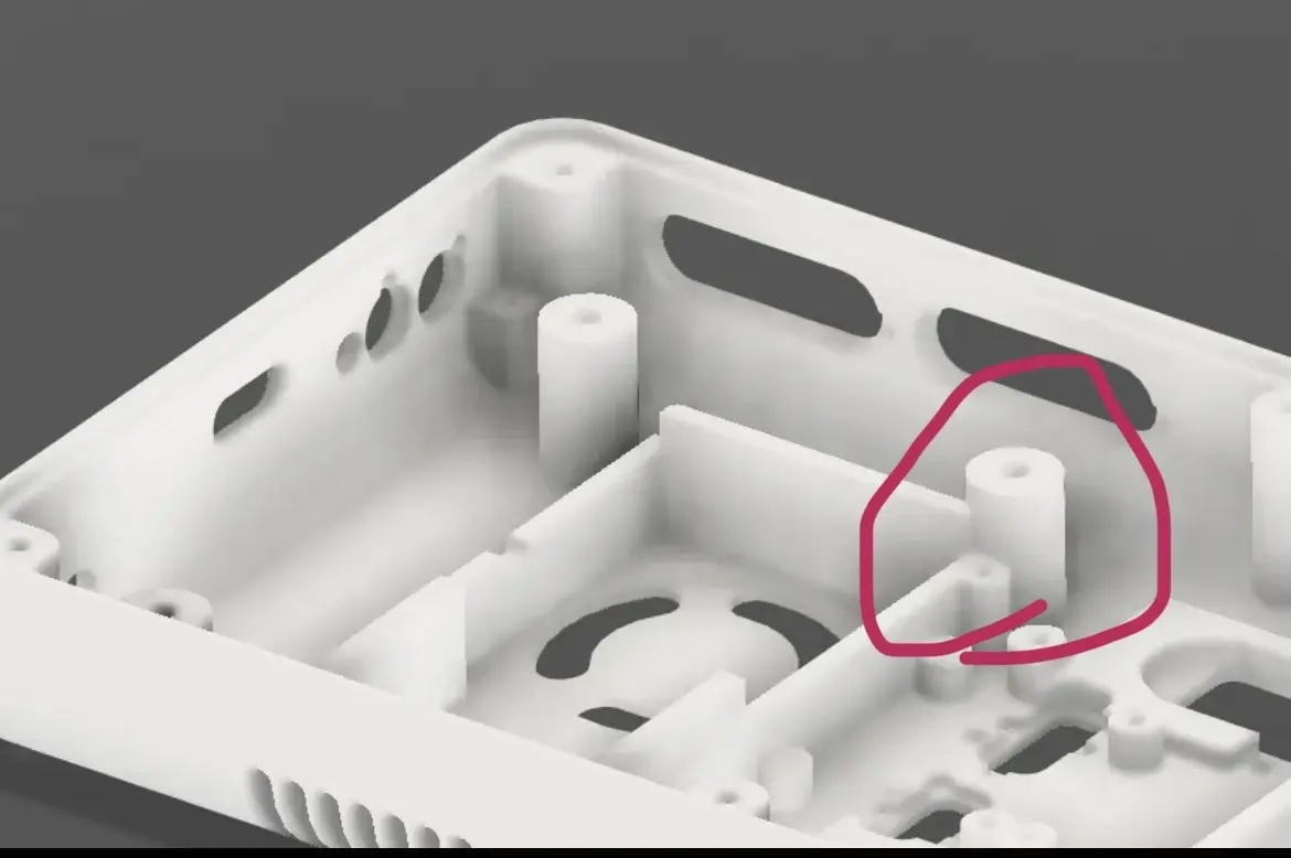

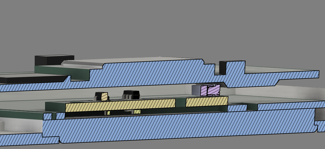

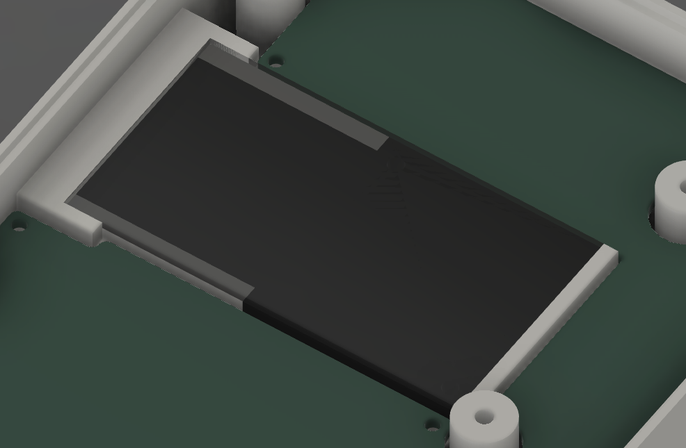

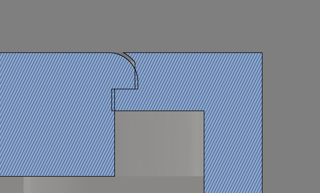

The only true and real mistake I've done is this one:

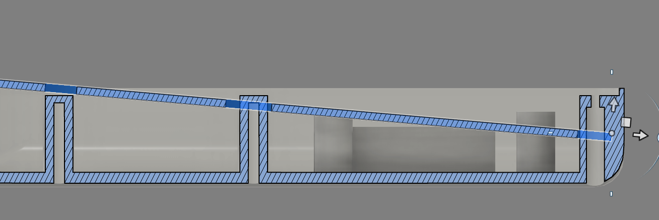

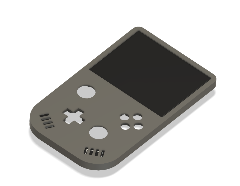

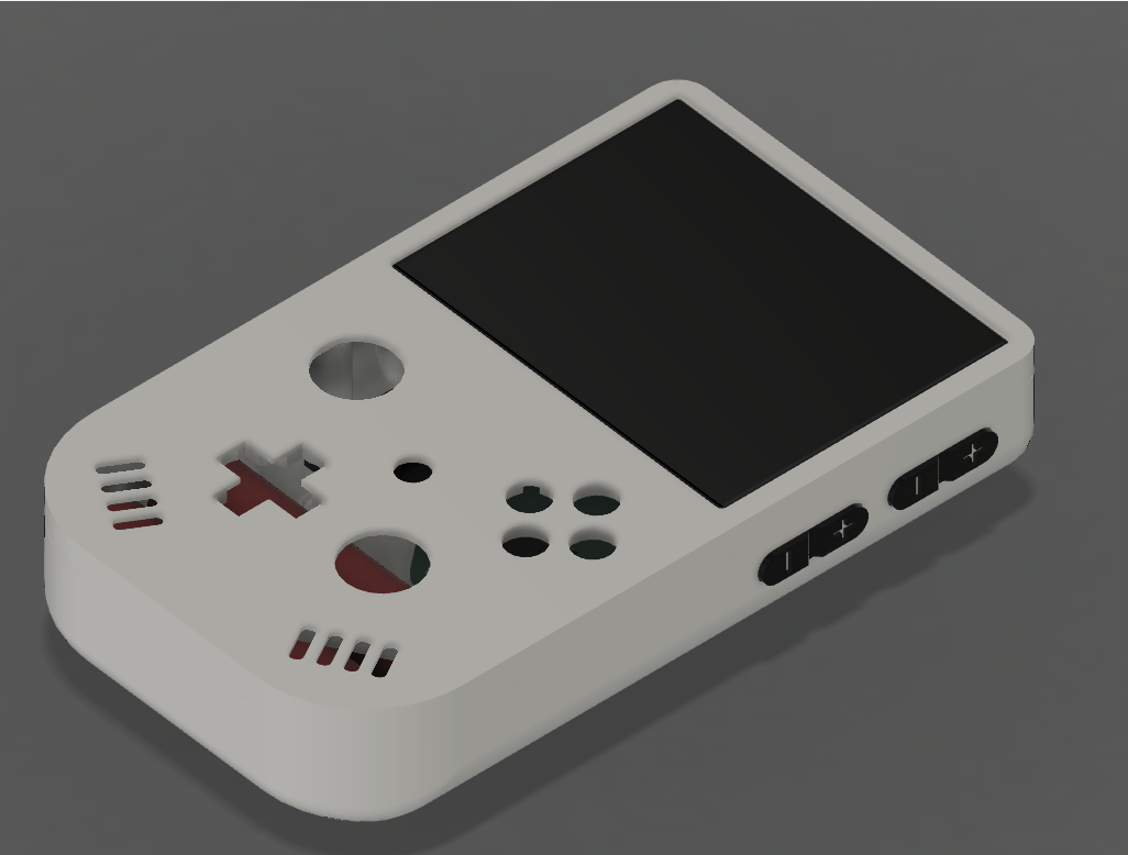

I don't really know what was going on, but for some reason, a change I've made in the shell was not in the final file.
Nothing terrible though, it was just this Wii screw post being 0.8mm too high. It's caused by the new Xii-Strip which cover this screw post, so it needs to be 0.8mm less high to be perfectly flat.

It was finally the time to assemble all the boards for the Beta Kits!

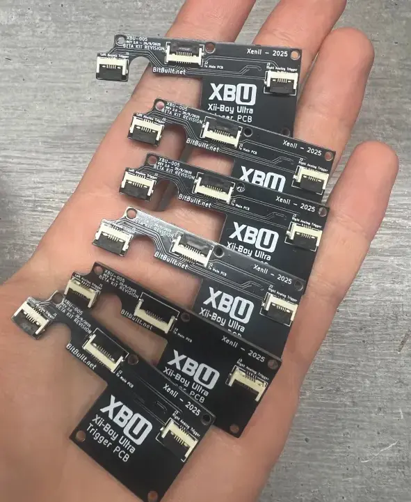

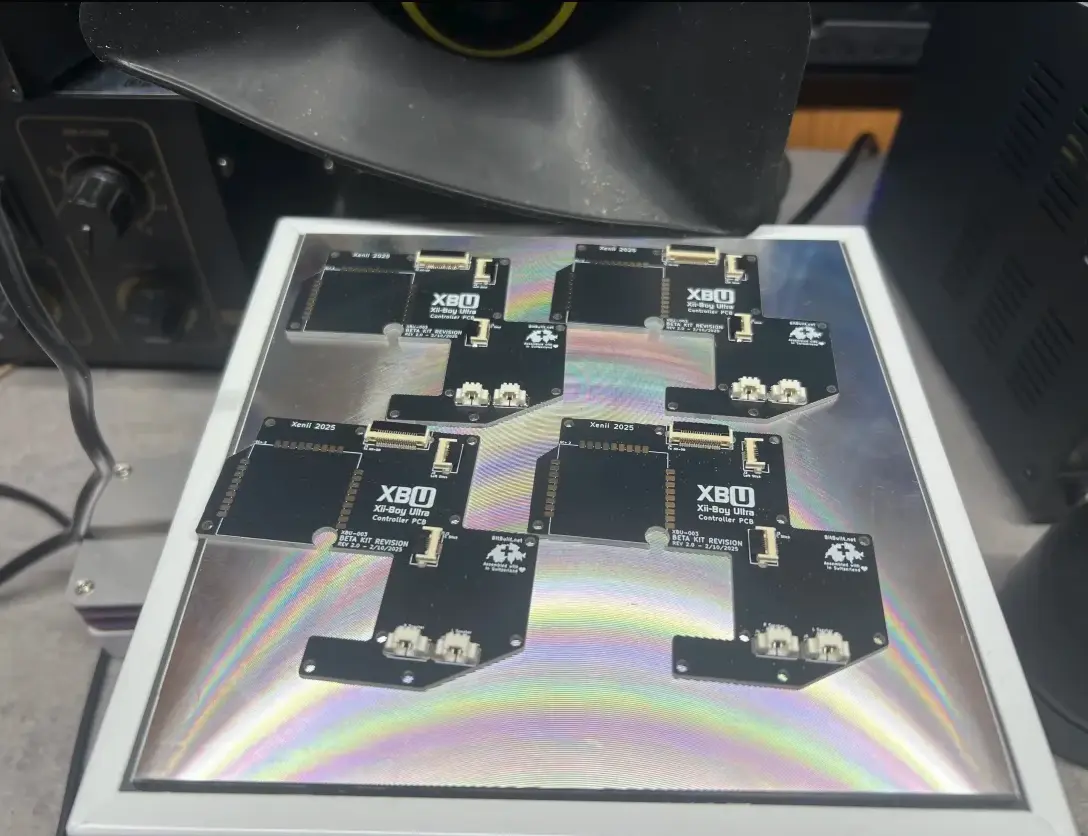

I got pretty excited and took some pictures. I first started with the trigger PCB. Since I got my jigs to be perfectly adjusted, I was able to assemble the board pretty quickly and with only a few pads to reflow, instead of the whole component.
After half an hour, I had all the Trigger PCBs done and cleaned!
1/11/2025
New month, new PCBs to assemble!
Was time for the Controller PCB!

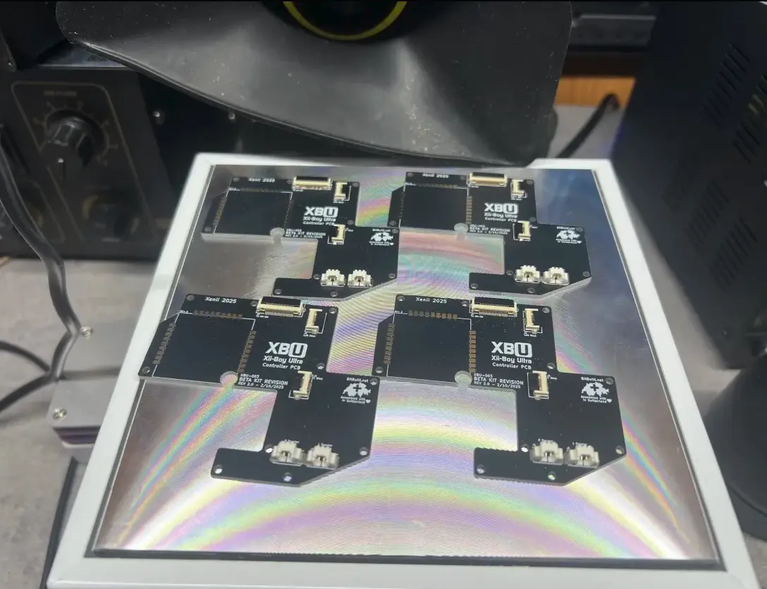

I was really happy to have my new heating plate; it helped a lot!

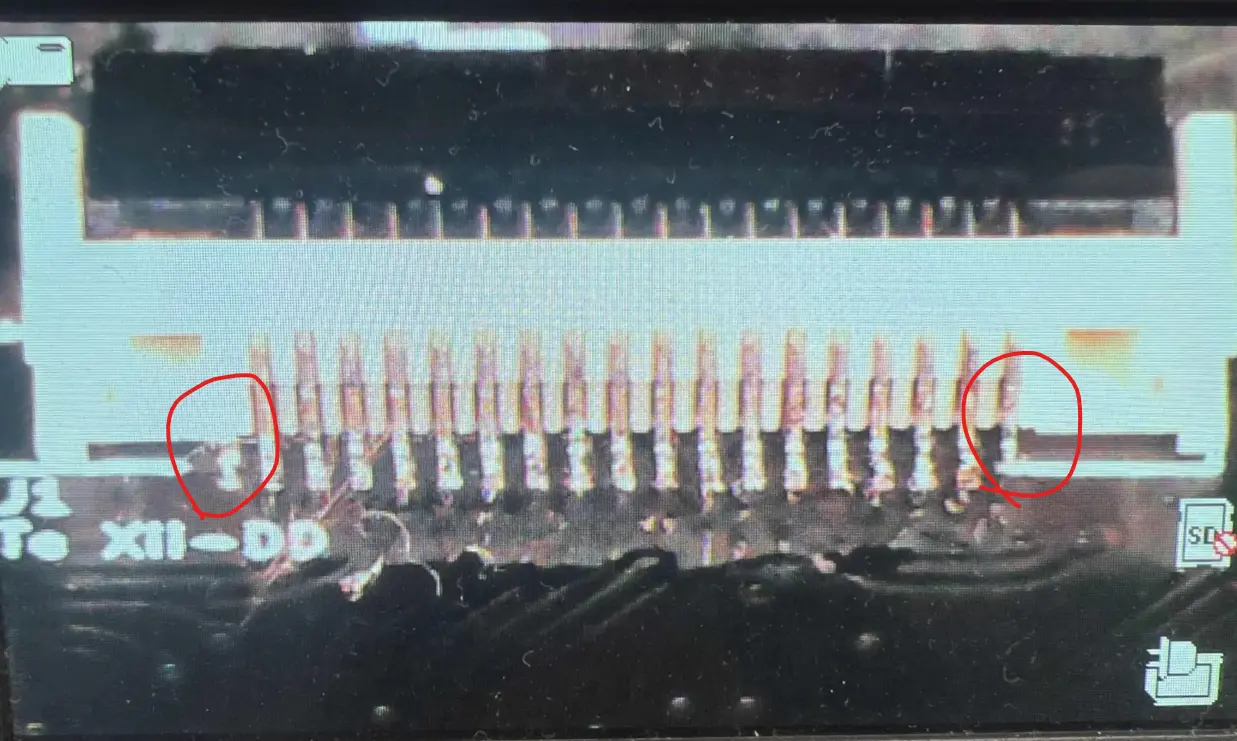

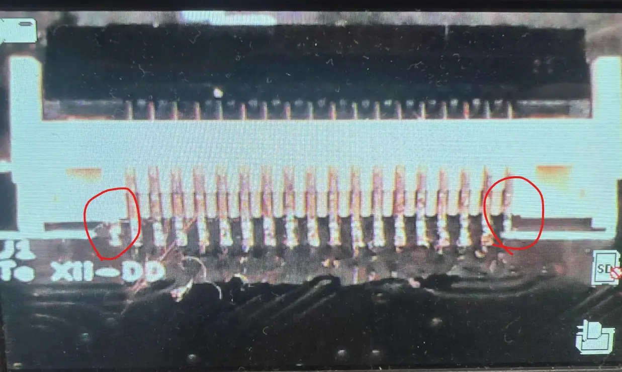

The assembly of these boards went really well. I only had one little issue with this one: the connector has kind of shifted, so the pads are not aligned with the pins they should be :XD:
It seems like a huge pain to correct, but it was pretty easy! I used my tiny soldering plate to quickly heat the board, and I gave a little push to the left to put the connector in place.

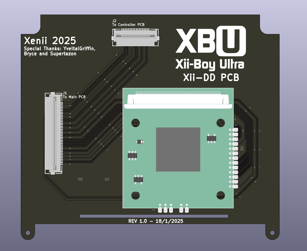

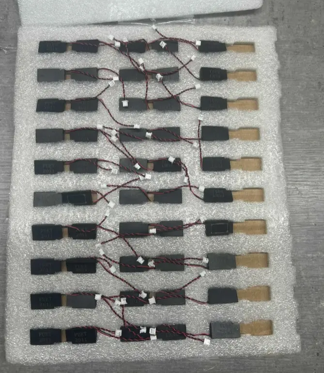

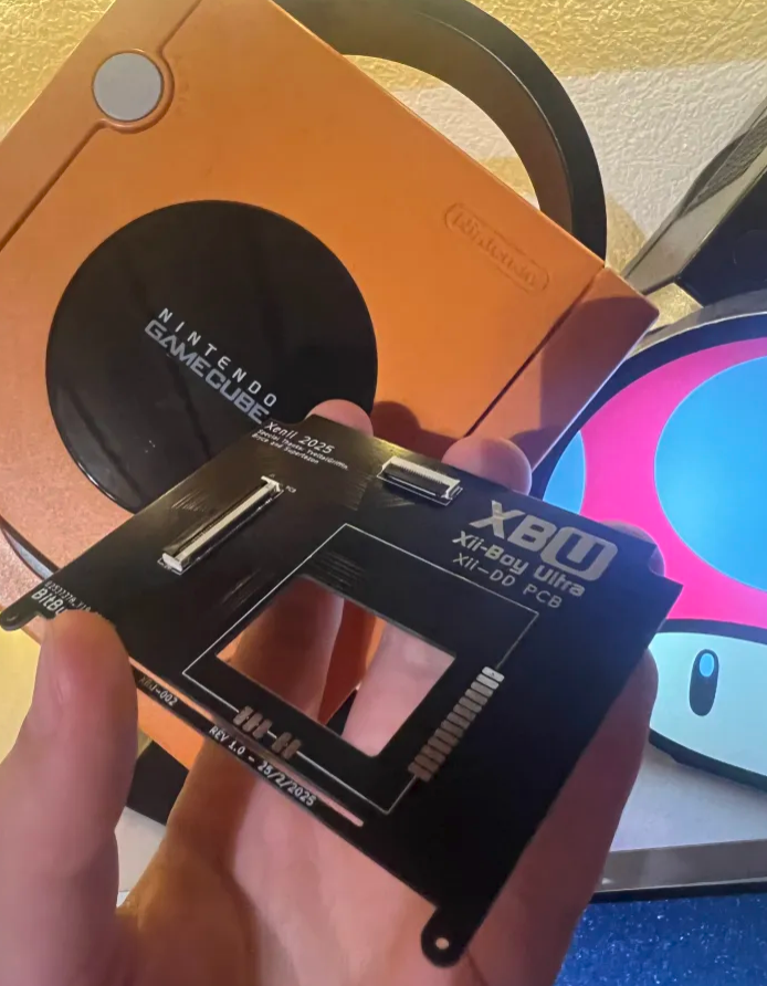

I also did the Xii-DD PCBs, the one that holds both RVL-DD from 4LayerTech and connectors to allow signals to flow through it!
The final boss was the Main PCBs! This one takes a lot of time. There are a lot of connectors I need to solder, a lot of tiny resistances, chips, and components in general.
It took some time, but after testing all the PCM circuits (the extra battery protections the Xii-Boy Ultra has), all the boards were working perfectly!

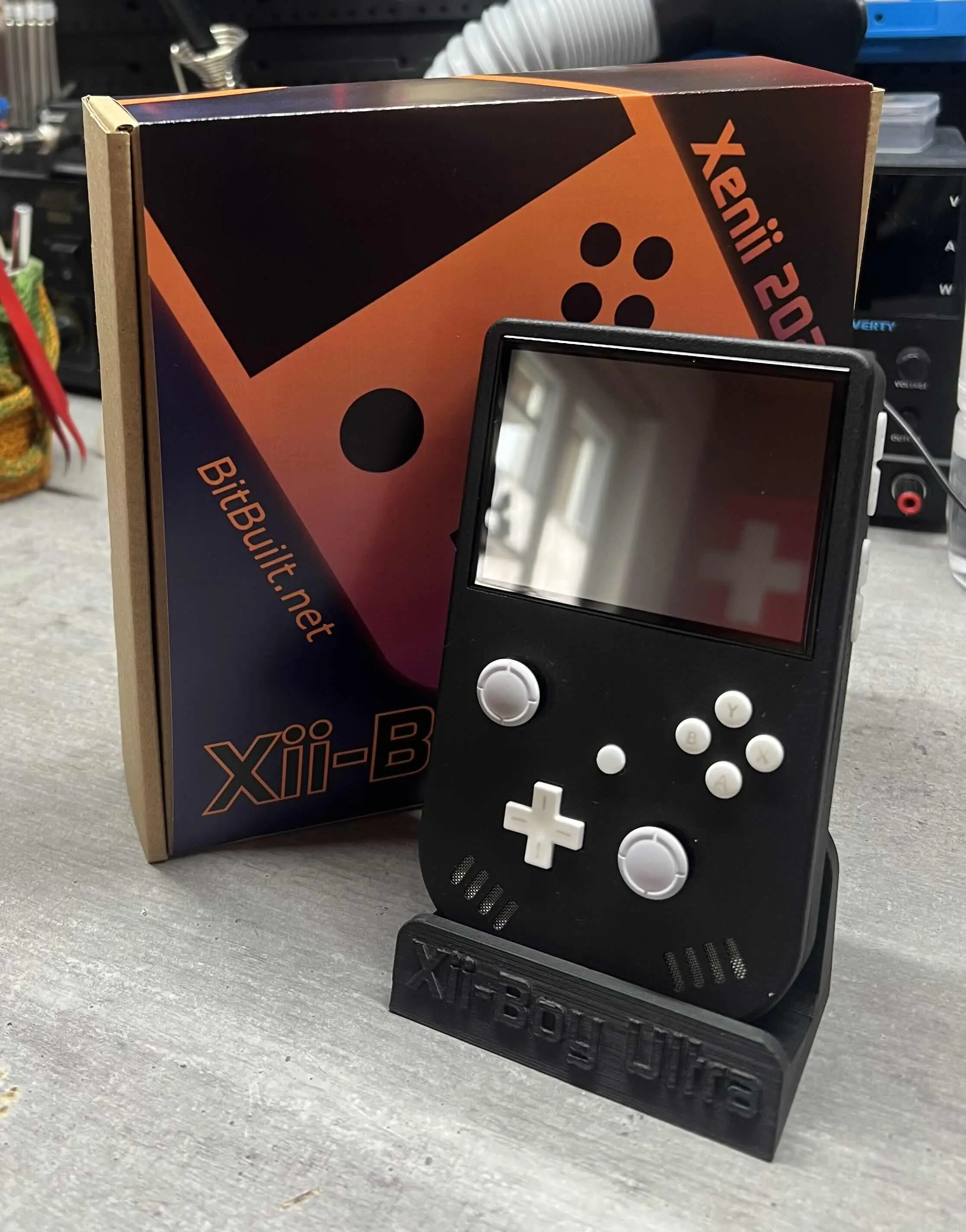

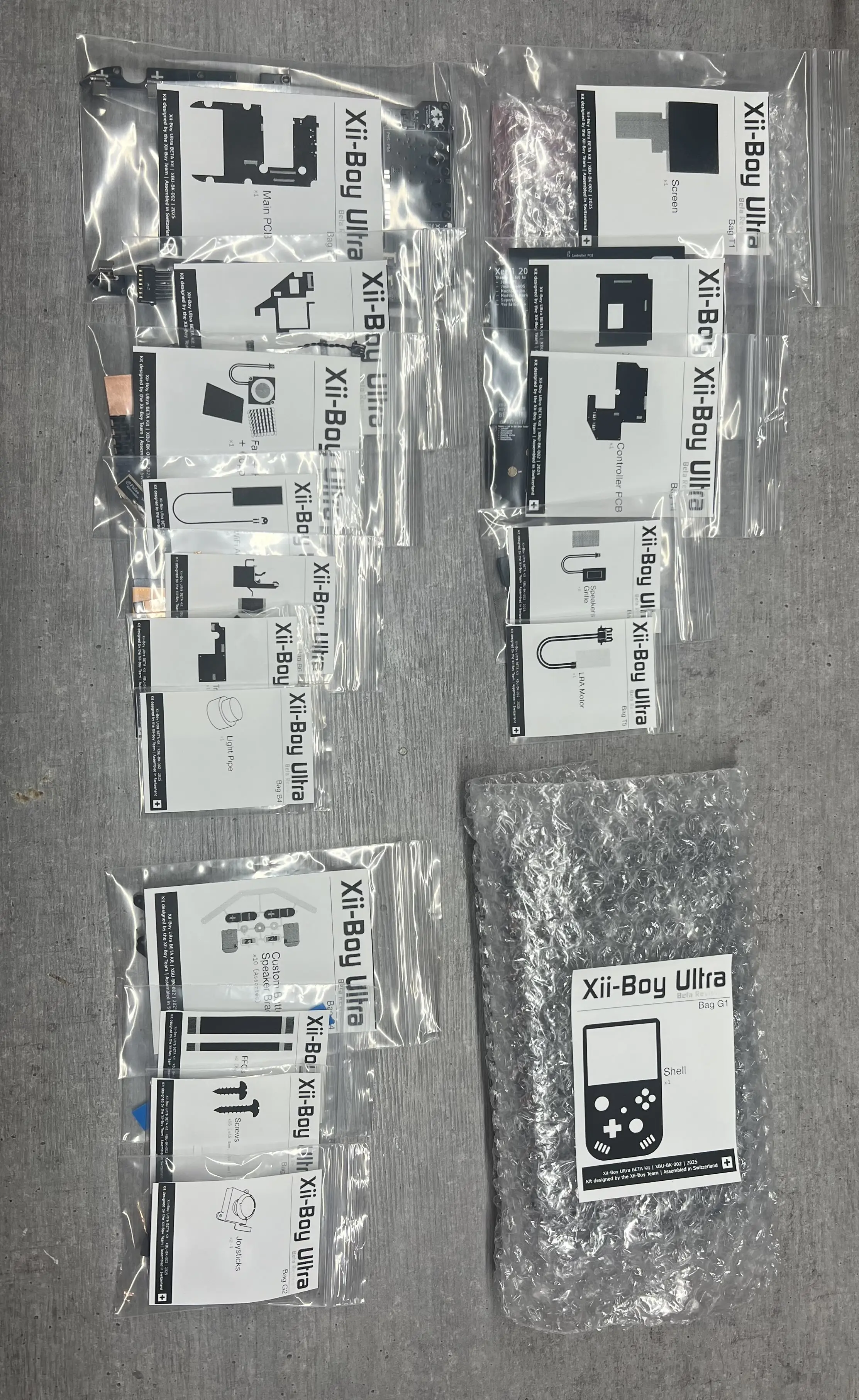

Bags were done, same for the front box.
I started packaging everything! I stole a thermal sticker printer from my dad; he didn't notice, and some "paper trimming machine". I don't have a single clue of what that thing is called, even in French...
I also asked my dad to print the box on some extremely high-quality paper with his awesome printer, lol. The result was looking awesome. Thousands of thanks to both James and my dad for this incredible box quality.
And this is what the box next to an assembled Xii-Boy Ultra looks like! How cool is this?! :)
This box is truly gorgeous!

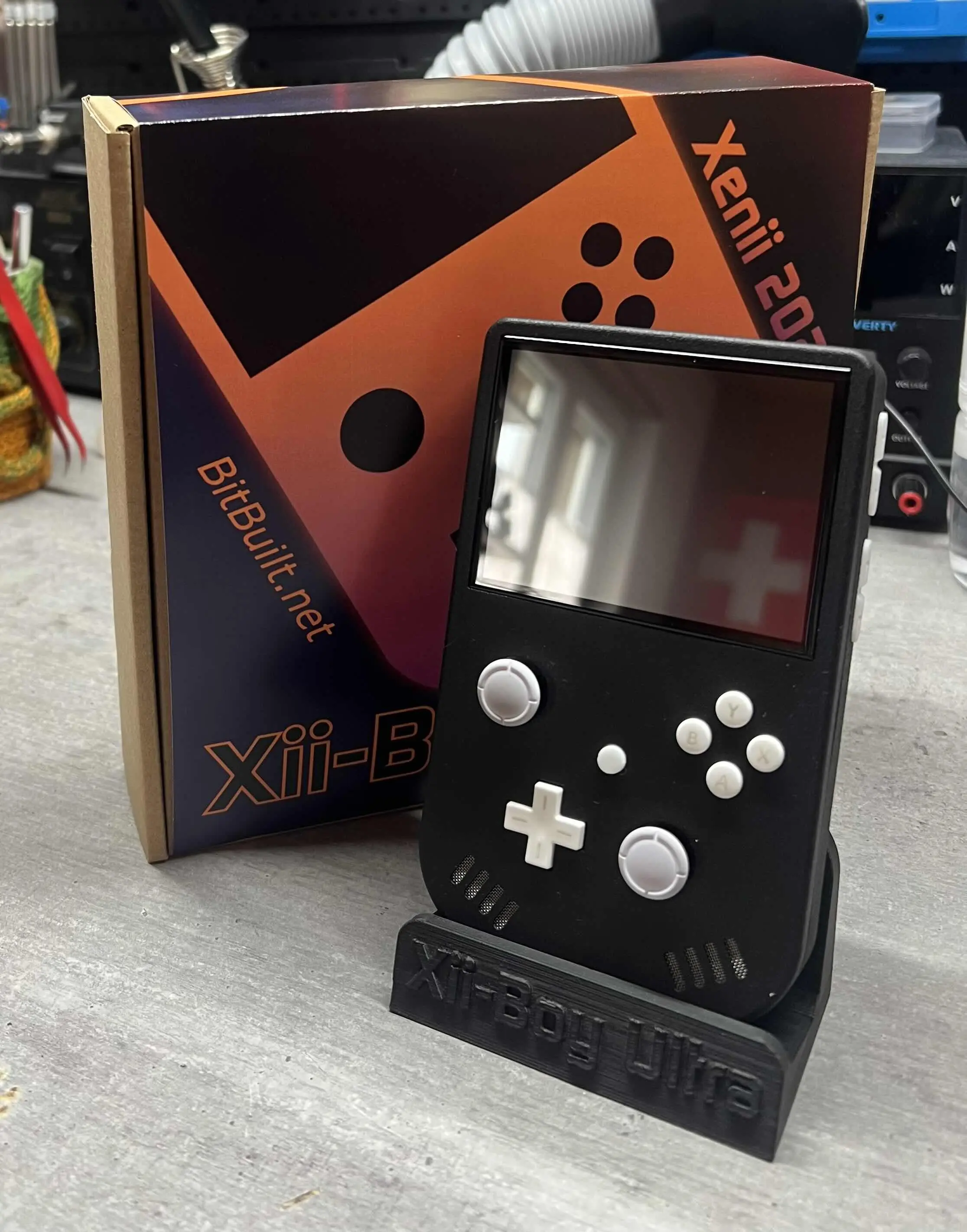

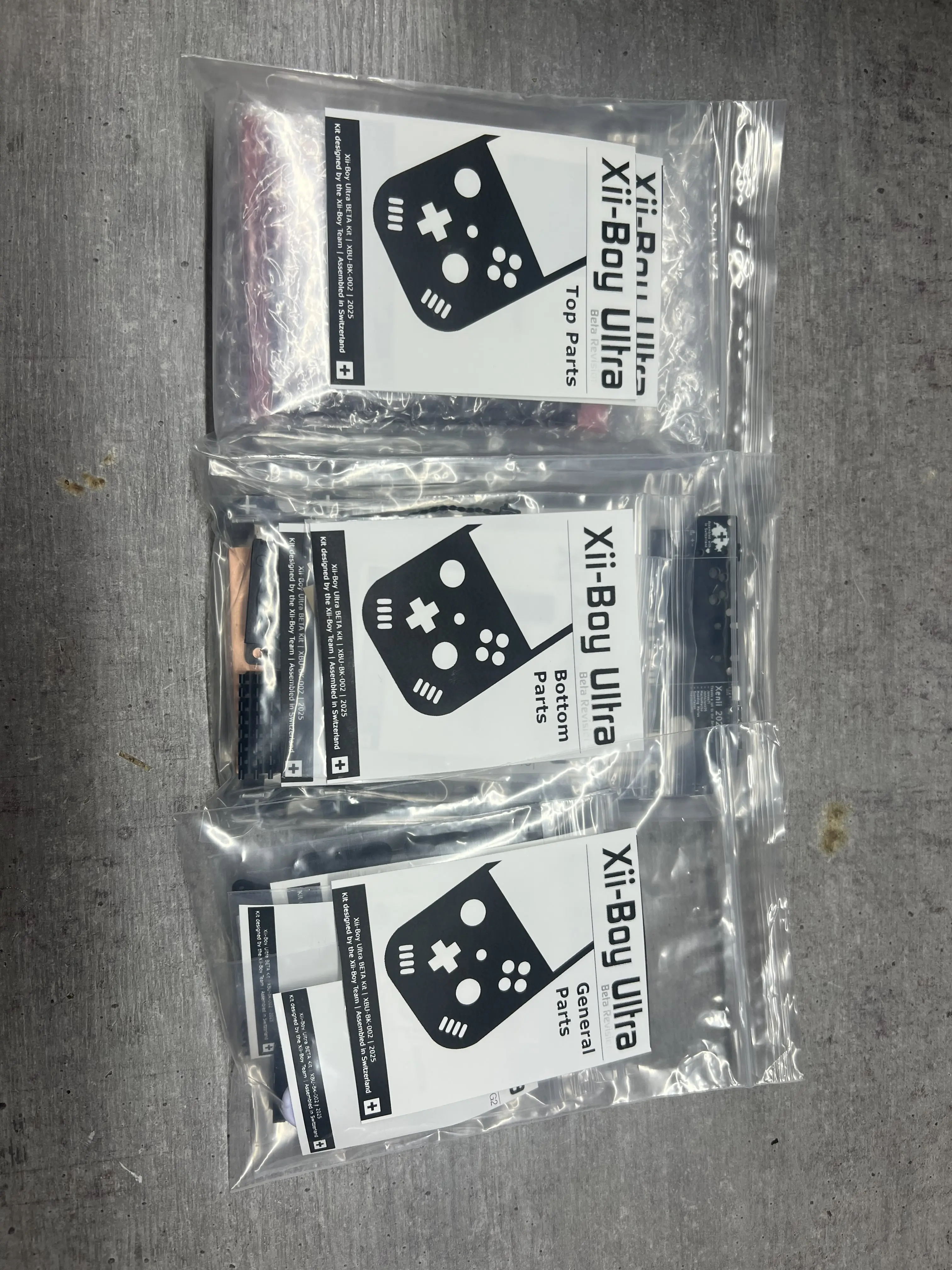

Merry Christmas! I got a nice gift for you guys; the first kit was packaged!
The quality of the box, stickers, etc., was truly perfect in my opinion.
Those two kits are the ones of Marius and Alex! The two French Beta testers!
I first packaged those, since sending to France from Switzerland is surprisingly simpler than sending to the United States. I have no idea how, though, if someone knows, lemme know! :XD:
View attachment 41618View attachment 41619
View attachment 41620View attachment 41621

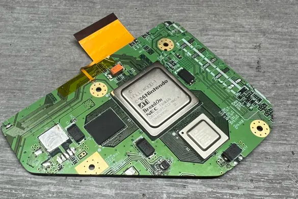

View attachment 41625View attachment 41626
It also meant something more important: I can start assembling all the boards for the Beta Kits!

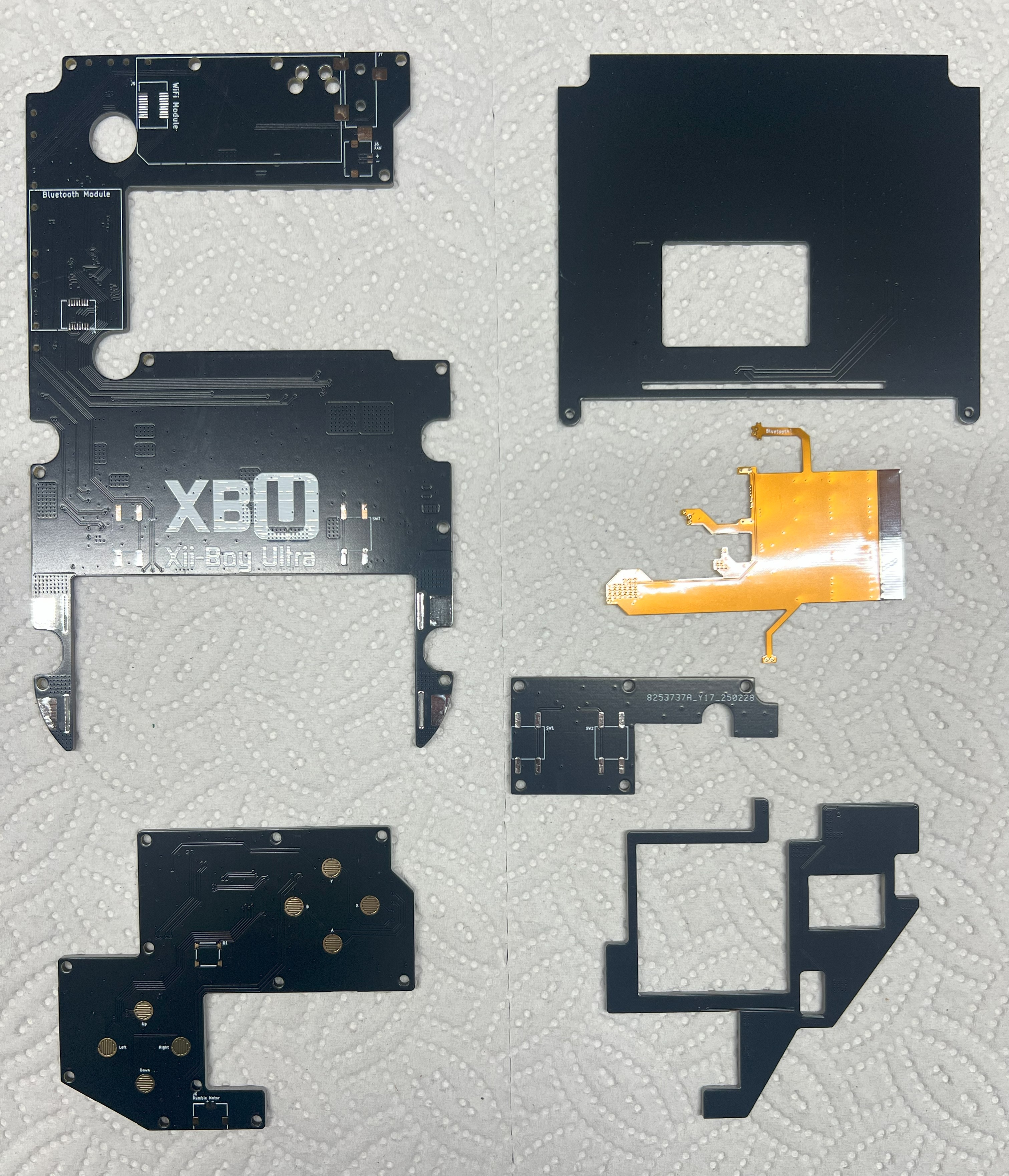

1/11/2025
27/12/2025
View attachment 41641View attachment 41642
View attachment 41643View attachment 41644

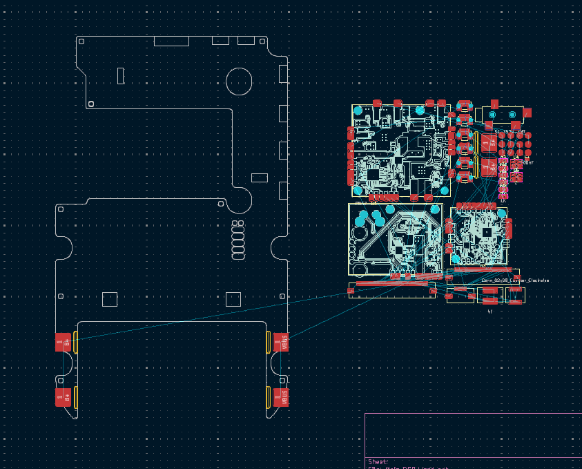

Alright, so I had the components, the PCBs, the tools, what was left? Oh right! Time!

Alright! The day has come!
1/11/2025

I sent James all the 3D files of the console to create some really nice renders for the guide's main page.
View attachment 41635View attachment 41636

27/12/2025
29/12/2025
After an awesome day of skiing in the Alps, I got home with my last goal of this whole project: sending.
I checked everything and made sure everything was properly packaged. I went to the Swiss Post with my package. It was a really exciting moment.
This was the first kit I've ever sold in my whole life. I took almost 2 years to get to that point, so I think you can understand how I felt. :D
The person at the post office took my package. I felt pride!

After successfully shipped the Xii-Boy Ultra Beta Kits to France, the Xii-Labs (previously called the Xii-Boy Team) and I had to find a way to ship the kits in the United States of America.
As I mentioned many times previously, shipping packages to the USA has getting quite complicated. The American government announced a reduction of the tariffs for goods originally from Switzerland. Since November 2025, Switzerland "only" faces 15% instead of the 39% we had since the 1st of August 2025.
We thought this reduction might bring the Swiss Post to relaunch their shipping services towards the United States, but it did not. We then decided to find a new way to ship the packages. As I mentioned, UPS seemed to be a decent solution. The service was much more expensive than the Swiss Post, but it was far cheaper than what DHL or Fedex quoted. However, shipping the packages to each individual person was not a convenient solution. Therefore, we started looking for people who could help us with that process. The idea was to ship all the kits as once to reduce custom fees and overall divide the shipping cost.
@YveltalGriffin gently offered his help! After a little organization with the other beta testers, the kits were ready to ship!
My next mission was to packed them up. It was quite complicated, because I only had 1.5cm of margin on each side, otherwise the package would be too big for UPS which would ask an additional fee. Hopefully, I was able to properly packed them up in the required space!
Creating the shipping labels and custom declaration was a huge challenge. For some reason, the UPS website was extremely glitchy. I had countless errors, and I actually "soft locked" the website after processing the payment (which hopefully, didn't go through). It kept telling me "we suggest you to call the UPS support". After noticing representatives might not speak either English or French, I took my courage to hopefully find someone who didn't only speak German lmao. I called, but I quickly realized no one was there to help me, and then I noticed it was already 11pm :facepalm:
Yveltal was able to help me to figure this out, and the next day, the package was ready for drop out!

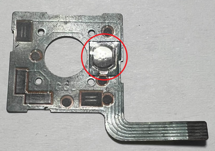

Sticks
The Xii-Boy Ultra uses 4 sticks. Two of them are used in the front half, and the two other are used as analog triggers and are fixed to the bottom half.
All of them are Nintendo Switch Joycon's sticks. Top sticks can be pretty much whatever stick you want, they just need to operate at 3.3V (some Hall Effect sticks might not work with this voltage).
HOWEVER, the two bottom one used as analog triggers MUST be identical to the one present in the list. They are after market parts, often referenced as "Stick V5.0".
They need to have that exact visual look:
The trigger caps that replace the original ones will only fit in that exact revision, so make sure to order the proper one.

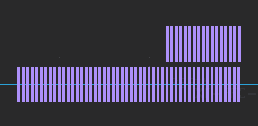

Screen
The screen used in the Xii-Boy Ultra is a 3.5" 480p laminated display with a 54-pin FFC.
It is the exact same display used in Anbernic RG35XX consoles.

Speakers
The speakers are probably the most specific parts.
They are rated at 8Ω and 0.7W. They should be ordered with a 40mm long cable, with a JST 1.25mm connector.
Can also be found on Alibaba if you can access it.
