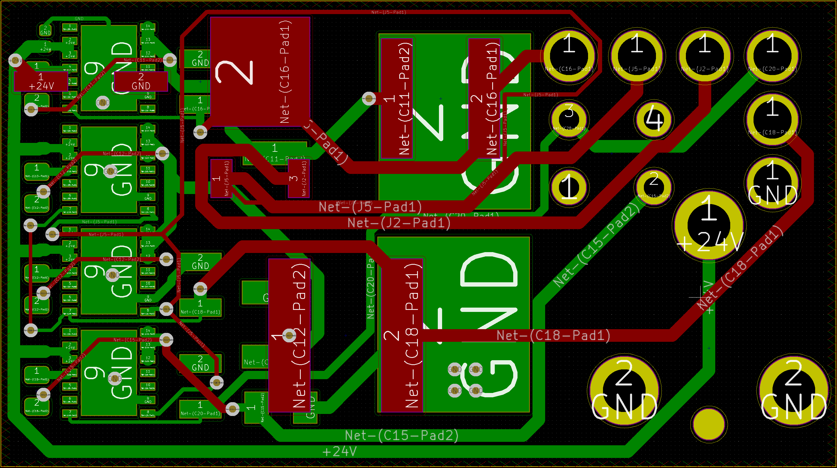

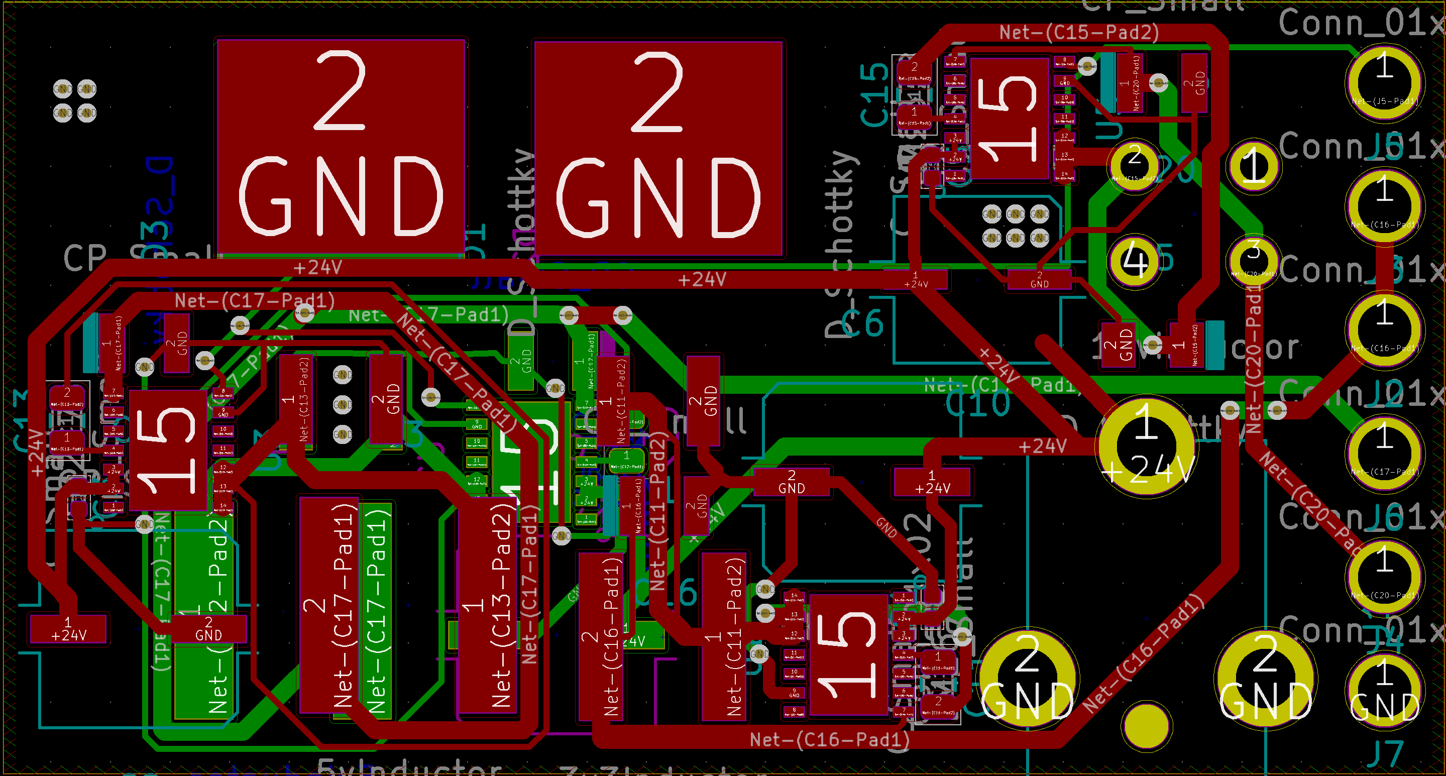

I've designed the first iteration of the 24v board, it's 60*32mm. Now that it's done, I don't like it for a variety of reasons. I'm going to try again, putting the low profile components on the backside of the board and the tall components on the topside of it. Maybe I'll be able to squish it down a bit more in the process.
There, that's a little better.
27.5*49.25 mm
Oh, hey, I worked on this a bit.
I ditched the 12v regulator and changed it to 12v in. I also had to source different inductors, which are sadly larger, so the whole board got a couple of mm wider in the process.
26.5mm*57.2mm
I think I'm gonna actually order this one, and see if it works.
I found a couple of errors with the design, such as multiple components trying to take up the same space, and fixed them. I also actually bothered to do trace width calculations and discovered that I was way off, so that's been remedied as well. I'm going to sleep on the design revisions, and look over everything with fresh eyes tomorrow. If everything checks out, I'll order the parts and we'll see if this nonsense actually works.

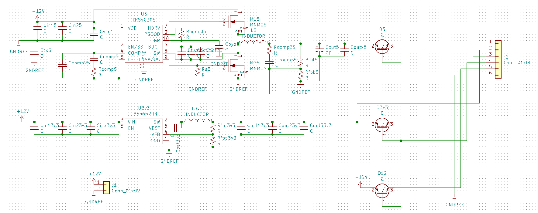

I slept on it, and I'm really not happy with the plan to use multiple switching regs in parallel to get the amount of current I need on the 5v line. So... I'm starting over with a controller and a pair of MOSFETs for the 5v line in hopes that what I build is going to be a bit less likely to literally explode in my face.
I've gotten the new schematic thrown together, next up is assigning footprints to everything and laying out the board.

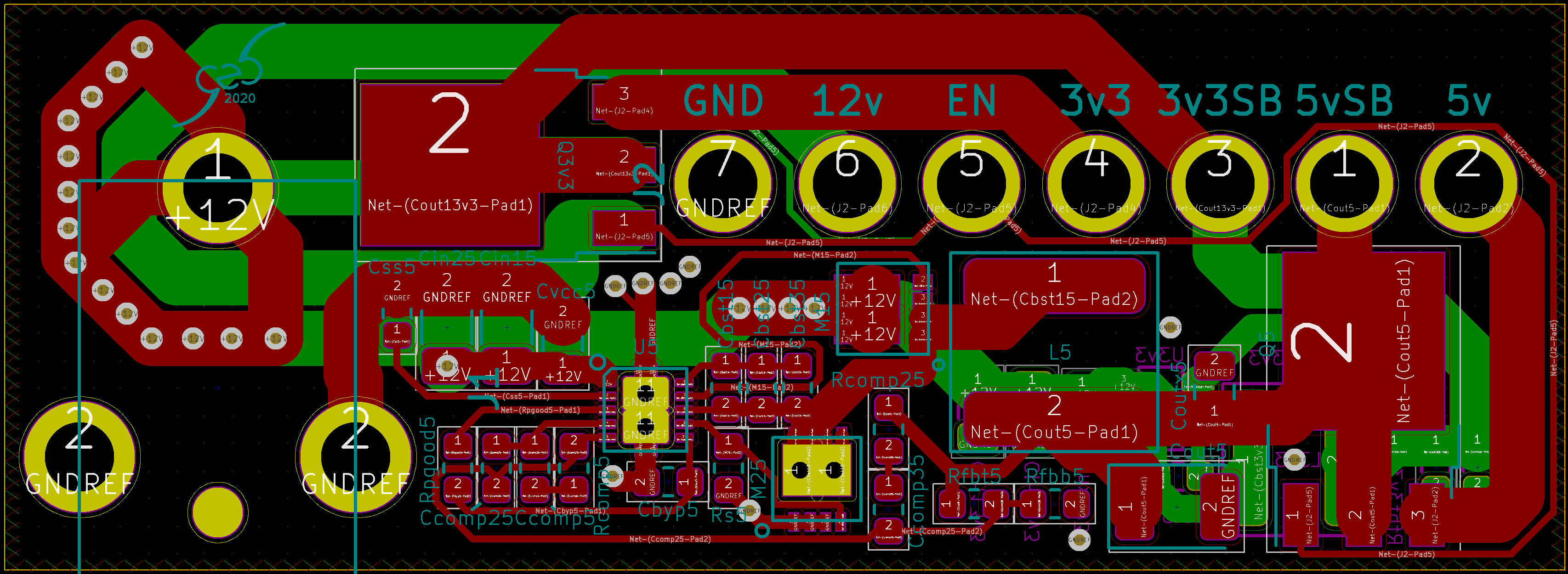

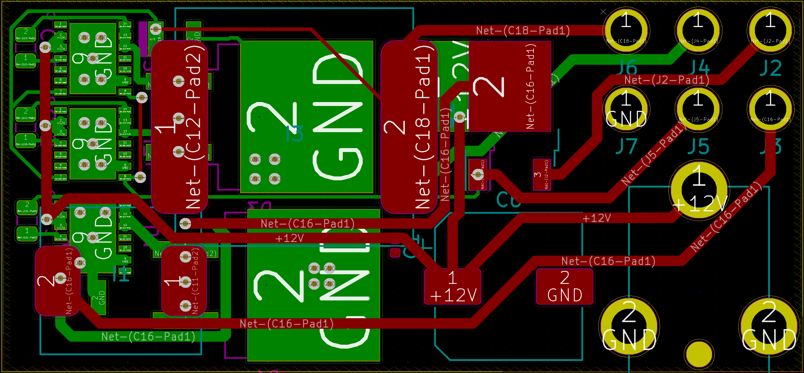

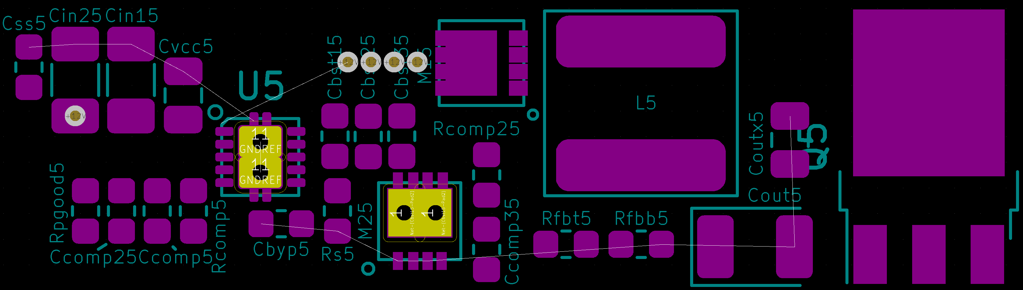

Update: I've gotten the 5v Circuit laid out
11*40mm
Update 2: The whole thing is laid out now.

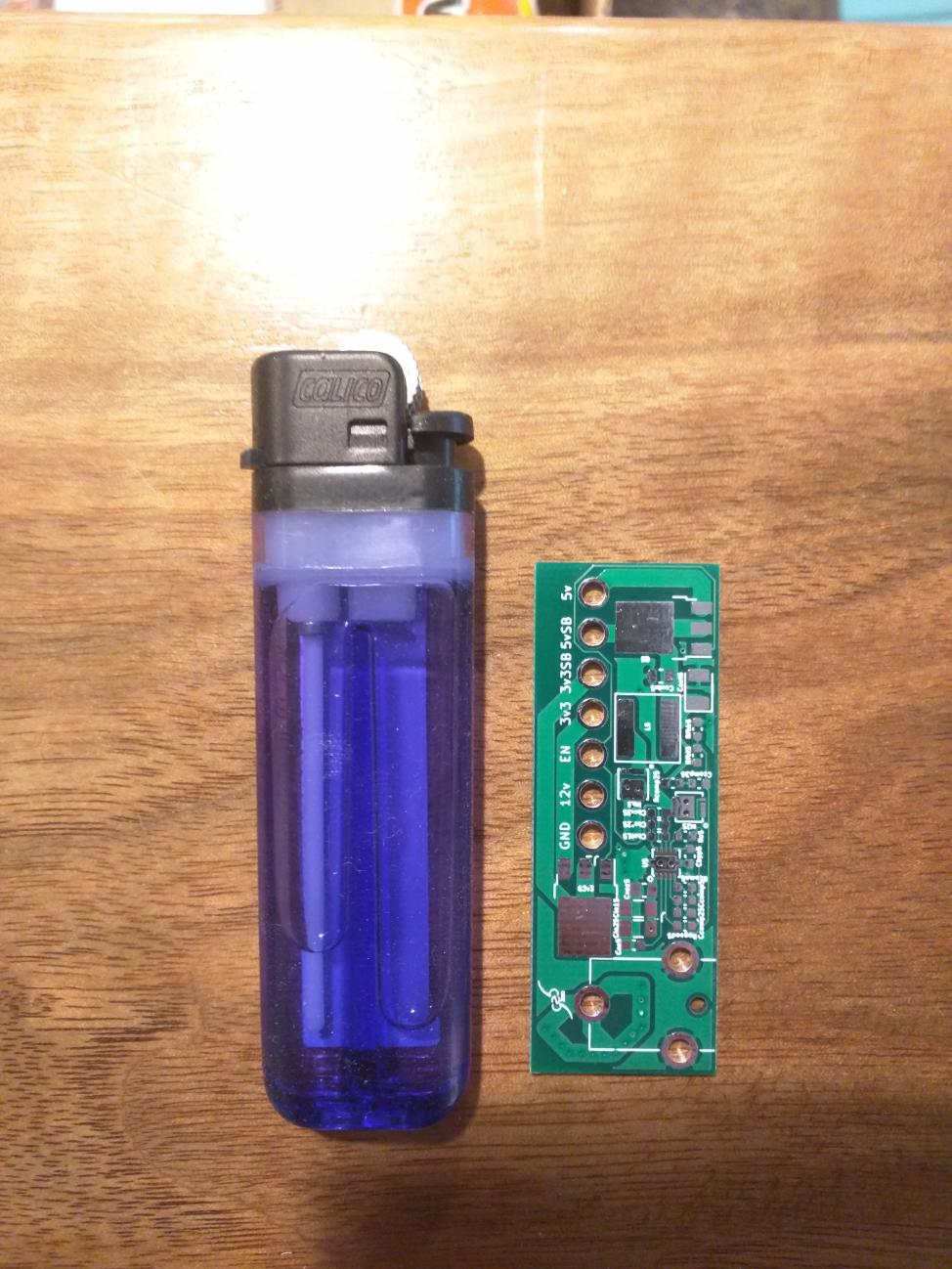

20.5mm*56.5mm, or slightly smaller than the cutout in the xbox motherboard for the fan.
Well, I just ordered everything I need for the first build. $76. I really hope this works.
Future boards will be under $30/each if this design works out, but that's with me assembling them, so there's quite a bit of time involved there.

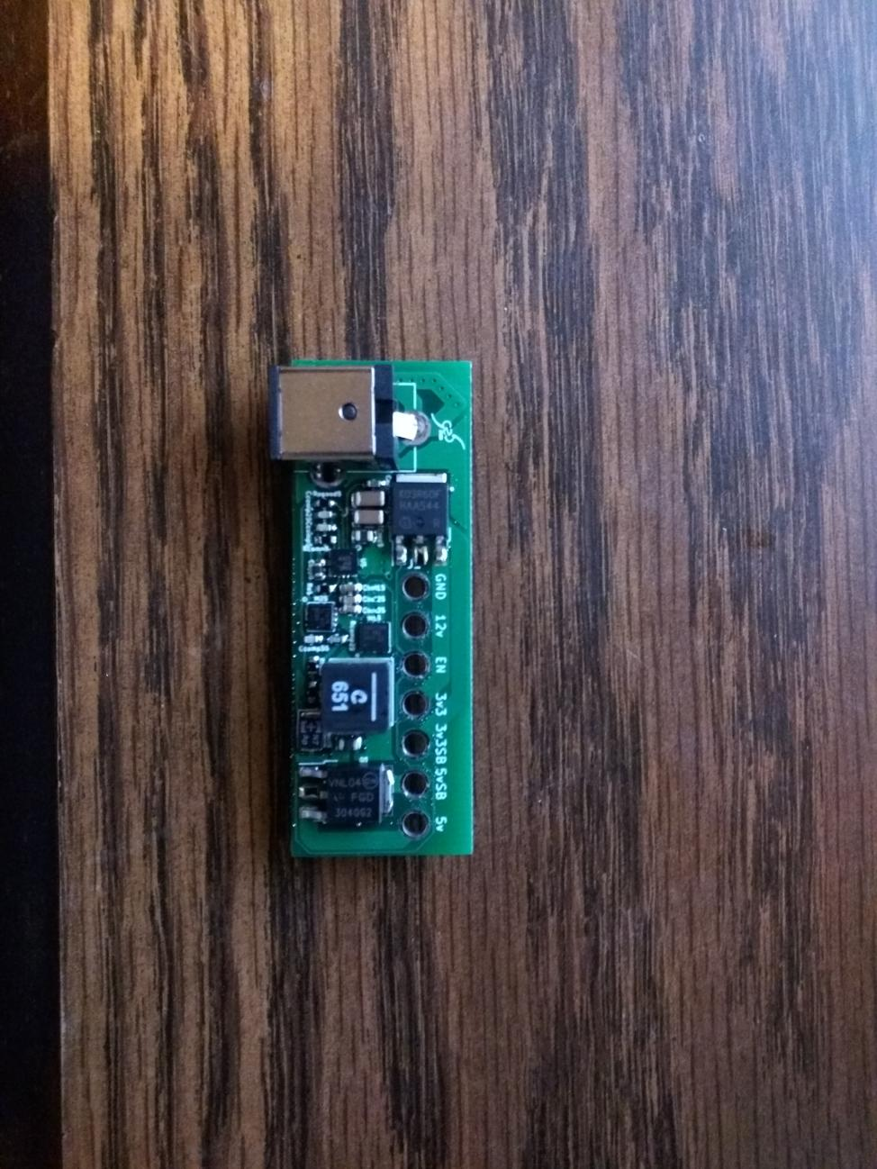

Boards came in today
Assembled and tested, the 3v3 line works as expected, but the 5v line doesn't work at all. I'm assuming it's due to a poorly aligned chip that I didn't notice until after I plugged it in. I re-aligned the chip and the problem got worse. I'm pretty sure that chip is fried.
I also ran into a problem with the power jack, apparently either I read the datasheet wrong, or the datasheet was wrong. Either way, I had to solder a pigtail jack on to get power to the board.
This little things handles 5V@13A ?! I need this so bad!
