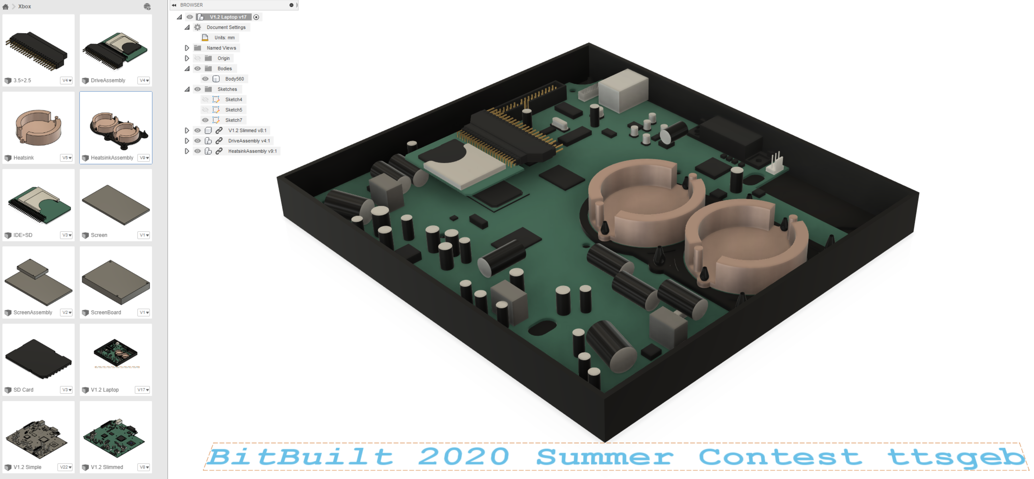

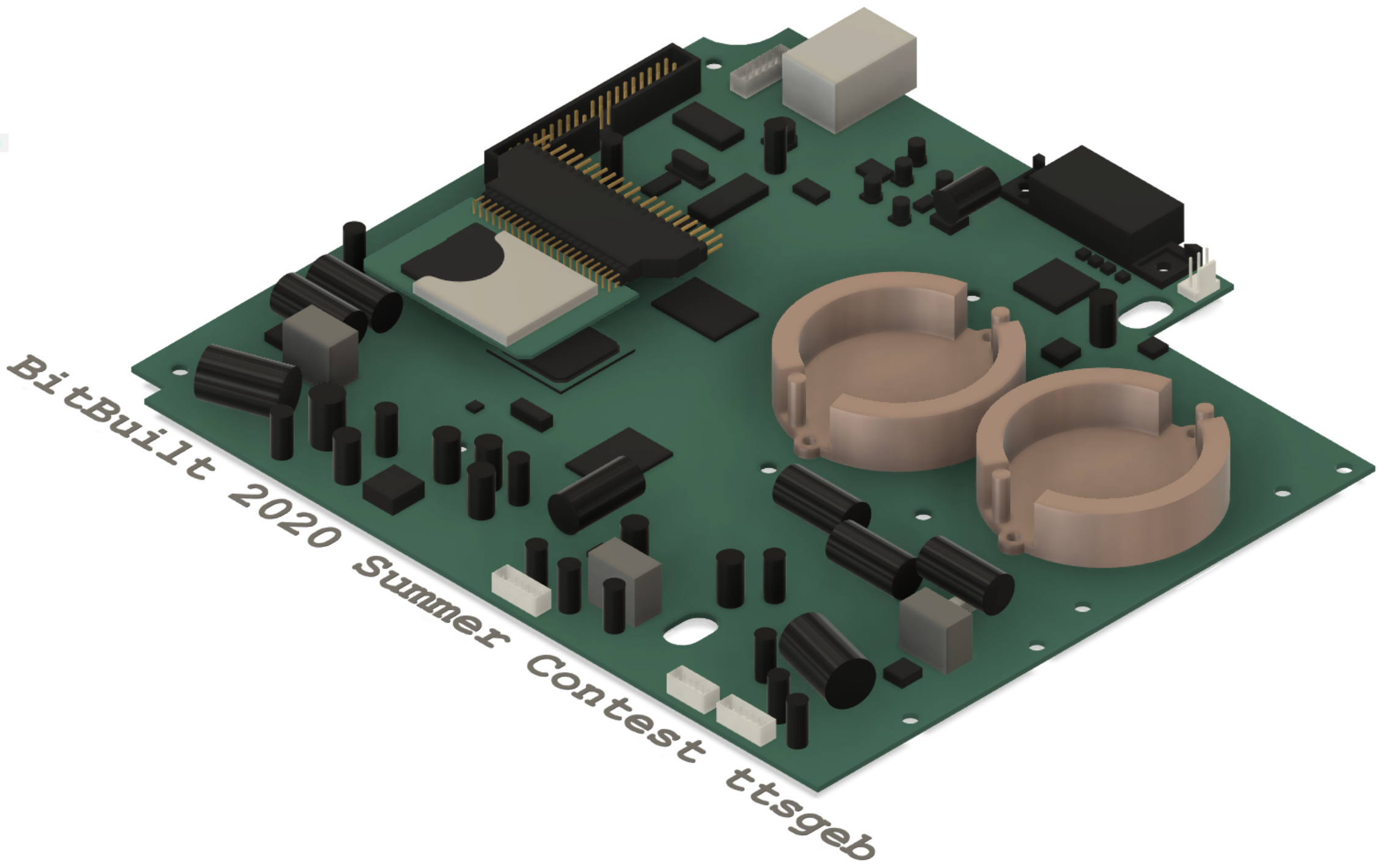

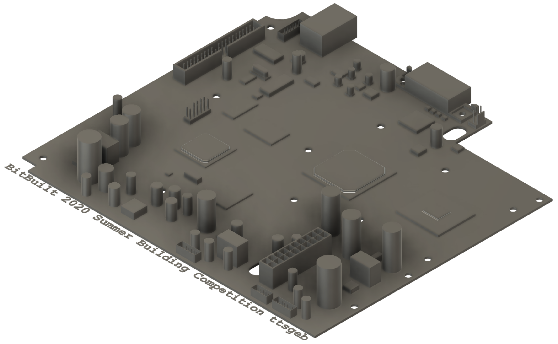

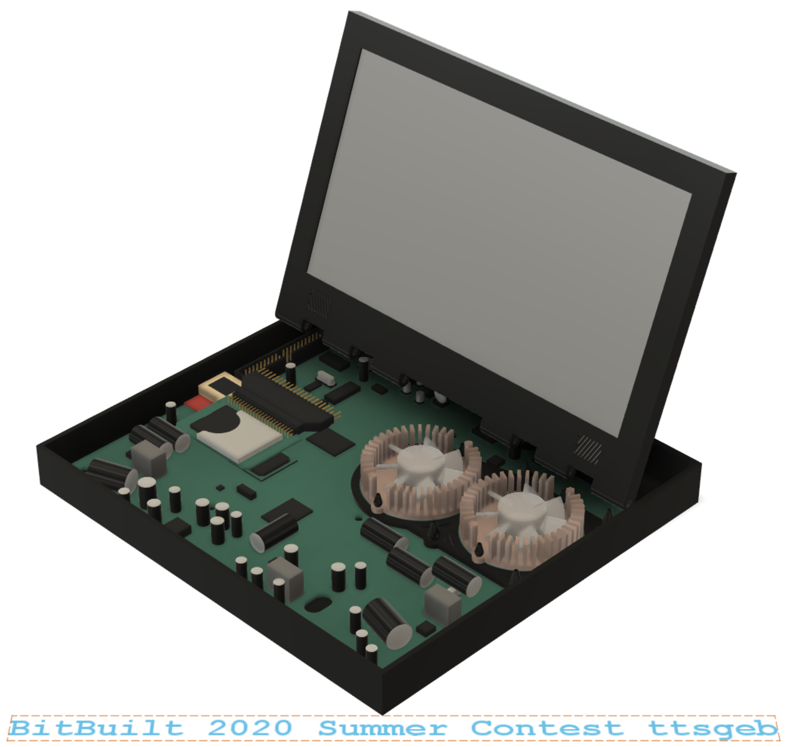

I've taken the time waiting for parts to arrive to casually model the motherboard I'll be using. Once parts get here, a lot of those big caps are going to be replaced with slightly smaller caps on their sides, so I'll have to update the model for that.
https://a360.co/2x7LeSB
It's still missing a lot of the details I want in it, but it should suffice for letting me know what my clearances are for my case design.
I suppose there are more fancy overly detailed CAD models to come as I work through the list of components going into this.

I've been waiting on parts and tools to arrive, so I haven't been able to do much, however I've designed a rudimentary bottom half of a case and a mount for the heatsinks. I've also cleaned up the model a little bit to be a bit easier to work with.

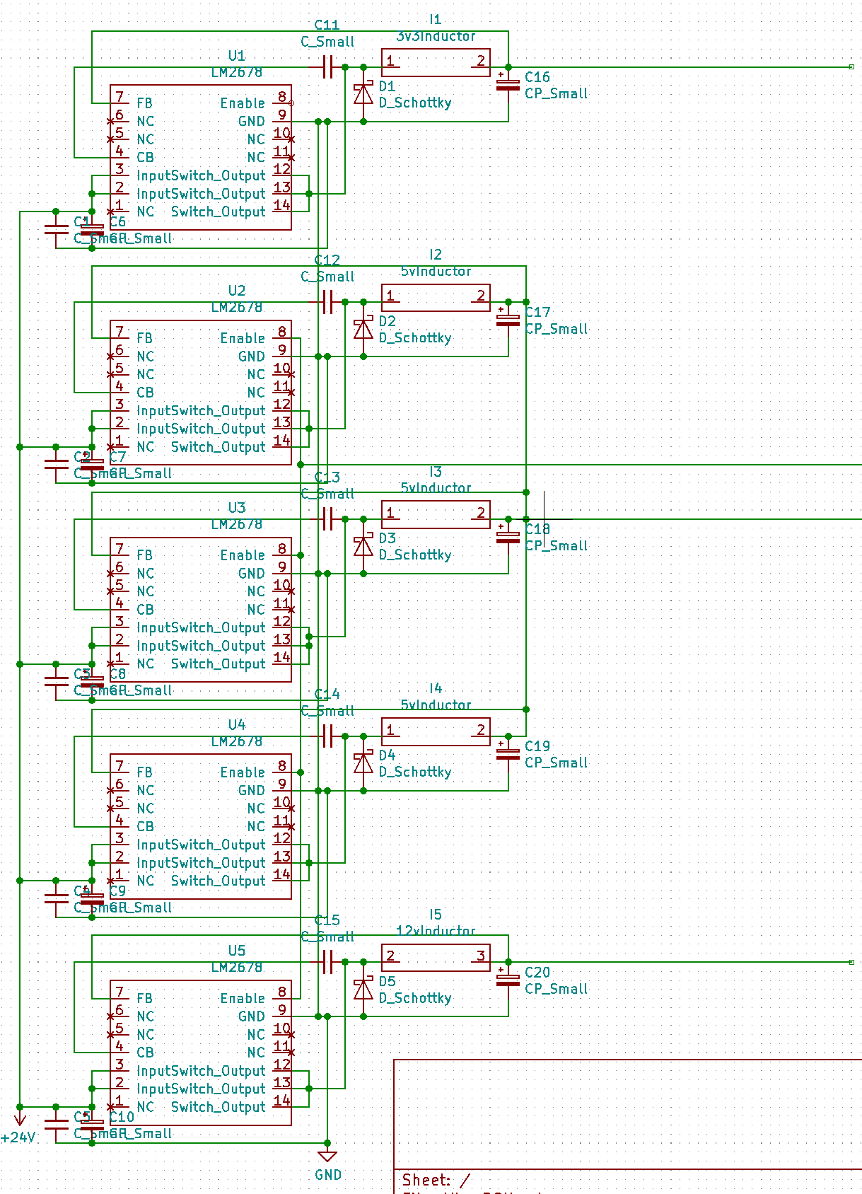

Well, I've ordered a couple of PicoPSUs, one to power this with and one to play with, as that's what everyone uses for the slim xboxen.
However, at the same time, I've taken up the project of designing my own PSU. It looks like it would be twice the size and 5 times the cost, so it's worse in every way... but it's a good project while I wait on parts, and it would be directly compatible with the xbox rather than having to be modified for purpose.
That said, I'm sure there's a dozen ways I could optimize this circuit and I can probably take out one of the regs all together. It's also just good practice, so it's not a lost cause by any means.

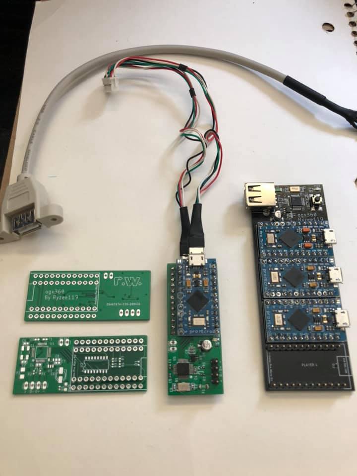

3) It would be awesome to throw in an internal ogx360 in the laptop too! That's up to you, but it would be kickass.

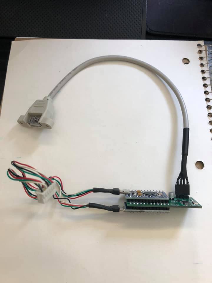

As for the internal ogx360 It's not difficult at all! To install the ogx360 internally you can splice a micro usb cable from each of the arduino's on the ogx360 board directly to the controller wires inside the Xbox. Ryzee119 has actually made a small PCB that allows for keeping both the ogx360 and the original controller ports together. If you plug in the wired controller it takes priority over the ogx360 controller. I am not sure the gerbers for this bboard have been released so maybe you'll want to contact him. Please see images attached.

Just a little CAD update: I've roughed out the front side of the screen enclosure and the top half of the hinge. Starting to get a bit better of an idea of how this thing is gonna look. Screen should be arriving Monday so that I can verify my measurements.

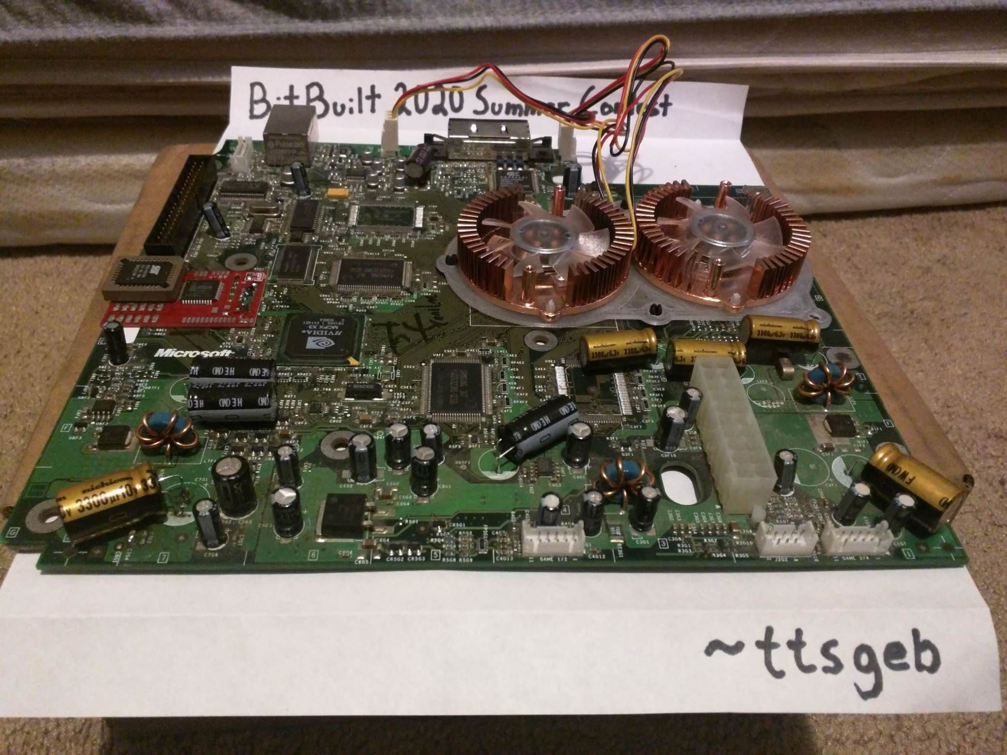

Cable management isn't final by any means, but my 3d printer came in the other day, so I've been able to move forward with this project a bit more. It's looking like xboxDVI isn't going to be ready in time for the contest, so I'm going to go ahead and install the VGA bios on this board and try to get that set up. Outside of that, it's sorting out my power supply, waiting on the uAmp to show up, and a TON more CAD work to reach the goal of 100% mechanical retention/3d printed fasteners for this project.
