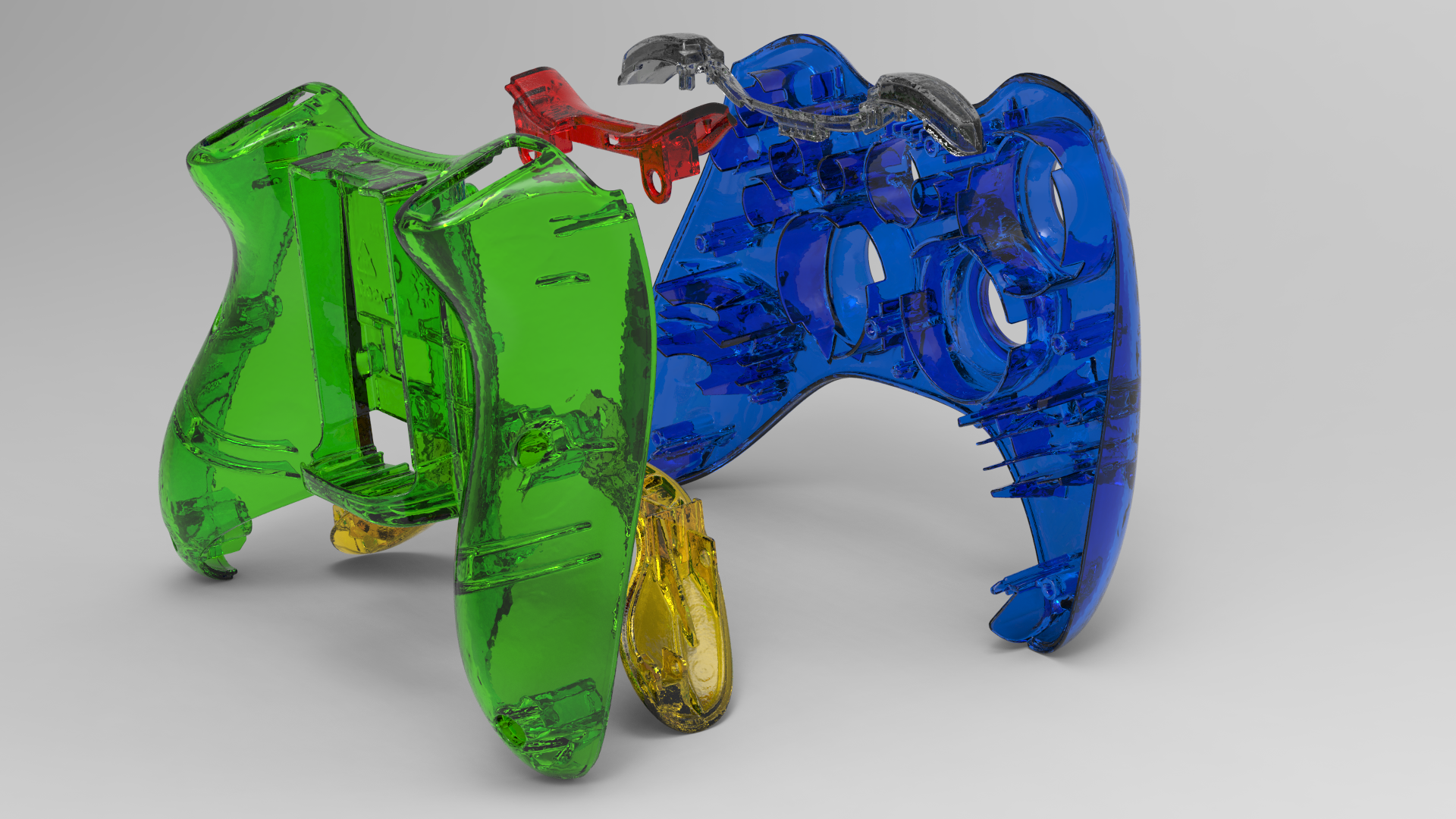

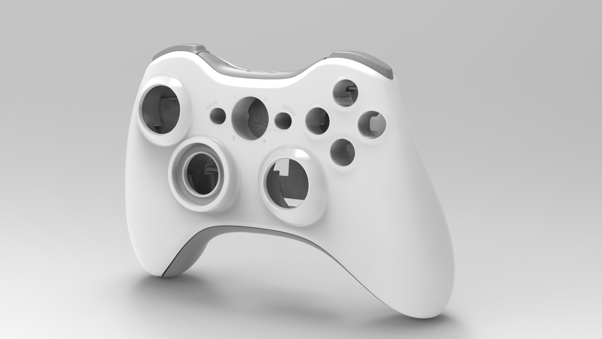

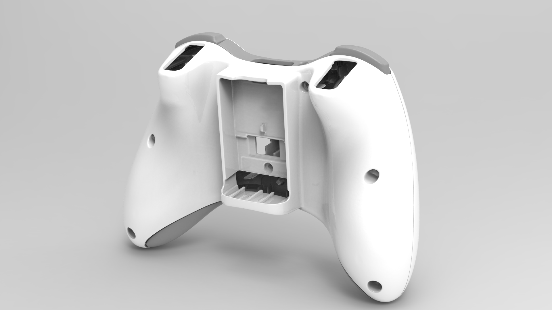

Xbox 360 Wireless Controller Scan
Contains:
Xbox 360 Wireless Controller Top
Xbox 360 Wireless Controller Bottom
Xbox 360 Wireless Controller Shoulders
Xbox 360 Wireless Controller Shoulder Mount
Xbox 360 Wireless Controller Grip Piece
Specs:
NOTE:
Downloads:
Meshes: Xbox 360 Wireless Controller Scan
Shell requested and paid for by @supertazon
Contains:
View attachment 26032View attachment 26031View attachment 26030
Specs:
NOTE:
Downloads:
