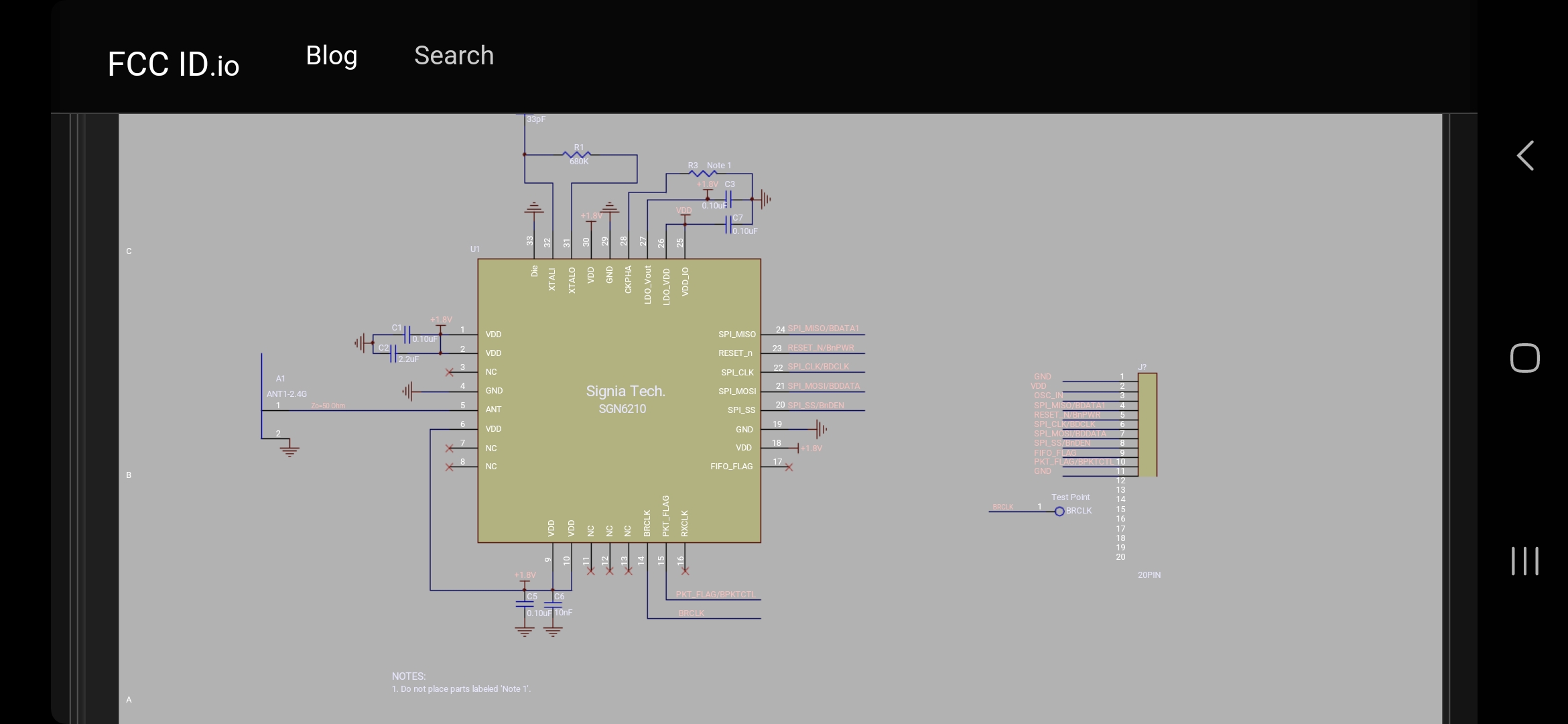

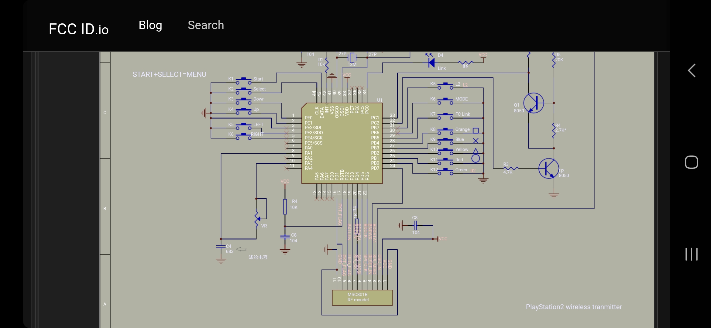

Never Mind!! I just somehow found exactly what I'm looking for!! I'm actually amazed lol
I actually don't know how I even found this lol, but these are the diagrams for the ps2 wireless guitar hero guitars. once I get my guitars, I'm gonna see what I can figure out! And I'll post my findings!
