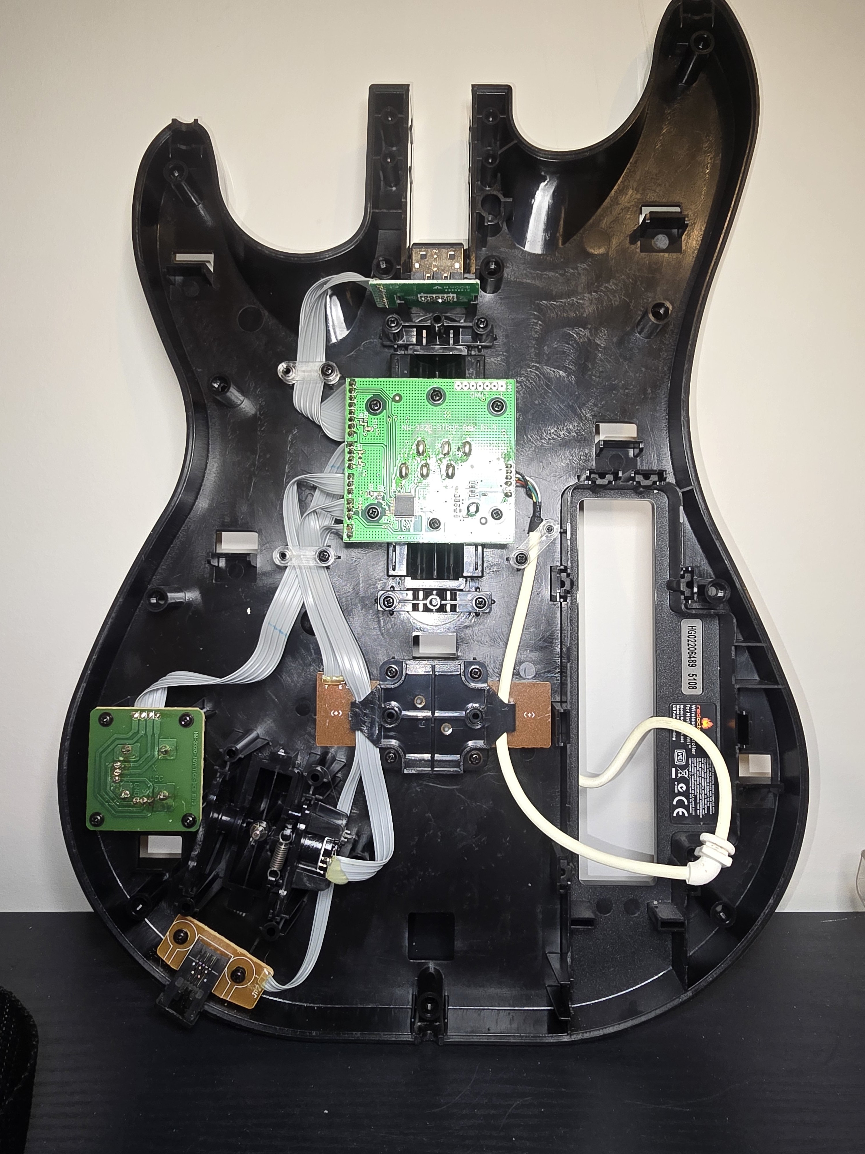

Got the guitar and before doing anything, I peeled it apart to see exactly what kind of constraints I'm working with.
Here is a picture of the inside:
So I plan to have the wii mounted around the bottom but I'm going to need to have the same kind of setup as the ashida in terms of "stacking" the wii over the PMS to save space. I plan on removing the "phone jack" as it's useless (fun fact is they were originally going to use that port for a pedal add on but it never came to fruition) and using that space for something, whether it be the PD board or one of the custom PCB's for the ports and switches. I still need to reference a few things to get dimensions to test out some configurations. I also concluded that 2 batteries beside each other will definitely fit in the top right corner of the guitar, and 2 more should fit in the top left corner however they will have to be positioned oddly, but whatever works right lol

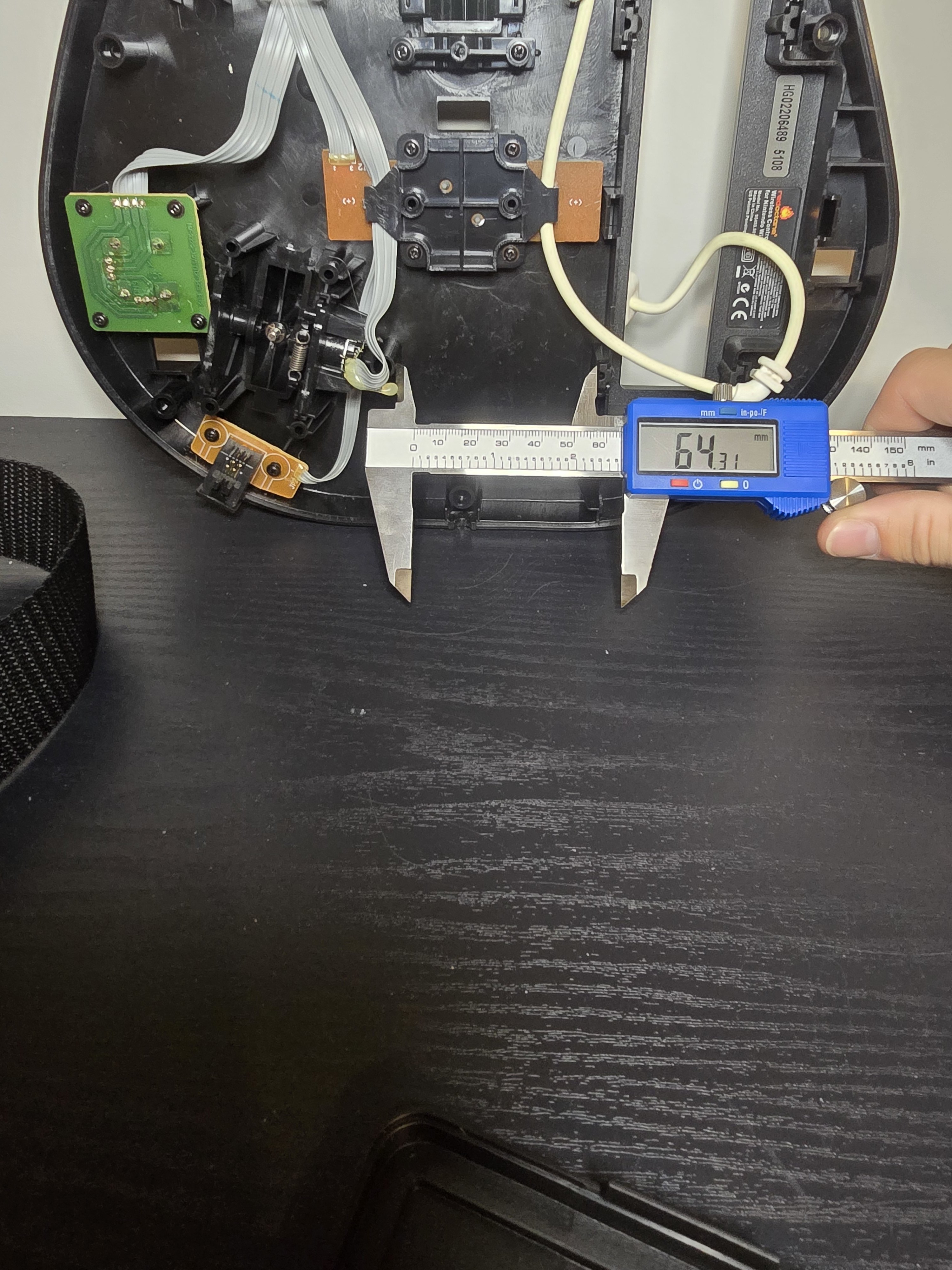

I measured my most narrow point in the case and realized I may need to do a sort of omega trim as I only have 64.5mm max to work with but I'll confirm what I'm going to do after referencing the compendium etc.

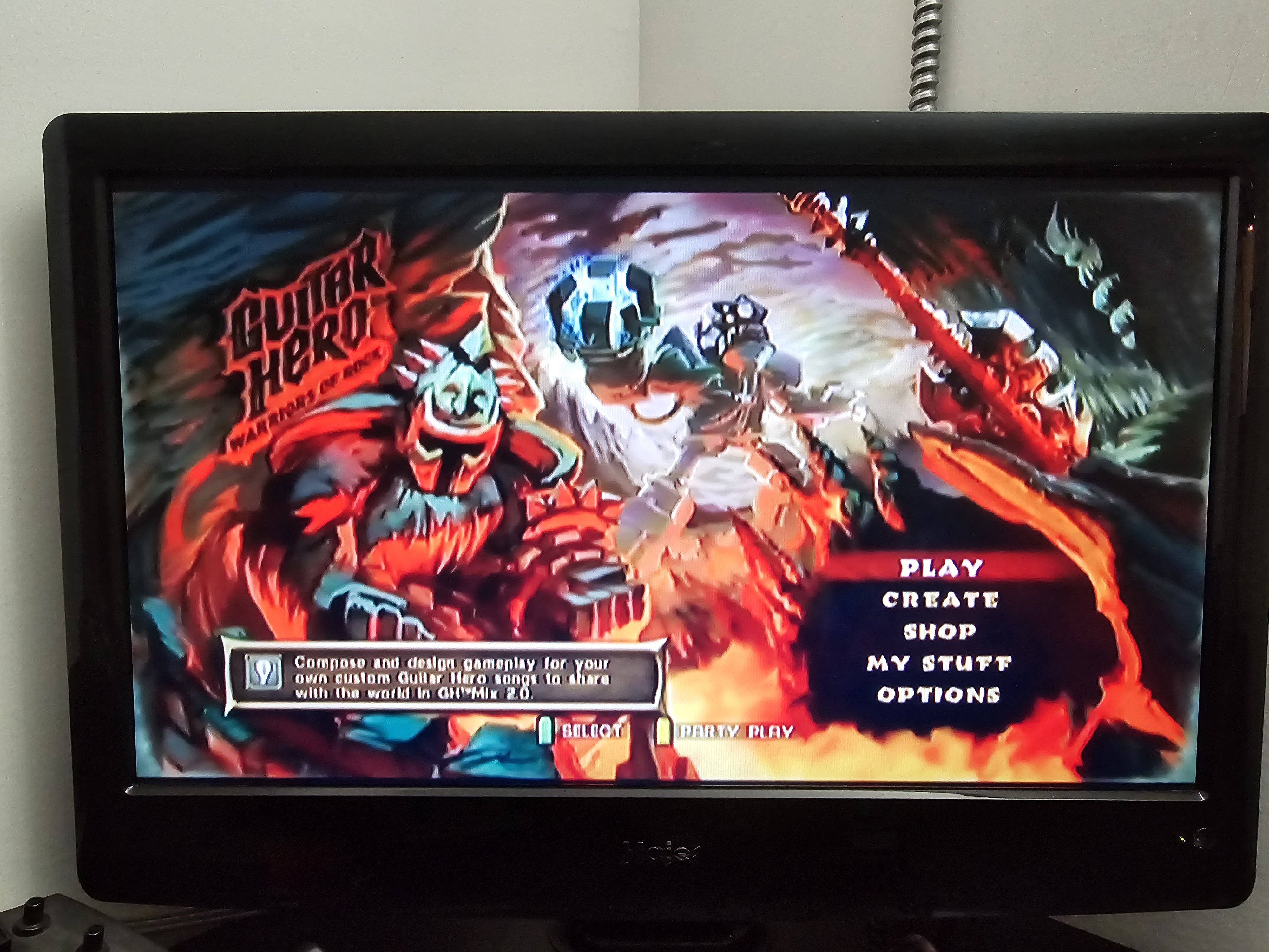

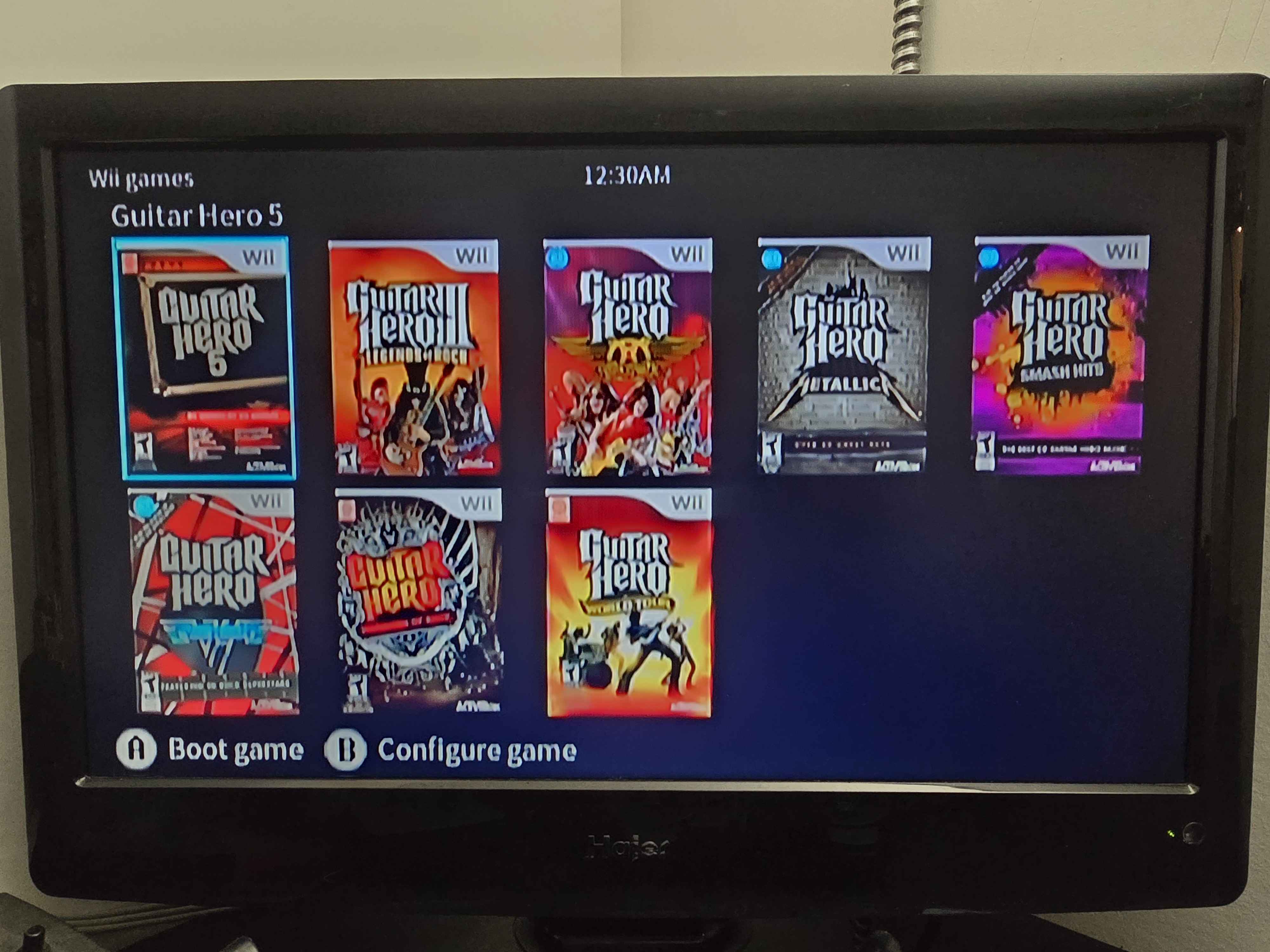

Software update!
So I managed to get all Guitar Hero games installed onto the wii!
I haven't tested all of them extensively however I'm happy to report that they do work! And I was lucky enough to have them all just barely fit onto a 32GB SD card.
I made sure to test GH Metallica and GH Warriors of Rock first as those games were the ones I've seen people have issues with due to mic support etc. But RVLoader is king and just loads them right out of the gate! The only issue I had was GH Metallica would not save when the "USB Saves" option was ticked in rvloader so I unchecked it and it saves fine now to the console.
My next steps are installing my nand flex peeling the guitar back open so I can start measuring things and coming up with some prototypes etc. It may be a while until I have another update as life is super busy but I'll do what I can to get something soon!

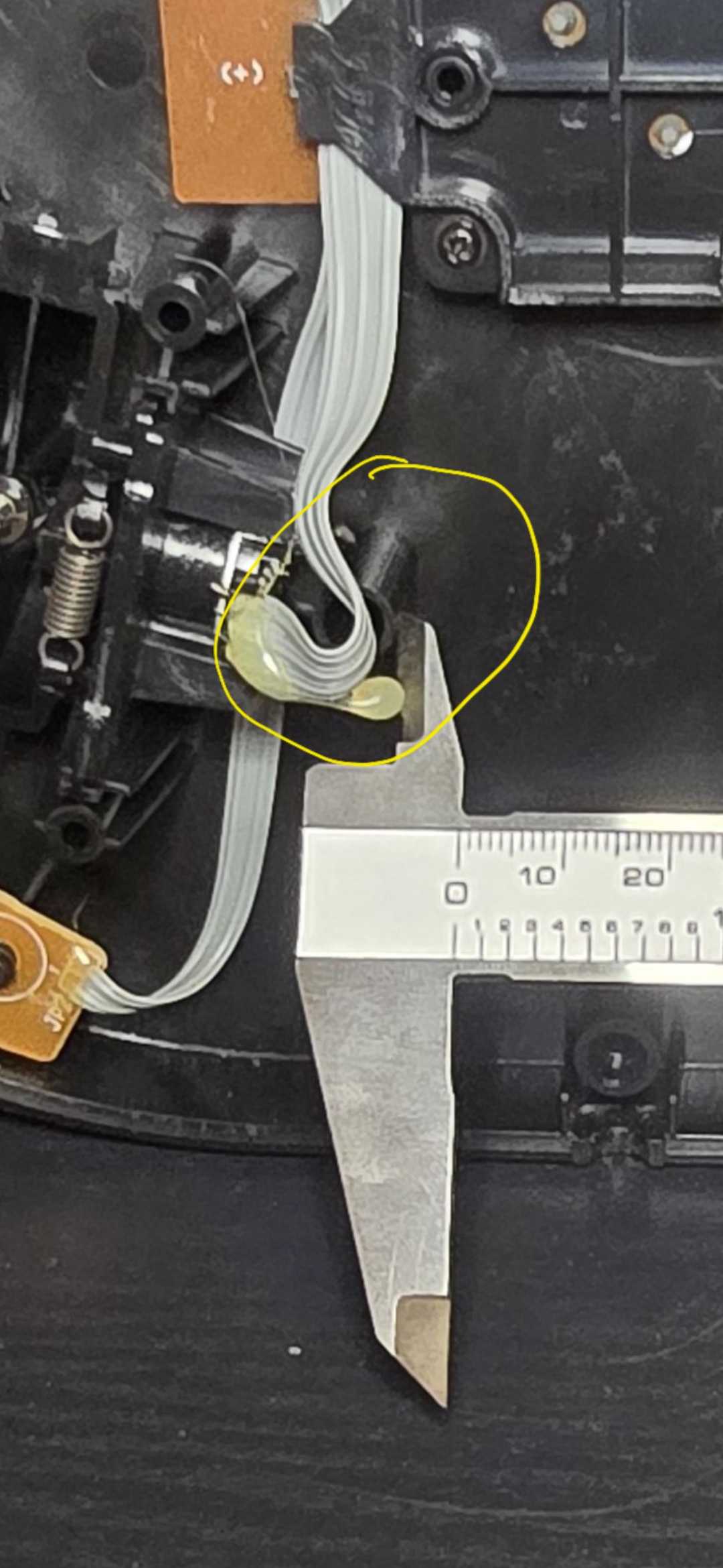

I've been doing some measuring and whatnot and I think everything will work out okay in this build. At first I was concerned about one of the screw posts for the whammy bar (see below)
For some reason my brain was telling me that the wii needed to be directly flat with the faceplate and I was worried I was going to have to trim in a weird way to get it to fit. In these thoughts, I wasn't accounting for the fan and heatsink that need to go under the wii lol. This screw post is 19mm high and the fan and heatsink combo will be at least 20mm (not including the frame it sits on) so that gives me room to set the wii over that screw post thus giving me a lot more space to work with. I'll still have to relocate the nand to get it to fit but I won't have to do any weird trims. I plan to cut the old ribbon style cable that is wired to the whammy potentiometer and wire it differently so it's out of the way to give me as much space as possible.

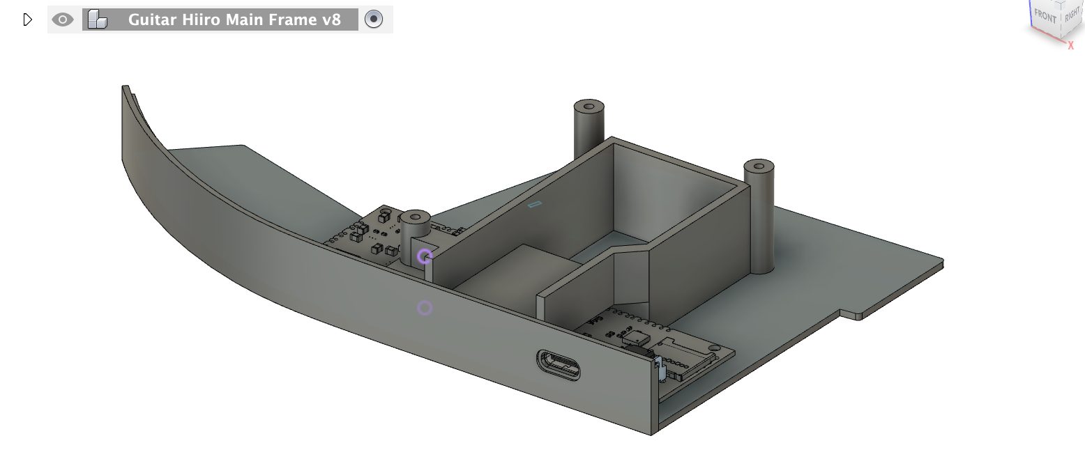

Ive started designing the frame in fusion to use the RVL-PMS as well as the PMS-PD but the design is subject to change in the event that Mjolnir: the thundervolt companion board is released before im done designing everything.
Right now I have the fan and dual heatsink setup as well as the wii mounting holes along with where i plan to place the PD board and USBC port. this setup uses a 5v 30mm fan and heatsink for the GPU and a 25mm heatsink for the CPU. Ive found that in order to fit everything as well as still have a custom PCB wrap around the fan and heatsinks, Im going to need to suspend my wii mounting screw posts and mount them to the actual fan/ heatsink support. Ive also figured out that by the way I have the PMS-PD tucked under the 25mm heatsink, im going to need to split my custom PCB into 2 boards as I cant fit one whole board over the screw posts and have it tuck under the heatsink, so I think im going to have to use an FFC cable as well as something a little more bulky like a molex connector for the CHRG and GND etc. but ill see how everything works as I go.

Also as much as I wanted to keep this whole frame on the top face of the guitar to prevent having to cut a whole bunch of the guitar up and potentially make mistakes, ive realized that im going to need to cut a small portion of the bottom plate of the guitar to make room for my fan vent, but it is what it is.
