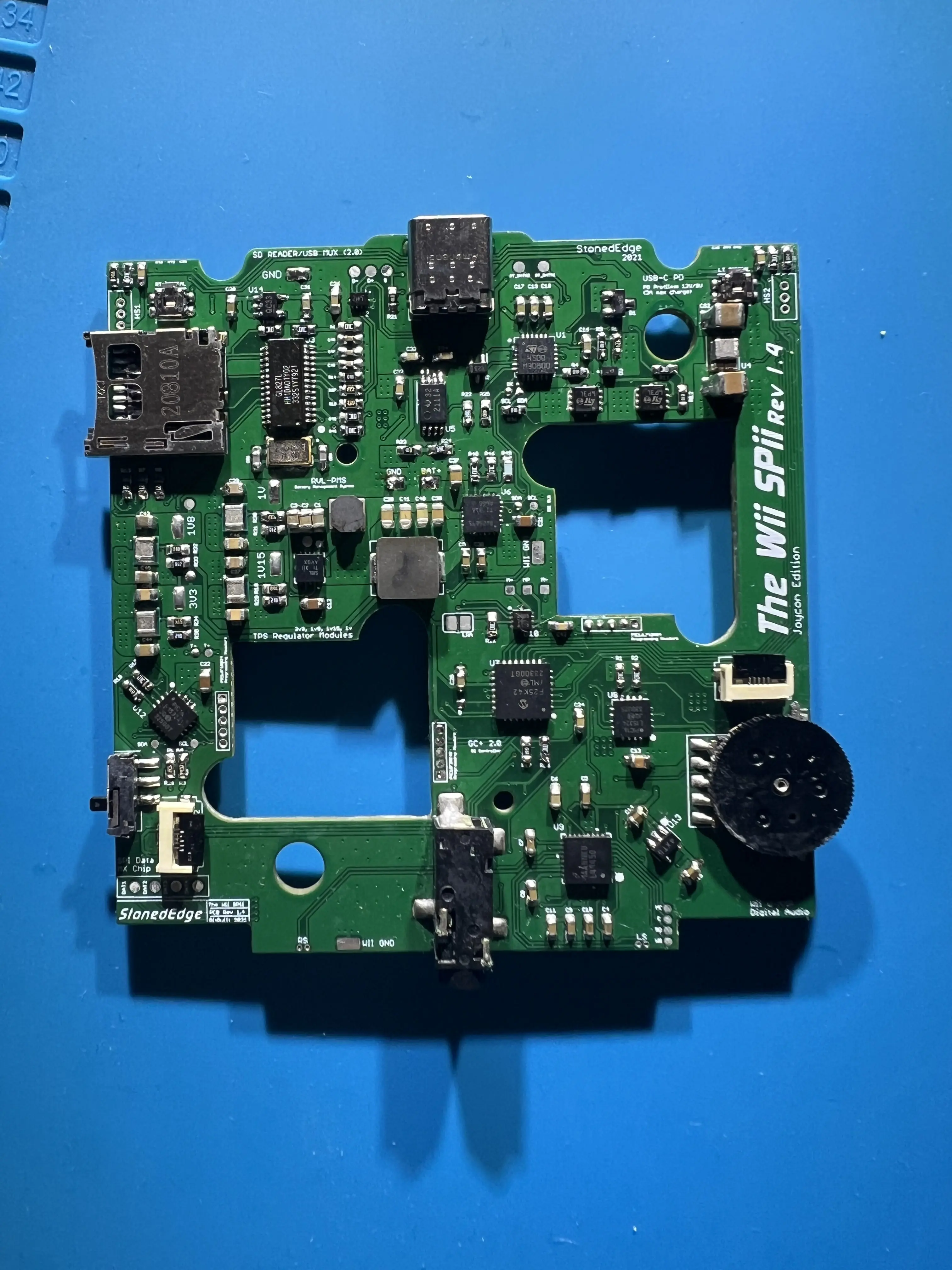

Hello All,
This year I decided to make my attempt at building StonedEdge's WiiSPii since I've had the PCBs for over a year just lying around on my desk staring at me. Around the time I purchased the PCBs I also ordered what was in stock from the BOM that he linked when he open sourced his build. When I went to attempt this build I realized I was missing a ton of parts, so a little over a month ago I scoured through his BOM, rev1.4_front/back.txt files to try and determine everything I was missing.
I also looked for any and all pictures I could find of his assembled custom board to use as a reference as the .txt files locations on the PCB didn't match the silkscreen on any of the revisions he had put up on his github. I believe I have managed to recreate the entire assembly as well as program the three PICs on the board using the PICKIT3 and the precompiled code he had in his files.
It is quite a beautiful board

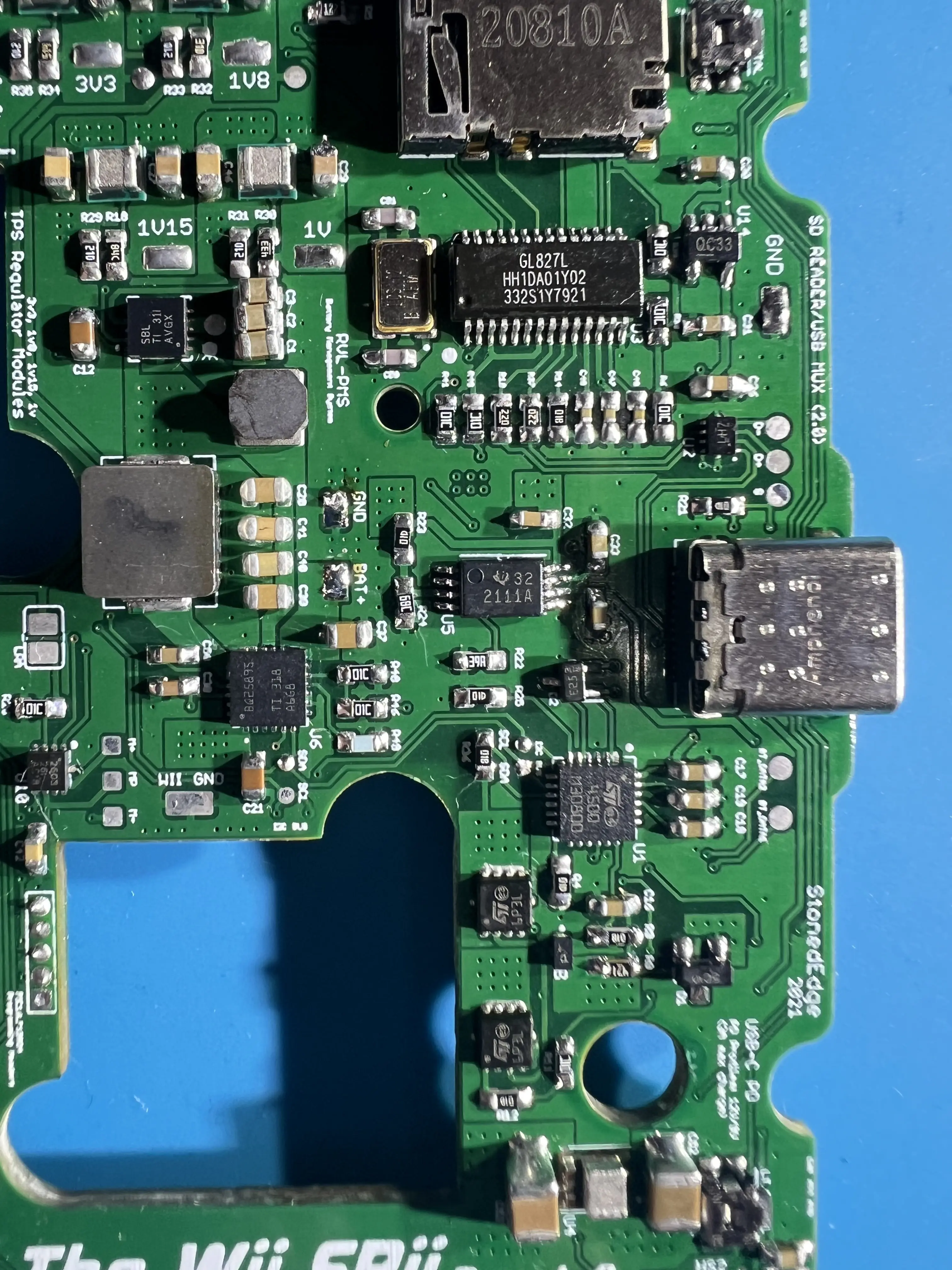

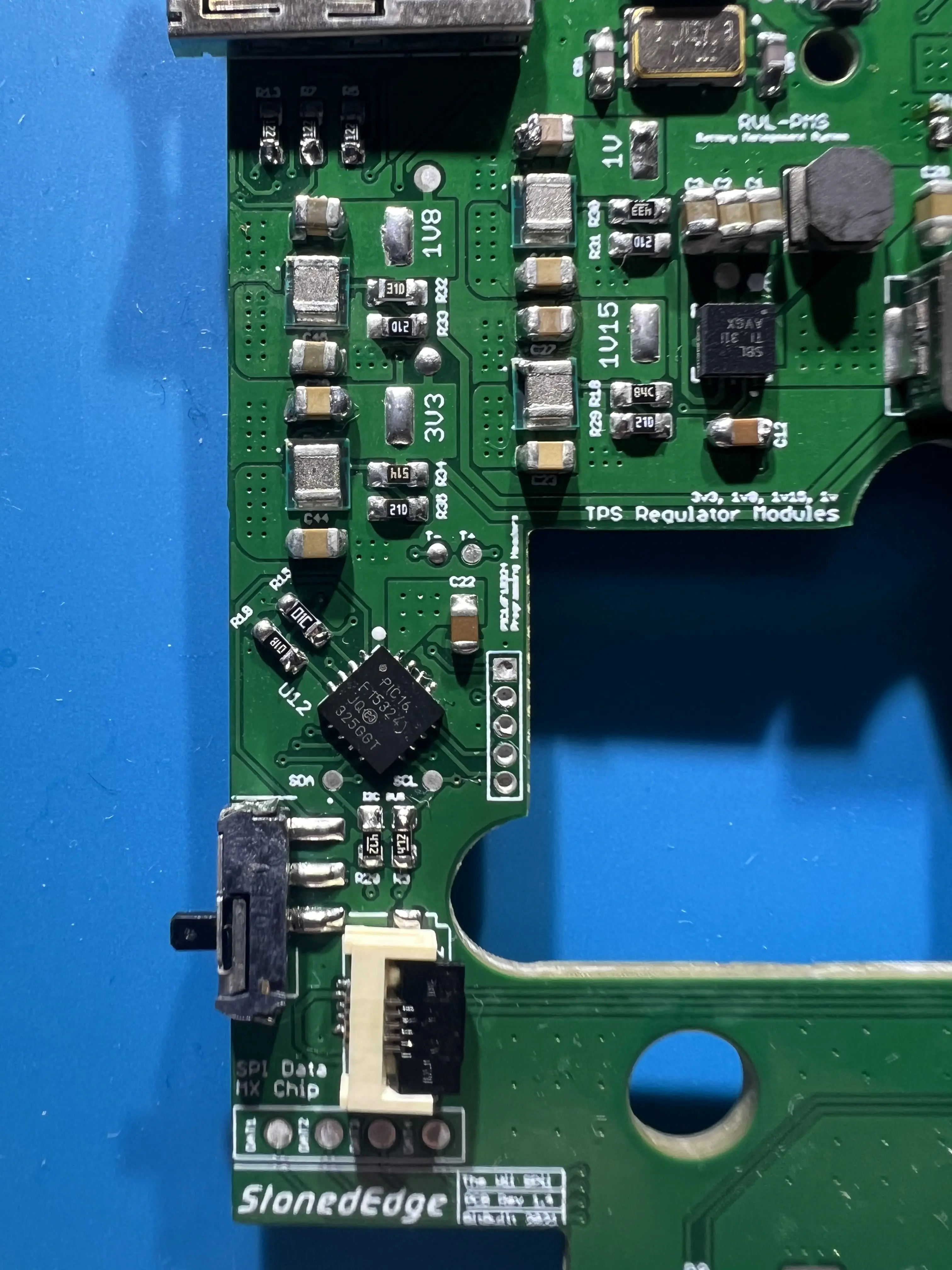

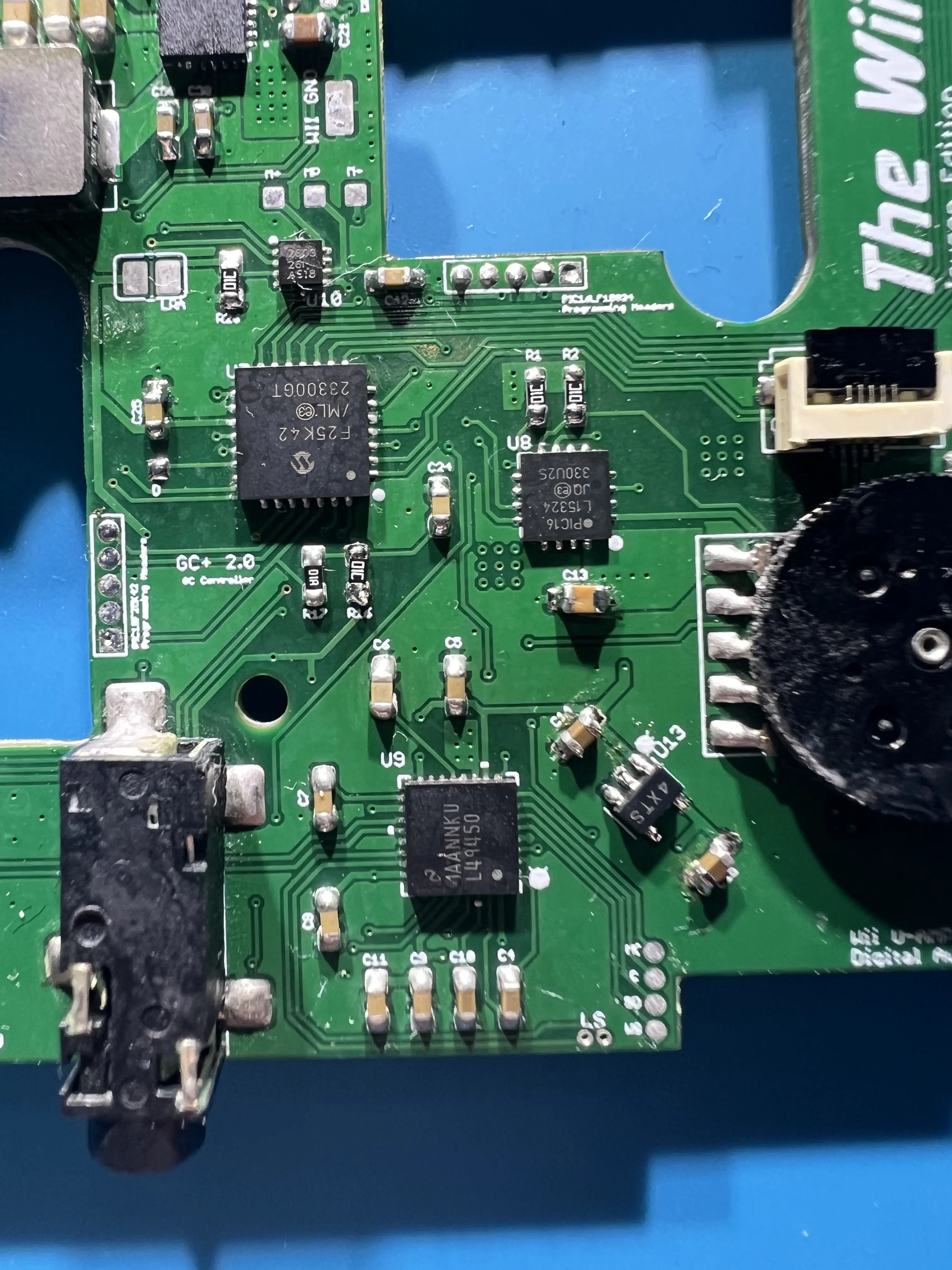

Here are some close ups of the front of the PCB
I have reached a point where I am not sure how to progress, attempting to plug the board into my pc with a usb-a to usb-c cable I can't seem to get the SD card to showup. I also realize this may not necessarily be something that was made possible with this board and have yet to fully determine this.
My next step is to cut down a wii and attempt my first lmao trim, I will likely be going for the V2 of the trim as that seems like it is the most applicable version due to shape and simplicity of the cuts/edges of the board.
If anyone has any tips, pointers or corrections based off my provided photos, I'm all ears!

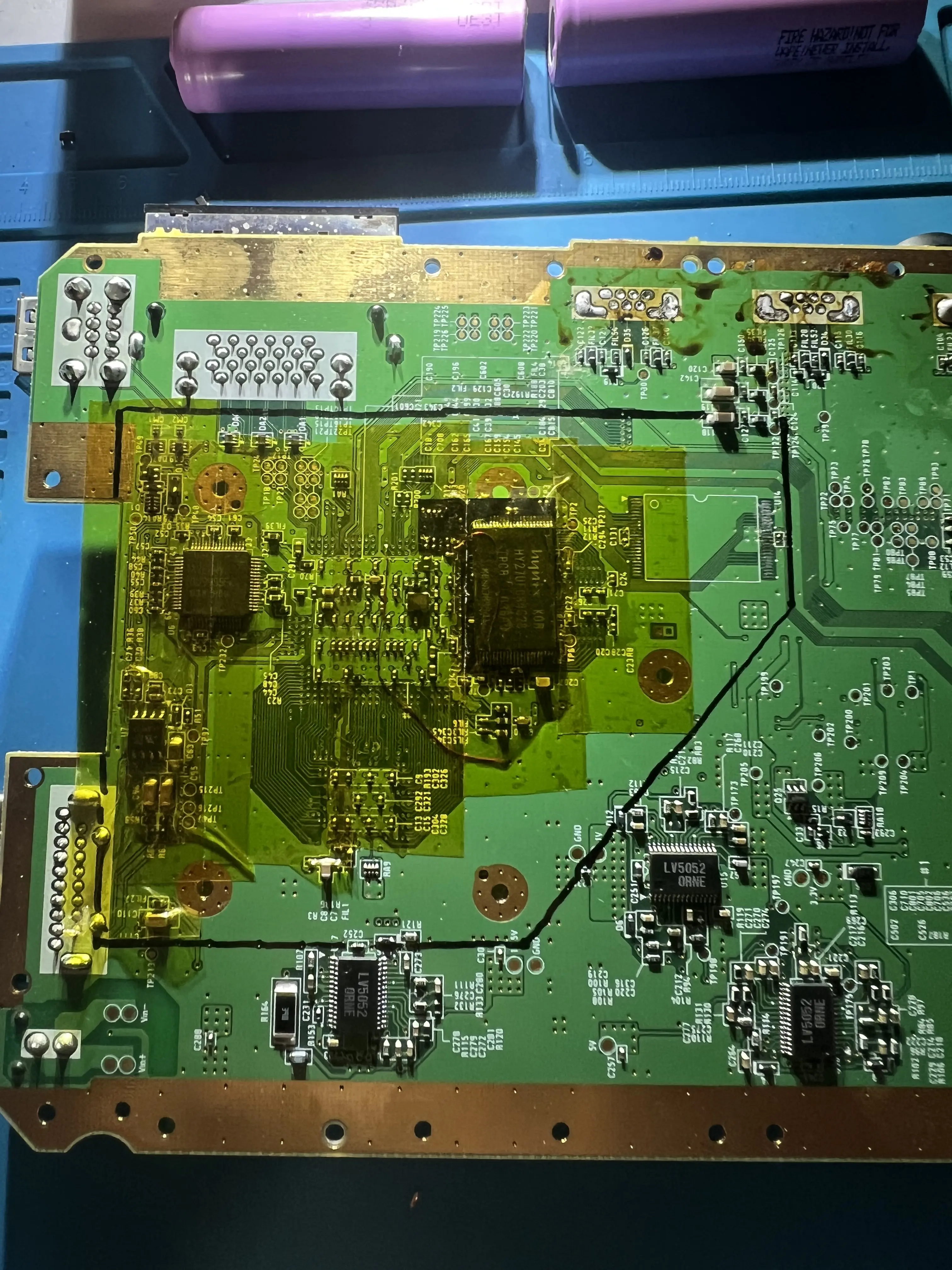

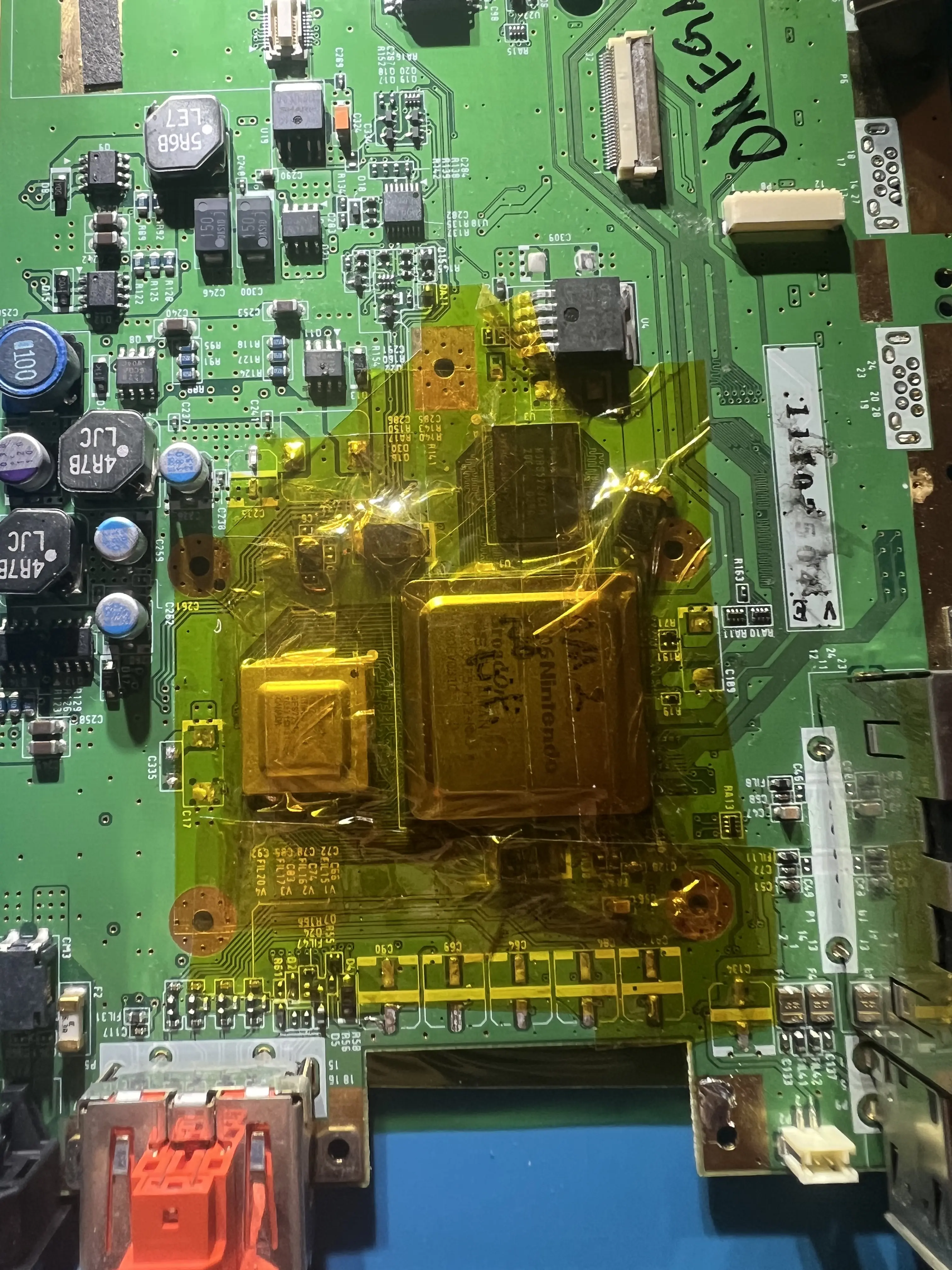

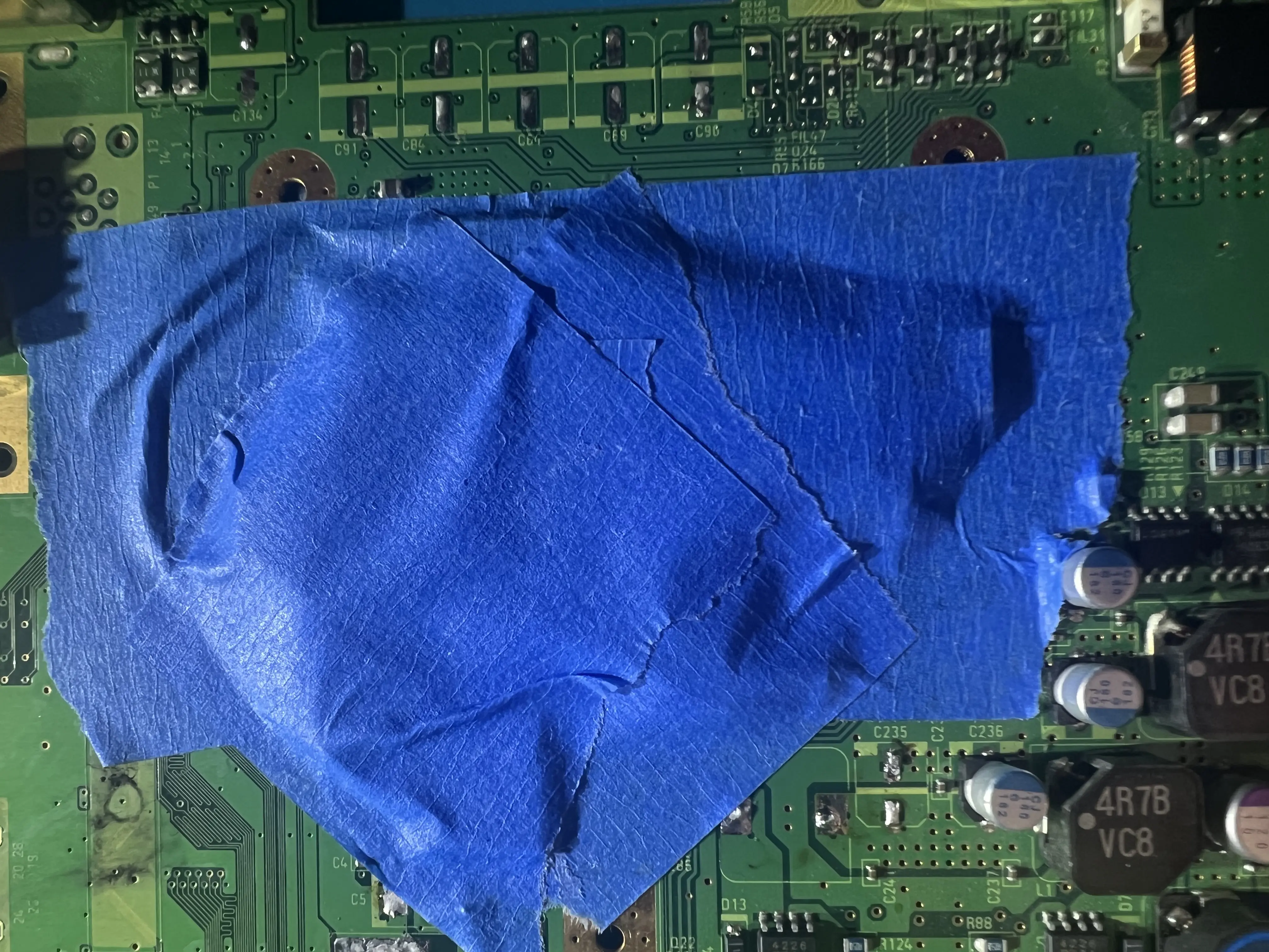

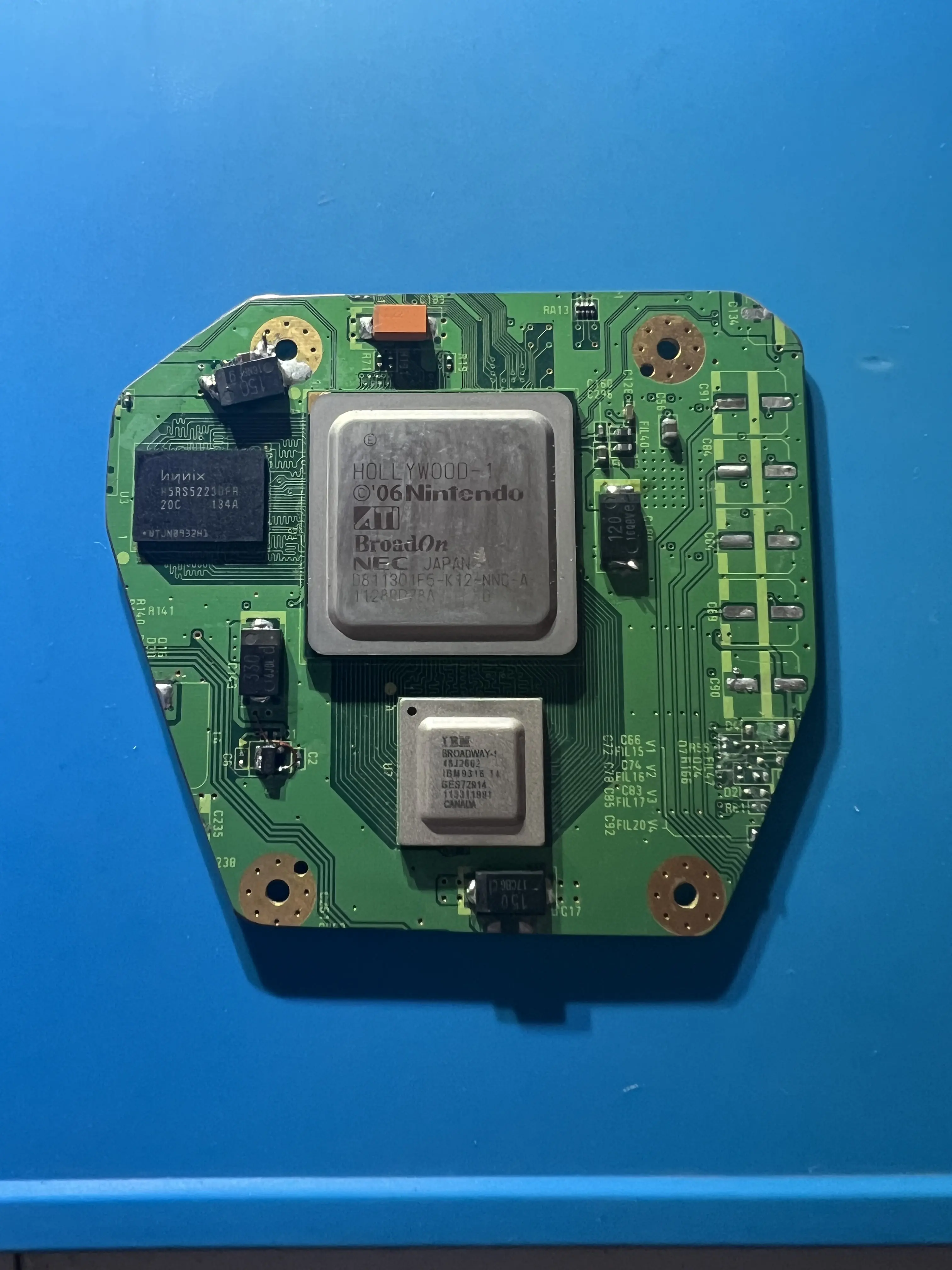

I started on my Wii trim and originally just went straight into the LMAO which was definitely a bad idea in hindsight. I think mostly because when sanding I had removed my tape, which I believe may have allowed things to build up under the the gpu/cpu and thus it wouldn’t boot.IMG_5689.webpIMG_5690.webp

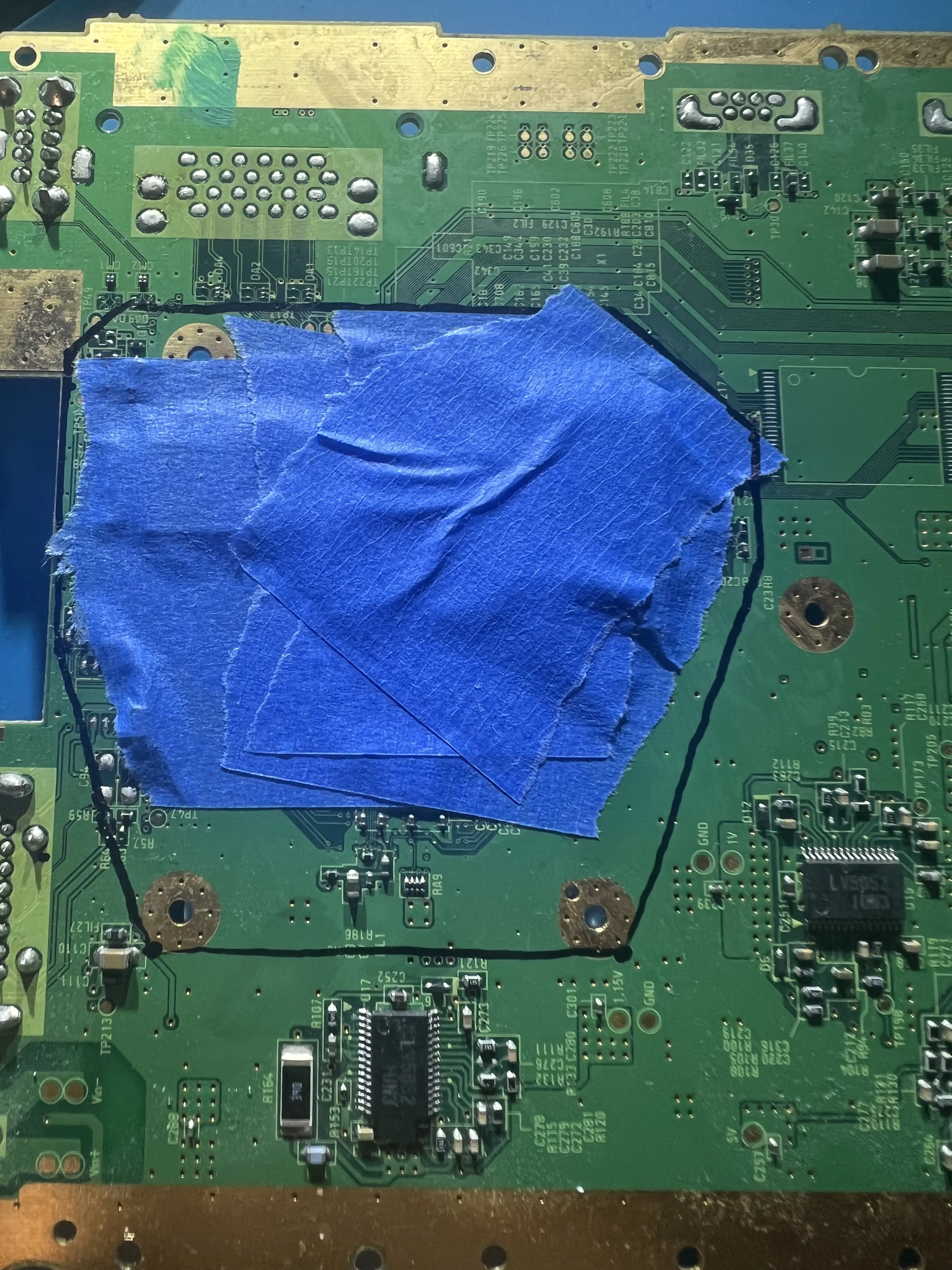

I spent a couple days trying to troubleshoot it and last night I finally decided to give up on it. In taking a break from my first trim, I worked on prepping the new board and verifying all my relocations. Everything was working properly so I outlined a larger OMGWTF on the back for the trim. I also taped the hell out of the front and back of the board.

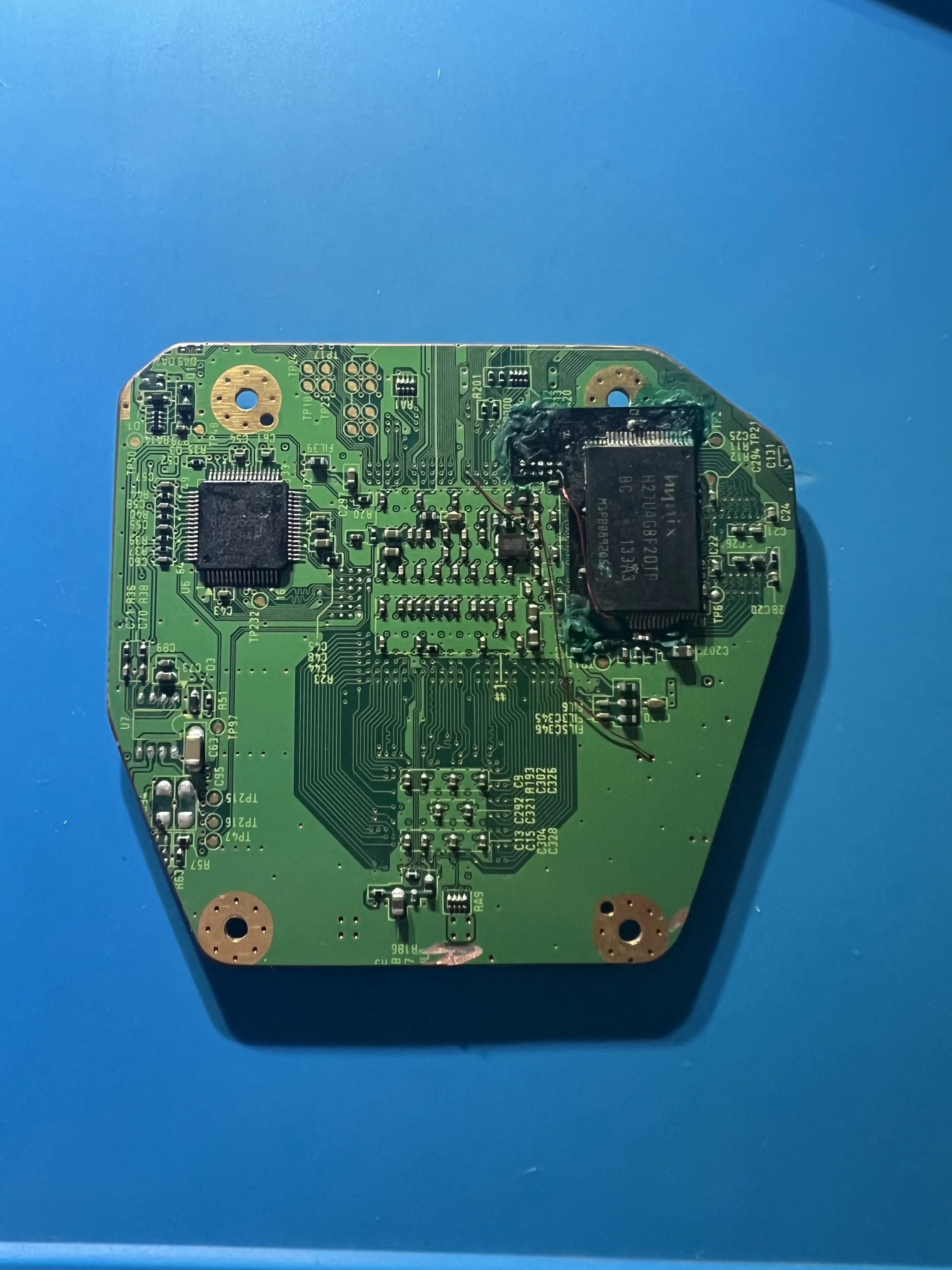

This trim was a success
I marked the back with a slightly larger LMAOv2 trim and taped the hell out of the back and front again, cut sanded and hooked up the WIISPII board and had a successful trim!

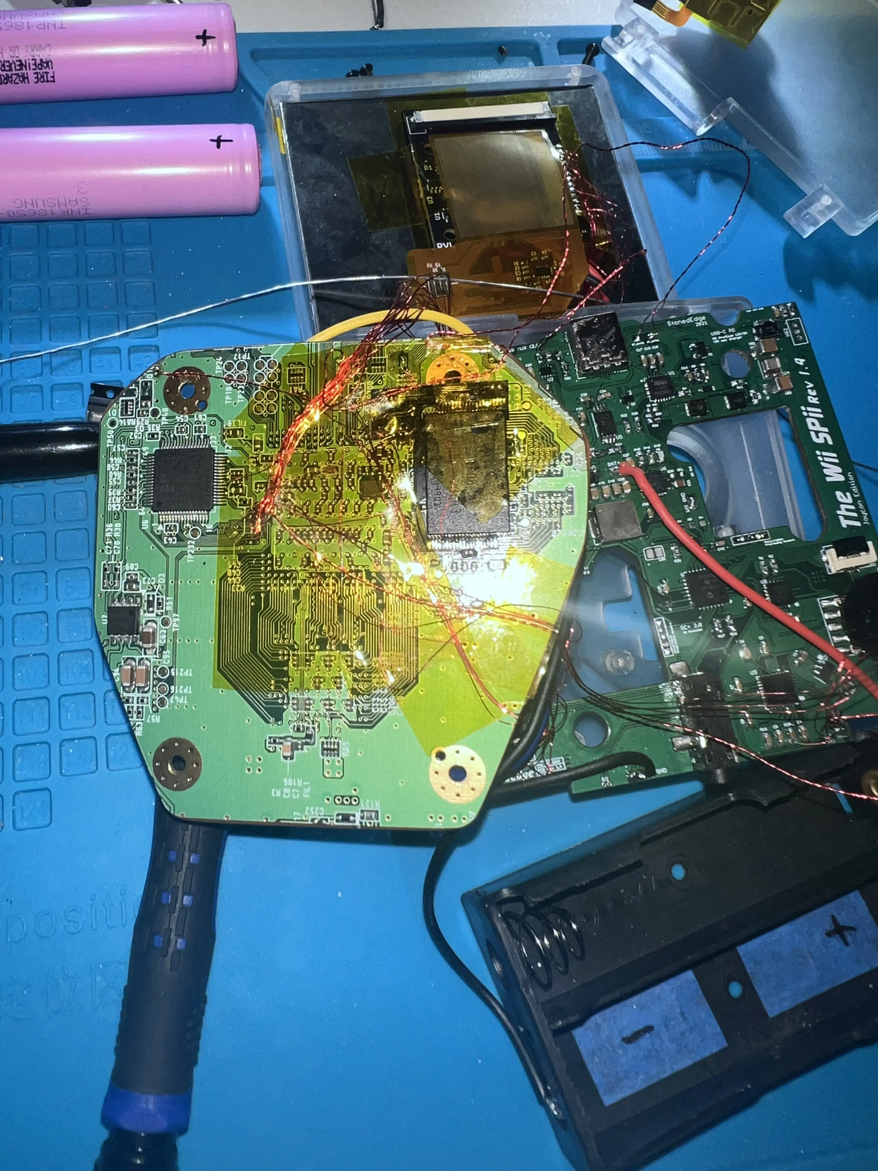

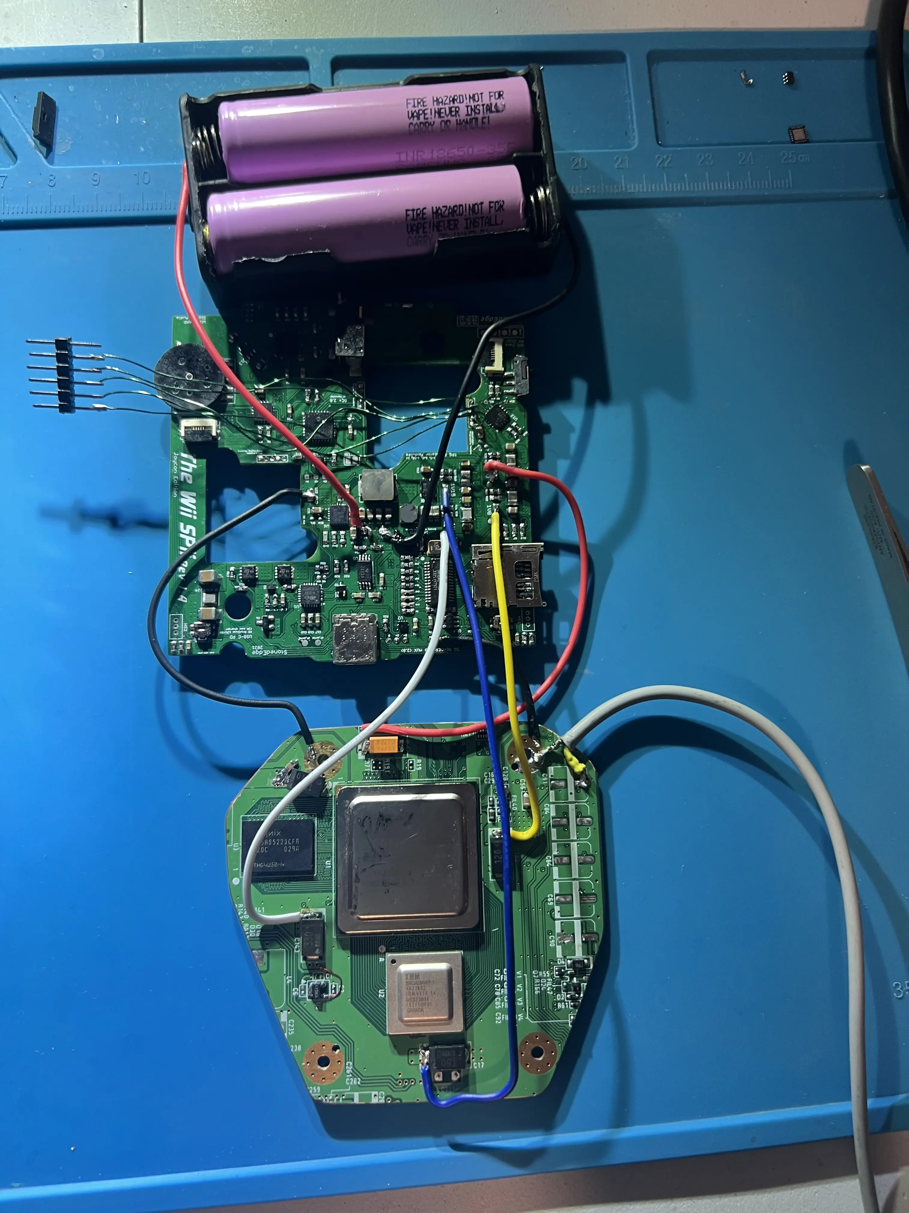

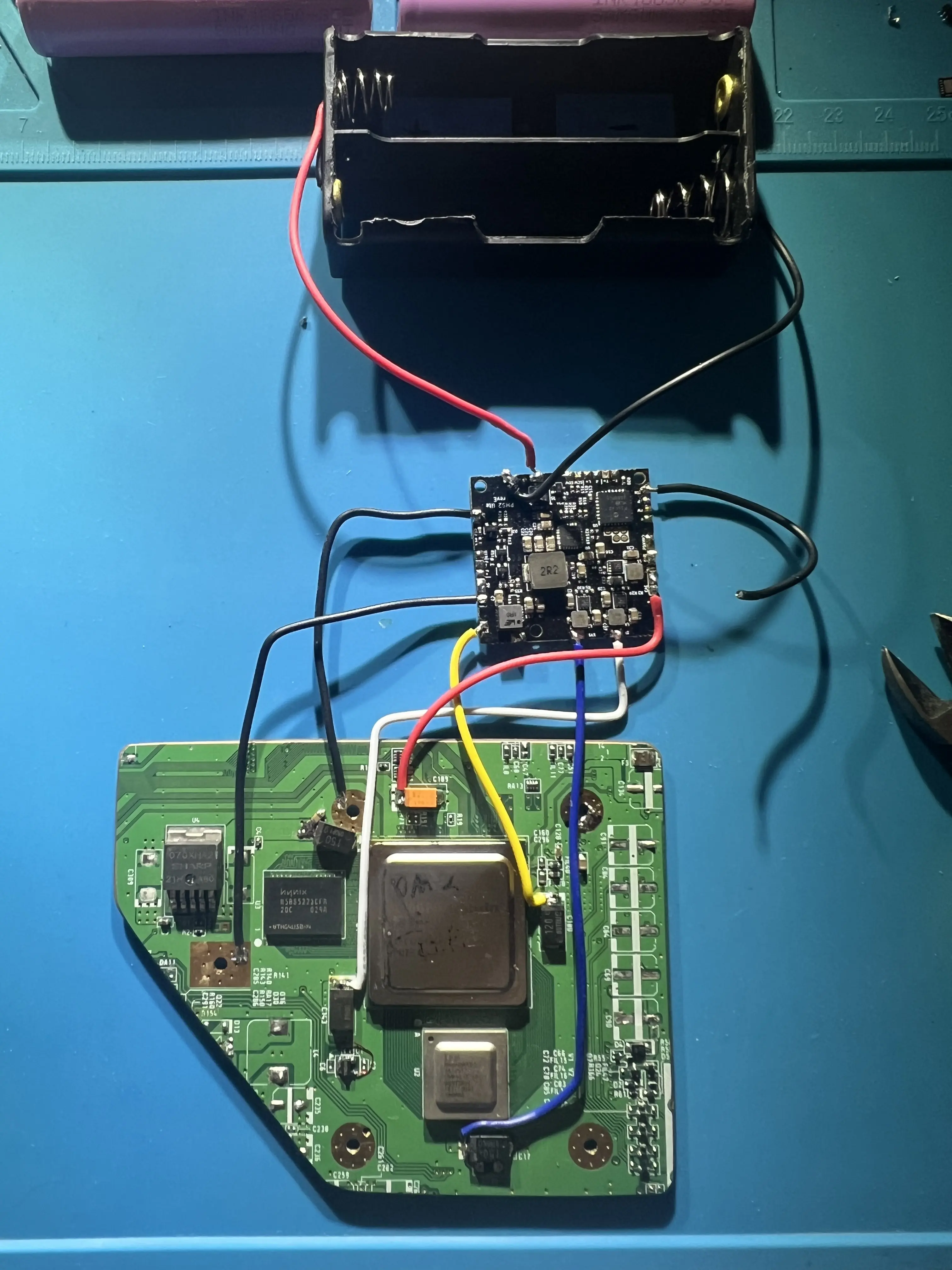

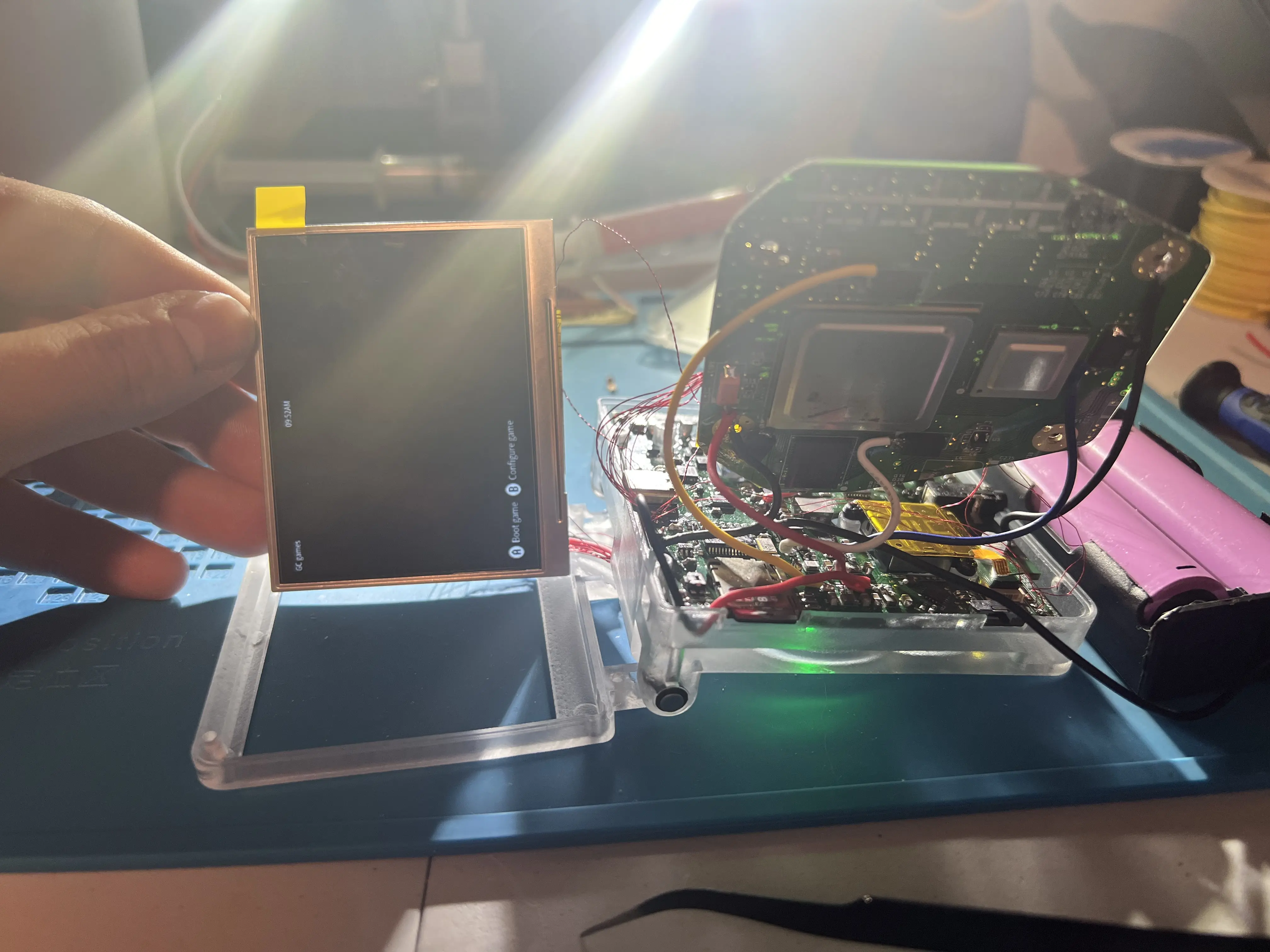

So tomorrow I’ll spend the day wiring up the wii to the RVL-DD and changing out the wiring for situating everything into the case
Screen works!
I did initially run into an issue where the 3.3v rail was being pulled down to 1.18-1.2 volts and I was trying so hard to figure what could possibly be affecting it. I spent an hour or so troubleshooting all the wires I had added to the pms and after disconnecting each one and trying to understand why the MX wires or the sound wires would cause an issue, I realized I should try the gulikit Hall effect sticks. For whatever reason this worked! I remember StonedEdge mentioning they didn’t work with his build for whatever reason and realized those are what I had ordered like a year or two ago for this project (I have ordered what I think are close to oem). I disconnected them and after a few moments that felt like an eternity, I saw the screen boot up! I think I may need to update my files on my sd card as I know there was a new file for the RVL-DD that kept the chatter on, I think, the sda scl lines down, which may improve the screen boot up time but I will have to check. I’m on a trip to Florida this weekend until Monday so I’ll just have to daydream about working on this while I’m there.
Next I think will be button testing and wiring up the batteries when I get back! And maybe figuring out the pesky charge led. And figuring out where to wire up the fan
Wii spaghetti!
