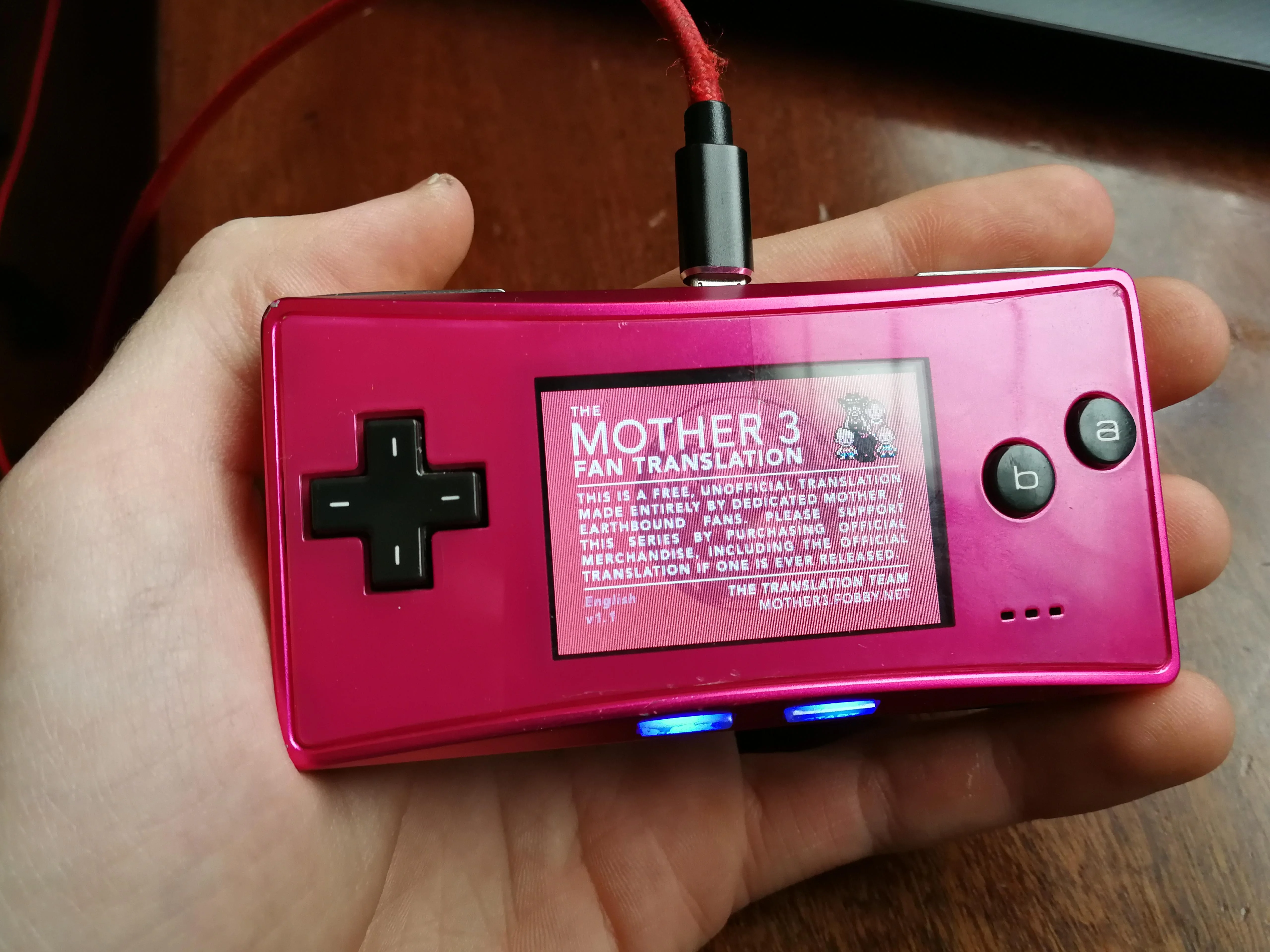

But then, a couple days in, I realised (or someone mentioned? I can't entirely remember) that it looked somewhat like the GameBoy Micro.
So, I decided to change the design somewhat, and fully commit to a GameBoy Micro-styled Wii.

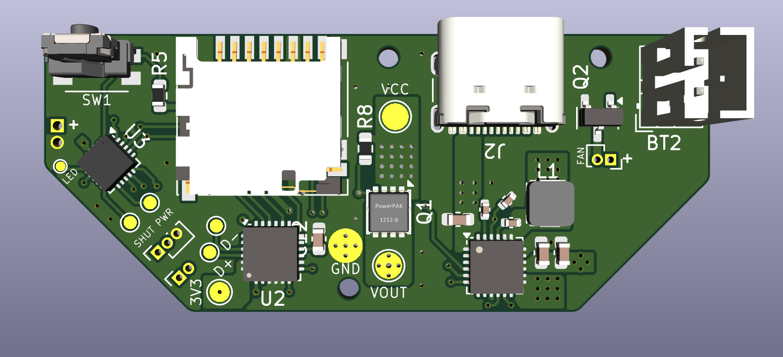

I think I'm finally done with my power board design! It's horrible and I hate it, but I think I'm done.
I've nicknamed it "Stormbreaker", trying to keep with Yveltal's Thor-inspired naming scheme.
Cause I already had enough of a nightmare just making this thing in the first place, not to mention my batteries are fairly low capacity, I decided to just do 5V/5A (actually 3A cause of the BQ chip) charging, no fancy PD stuff. HUGE thanks to @YveltalGriffin for giving me tips along the way, there's no chance I would've been able to make a successful design without his help.

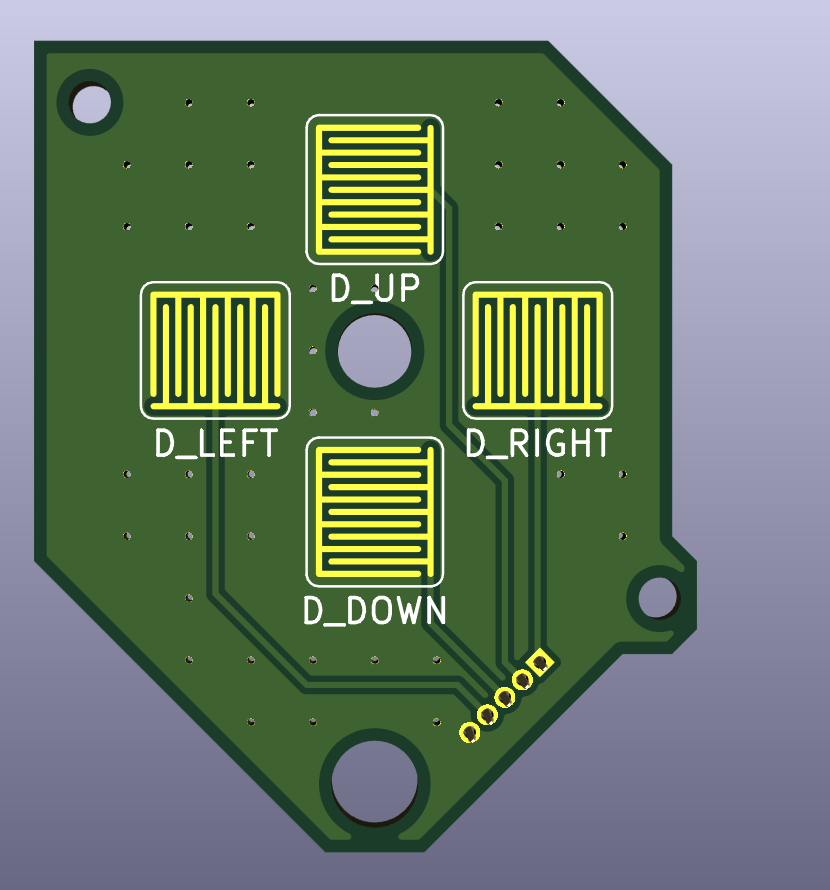

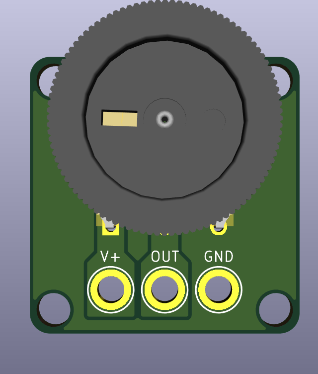

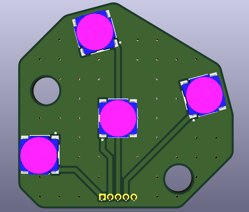

I've also done a couple other smaller PCB designs, for the face buttons, D-Pad, and volume wheel.

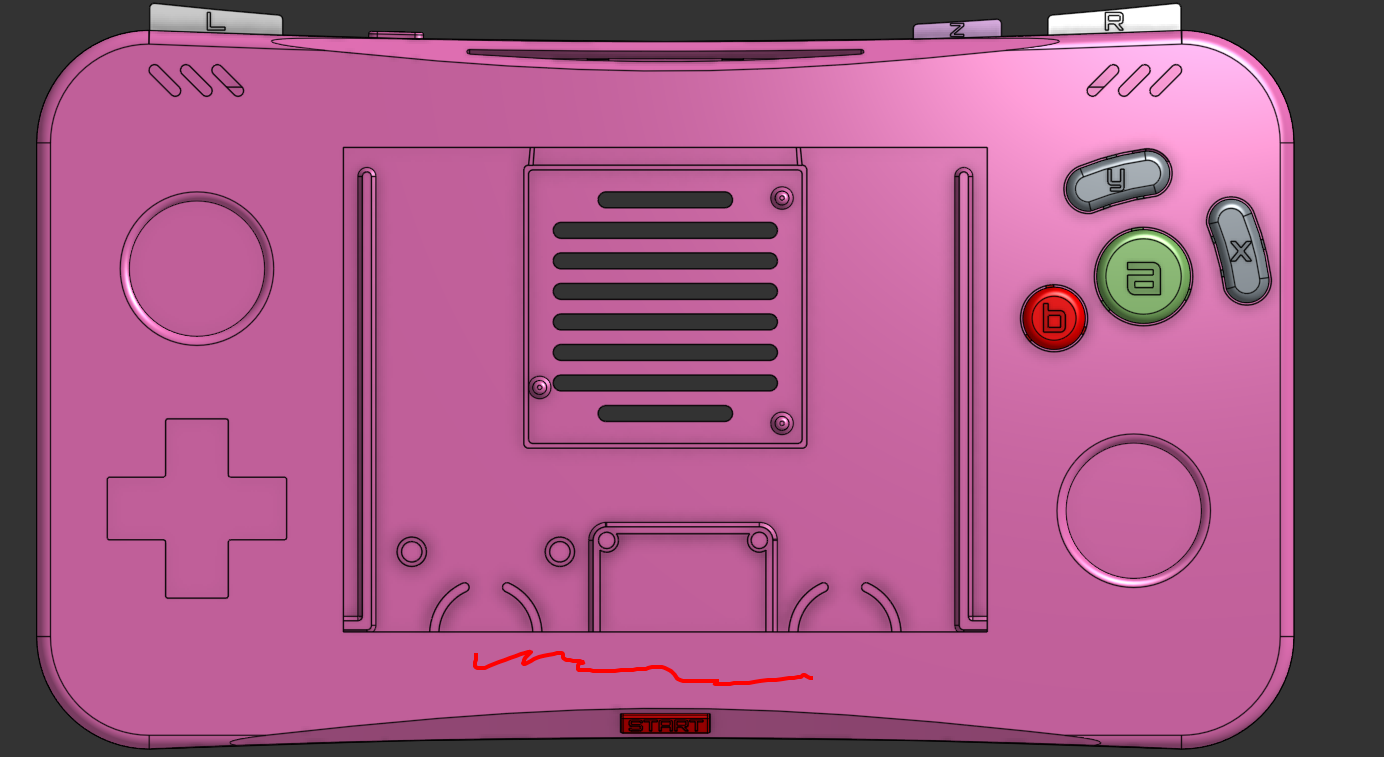

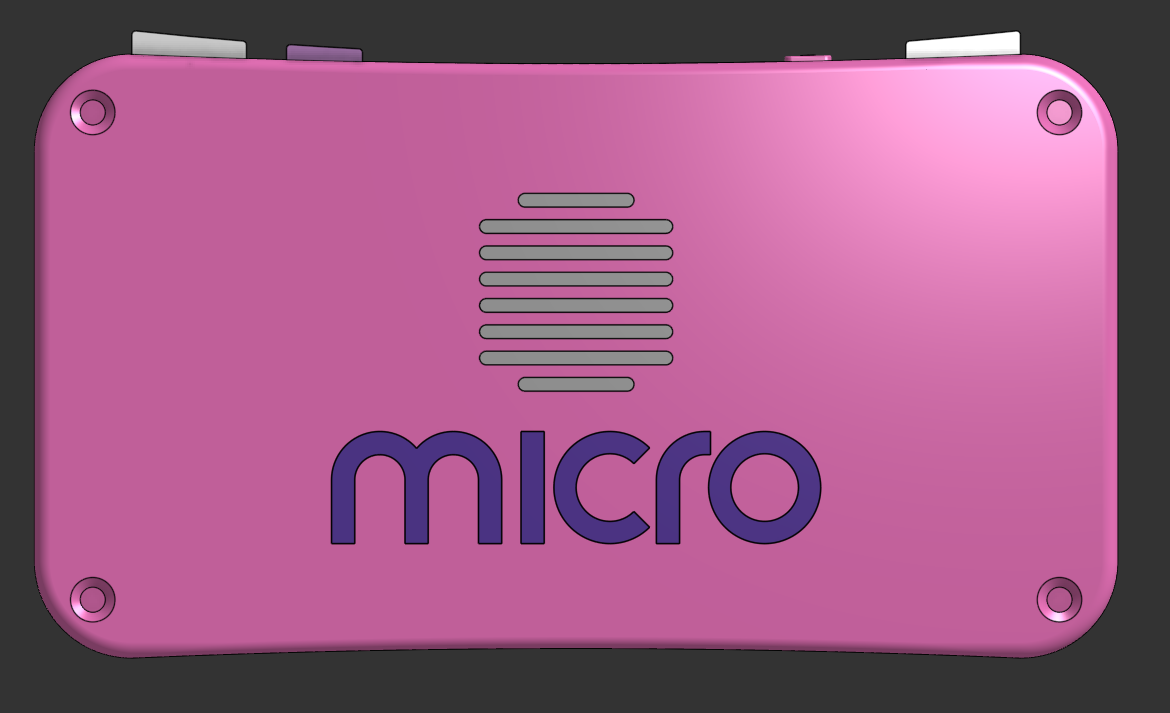

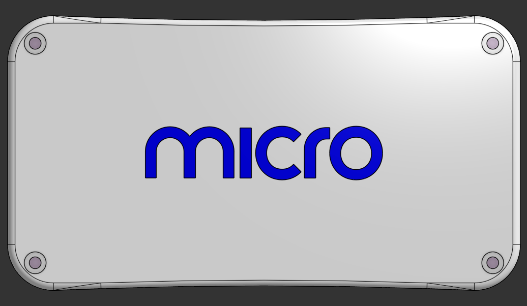

I'm also wondering, should I put anything here? (indicated in red)
I used to have the micro symbol (μ) there, but a couple people said it looked tacky, so I got rid of it. Now, though, I'm wondering if I should decorate the front a bit more. Any suggestions would be heavily appreciated!

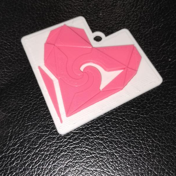

I also wanna shove some Easter eggs on the inside of the case, in the form of vector art. I figured out a while ago how to import graphical SVGs into OnShape, and I've had some success making 3D models from 2D vectors in the past.
bonus points if you know where this is from

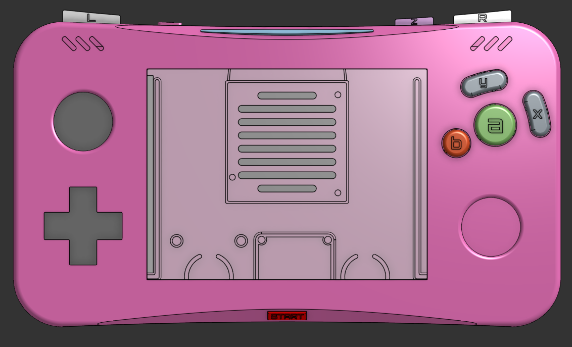

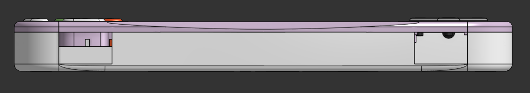

Now, onto the bad news. I'm so sorry, everyone. I had to increase the thickness of the case...by 2mm.
I know it's an unforgivable sin, and I will spend the rest of my life repenting for it. I hope you can look past my transgressions.
The total thickness is now 20mm, making the max outer dimensions 140x80x20mm. Unfortunately, despite 20 being more than 18 (evidence needed), I won't be able to fit 18650s in. Too much thickness is taken up by other components like the D-Pad, face buttons, etc. I might be able to get 800mAh more (bringing the total to 5Ah), but that might be a bit annoying to accomplish. Still, I'll think on it, and I'm open to suggestions and feedback.
And, well, I think that's it! Lemme know your thoughts and suggestions, even if it's just to tell me how much you hate the colour pink.

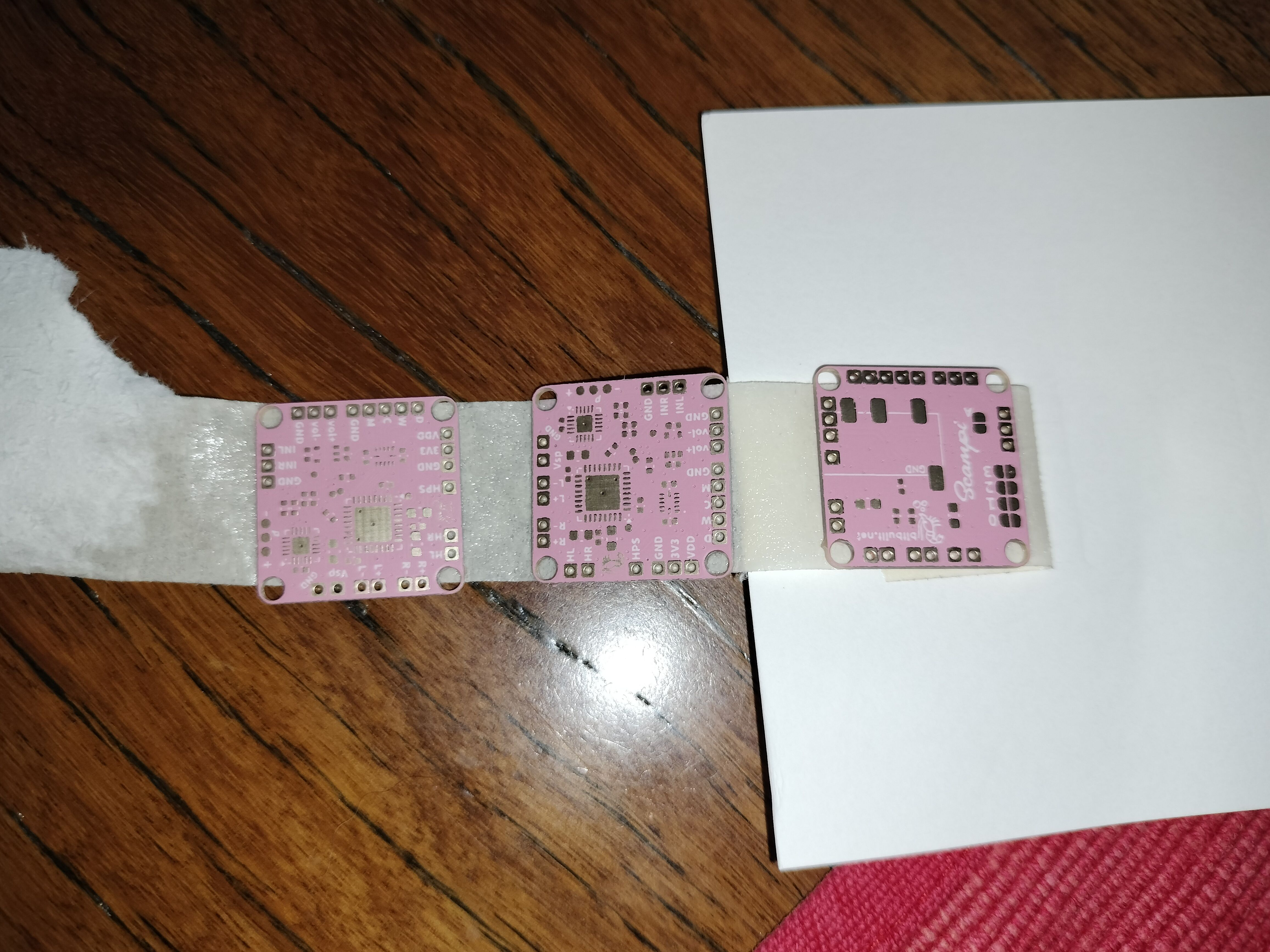

While I'm still waiting on my PCBs from JLCPCB, the Scampi boards (thanks @YveltalGriffin!) and Digikey components all arrived, so I've begun assembling Scampi. I absolutely love the pink soldermask, it's beautiful.
(terrible image, I know, sorry)

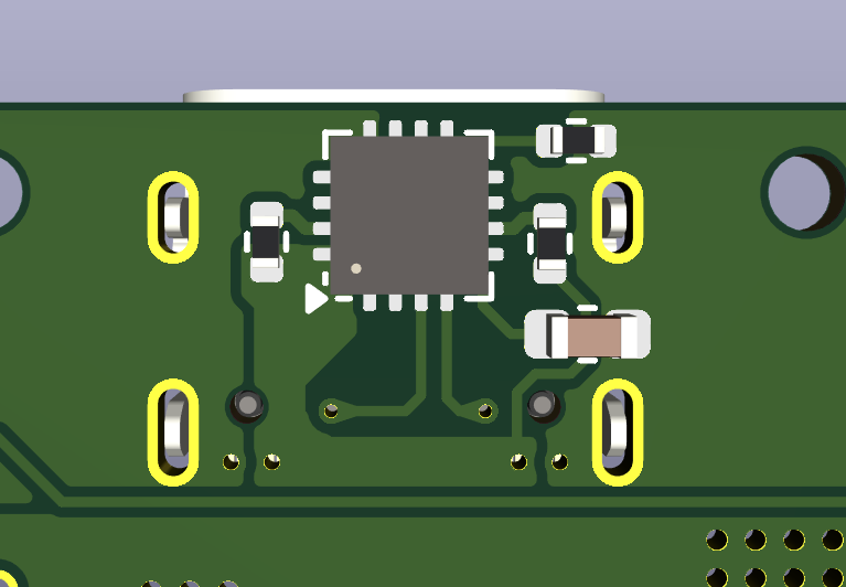

One change I've also made to Stormbreaker is adding USB-C PD charging. Gunnar pushed for it, and I found that the HUSB238A could just barely fit on the board, so I have it handling PD negotiation.
Unfortunately, that does add another chip that can't be purchased through Mouser or Digikey, but ah well. Hopefully this chip should allow much faster charging, and with lower currents.
I've also started work on the software and firmware side of things. Stormbreaker's firmware is pretty much complete, I think, and I've also modified RVLoader to support it. It's a bit of a bad modification, as I've simply replaced the hard-coded PMS2/lite support for hard-coded Stormbreaker support. At some point, I should modify RVLoader to have a framework, so other PMS boards can be easily added. For now, though, and for my specific project, this should work fine.
