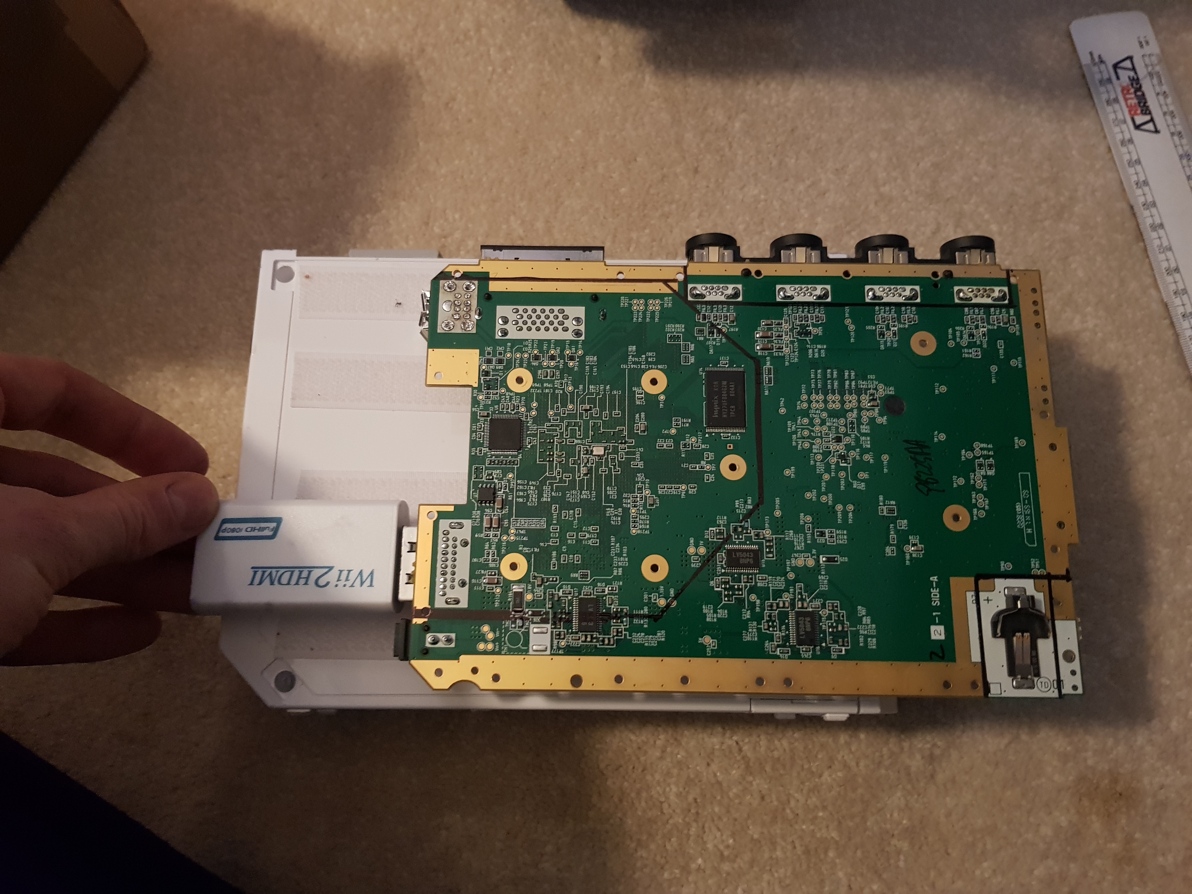

Hello all, I have been browsing these forums for a weeks now. You have all really put a lot work and research into documenting how to do this and some of the finished projects are amazing.
I think a handheld portable wii is going to be outside my skill set for the time being. My goal is to slim down my wii (6 layer motherboard) by removing the disc drive, gamecube memory card slots, sensor bar port and original fan / heat sink assembly. I would also like to have it powered via usb c. I have one of these usb c boards:
It can supply a variety of different voltages if you use the correct power brick. I am wondering if I were not to trim my wii at all, could I simply remove the current power socket and solder the + & - connections from the USB c board to the Wii and then power everything with a 12v power brick? This would obviously save me having to wire custom voltage regulators.
Another option I'm considering is to also trim the Wii as per Nold's wii mini design:
And then internally mount a Wii2hdmi adapter to give me a relatively simple solution for getting video out wherever I take the Wii. If I were to do this I would need to relocate the usb ports to so they are accessible on the outside of the console. Would it be possible to de-solder the USB ports and then re-mount them on some circuit board and re-wire the connections? Or alternatively just have the USB ports OEM and then extend them with USB male to female cable (this would be easiest but I'm not sure if the Wii likes this type of connection).

the usb ports can be relocated as long as the data and power lines are connected to their old locations on the motherboard. the data lines should be twisted together tightly to avoid interference. as for your usb c power solution, it should work if you remove the stock power jack and rewire the ground and voltage in. the video out jack can also be desoldered and you can manually wire the circuit from the wii2hdmi to the wii motherboard. make sure to check out the wii trimming guide and the 6 layer expansion for more information on relocations, wiring, etc.
EDIT: if it's an option for you, the kingston microsd to usb adapter is on the bb store
If you want to build a noldendo you won't need to relocate the USB port as they are availlable.
The easier way to fit the wii2hdmi would be to use a smaller cooling solution and put the wii2hdmi board on top.
You could also remove the original port and put the wii2hdmi in place, but I guess it will be quite long.
The 12 volts pd looks fine to me. If you want to do the wii micro, the easier thing would be to buy the rvl psu, and you could take a kingston adapter too on the store.
I have a 128Gb sandisk cruzer blade that work quite well for the wii, but I only tried one of those so I don't know if it will be ok for every one of them.

I think based on that then, the easiest solution for what I want to achieve will be to not trim the board at all, de-solder the current video out port and then re wire the connections to the Wii2hdmi adaptor relocated to a sensible place near the outside of the console. That way I could also utilise all the existing mounting points and openings in the original shell, and then trim down the original shell to better suit the thinner design.

I saw someone adding a wii2hdmi without taking out the original port, I guess there is enough space in the wii shell.

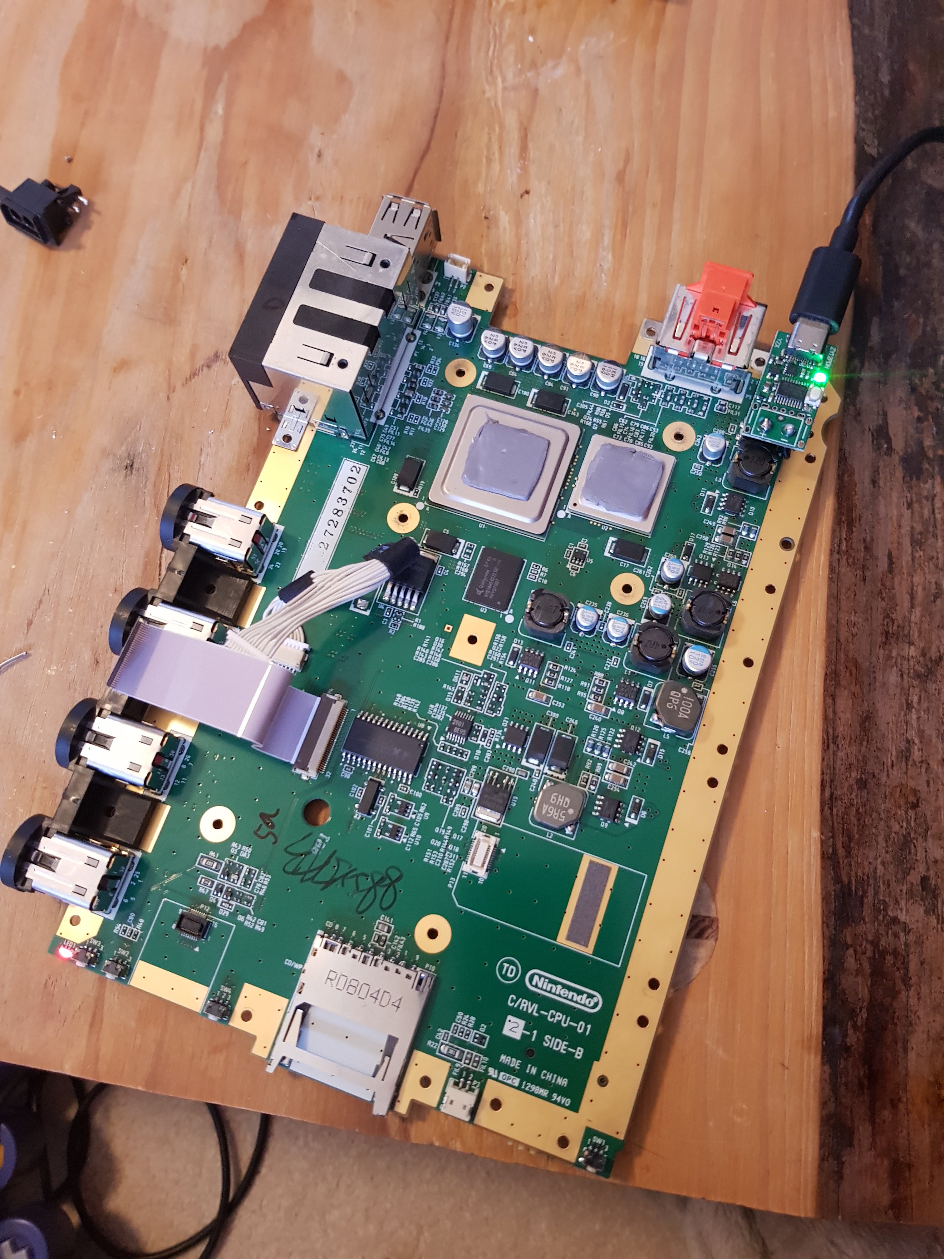

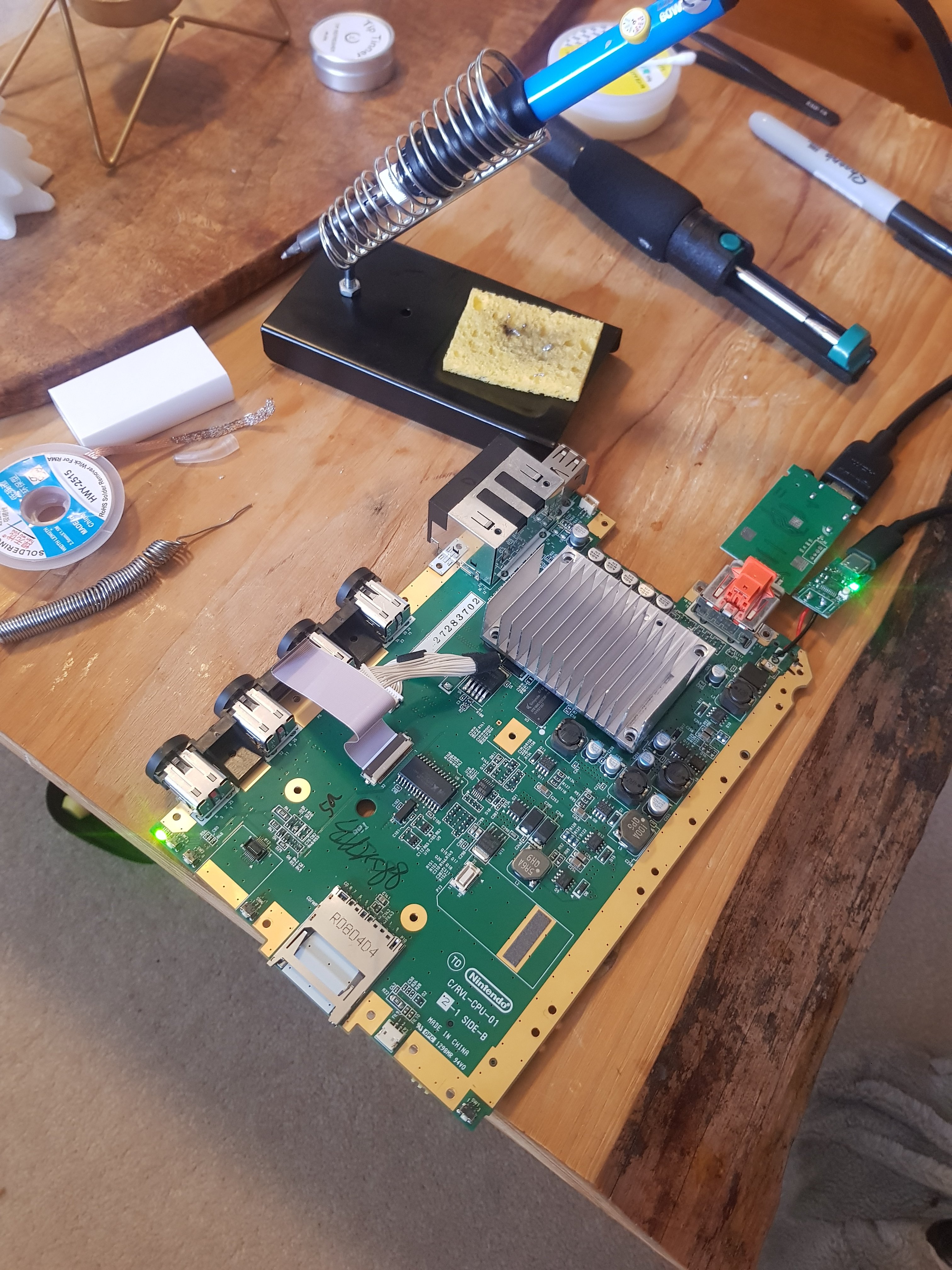

Got the USB C pd board working. This article was really helpful for explaining how to set it for the different voltages.
Had to order a different power brick to get it to work though. When I first tried to set it it was flashing blue all the time (indicating that the power brick didn't support usb power delivery). Ended up getting this one which was the cheapest I could find on amazon:
Amazon product ASIN B07VSMRZLR
It's fairly chunky but obviously still smaller than the stock Wii power brick.

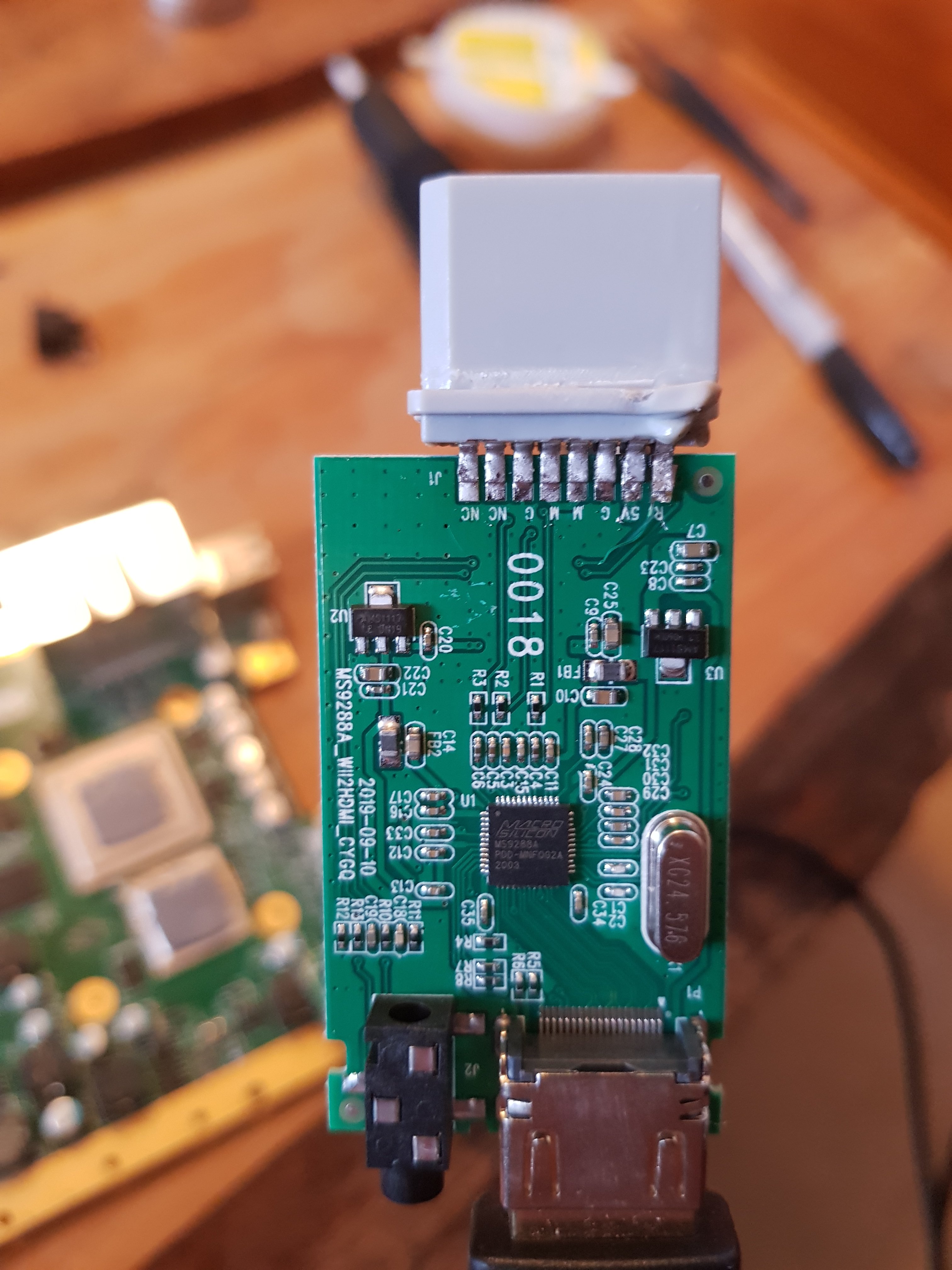

Unfortunately I damaged my wii2hdmi adapter when trying to de-solder the port on it. One of the solder pads came off (probably due to me being to aggressive with the heat). Luckily it was for the right audio channel, so I can still get video out. Will still be useful for testing which connections are required for the video signal but I'll order a new one for the final build as they are fairly cheap.
I suppose it's not absolutely necessary to de-solder the port but was wanting to do it to save space for the heat sink. I will maybe just leave the port on and re-locate where the outlet will be (originally I wanted to utilise the existing hole for the a/v port).

Hi, I don't know for sure but when a pad came off, it is because you don't heat it enough and pull it before the solder is fully liquefied. So it would be a lack of heat more than to much.
You may be able to trace where the right audio channel on the board and solder a magnet wire to it.
If you are using a heatgun to desolder it you could put some aluminium foil over the plastic part if you don't want to smoke to much plastic.
Adding some fresh solder on the pad will help melting it quicker and adding some flux too.
Cutting the legs with small pliers, then desoldering them would be easier.
Thank you for the tips .
I was thinking that cutting the pins with pliers and then de-soldering would be easier so I will try that.
