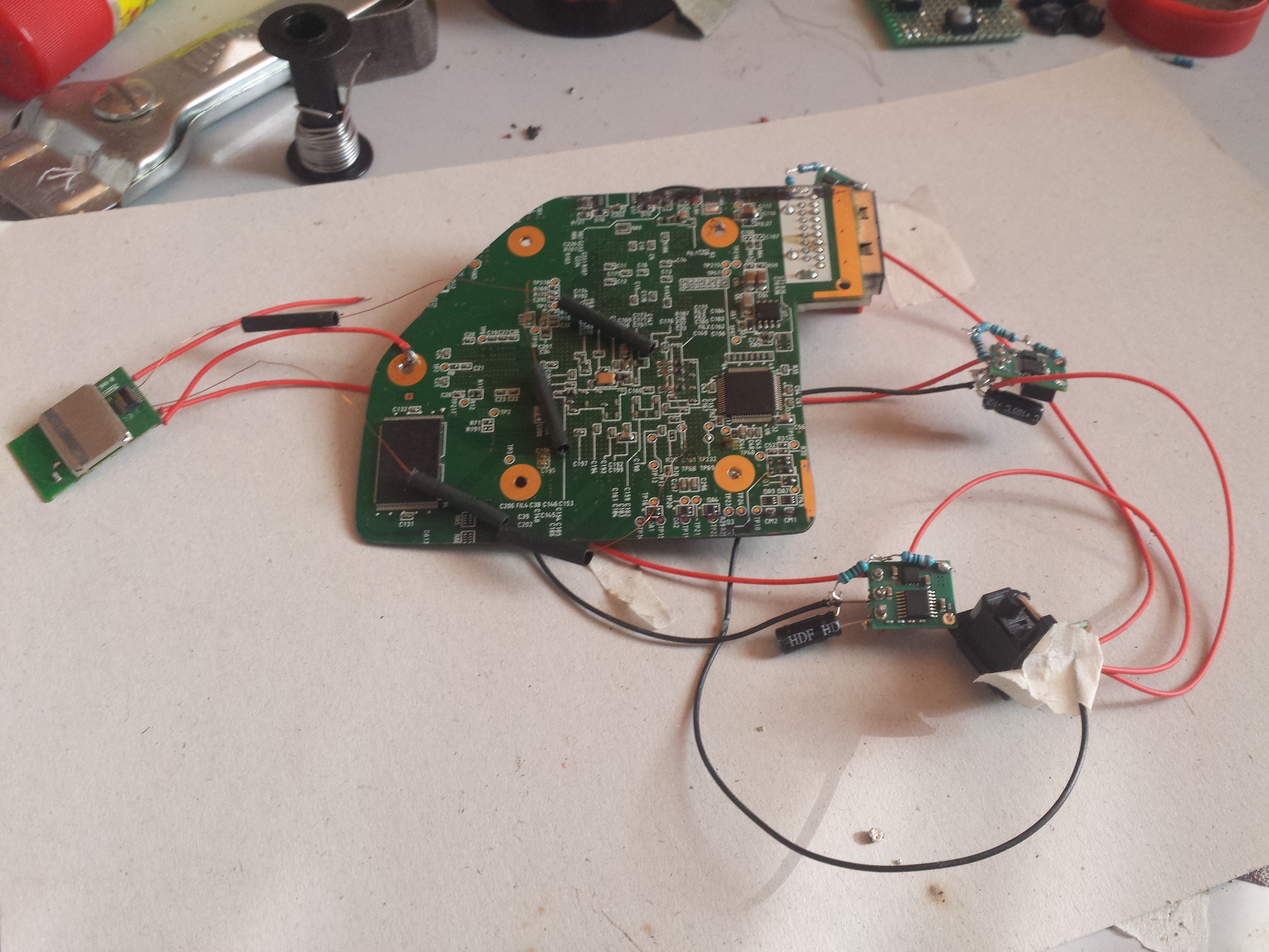

Ok after a lot of soldering done i pluged av into tv and mb, power into wall and regulators everything seems fine all voltages are at right levels even through i thought i bridged 2 wires its ok after probing with multimeter U10(U9 in my case when desoldering i lost U10) is getting 3.3v at output leg signals are going from AVE to end of AV cable i know TV works bcz of another Wii, cpu and gpu are slowly heating up(normally) but the MB WONT OUTPUT ANY VIDEO(and/or sound)("no signal" on TV) WTF

The trick to troubleshooting is eliminating as many variables when you test. So wire reset to ground so it will boot into priiloader (this eliminates USB troubleshooting). Make sure the TV shares a common ground with the Wii or it will not work. Also pictures will help us too.

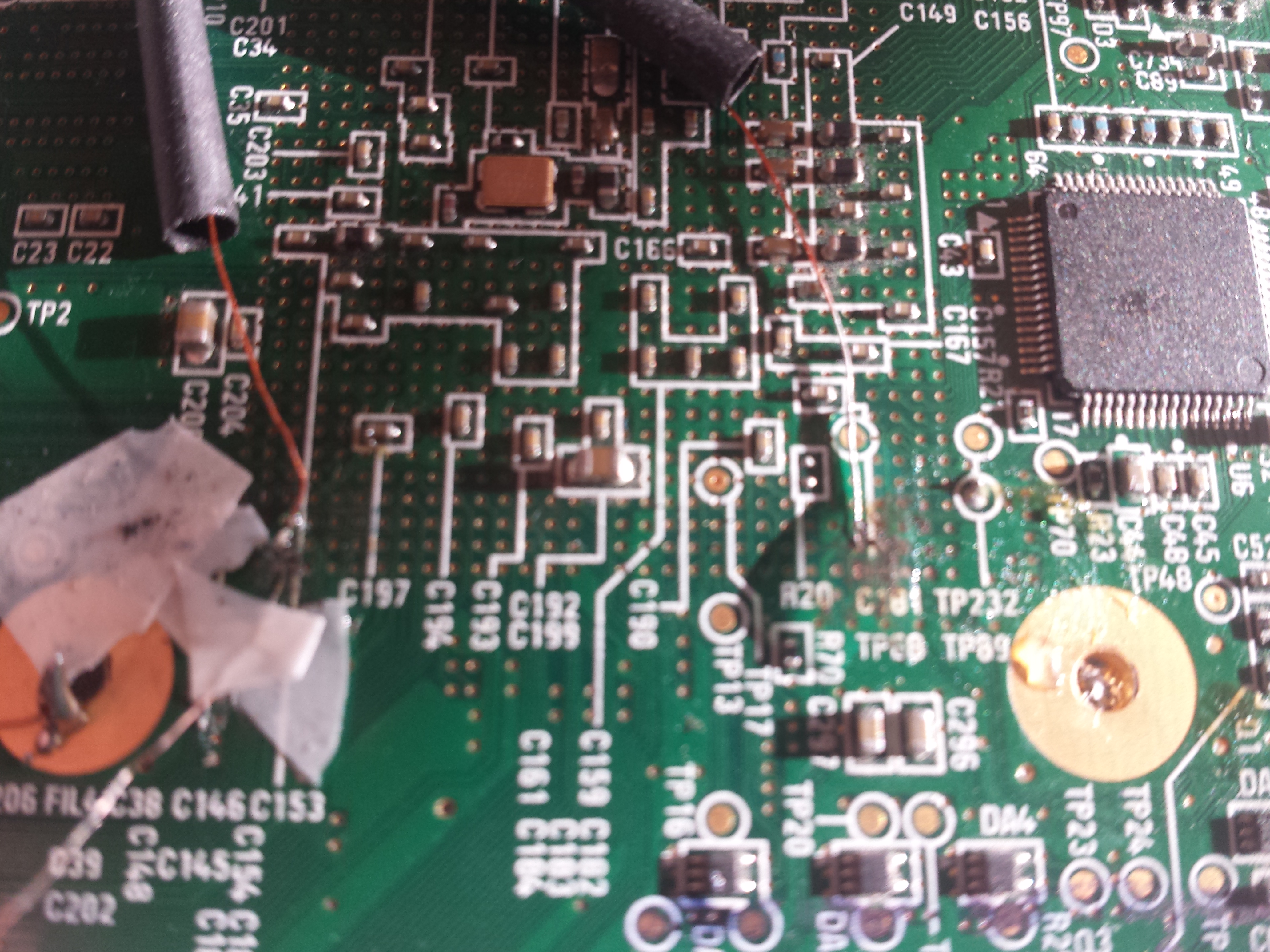

I used original cable and connector on MB was left as is,

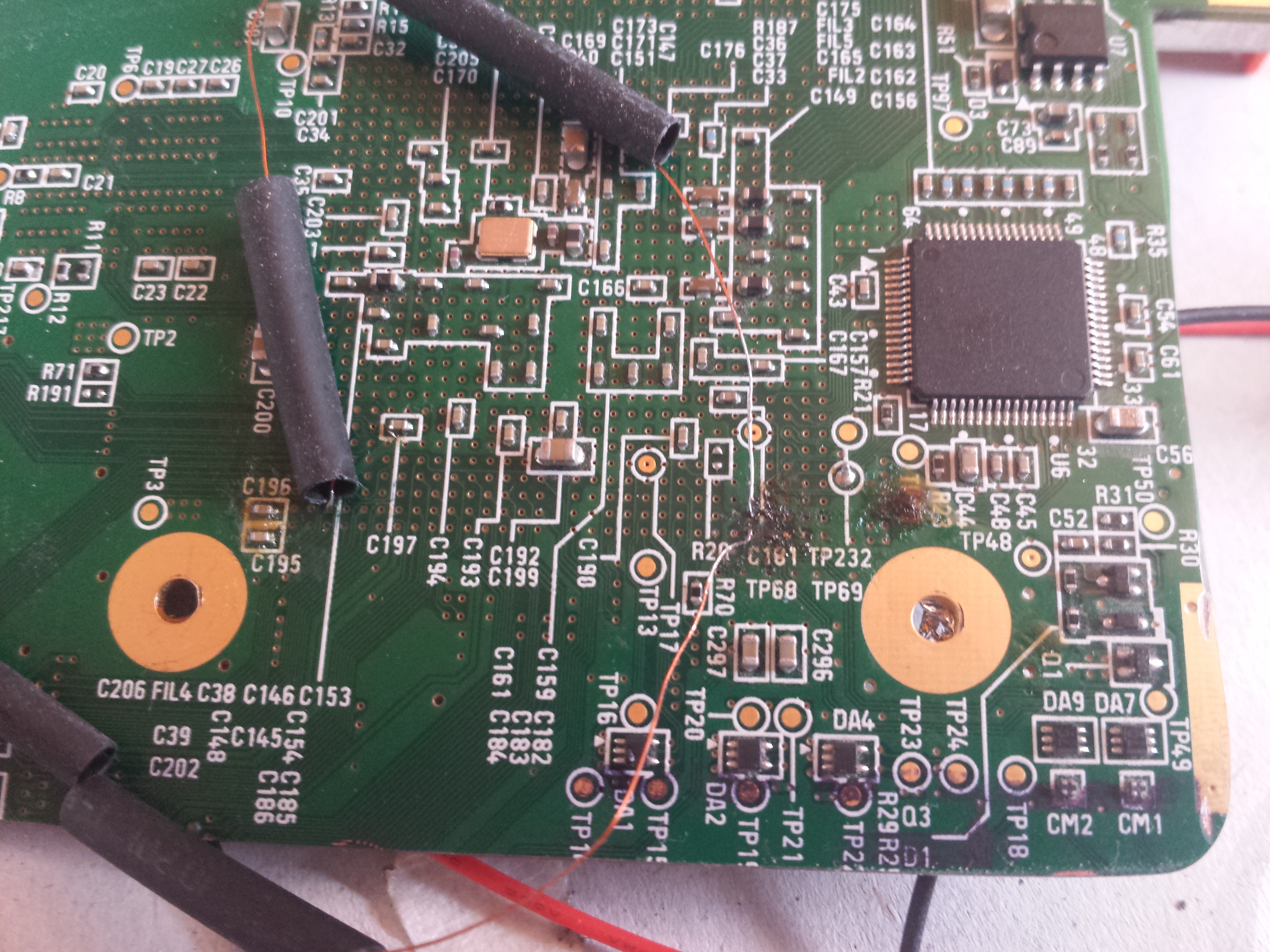

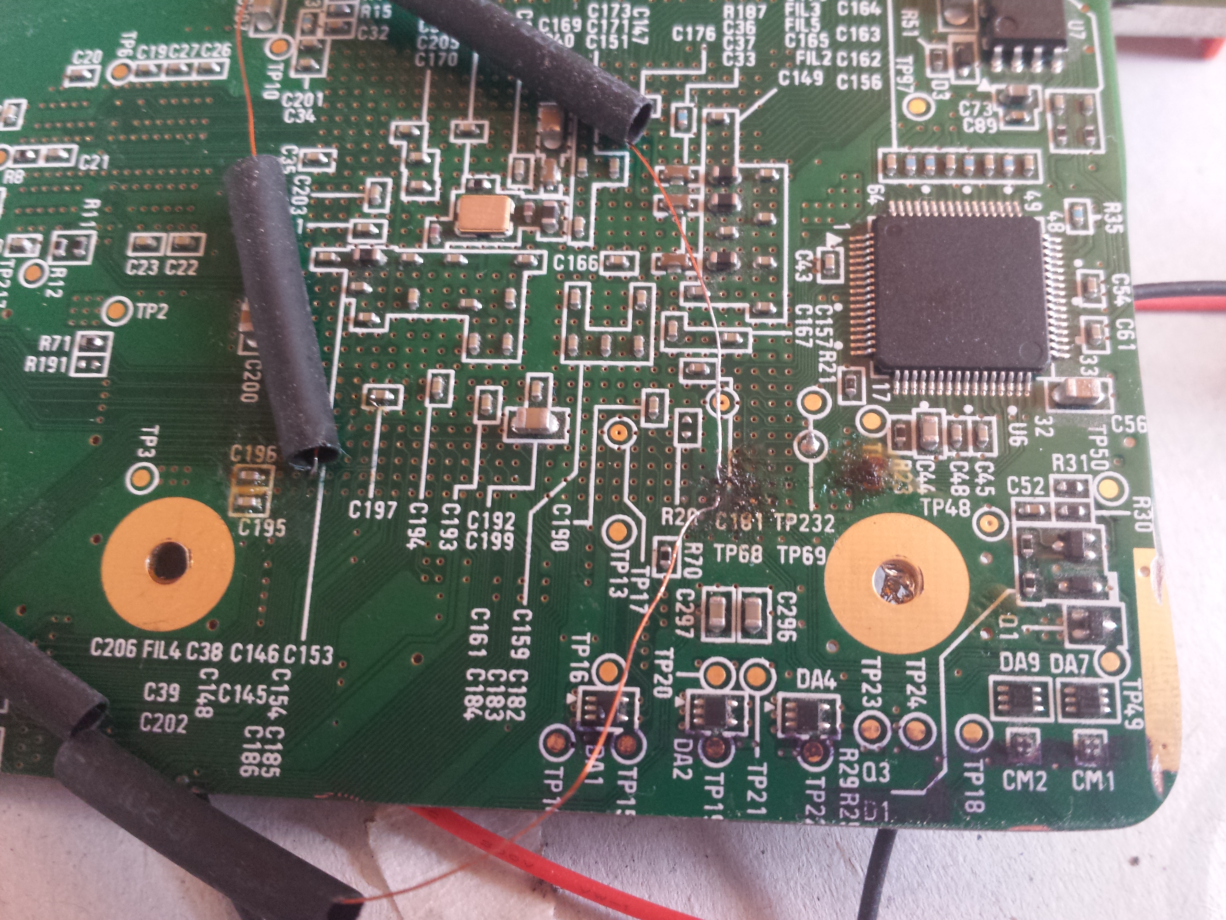

Yikes.

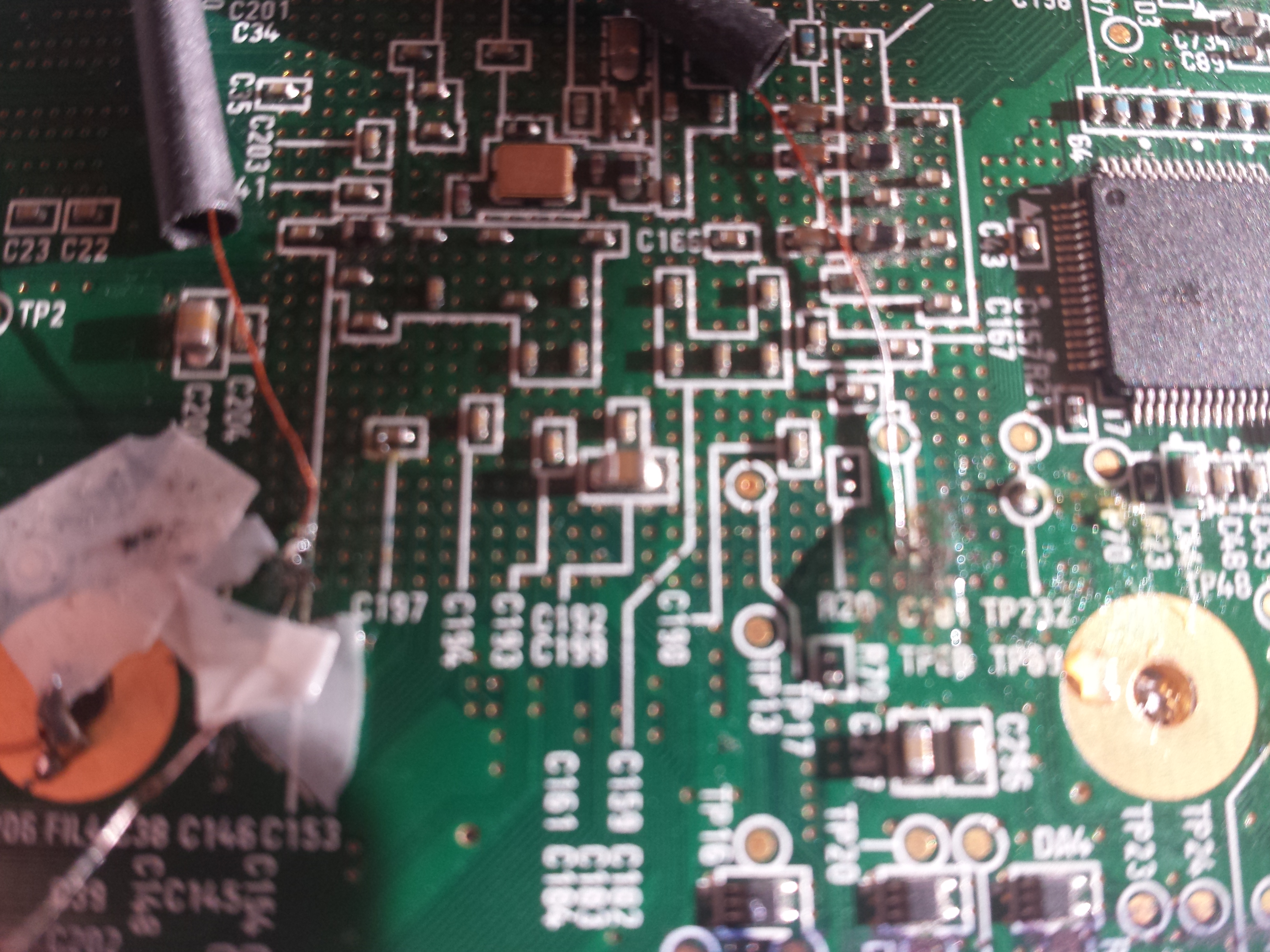

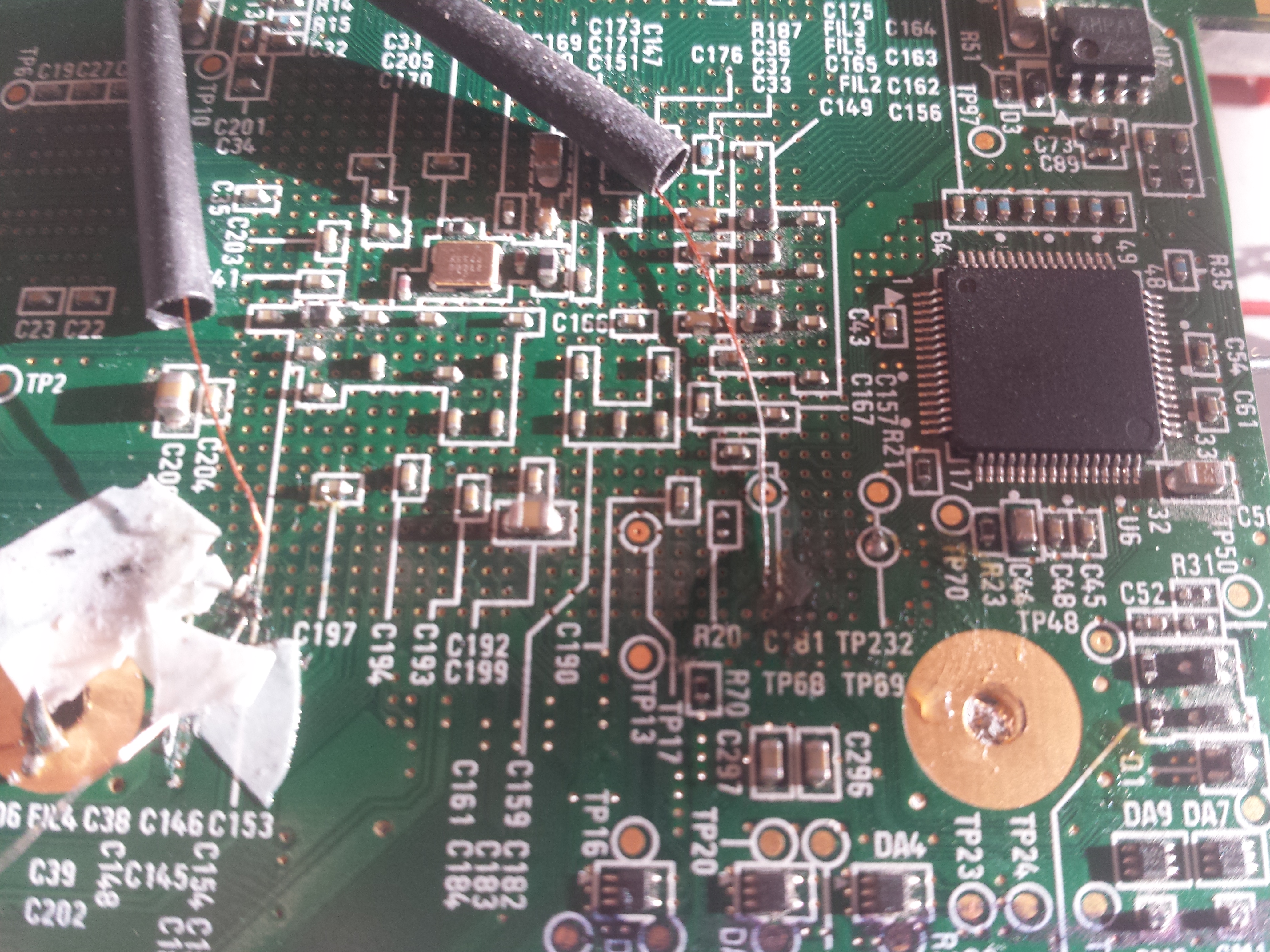

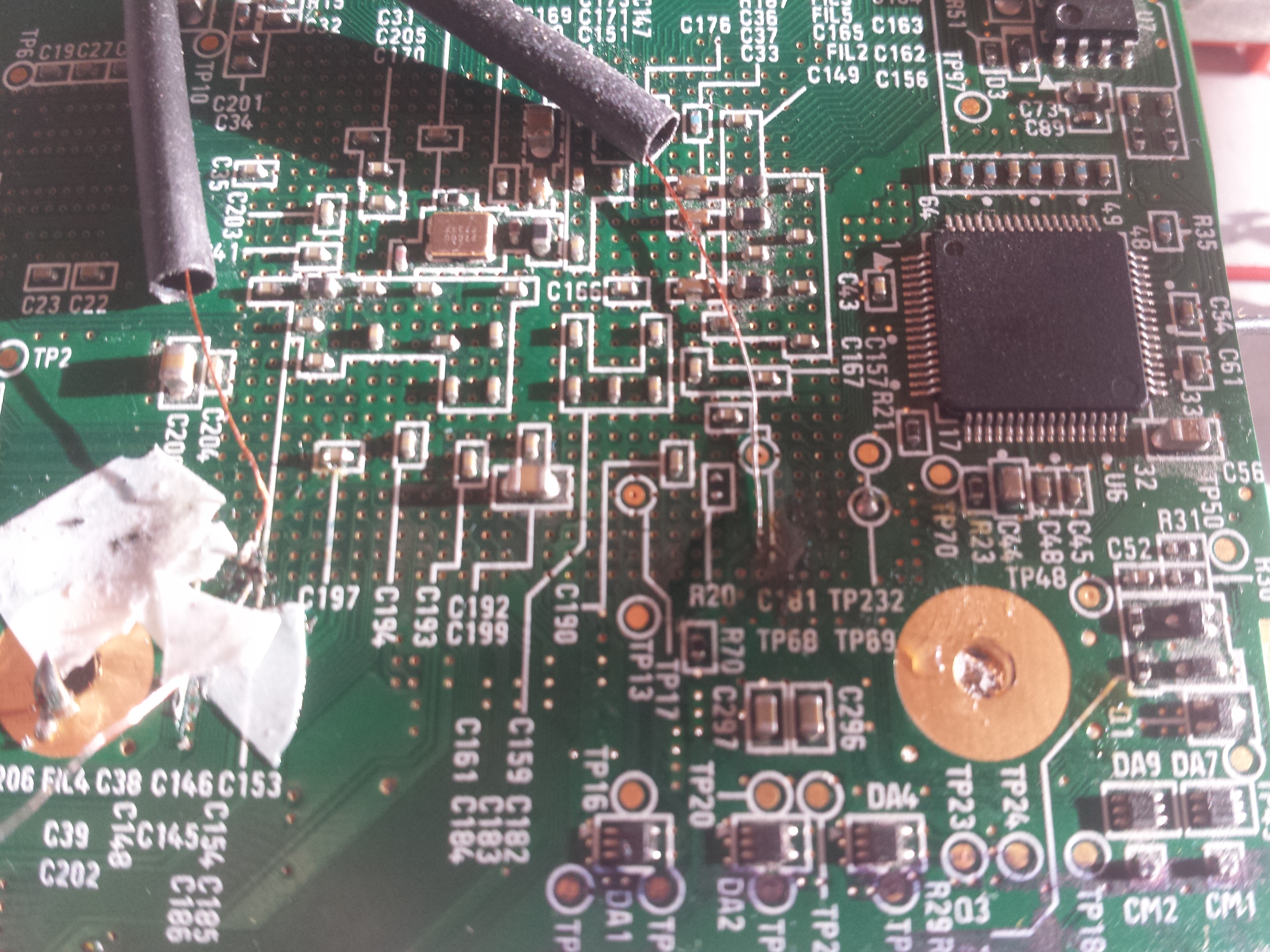

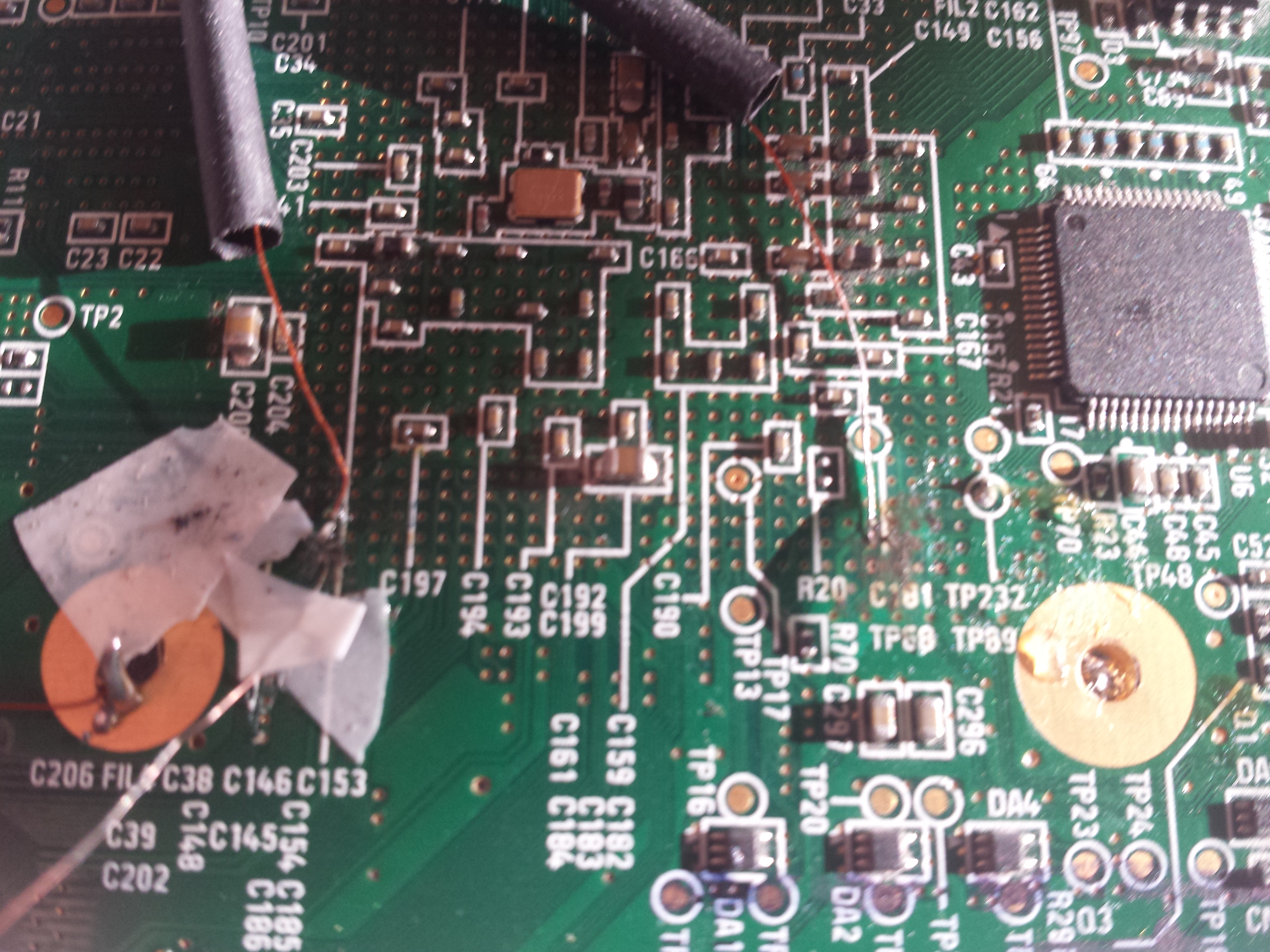

There is something very wrong with the way you are soldering. The board should not be blackened to a crisp around those vias. What kind of soldering iron and what level of heat are you using?
Try cleaning the board with isopropyl alcohol to see what comes up and what doesn't, but you may have burned off some of those vias which would mean this motherboard is useless.

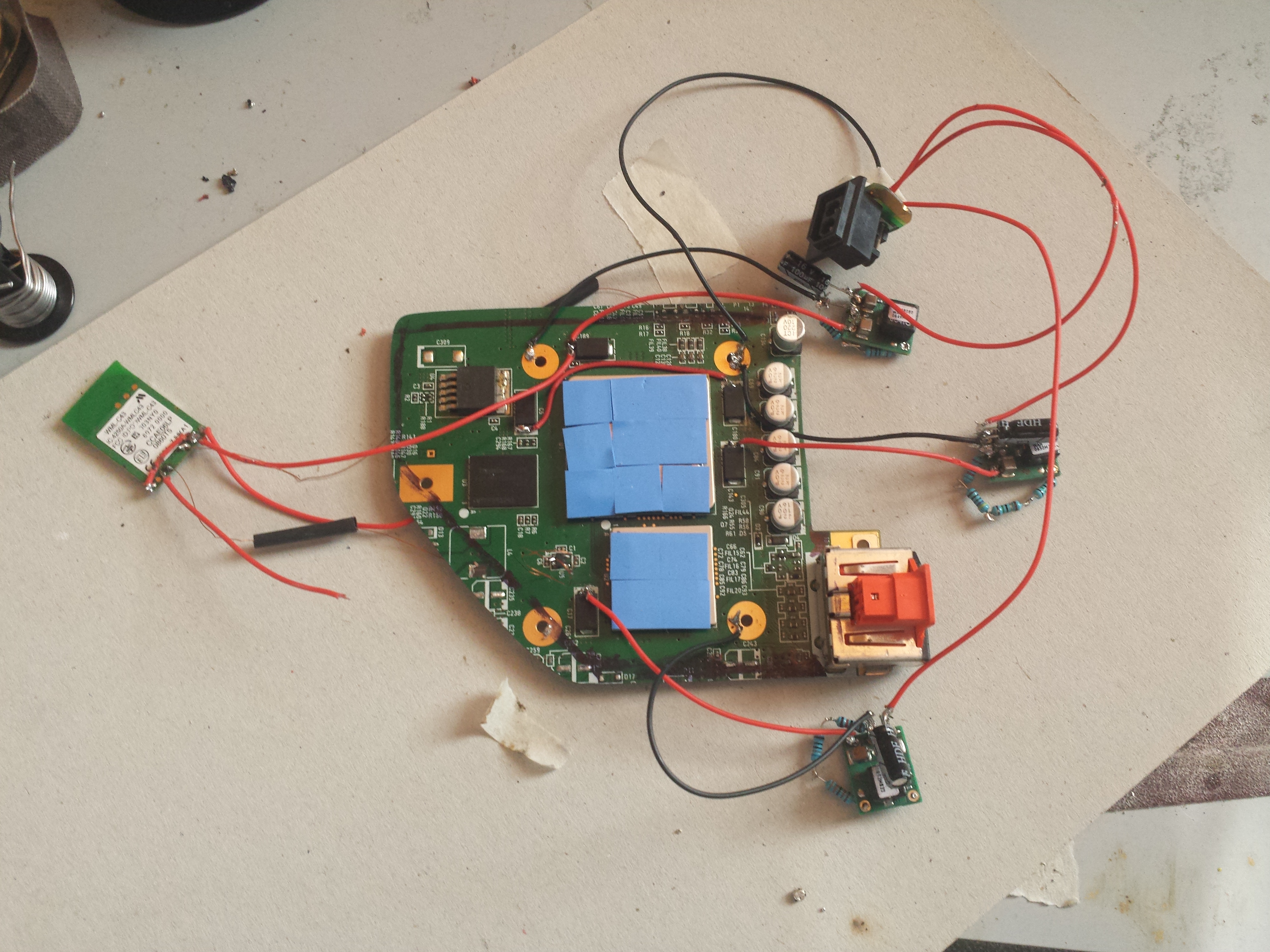

It appears like you only have thermal pads on the Wii, that is not going to do any good cooling it. You need a heatsink on it. It might make it easier if you unsolder the BT module until you get the wii booting.
STAMOS Schlaing 325(insert that small o here)C soldering takes me a lot of time as solder does not want to stick to wire nor the mb
Atleast under magnifying galss pads looks to be good
ignore that white tape its there to hold the wire to the reset pin
and as I think about it i cannot test board now as alcohol needs to dry as its good conductor
I know that was when I thought it will go smooth i have heatsink ready for it
Uhh board still wont boot even after desoldered everything and tried to resolder U10(U9)(still havent got grip to solder magnet wire to that small pin) even adding direct connection for composite between aves first resistor and connector. I can try to resodlere U9 one more time.
Can it be anything else?Is there any other way of knowing board boots as there are no leds etc to atleast know difference between bad connection ave tv and cpu u10
This motherboard is dead, you've burned too many critical points to a crisp.
You should buy some magnet wire and flux, and practice soldering to the vias on this dead board before you try again on another Wii. The board should look just as pretty as before when you are done soldering to the vias. Also are you sure that you gave the correct name for your soldering iron? I googled it and the search came back empty.
