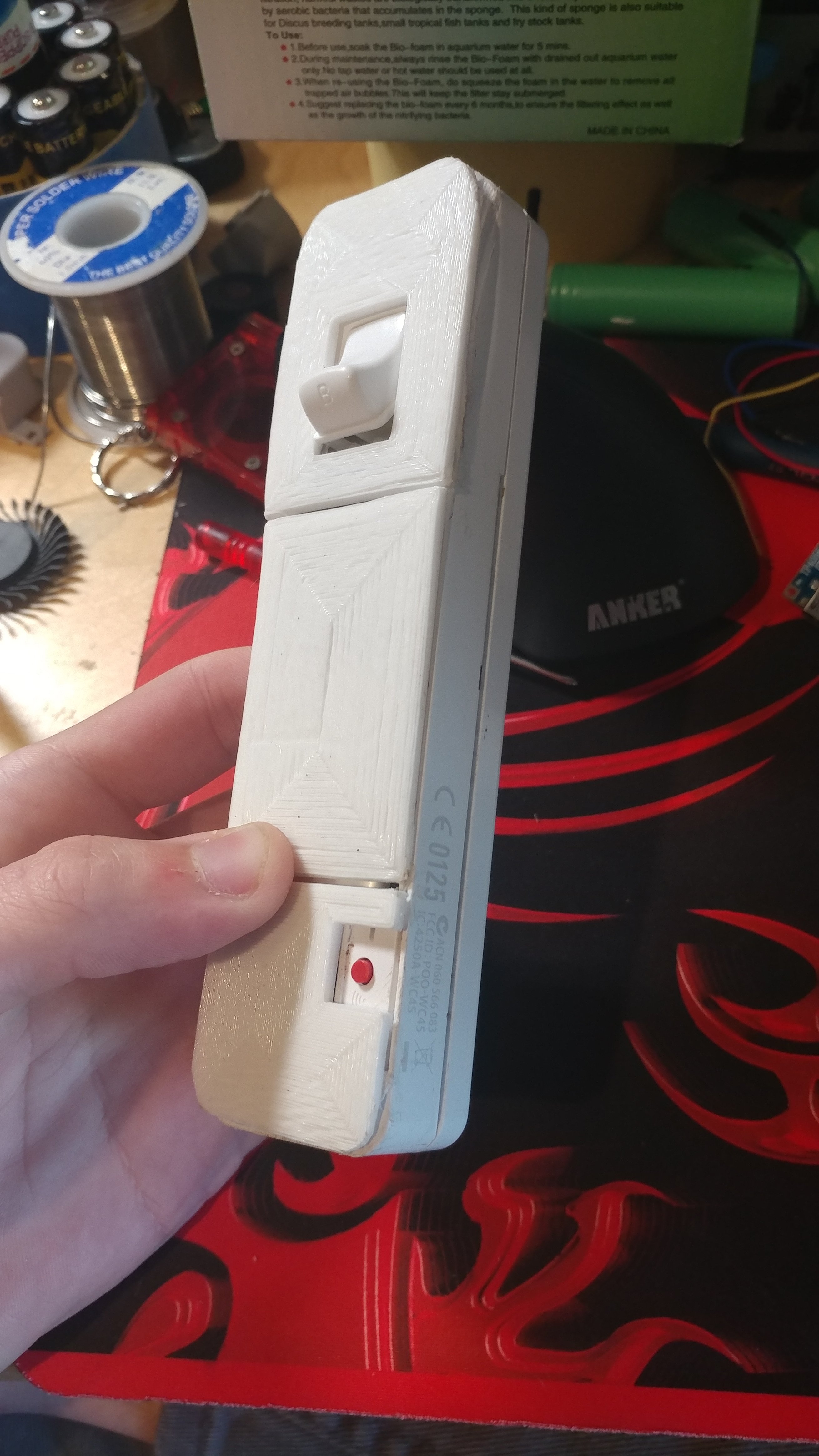

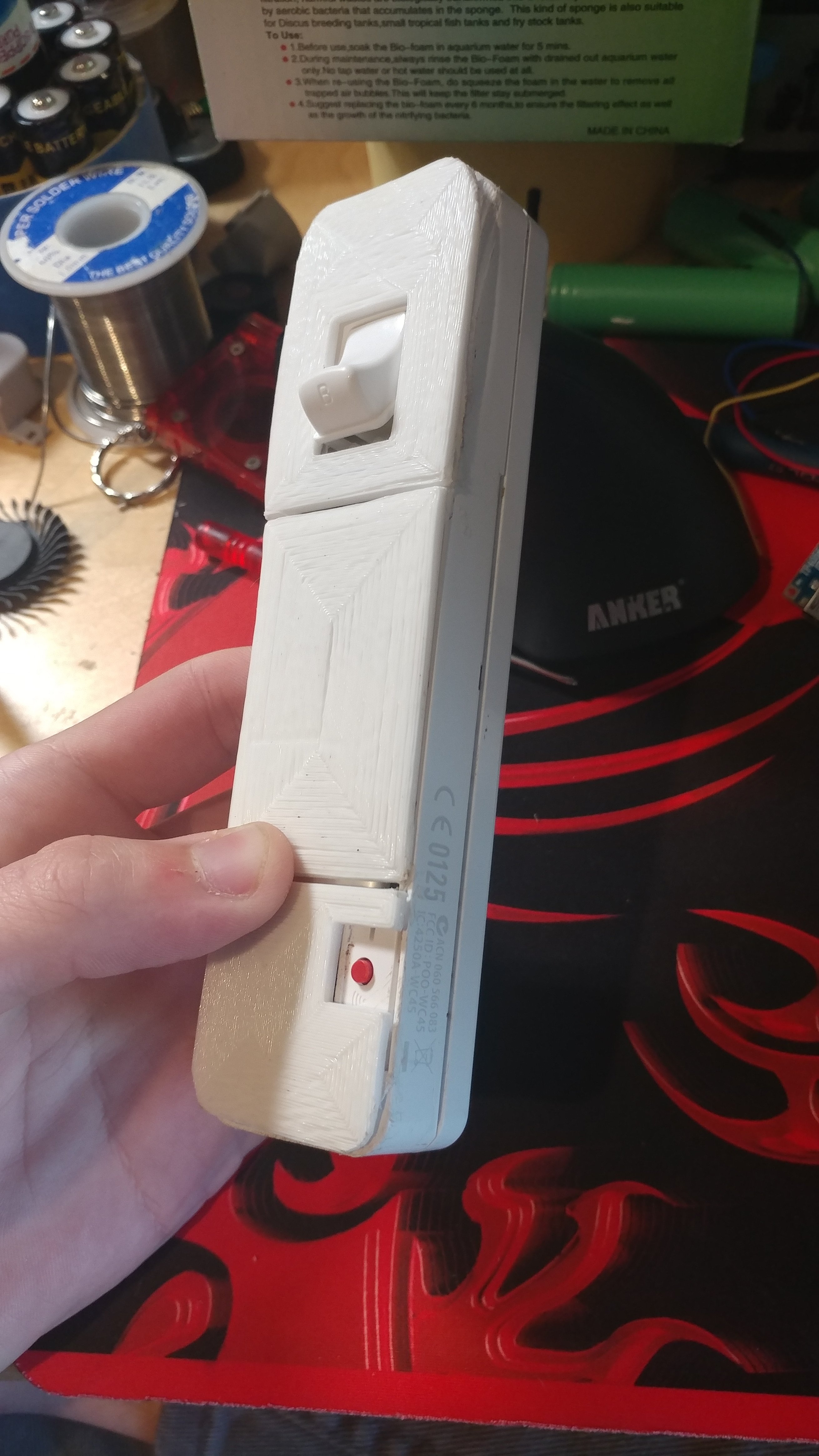

it's been awhile... Thought now would be an okay time to talk about this because people are now revealing their plans. But I've been playing around with the wii mote, and got it to a point that i think will serve my purpose.
Trimmed the mote down from what i believe to have been 32-34mm, to 22mm. Functions are the same as a regular wii mote. Using a 600mah 3.7v Lipo battery, with a step down to 3v.

That duct tape scares me lol, Do you have electrical tape, it would work alot better.
You could possibly fit in a powerboost(adafruit), like the 500 might be able to fit.
nice progress though :33
I had no idea there are so many duck tap fans lol.
Got the electrical tap in :awesome:
just to give ya an idea on how it will look closed up. With the SYNC button on the outside;)
The cover is just a quick 3d printed prototype, but it can handle smashing.

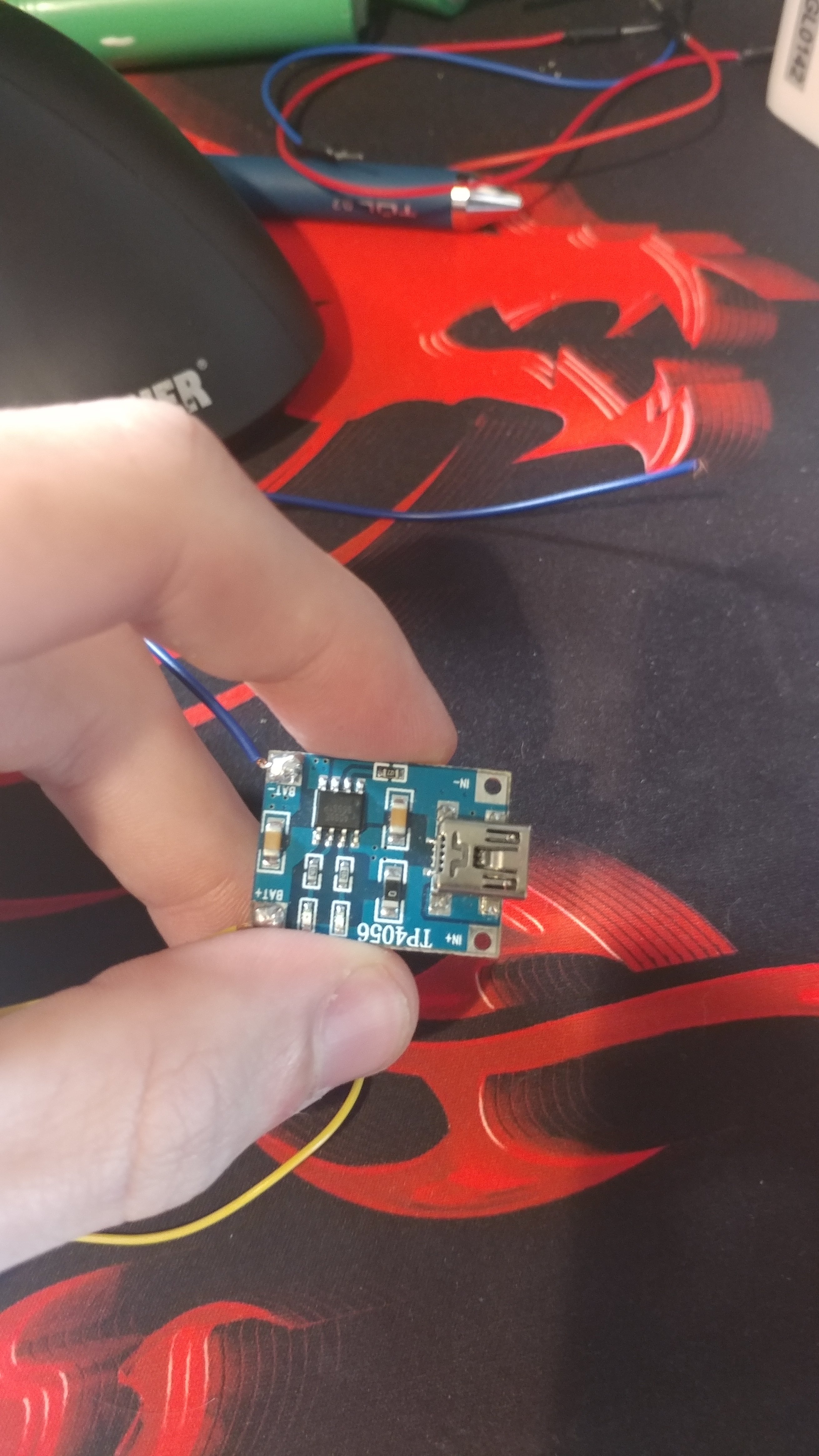

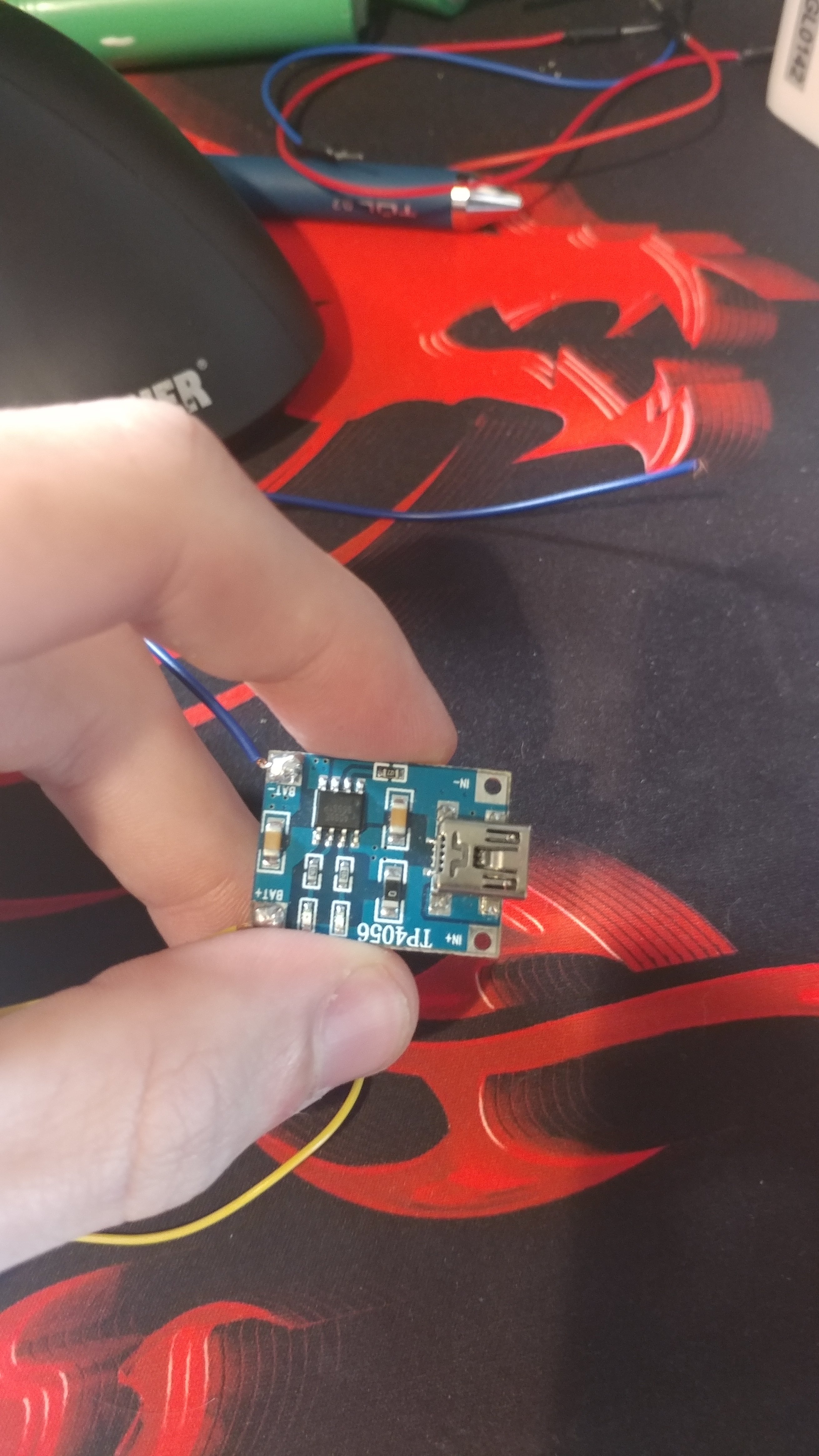

this is battery charger. Have to decide if i want it in the controller, or in my handheld. But it's a universal not micro, cause micro is expensive on ebay lol

Got the electrical tap in :awesome:View attachment 6181just to give ya an idea on how it will look closed up. With the SYNC button on the outside;)
View attachment 6182 this is battery charger. Have to decide if i want it in the controller, or in my handheld. But it's a universal not micro, cause micro is expensive on ebay lol
I'm not sure if I'm correct here or not, but I believe the default charging current for the TP4056 board (with a 1.2kΩ resistor) is 1A. If you didn't change the resistor responsible for setting the output current you might end up overcharging your lipo.
I've charged the Lipo battery 3× now to full capacity so i think it's okay lol... But if anyone else wants to chime in so i don't blow up the wii mote that'd be great:D
