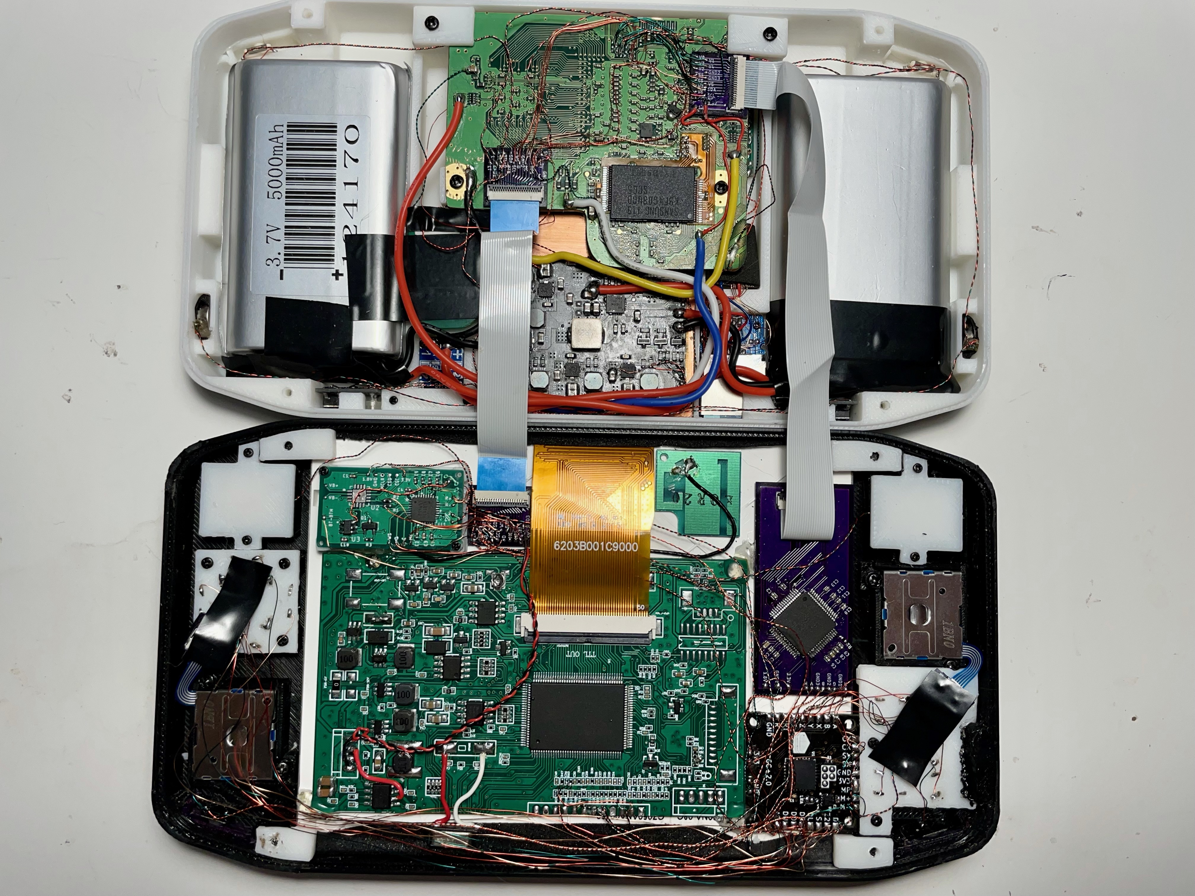

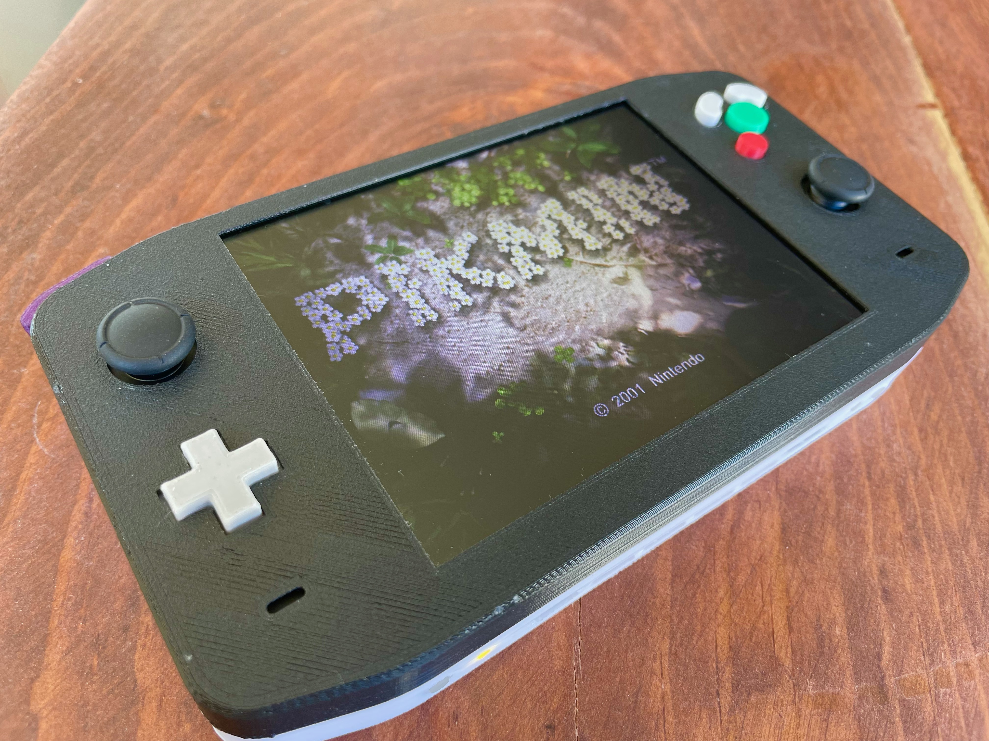

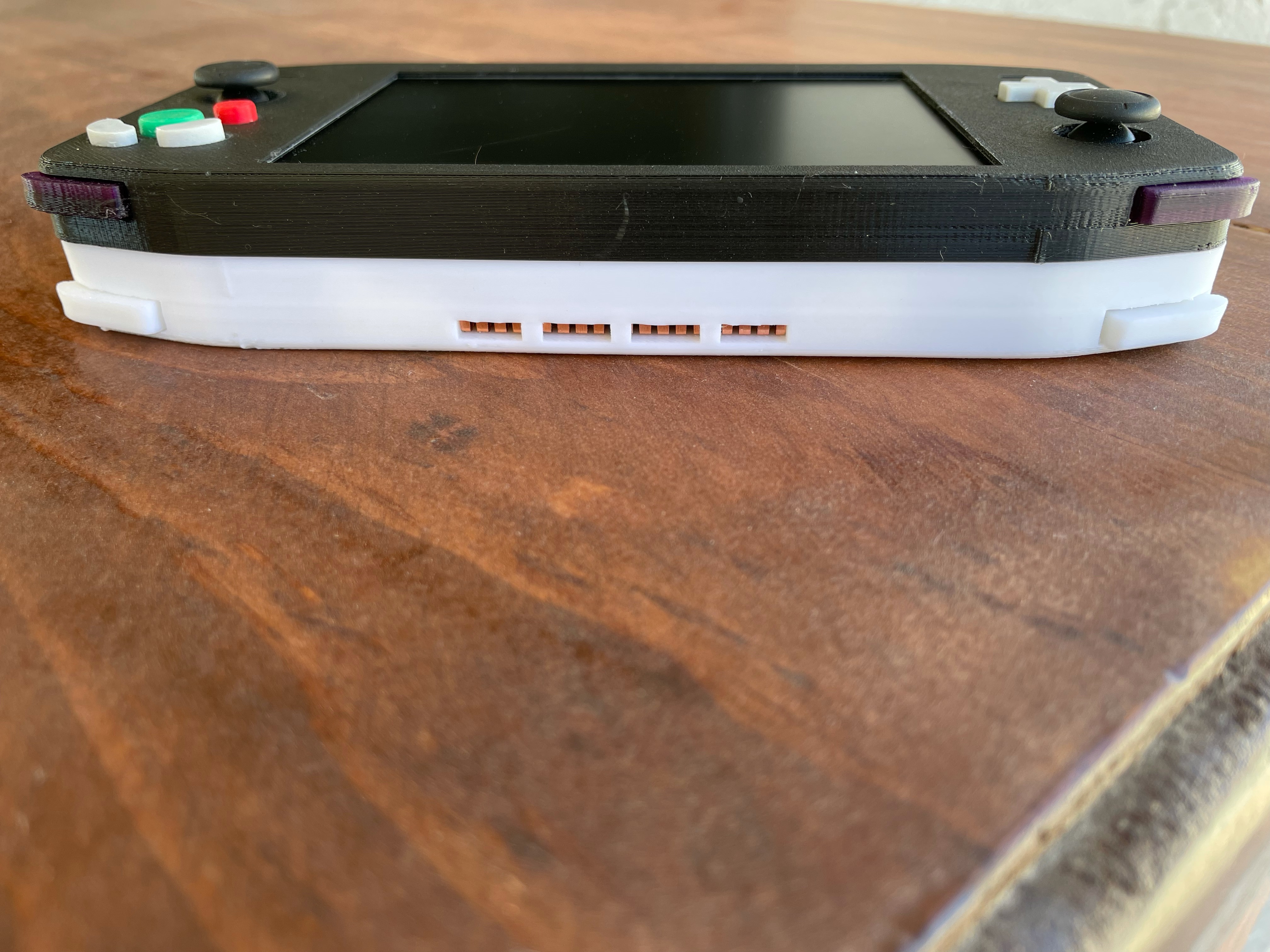

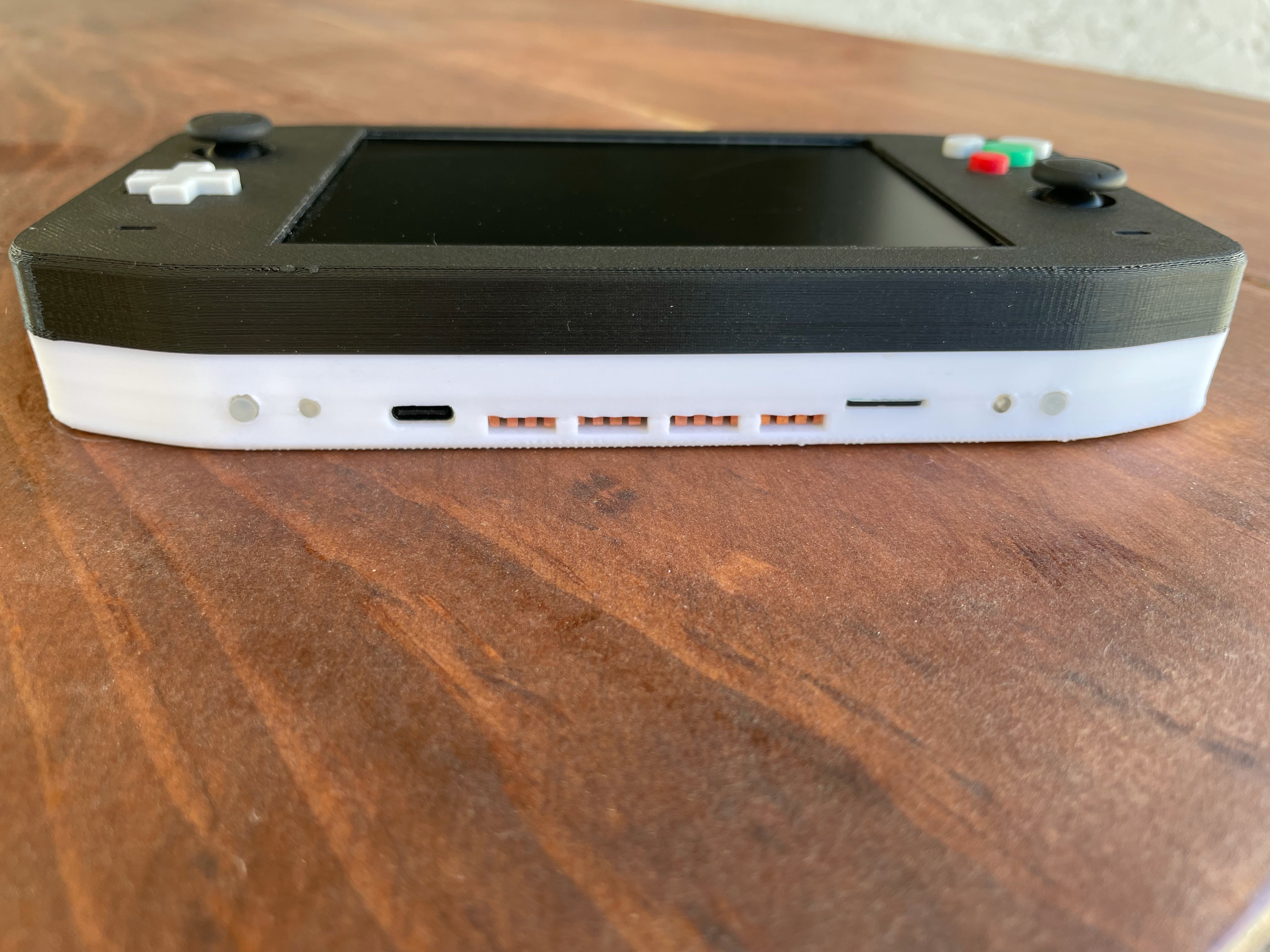

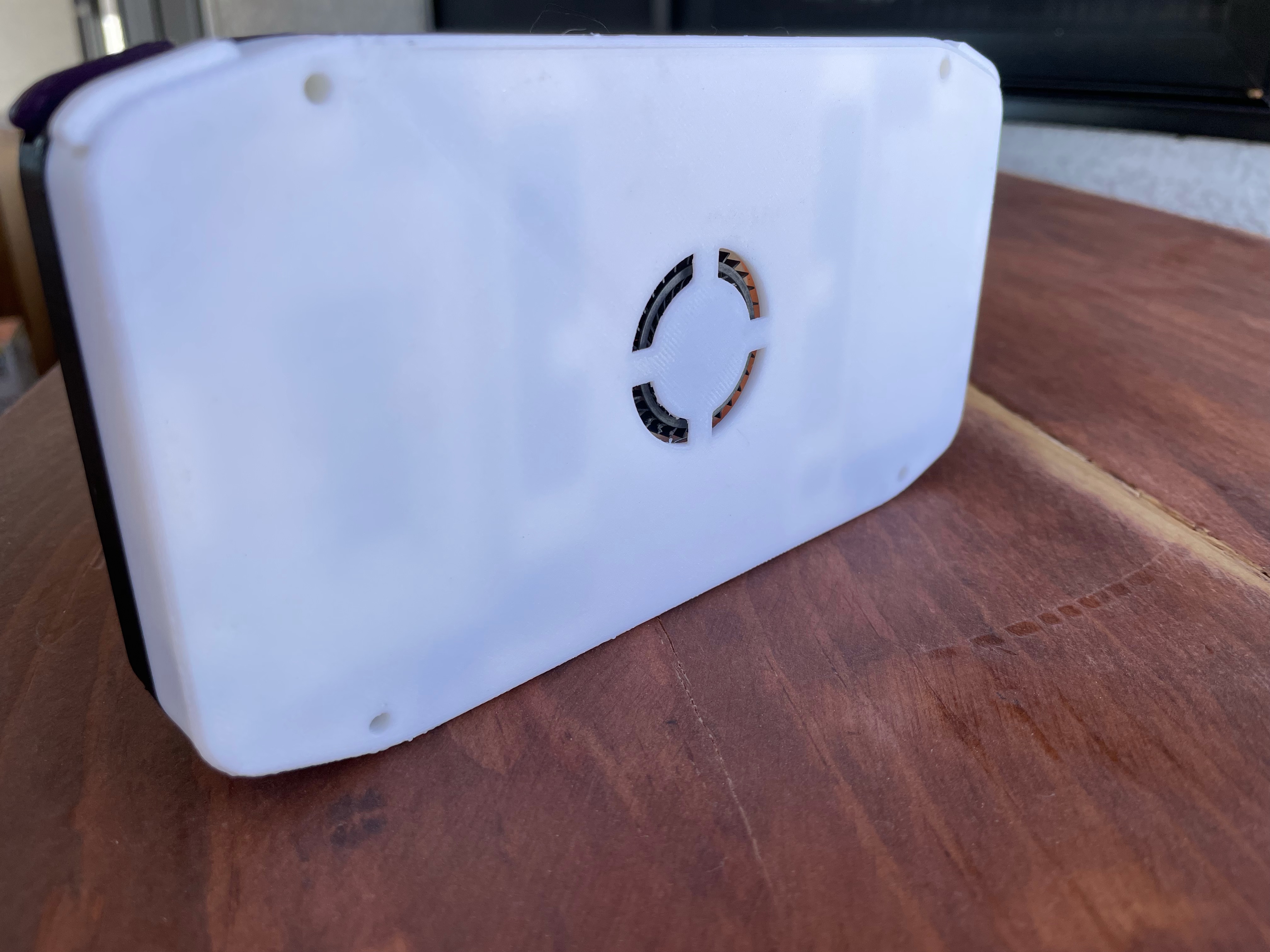

The Wii-C was intended to not be too complicated and to use some old parts I had laying around. It is complete and fully functional.
Specs:
- 5" 4:3 via VGA from custom relocated AVE Board
- Digital Audio & Bluetooth Audio for Headphones
- 10,000mah Lipos for 3.5 Hour Battery Life
- Dual Z Buttons
- Enclosed Speakers (For Better Audio Sound)
- Type C Fast Charging
- PMS V1
- GC+ 2.0
- Top Half Removeable by just 2 FFC Cables
- OMEGA Like Trim
- 3D Printed Case & Buttons
- Final Dimensions are 175mm x 94mm x 27mm

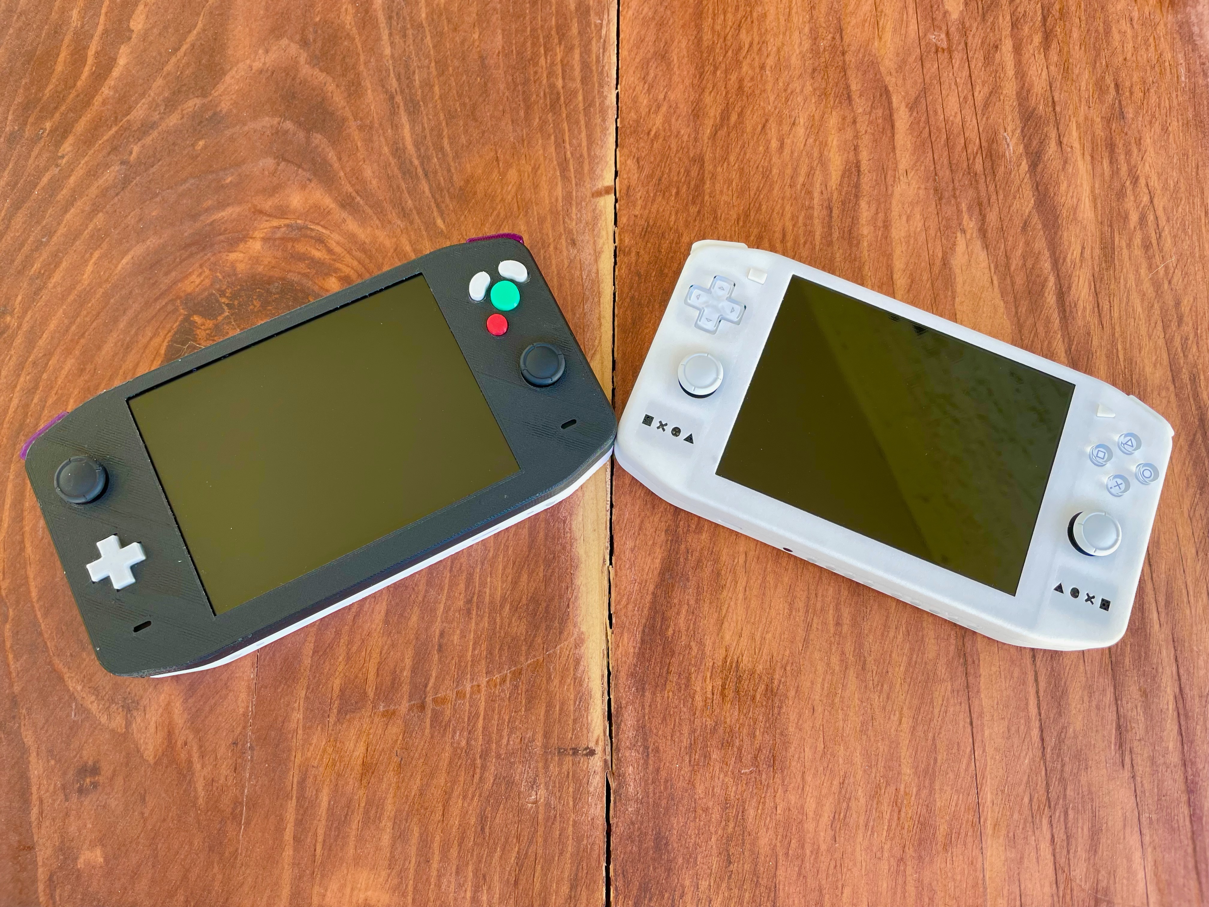

The Siblings
Nudez
Specs:
- Dual Z Buttons
- PMS V1
- GC+ 2.0
- OMEGA Like Trim
The Siblings
Nudez
