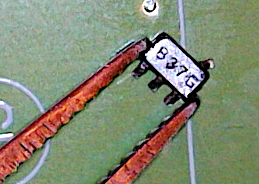

Hey all, I'm wondering if anyone has discovered exactly what the U9/U10 chip is. I'm trying to figure out if it is an off-the-shelf, commercially available component, or a custom chip that Nintendo or one of it's partners made?
It looks to be a SSOP5 package (the same footprint as a transistor SOT23-5 package) but since it is labelled U9/U10 rather than Q9/Q10 I'm 99% sure this is not a transistor.
One of my U10's that I damaged during desoldering has the marking B37G.
I'm wondering for a couple of reasons: a) I'm curious about the role this mysterious component performs, and b) I'm wondering if drop-in replacement chips can be found on mouser/digikey for people who damage their U9 and U10 chips.

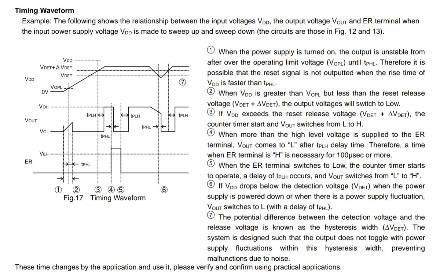

The U10 is a supervisory IC that generates a delayed 3.3V signal. It sends the signal to the Wii's Hollywood, letting it know that it's good to go to boot up.
Edit 2024-05-13: My old explanation was flawed. For future travelers: U10 holds its output LOW to keep the Hollywood in reset, until the 3.3v rail rises above ~2.9V, at which point the output goes HI-Z (floating) and the Hollywood comes out of reset.
It's probably pretty similar (if not identical) to this voltage detector IC: https://fscdn.rohm.com/en/products/databook/datasheet/ic/power/voltage_detector/bd45xxg-e.pdf

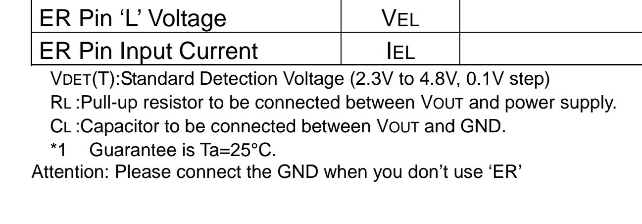

I'm eager to see if you can get them working. I ordered a couple a few weeks ago and couldn't get them to work on untrimmed or trimmed mobos. A deeper read into the DS indicates that the ER line might need to be pulsed to start the POR timer, but it also says that you can tie ER to GND if it's unused (which is what U10 seemingly does)
The sheet also shows application circuits with ER grounded. But I couldn't get the ICs to output 3v3 at all, even just hooked up to my benchtop PSU. Probably just a dumb mistake on my end. Please keep us updated!

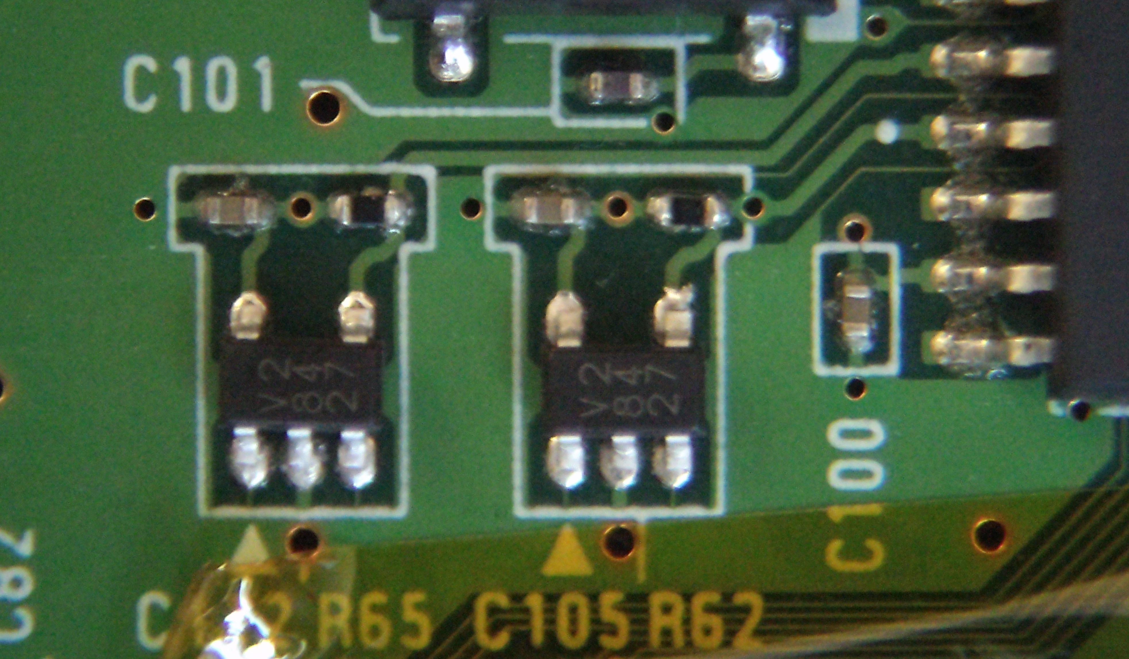

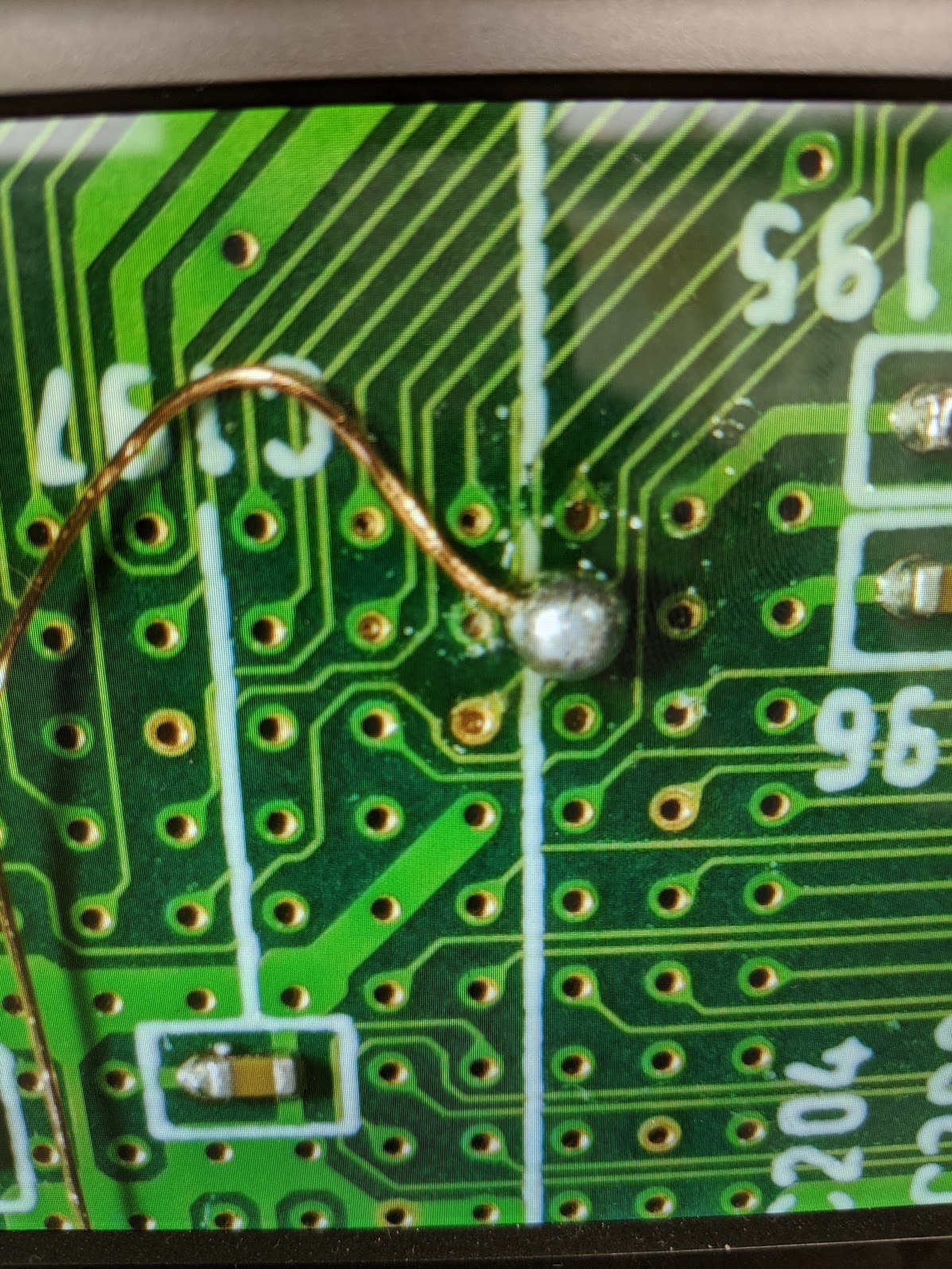

Just tried this out on an untrimmed 6 layer RVL-CPU-30.
Bad news, as YvenltalGriffin says it does not work as a straight swap out, the Wii does not boot.
I confirmed my wiring is ok by removing the chip and replacing with the stock U10, and the console boots.

There’s a decent chance that 3.3v threshold part is too high. I’m getting a parts order ready for something else and thinking I might throw in a 3.0V version. Then after a swap, I can test the original in isolation and see if I can figure out more specifics.
I ordered the parts but then I got impatient and pulled the original anyway. I can confirm my guess was correct - the original has a 3.0V threshold. Additionally, it is open-drain and has about 160ms delay.
edit: improved my timing measurement setup a bit. This particular unit has a very consistent 169.6 ms delay. I’ll know for sure in a few days but I’m very confident at this point that the BD45302 will be a drop-in replacement.

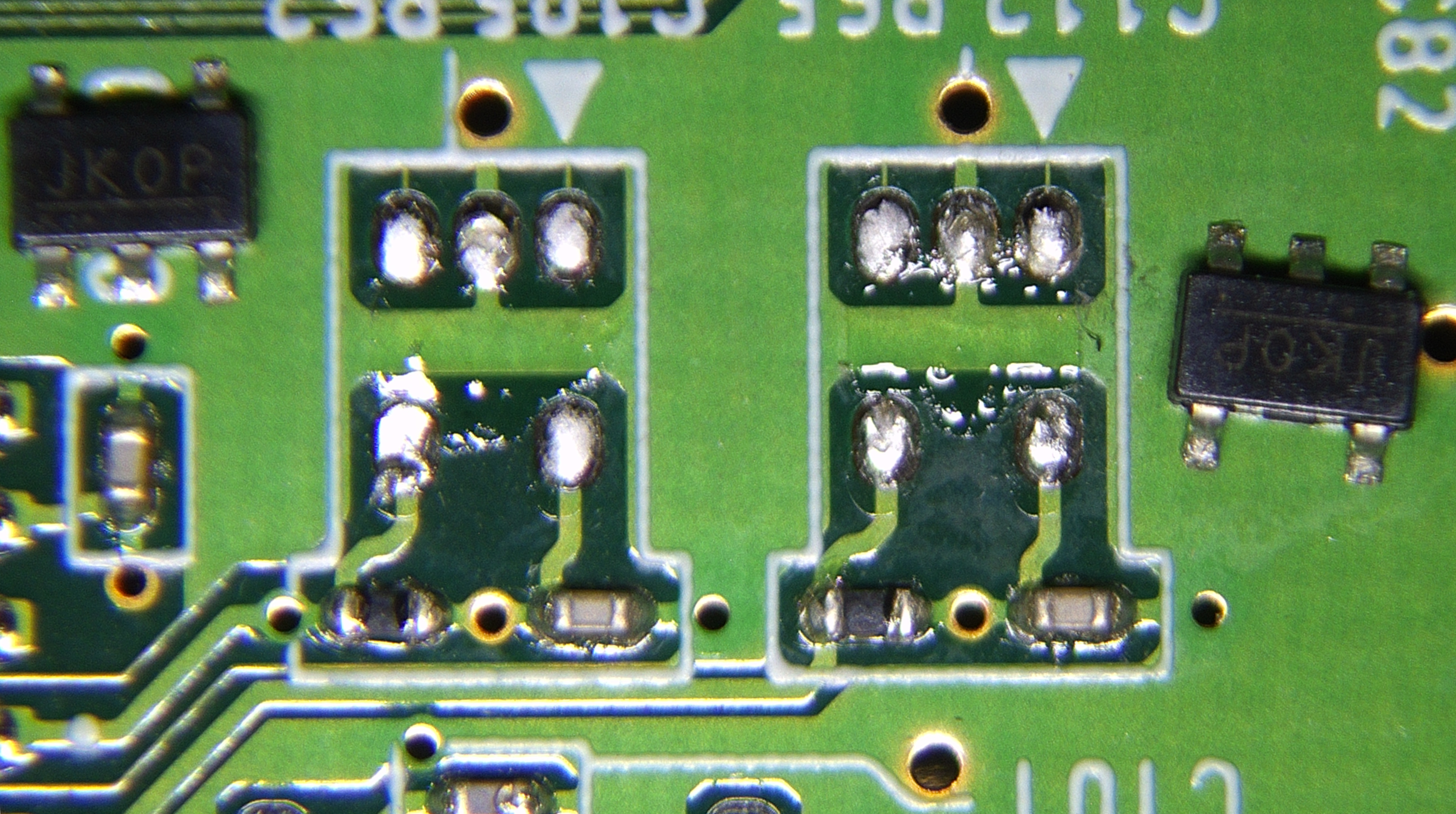

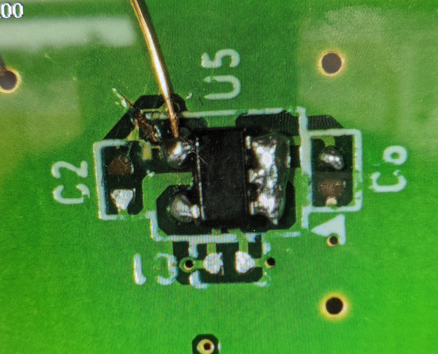

Final update - swapped the new parts in (replaced both U9 and U10 with BD45302G) and it works :D. Booted right up like nothing had changed at all.
