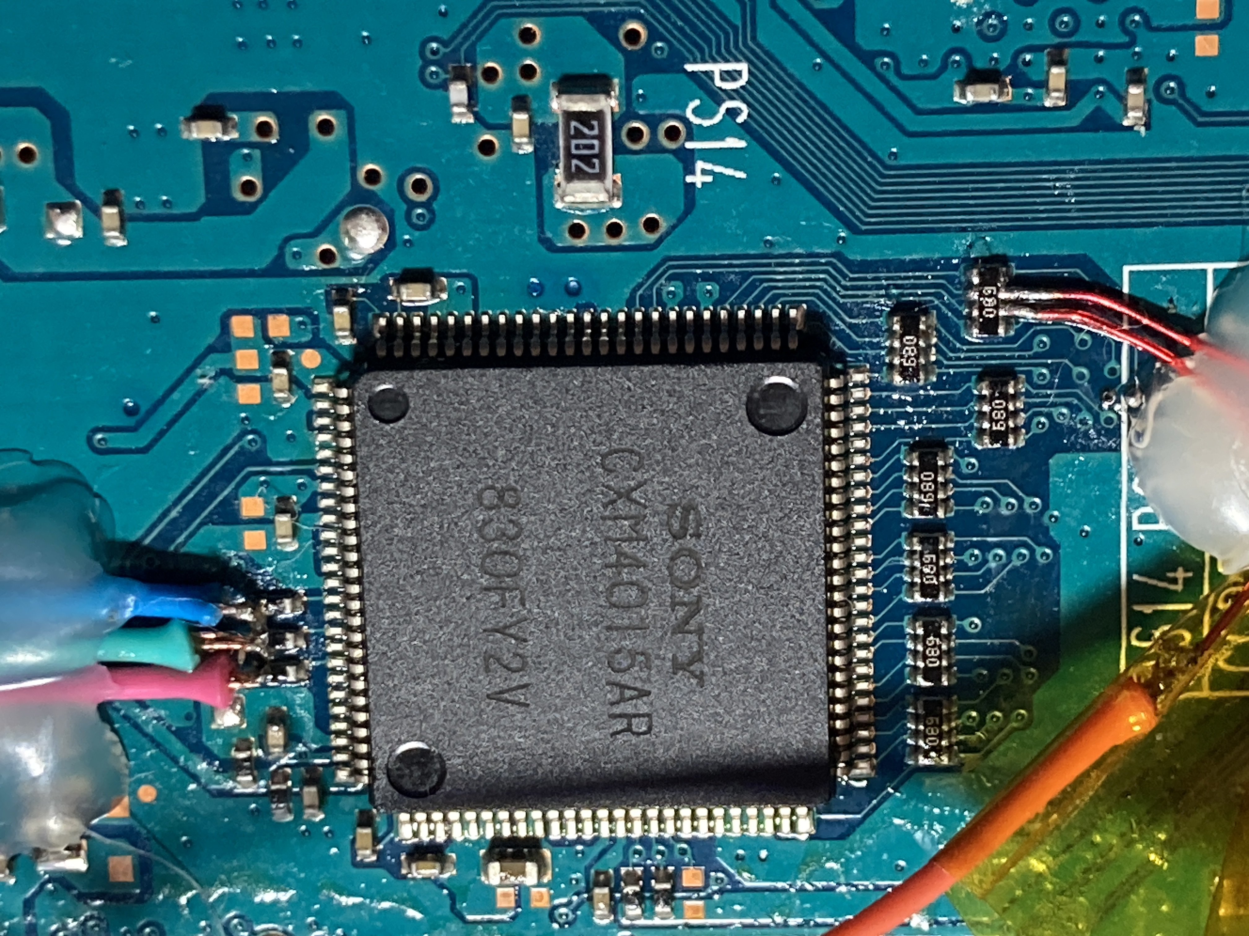

Hello, I am trying to get VGA output from the Ps2 model 90004 and I get the image displaced I have connected all the cables (I think) that in place, but I think there is something that I left that makes the image is not centered, someone could help me? greetings

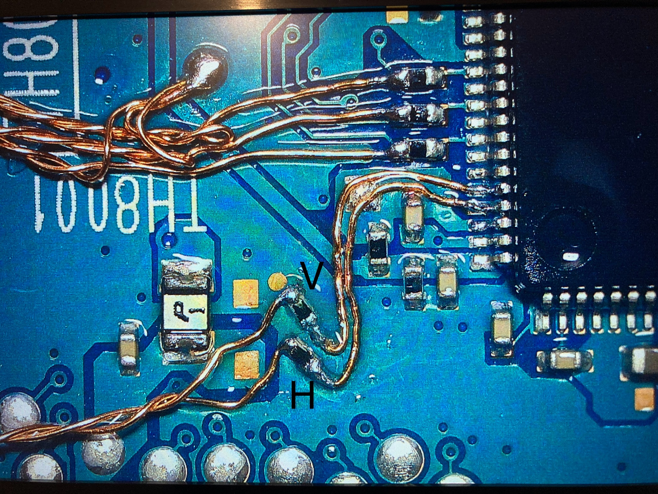

Have you tried grabbing the H and V sync from pins 22 and 21 on the other side of the DAC? The logic level on the input side is only 1.2 volts.
Might be a good idea to use resistors on them as well, 75Ω should suffice, same as ones on the RGB lines
thank you very much for helping me I will follow your advice and report back to you.
Do you mean to take the H and V points directly from pins 22 and 21 of the video DAC ?
"H" in PIN 22 and "V" in PIN 21 ? are you sure ?
Pretty sure, but you can look on page 11 of the 70000 service manual for confirmation.
My board is a 90004 but it has the same video DAC, I'm going to take out those points and put a 75 ohm interleaved resistor on it.
Is it ok like this ?
I tried it and it doesn't work either
That's a bummer. Sorry I wasn't able to help. Only thing I can suggest is trying to use C-Sync to get the H and V signals. A guy who called himself Ashen on the old ModRetro forum did it like that years ago.

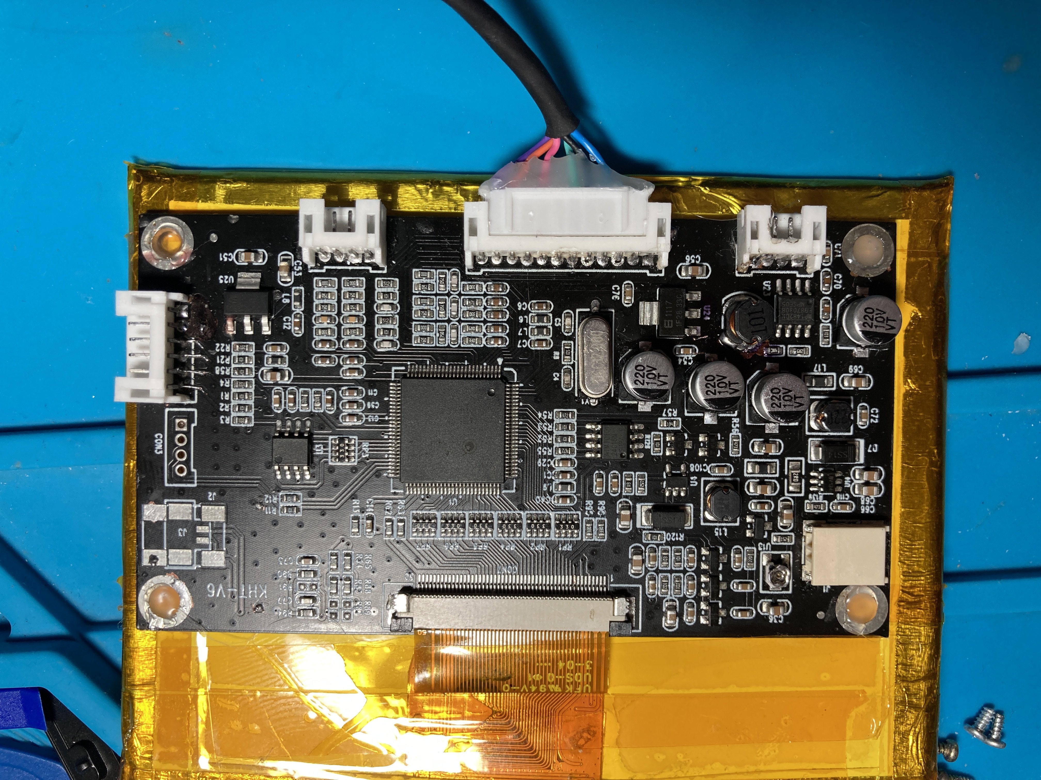

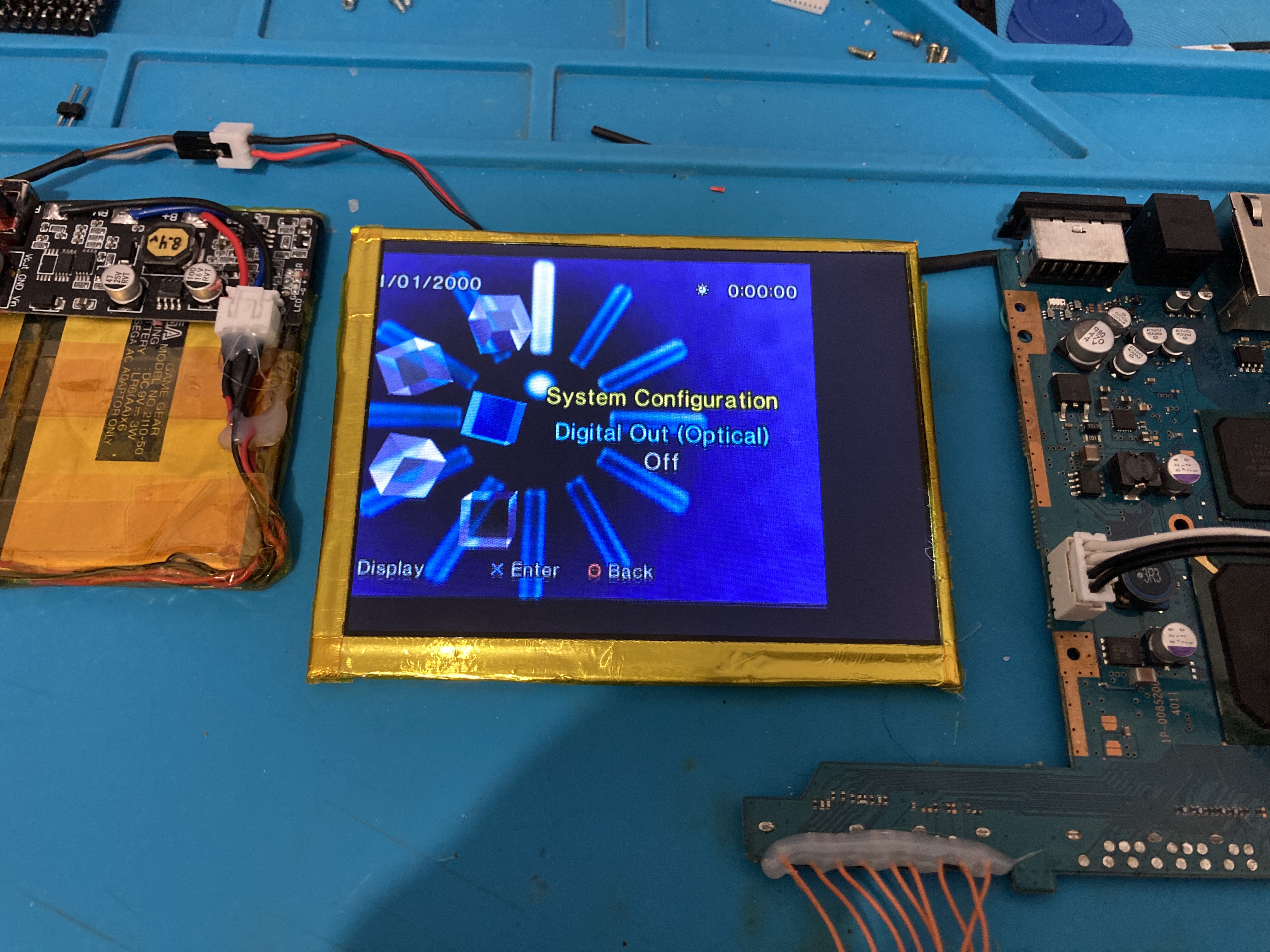

It is off-centre in the ps2 menu but in the opl menu I can configure it and I can centre it. I don't understand why in the ps2 menu it is offset.
I don’t know where I saw a post but they used the lcd button controller to enter menu then reset settings it might re adjust the display.
Enter the menu but there is no reset option.
Is there an option to adjust the h or v, can you post picture of screen menu
