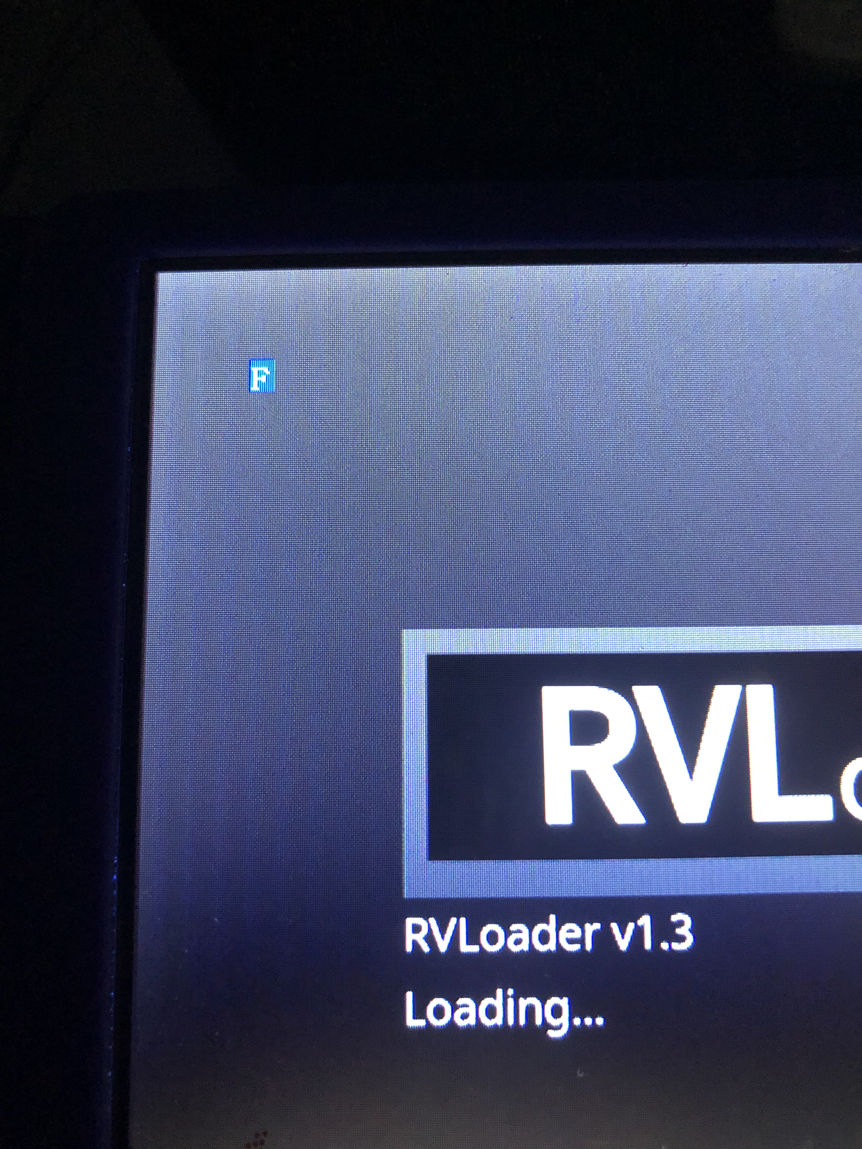

I just discovered something helpful about the ZJ050NA-08C 5 inch screens/driver board we use these days... I always wondered how to access the RGB levels and it was no where to be found in the menus. Chalked it up to poor design choices.
Well, I just turned my g-wii on while it was balancing on the bottom edge where the screen controls are and noticed a little green F in a blue box...

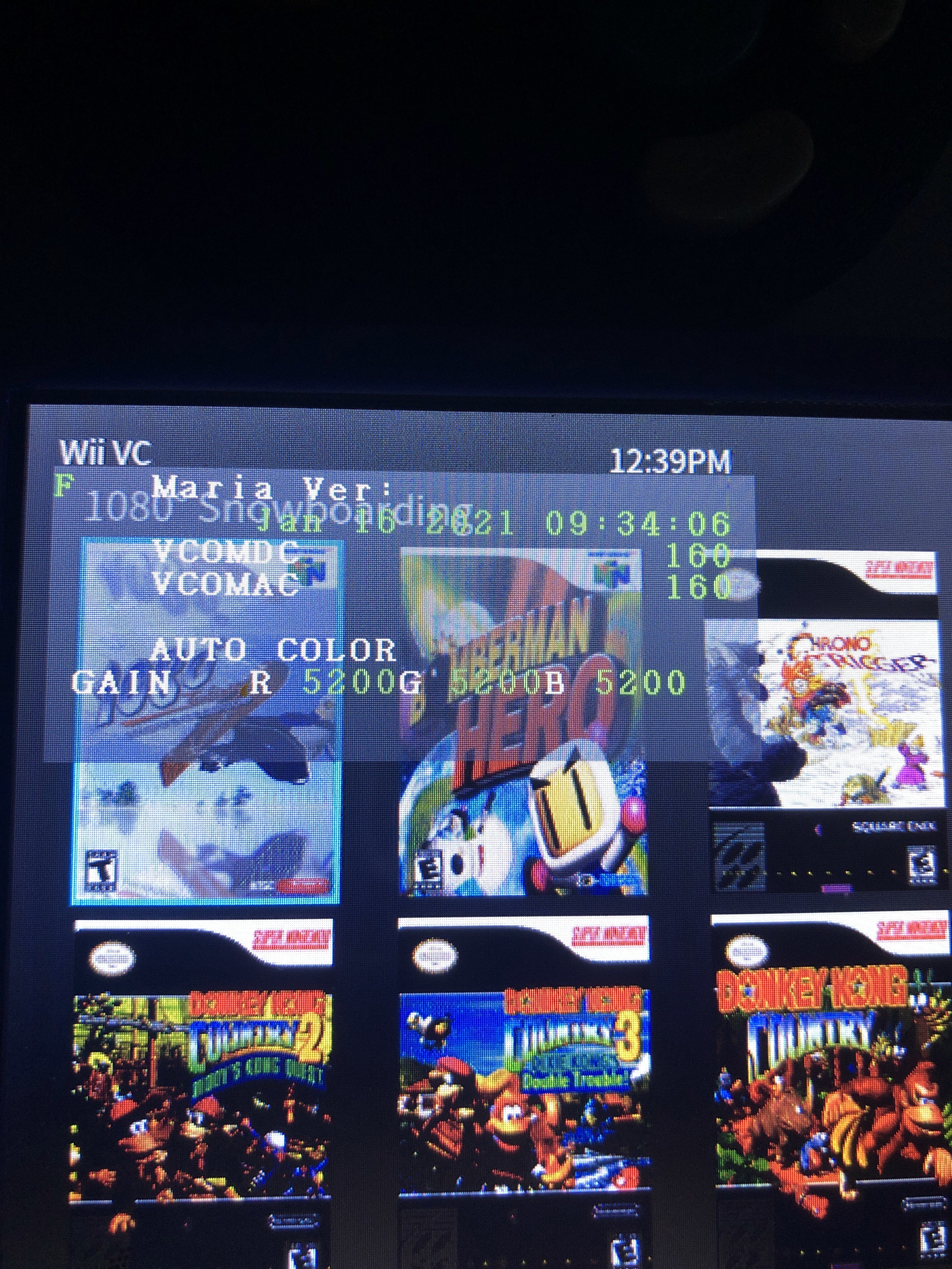

"Weird", I thought. Pressed menu and bam, discovery of RGB adjustment and something called VCOMDC and VCOMAC which I think is some sort of PMW output or something. I couldn't figure out exactly what it was... But the way you get to these settings is to hold the MENU button as you power on the device/screen.
I do wish this board did H and V scaling ... but this is definitely better than nothing.
Once you power cycle again it will be regular menu behavior.
