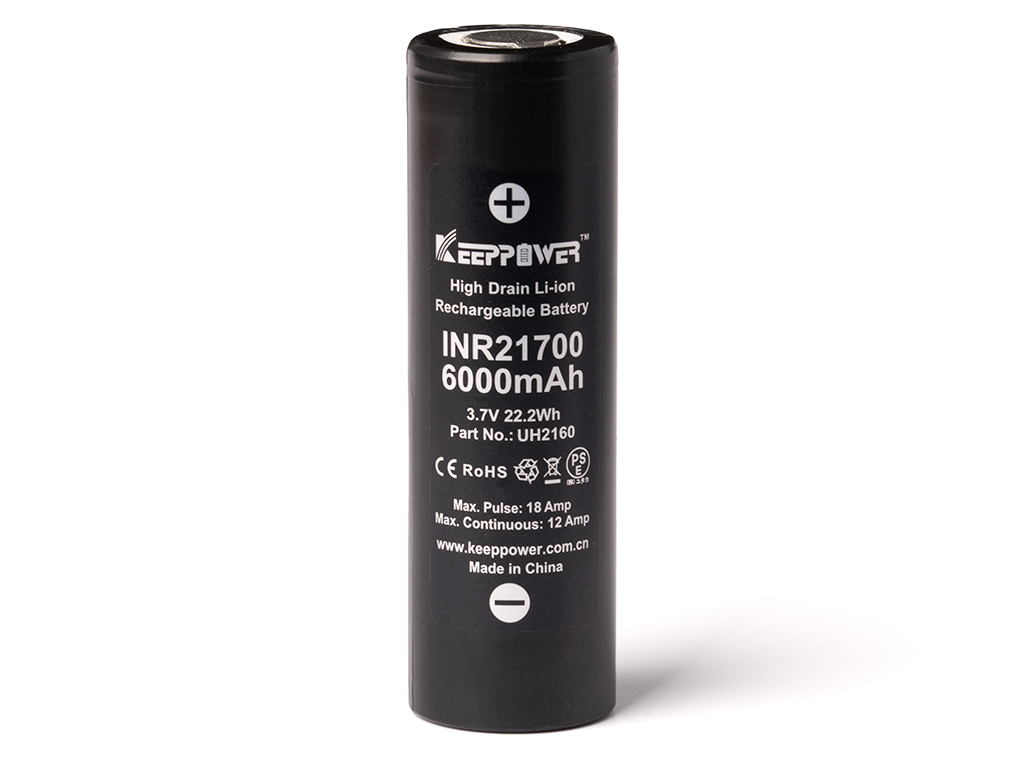

I want to upgrade the battery time on my ashida. I have the two Samsung 4900mAh inside my ashida and saw that Vapcell and Keeppower offer 6000mAh batteries. that would be 2200mAh extra battery time that would be great. Did someone used them before? They are no knockoff batteries they really have 6000mAh.

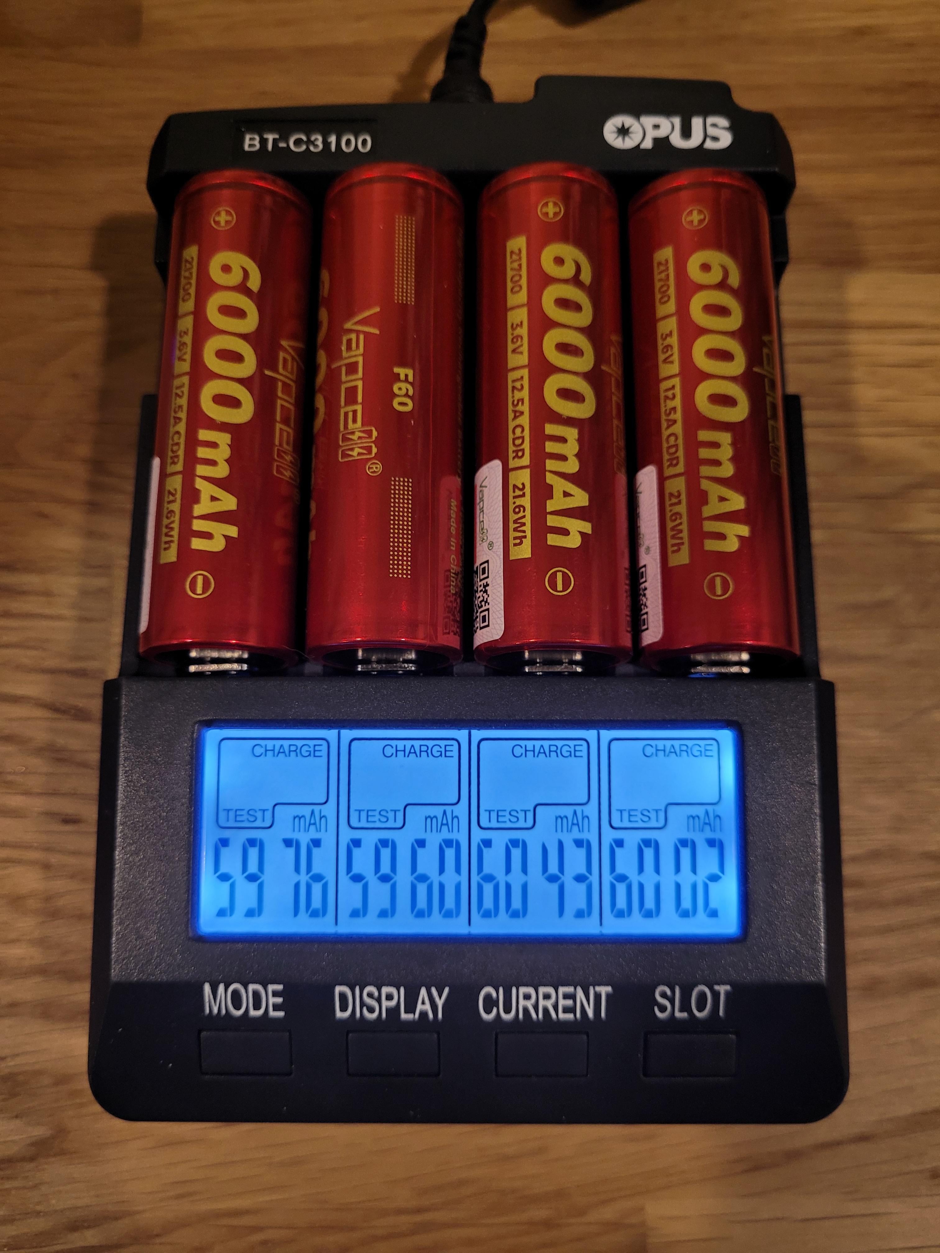

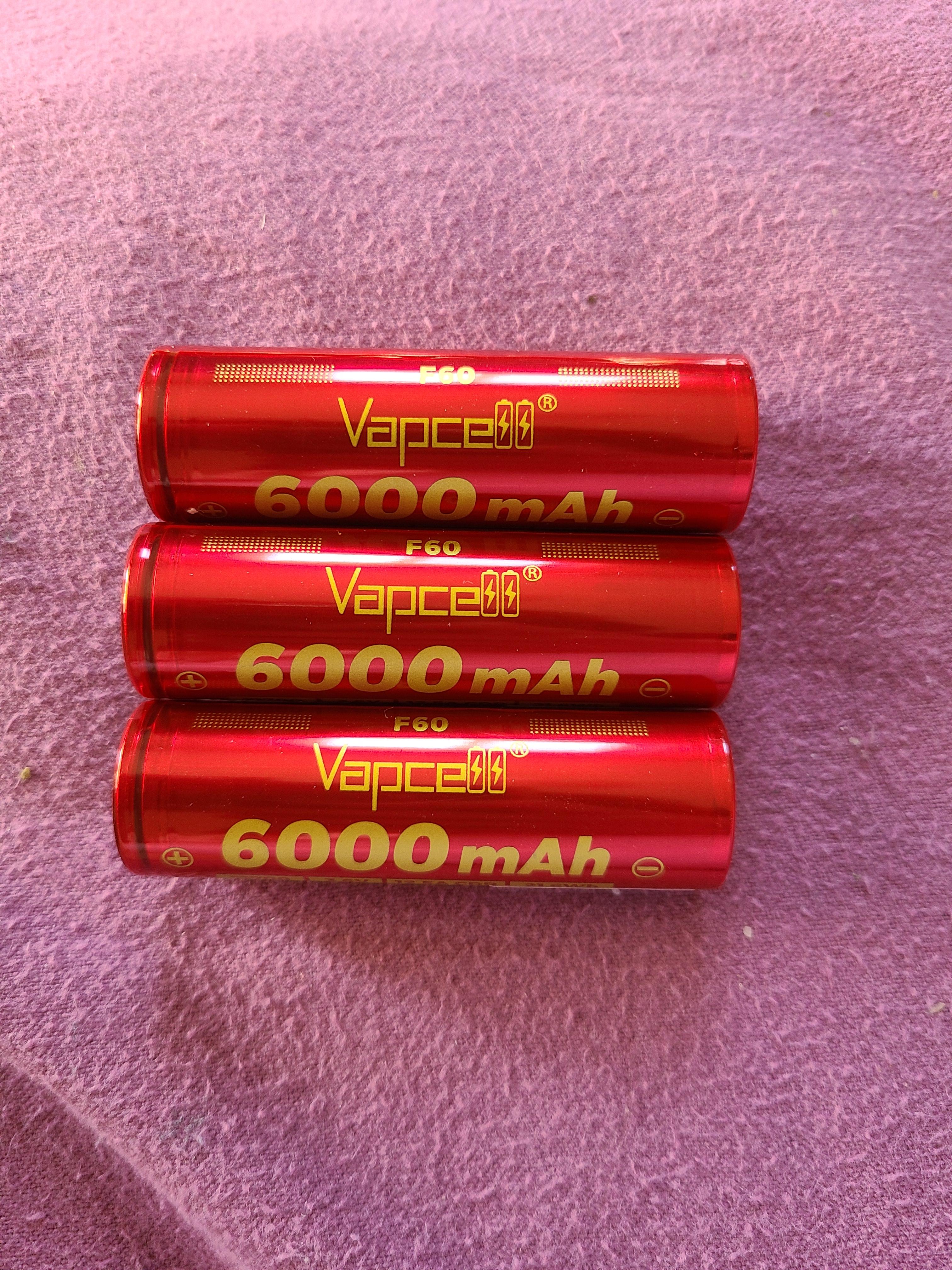

I saw some tests of it in several german forums for flashlight batteries. I give it a try and give everyone feedback in my thread here after that :-)

I don't see a reason to be wary. Mooch's tests on BLF indicate the capacity claims are legit.
They're actually optimal for our usecase, because the additional capacity is only accessible at low discharge currents (<2A per cell). Wii portables use little power and usually discharge at 500mA - 1.5A per cell (depending on pack config.)

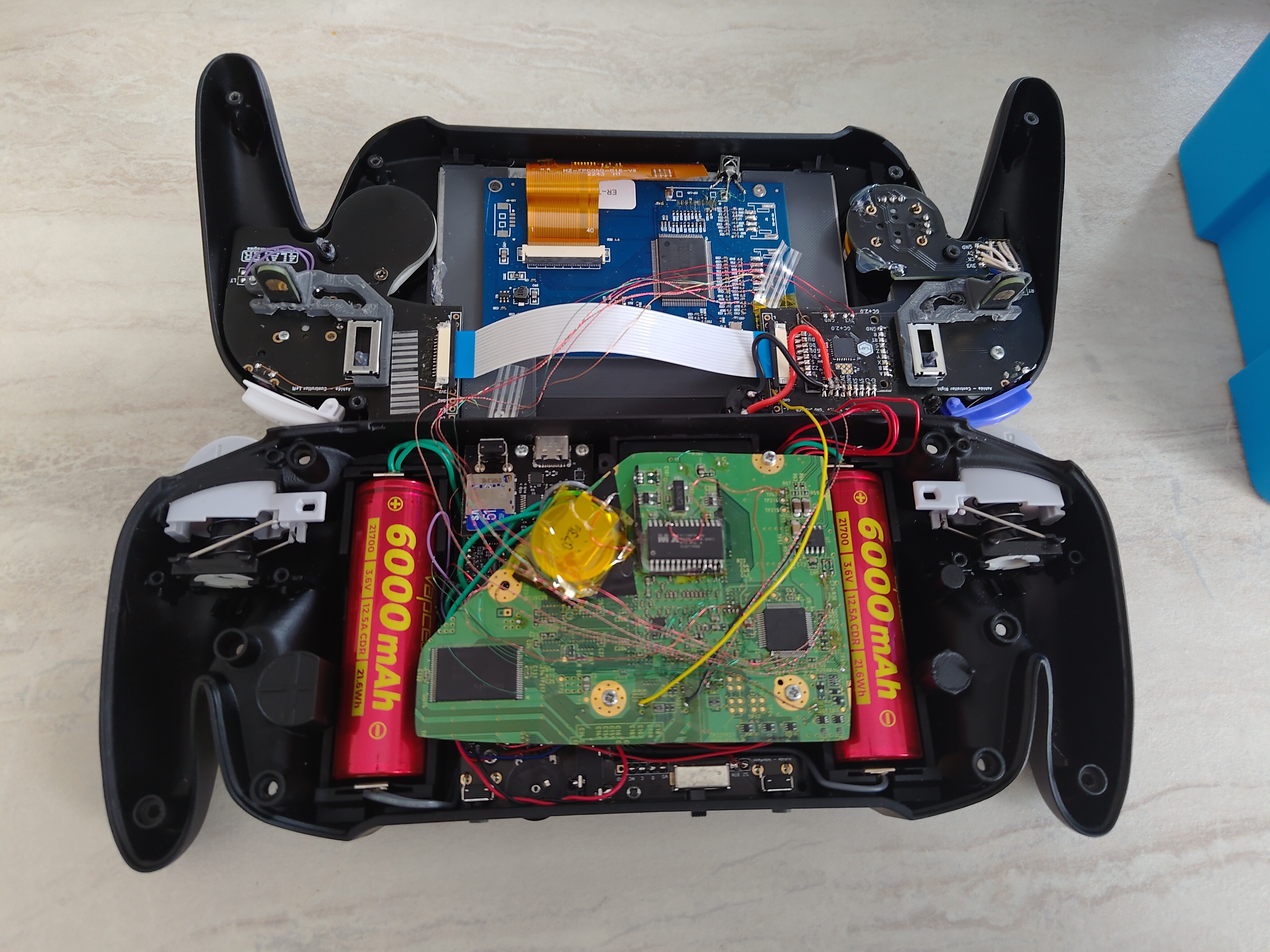

Update: Got my batteries today, they fit perfect. So anyone that wants to upgrade their Ashida's battery life go for it :-)

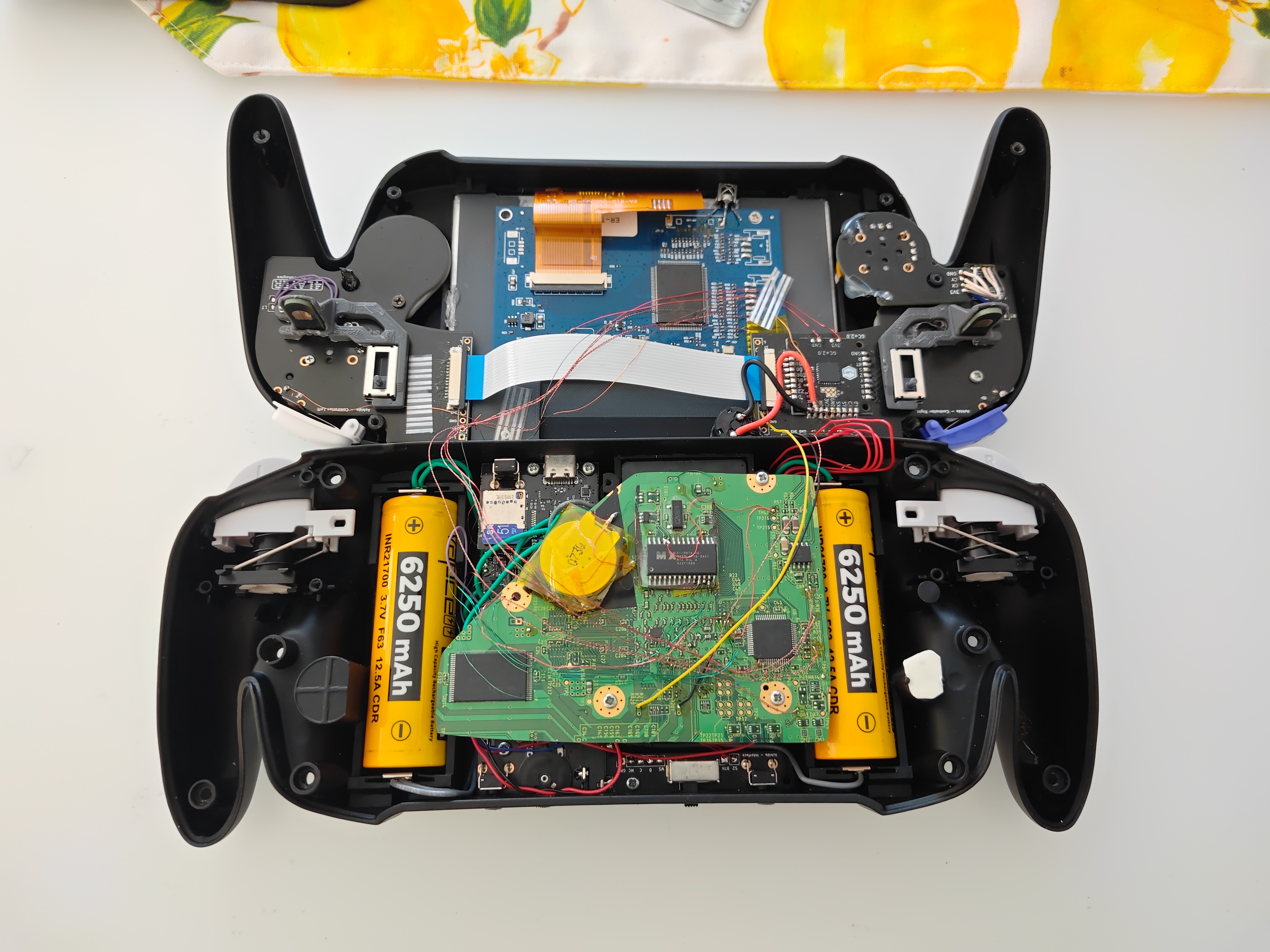

there are new ones available now. With 6250mAh. I try them now.
