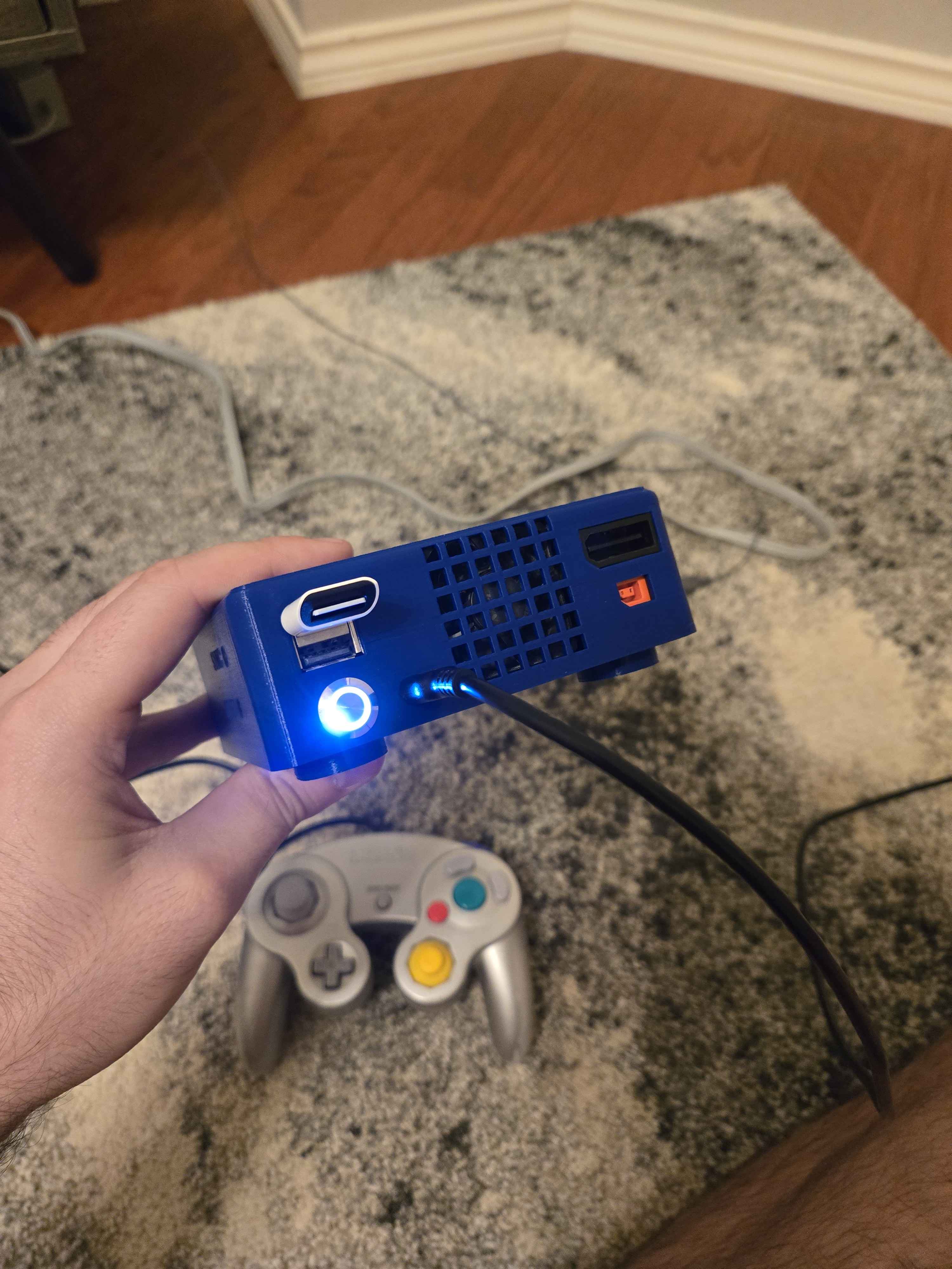

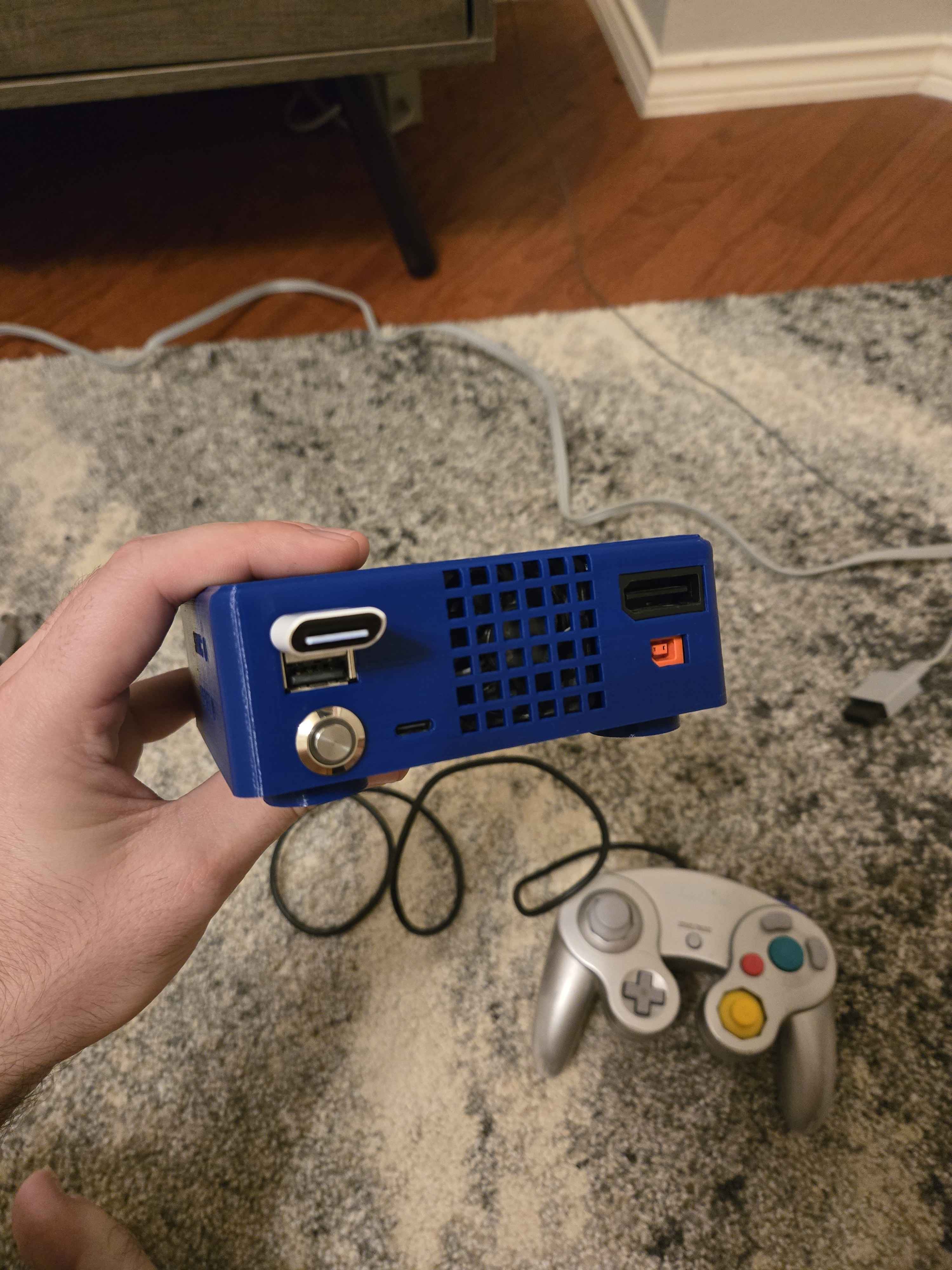

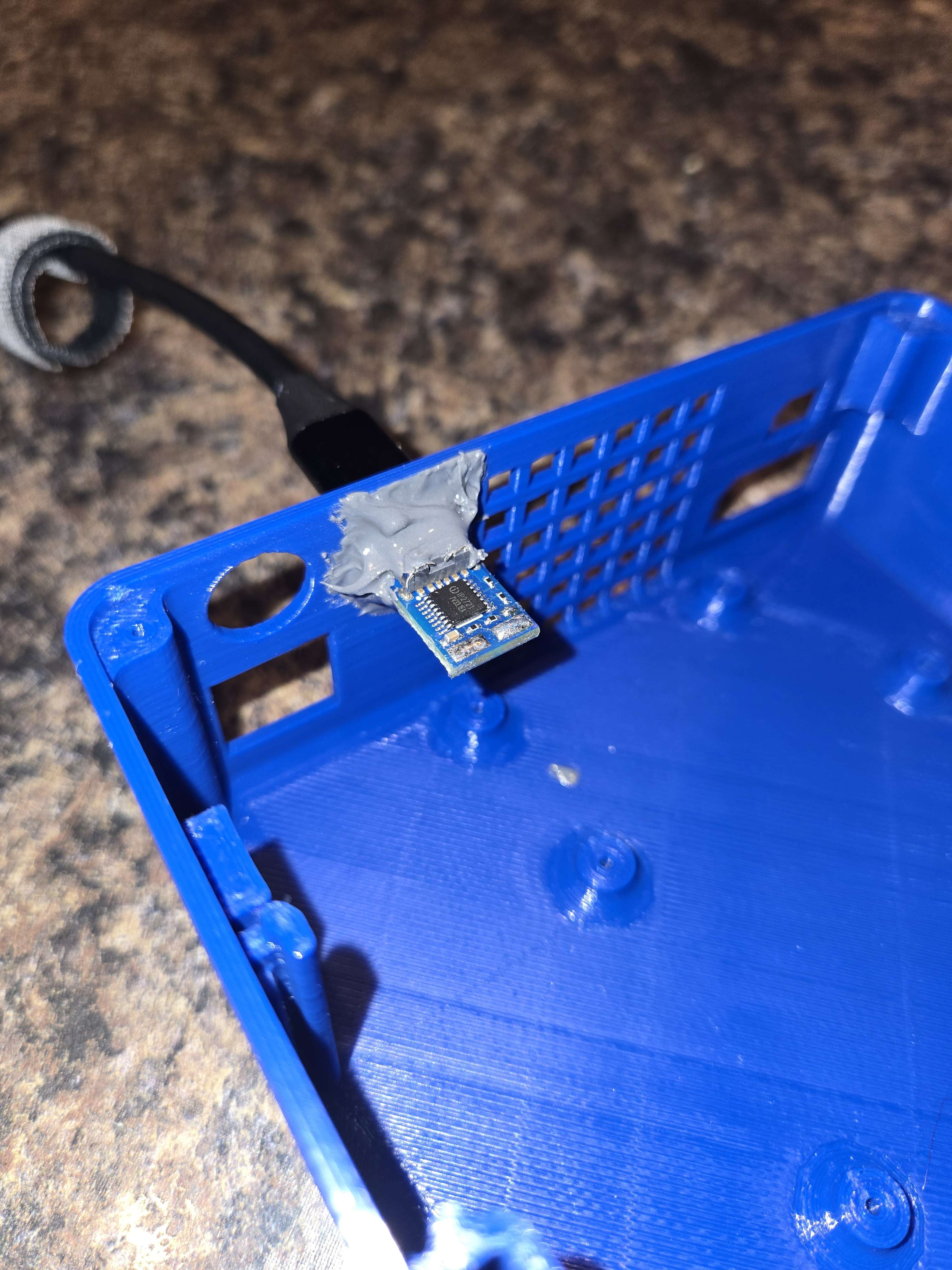

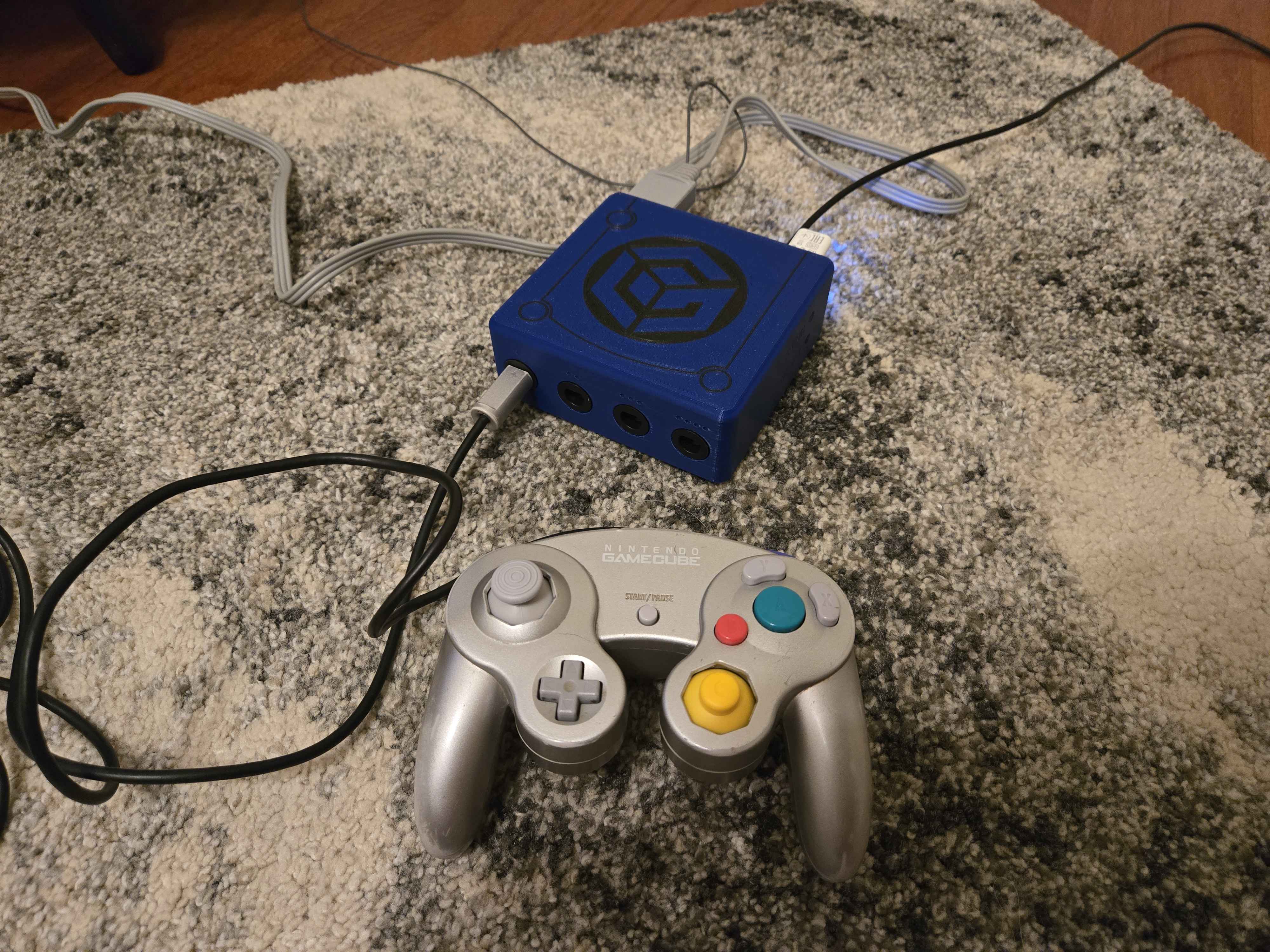

Hello everybody,
I finally finished upgrading my Noldendo to support USB C powering. All I did was fill the power hole of Nold's STL file in Tinkercad, and added a USB C size hole that I made in Fusion 360. Hope you guys enjoy the pics! If anyone has any questions or advice on how to improve this, let me know!
20240922_222434.jpg20240922_222417.jpg323984.jpgrn_image_picker_lib_temp_bc29cd2c-0e5d-4c02-abd0-6b0b4d96d44c.jpg

Hi, here's a link to the USB C board and power supply I use
USB C board: https://a.co/d/6sRxPDc
Power supply: https://a.co/d/8IMe347
For the USB C boards, you can convert the 9V board I linked to 12V by soldering two pads on them, or just buy the 12V variant for $5 more. For the power supply, realistically you just need 12V 3A supply, although you could likely get away with less amperage. The benefit with going 12V is you have a direct line to supply the circuit that does the voltage conversion for the sensor bar port.
With regards to the 15V switch charger, the RVL PSU I used for my Noldendo supports 5V-17V in, so you could find a 15V USB C board and use that, but you would have to step it down to 12V for the sensor bar circuit.
