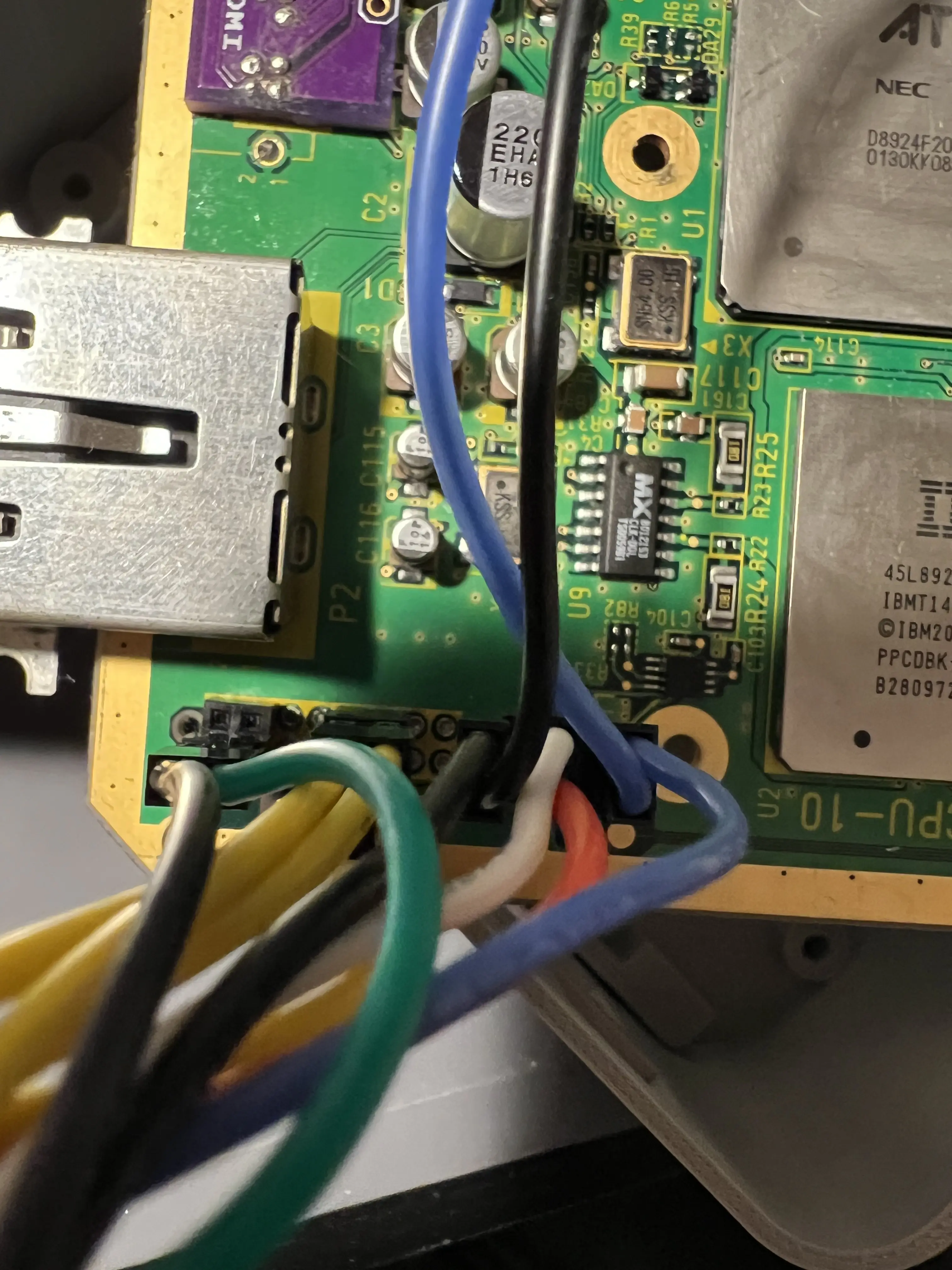

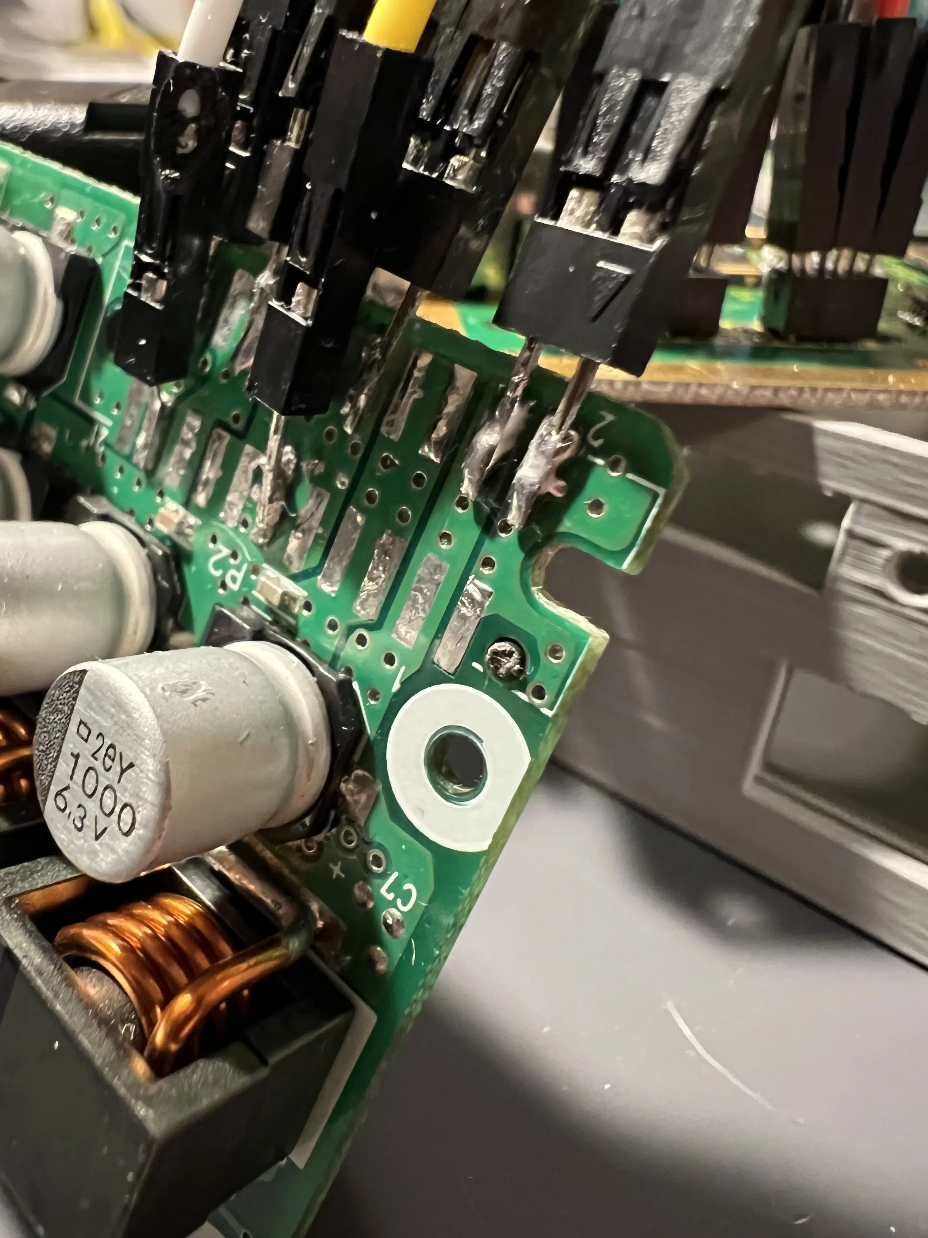

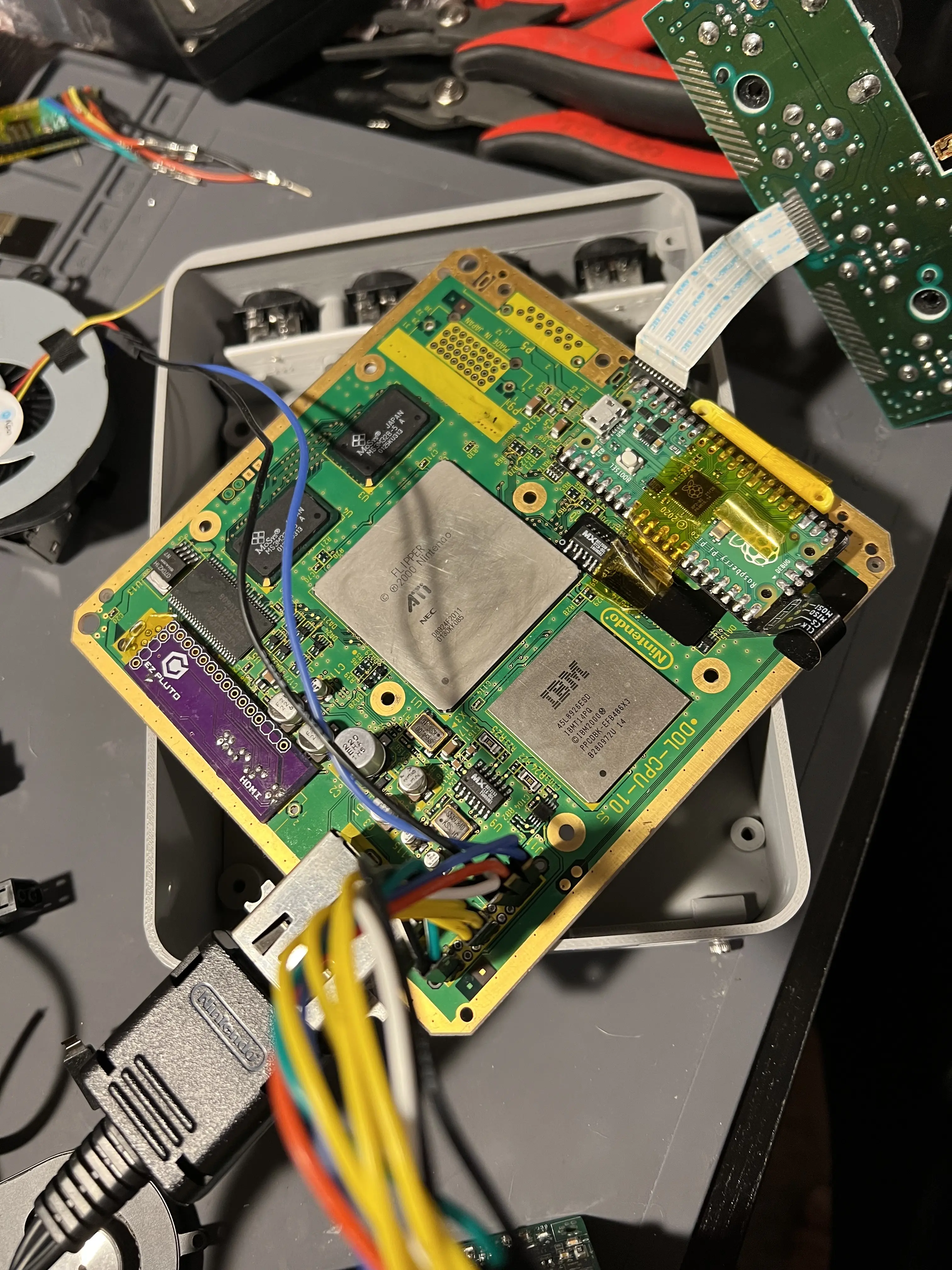

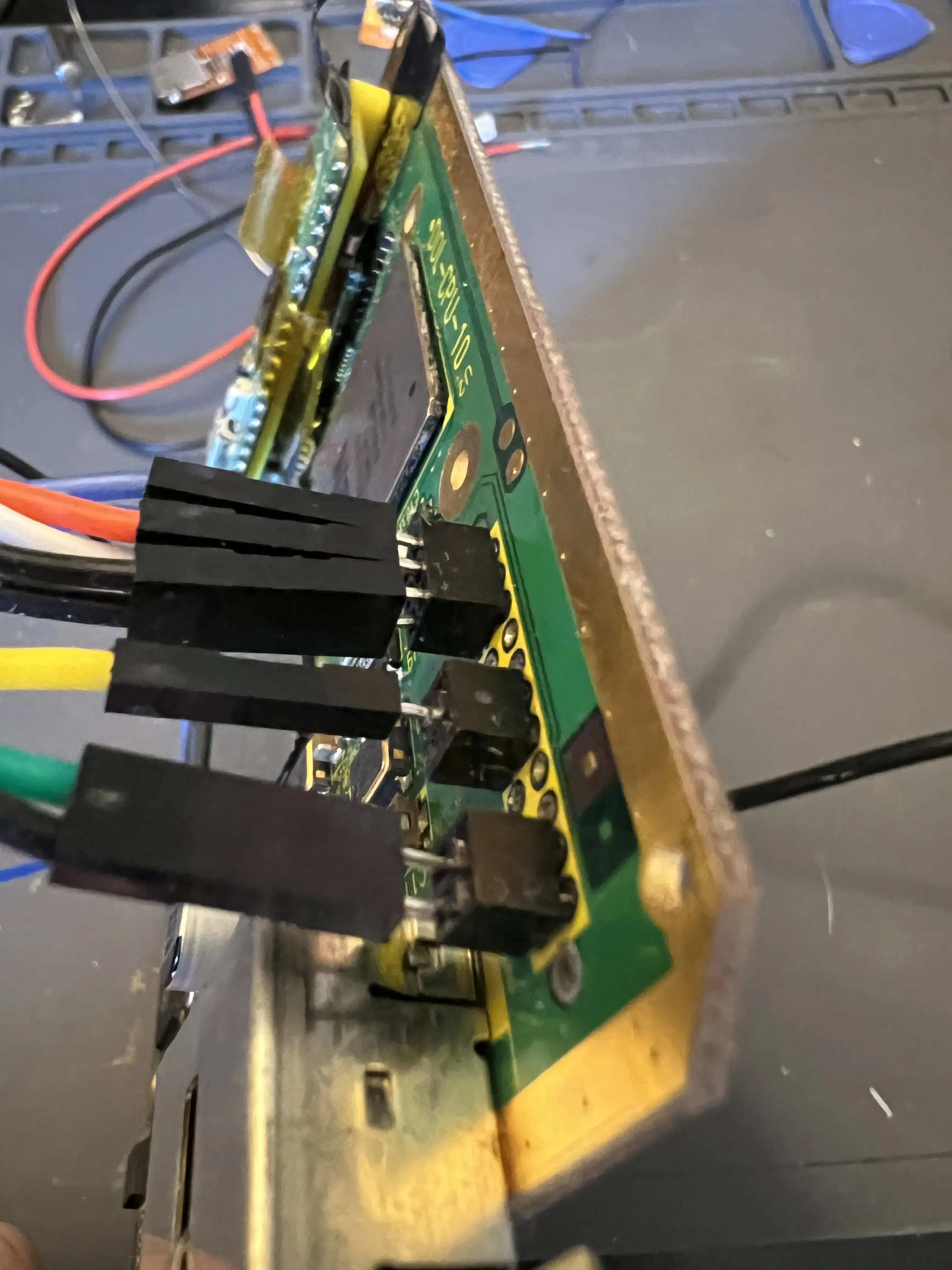

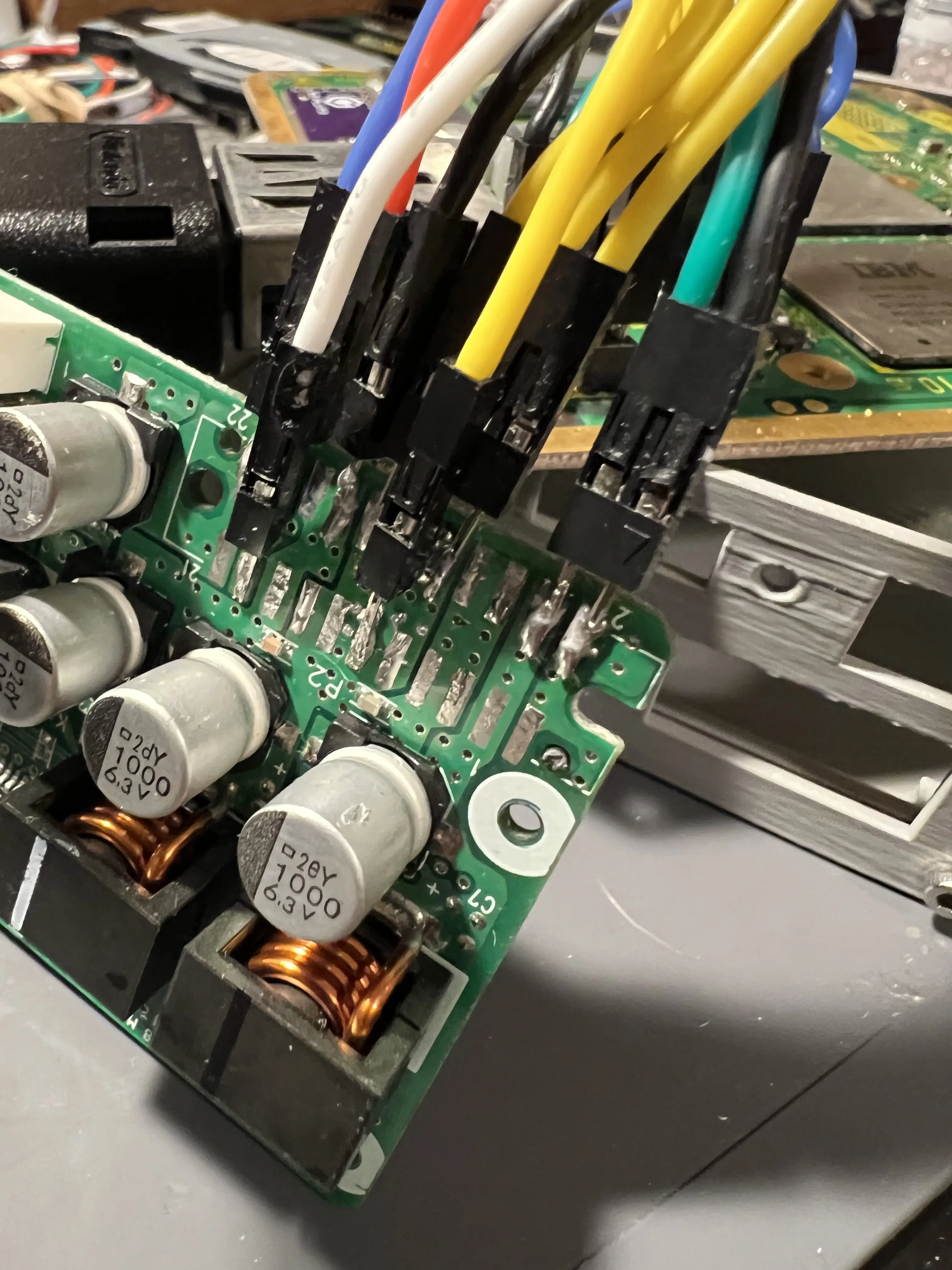

So I’ve been working on a GameCube slim of sorts with an extra dol001 mobo and I recently redid how the connection to the power regulator board is and went to test it and the led on controller ports lights up, raspberry pi lights up, but nothing out of the video cable.
I even tested that all the voltages are correct and coming through the regulator: 1.9v, 3v3, 5v, 12v, temp safety.
I’m not sure what else might be the issue. It worked before for the record.
So the female headers in mobo are 2.0mm pitch
Wires are 22gauge with 2.54mm DuPont

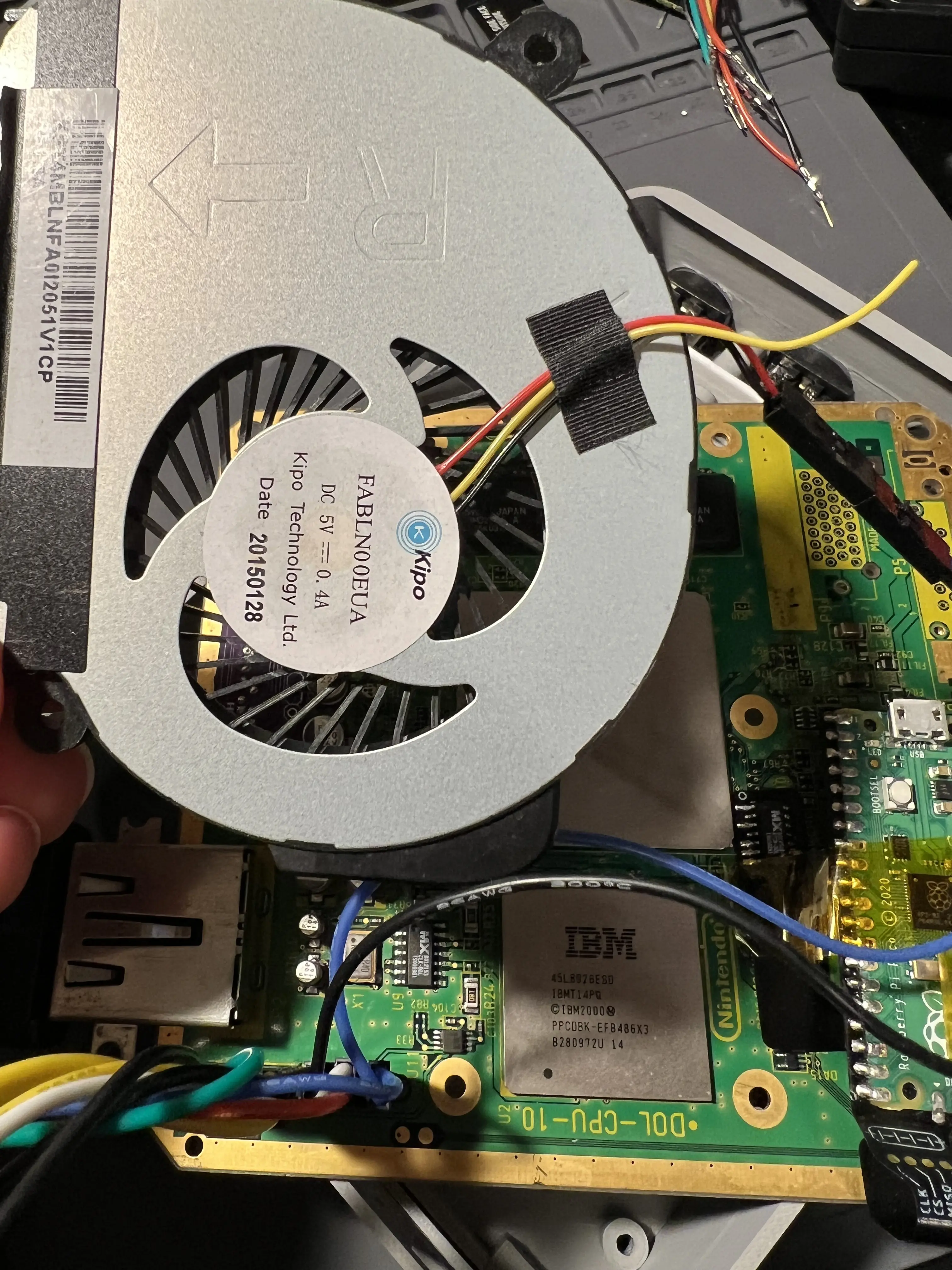

The extra blue and black wires are 5v GND to a laptop fan. That didn’t spin up so not sure if I blew the fan somehow.
The voltages all seem right but I only know what they should be at this spot on the board. I’m hoping I didn’t fry the main chips.
