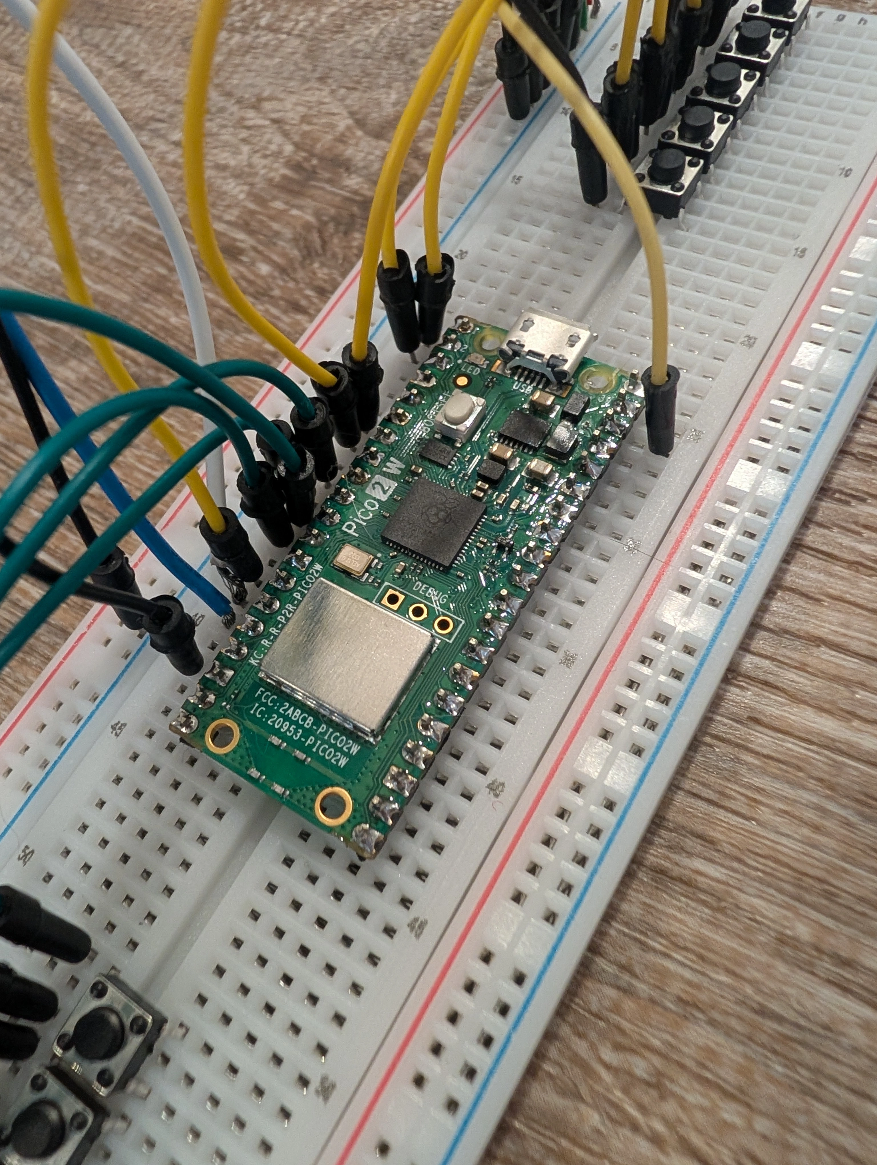

I am having trouble getting MaplePad v1.5 (https://github.com/mackieks/MaplePad) to run on my Pico 2W (RP2350). Seems like the issue might be related to MaplePad being designed to run on an RP2040, and there's some addition step I need to take to get it running.

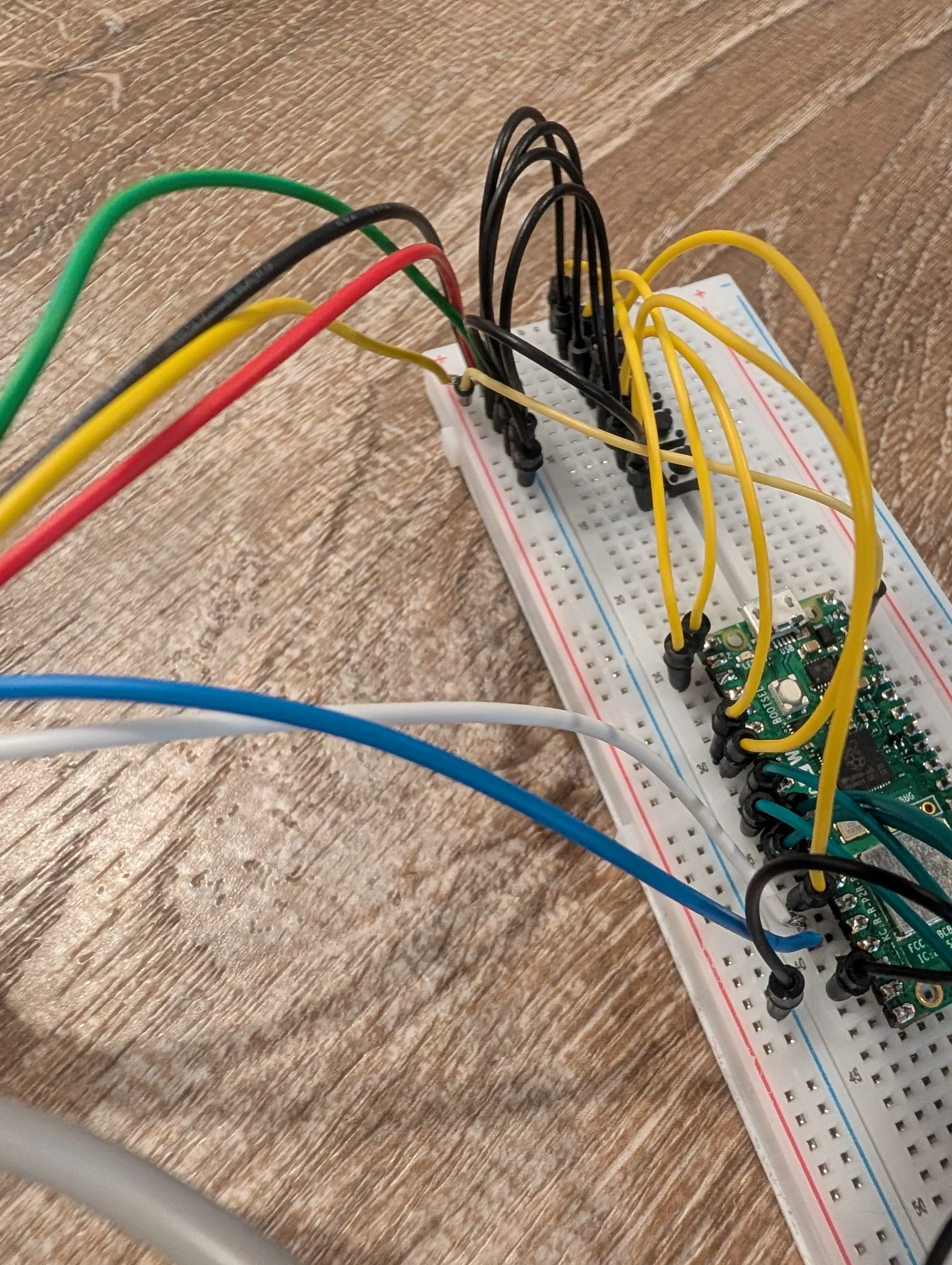

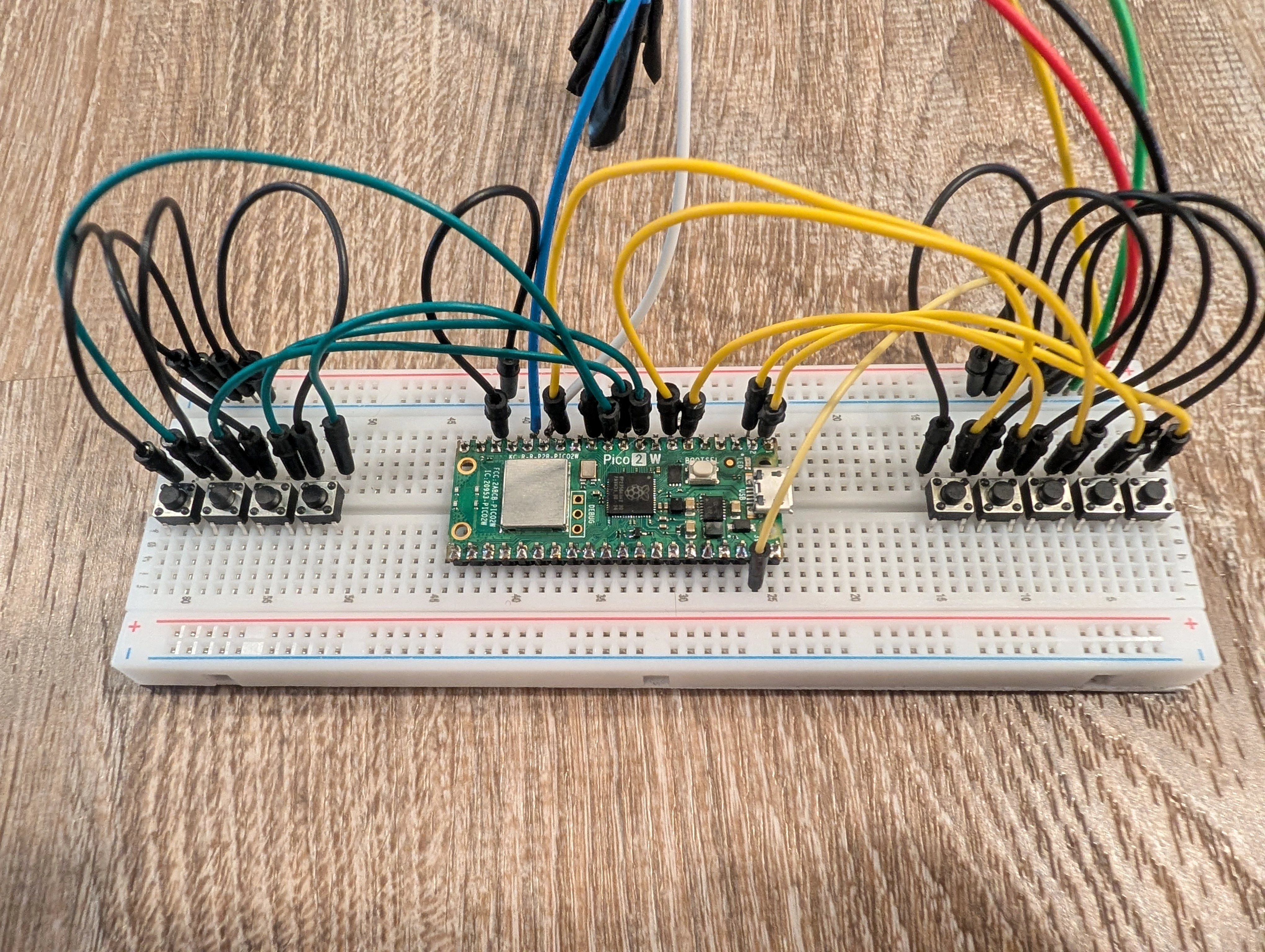

I have the RP2350 mounted to a breadboard and all of the face buttons are wired in (A, B, X, Y, Start, and D-Pad). I haven't yet wired in the analog stick or triggers. Here's where I'm:
  1. I confirmed that the wires in the Dreamcast controller extension cable I am using are going to the correct corresponding pins on the Pico, according to the Pi Pico wiring diagram instructions.
