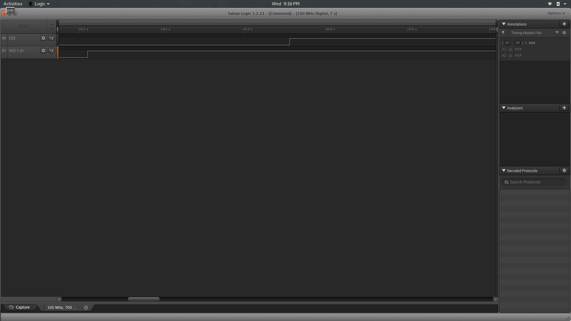

Doing this manually was way too slow, unfortunately, so I need to build something that can switch for me. Someone had graciously given me a dead 3d printer board, and on it I found some solid state relays. After a bit of testing, I determined that these were perfect for my purposes, and have since made a basic circuit with them:
(Please excuse the text oddities, those were out of my control)
From here, it's a simple matter of writing some code to control this circuit externally. I'll be using a raspberry pi 2 B to do this, since I have one on hand. I currently haven't written any code, but it's on the todo directly after writing this post
