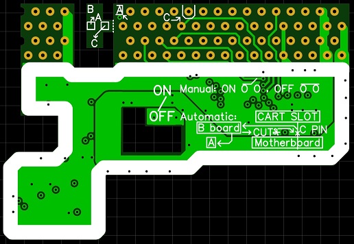

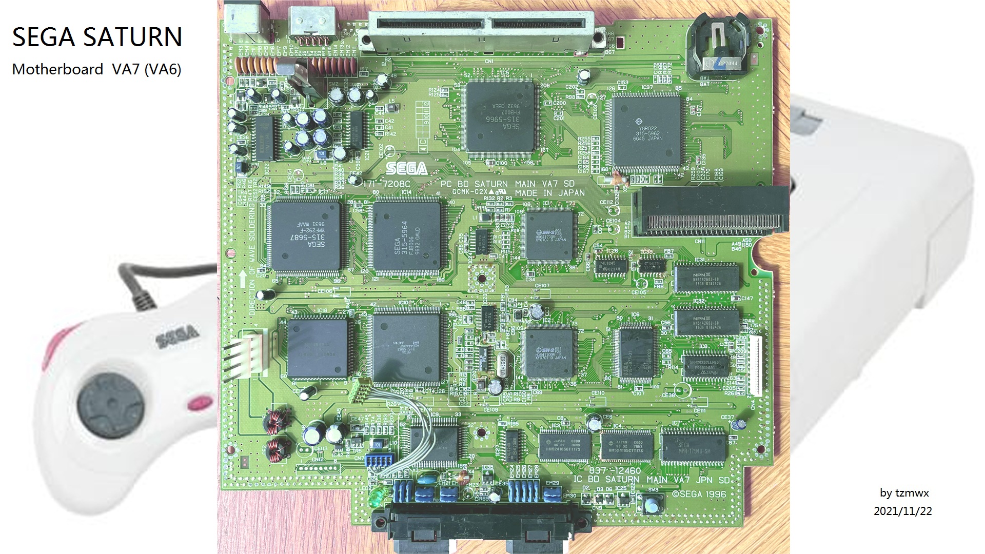

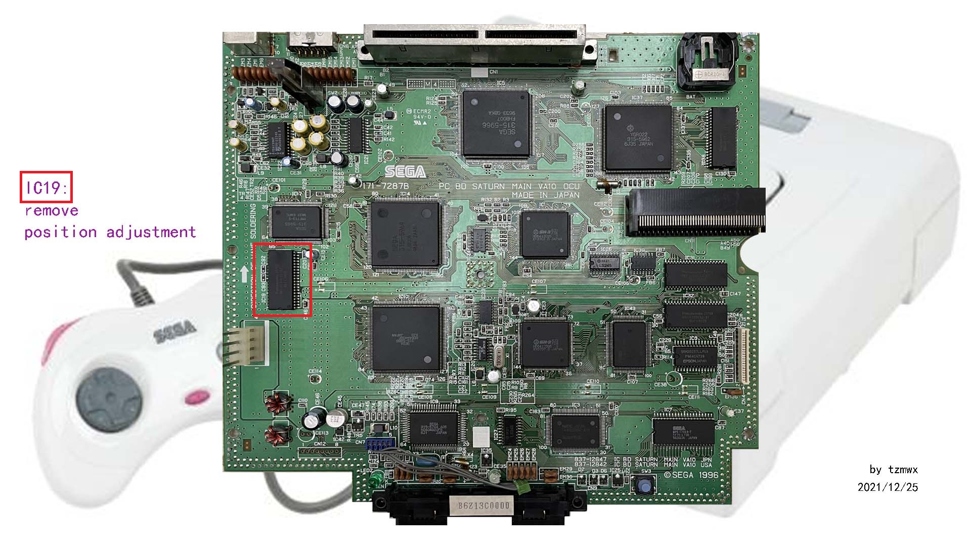

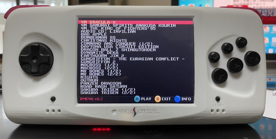

Guide The SEGASATURN Trimming Guide

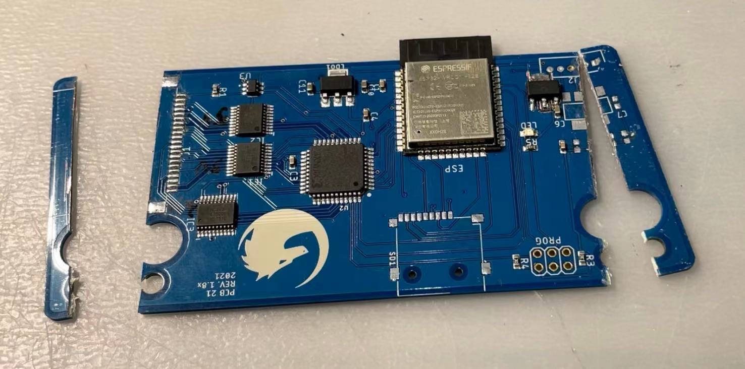

STEP 1:

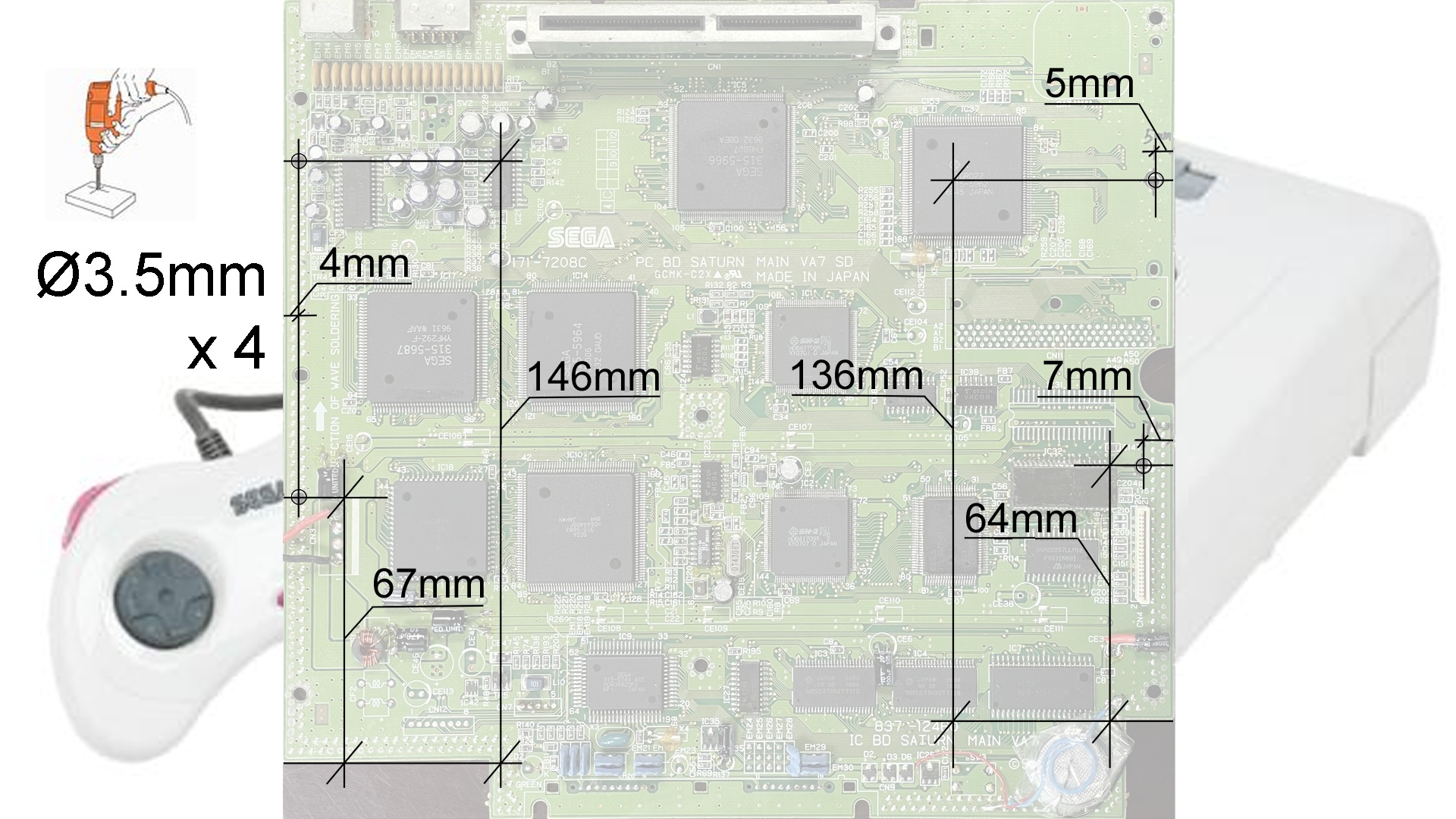

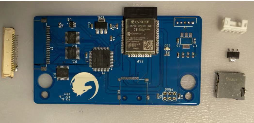

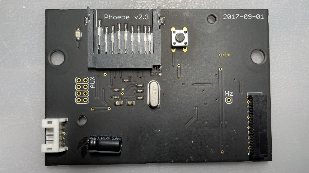

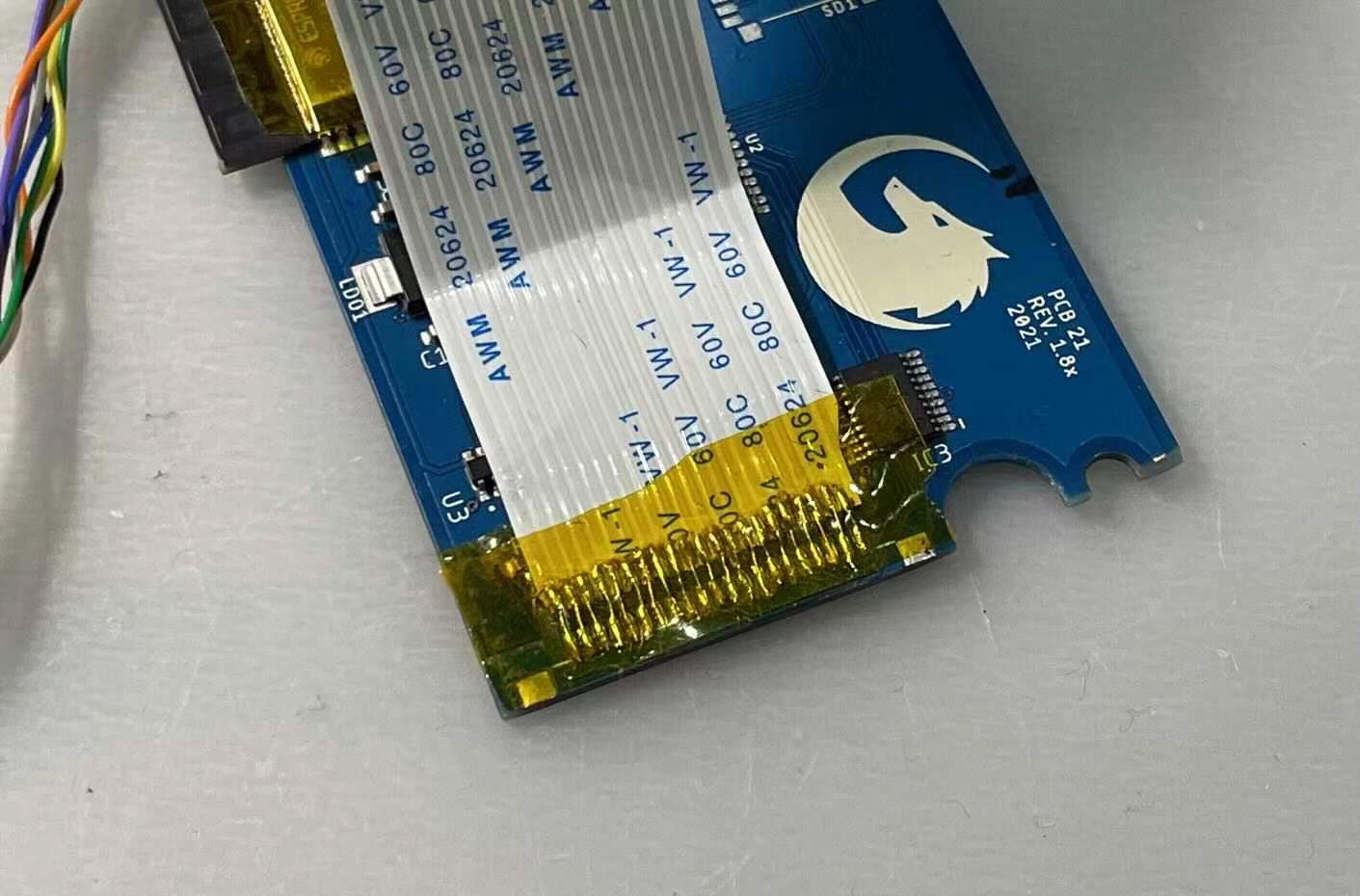

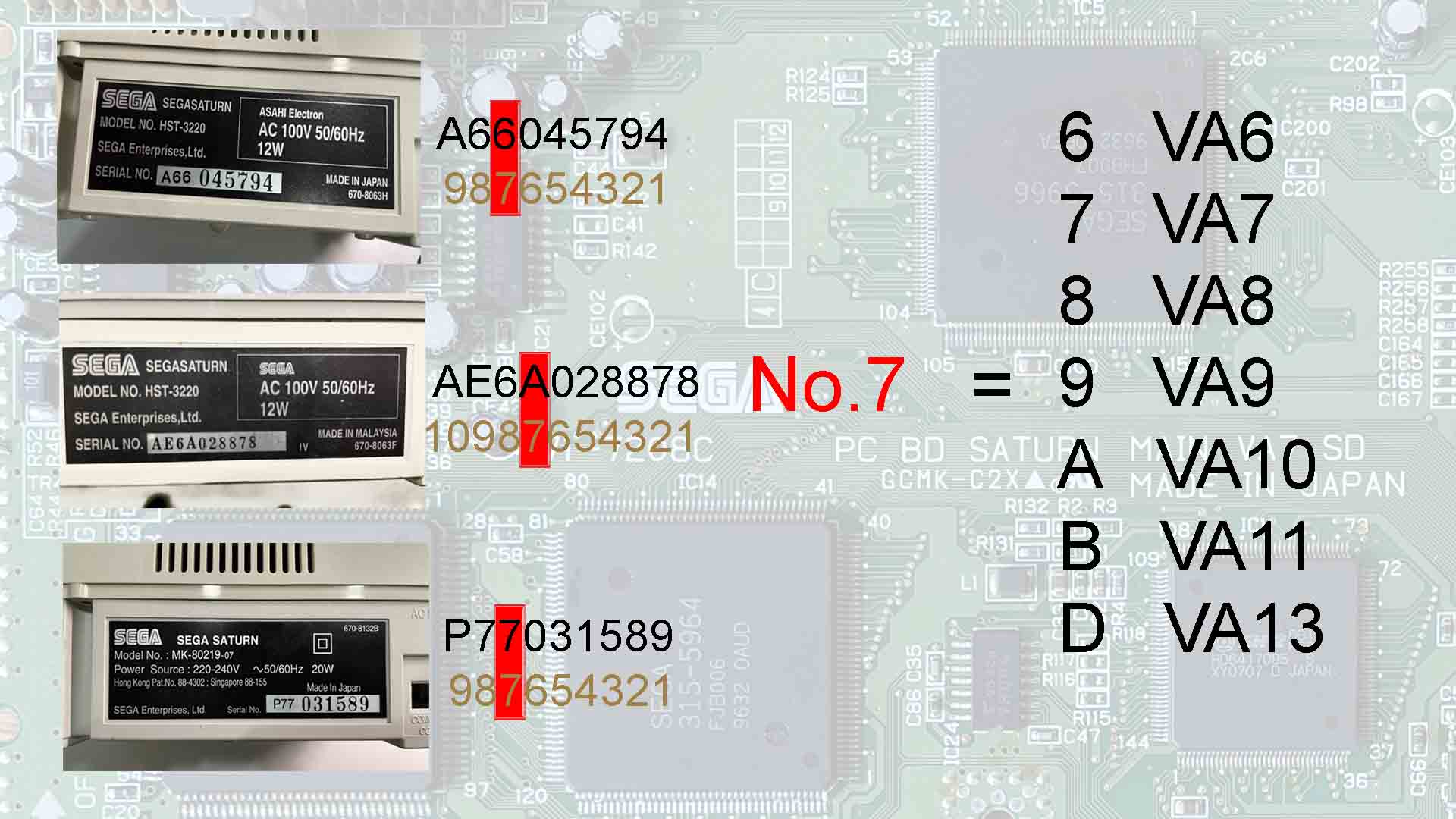

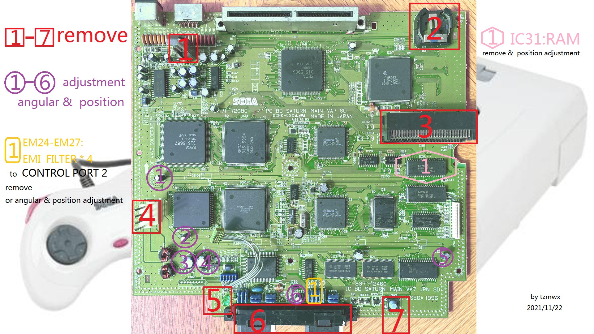

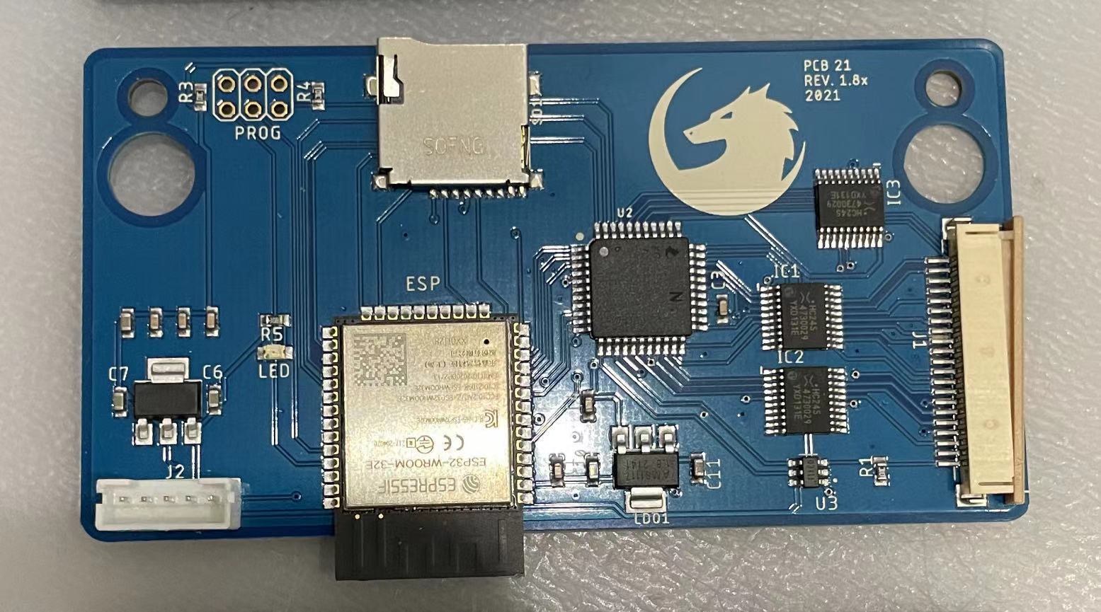

SegaSaturn Motherboard : VA7(VA6) & Saturn Optical Drive Emulator : Phoebe or Fenrir
Phoebe:
Fenrir:
index.php

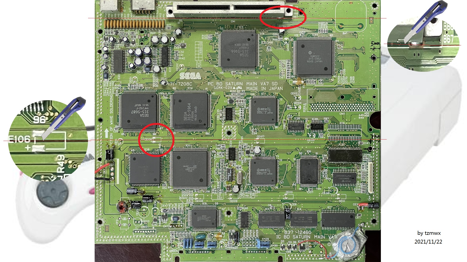

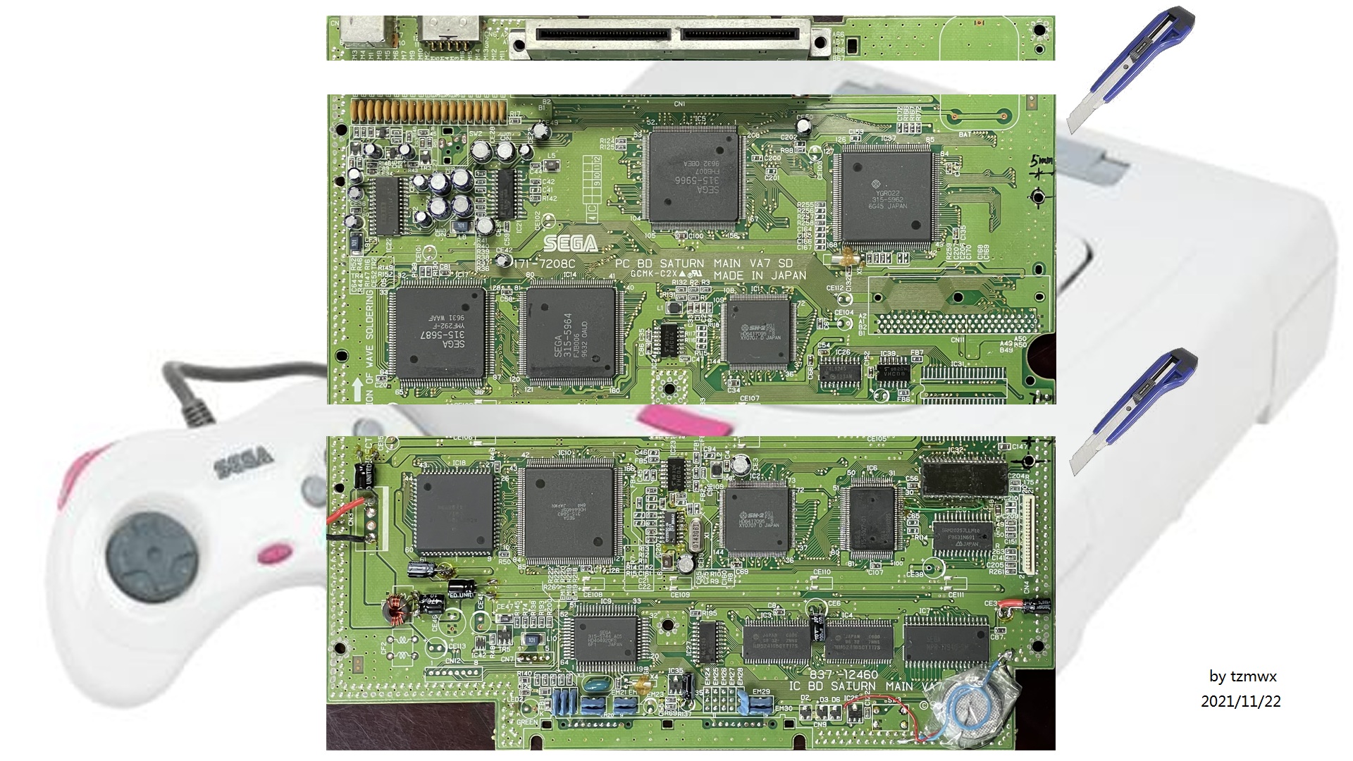

STEP 2:

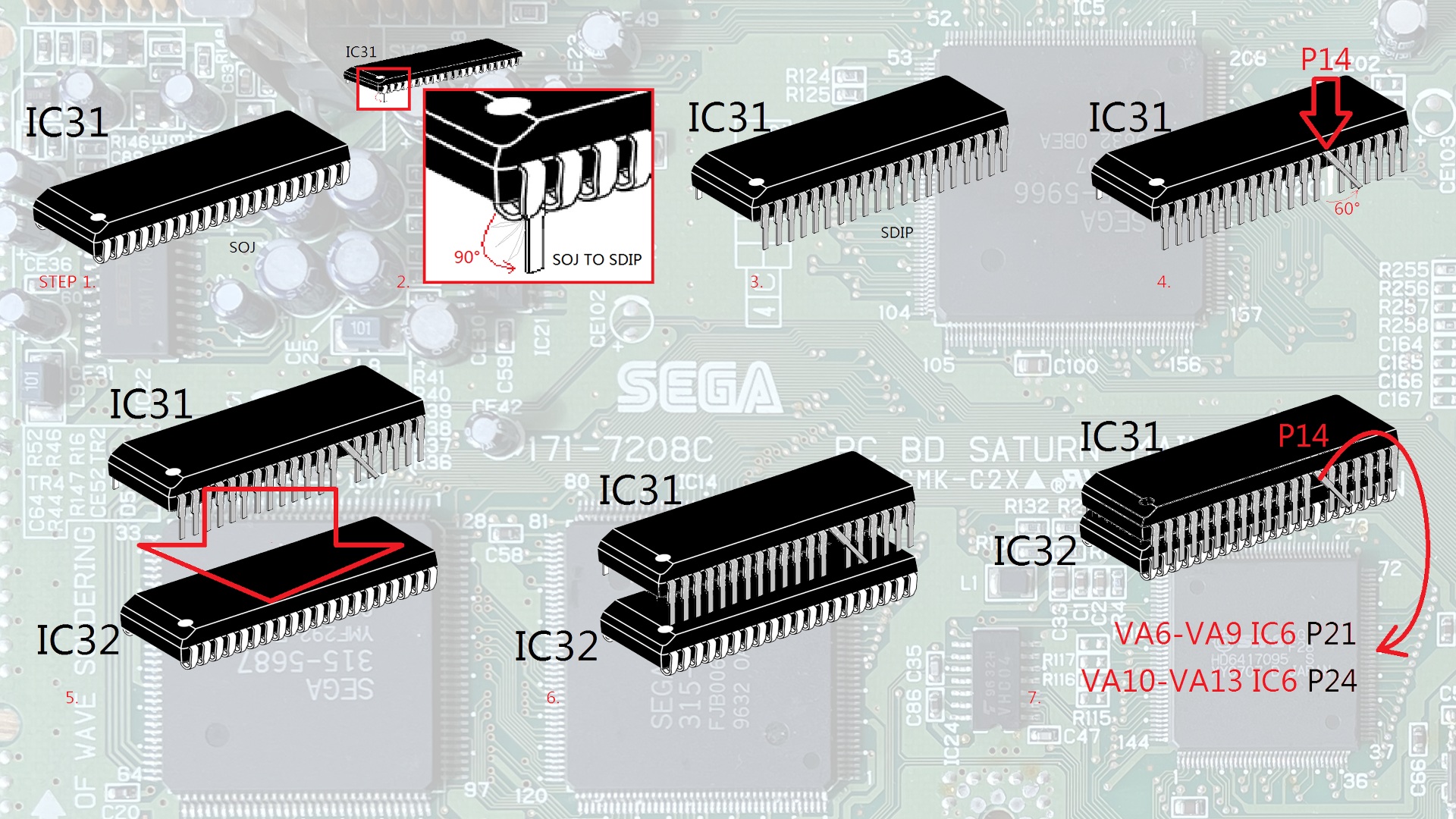

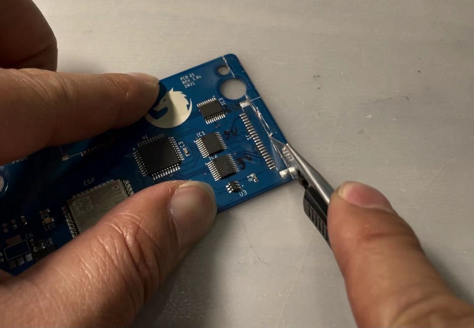

IC31 & IC32:
Punch:

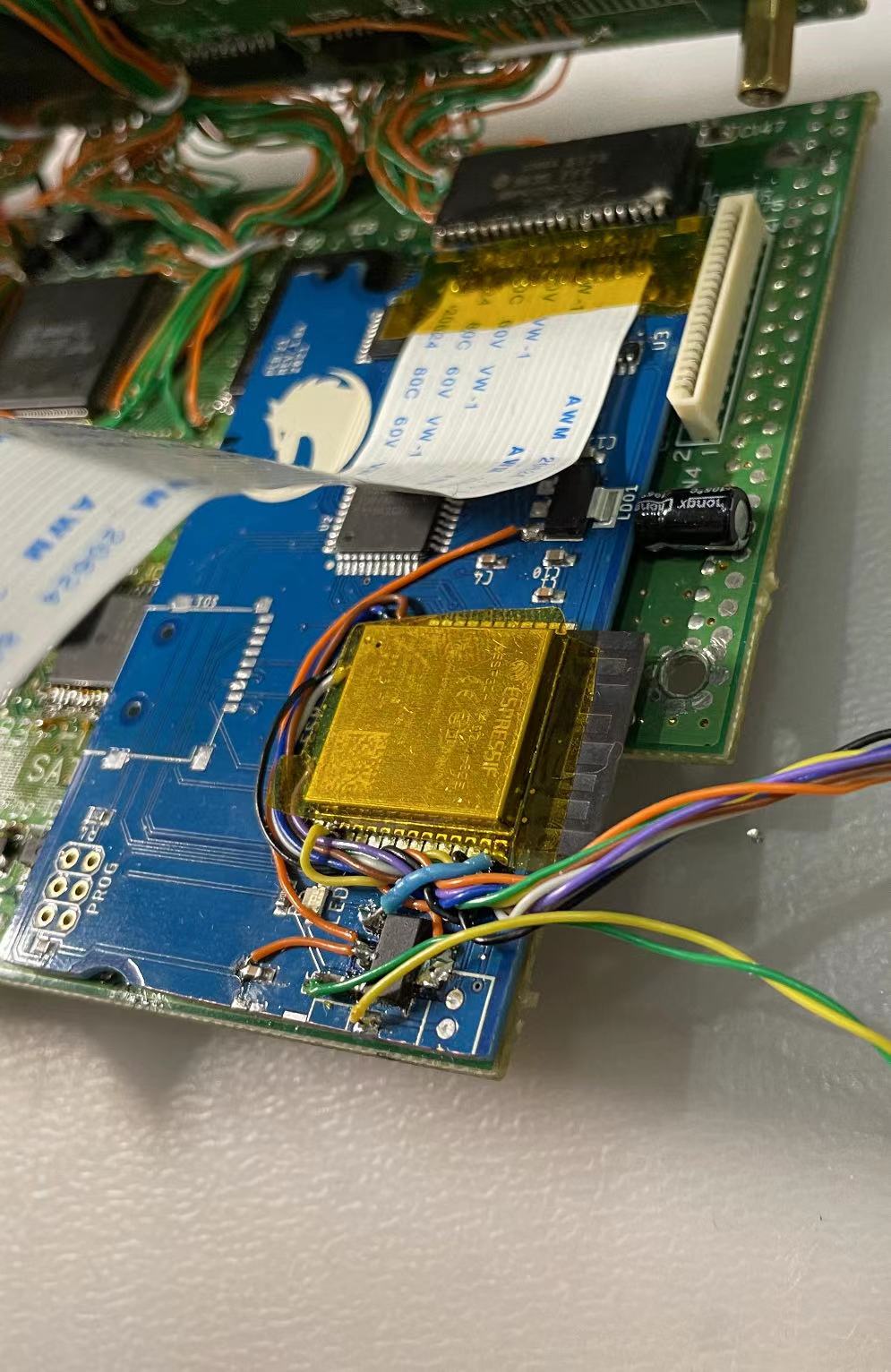

STEP3:
Cut:

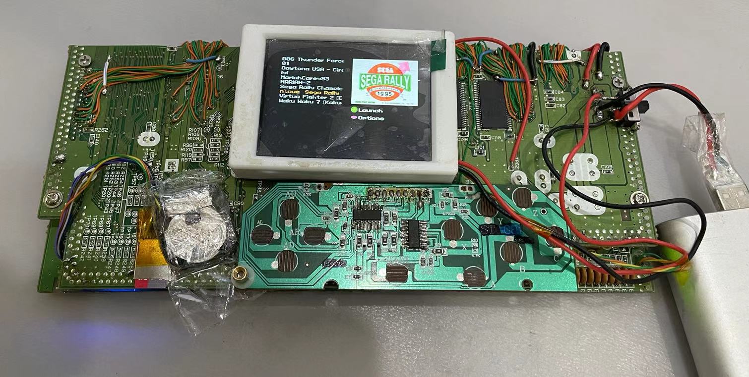

STEP 4:

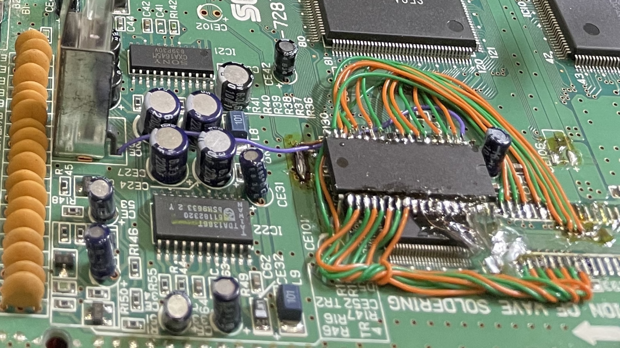

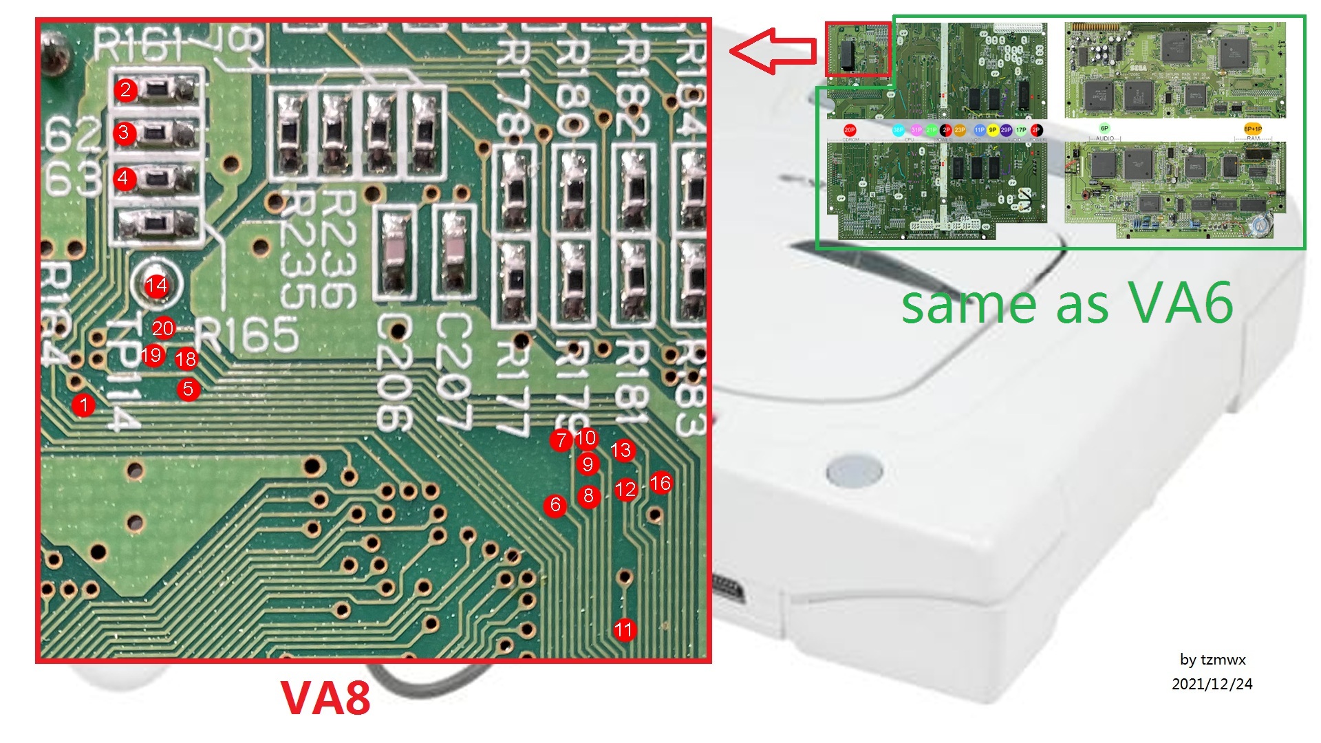

Reconnect , 218 wires , 95% VIA to VIA
index.php
index.php

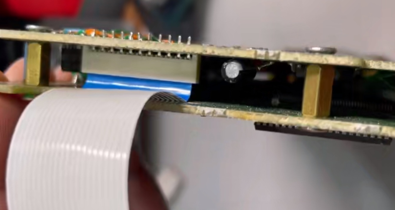

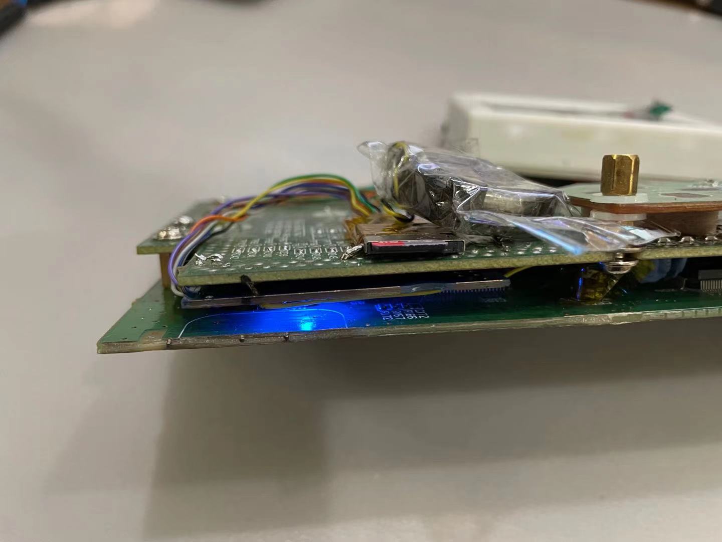

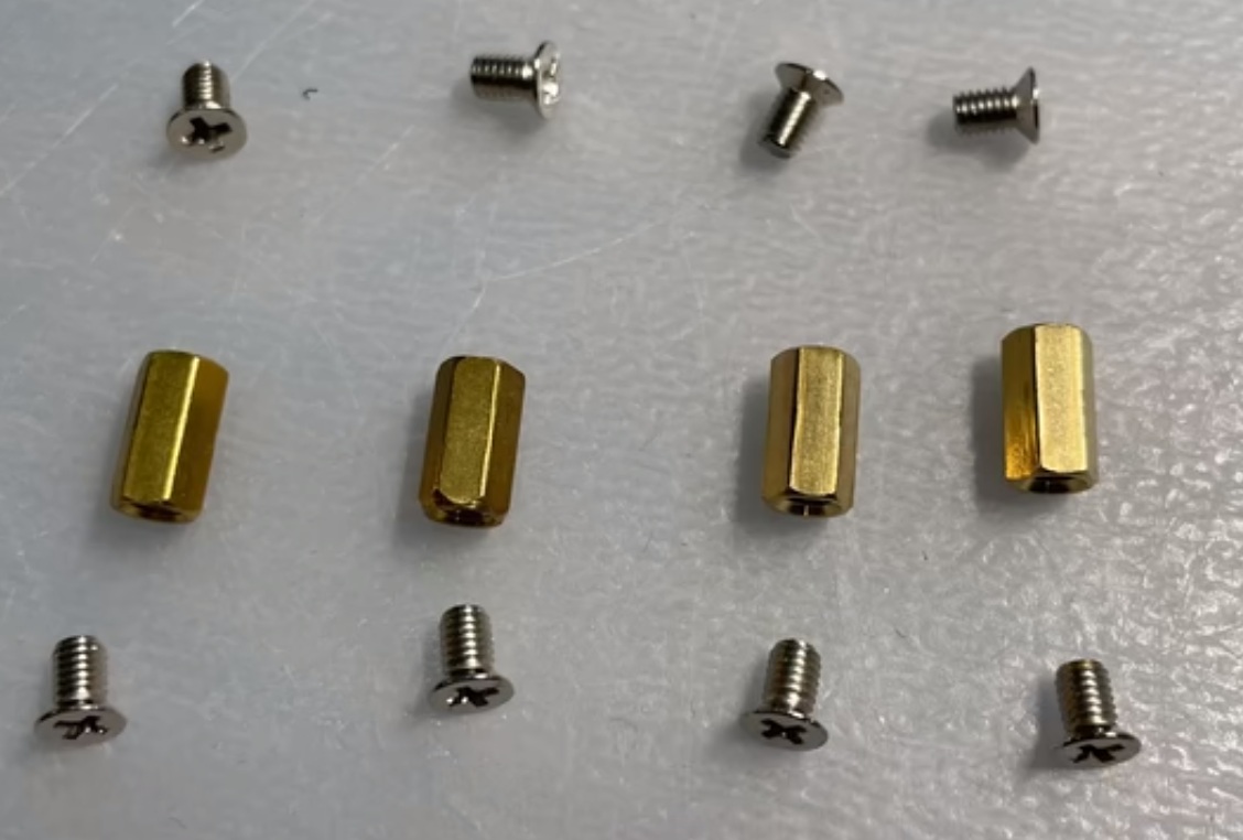

STEP 5:
Copper Pillar : 3mm * 9mm
View attachment 20229View attachment 20228
Others:
Seems to be Ultra Hard to do, but with pacience it would be possible to do! You are very impressive! I will try do do One! Do you have the 3d Templates? I will try to print the case in 3d! congratulations for your Amazing Work!
