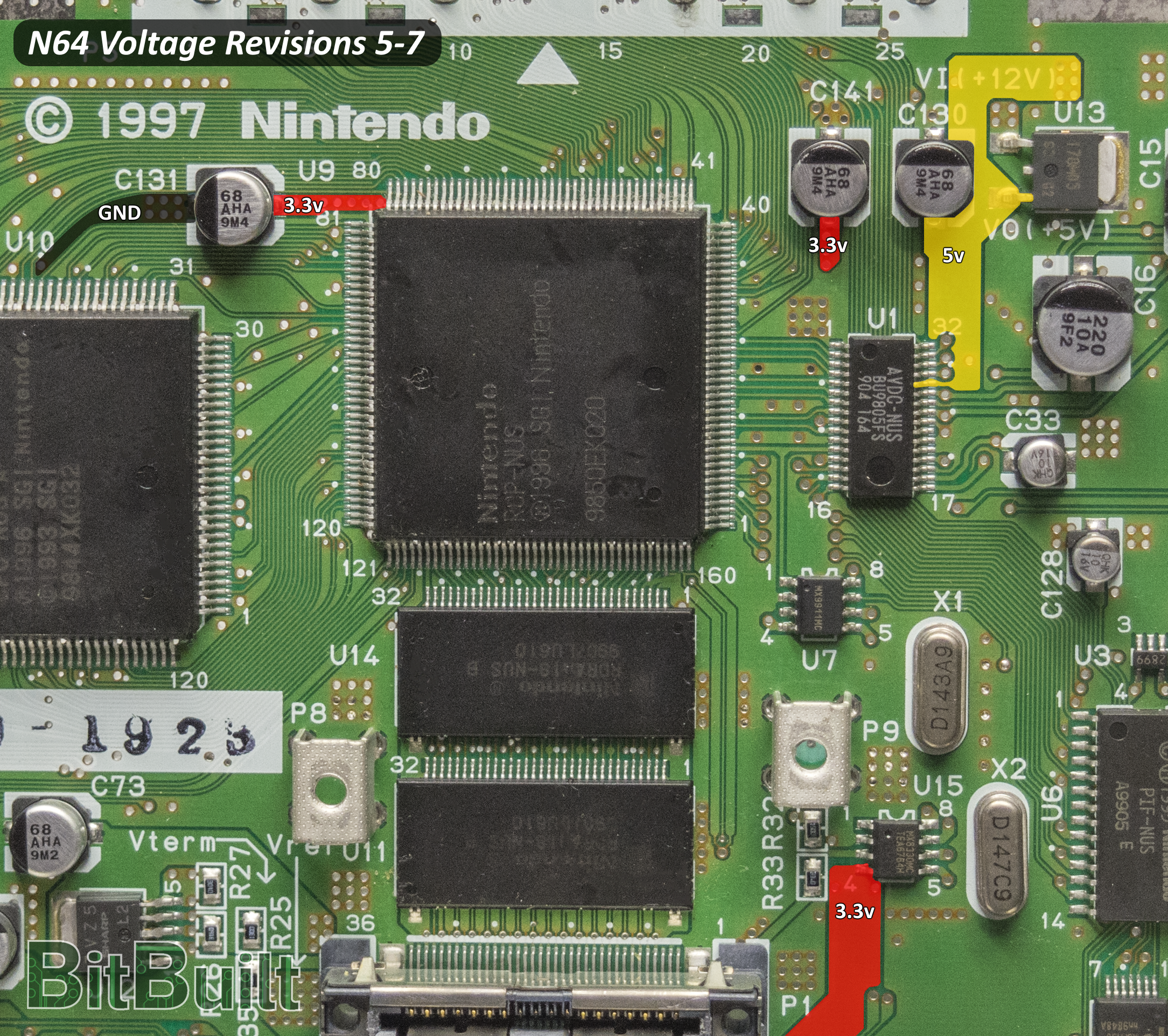

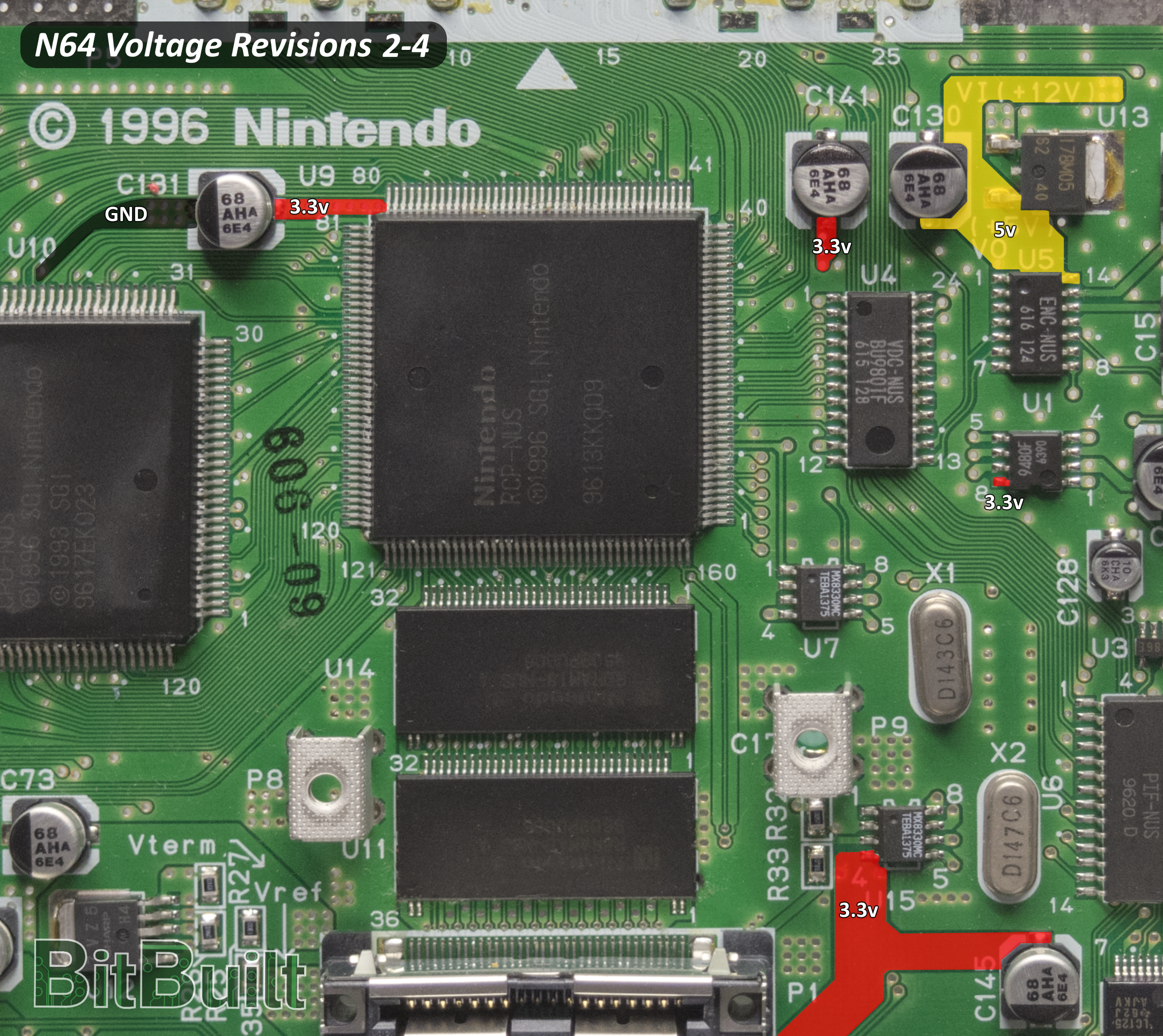

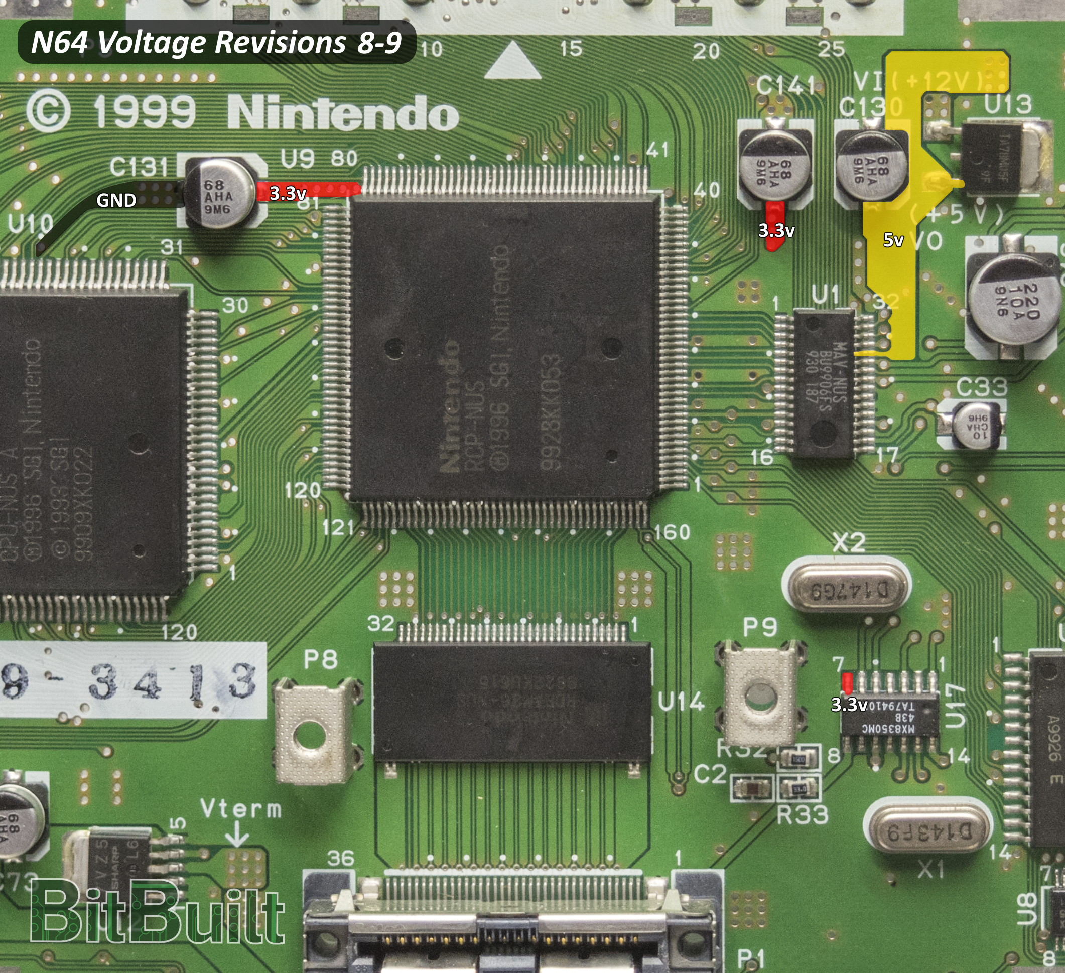

Voltage Relocation
Voltage relocation for Standard Trim:
  • Custom regulators (3.3V and 5V)
Revisions 2-4
Revisions 5-7
Revisions 8-9
Note:
  • 5V is only required if the original N64 video circuit is being used. 5V is not required if you are using a video replacement like ultraVGA or N64advanced with a digital audio amp.
  • The 5V LDO (U13) should be removed if you are not wiring the input to 12V.
  • All 3V3 spots must be reconnected.

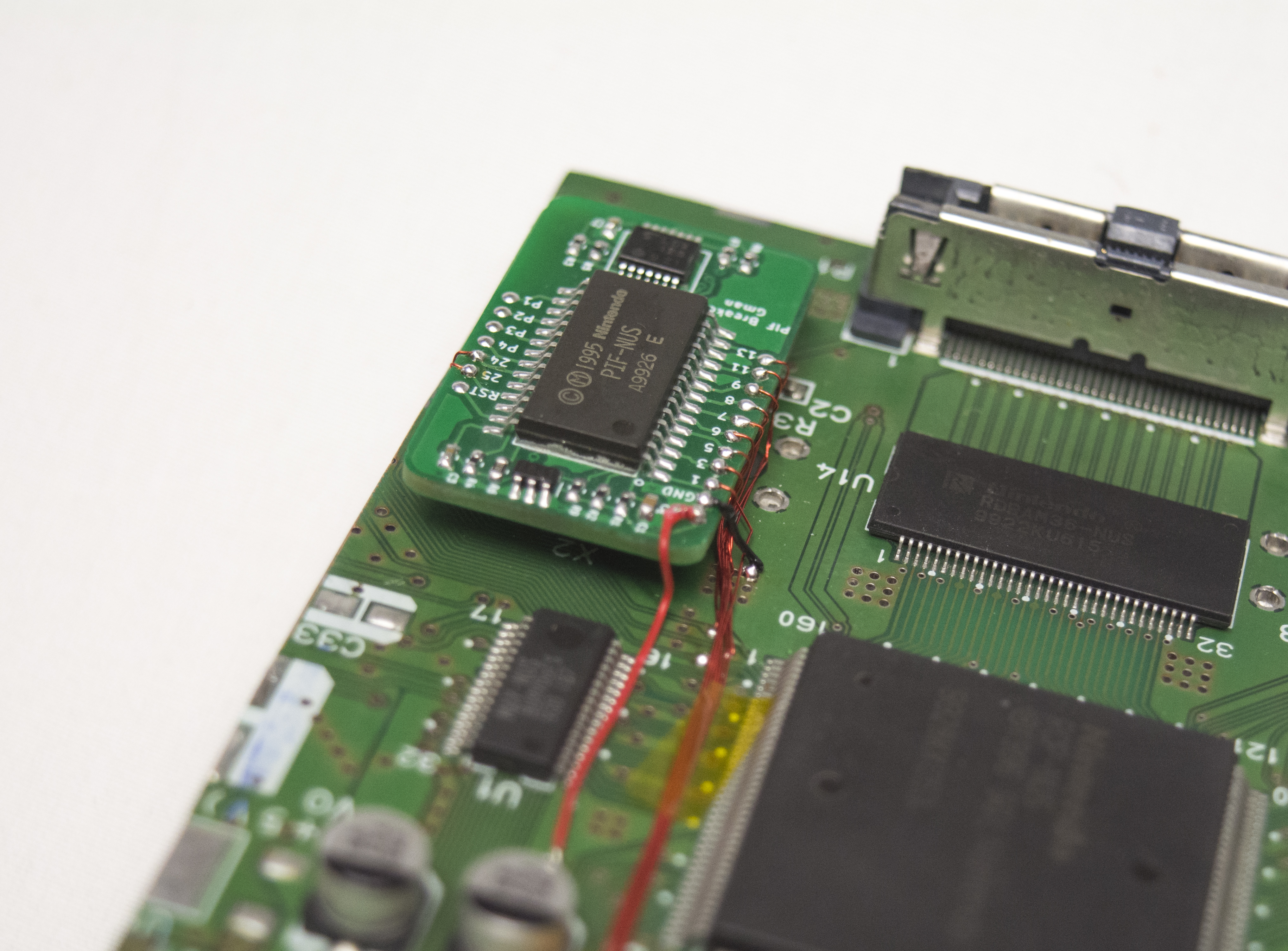

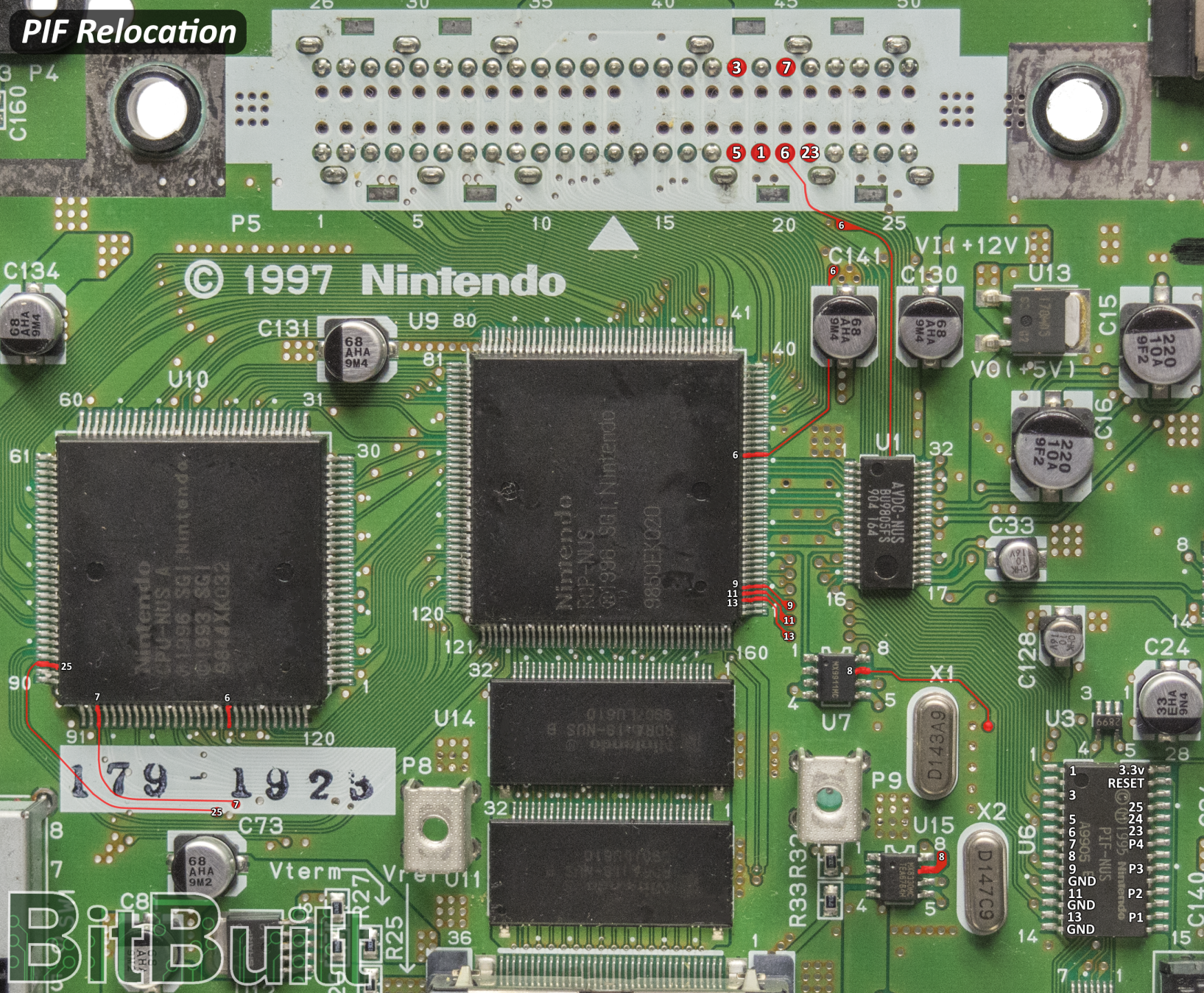

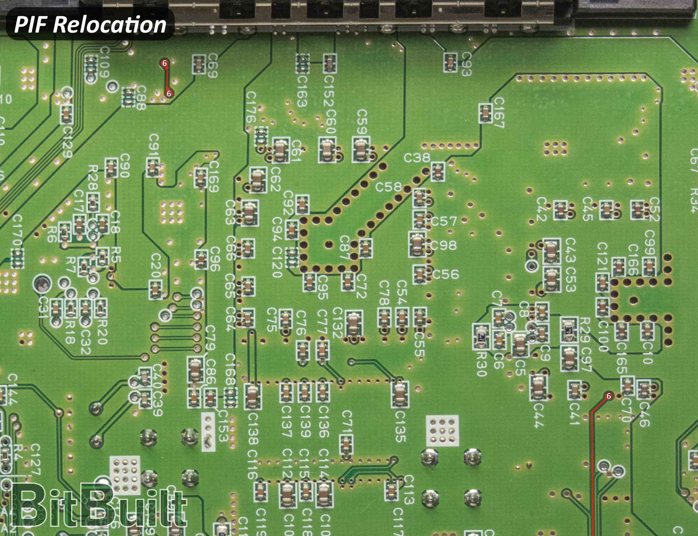

PIF Relocation

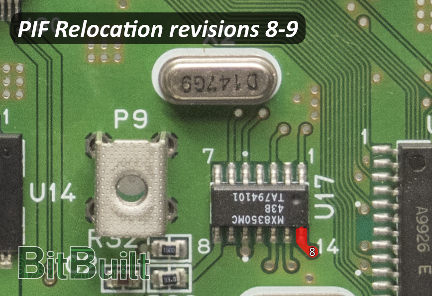

Revisions 8-9: PIF-8 will be wired to Pin14 of U17
Note:
  • It is easiest to reconnect PIF-6 to CPU-110 on the back side at these points by running a wire between them.
  • PIF-6 must be connected to the spots on the cartridge slot, RCP, and CPU. PIF-7 must be connected to the spots on the cartridge slot and CPU.
  • RST is the N64 Reset button and it is wired to a tactile switch and ground.

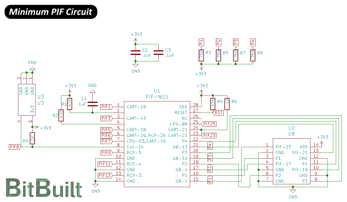

It is possible to relocate the PIF by cutting around it on the PCB. However, to ensure the minimum connections and components are made it is recommended to use the PIF Breakout Board. This can be purchased pre-assembled from the BitBuilt store, or you can build it yourself using the board files. https://store.bitbuilt.net/pif-breakout-pcb/
Minimum PIF circuit:
Note: The resistor and capacitor component designators in this schematic are not representative of the N64 motherboard.

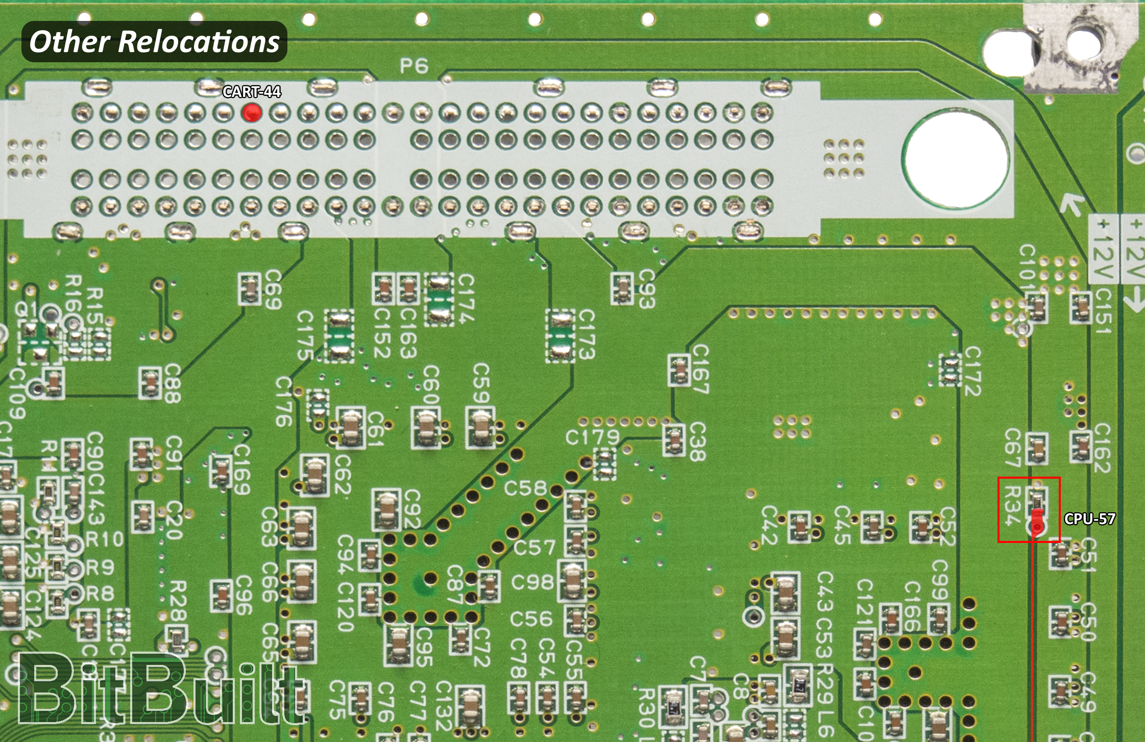

Other Relocations
Connect CPU-57 and CART-44 together. There is a 47Kohm Pullup resistor (R34) connected to these pins which will be preserved on the board for revisions 2-7. On the revisions 8-9 the resistor is cut off and will need to be replaced.

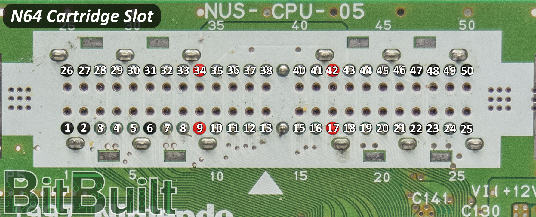

Cartridge Slot Relocation
Note: You must connect all the GND and 3V3 connections to the cartridge slot.
Pins 24 and 49 are not connected and do not need to be wired.

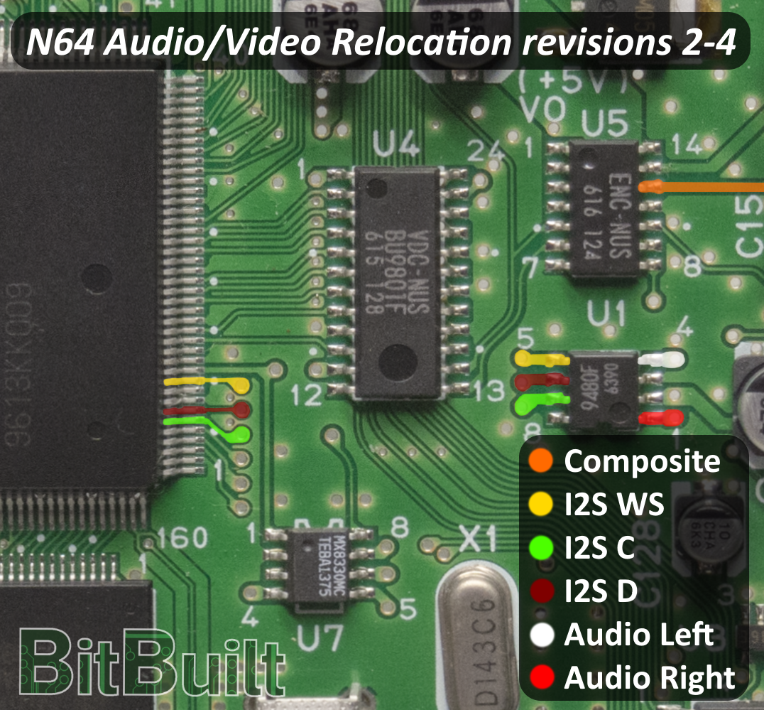

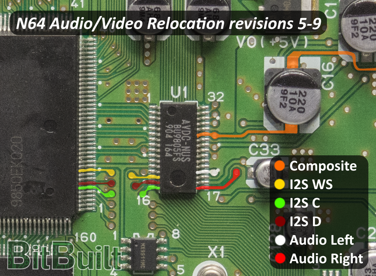

Audio/Video

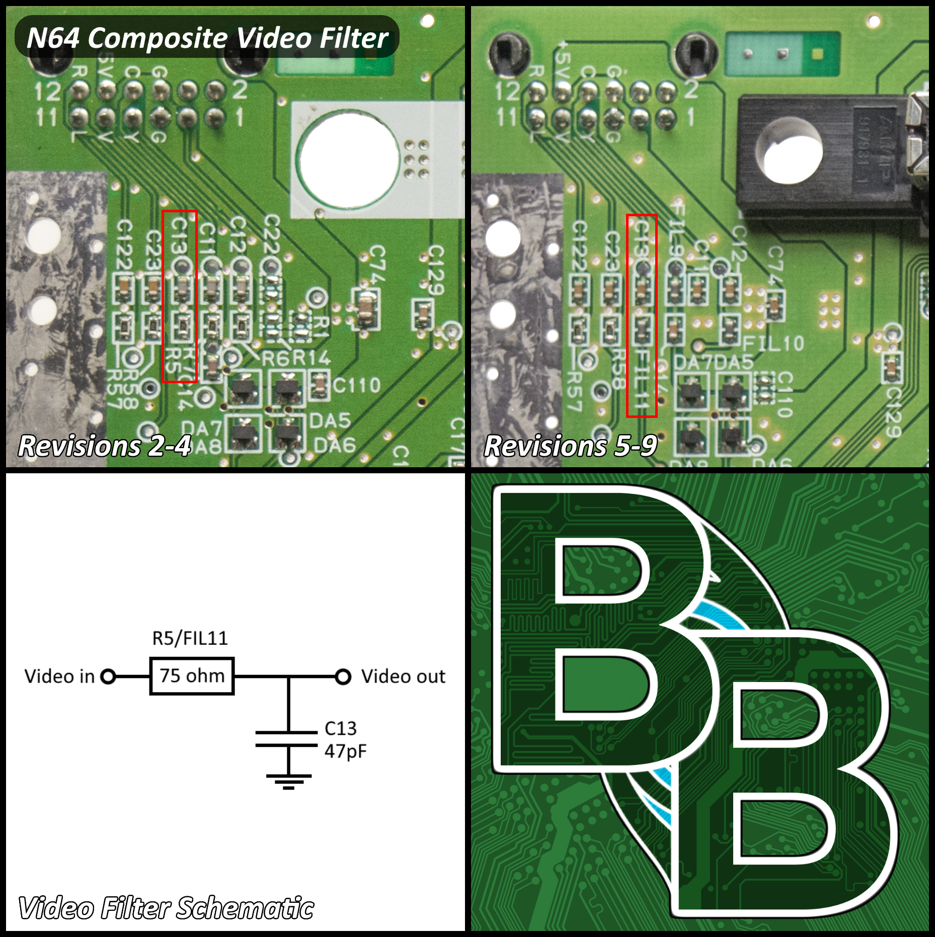

If the composite video signal color looks "washed out" on your screen, you may need to rewire the composite video filter: 75ohm resistor and 47pF capacitor forming a low-pass filter. R5/C13 on revisions 2-4 and FIL11/C13 on revisions 5-9.
Note: The N64 I2S digital audio sampling frequency can change per game and mid game and it does not have an master clock signal. One solution to be used in digital audio amps like the popular LM49450 is to use a PLL IC to generate the MC signal at a fixed ratio from WS.

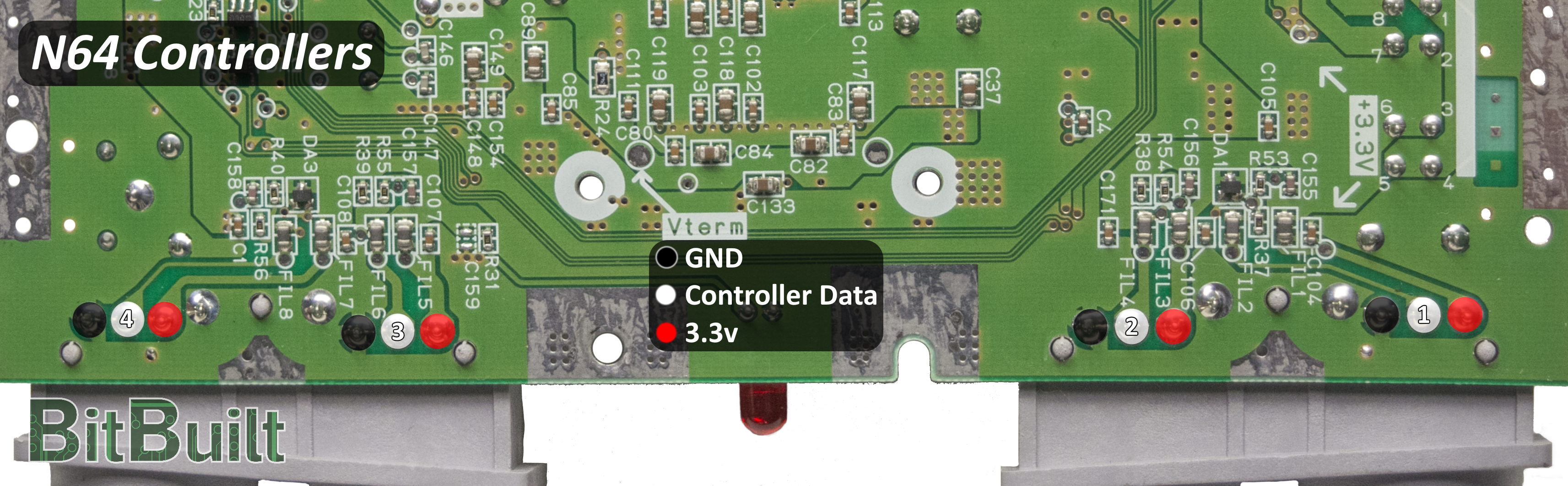

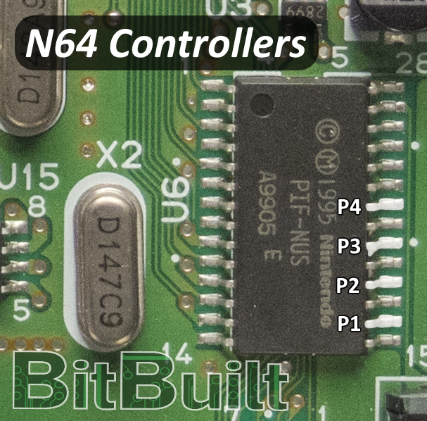

Controllers
