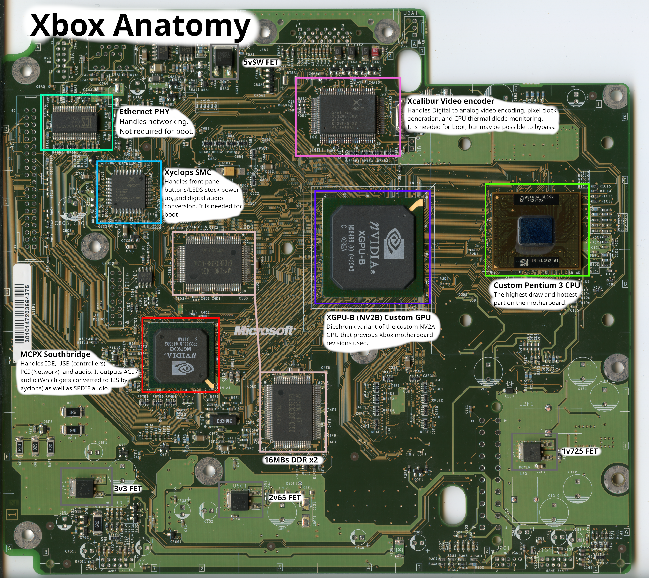

Additionally there are 3 retail Xbox motherboards. This guide is only for the 3rd and final board revision, X01063-121 or 121 for short. The 2 older PCBs are not suitable for portable use, they cannot be cut down as densely (or at all), and they draw up to 50% more power, and they lack a variety of hardware that amounts to making the 121 board perfect for the job. All research and documents pertain to the 121 board, and this is what is detailed in the Compendium document as well.
The following is the "anatomy" of the 121 motherboard, please get acquainted with it before proceeding.

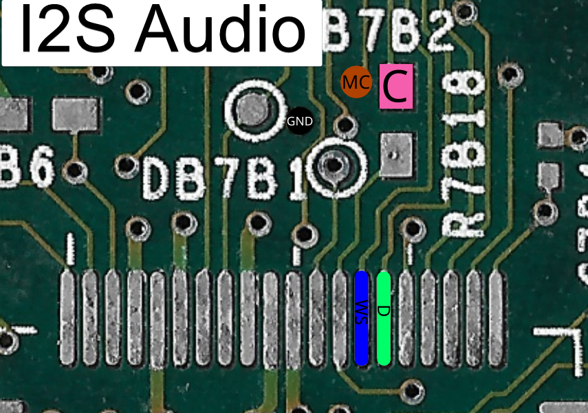

I2S AUDIO:
The Xbox MCPX outputs 2 types of digital audio, SPDIF, and AC97. SPDIF is routed straight to the AV output port for some AV output modes, and the AC97 is converted for analog audio.
On previous boards there is a dedicated AC97 DAC for this job, however the 121 uses the custom Xyclops SMC to convert AC97 to I2S, which then goes to a cheaper I2S DAC.
Thanks to this we can very easily use crisp digital audio in our portables.
It is possible to use the U-AMP2 to do this, however it isn't implemented just yet.

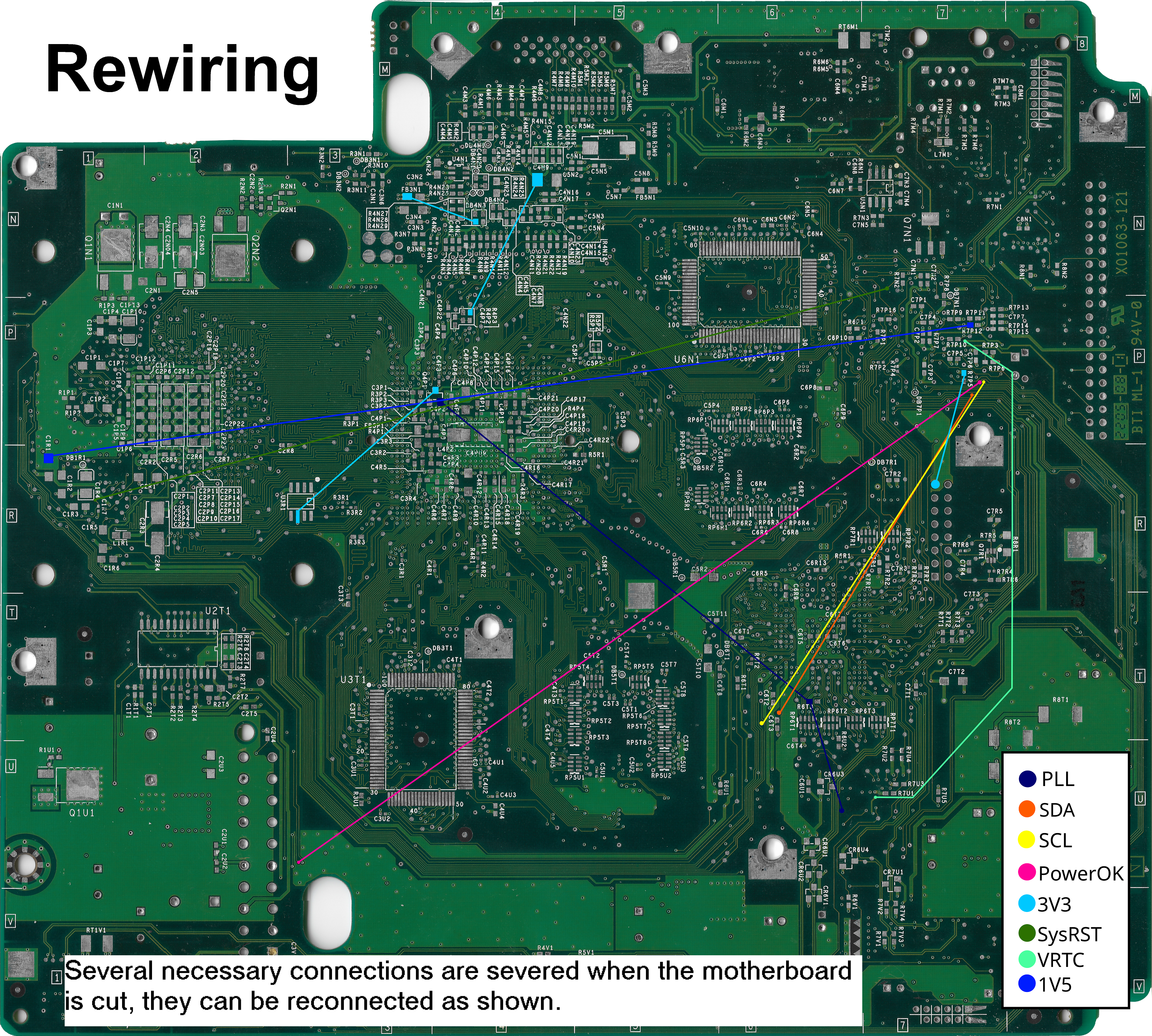

REWIRING:
When the board is trimmed a handful of connections are severed, these are required for the Xbox to boot and as such must be reconnected prior to using the trim.
Additionally both the power and eject switch lines need pull up resistors in order for the Xbox to boot normally, and the CPU JTAG lines need 1K pull ups to 1v5. They are shown in separate diagrams.
