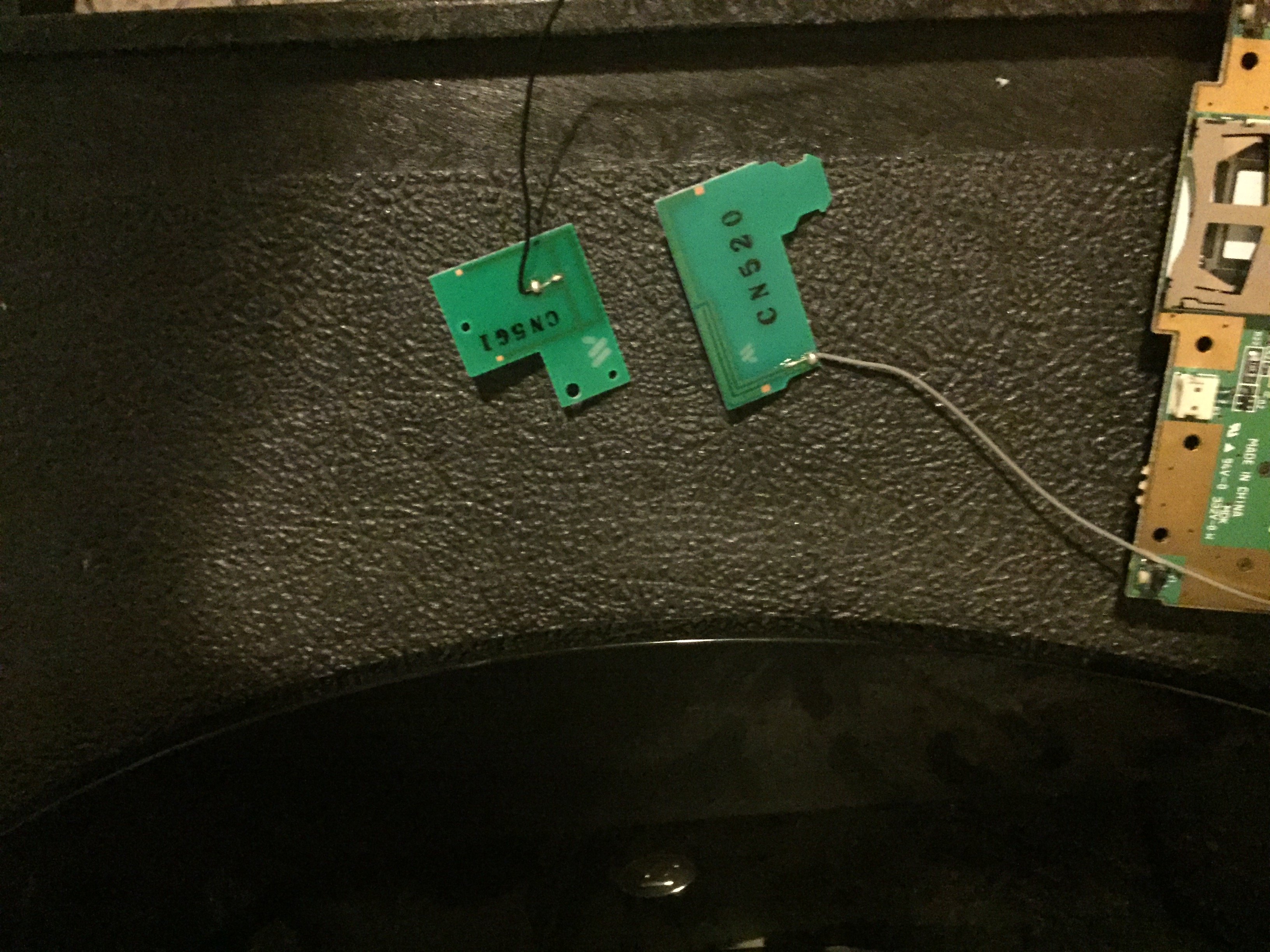

If you want to get signal, yes.Thanks for the reply! Do I need to keep them in tact when I relocate the wifi module?

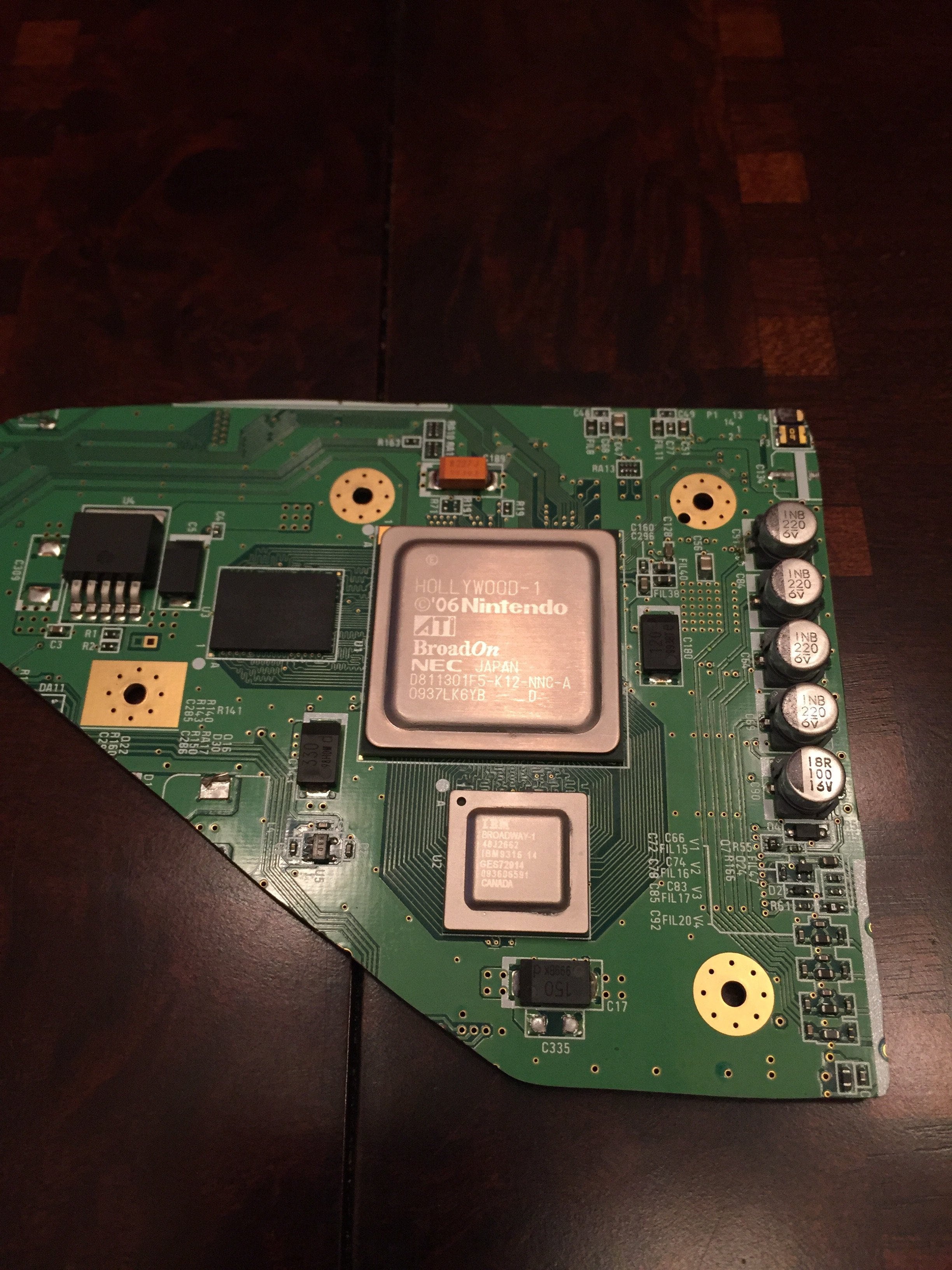

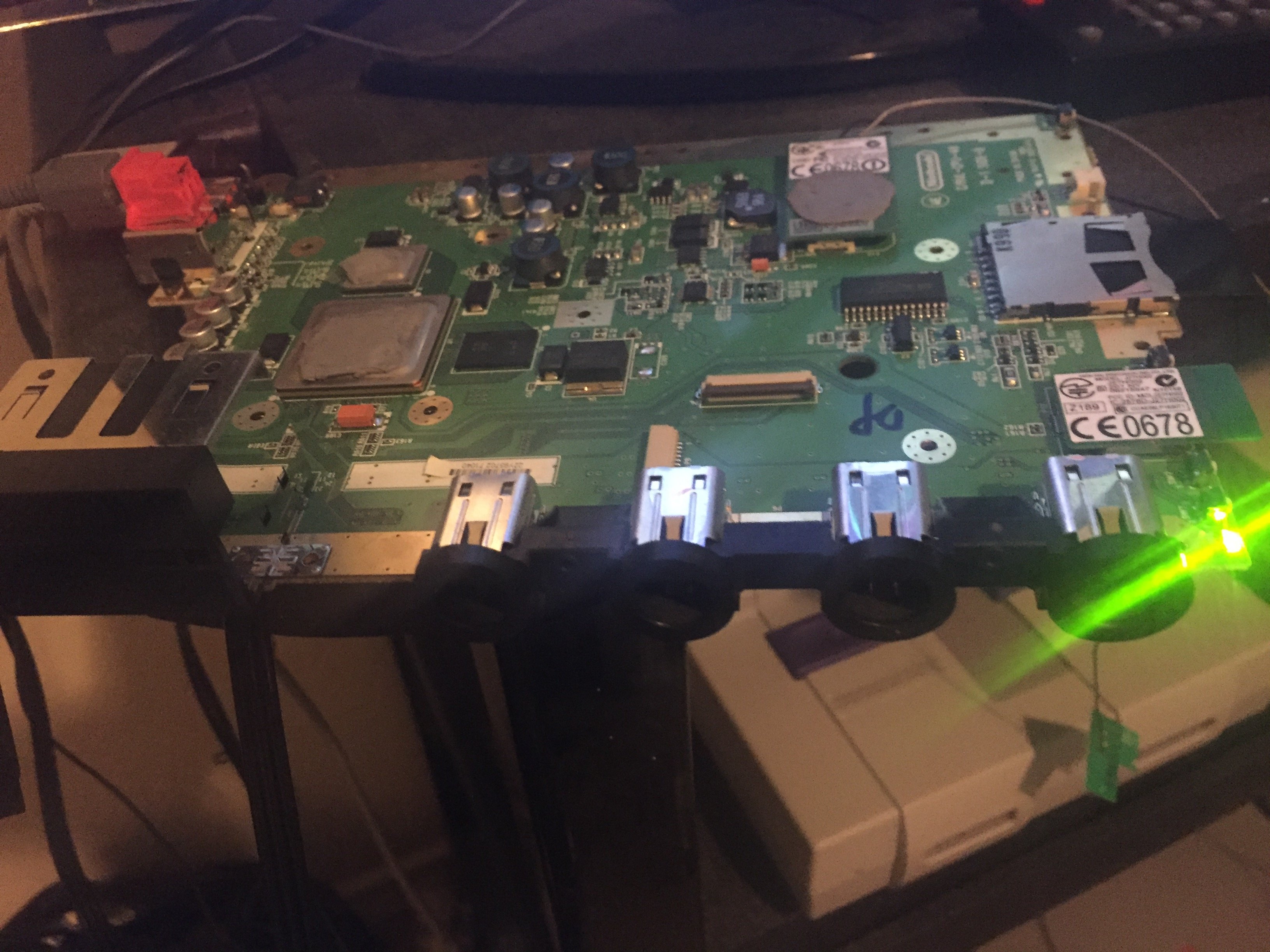

I got lucky this time and scored a 4-layer board so I'll be able to do more reallocations!

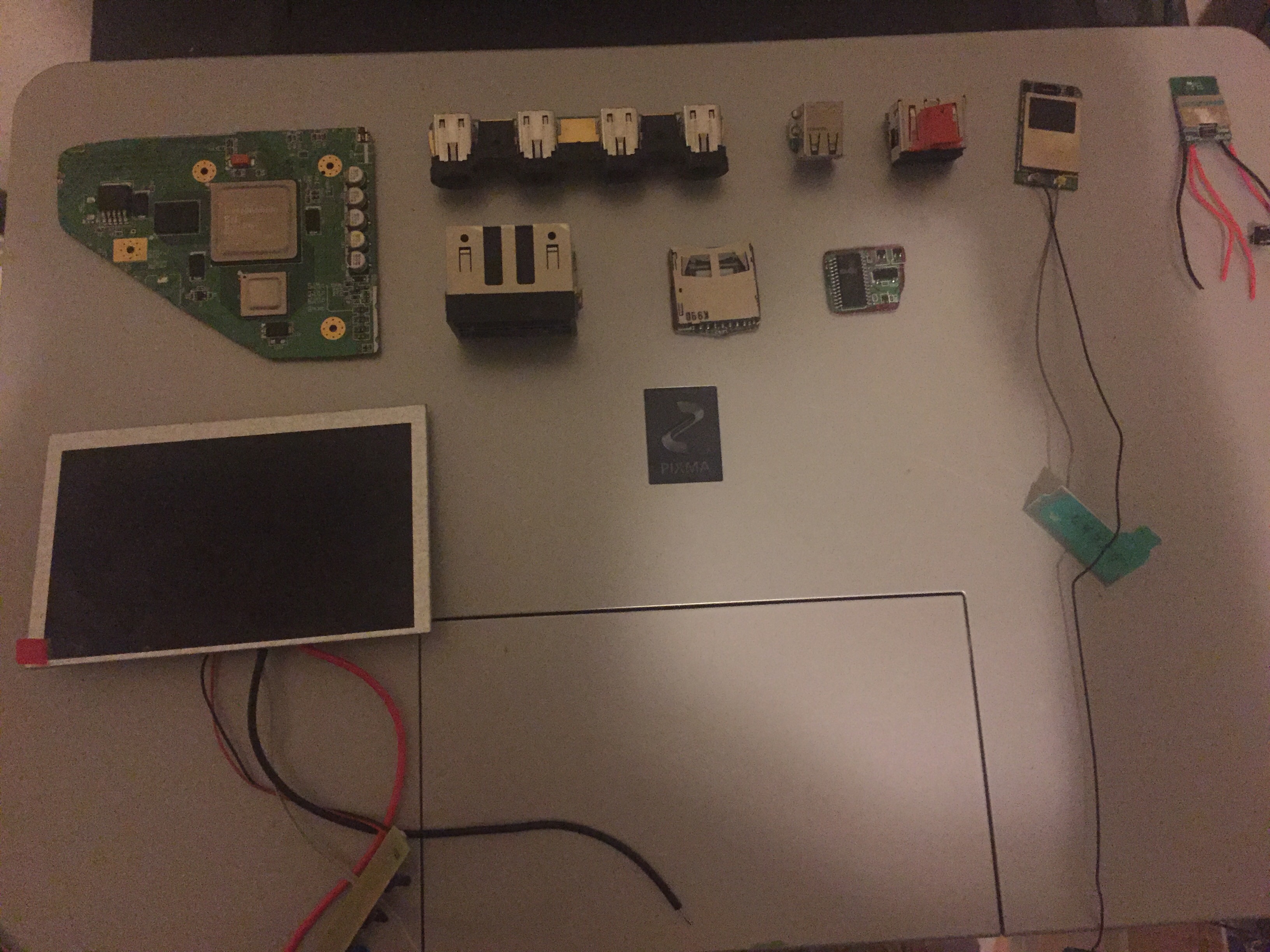

I'm not gonna update my last post on my haves and have nots because the only new things I have now are two more Wiis...
And this:

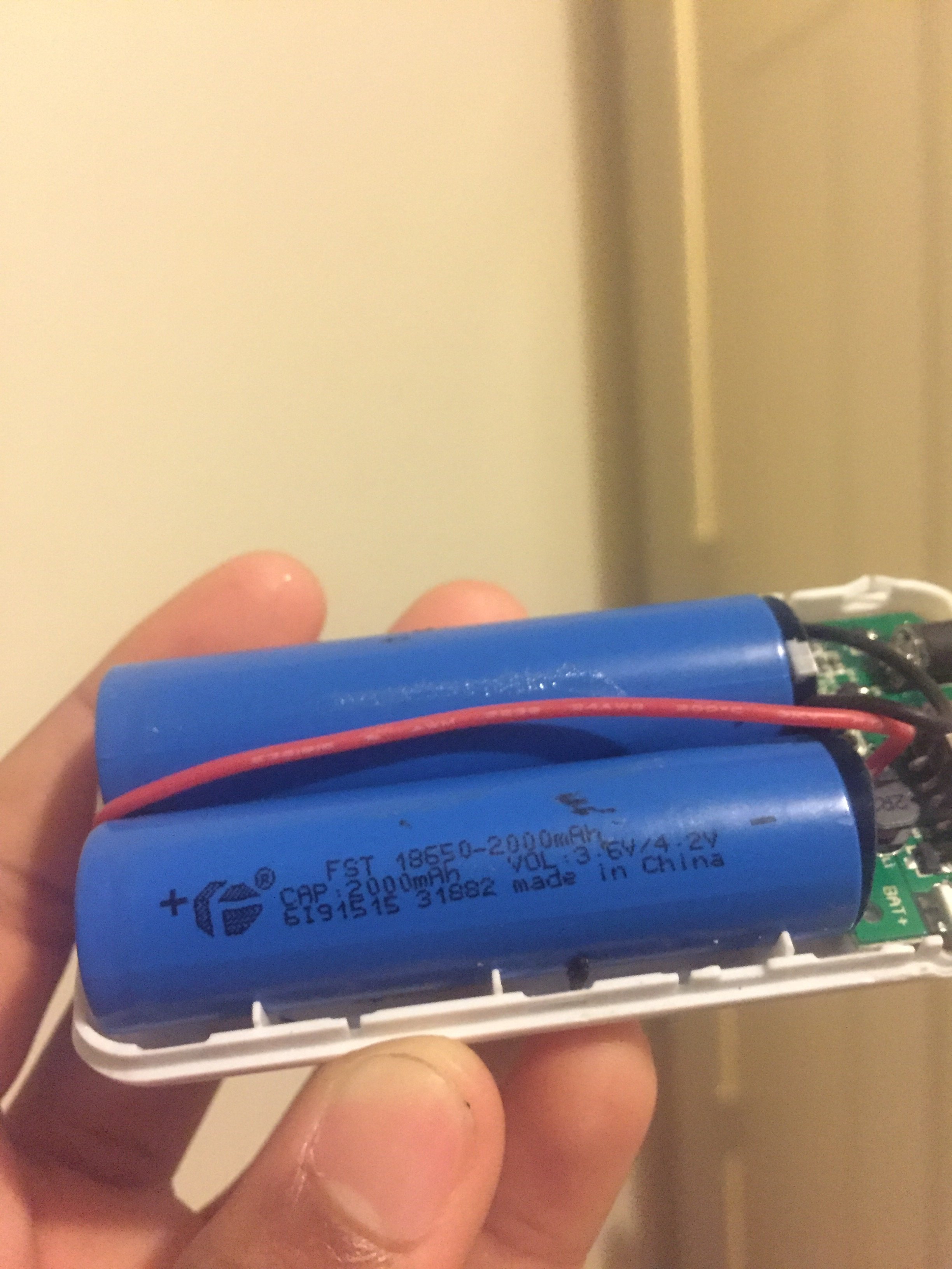

I don't know if I should be asking questions on here but... Are these usable? I have one more laying around some where and it has a lot cool features. I hadn't even thought about using it but once I opened it up ( ͡° ͜ʖ ͡°). If I can use it what kind of battery life would I be looking at?
One more random question: what are these?
Ok, that's it for now! I'll probably go ahead and test my screen later tonight!

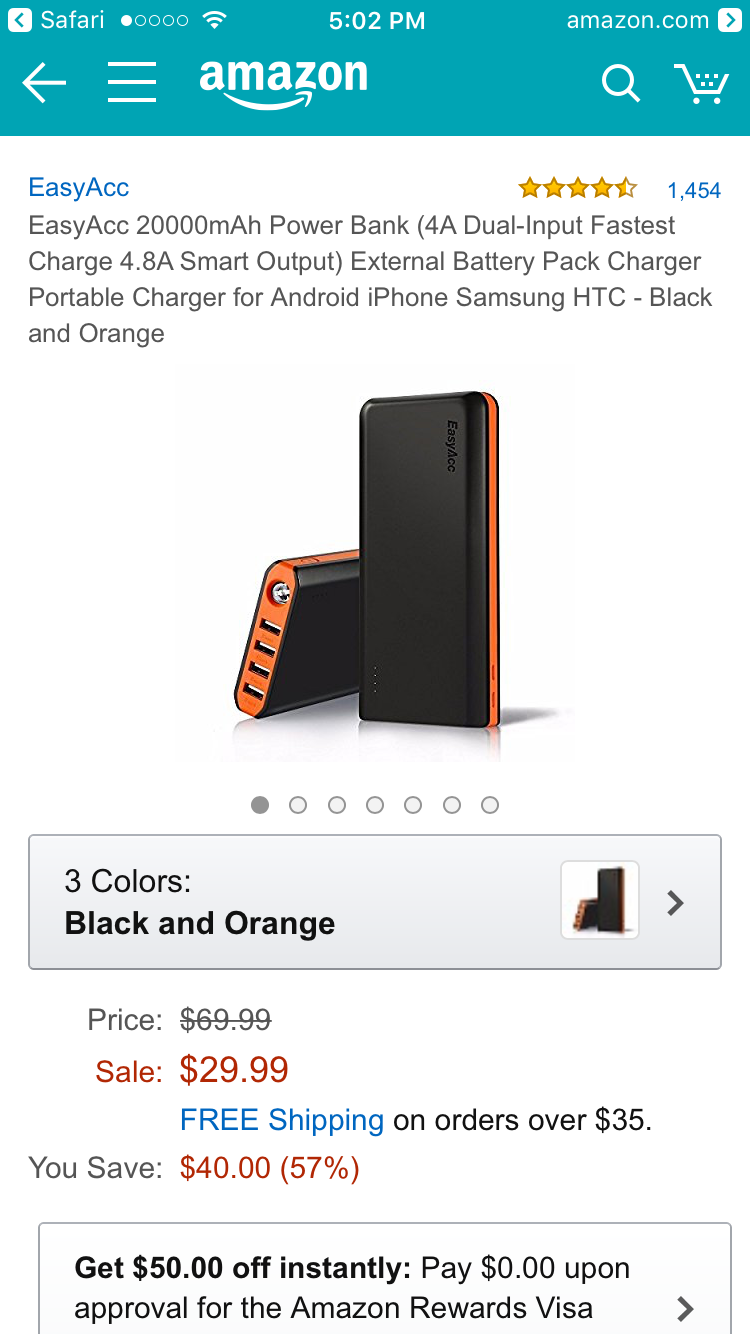

If that's a 5v rechargeable portable phone battery pack, you can use it as long as it can supply enough current. I believe for wiis the average is about one cell = one hour of battery life with a small screen. I'm using one of those for my wiip and so far it's working great. Mine supplies 2.4 A and my wii with everything except the screen and fan is drawing like 1.8ish amps. So it will be a close call, but I'm hoping it'll work.
The maximum it can output? Look at your battery on AmazonThanks for the reply! How do I measure the current?
. I suppose you could cut up a micro usb charger instead and measure it while charging your phone, but it's easier just to look it up. Also, you might consider getting a new one since there's no way of telling what the quality / capacity of those cells really is, plus batteries only work a certain number of times so if you've had them a while and use them they won't last quite as long.The maximum it can output? Look at your battery on Amazon. I suppose you could cut up a micro usb charger instead and measure it while charging your phone, but it's easier just to look it up. Also, you might consider getting a new one since there's no way of telling what the quality / capacity of those cells really is, plus batteries only work a certain number of times so if you've had them a while and use them they won't last quite as long.
It should have both overcharge and overdischarge protection. Just make sure that they can output enough current for your wiiI've had them for a little under a year and only used them about twice. I'm gonna go ahead and use this in my personal portable for now. The pcb attached includes overcharge protection right?
https://bitbuilt.net/forums/index.php?threads/portable-battery-pack-for-wii-portable.731/Ok, thanks a whole lot! Why don't people go this route more often?
https://www.amazon.com/dp/B01LW6BT21/ref=cm_sw_r_cp_apa_ayA4ybYYQP0J2Out of curiosity, what charging bank are you using for your portable?
Phone batteries output 5v so you'll have to figure out how to power your screen off them if it really only accepts 9v and upI may just buy something similar to that but with 4 batteries to power my 9v-36v screen. The current for what I have is 1A. Lol! This way seems much more affordable and efficient. I think someone should add some portable chargers to the BOM...
