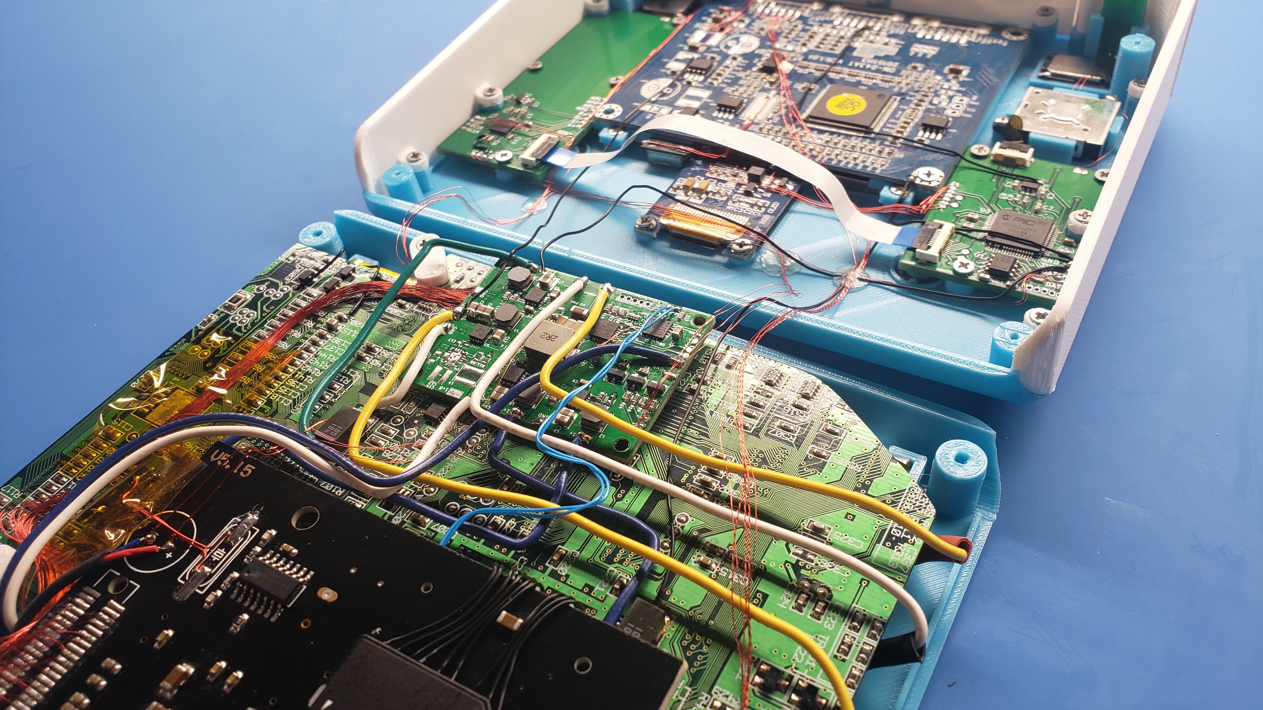

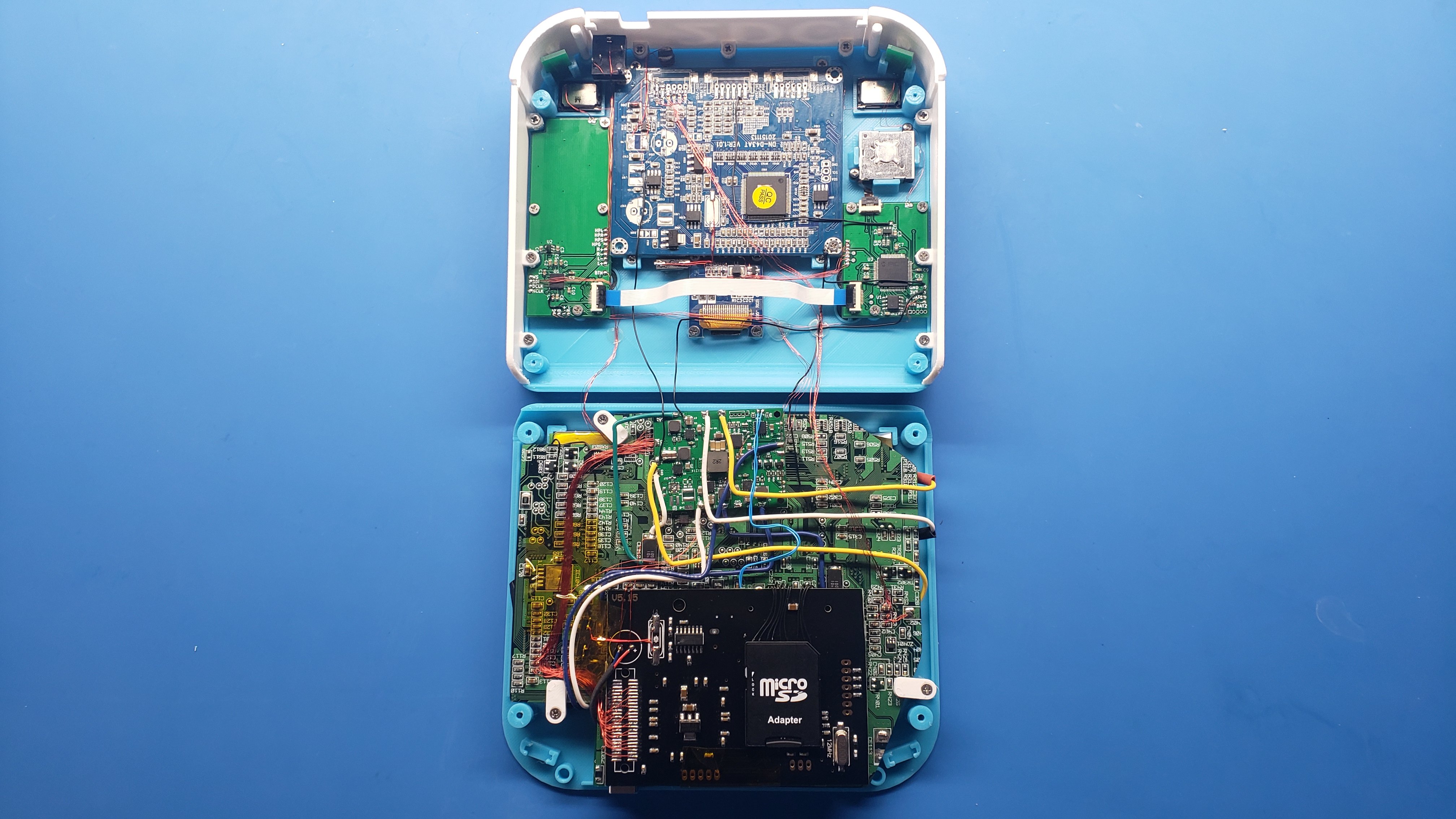

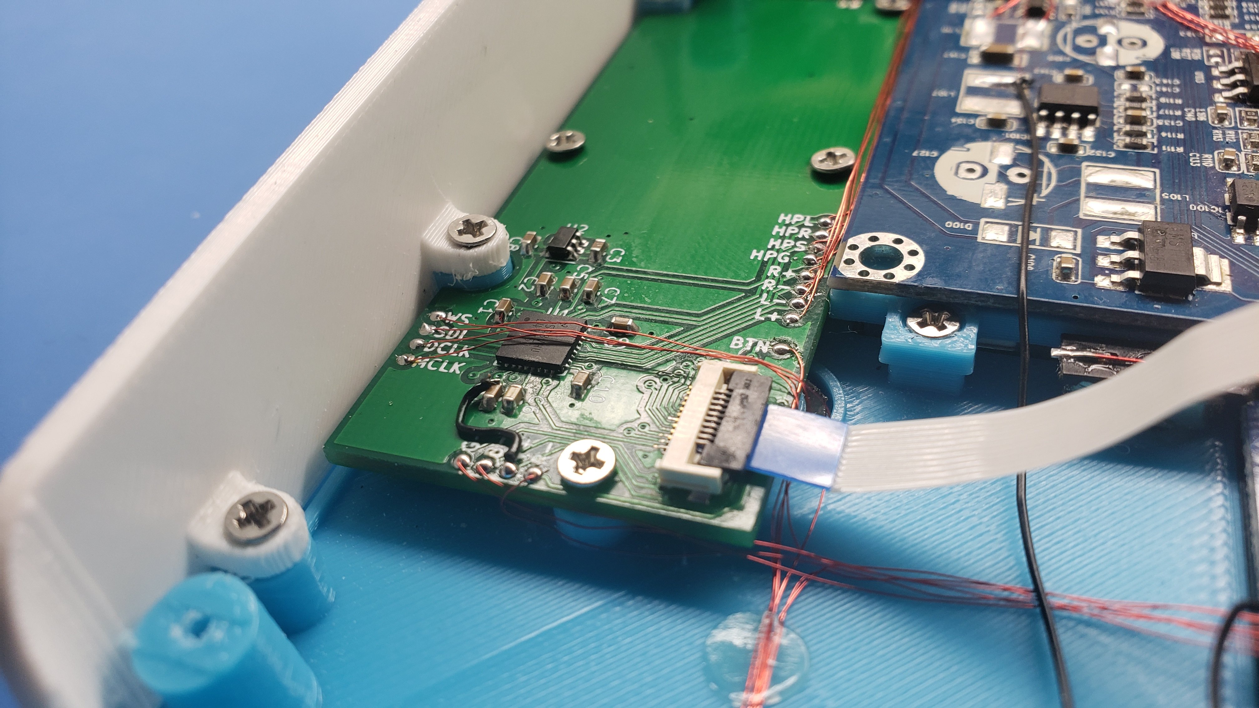

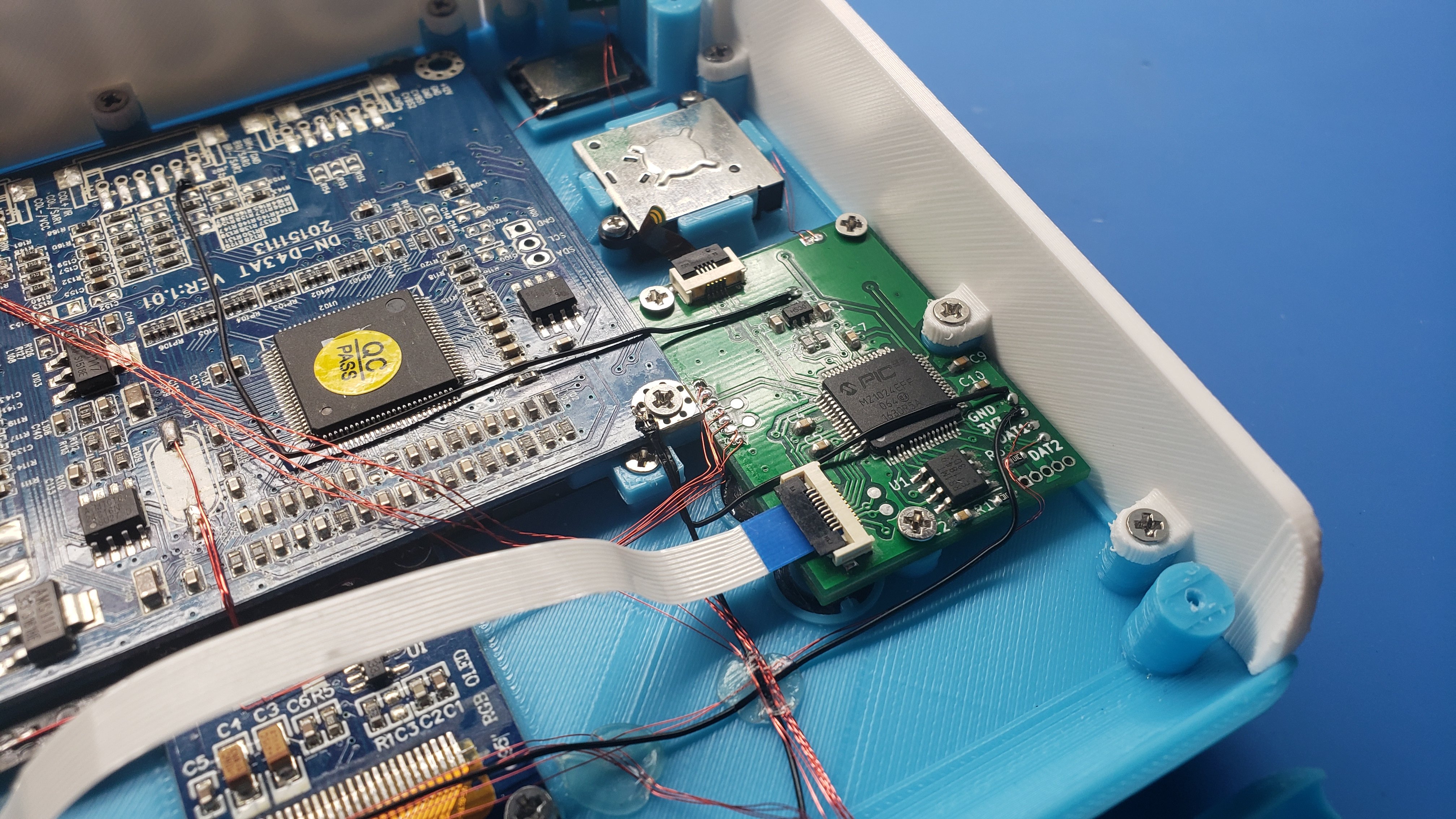

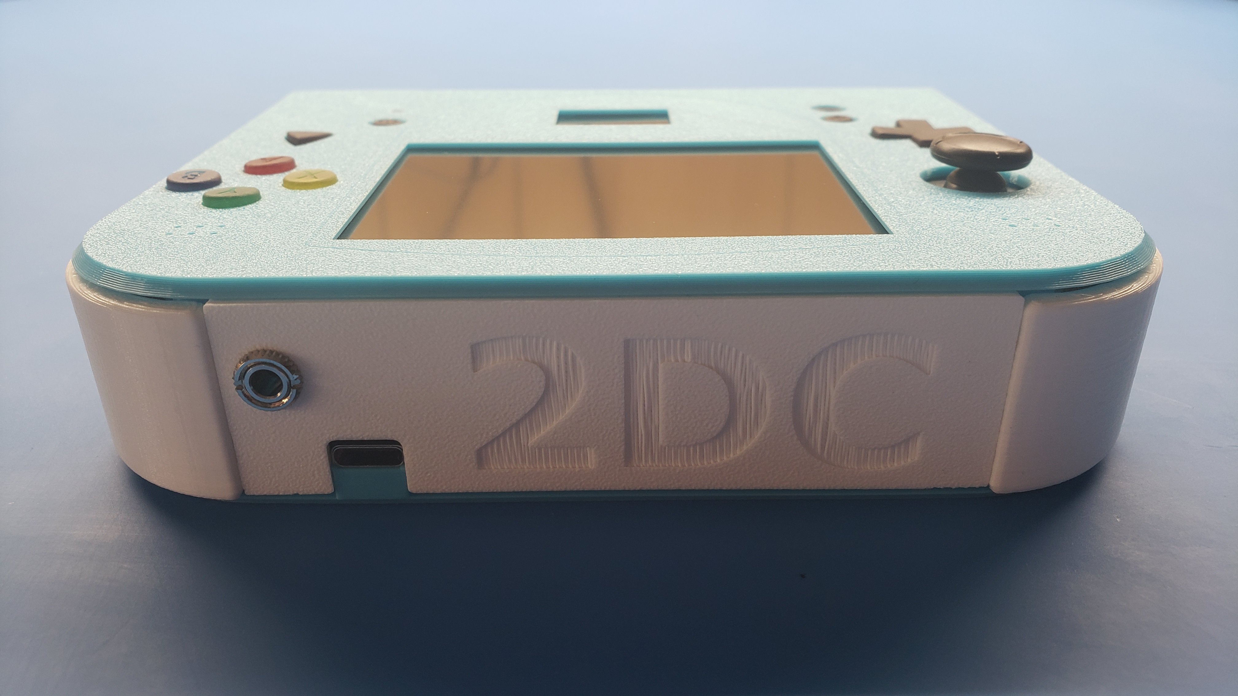

Hi,

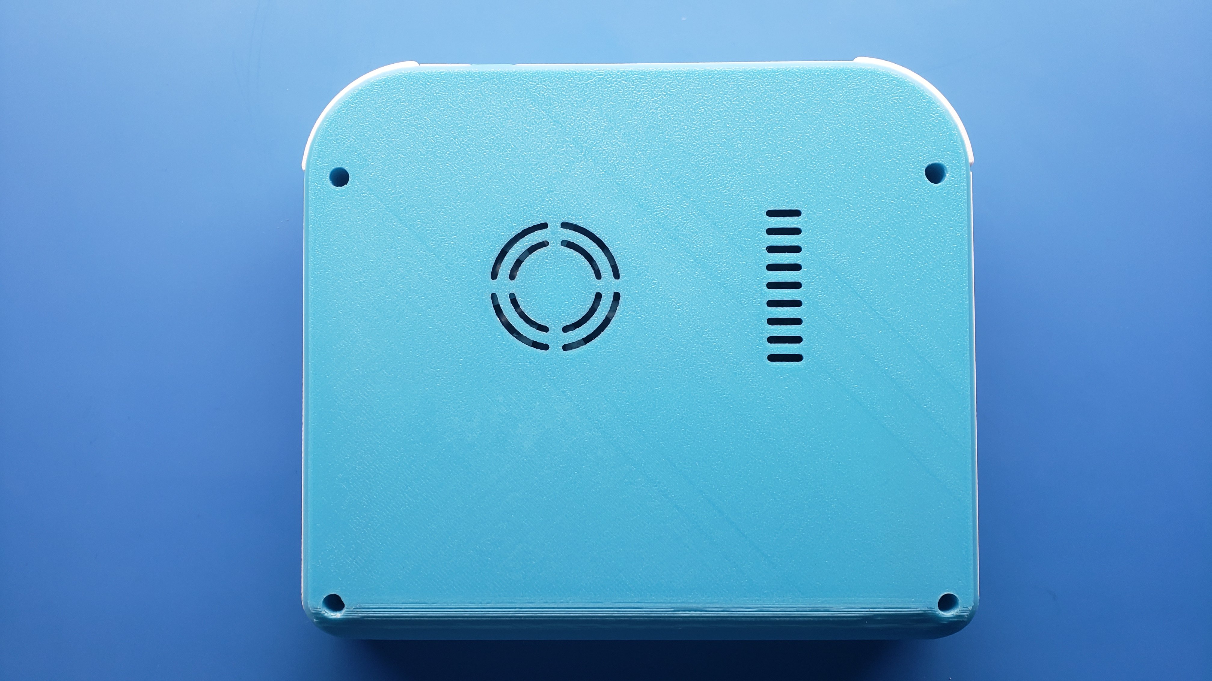

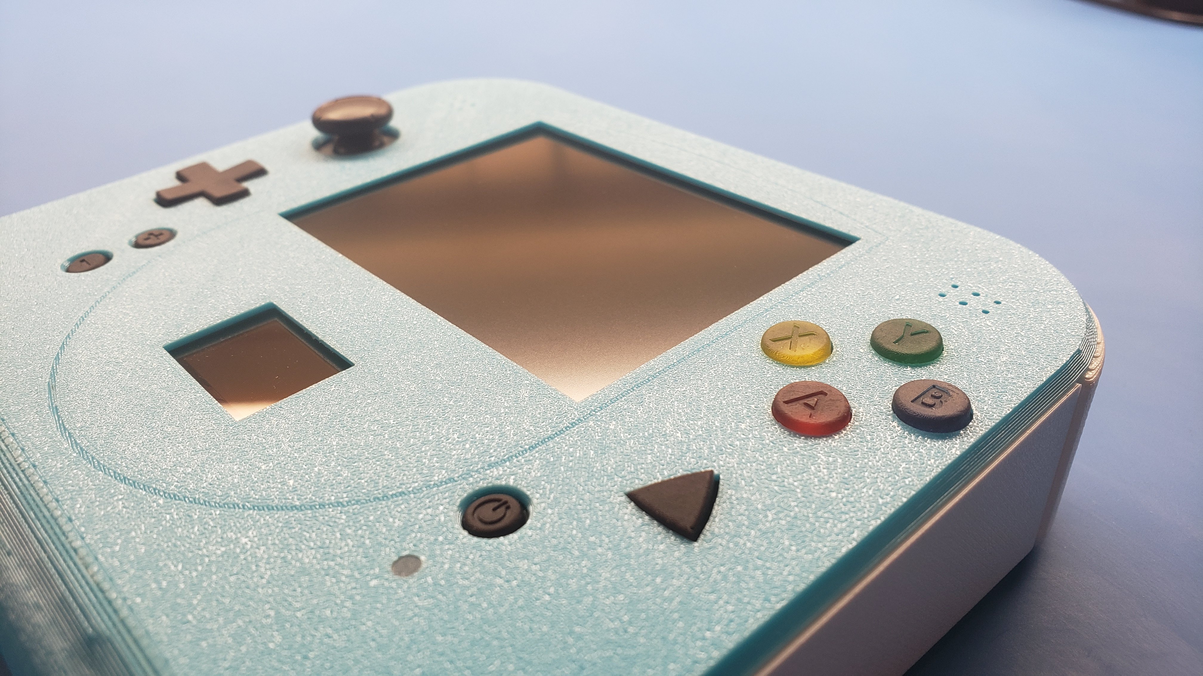

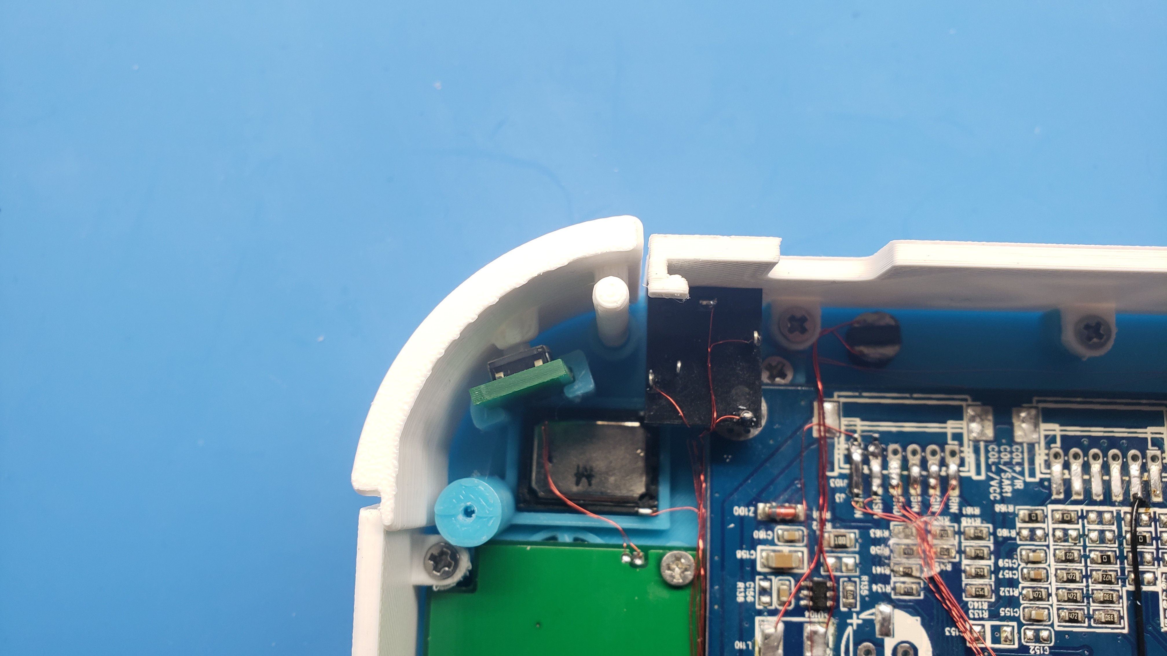

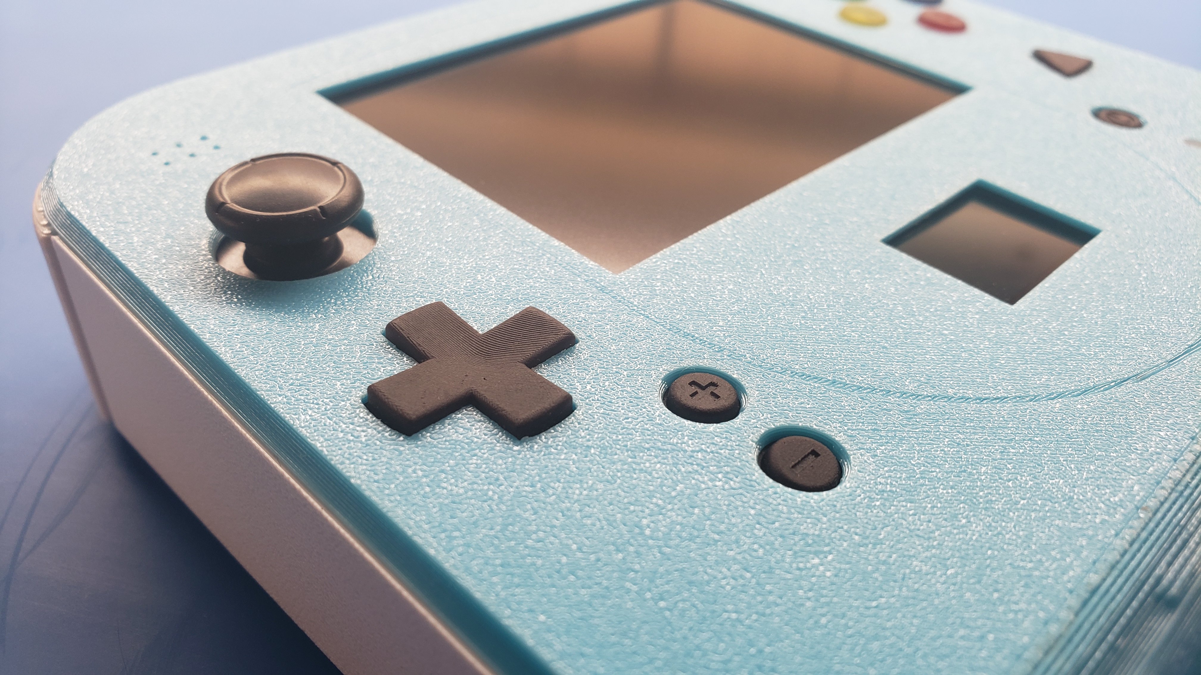

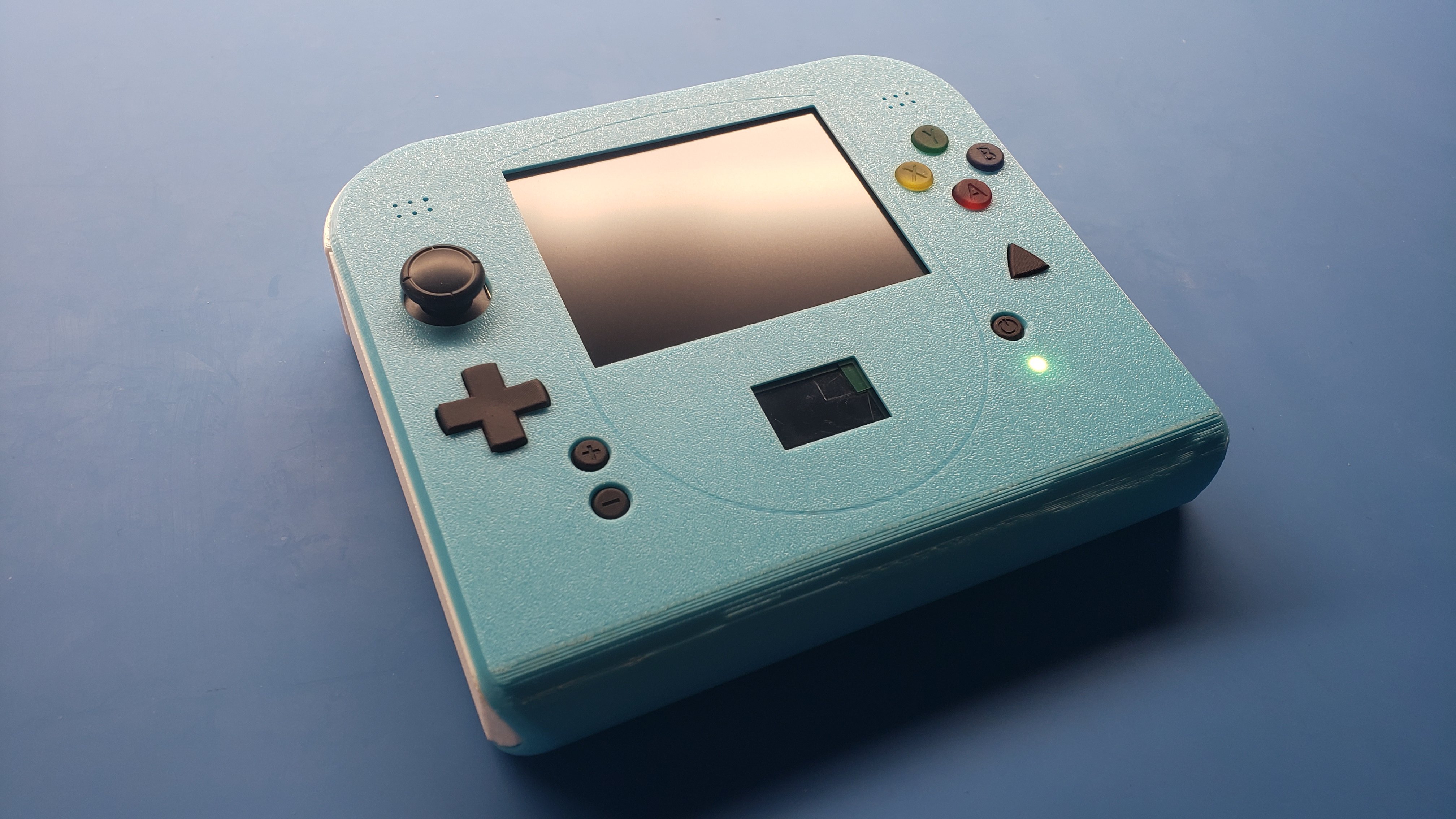

The 2DC is finished! Hope you like it. Good luck to the other contestants, work hard.
Features:
Real Sega Dreamcast Motherboard -- not emulation
Loads games using a GDEMU
Dreamcast controller emulator (ie DC+)
-PIC32 based
-Range/deadzone calibration for Switch Joystick
-Integrated volume control through I2C
-DAC for OSD menu control. Hold Start + DL = Menu, Start + DU = Up, Start + DD = Down
-Future hardware support for VMU emulation (code does not do this currently)
Wii PMS PCB modified for Dreamcast
-Custom regulators ~7watts
-Charge/Play capabilities
-Thermal protection
-RGB led interface
USB-C PD charging
5amp lithium polymer battery
I2S Audio with speakers and headphones
3.5" VGA 320x240
Custom designed and molded buttons
31mm at thickest point
worklog: https://bitbuilt.net/forums/index.php?threads/2dc.2718/

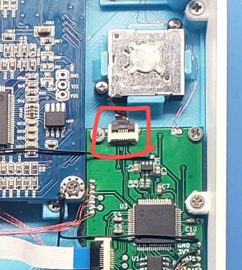

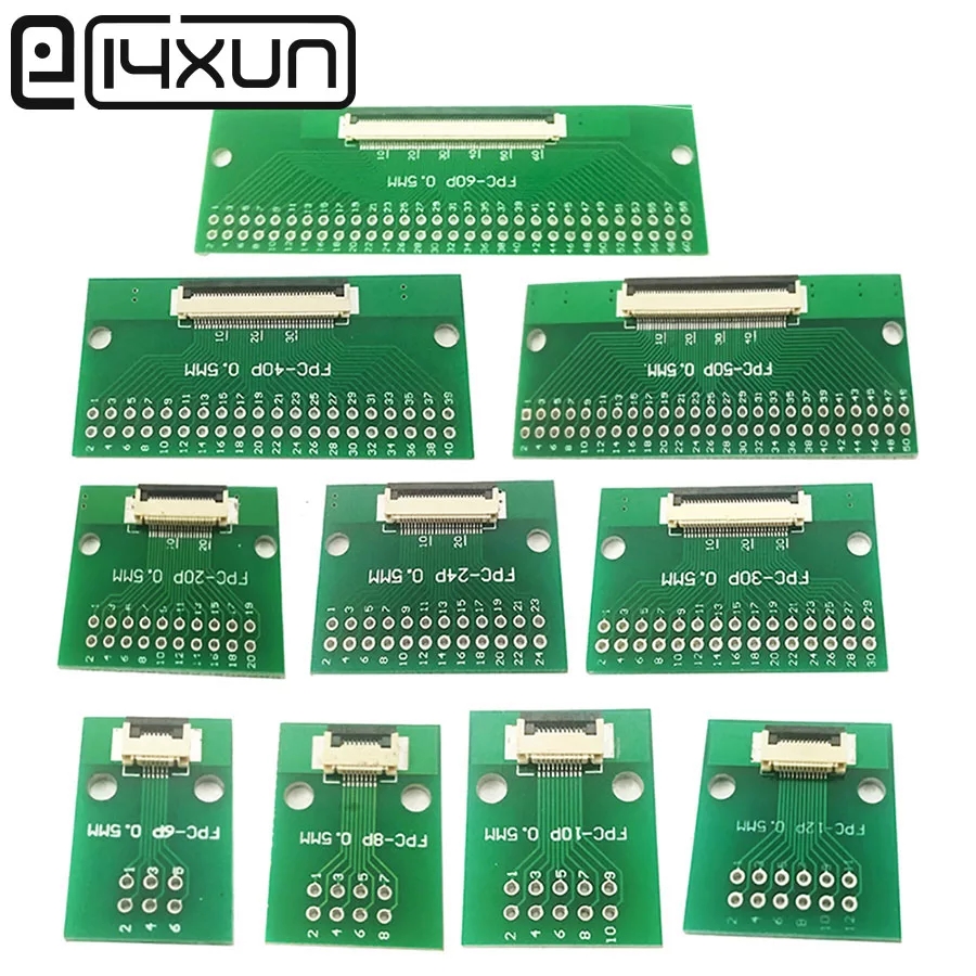

Hi, im novice here, gman, where i found these conector to purchase, aliexpress is better please, thanks
We usually prefer paying a bit more and getting them from digikey or mouser. Anyways those are 5pin 0.5mm pitch FFC connectors with bottom contacts.
Hi, these?
