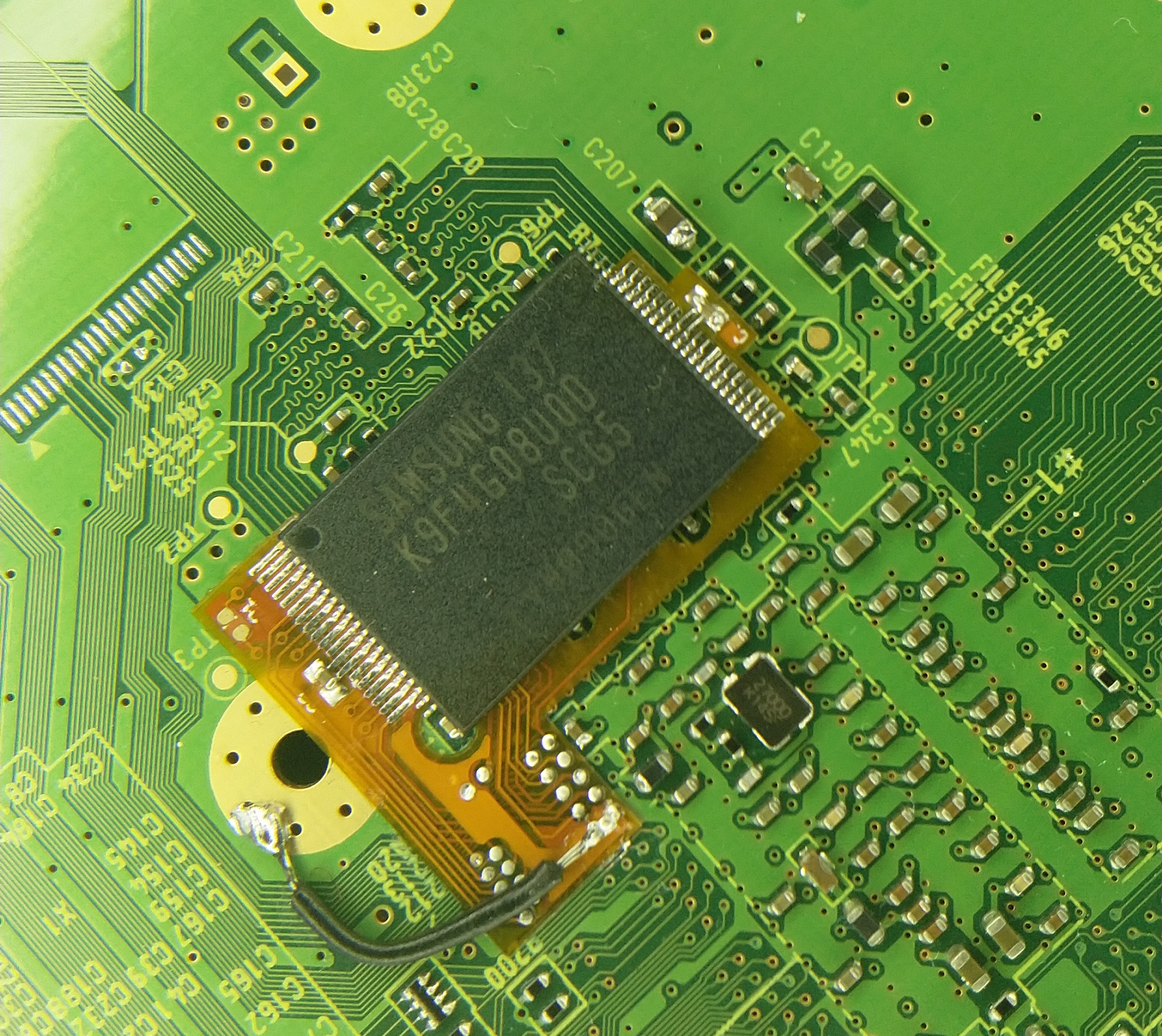

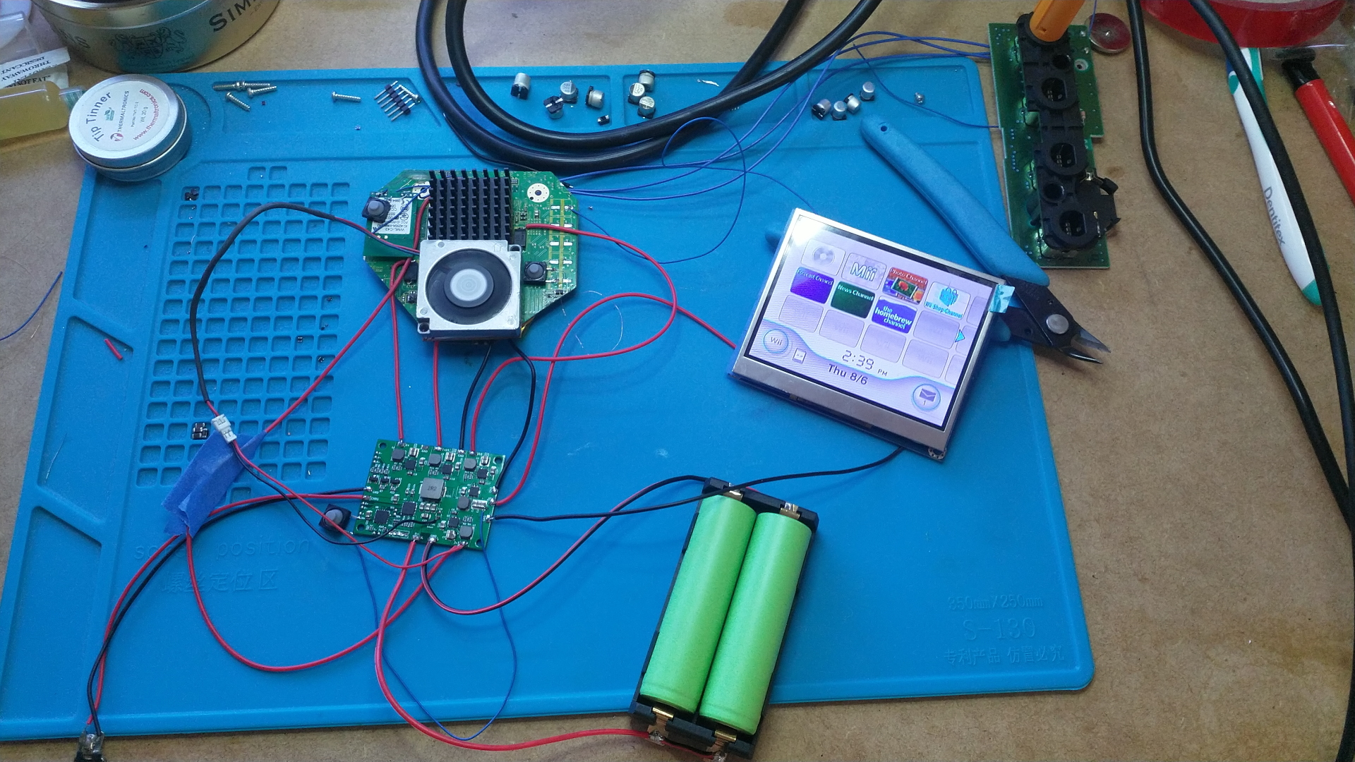

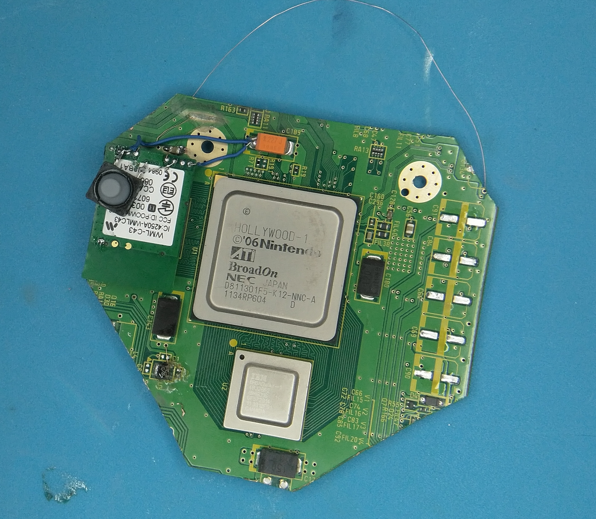

Update: My dumb ass managed to hit the 1.8v tantalum cap by the RAM during trimming, but Number 3 is still alive!
The test wiring isn't pretty, but it works. Gets into sysmenu and everything. So far I've relocated the NAND, U10, BT, MX chip, and the 1.8v cap. Next is USB, U-Amp and a GCDual with Wii compatible firmware for better scaling (edit: fuck that, too much bullshit going on). Sadly that screen is only 320x240, but I do have a 640x480 one on the way.
I'll show the full noods once everything is in place.

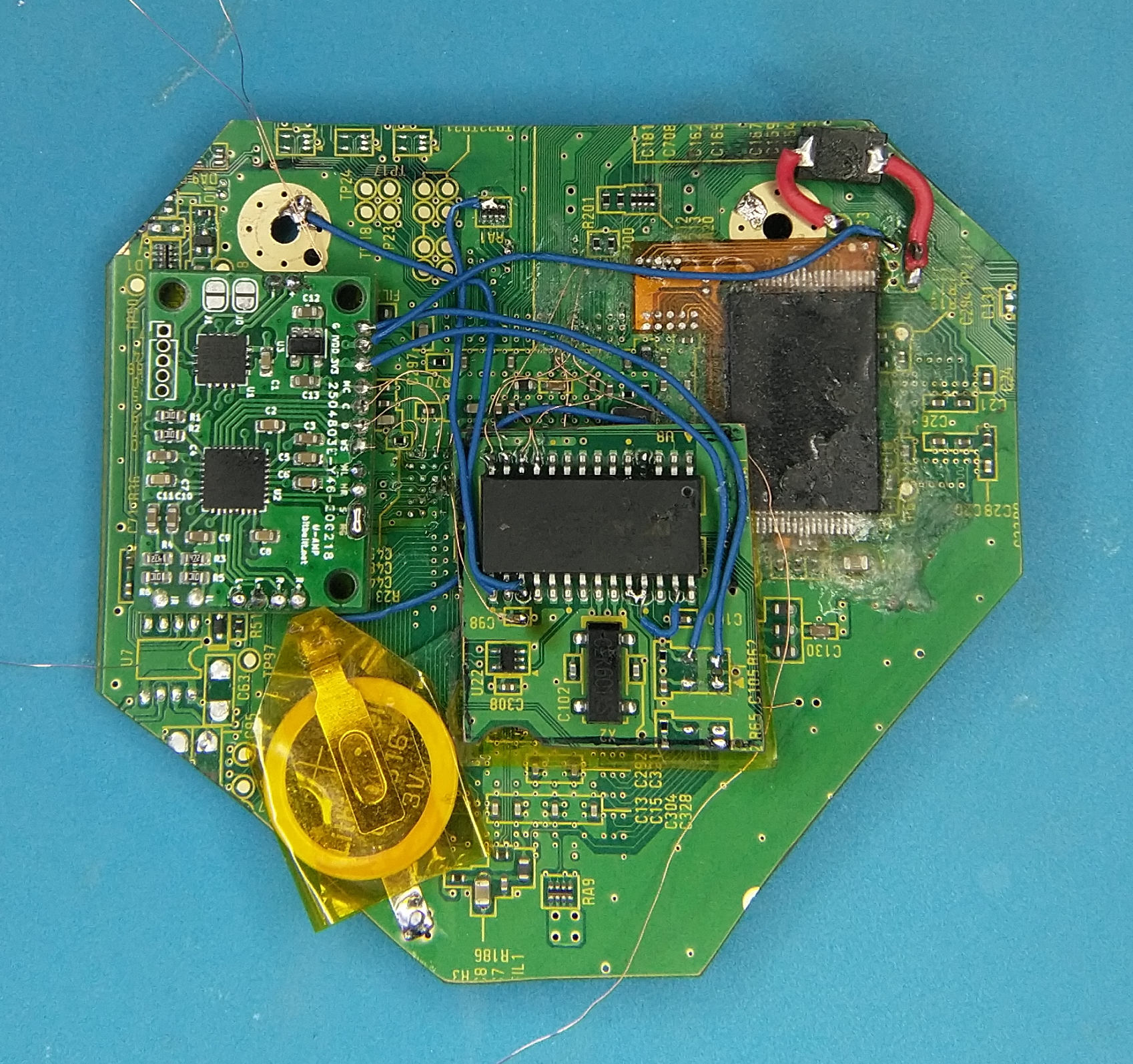

Triple post but its my own thread so go heck yourselves. Lookit this fine ass.
Ignore the shitty epoxy job, I used 60 minute set instead of 90 second by accident and it spread out way too much and then got baked a bit by hot air. I was trying to go for a Gman level wire arrangement, but my solid core just wan't playing ball and I cracked the shits and gave up. Kinda proud of my CMOS battery mount solution tho, those replacement GBC cart batteries are perfect for this. The MX stacking job does make the board a little tall, but I'll do it better next time. Now I just have to take final measurements and do the case design. I might actually finish this on time!

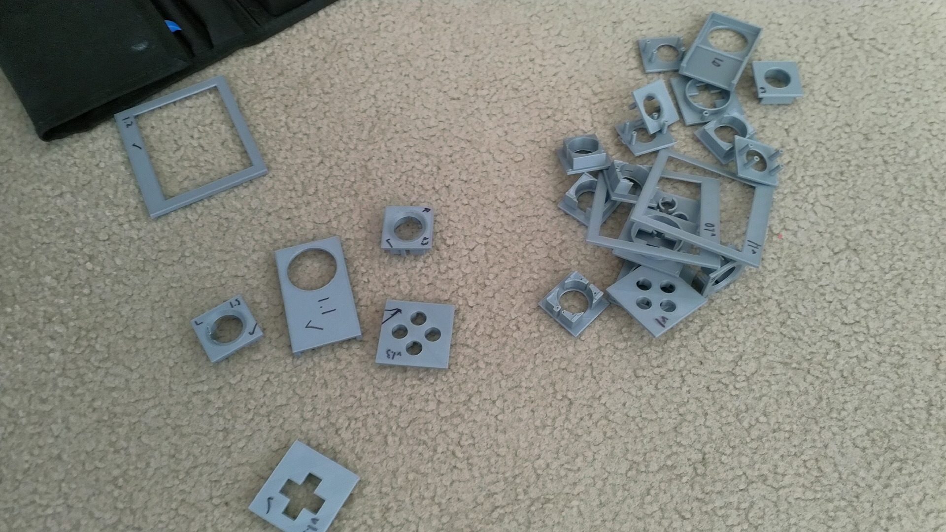

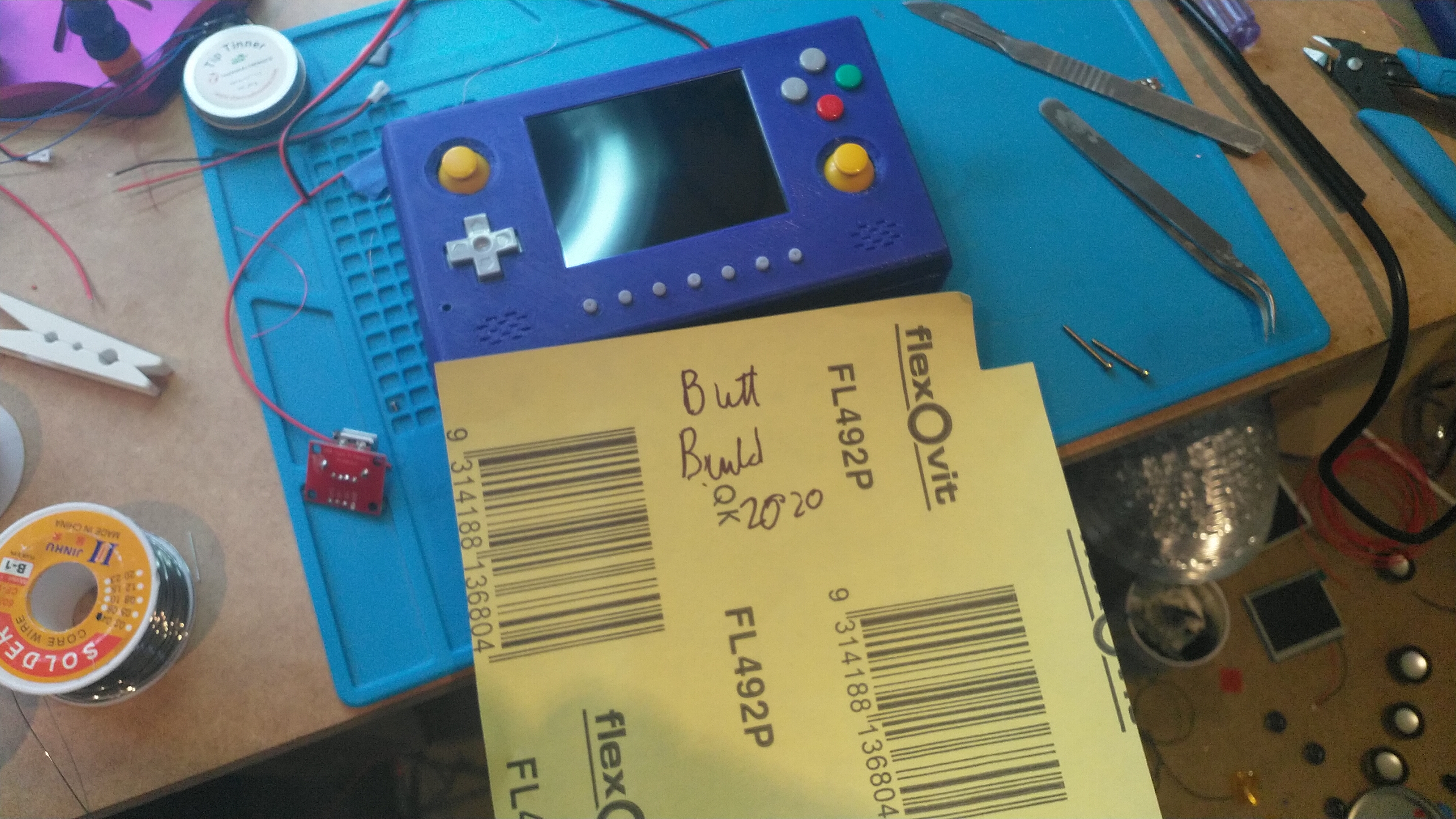

I did a lot of test prints to get these stupid controls to work, and the sticks turned out to be way more trouble than they're worth. I have the triggers, screen/volume controls, and the USB-C port left to work out, then I have to put errything together into a case design and print the thing. Easier said than done.
That's a lot of test prints, I hope you're able to get it by the deadline! But you forgot the most important thing yet: A name!
It has a name, I just ain't telling yet.

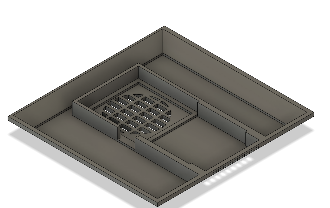

Modelling shit's aids yo, BUT IT SO PURTY!
I'm about to aliven't down the stairs

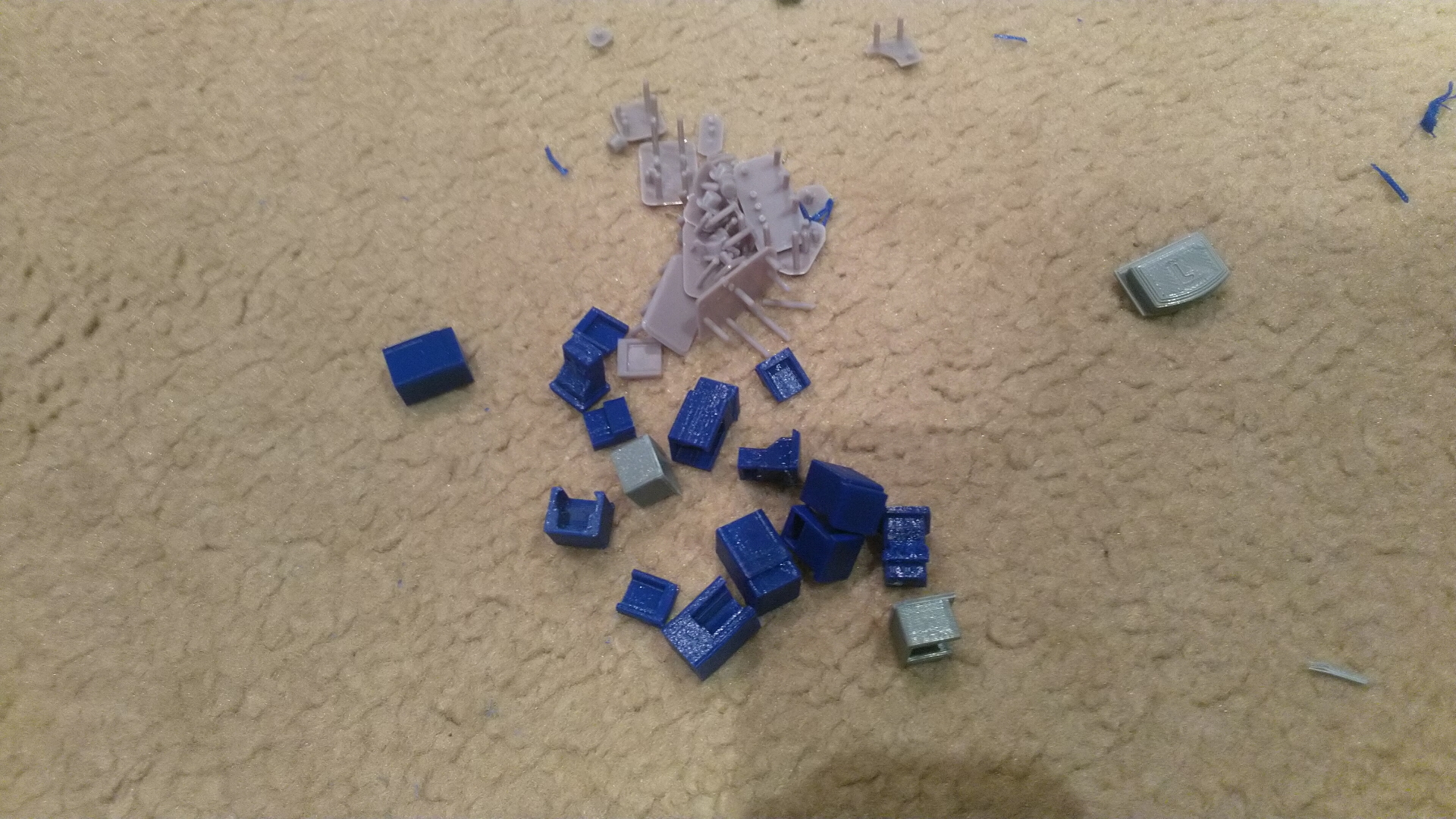

No those arent monopoly pieces, that's 6 hours of 4 different versions of bullshit trigger mount reprints
I feel your pain Stitches. You still have a little time before the contest closes!

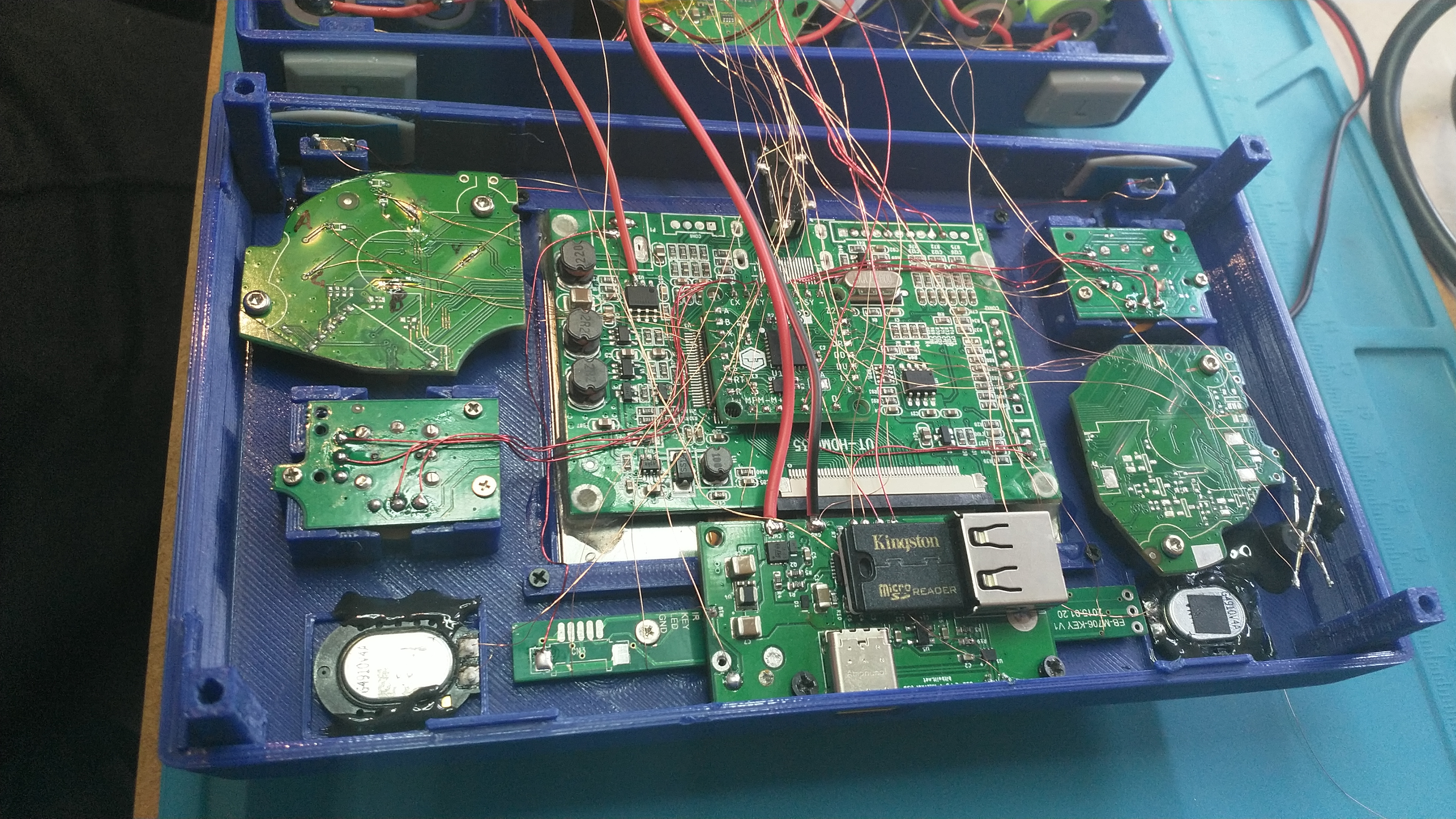

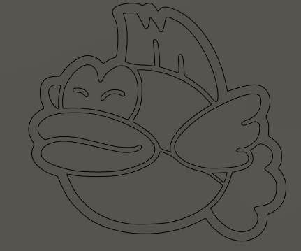

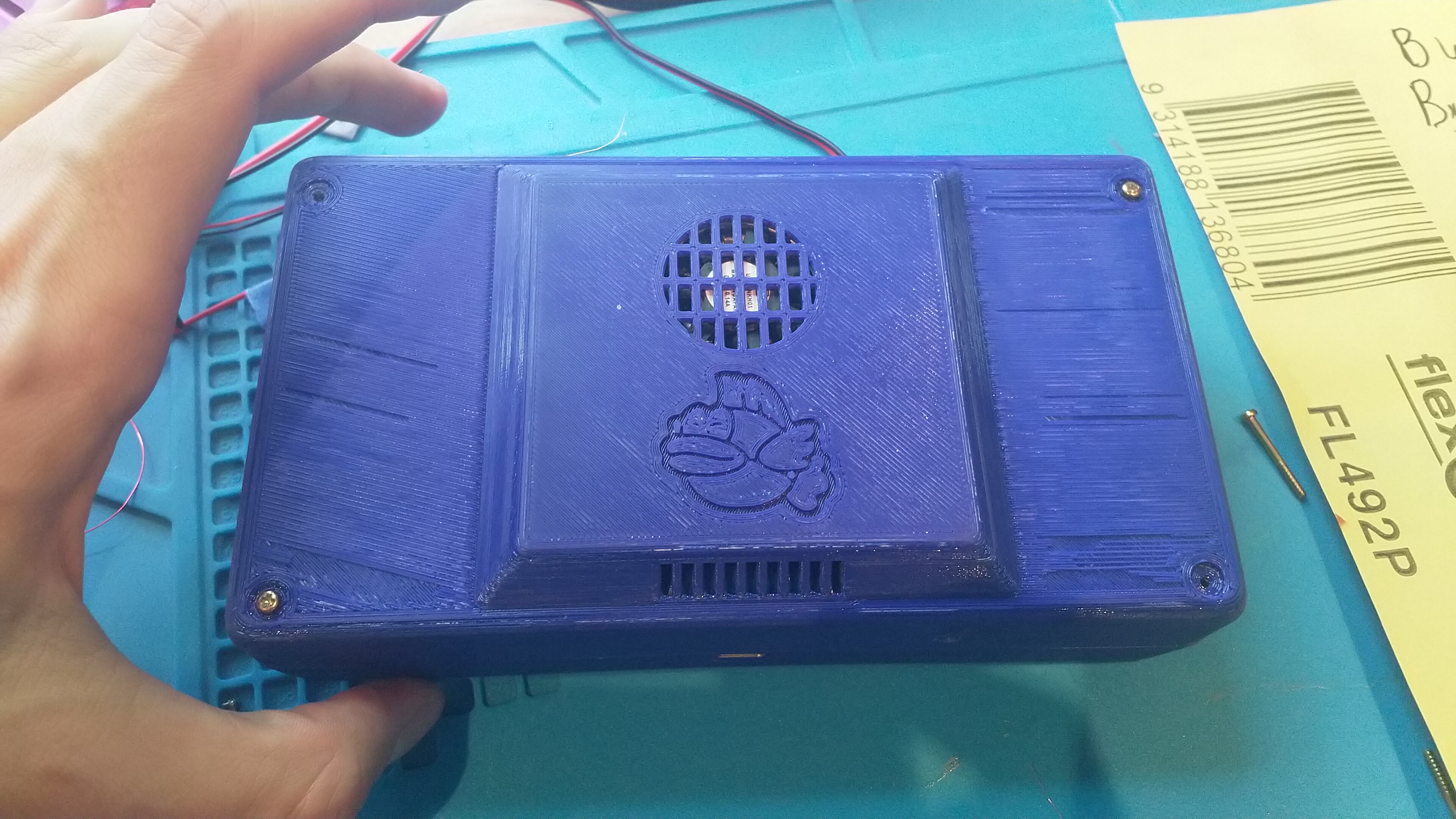

This is the Sushii
This is why
She the best partner in Paper Mario

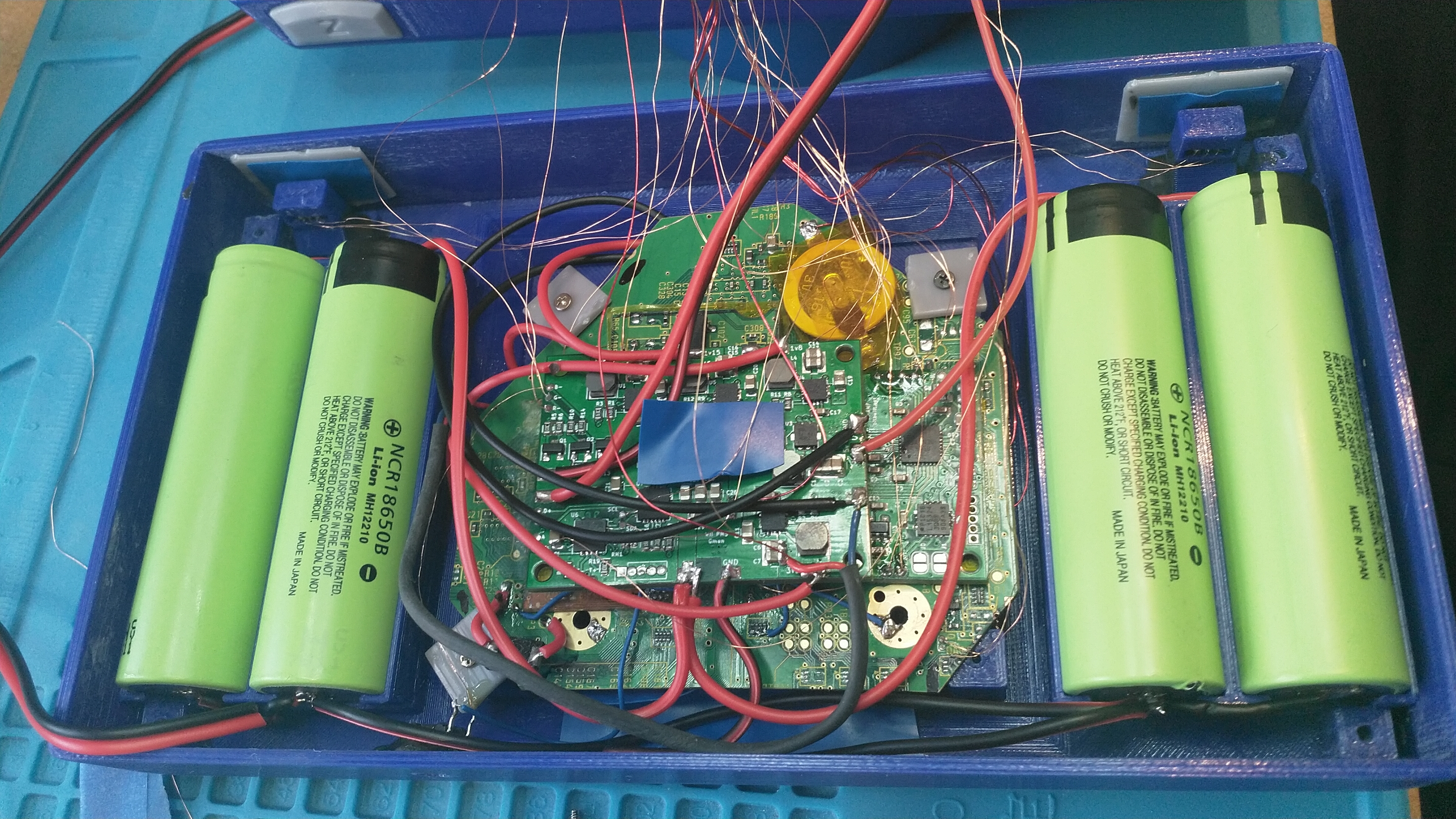

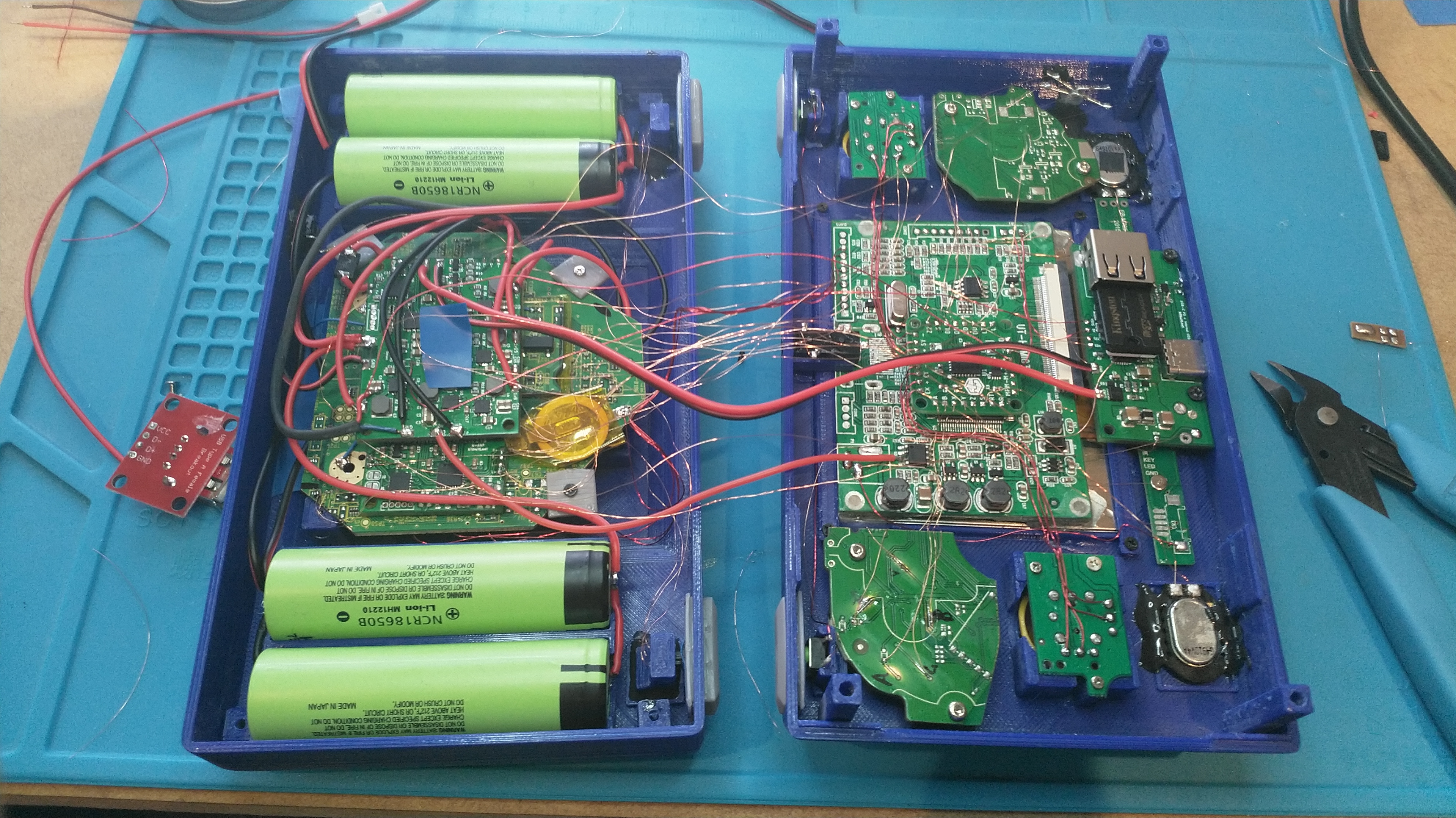

Here n00ds
I wanted to do a Gman level routing job, but I just ran out of time. I'll redux it soon, but I need a fucking breather now.
I DID IT!
