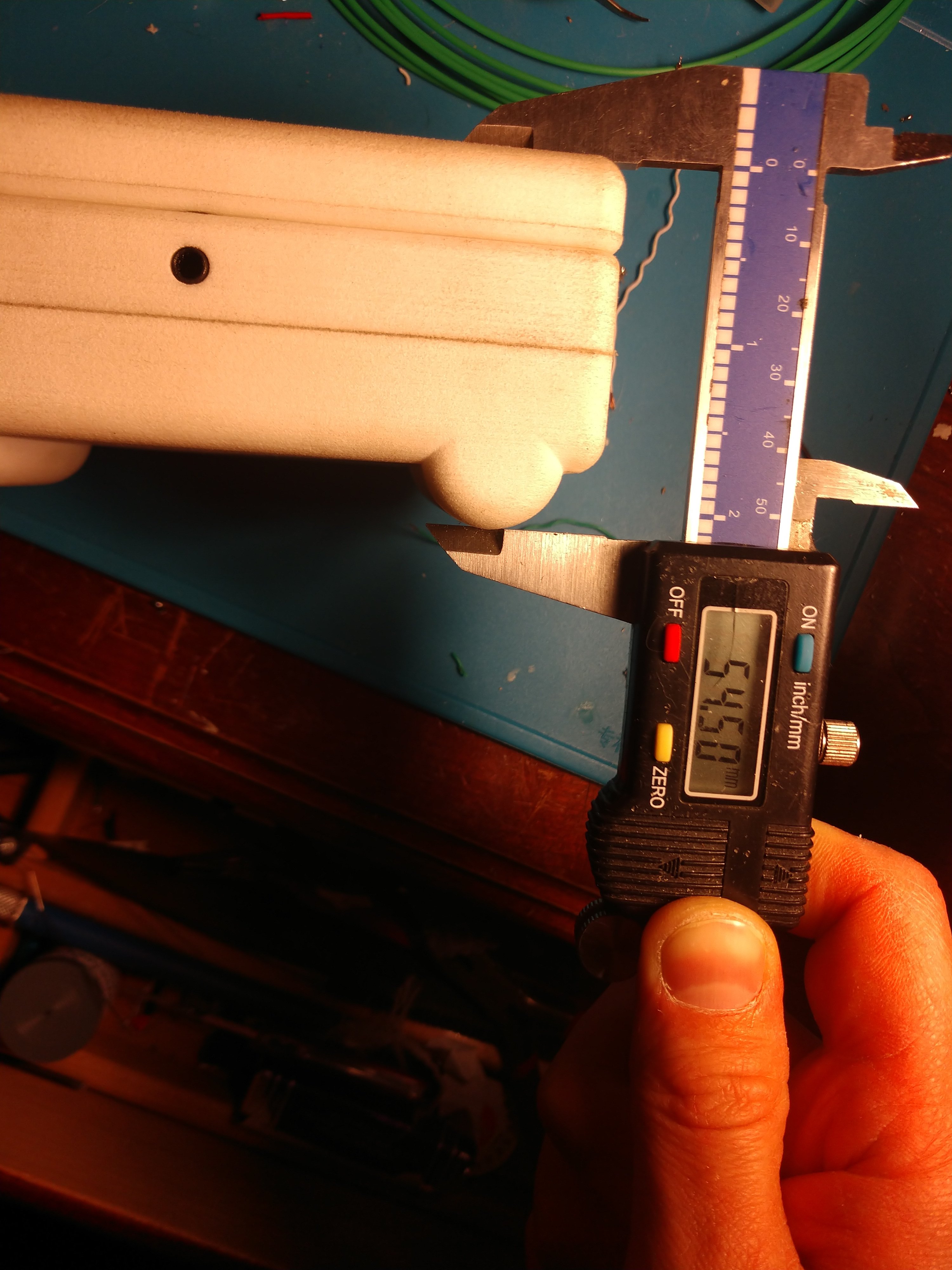

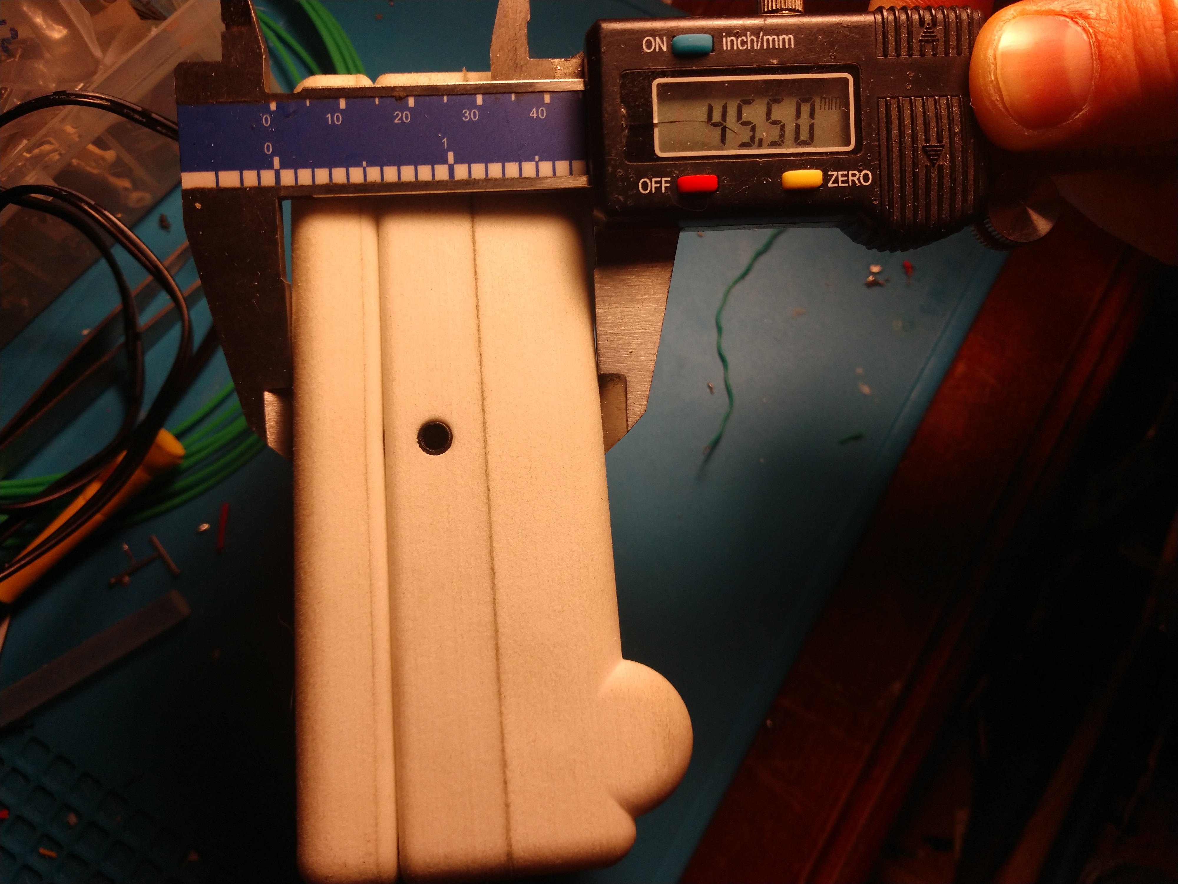

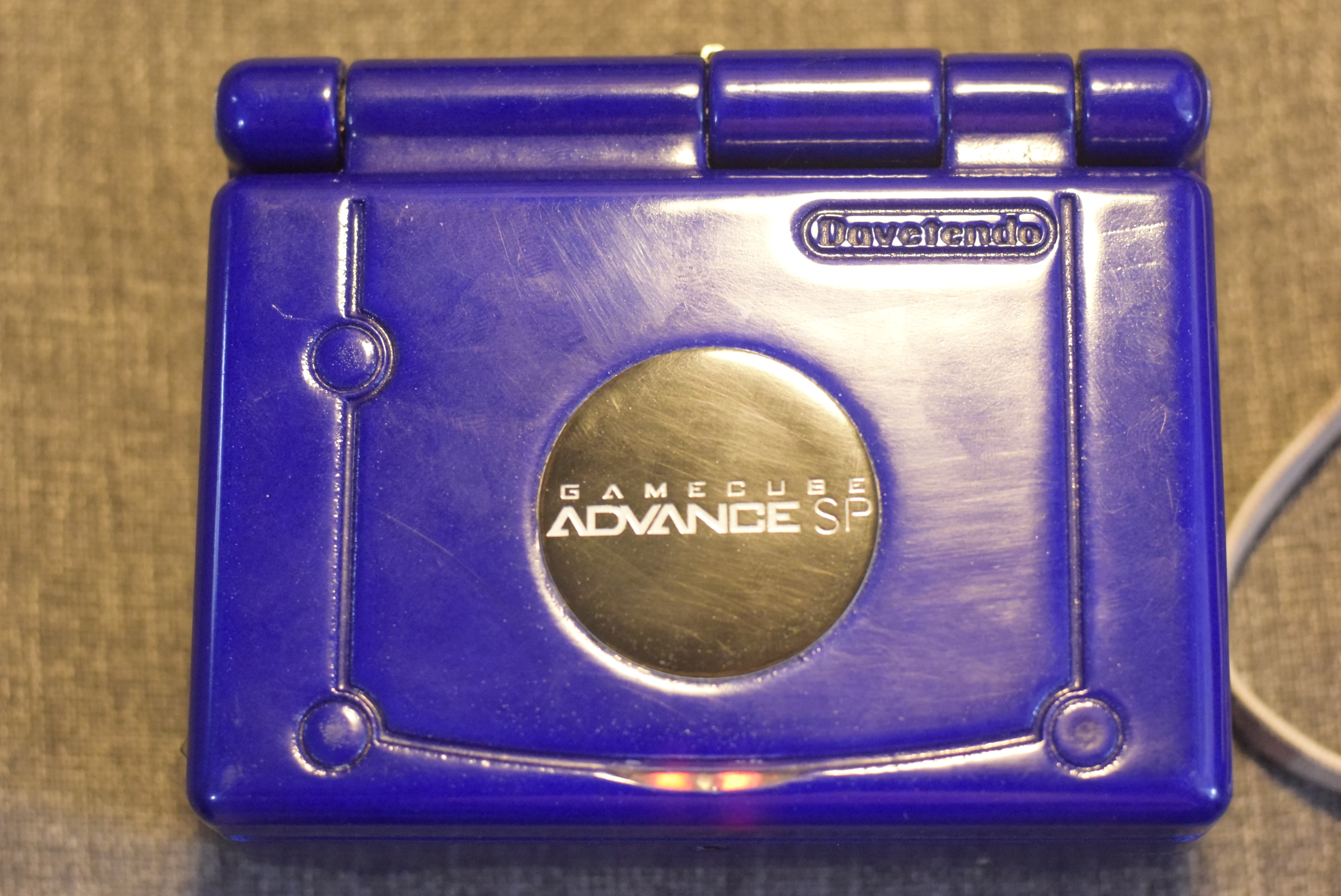

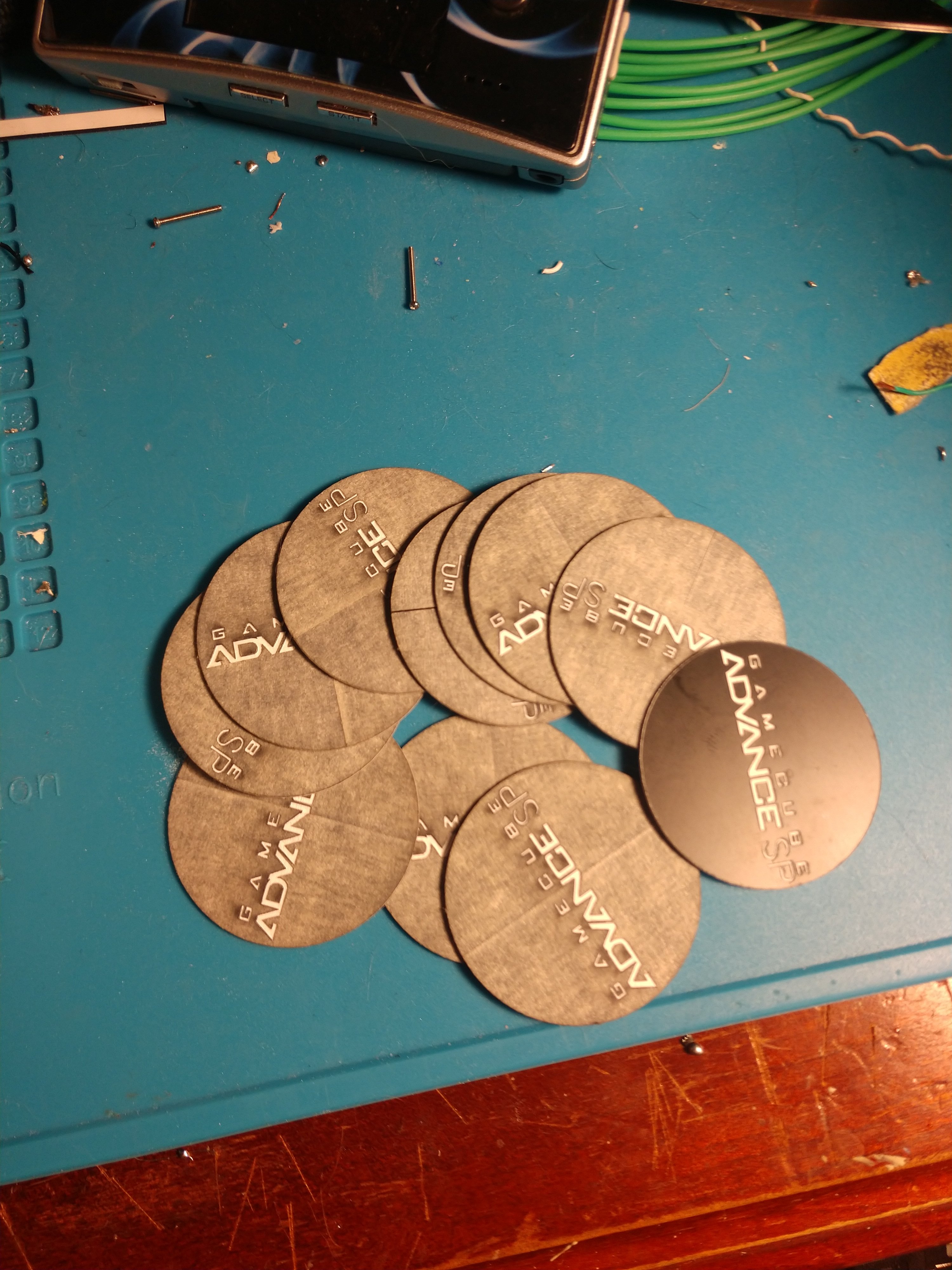

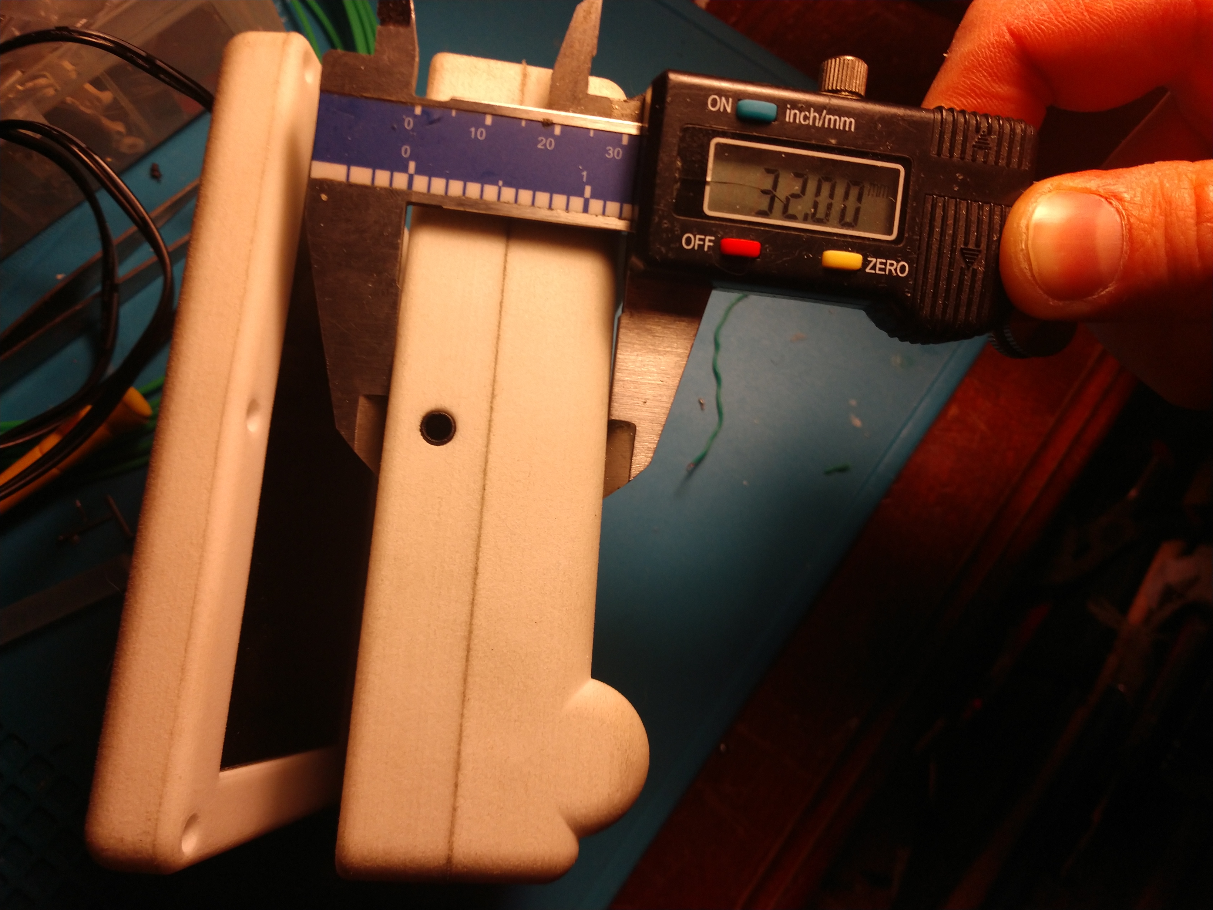

what's the thickness?
is the emblem just two pieces of acrylic?

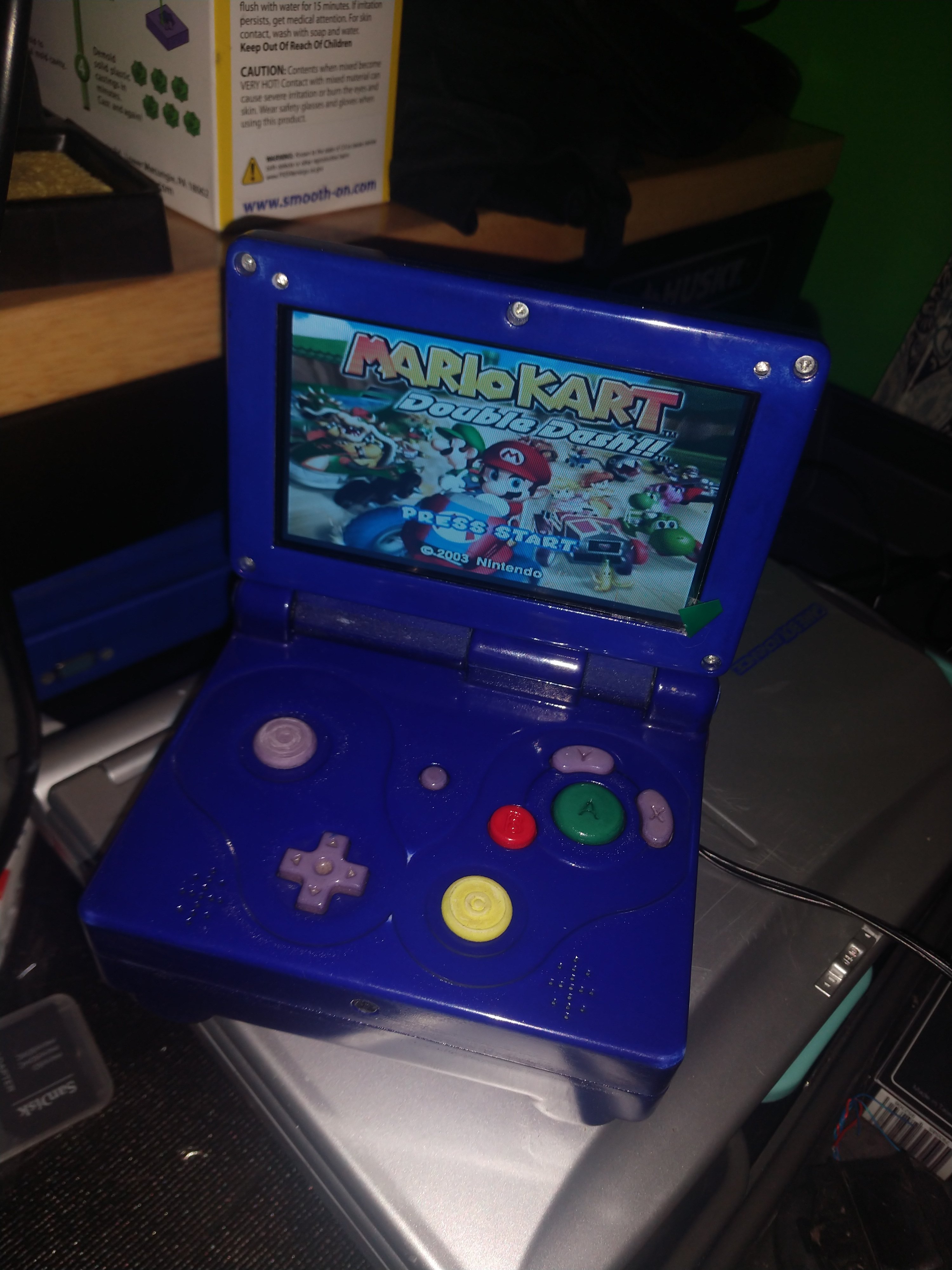

Wow, this looks legit! Hats off to you for everything from the 3d designing to the pcb designing as well!
@Bill Paxton

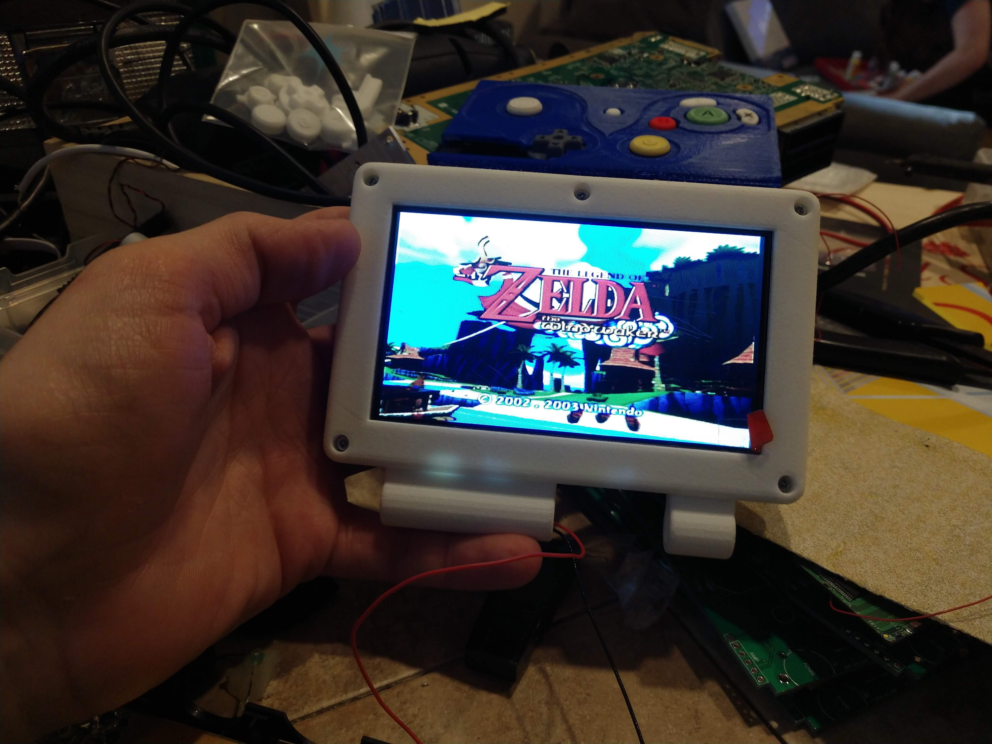

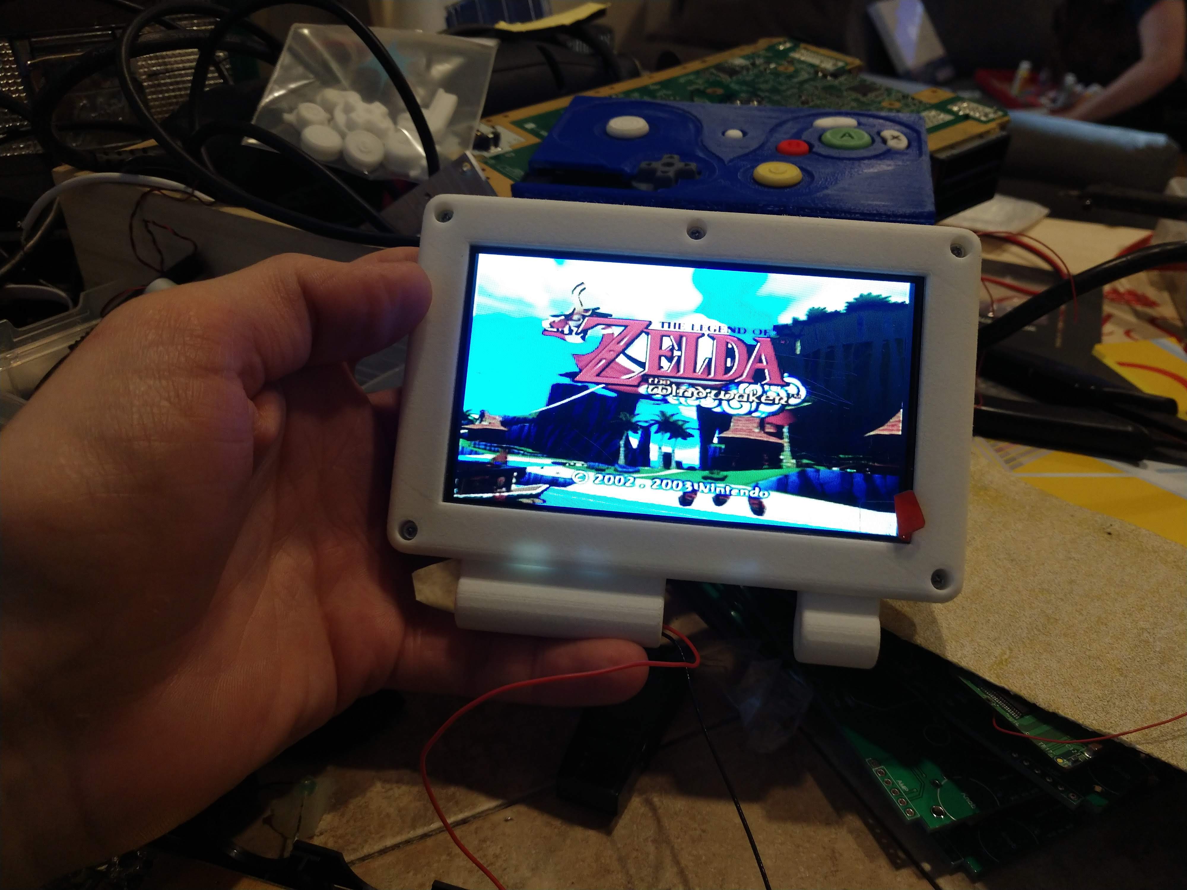

What screen did you use?
@Bill Paxton
Thanks. The screen I used was just a cheap backup camera kit thing from Amazon.

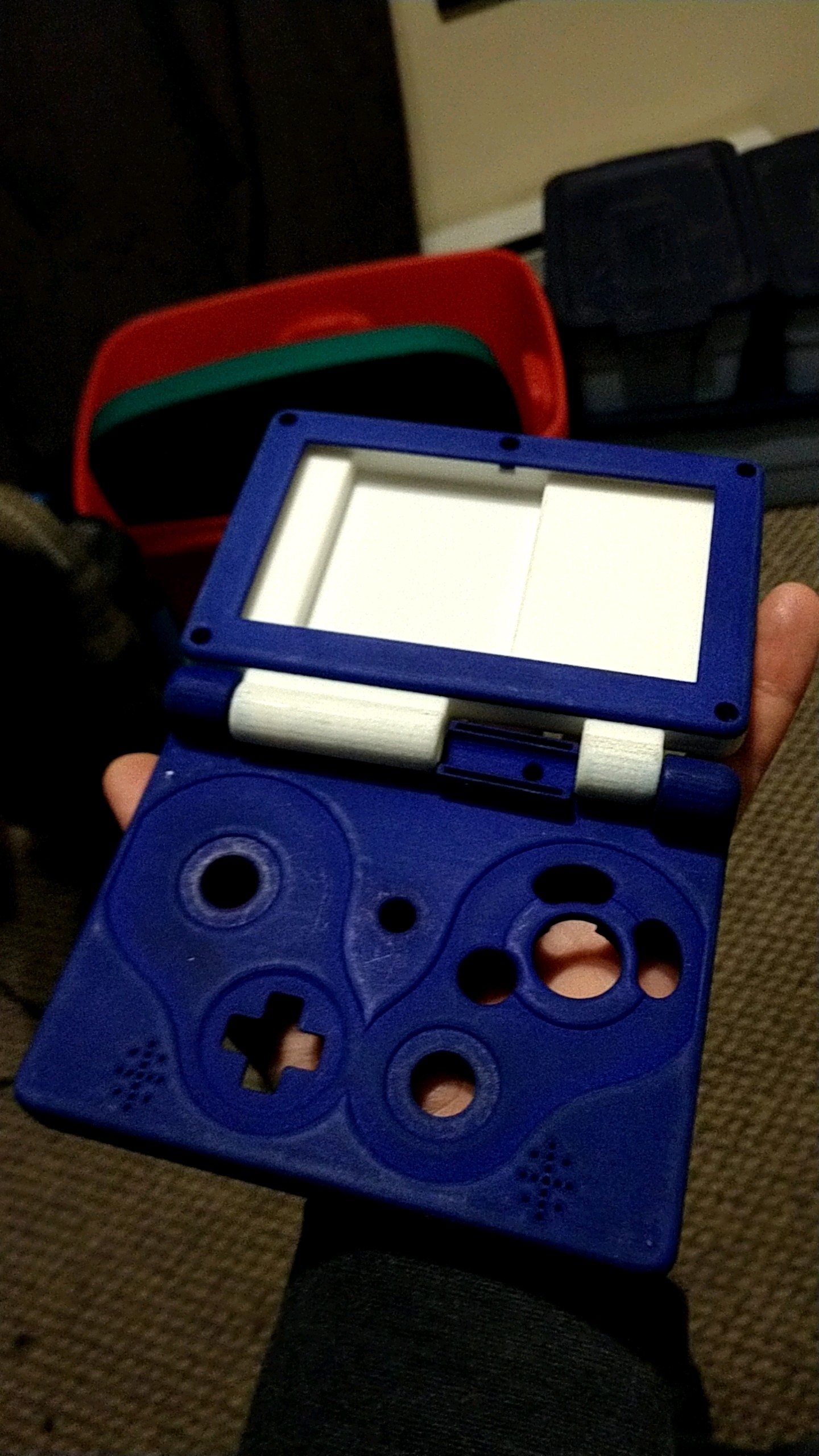

That's cool, technically speaking it should work with regular white pla aswell right?
and, if you don't mind sharing, is the hinge method using a ds type of hinge, or something else entirely?
Not sure if it will work with regular PLA. Initially I ripped apart a GBA SP hinge and made my own 3D model, scaled it up, and had Shapeways print it. Long story short: it worked, but not as well as I hoped. :( So I am now currently using two 3DS barrel axis hinges. One on each side.

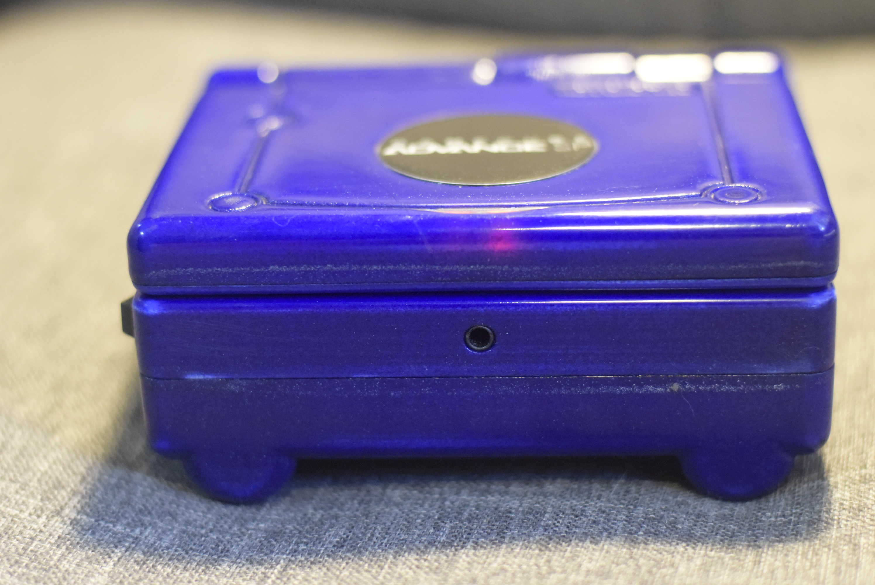

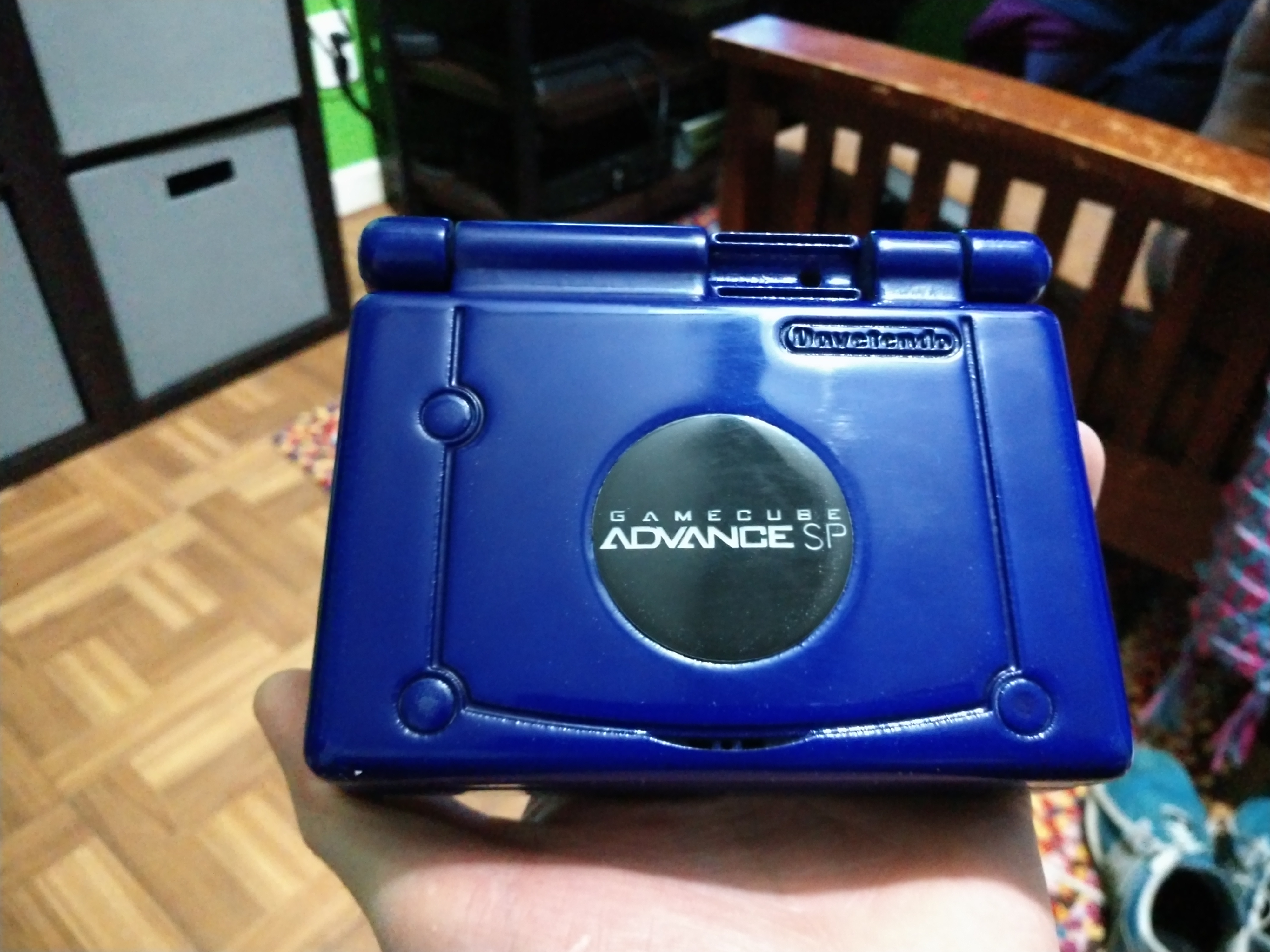

After many tries and fails, I finally leaned the correct way to mix and spray clear coat on things. Not 100% perfect, but I realized that if I keep aiming for absolute perfection, I'm never going to be done with this.
Nope, that looks to be only 99% perfect, so just start over again and send that one to me. I'll make sure it gets disposed of properly.
that thing is 2sexy4me
But you probably have too many so I'll take it off your hands

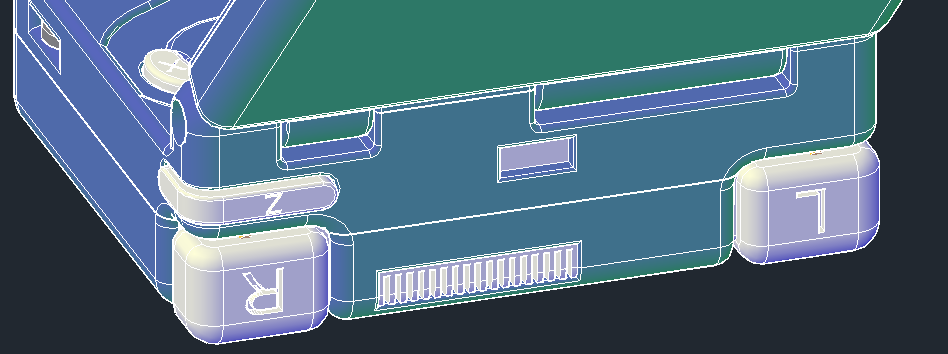

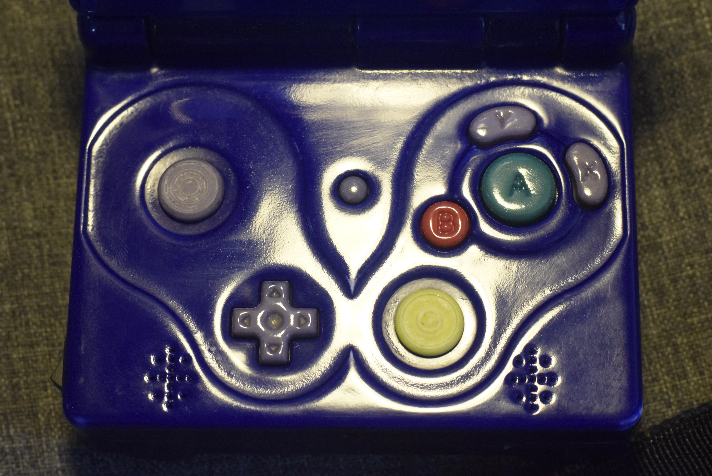

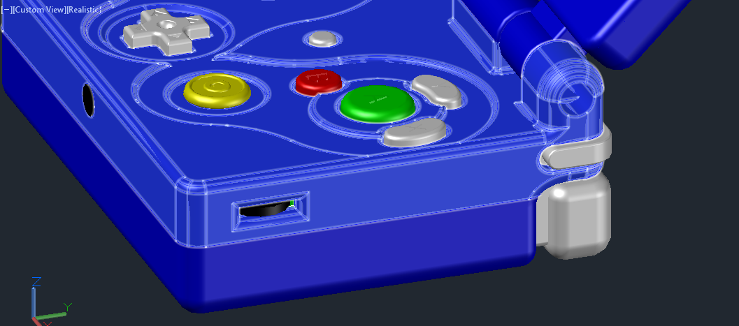

Amazing stuff, I really like the simplicity of the design, as well as the Gamecube Advance SP emblem.
What kind of buttons are you using for the ABXY? Did you pull them from an old controller or design them in CAD?
Thanks! The ABXY buttons were designed in AutoCAD. The face shape and diameter are same, but they needed to be shorter to fit into the design. Font of the letters is wrong, but I couldn't figure out what it was, so I just picked something close.

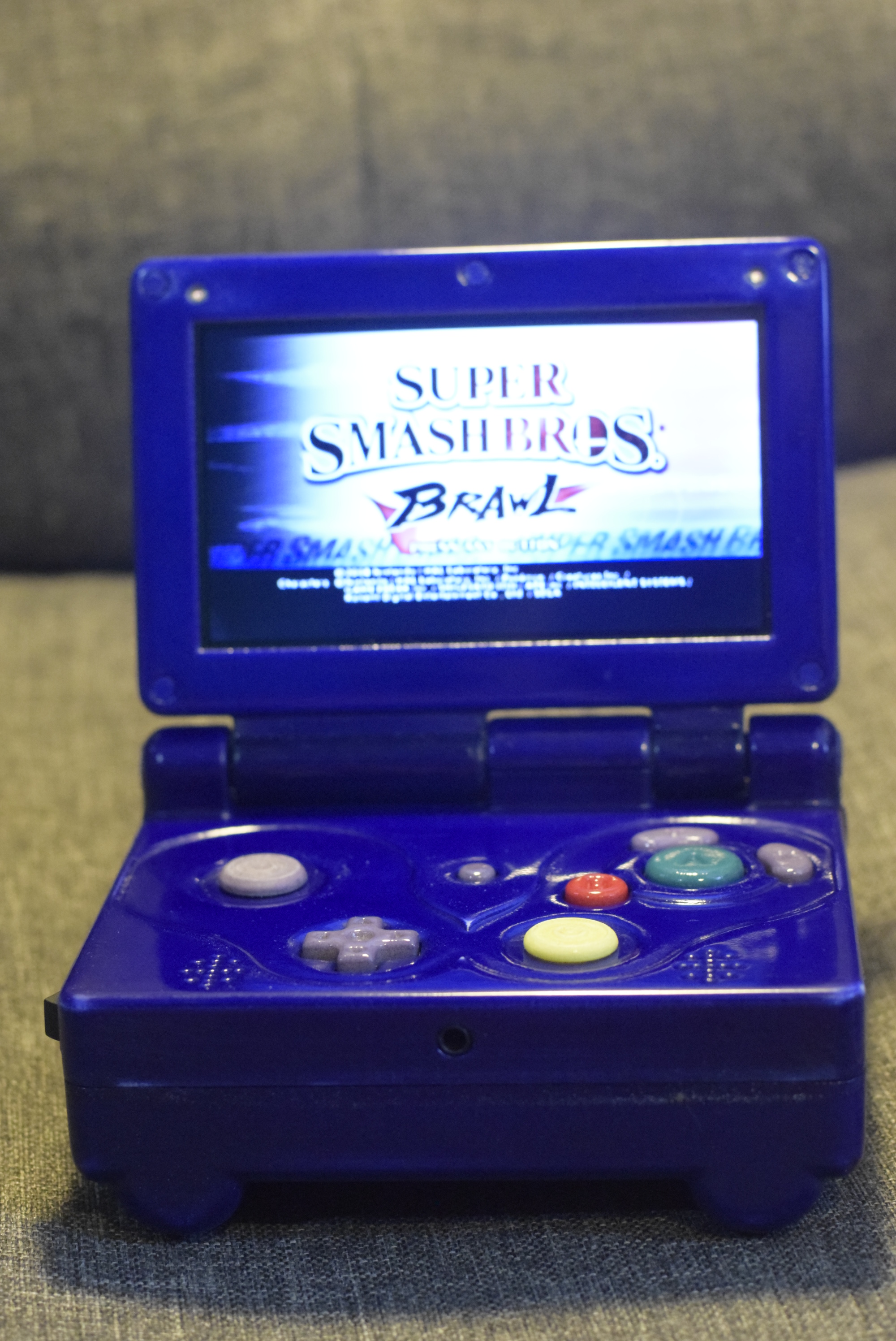

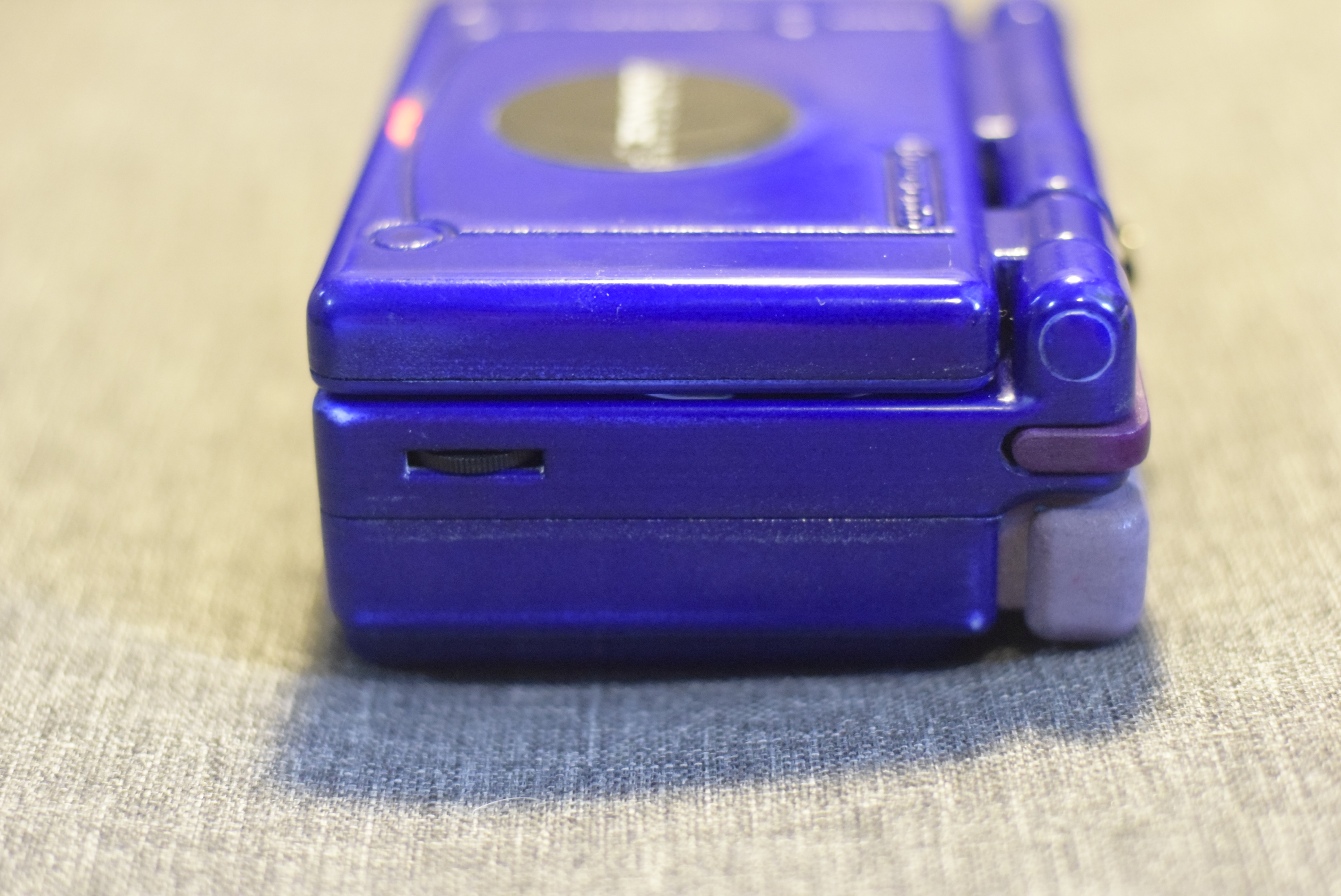

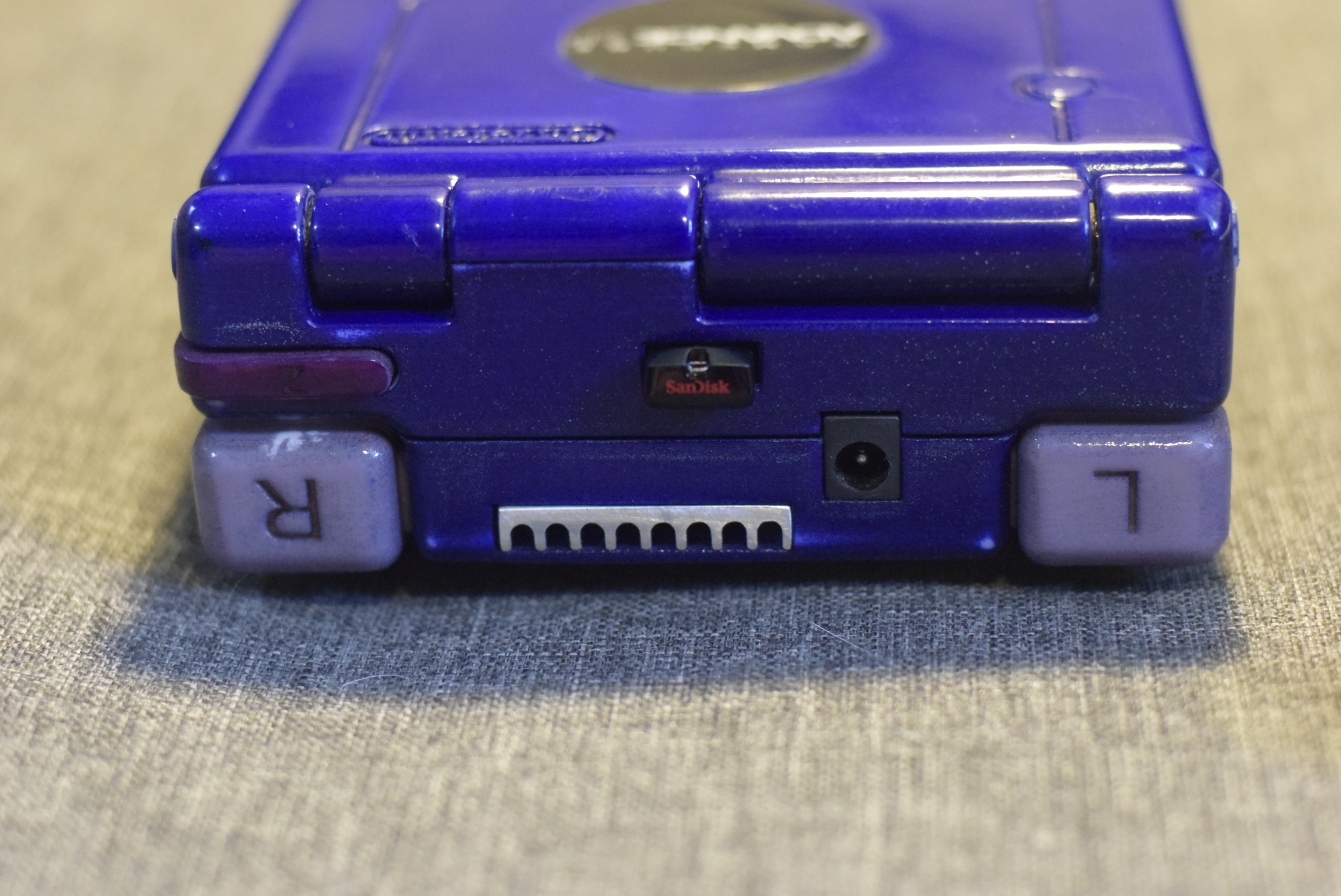

I stopped being lazy and shot a video today. Enjoy!

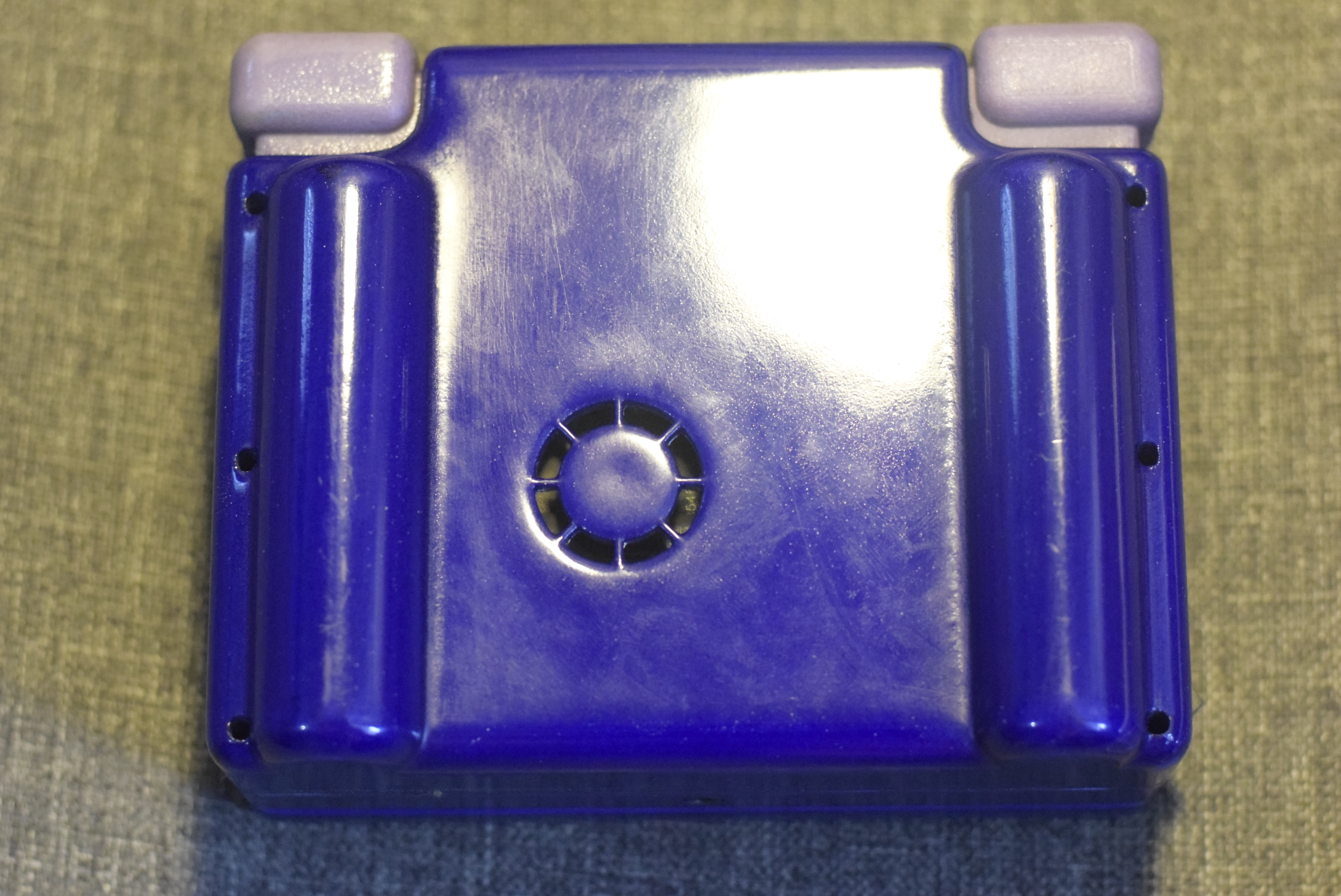

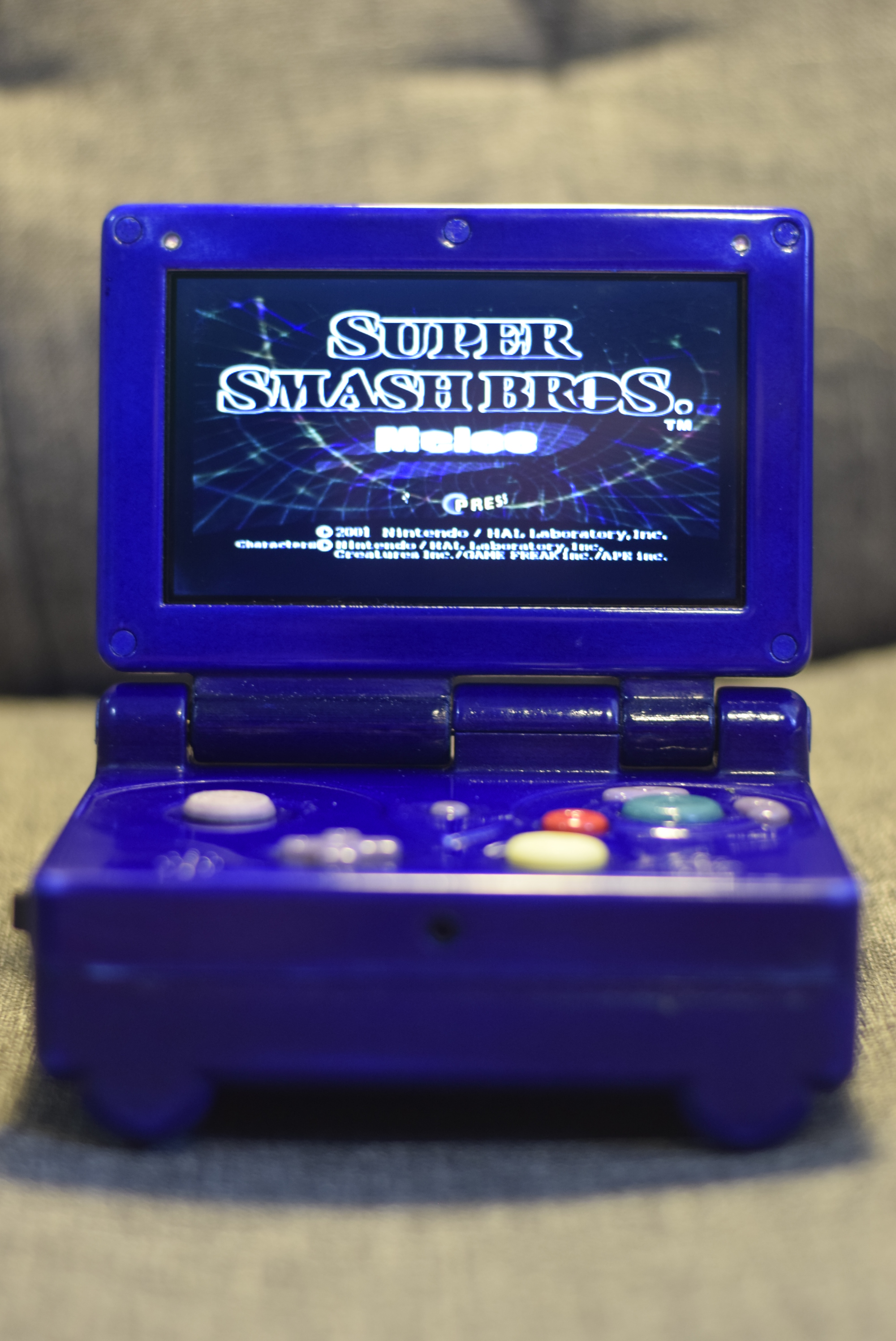

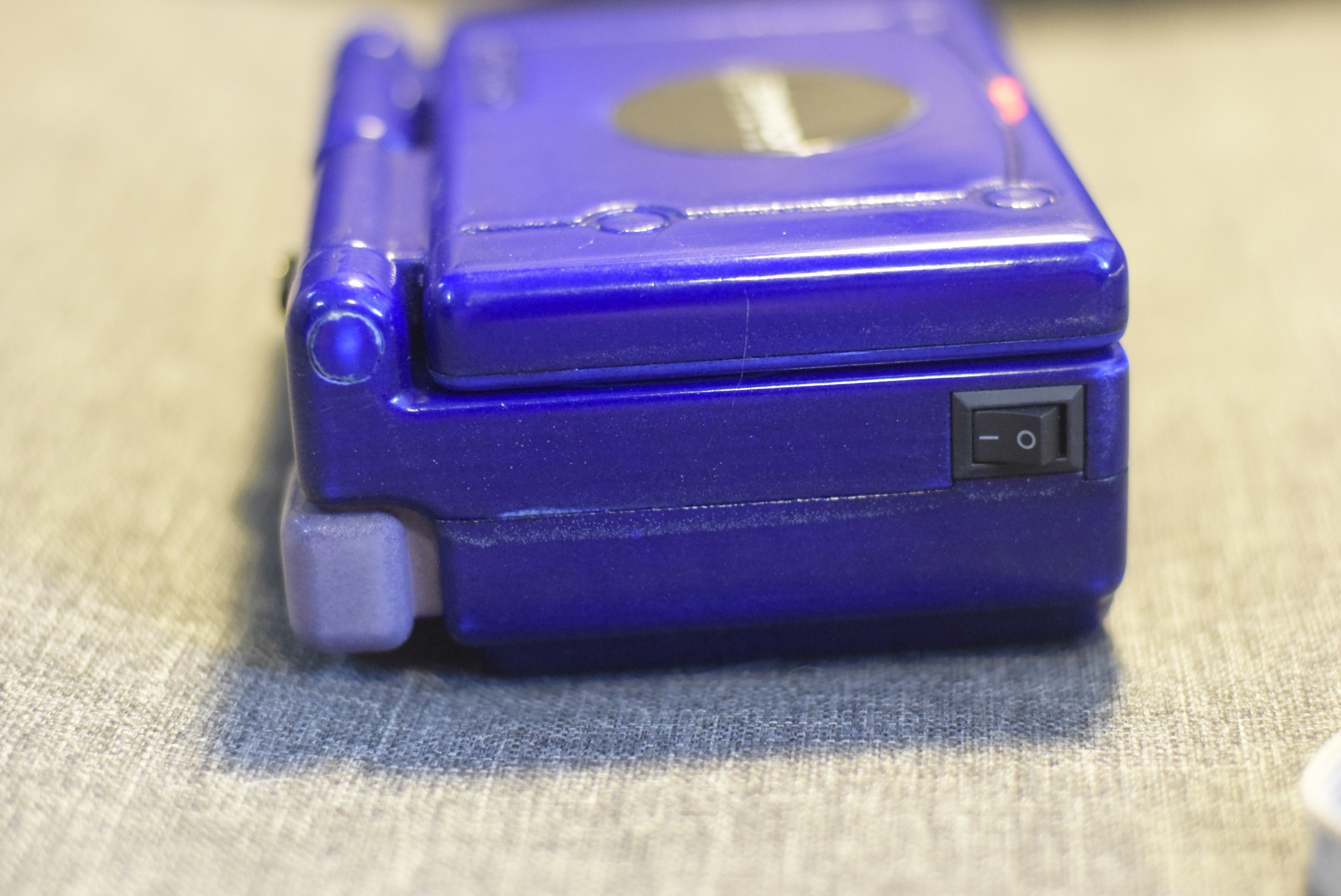

That is one Glossy boy
the Power switch looks like it's easily hit, or does it stay out of the way most of the time?
It fits into like, the cup of your hand. It also takes a bit of force to flip it back and fourth. I have not once turned it off by accident.
