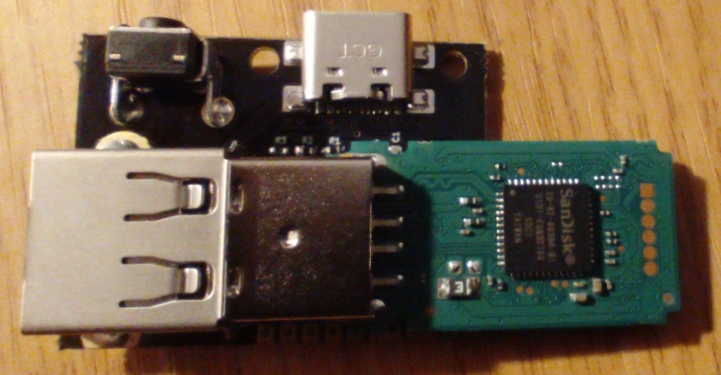

I tested a few USB flash drives on my untrimmed 4-layer Wii with RVLoader installed. As above, I tested 5 GC and 5 Wii games for 10 minutes per game. Failure means I got it to hang the system at least twice when trying to boot RVLoader or load a game.
Passed:
SanDisk 256GB Cruzer USB 2.0 Flash Drive (SDCZ36-256G-B35)​
SanDisk 256GB Ultra Fit USB 3.1 Flash Drive (SDCZ430-256G-G46)​
Failed:
SAMSUNG FIT Plus 256GB USB 3.1 Flash Drive (MUF-256AB/AM)​
TEAMGROUP 256GB USB 3.2 Gen 1 Flash Drive (C162)​

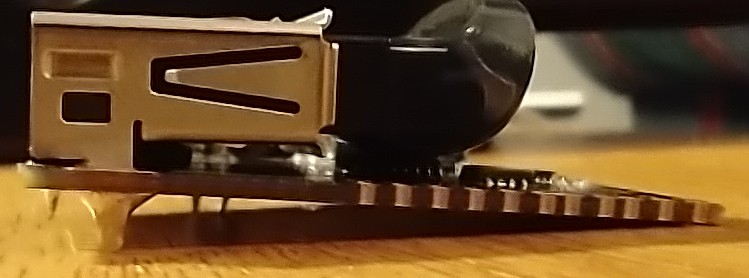

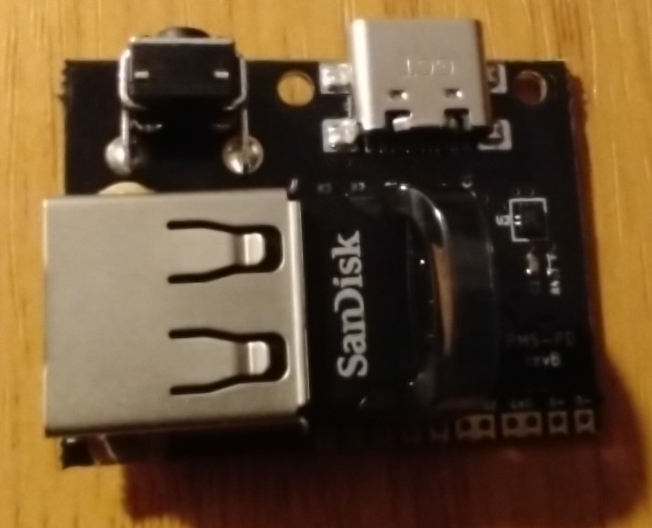

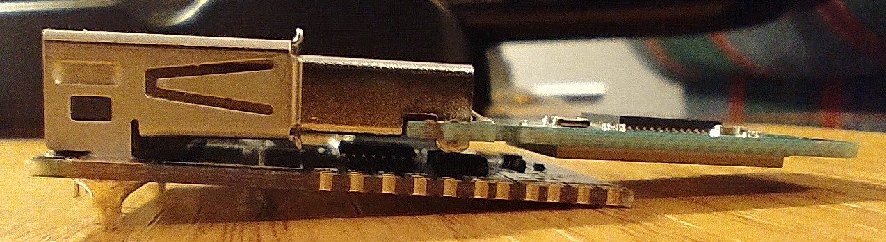

The SanDisk Cruzer is rather large and won't fit in the PMS-PD with its case intact. After removal of the case it fits, but is still pretty long.
The SanDisk Ultra Fit fits the PMS-PD just fine with case intact, no sanding required.
