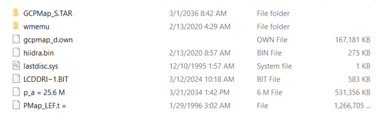

Issues with corruption (with SanDisk):
Corruption is always present when the GCPMap_S.TAR folder is in the root of the drive.

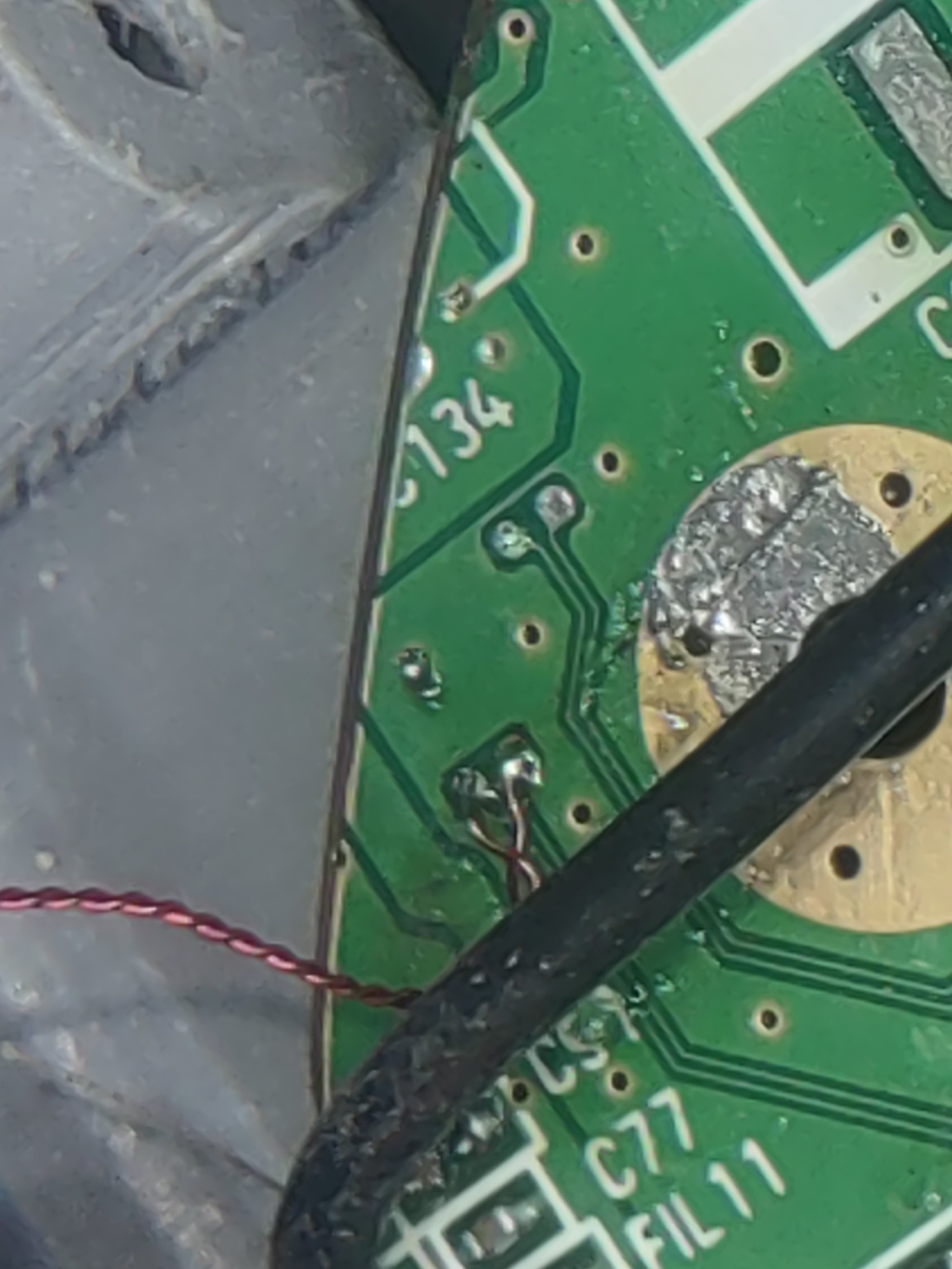

I tested with different wire, shielded wire, different gauges, and more. Here is a picture of the wiring before I routed it away from everything:
I have since closed up the portable. I also shortened the wire.

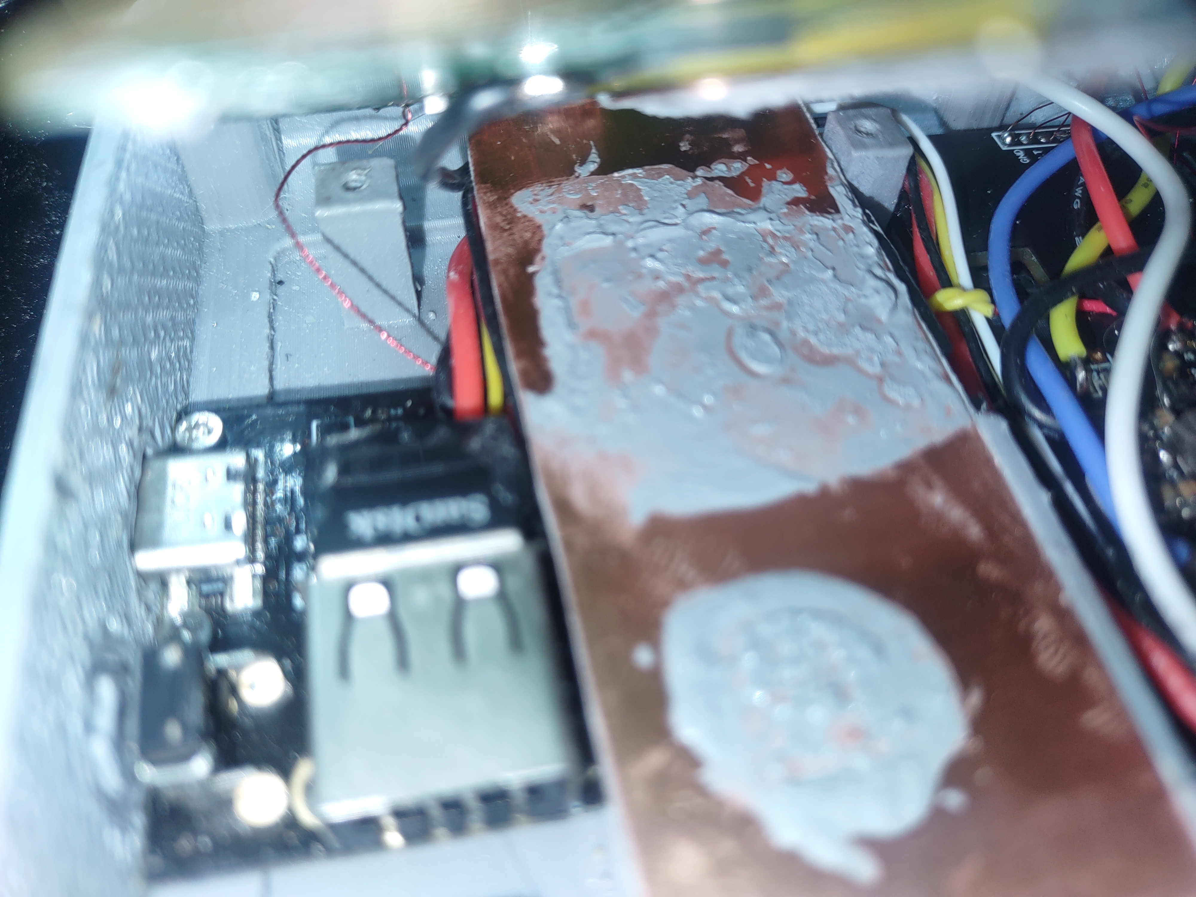

Here is when I used super shielded wire, and the issue still wasn’t fixed until changing the drive:

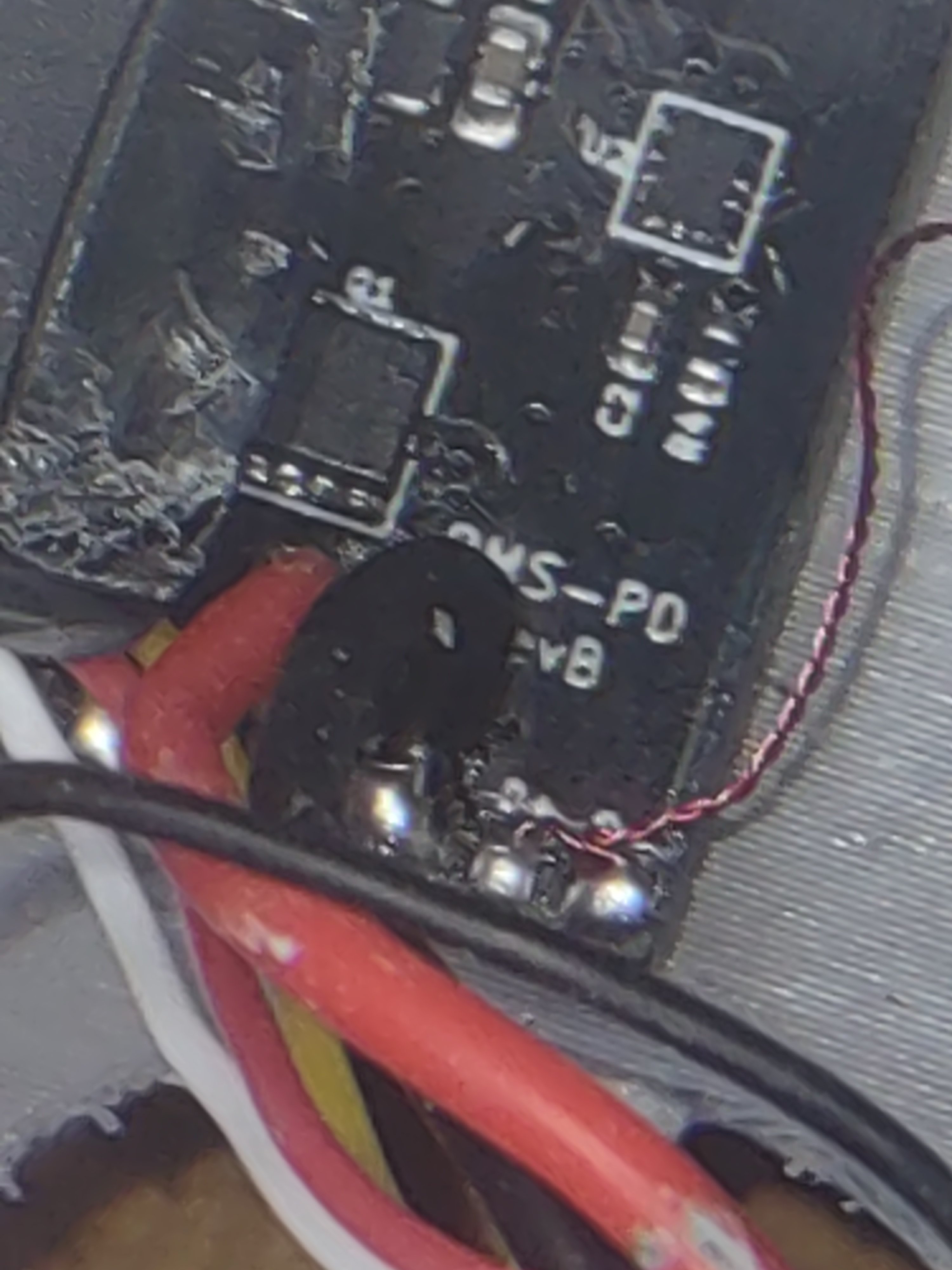

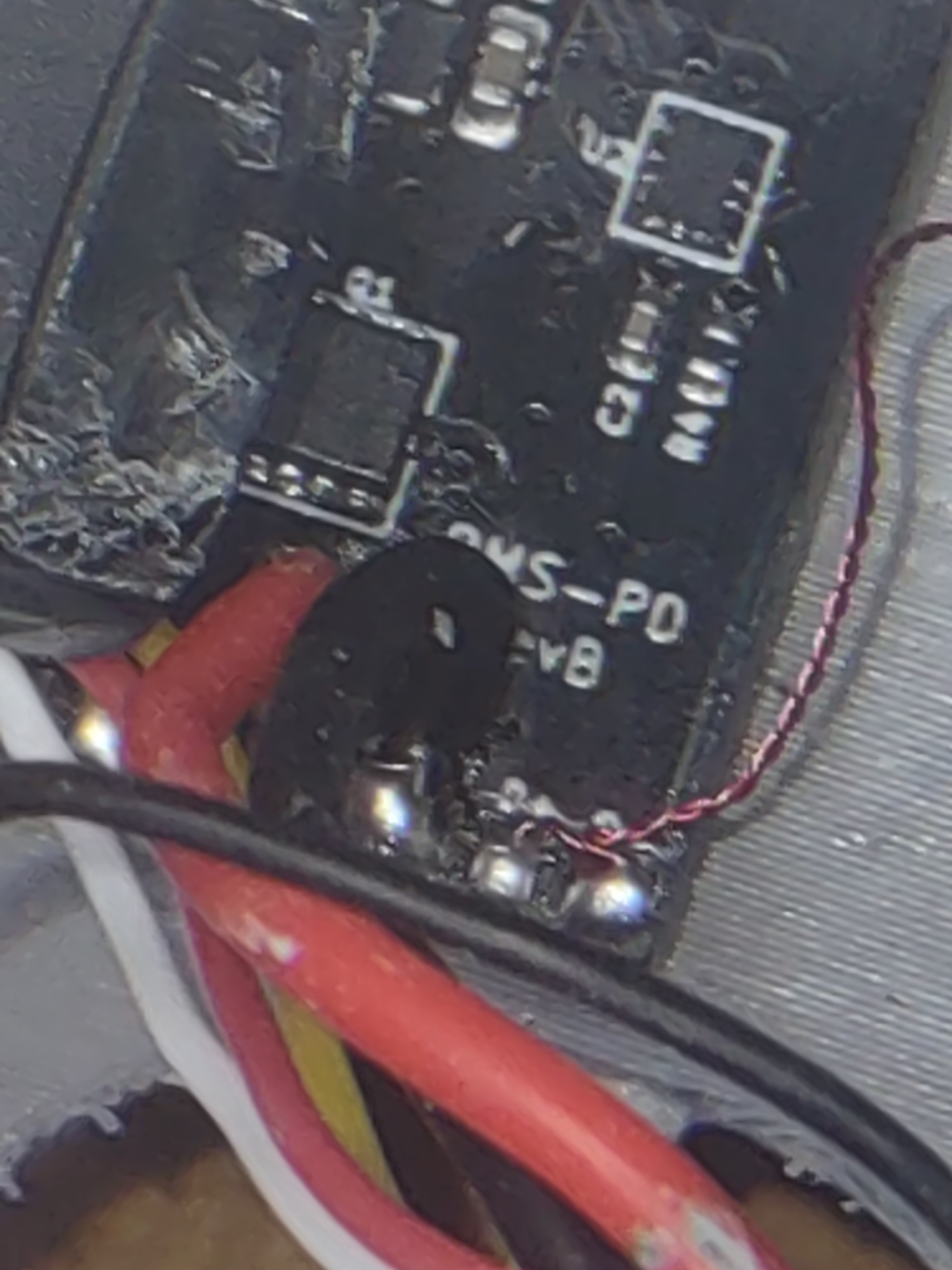

Ok I got home. Here are the pictures of my wiring.

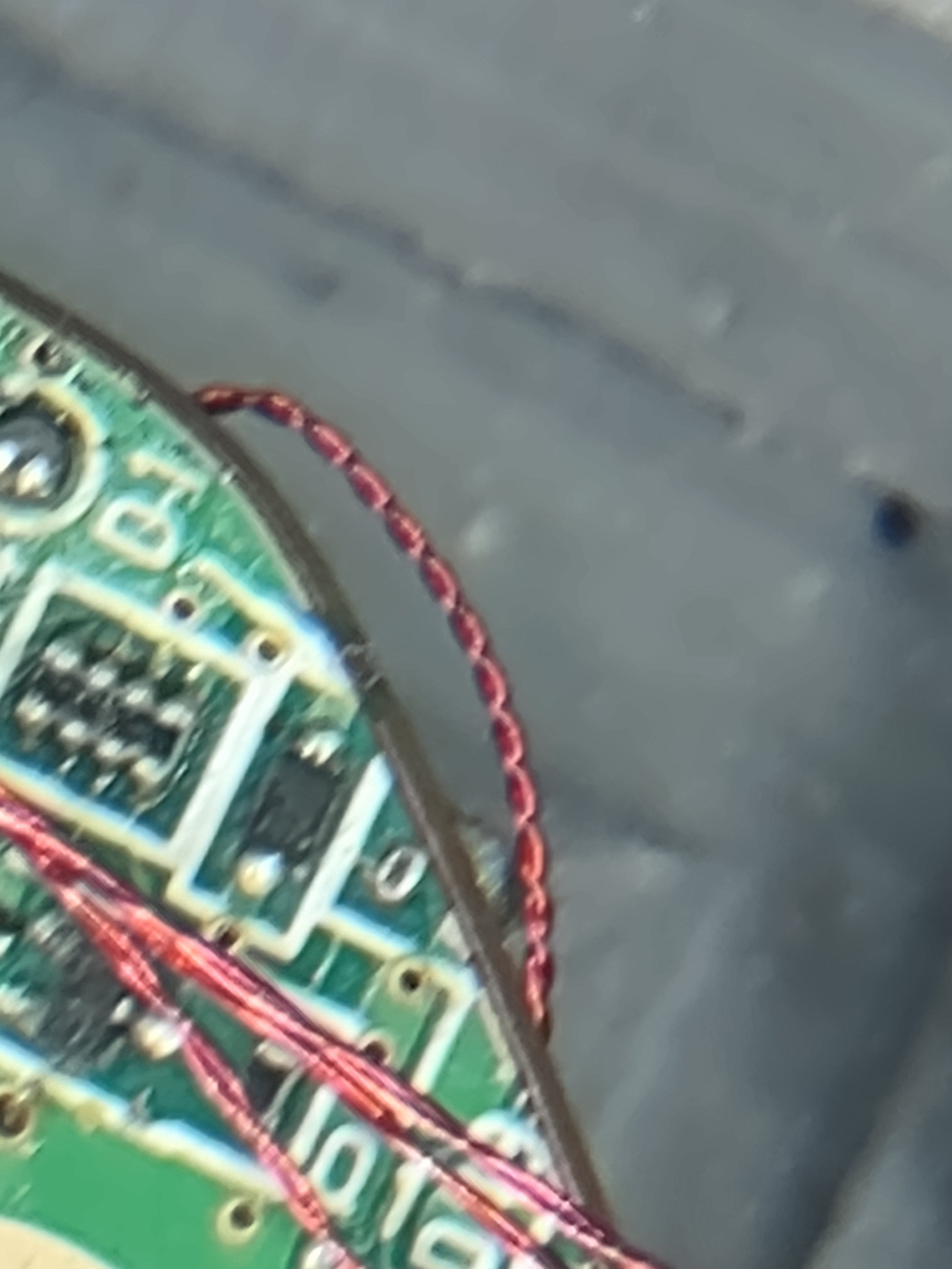

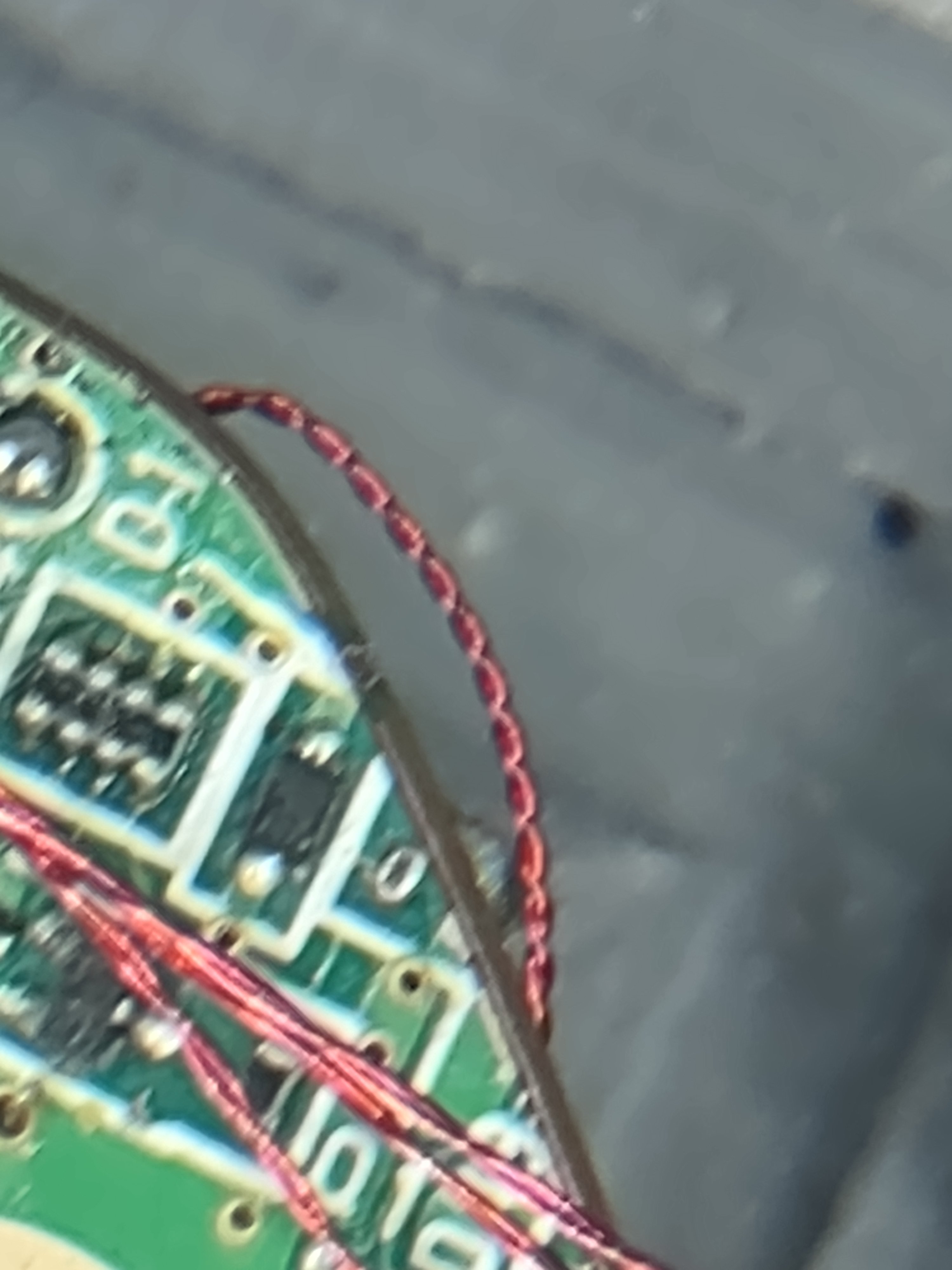

Here is how twisted they are.

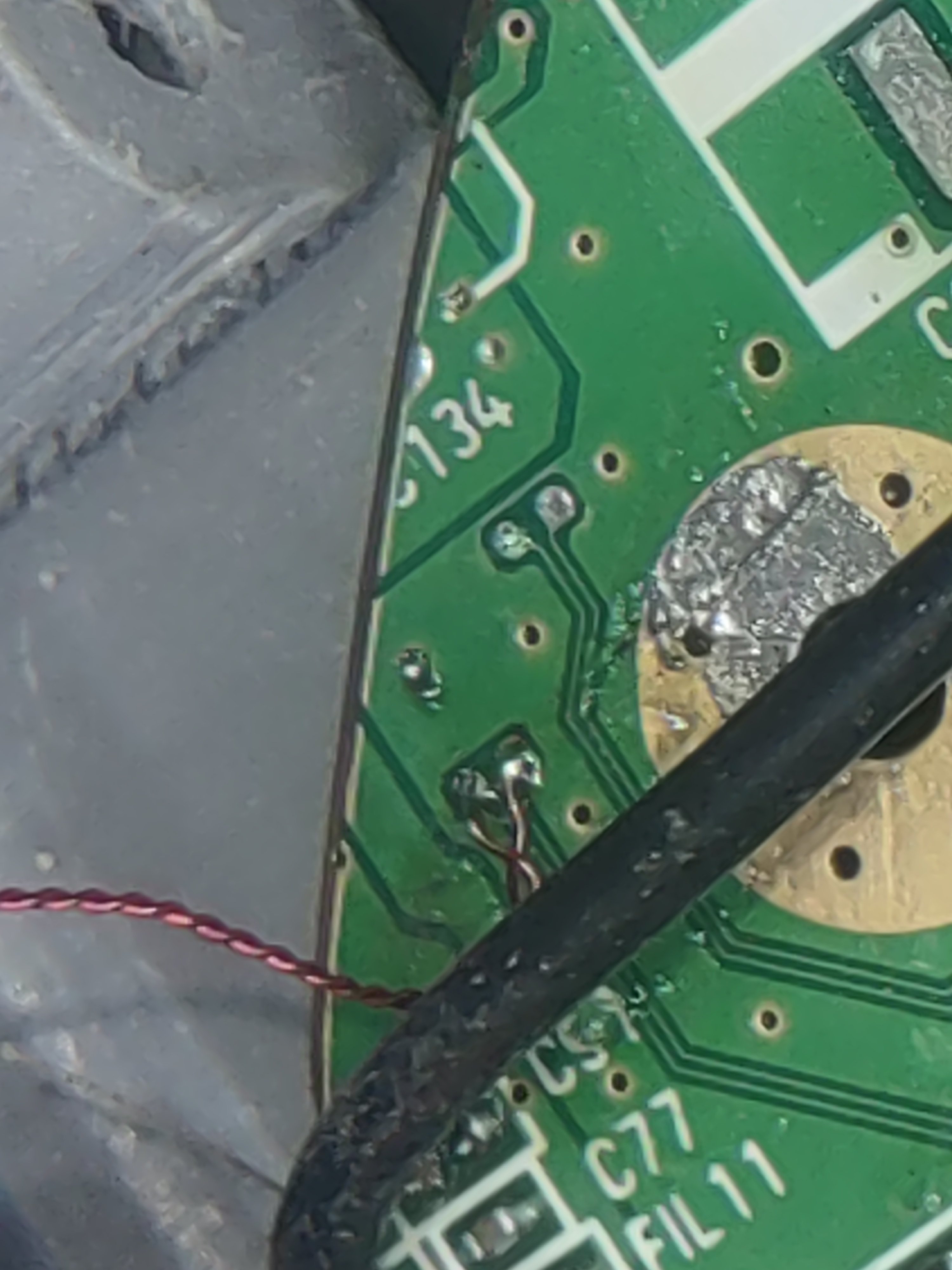

As well as the length and their connection to their respective boards.

Ok I got home. Here are the pictures of my wiring.View attachment 32257
Here is how twister they are.
