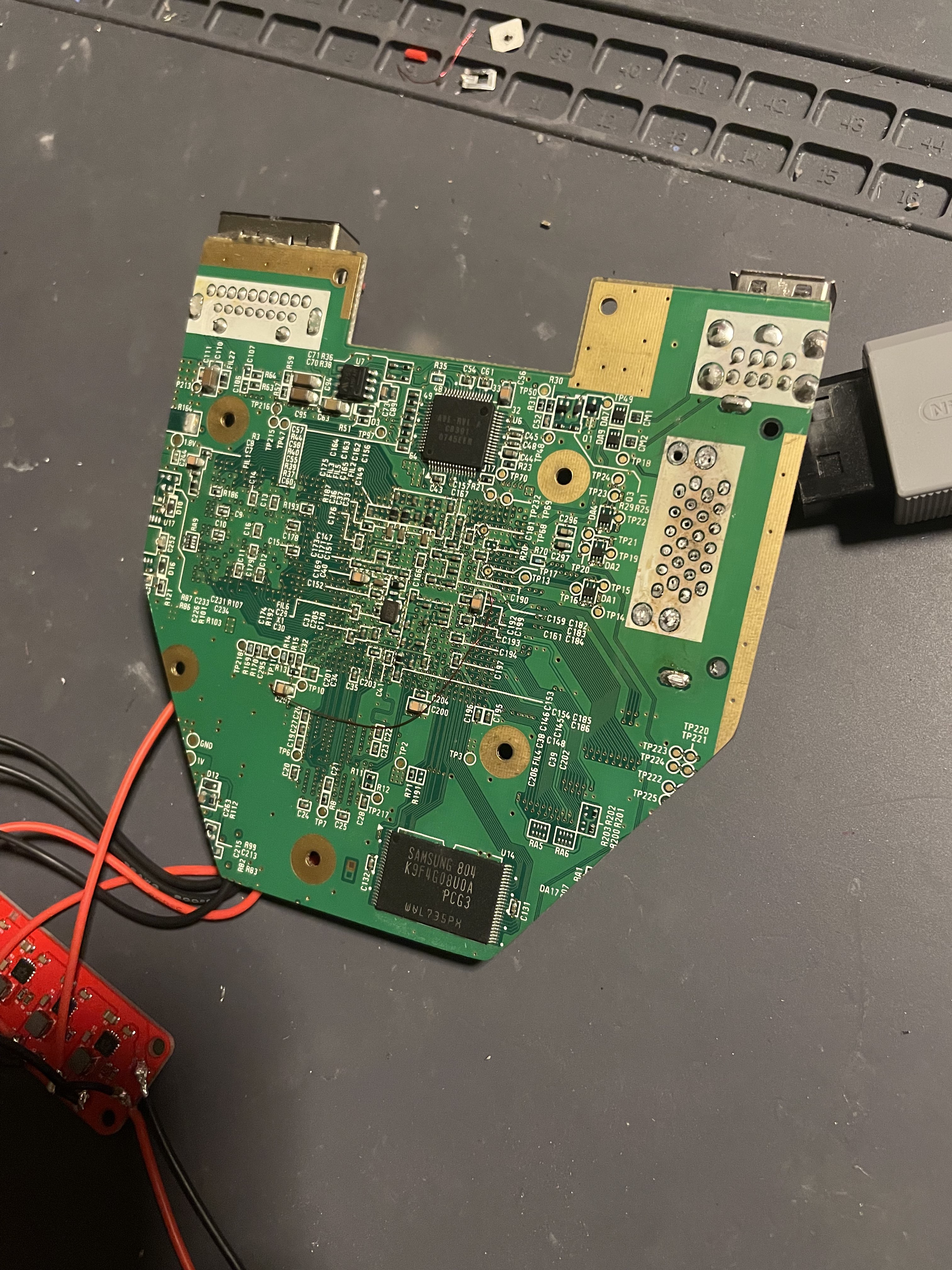

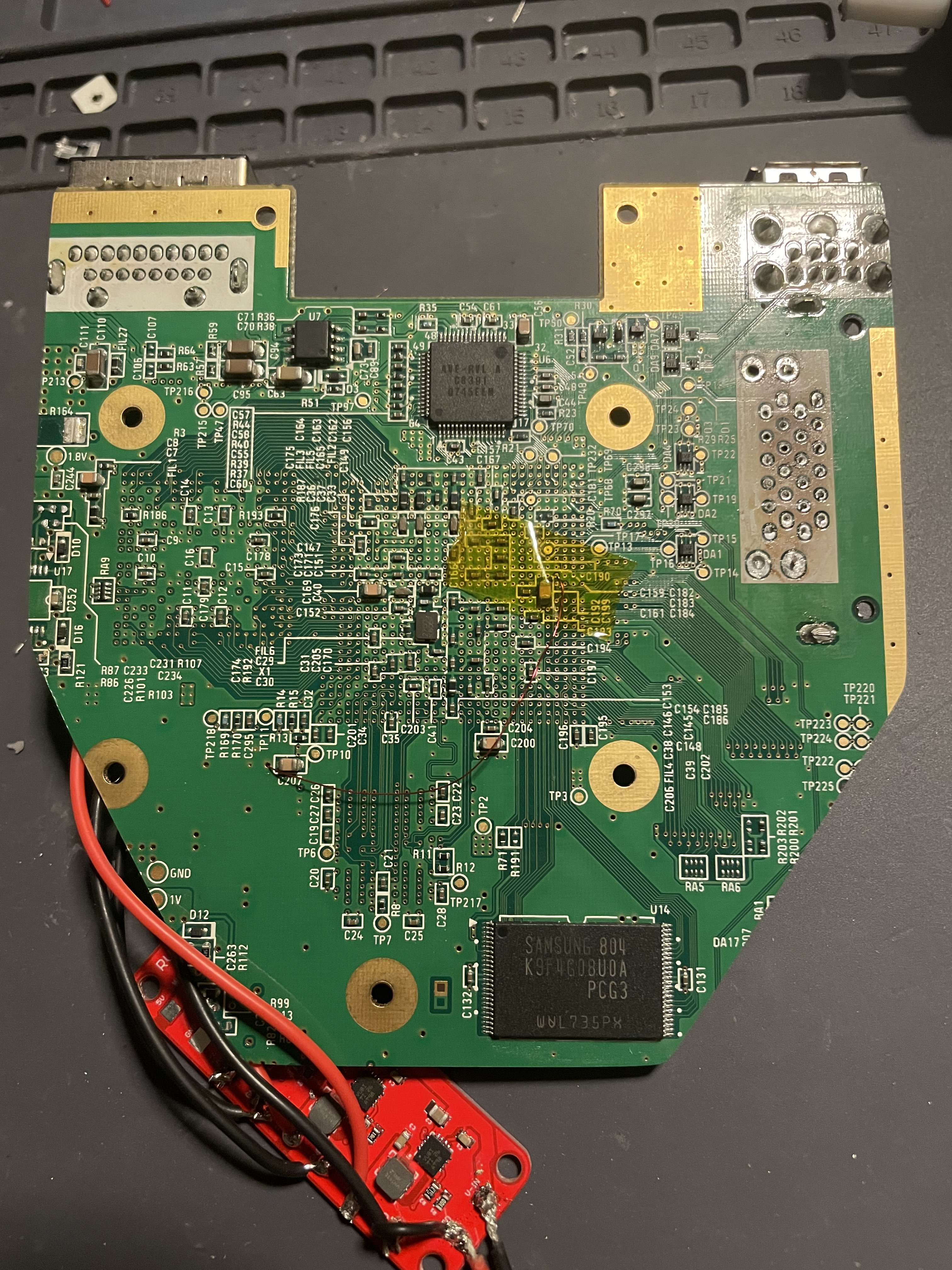

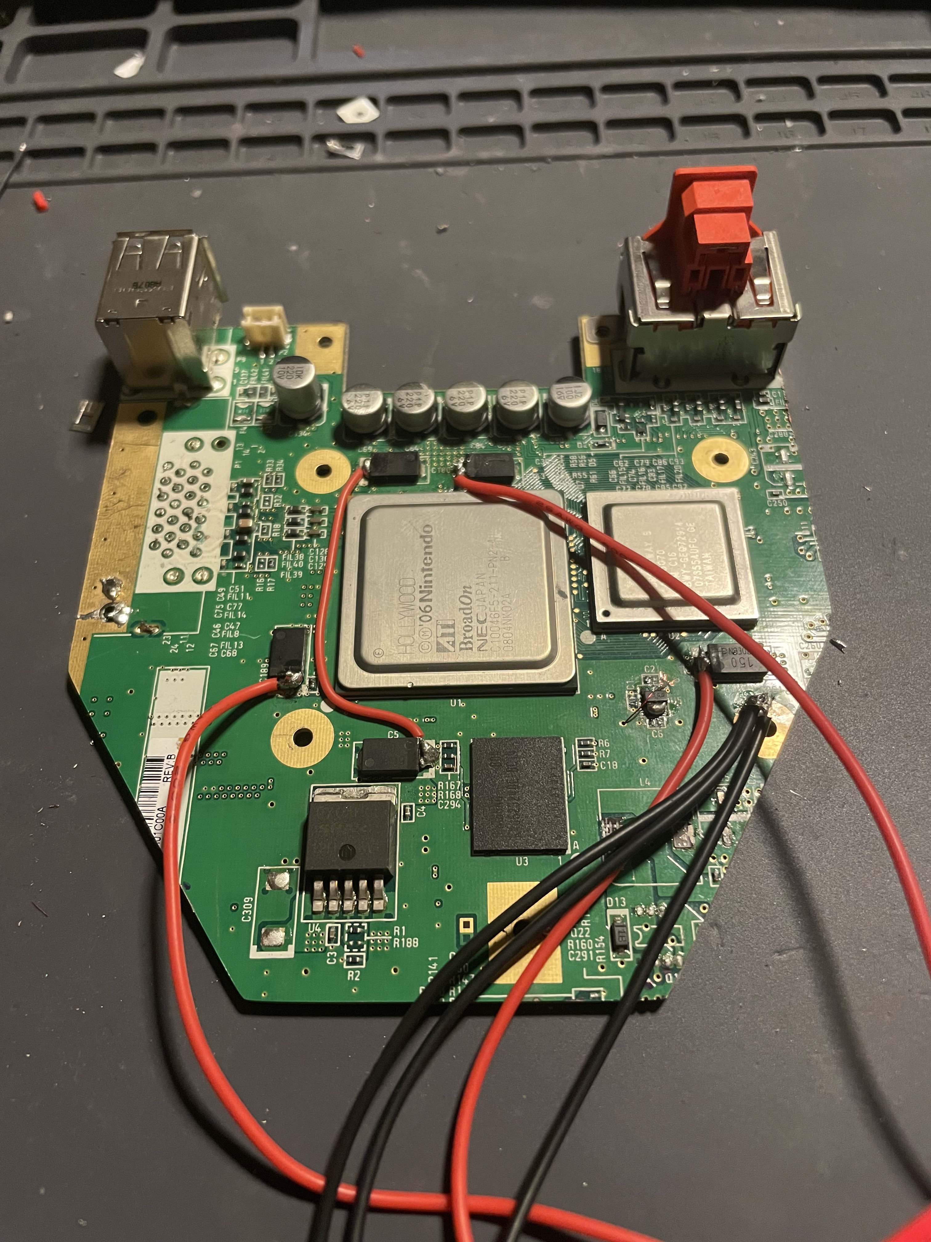

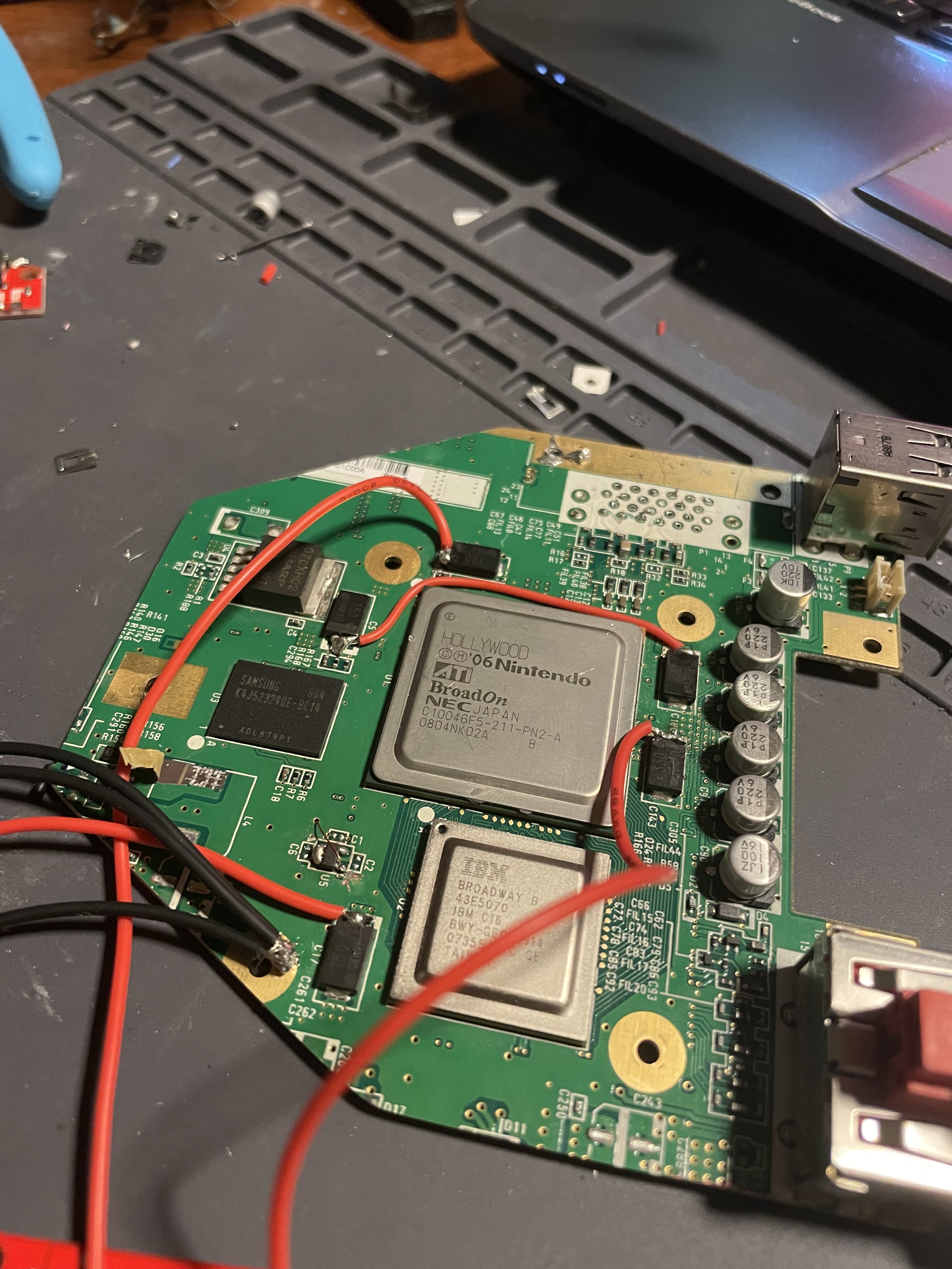

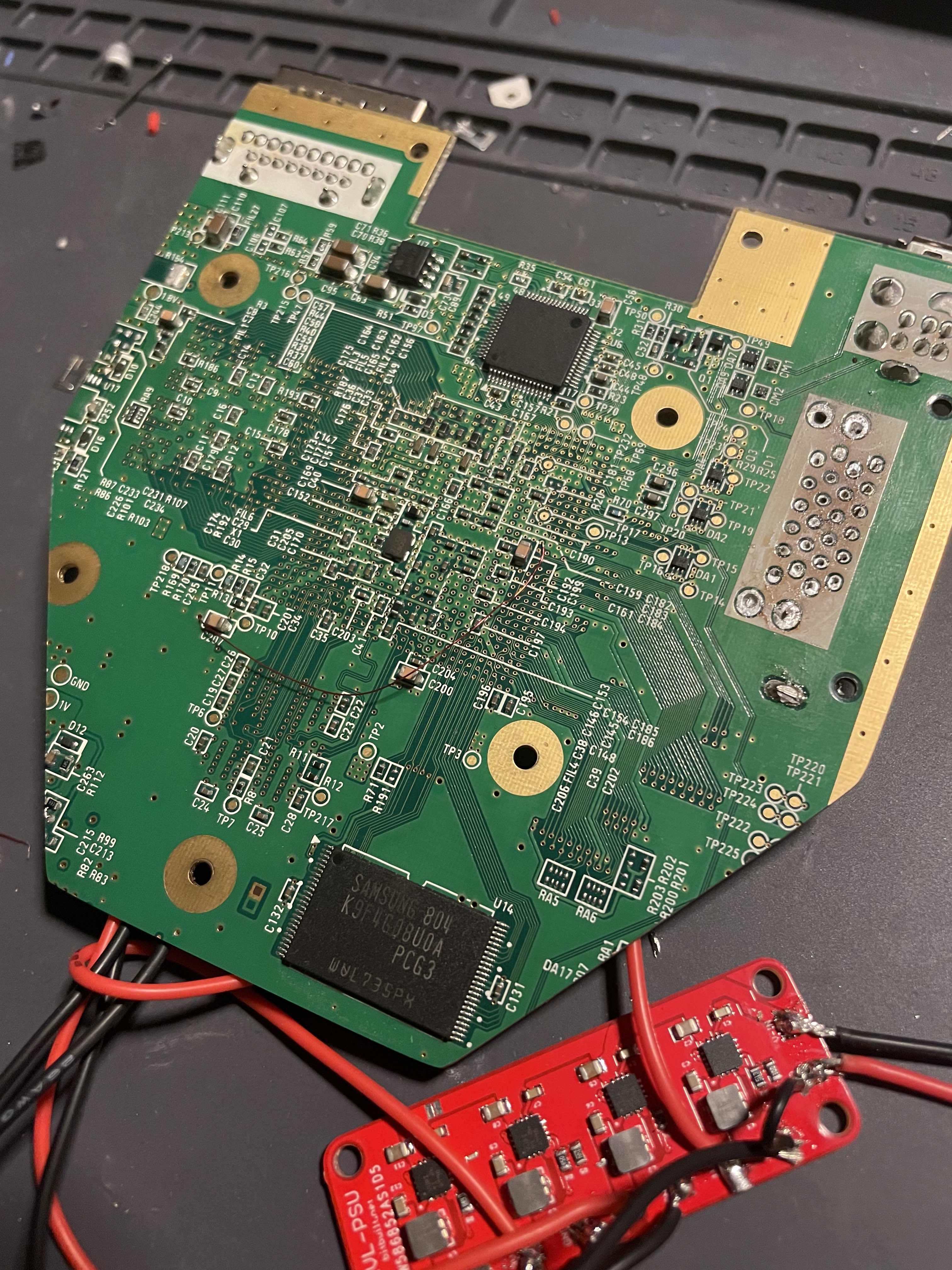

Okay! So I recently got some RVL-PSUs sent to me by way of PCBWay and I wanted to get back into the trimming game with yet another wii!
The Basics:
- 6 Layer Board
- Modded with RVLoader
- U10 Relocated and validated pre-trim.
- I don't really care about wii features, I'm basically just trying to make a small melee machine.
I trimmed my wii tonight and I didn't think it was any different from the other wii boards I've trimmed. This is technically the farthest I've gotten with a 6 layer board and I still can't seem to get it to boot to RVloader post trim.
What's happening?
- After wiring up everything and powering the various components, I see the TV flash a horrifying bunch of pixels and then simply black screen.
- After checking the voltages of each component that needs power, I can verify I'm getting approximately 1v, 1.5v, 3.3v, and I've bridged the onboard Sharp regulator to receive 1.8 in the two places it needs.
- And yes, I sanded with 200, 400, 600, and 800 grit on the sides
Some things I'm considering
- I verified the U10 working and I taped it in place to verify it worked pre-trim. I also re-inserted it just as a double-check measure post-trim after an attempt at powering it.
- Is it possible that I'm leaving too much extra board? will any of the components on the periphery of the trim line interfere with my ability to see the damn Rvloader boot text?
- I did a modified trim (not exactly OM6 but closer to what Jeff did with his wii micro stuff) and I"m wondering if it's way more risky with 6-layers. I remember reading that they're more unknown than four layers. is trimming it while retaining the USB / A/V just... a difficult thing?
Attached a video of my whole situation and pictures of my RVL-PSU and 6-Layer.
For additional context, I'm adding a zip file containing a video of my problem and also showing me booting it! I have to zip it because the forums don't allow me to raw post vid RIP.

3 things:
-Did you check the resistances between your voltage lines after you sanded, as per Nold's forum guide?
-Is the U10 wire even soldered to the via? It looks to just be "inserted," not soldered. That could be an intermittent connection, causing your issue.
-I'd reflow a bunch of those joints on the Wii / PSU with some flux and an iron to get some smoother joints.
As a side note, it's good that you have a couple grounds going between the Wii / PSU. While I don't think it matters much (but technically could cause ground loops), I like to take from one ground pad on the PSU and solder it somewhere on top of the wii, and then take another ground pad on the PSU and solder it somewhere on thr bottom of the Wii. Again, ground loops? Technically. Has it ever caused issues in my experience? No.
I had genuinely not considered that simply inserting would cause connectivity issues because yeah, that makes sense. I should totally solder that wire to the via so it's connected.
I have a multimeter and I'll need to actually look up how to test resistances but this is something else I haven't done. I'll make sure I test it.
And to your 3rd point: yeah my soldering acumen is still very very weak so I'll get a better tip to disperse heat onto some of these bigger joints (I'm using basically a pencil tip which might just be not enough surface area to get a good flow on to the joints)
For the ground pad on the PSU stuff, is it sufficient for me to only ground two of the pads from the RVL-PSU onto the wii? I was under the impression I'd need to ground every pad that has a voltage (except for 5v since I didn't bridge it)

Update on resistances:
I uh. It was very hard to wait for the resistance to kind of stabilize, but I noticed when trying to measure them, sometimes my multimeter wouldn't react at all (even controlling for what level I was at, 200 for most and then jumping to 20k for the 3.3v checks). I'm assuming this is because the soldering is messy or bad?
I re-did some soldering on the 3.3v and was able to get readings so I'm assuming I just botched that bit of it in some ways, because it seems like with some of the blobs, I have to really find a "sweetspot" for my multimeter needles to prod to start getting readings which should indicate that my flowing of these joints includes a lot of bad continuity, right? or something else. because these resistance readings feel WAY off base. Anyways here's what I got:
COM1v1.15v1.8v3.3v
GND~12~36~29~15.5k
1v~48~42~16.8k
1.15v~82~14.5k
1.8v~14.3k
As you can see... a lot of these numbers (especially for 3.3?) seem... super high? I actually have no idea what high resistance means? I'm hoping it's just "lol you soldered bad, bud. redo it"
All those resistances seem okay to me. The fact there are no dead shorts is a good sign. The voltage lines' loads are not purely resistive; they have a capacitive load as well - this causes the "jumping" you see on the 3v3 line. That's actually a good sign!!! Every meter seems to act a little differently on where it stabilizes, I've had some meters cap around 8k, some 16k like you see, and some depend on the range you have it set at, etc...
Regarding the PSU / grounds, for a 6-layer wii, you *need* at least 2 grounds between the wii and the psu. All grounds on the wii are interconnected on the board, all grounds on the psu are interconnected on the board. It's a matter of connecting the two boards' grounds, so any ground point on the PSU can connect to any ground point on the wii. Just need 2 grounds between the 2 boards.
I can't speak for the supply you're using, but it'll be worth it for you to pick up a 12V 2A wall wart from Amazon, as you will end up using it for the noldendo anyway. That way you can rule your supply out of the equation.
Funnily enough I've had the RVL-PSU by-way-of-USB-c work on my four layer board. but maybe I just need to go with a DC jack noldendo style. I've plugged it in after checking everything and trying to reflow pads but now it won't even give me the gross mess of pixels (which is a damn shame because it's actually a beautiful trim I've done and I'm super proud of it!
All that said I'm gonna grabsome DC power jacks, a wall wart, and wait for some 90% isopropyl to come through so I can clean up the flux residue from cleaning.
Hoping it's not dead in the water! just gotta be patient.

Update:
I've replaced my usbc with a wall wart 12v dc input, I'm feeding power everywhere it needs to go, I've tested the U10 via in both places, I get a static screen when booting, the AUX prompt on my TV goes away, and I just stare at black screen while the CPU/GPU heat up.
I'm running two ground wires: one from the RVL-PSU to the topside ground of the board, and one from the PSU to the underside ground of the board. I actually think as far as trims go this one was my best one, and I can't easily find any faults.
I verified continuity, power, etc, and I'm truly at a loss for how I can move forward so I might just relegate this to the shit pile of other 6-layers I've already wrecked.
RIP.

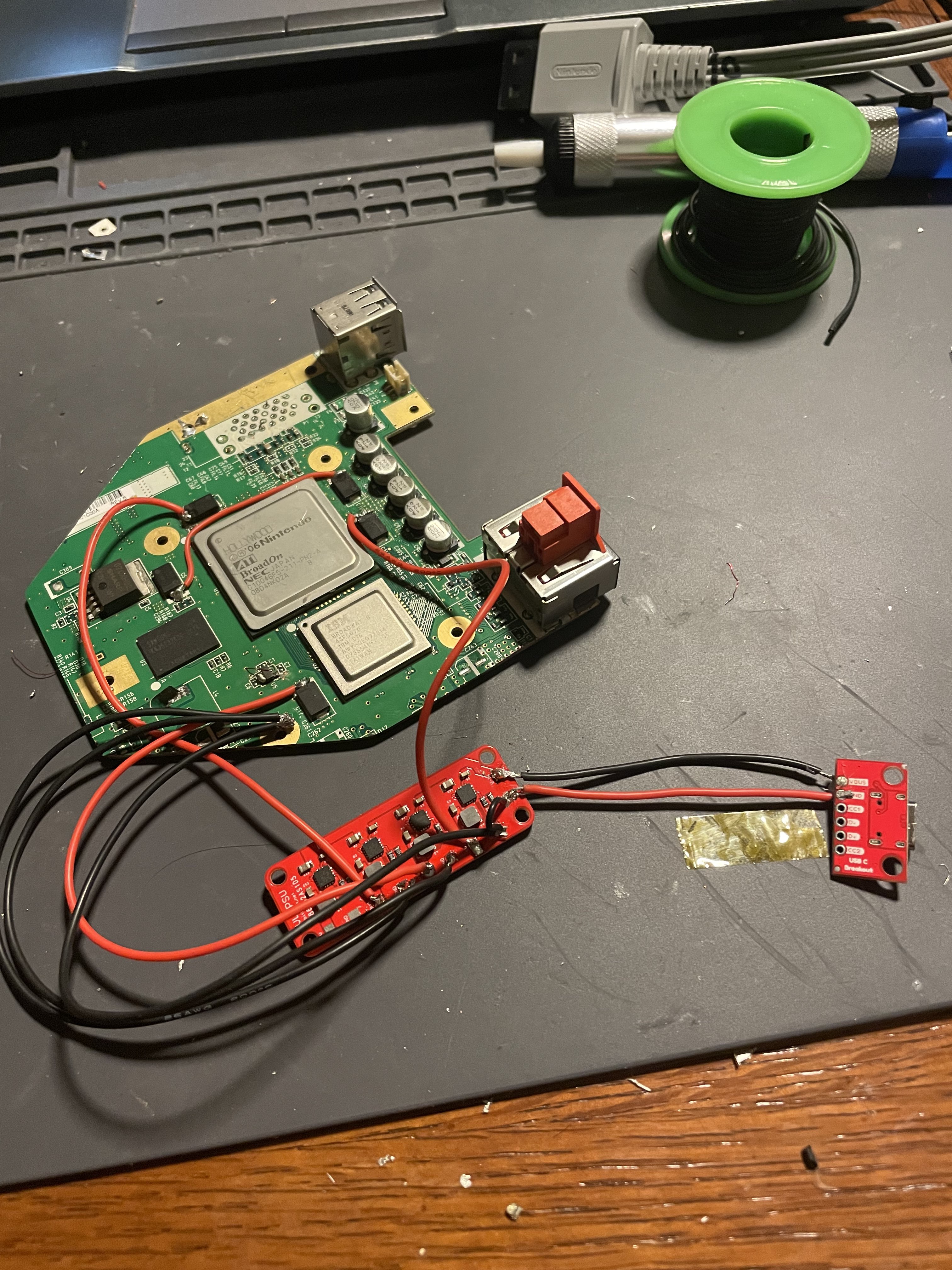

Okay, I ended the night LATE, but I believe I understood the problem.
Essentially, in the future if I'm using a heat gun to remove the memory card port pins, I should cover the components that run downstream of the USB with thermal tape so they don't... move.
basically I tried heatgunning the pins of the memory card and at some point the solder came loose from the DA7 component (which looks like is the component that hits just after CM1 for the USB trace).
Basically I THOUGHT I may have screwed myself here. In the pictures you see a DA7 component because I TRIED to grab one from another dead board and replaceit to see if that just... "worked" lol.
Spoiler: it did not.
But I also managed to test-wire up a USB breakout board to the traces (much like I did with my original 4-layer trim) and it was reading! So I think I may have just borked the usb ports on the board, which is unfortunate, but I have a way forward by way of direct-to-trace wiring.

You could just run a twisted pair from the vias to the pins on the port. You won't have the protection from CM1/2, but you'll restore the onboard USB ports' functionality.
Regarding the memory card ports, I find it much easier to physically break thr plastic / metal retaining brackets with some big wire cutters (it's not good for them, so use a pair you don't like). Once I've mangled the port and gotten it off, I desolder each of the pins one by one. Better than using a rework station and having the board sink that much heat.
Oh this is massive advice. I read this and then immediately yeeted my breakout board into the sun. Got the wires twisted to 2 and 3 and holy shit I really do just need a second color magnet wire, red by itself is just hard lol. Hot glued the wires into place because I was afraid of things moving and not working, but I expect in the future to not need it.
So to recap:
Using onboard now, only one port works (totally fine I don't give a FUCK about the other USB port, all my homies hate the second USB port) but it's booting!

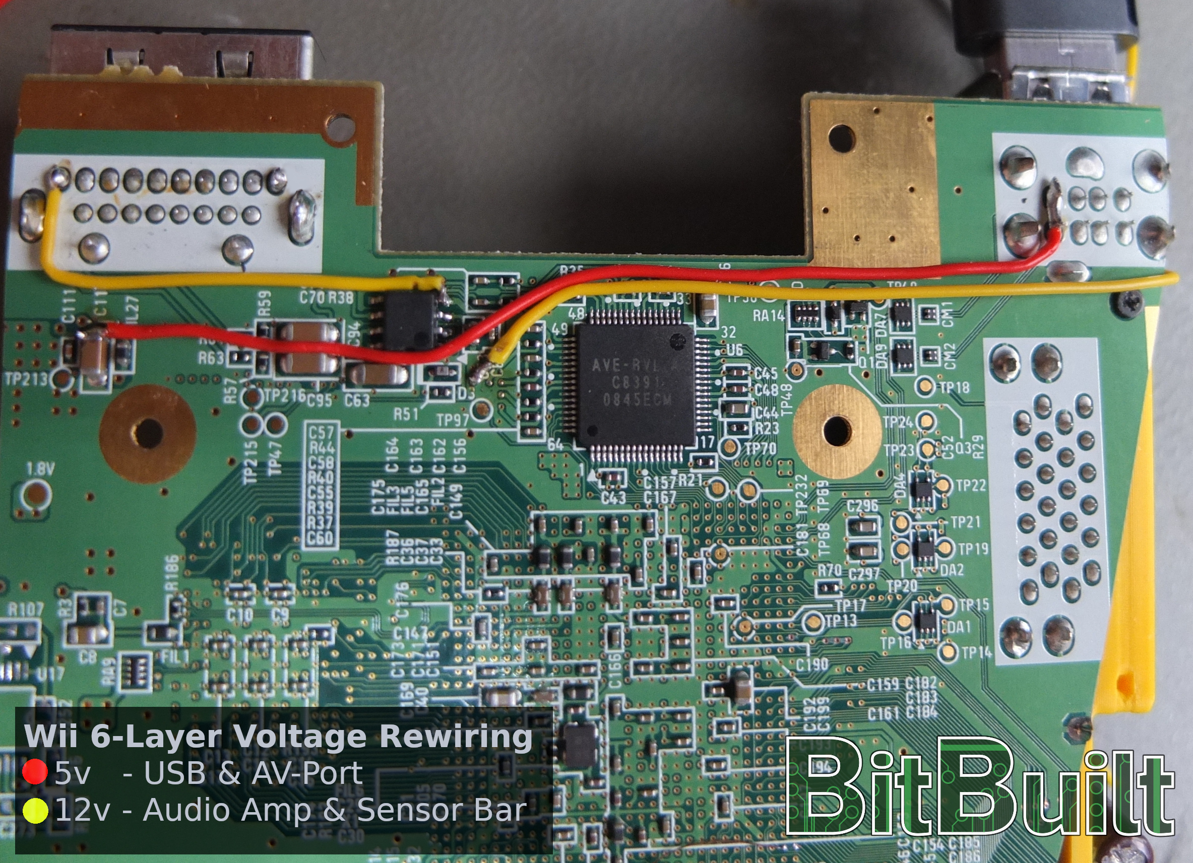

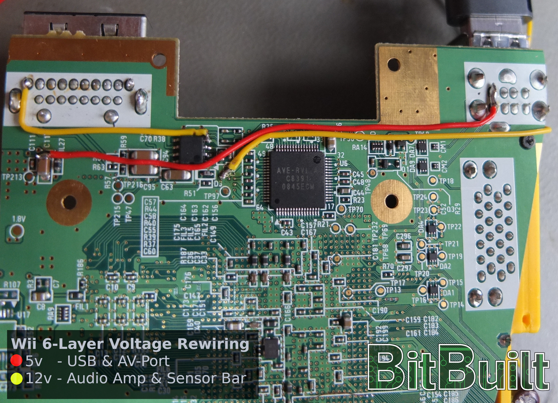

I actually have a question while I'm here. When I look at the Noldendo thread, I see this rewiring:
The usb 5v to the C110... whatt is that doing? is theC110 component actually providing 5 volts here? I'm just trying to make sense of that bit.
I can only assume... yes?
I need to read more lmao.
So to recap:
Yea the red wire is connected from that capa to send the 5V to the USB since the trim process cut the internal 5V copper track
