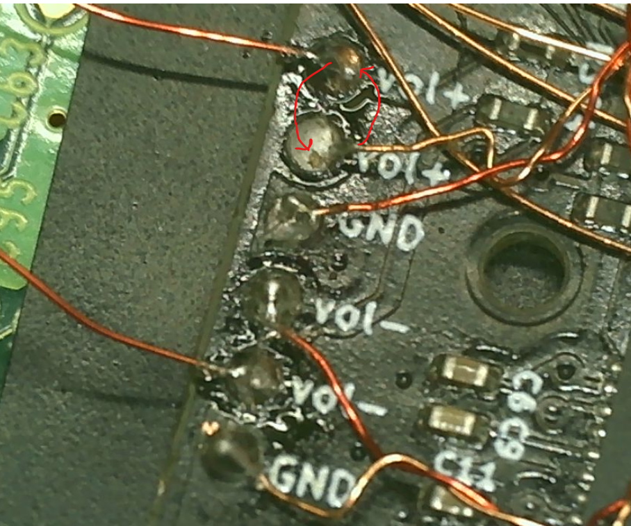

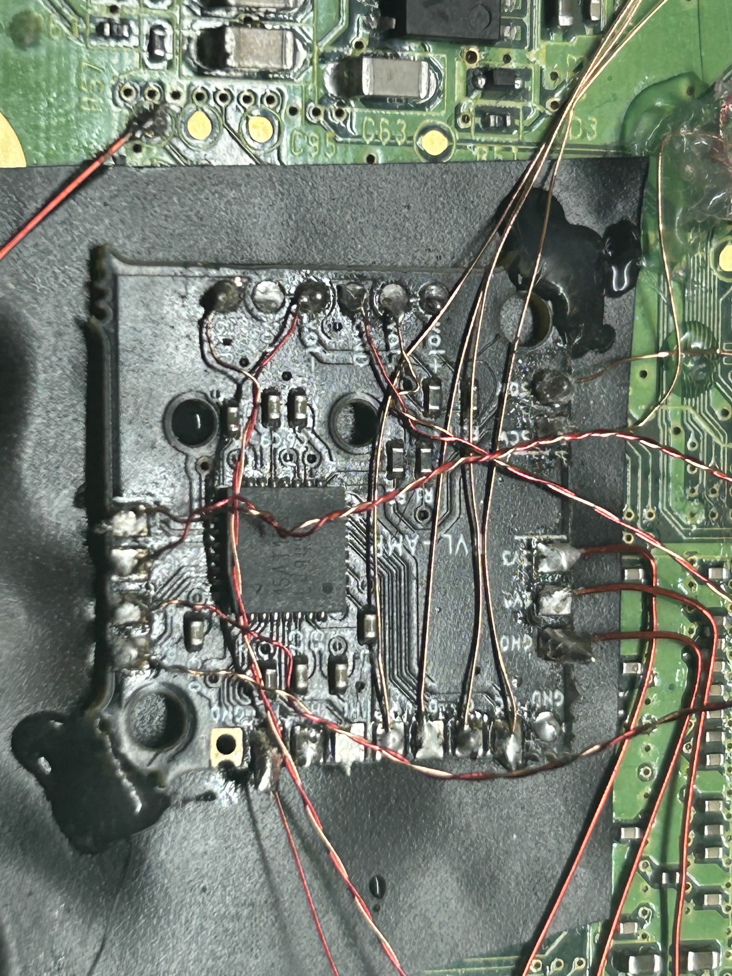

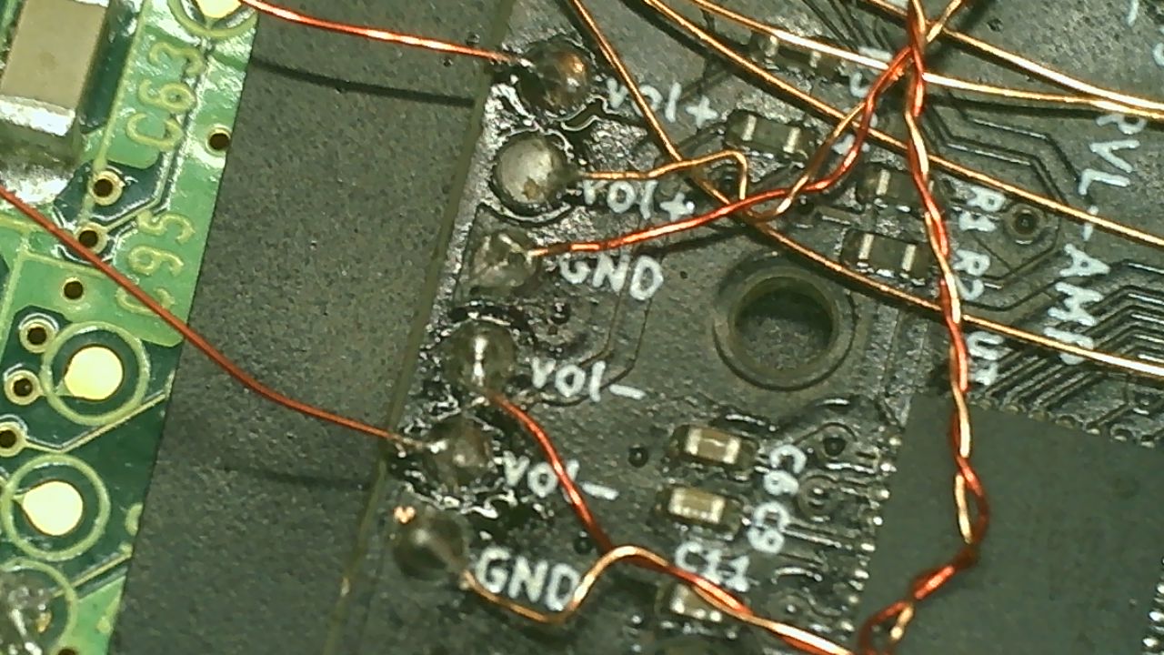

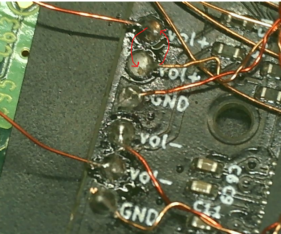

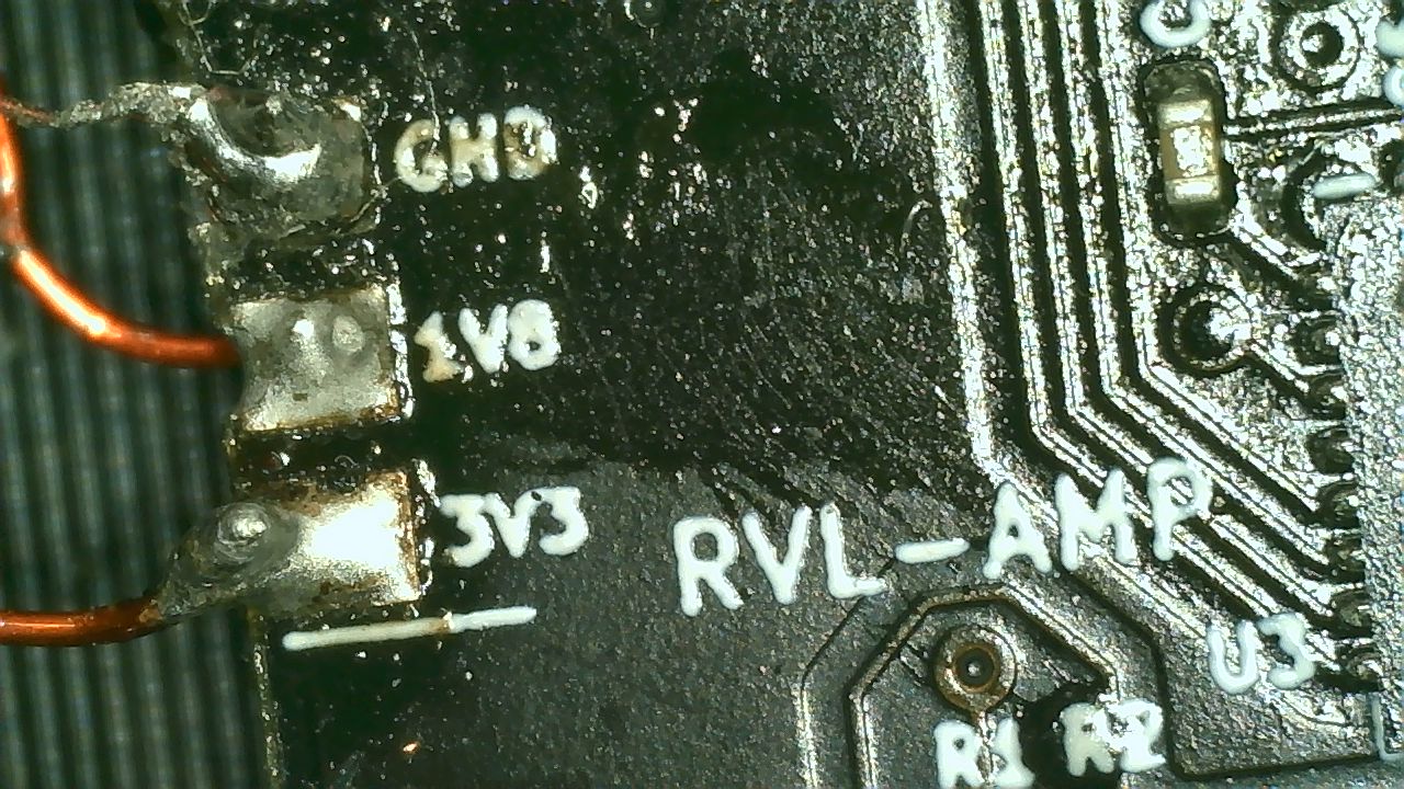

Question RVL AMP presses volume up constantly
Wait, are you on RVLoader 2.1? for whatever reason the audio gets cranked up to max in Wii games when you have the audio amp connected in this config.
Yes, I'm on RVLoader version 2.1. So it is a software glitch, not hardware?

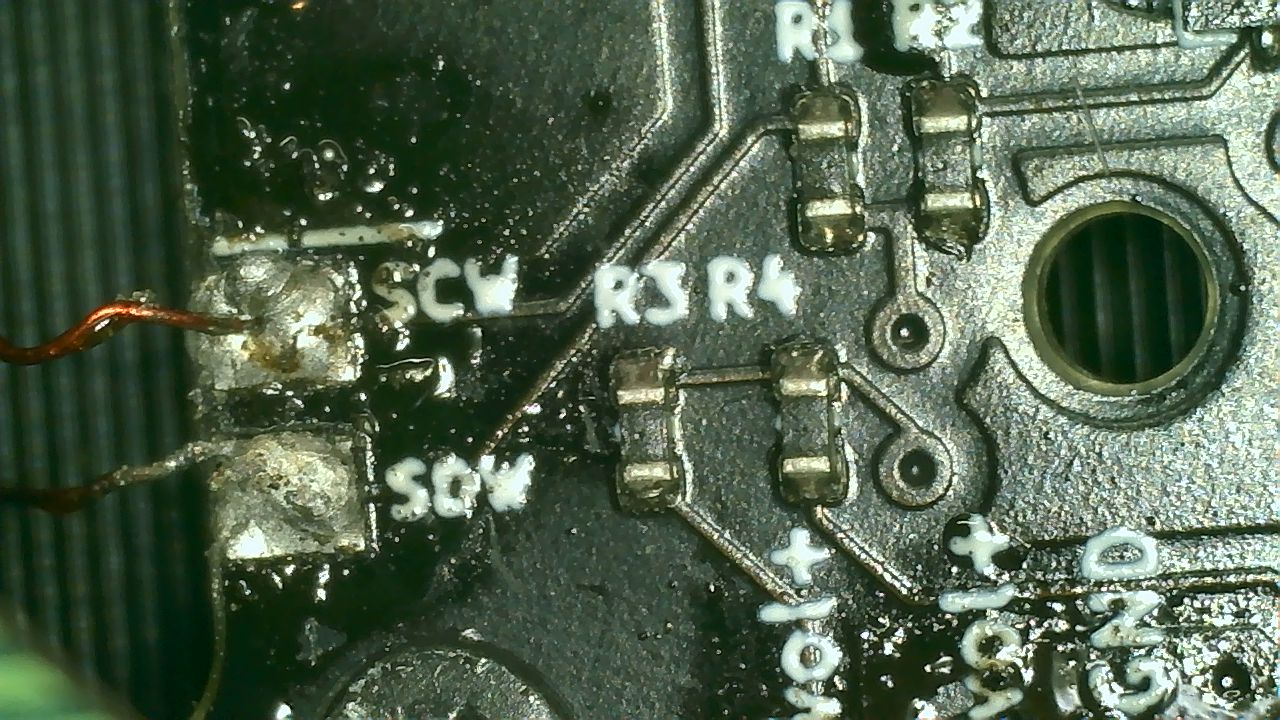

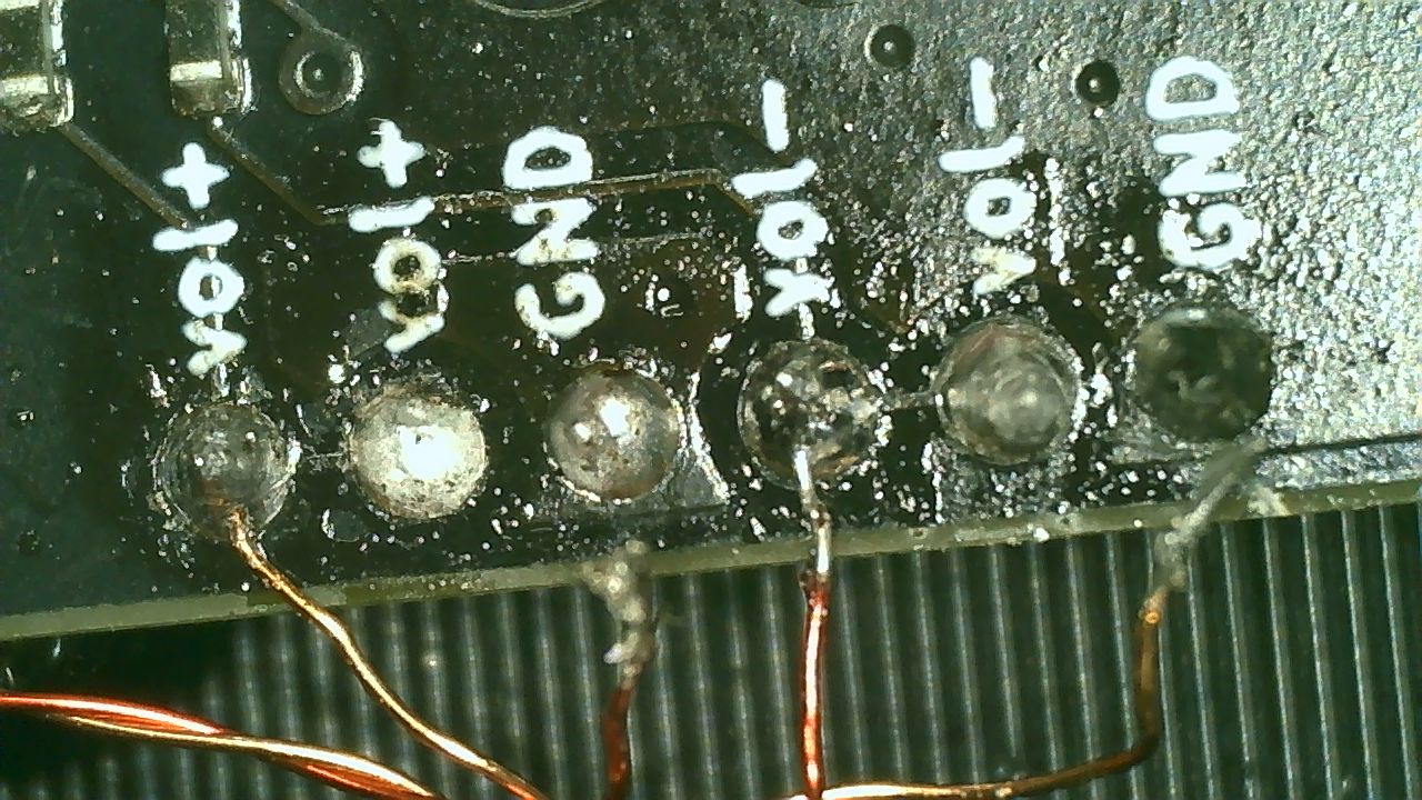

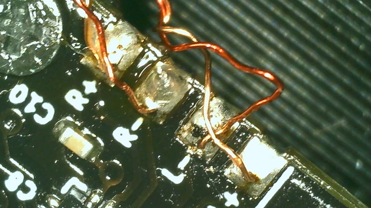

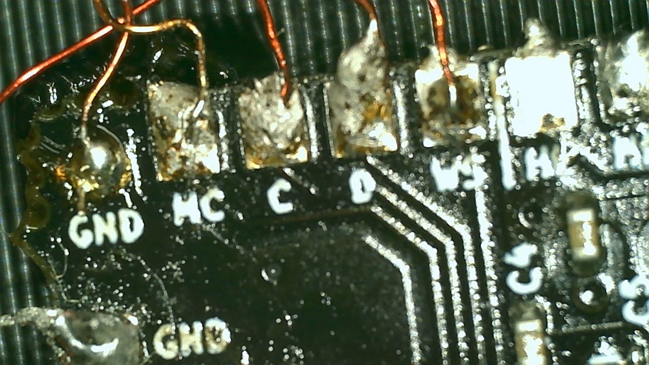

The headphone sense castellated pad (HS) on the RVL-AMP is directly electrically connected to the tip switch pad for the headphone jack. I’m not sure why you would need to add an additional wire here, unless you severed the trace between HS and the headphone jack somehow.
You're right. I have another RVL AMP in front of me now and I just tested it. It is connected. I wonder why on the board I have in the wii, it didn't work that way. It started working immediately after connecting them together.
Is there a fix for this? Revert to an older version of RVLoader or a different way to wire it up?
