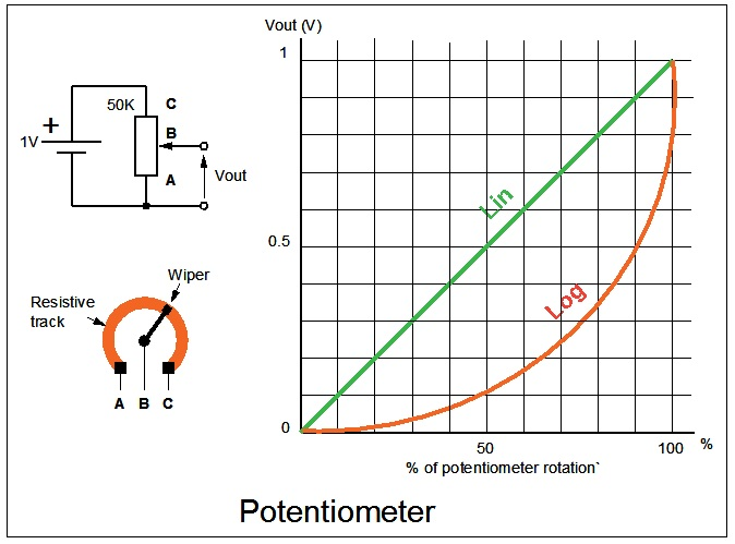

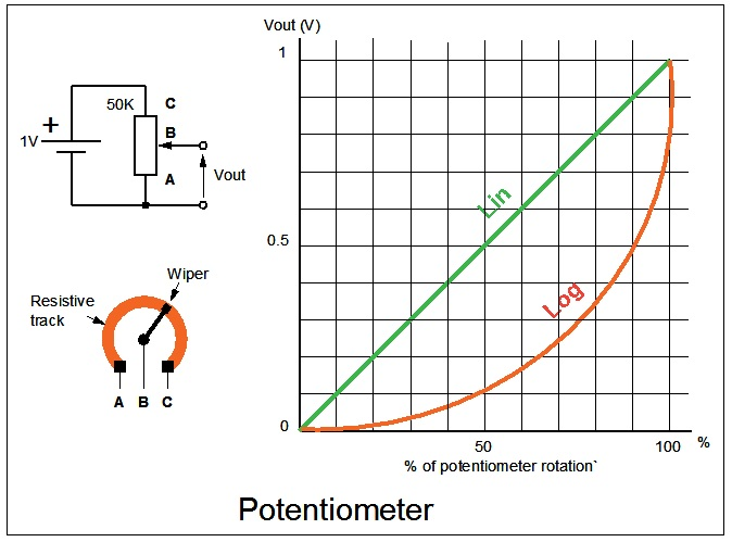

Linear refers to the resistance taper. There are linear taper potentiometers and audio/logarithmic taper potentiometers.
You can use any B103 10k ohm linear wheel pots with 3 legs to mimic the GBA's wheel, like the Ashida does
