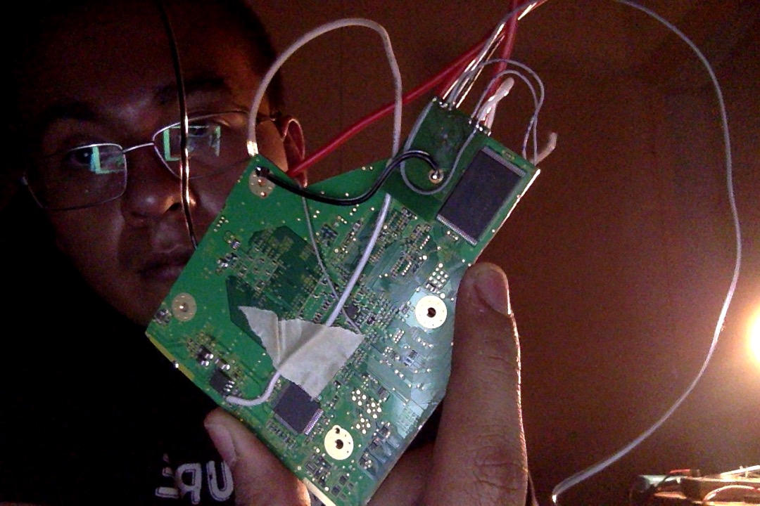

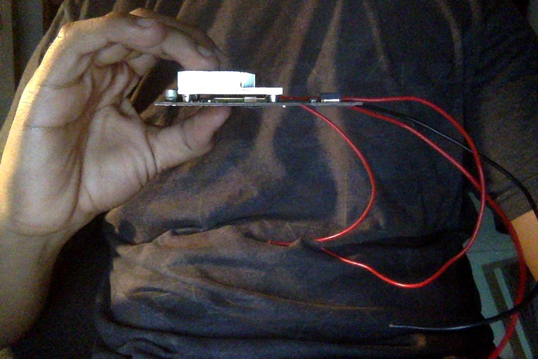

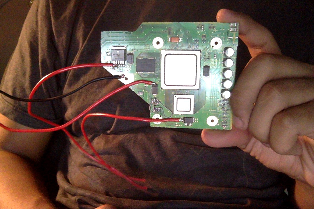

the new board is trimmed, also did the u10 relocation, i just trimmed around it and kept it on the board, glued down and rewired. want to say it will work, but won't find out 'till its properly tested. how does it look? (btw it is soft modded - portablizemii) i might have a working board tomorrow that i can get the voltages off of. there's the board with the heatsink on it as well.
Make sure you sand like crazy before turning that on, those inner corners can be a pain to sand properly
sure will, i still have to cut that top left corner some more in order to allow the usb ports to fit anyways lol
relocated the bluetooth module, using continuity, it makes contact, no bridges. once i can test the voltages ill be wiring up av too.
Looks good!
thanks man, i was a little worried at first, but then i figured i'd scratch the traces at different sections since it couldn't bridge if they weren't together.
might be able to shorten the data wires a lot more, i also used 22awg solid core wire for 5v and 12v. will swap it (probably) with stranded wire. is 22awg ok? would've used 18awg on those two like i did with the other places, but didn't think it was necessary (plus i couldn't actually use that thick of wire on any 12v pins lol)
Nice find for placement, I may have to copy that in mine... Can't wait to see it finished!
22awg should be fine, the processor/gpu/ldo combo are the only parts that really need thicker wires since they can draw some amps, while the rest of the components stay quite low, usually in the milliamps range.

Aside from that i wired up av out, the usbs, as well as shortned the data wires on the bluetooth module. Something i was curious about was, on the guide, av has a few data lines. So do i have to do anything wit those? Ill have some pics up tomorrow

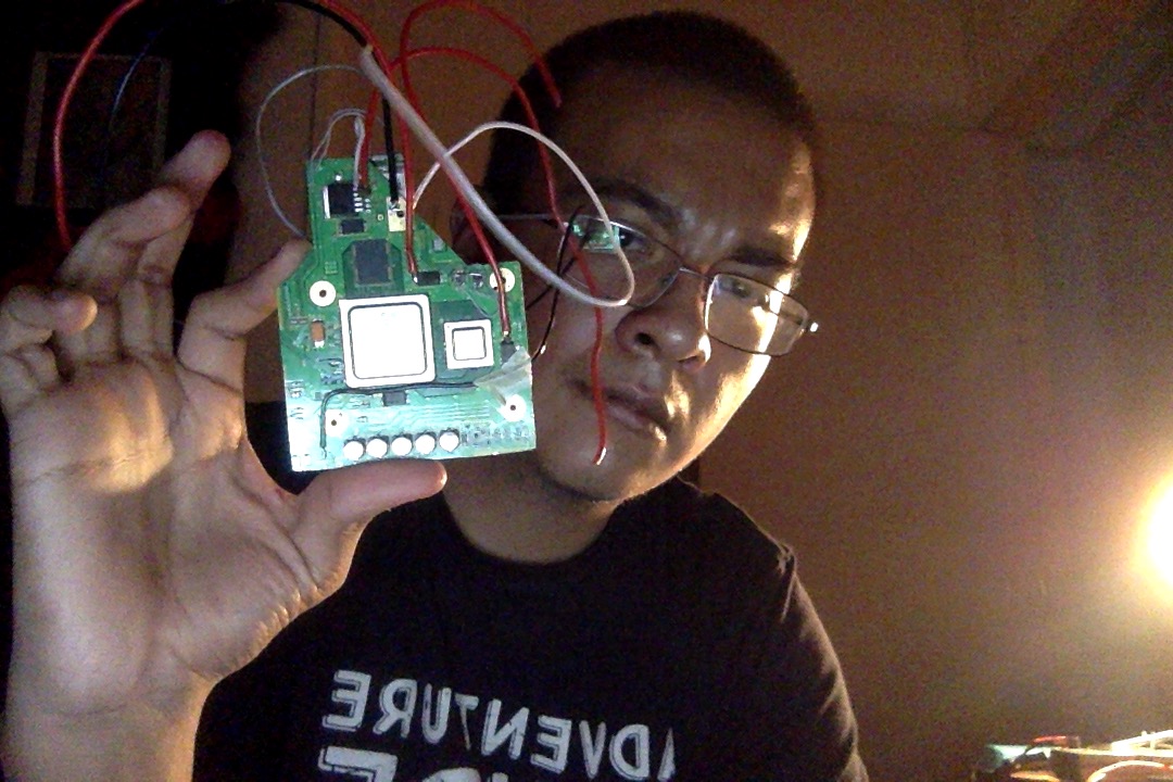

Couldnt get the last board to run. Trimmed this new board, had it boot portablizemii. (before trim) Will do u10 relocation soon. This time i wont wire up bluetooth until confirmed booting board. Next week when i get paid ill be ordering some ti regs and maybe some batteries. By then i can finally finish the n64 mini and hopefully will recieve the stuff to assemble the front.

Lookin good dude. Here's a tip: relocate u10 before trimming so there is less to troubleshoot if it doesn't work right away after trimming. I usually like testing the custom regulators on the wii before trimming too.
I hear you. But i couldnt remove u10 with heating so i just remove the section off with a dremel..i also dont have a way of testing the voltages so im currently forced to do it this way which is a pain.

Was wiring up av. A lot of the pins have continuity with all of the pins on the encoder. What does that mean, shorts? Bridges?
