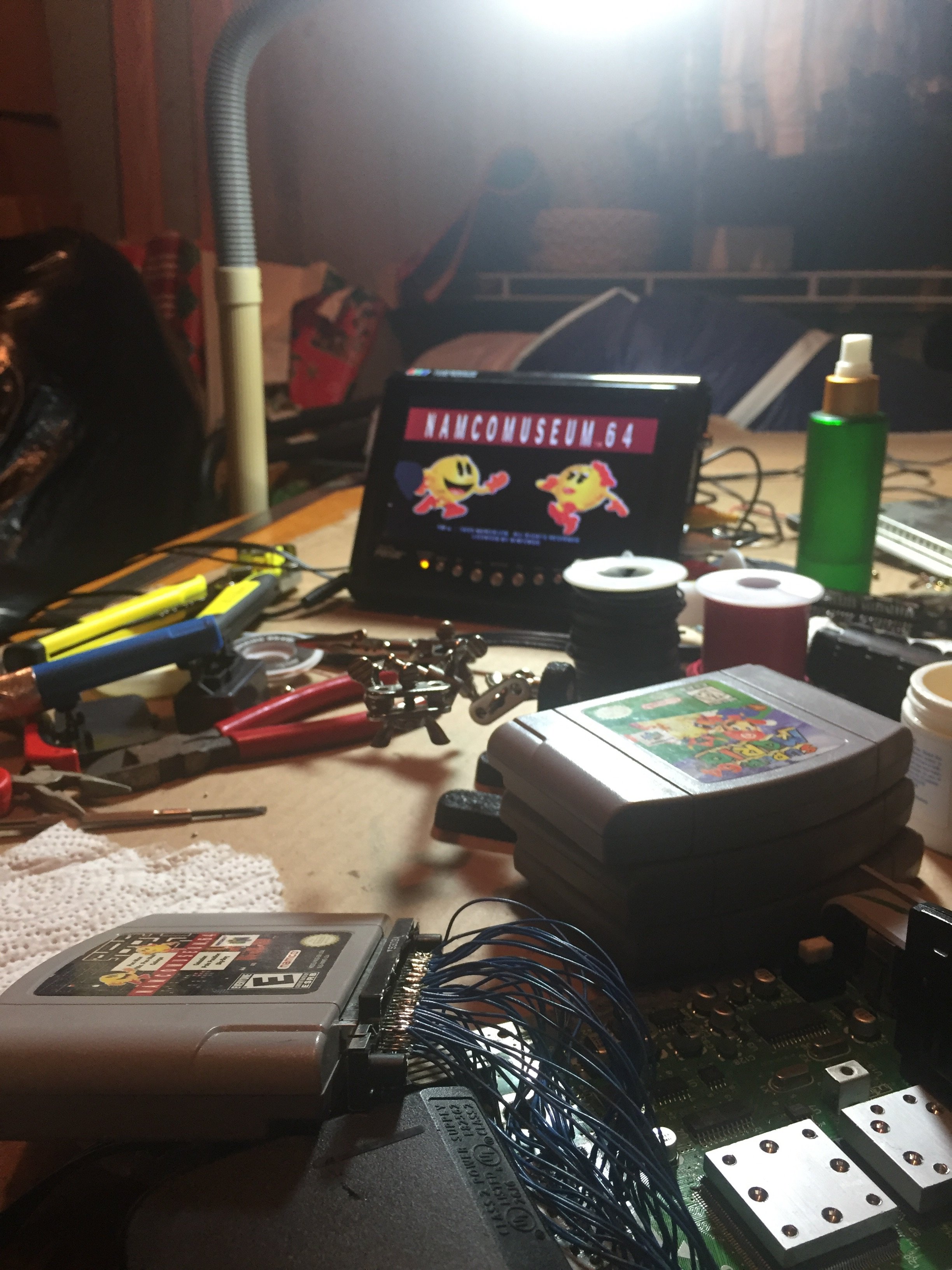

Yeah, i've seen those videos before and are pretty helpful. But I just got done trimming and rewiring the wires to 3.5 inches, and well, it doesn't work still :/ I think the board is fried or something, though idk how that could've even happened.
EDIT: Well I didn't see your post about continuity until now. I checked the continuity of all those points that you linked and they all seem to check out fine. The problem has to be somewhere outside of a short. Oh well, I'll keep thinking of possible issues. I hate to have dragged this thread on for so long xD

This feeling has never felt so good.. I finally got it to work :000
The issue was on the cart slot itself. Under the pins are little bridges where the pins are attached to. Well, two of those bridges were soldered together and apparently causing the short. Well anyway, thanks for all the help/support that was given to help me solve the problem!
