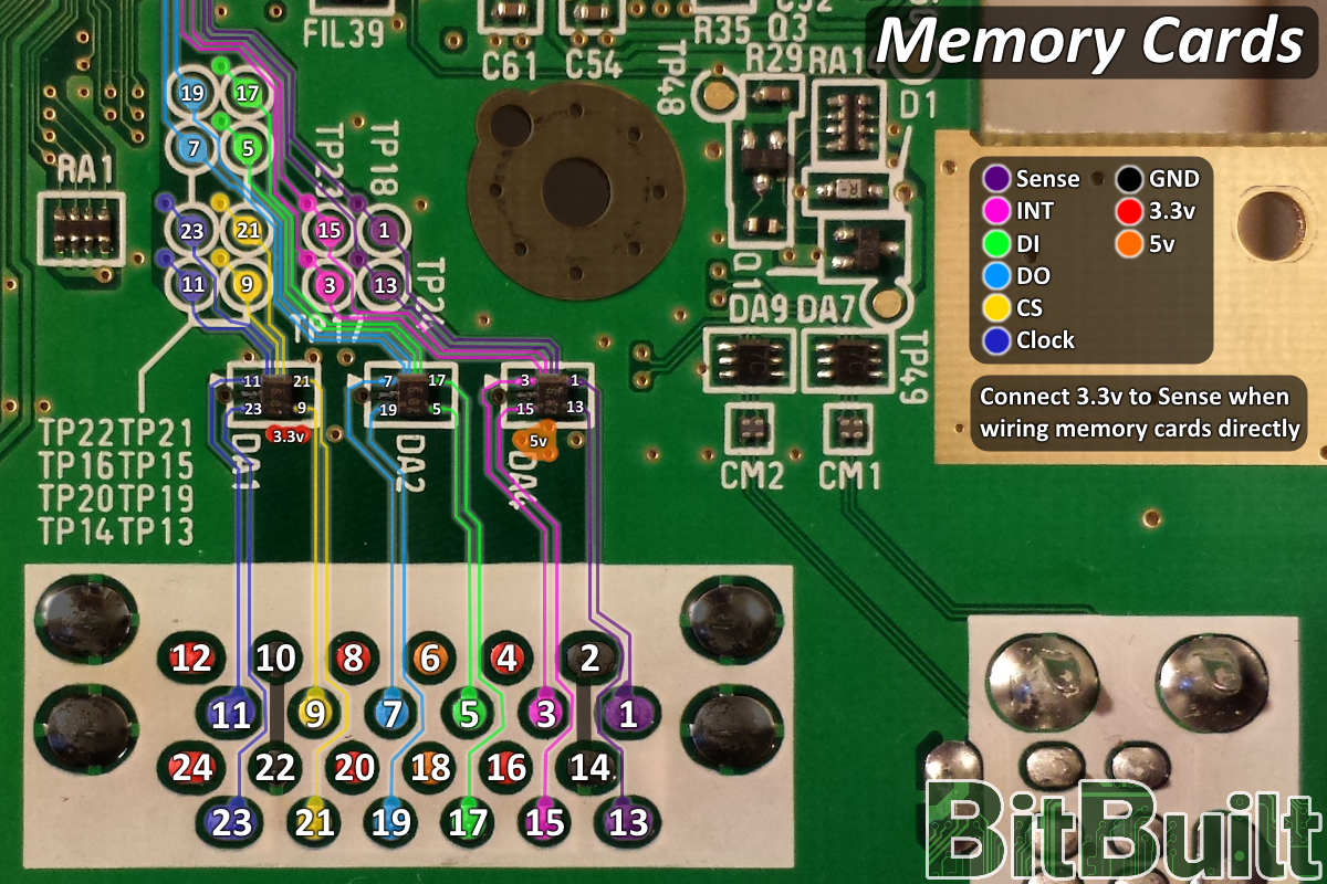

Question Wii memory card slot relocation
SartoZ
May 15, 2023
35
24
Italy
Hello there
I'm building an Ashida with GC memory card slot, but looking at the wii trim diagram I'm not sure if I have to solder the data wires to the test pads or to those DA components. Do somebody know it?
You can do either. The DA components help protect the data lines against static charge, but you can bypass them and solder to the test pads for convenience. It doesn't really matter terribly
