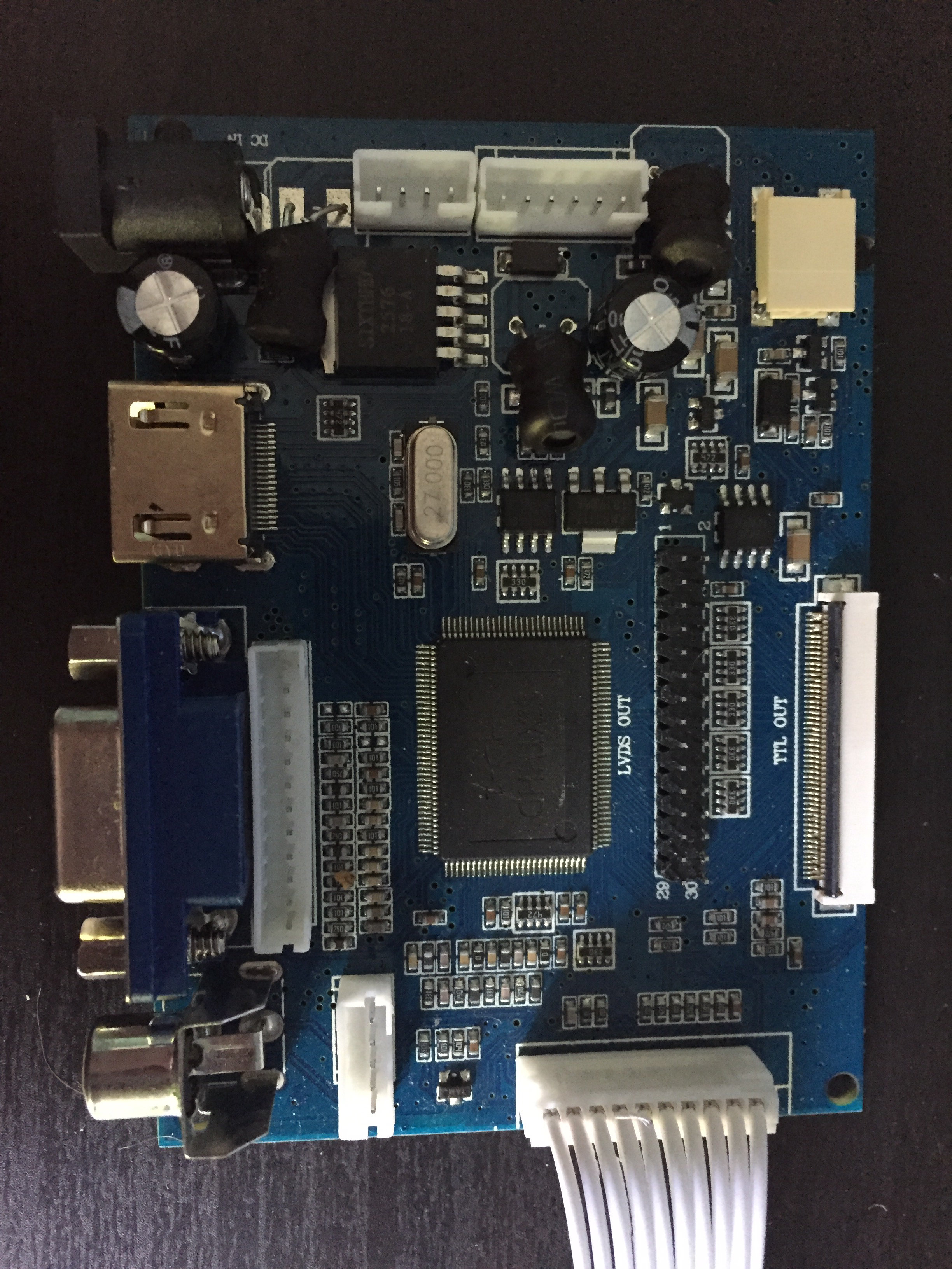

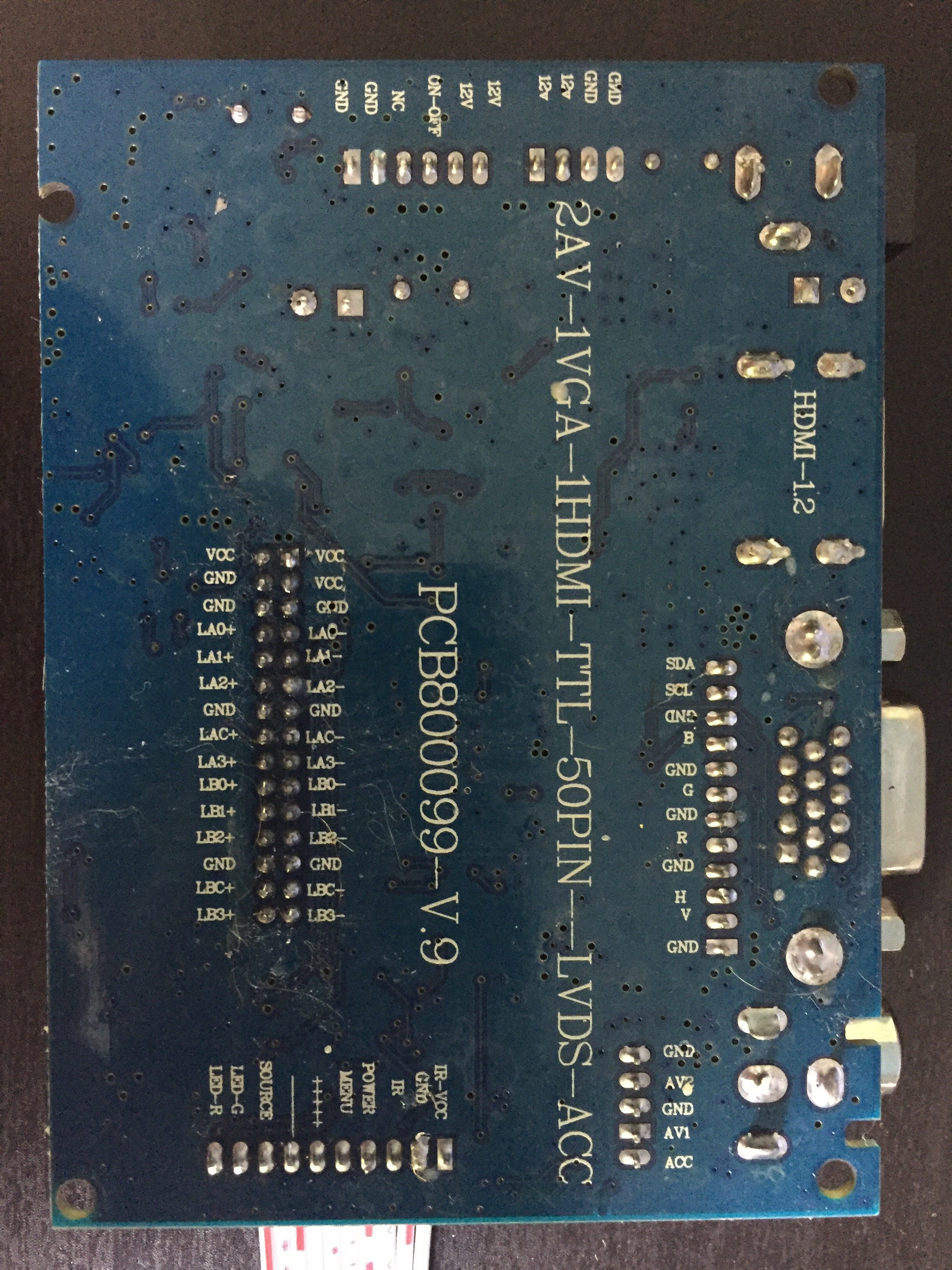

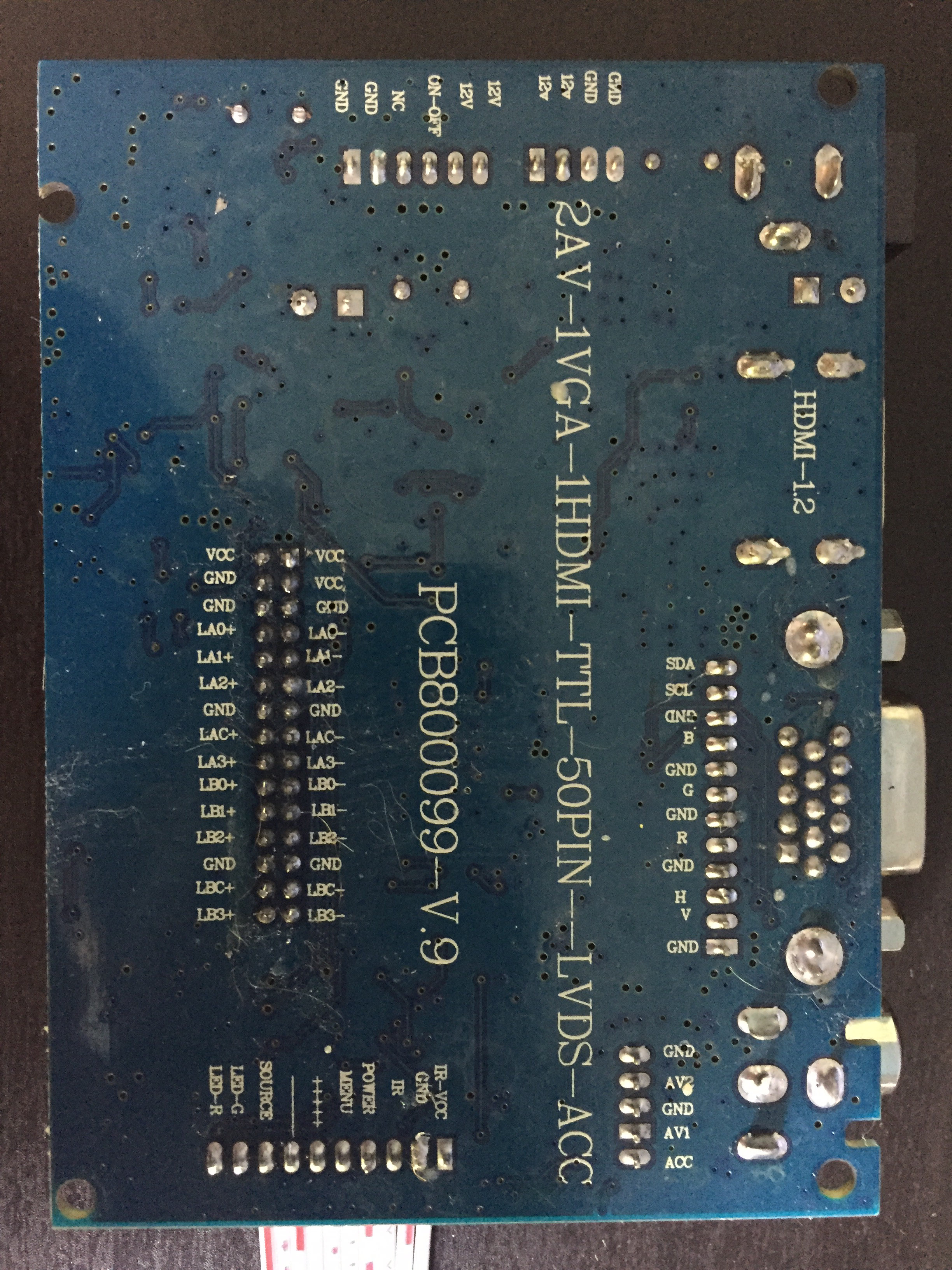

Here are some pictures of my driver board:

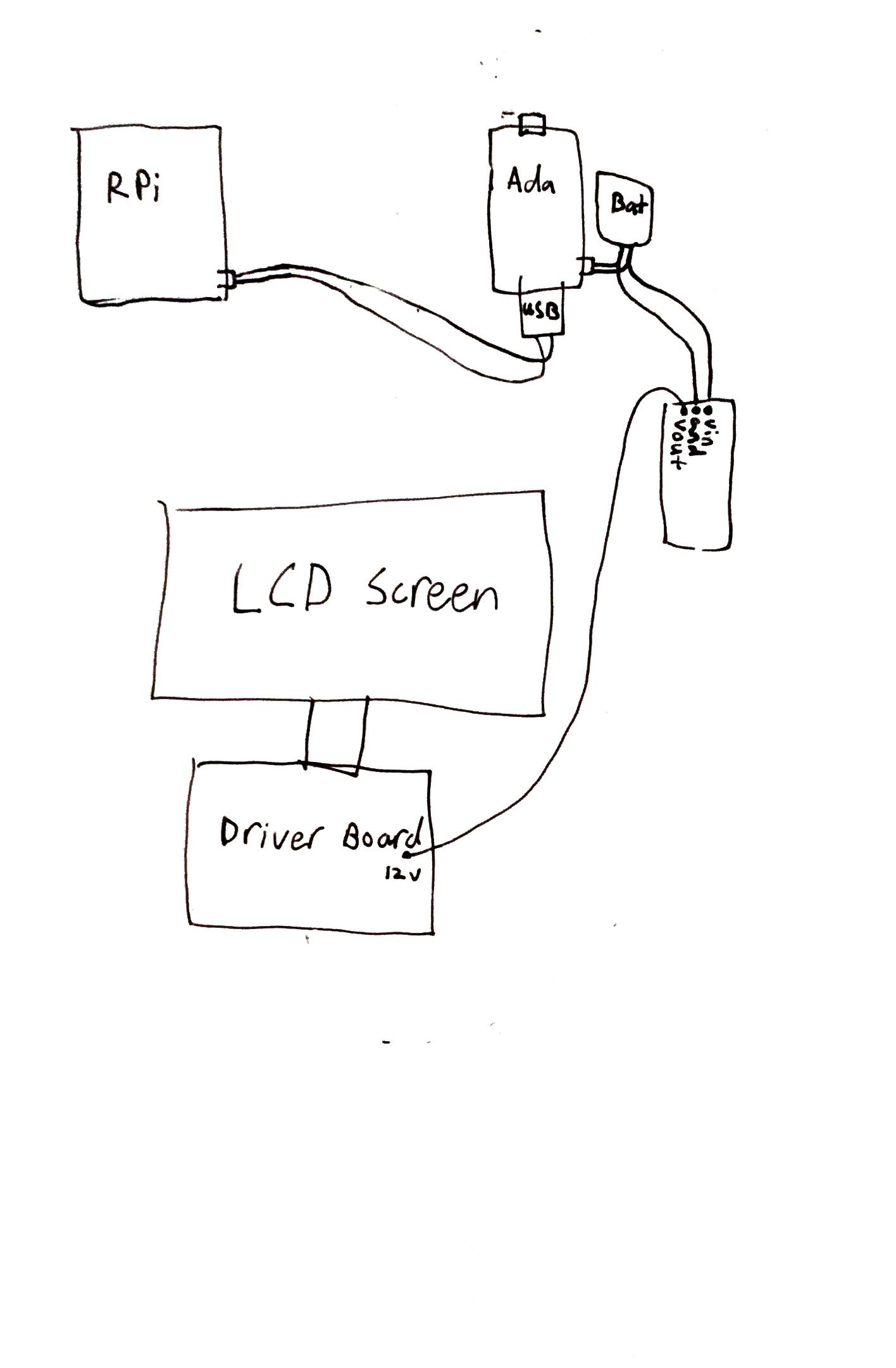

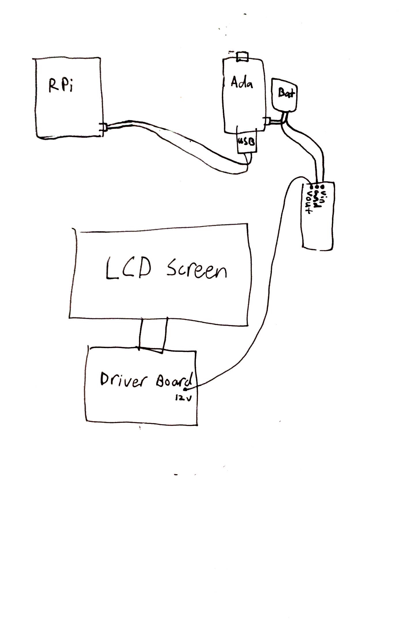

and I was talking to a friend of mine who is really good with electronics about what I should do, so I sketched out a model of what we were thinking:
'ADA' is the Adafruit Powerboost, the bouard with VOut GND and VIN is a 12volt step-up voltage regulator. (Of course this is just a rough sketch and probably won't reflect the finished product)
Wait, so you're telling me that you tried to wire your battery directly to a screen?
That's bad news if you did.
And plugging the voltages of your battery straight into a 12V buck converter isn't any better.
Batteries NEED TO BE PROTECTED AT ALL TIMES FOR EVERYTHING!!! NEVER try to pull battery voltage directly to a load, or else you will damage the cells/damage the load/ cause an explosion.
This stuff isn't a joke.
This thread has some really nice information on handling batteries safely, so I'd go through it for sure because what you're doing is quite dangerous. I'd have your friend read through it too because while I'm sure there are areas of electronics he is quite knowledgeable in, batteries aren't the kind of thing you want to guess at.
Your batteries are protected through the powerboost for your Pi, so you don't have to worry about protection there. But trying to pull voltage direcrly from your batteries to anything wasn't a good idea. That's what probably killed your powerboost.
I'm sorry if I'm sounding harsh, but if you don't understand what you're doing then your figurative playing with fire is going to turn literal soon enough. You should definitely do more research beyond that thread I gave you, espescially with how other people have safely powered TFTs with Pi setups
Additionally, how do you plan to step up to 12v? And what you made you think your screen could run natively on such a low voltage? It's not uncommon for TFTs to be able to run off of 5v, but 3.7 is quite a stretch considering that the driver boards generally step down to 5v and 3.3v.

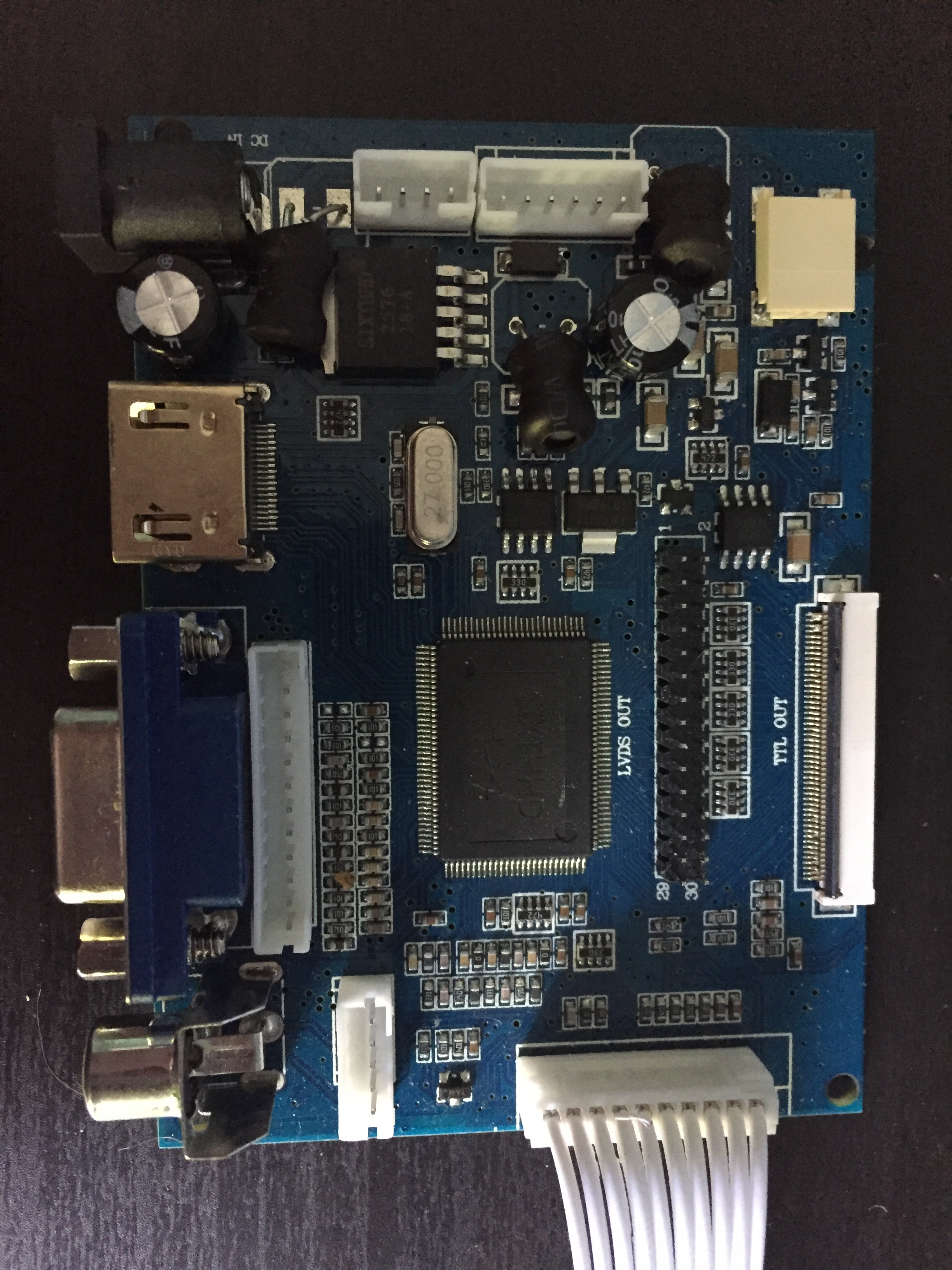

View attachment 6105 View attachment 6106

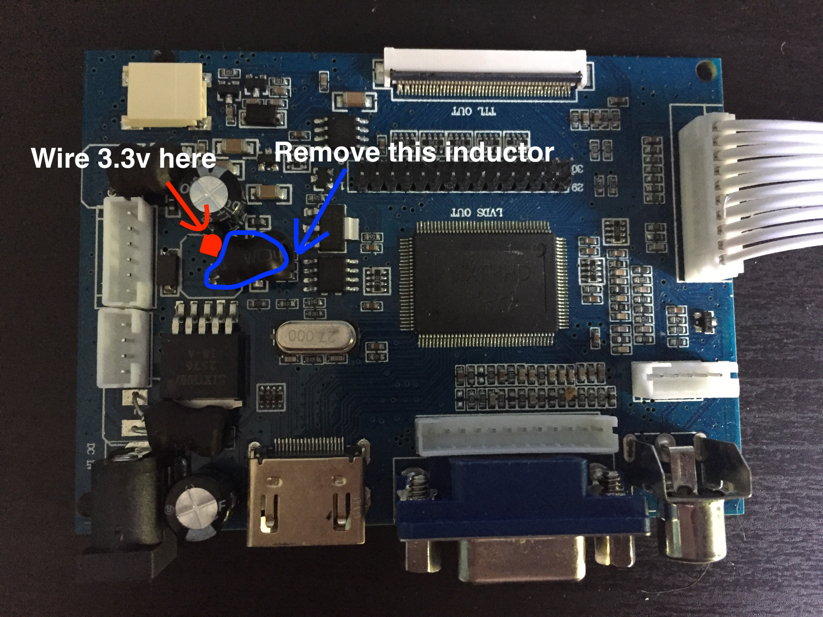

NOOOOOOOOOOOOOOOOOOOOOOOOOOOOOOOOOOOOOOOOO!!!! You never wire straight from a battery to a load, anything that wants power must be wired to the 5v output of the Powerboost. Also, what do you mean when you say "power pin"? Which pin on the driver board did you power?
there should be a number of 8 legged ICs on the board. If you check them with a multimeter you should find that one of them will have a leg that outputs between 4.5v and 5.2v. If you lift that leg off the board and solder a 5v carrying wire to the pad, that should run the screen with significantly less power
Did you do this as I suggested before? There are two 8 legged ICs on that board, one of them should be it.
Uhm, please tell me you don't wire 5v to the power pin again. Its supposed to be grounded to turn on the on board 3,3 regulator ;). It goes to a gpio line on the main driver ic which controls the regulator. If you want to power the screen from 5v, you will need a voltage regulator to step it down to 3,3v. The easiest way to do this is probably a PTH08080 and a 1,8kΩ resistor. Use this thread to find out how to wire the PTH08080. Wire the 3,3v output to the following pin on your driver board, after removing the black inductor:
The easiest way to remove the inductor without damaging the pads is by heating one pin up with your iron, pull on the other side of the cap to move it, then heat up the other pin, repeat. Slowly remove the inductor this way.
About the Powerboost: It might be dead depending on if the power pin on the lcd driver was grounded. I'm not sure about its default state. To be safe I'd just order a new one. And just to repeat it: Don't wire anything to your battery but the powerboost. Then wire everything to the powerboost output.
