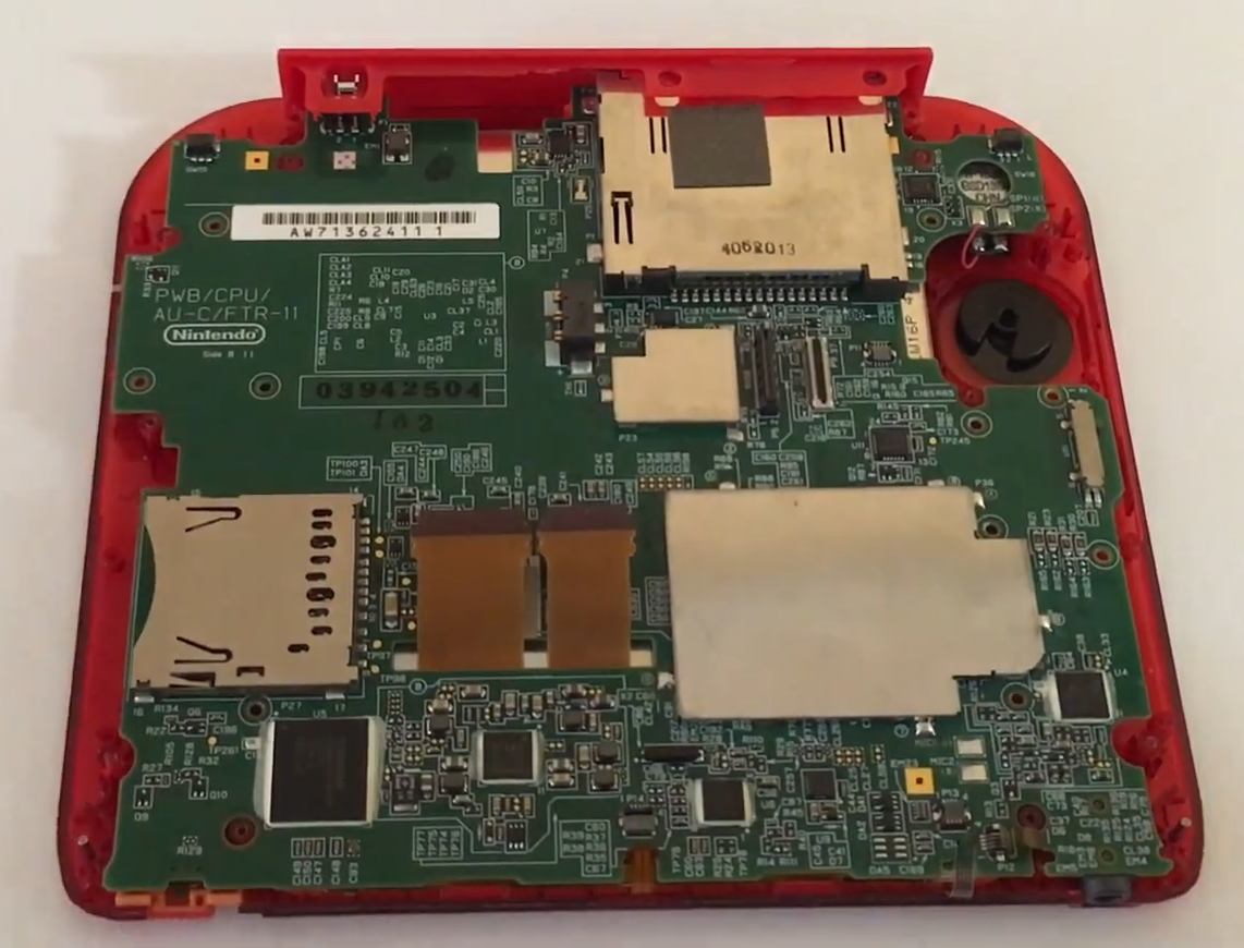

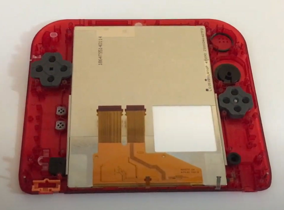

The 2DS has one big screen inside-- there aren't two separate LCDs like in the DS/3DS. So, you wouldn't be able to use the original screen.
The motherboard is also really big and has high-speed stuff spanning the top and bottom halves.
Unfortunately, a conversion would be an absolutely massive amount of work and wouldn't be worth it vs getting a 3DS or 2DS XL.
