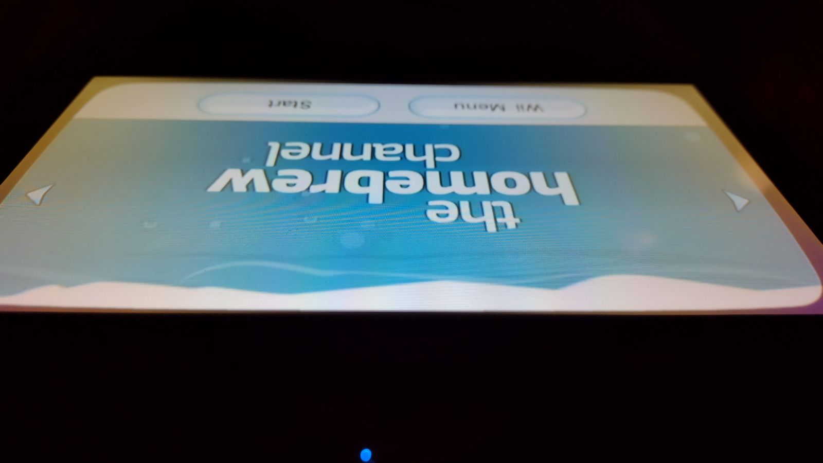

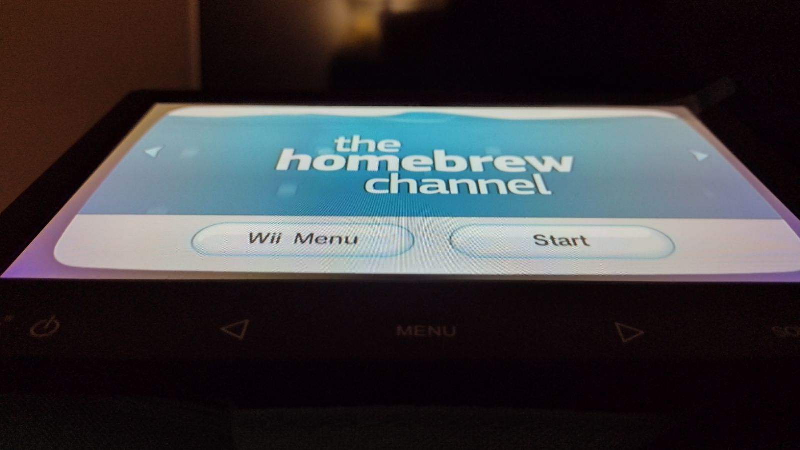

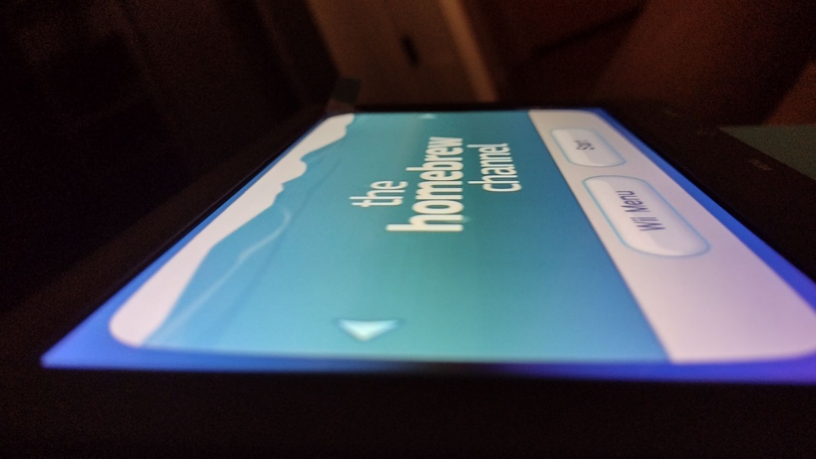

So, I ordered 3 different screens and here are my thoughts on each and some pictures of the one I kept.

  3. The Keeper: Amazon.com: Eyoyo 7 inch Monitor, 1024x600 Small IPS HDMI Monitor, HDMI VGA AV Monitor with Remote Control & Speaker, Portable Display for Gaming Raspi PC DVD Car : Electronics
    1. This one has great viewing angles. It worked with my computer through VGA and I played some Double Dash on it thought AV. I am going to keep this one.
Here are the pictures of the one I'm going to keep:
Hopefully this helps someone else out!
