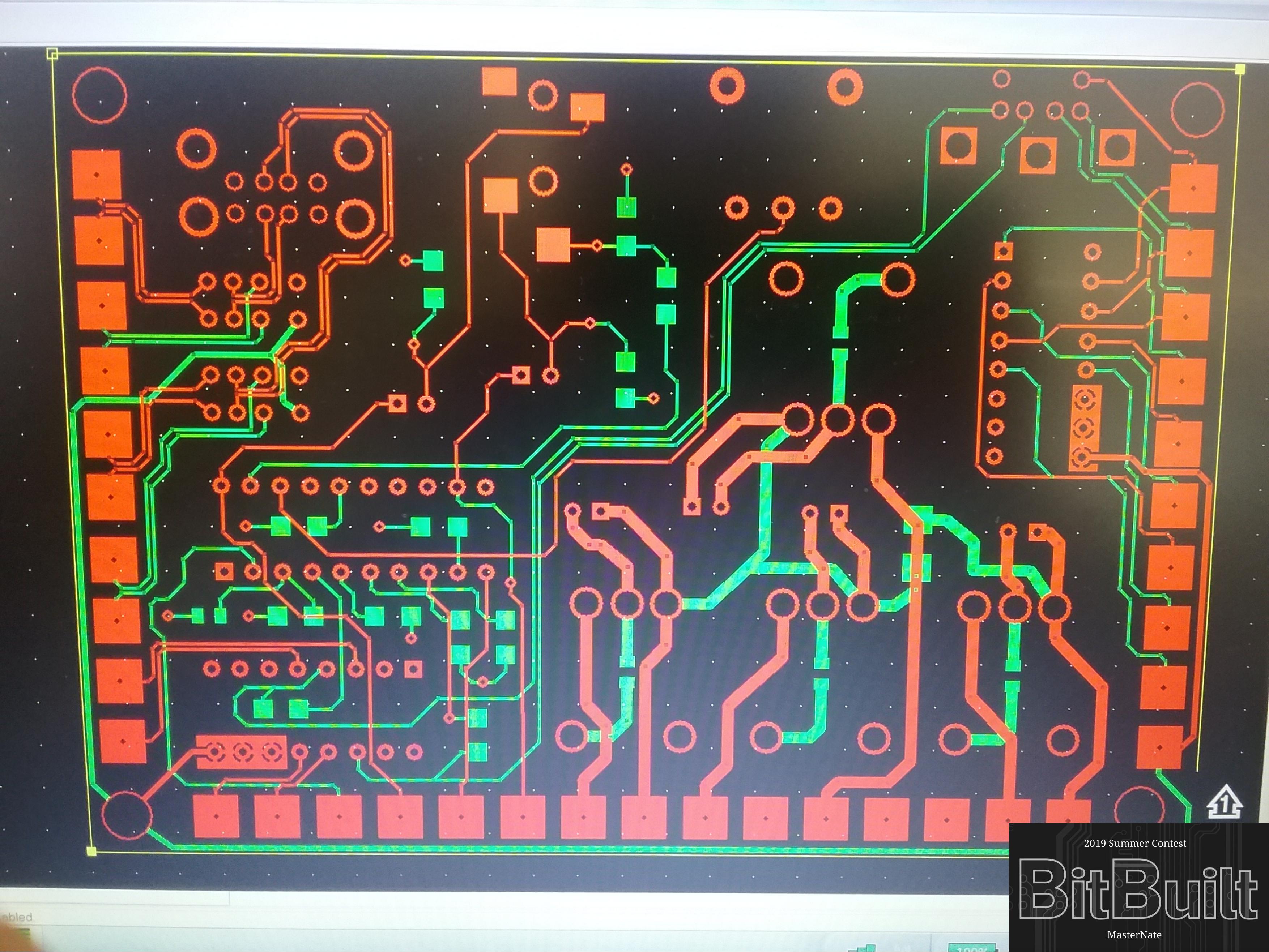

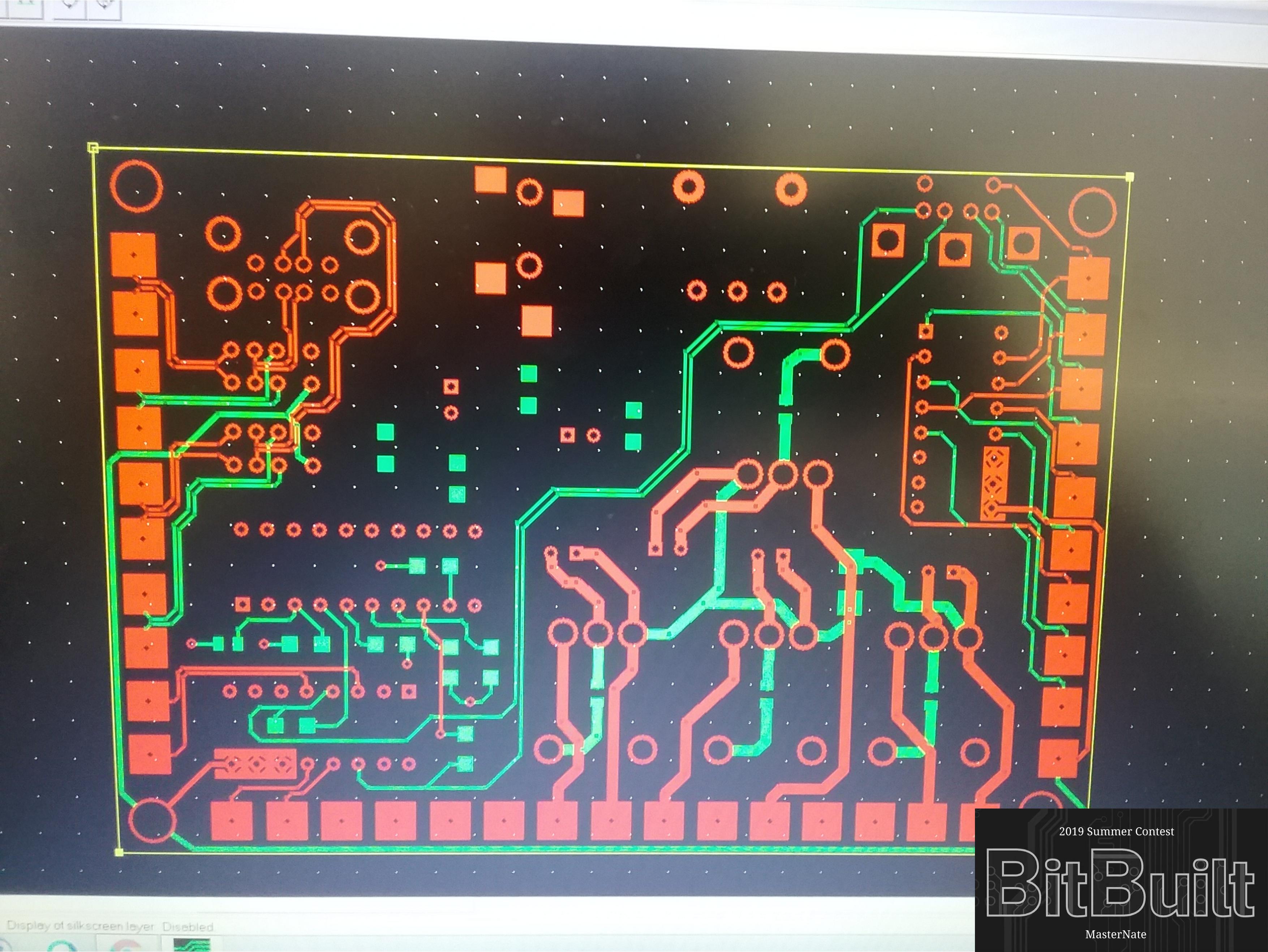

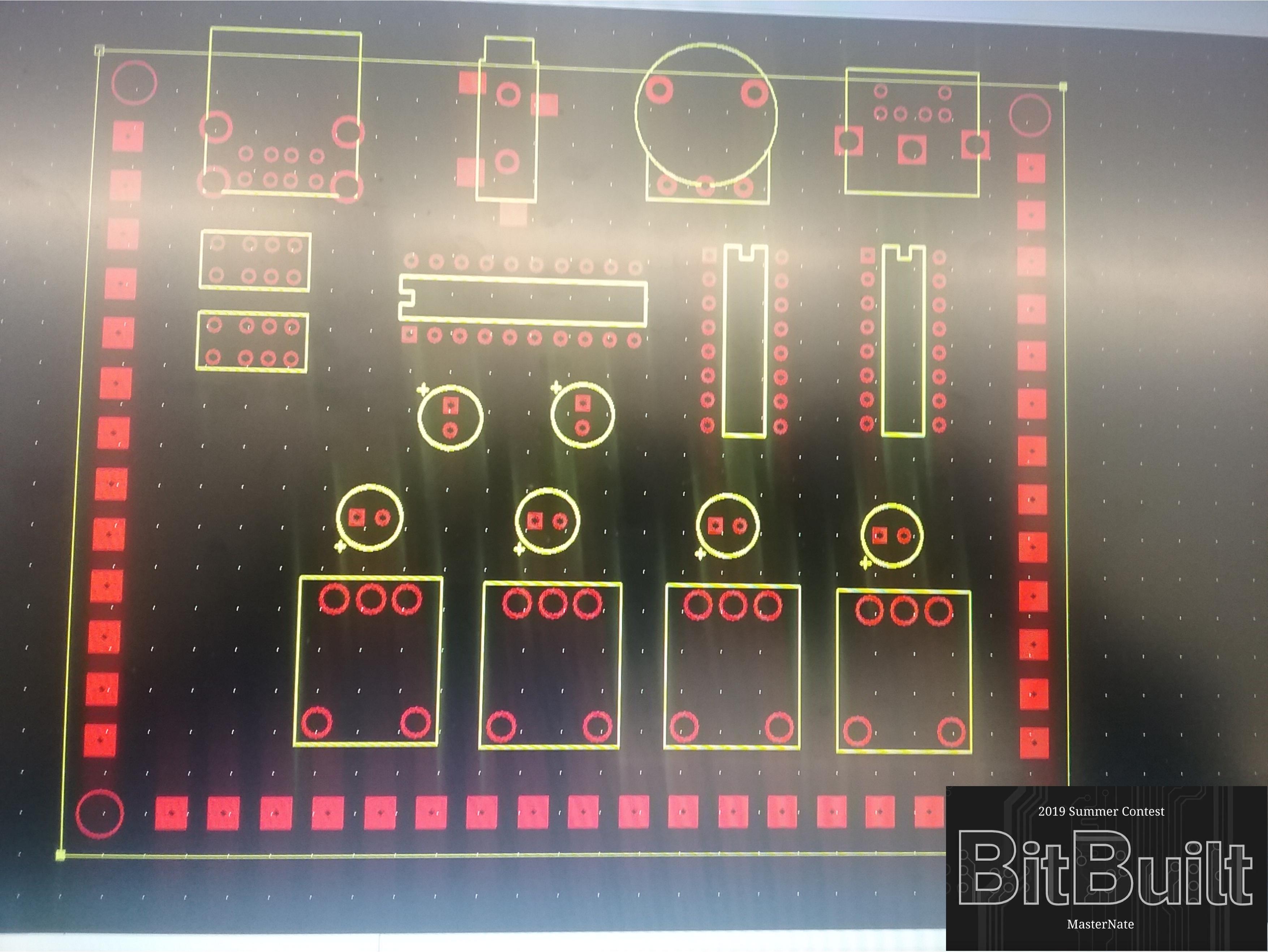

The reason it is named the PsWii is because I am making a combo Wii and PS2 portable in one. Inside the PsWii will be a fully functional Wii and PS2. I have been making slow progress with school, but last year with the start of my first job, I was able to make the circuit board which will handle all of the video switching, audio switching, USB switching, audio amplification, and voltage regulation. I used ExpressPCB for the design which was really easy to use, but when it came time to actually get the board made, the board design file was not in a format which any PCB building place accepted. Here are some pictures of the design and final product.
This was the starting layout of my board, but it was not well laid out and I ended up changing it later.
This was the ending layout of my board. The top left part of the board handles the USB switching from Wii to PS2. The top right part handles the video switching from Wii to PS2. I am using Component video for this project. The bottom right handles voltage regulation. The bottom left handles audio switching and amplification. For some reason I do not have a picture of my board design with everything finished, but it was finished completely before I had the board made.

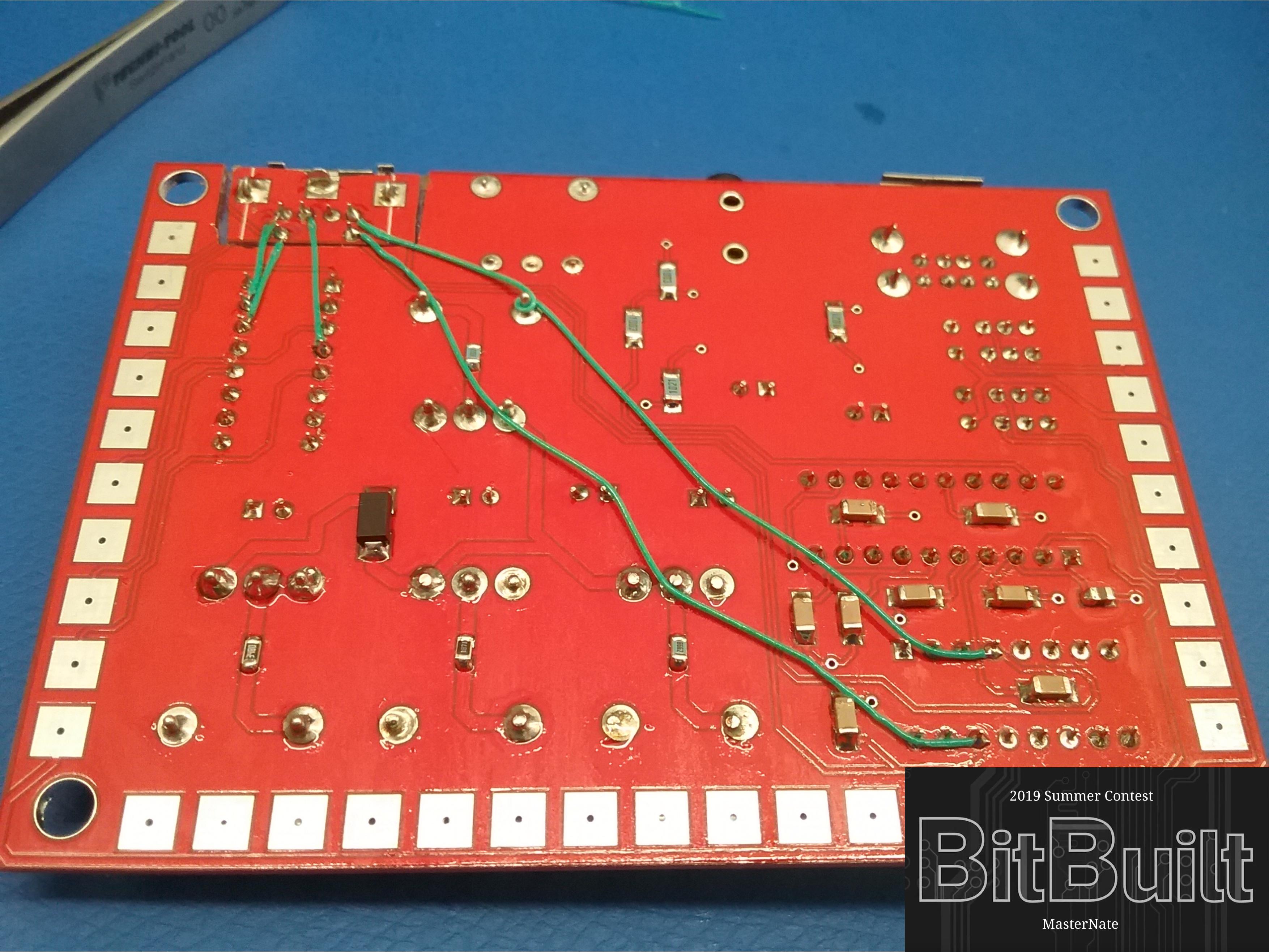

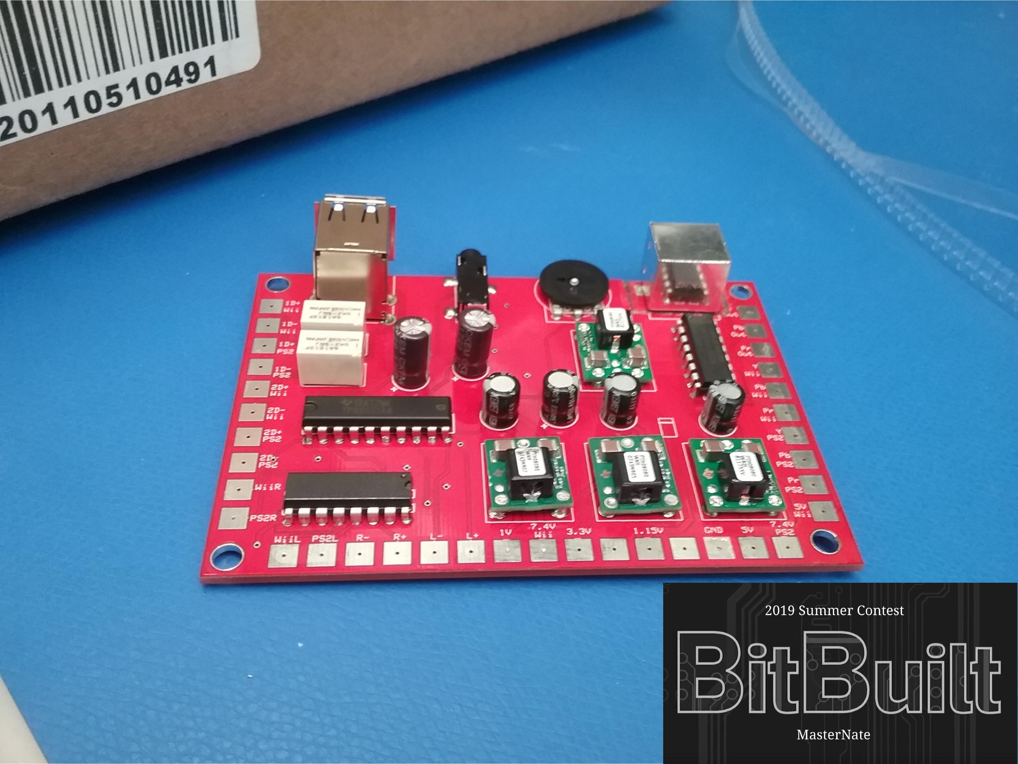

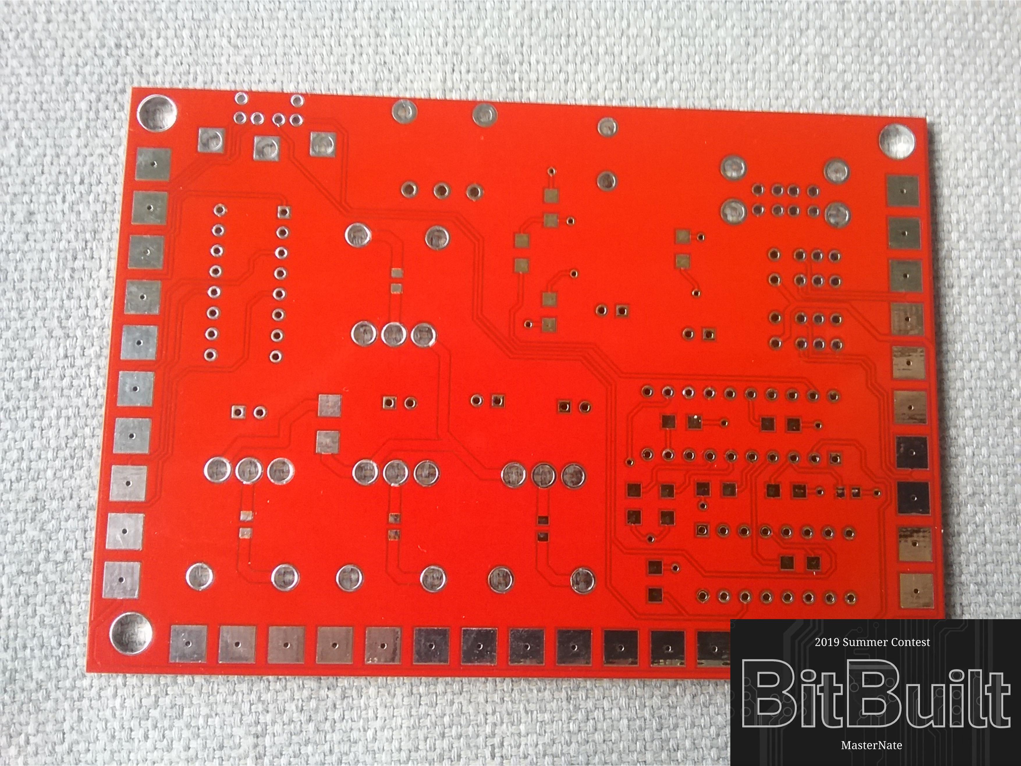

Here is a picture of the fully completed board. In my design, I accidentally flipped one of the connectors backwards. So when I finally got my boards in the mail, I had to cut out the connector, flip it around, and solder the wires to the connector by hand because I cut through the traces.
Here is a picture of the fully populated board. All of the major parts use through hole parts because at the time I designed the board, I was not good enough at soldering to solder anything surface mount that was not a passive component like a diode or a capacitor. I am really happy with how the board turned out.

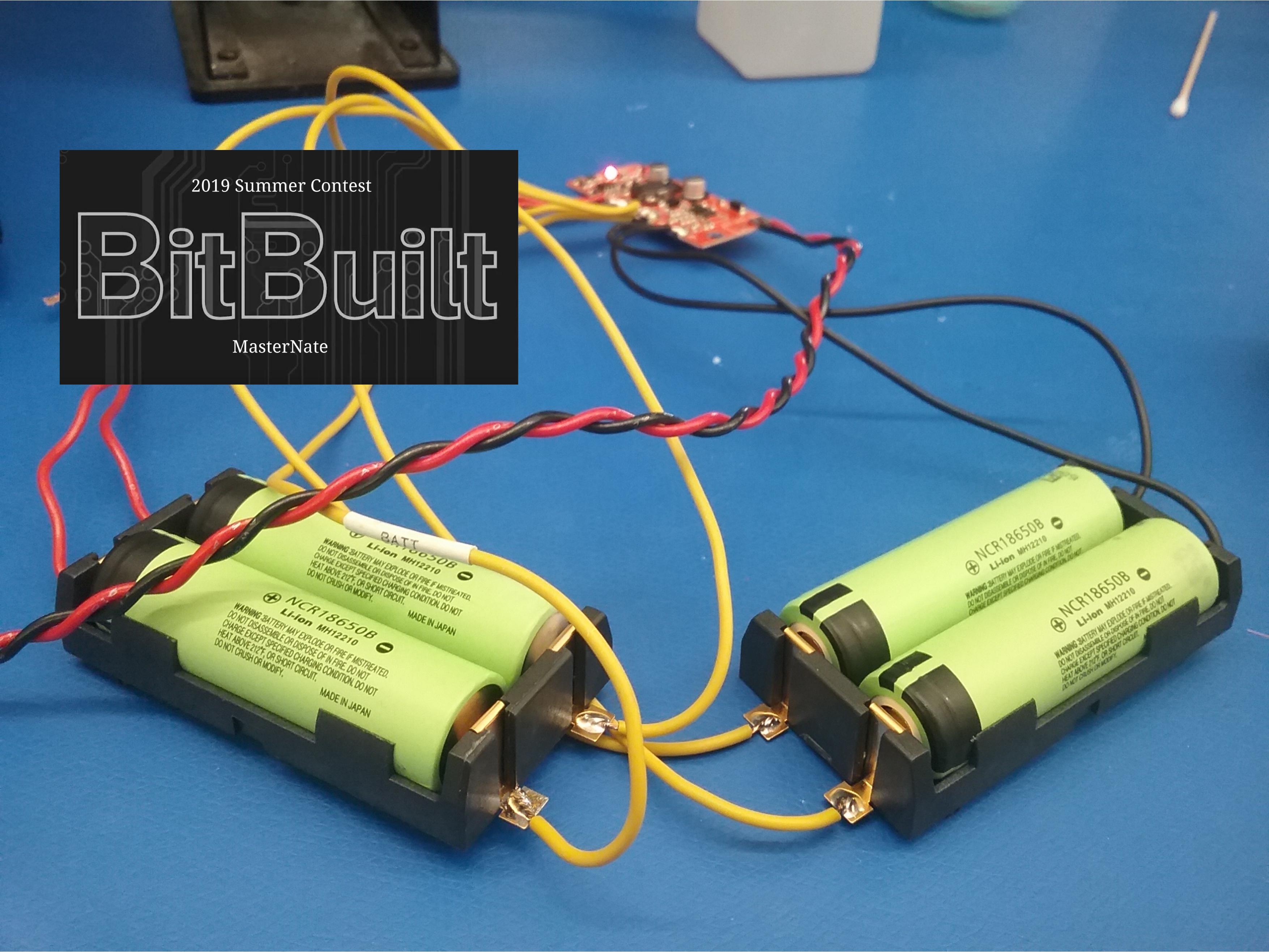

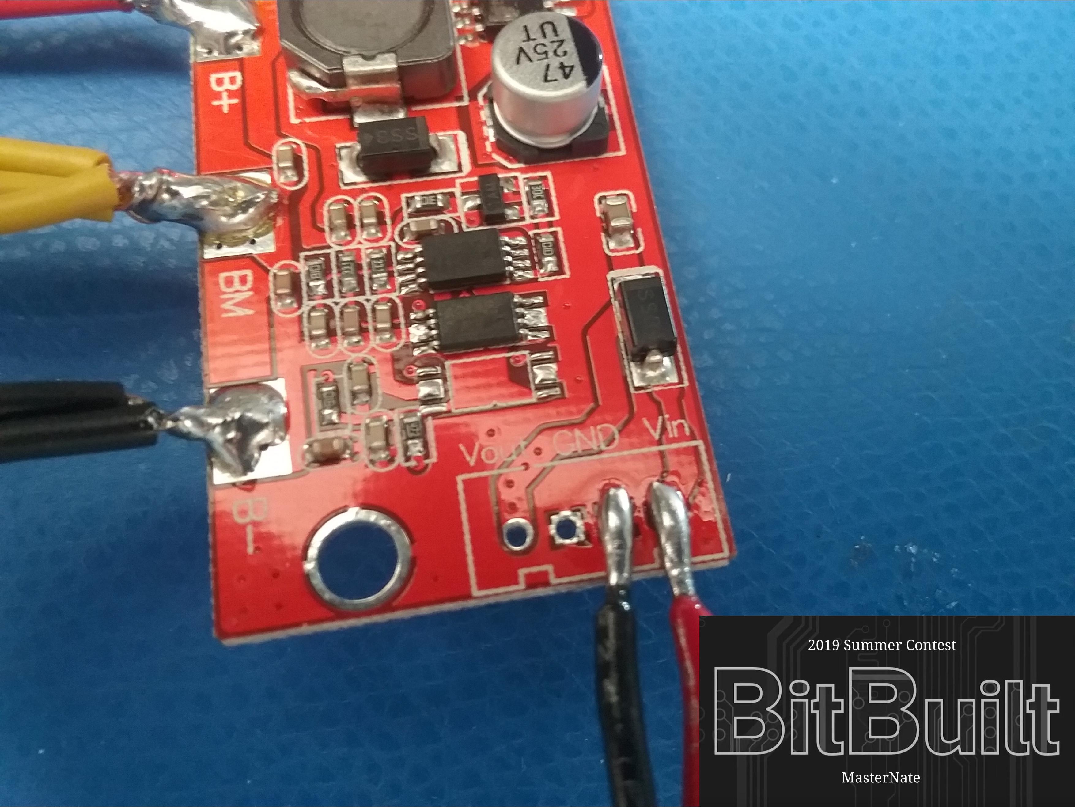

I also have my battery setup all done. I am using the standard red board for charge and play. Here are a couple pictures.

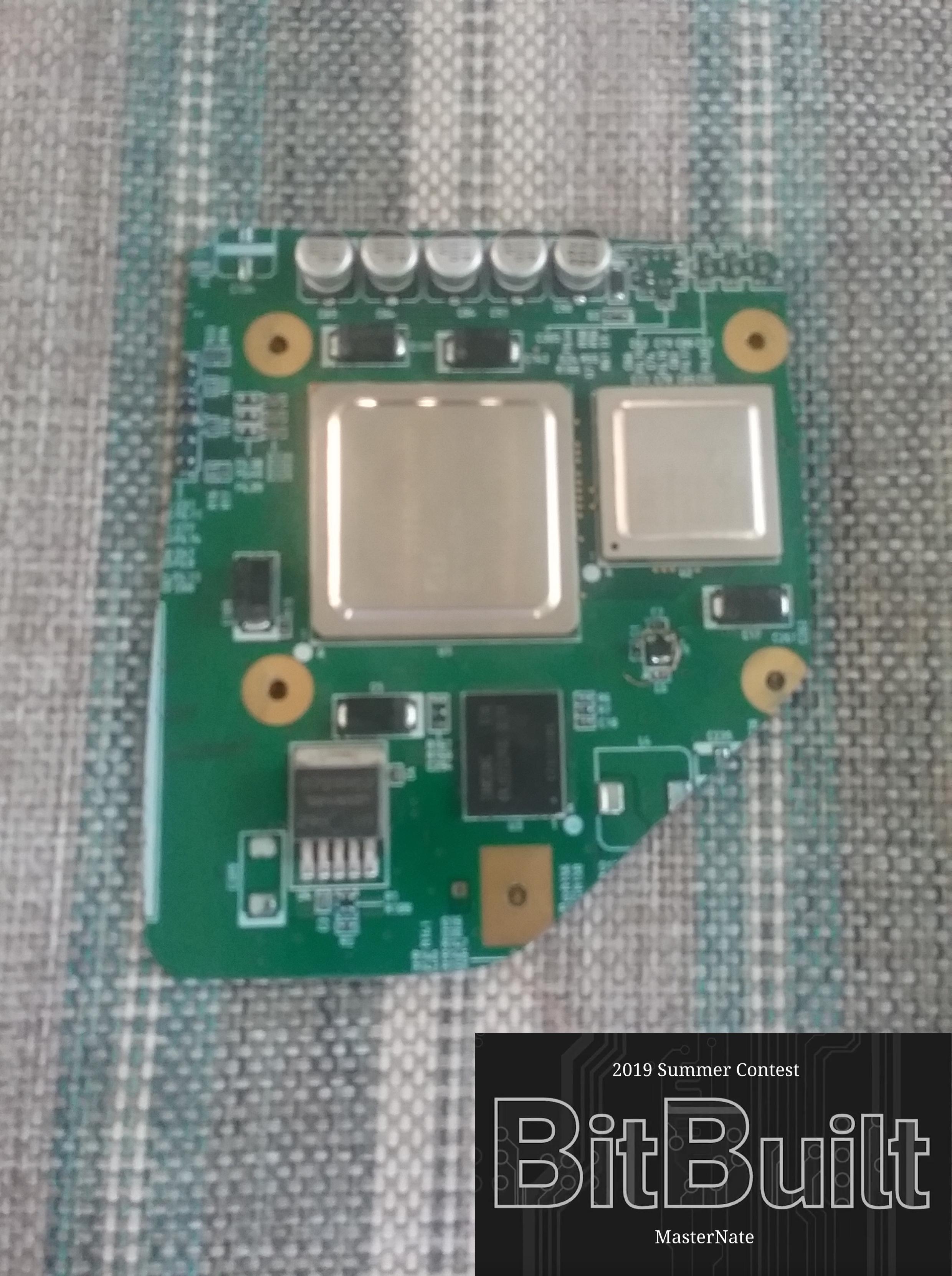

Hello BitBuilt. I am back with another update. This week, I wanted to get at least my wii trim working. I decided to practice trimming a 6 layer board first seeing as how I have never done a trim before and I only have 1 4-layer wii and have 5 6-layer wiis. The trim ended up going really smoothly. After taking a Dremel to my board, I sanded it for about an hour and a half starting at 180 grit sandpaper and working my way up to 1500 grit. The edges were so smooth. Here is a picture of my trim after I finished sanding. (Sorry for the bad picture quality. My phone camera is terrible.)

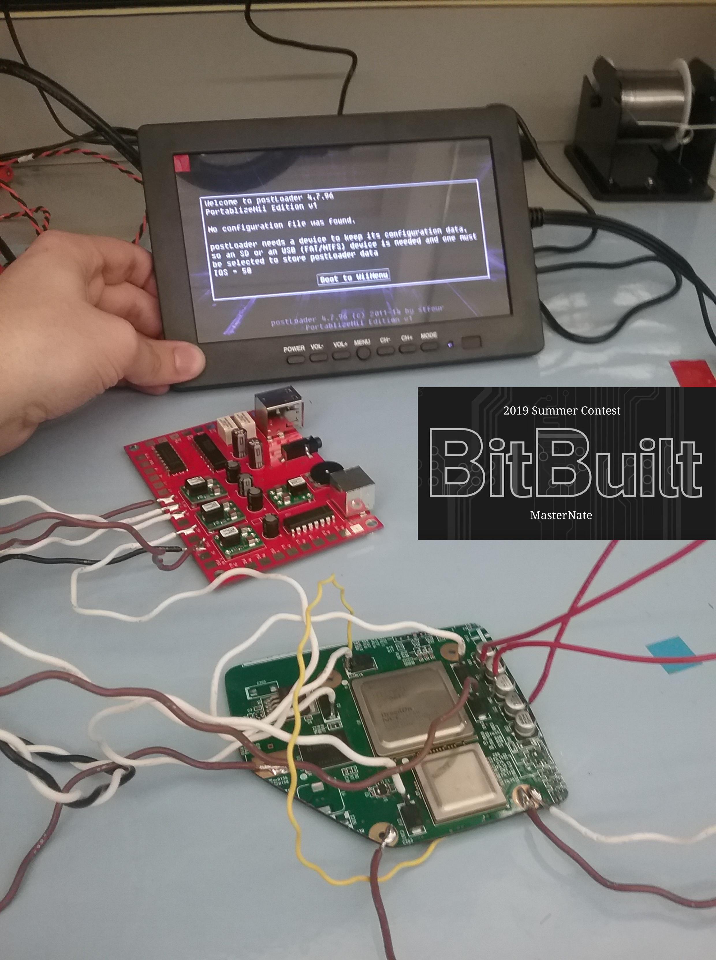

After I did the trimming, I then went to test the trim the next day. That went off without a hitch. Everything worked great. There were a couple problems with the video colors, but after I grounded the RCA jacks, most of the color seemed to come back to normal. I did end up having to switch two of the component cables for the colors to come back to normal. The weird thing though is that they do not line up with what the 6-layer trimming guide says. I am not sure if it is just my revision or if something else is weird. But here is a picture of my working wii trim.
