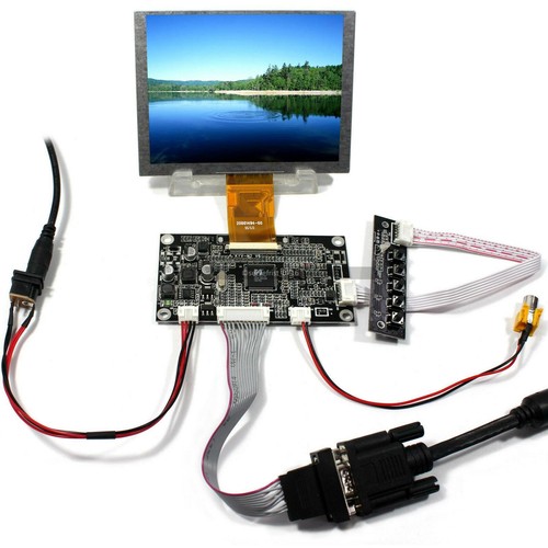

Look at this on eBay
I'd like to know if I can use this screen for my project in particular if I can power it with 5v.
Video inputs would work, officially don't believe anyone has tested it so it would require some poking and prodding to find out if 5v can be wired to a point past the DC input jack it has been talked about briefly on discord. There should also be a variant with a different driver board that would work too.
This would be the other type of 7" at 800 600 that could accept a 5v input straight at the jack.
7" LCD 800 600
Thanks for the quick answer. I choosed this screen because of the price and more importantly because of the small board. The one that you linked has also an adapter and some fcc cable extra.
It's true there's more fpc but it doesn't hinder building a portable, I had a similar setup in my wiide-boy handheld and the display board in the link I gave was able to run on 3.3v so you're milage will vary with either option.
