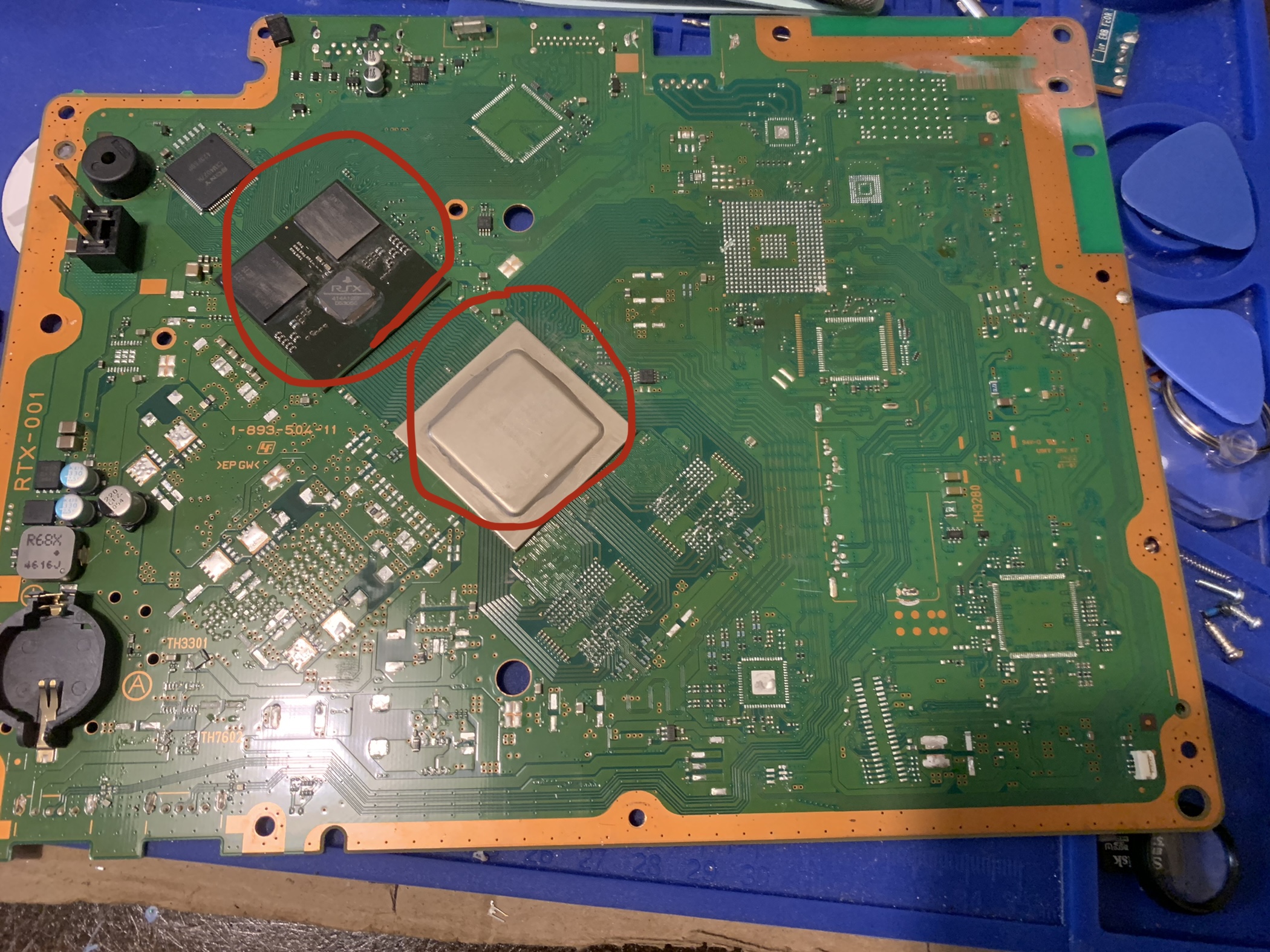

Customledmods . Joined Nov 9, 2017 Messages 875 Likes 838 Location CA Portables 8 Jan 5, 2021 #1 I need help removing these chips I’m using a hot air gun set at 380 Celsius any help would be great thanks.
Gman RTFDS Staff member . . . . . . Joined Feb 25, 2016 Messages 1,465 Likes 3,020 Jan 5, 2021 #2 Without a pcb heater it can take several minutes with a hot air gun to heat it up enough to carefully remove them
Customledmods . Joined Nov 9, 2017 Messages 875 Likes 838 Location CA Portables 8 Jan 5, 2021 #3 Gman said: Without a pcb heater it can take several minutes with a hot air gun to heat it up enough to carefully remove them Click to expand... Thanks for the fast reply I had it on for about 5 min and it was not budging should I leave it longer or higher the heat?
Lightning . Joined Apr 12, 2017 Messages 225 Likes 156 Location Canada Jan 5, 2021 #4 My suggestion would be putting it in the oven to get the whole thing up to temp
Customledmods . Joined Nov 9, 2017 Messages 875 Likes 838 Location CA Portables 8 Jan 5, 2021 #5 Lightning said: My suggestion would be putting it in the oven to get the whole thing up to temp Click to expand... Regular oven same temperature?
Lightning . Joined Apr 12, 2017 Messages 225 Likes 156 Location Canada Jan 5, 2021 #6 For reflow you can just heat it to between 233 and 250 degrees Celsius, most will just do 240 degrees
Customledmods . Joined Nov 9, 2017 Messages 875 Likes 838 Location CA Portables 8 Jan 5, 2021 #7 Lightning said: For reflow you can just heat it to between 233 and 250 degrees Celsius, most will just do 240 degrees Click to expand... Thank you so much for the help
