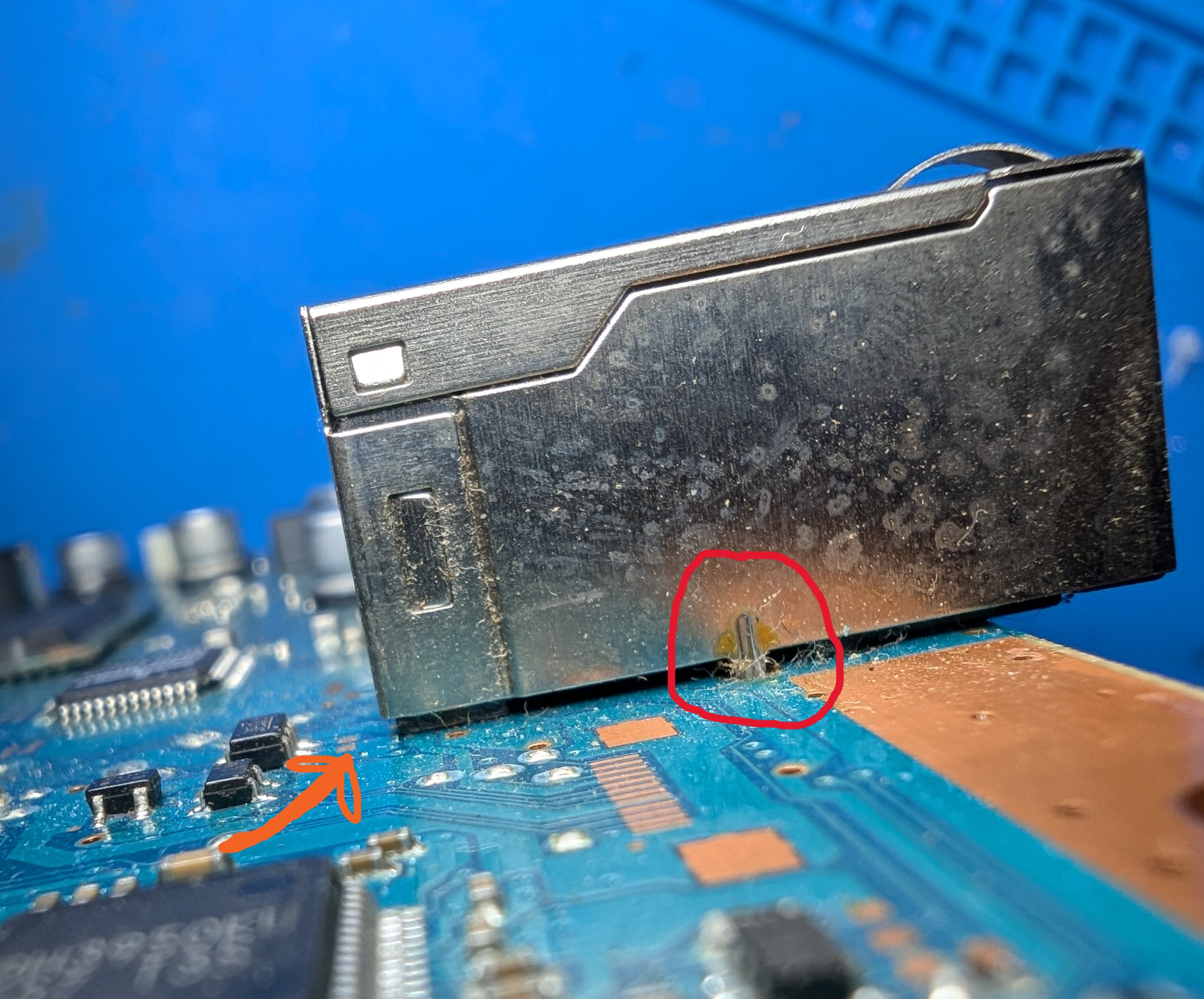

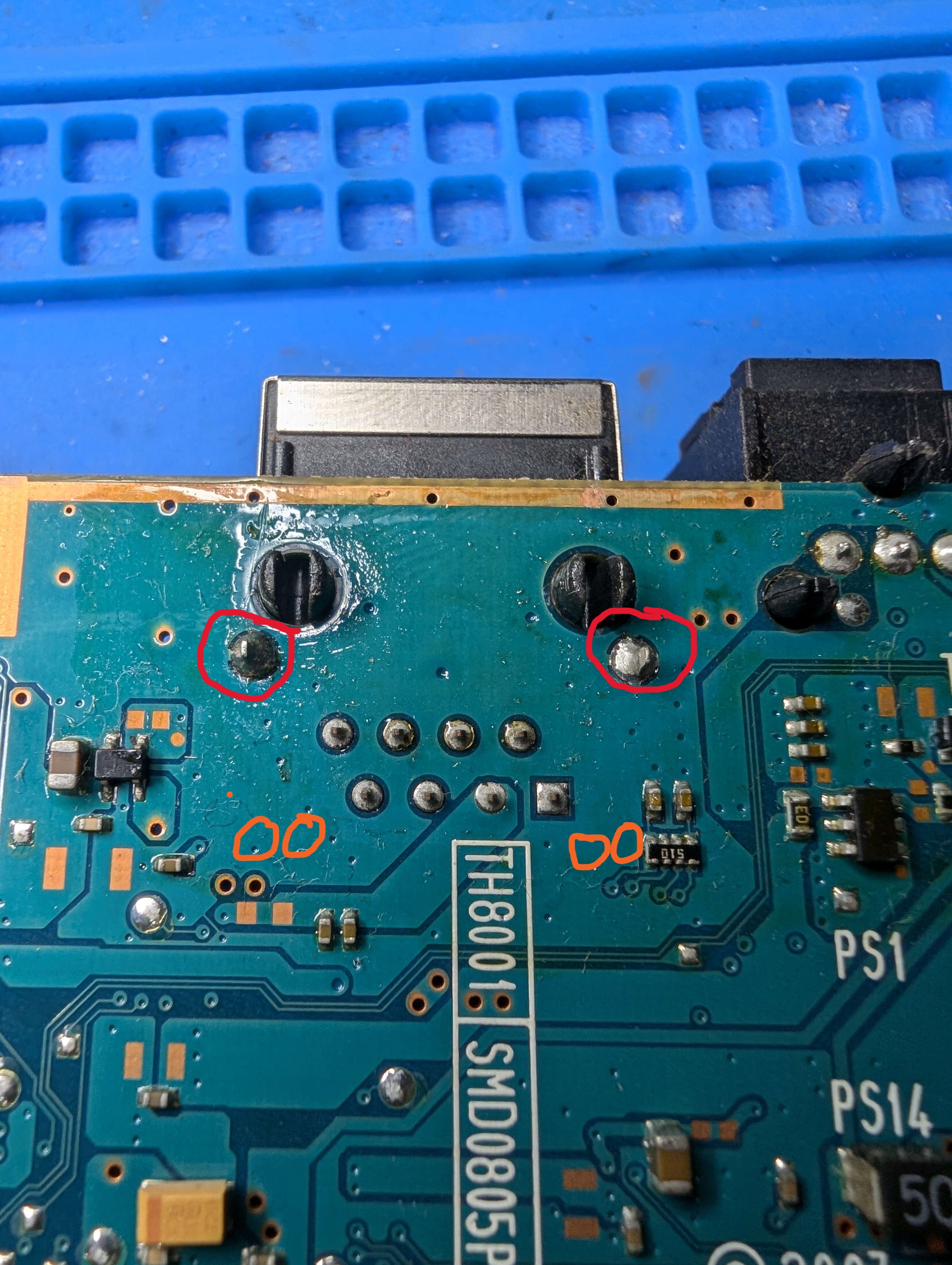

interesting question. I have never thought about that before.
I think it would work though, because the only difference I can see between the port you have there, and the original, is the 4 extra ground ports at the back (which could be cut off).
as you can see in the images, the original only has 2 ground pins (in red) that should line up with the new port. In orange I have marked where the missing pins are on the original port. as for the other pins, there are 8 data pins on both of these in the same pattern. The 2 plastic clips look the same but its impossible to tell if the spacing is exactly the same.
I don't see why it wouldn't work, so it could be worth a try if its not too expensive. You should post your findings if you do it though.

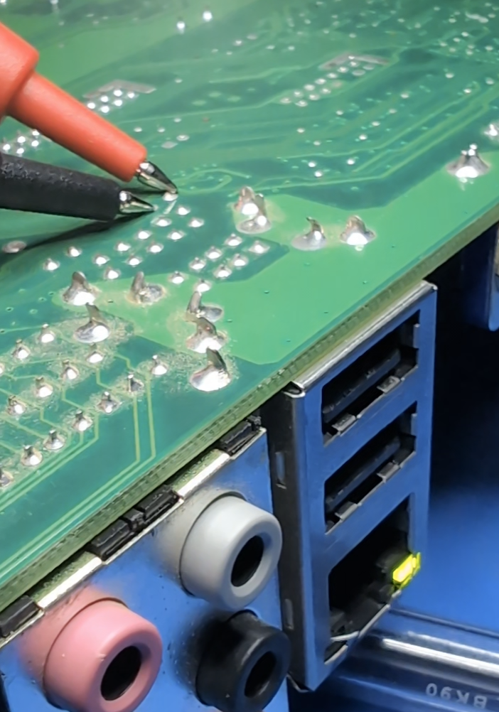

I'm very sorry, but I was wrong. I tested a port similar to the AliExpress one, that I had on an old computer and the 4 pins at the back are actually for the leds, not extra grounds.
this is made more clear with these photos:
https://ae-pic-a1.aliexpress-media....AN-Connector-Shielded-with-LED-Lamp.jpg_.webp
they seem to just be normal 3 volt leds.
however I don't know if this means that your idea wont work, because maybe (extra emphasis on MAYBE) you can make one of the data lines flow through the led before going to the port, but I have no idea if this works, and I didn't have time to test it (and It would also not be easy to do).
