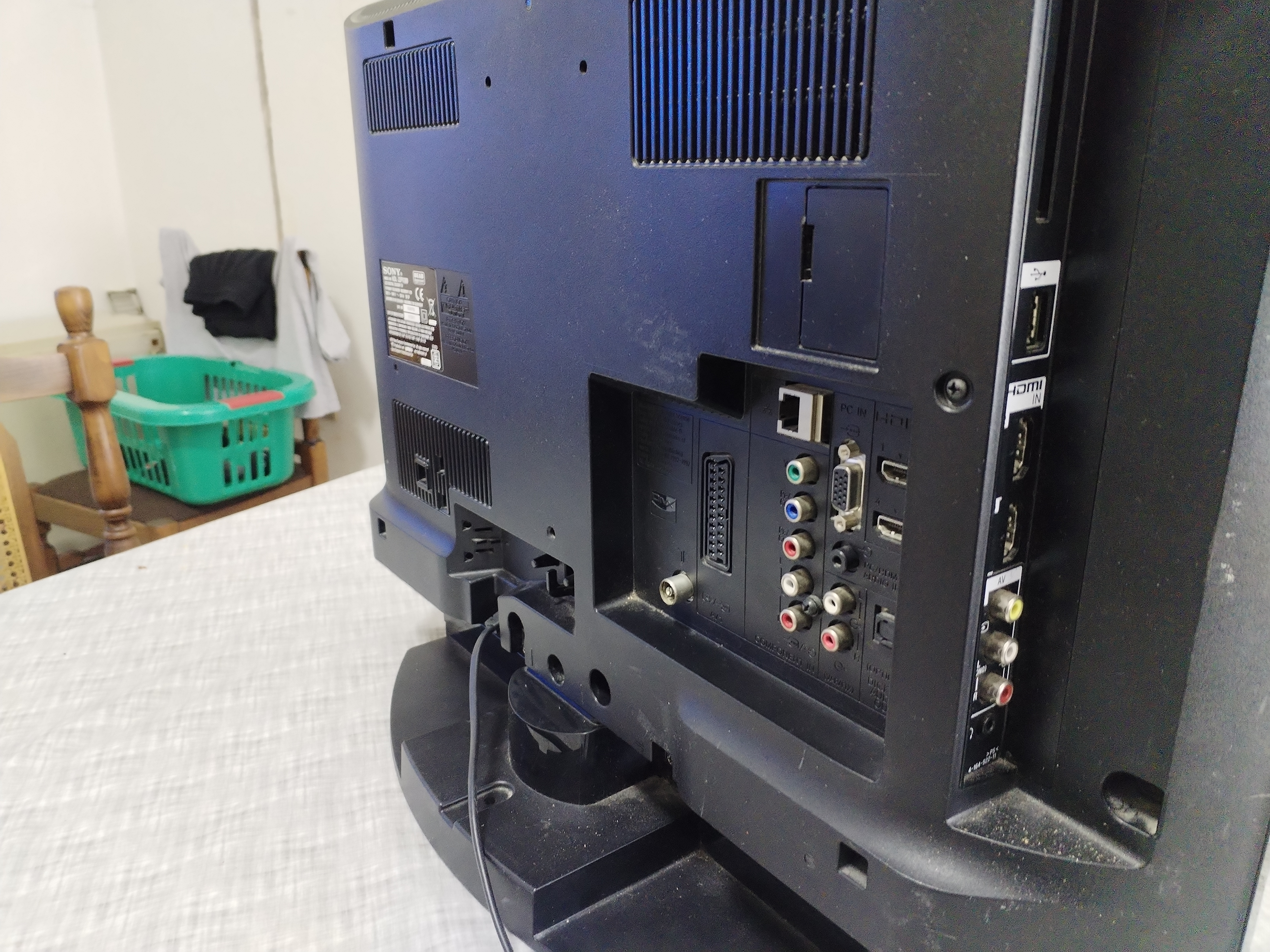

My first threat here on forum so hello there too all of you...
I found this peace of history on internet sales and I had to buy it if you know what I mean
The sad story is that the screen is damaged ( ) but I get it cheep so why not any way I have a room and basement fill with electronics and stuff
So I am here to represent you this beast in that time:
Sony KDL-22PX300
Sorry for too much img's but I want all off you too feel the vibe Is just me or someone else here will pay for dameged electronics? Do you wanna se what I found inside? what would be your last price for this in this condition?!?
Greetings from Macedonia wild wild western balkan

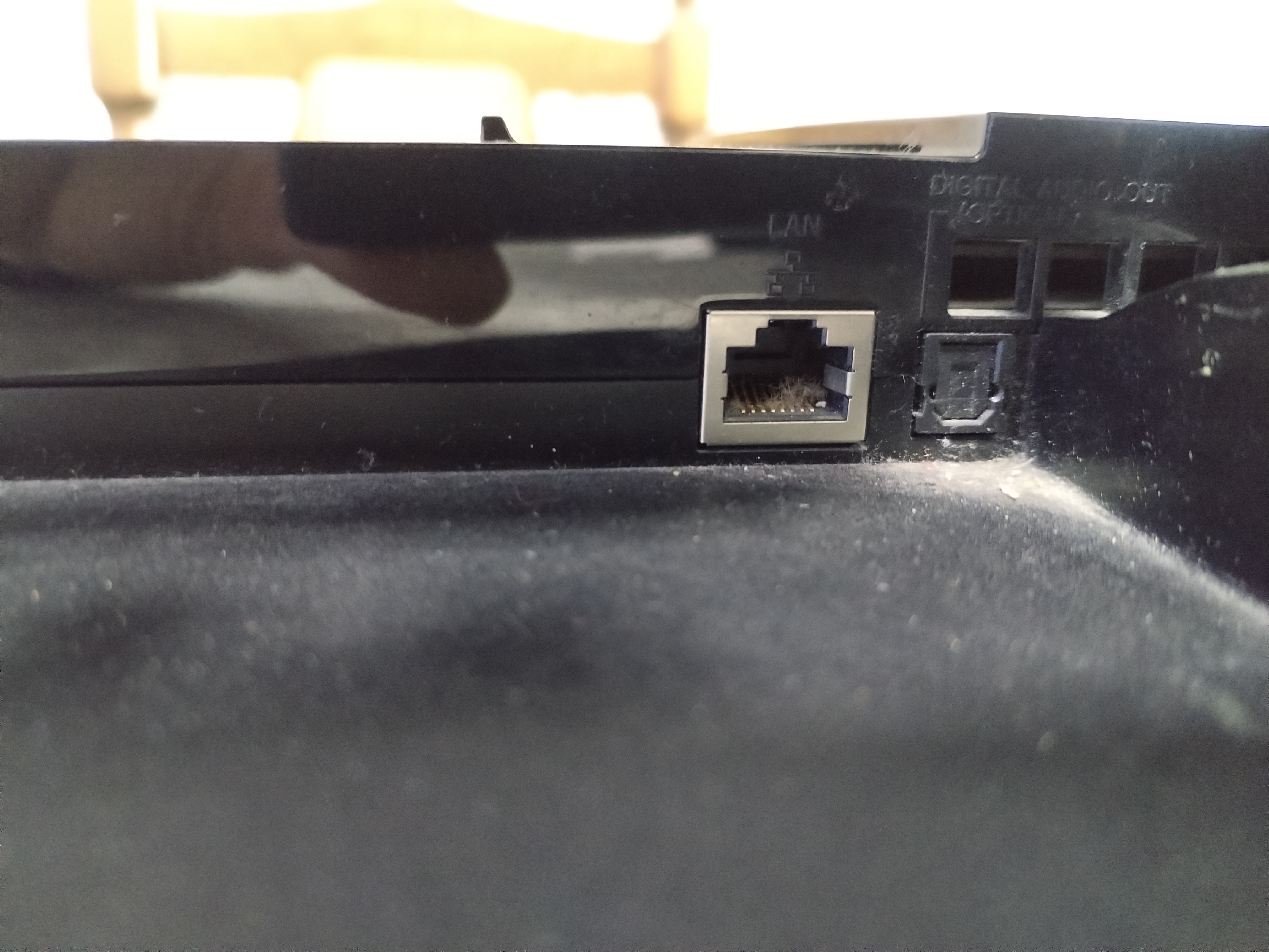

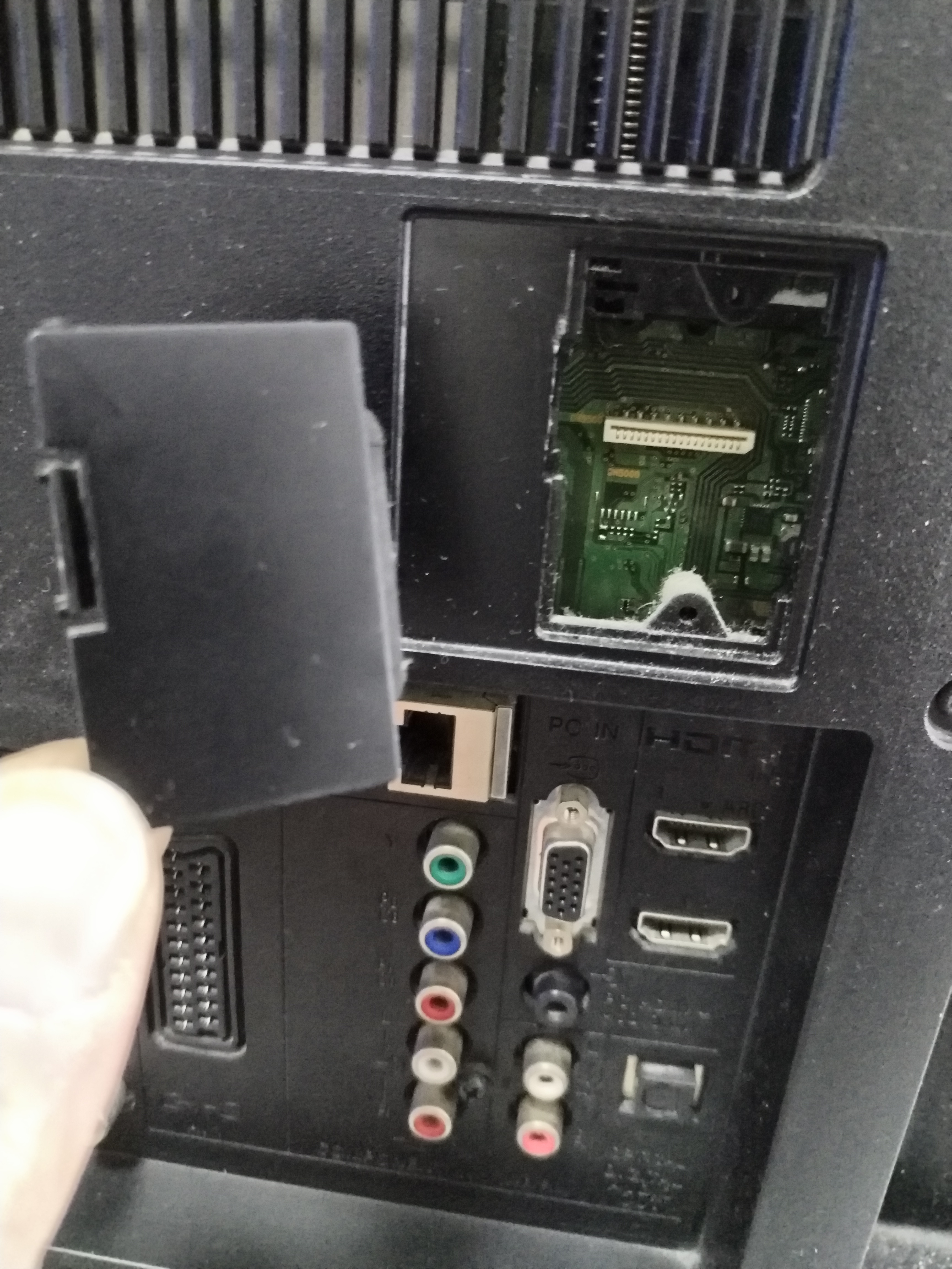

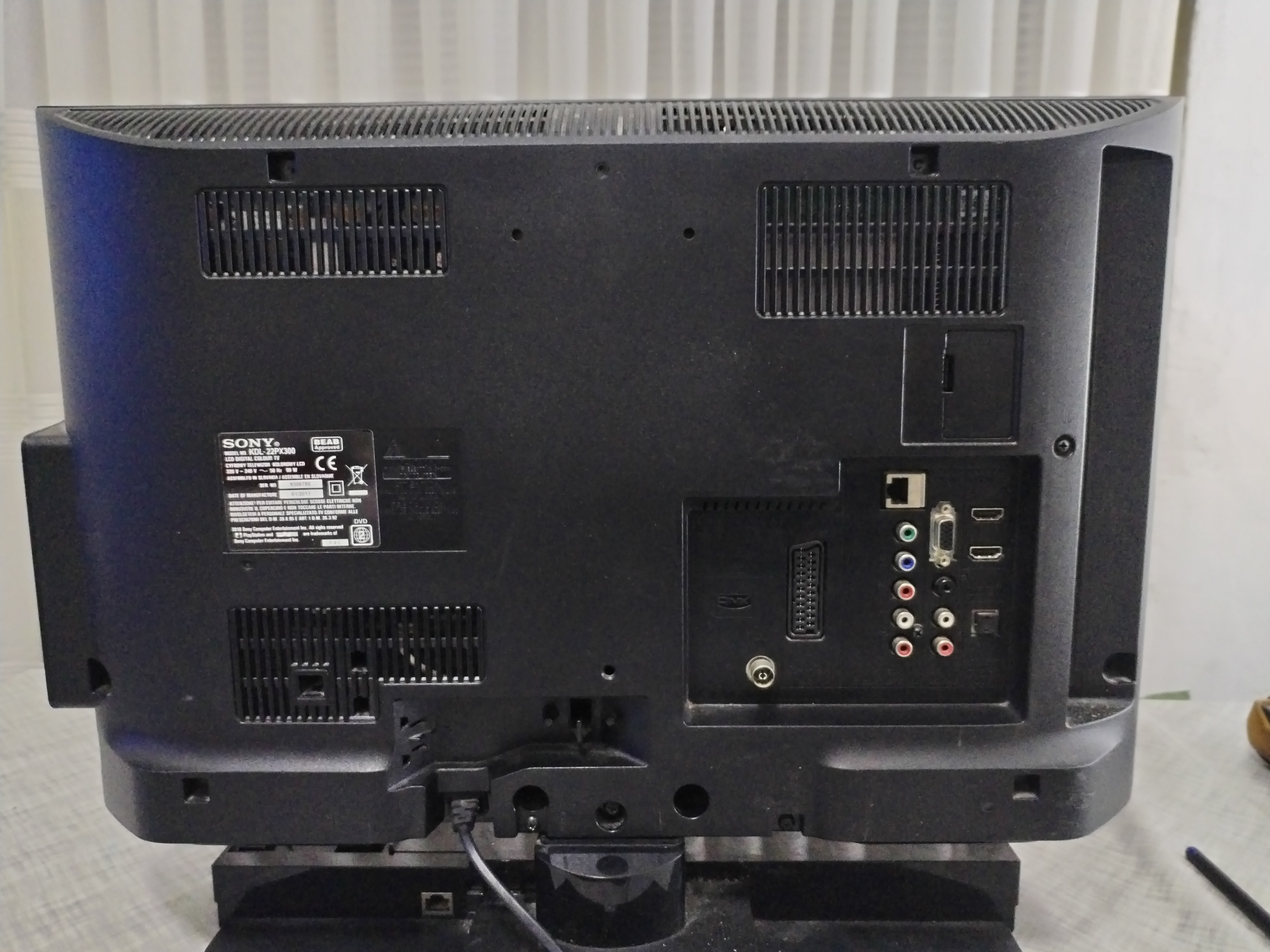

So my 8h shift is over now I can post the rest of the images and see what is inside...
First thing we do is to remove back cover and holder of a screen so we can dissasemble entire thing to the screews.
The truth is very simple the ps2tv is basicly assembled with:
Sony Bravia 22BX300 for tv/screen
and
Sony Playstation2 SCPH-9000x
The sony put new product code and name it PX-300...
They have tv they have ps2 boards at stock so why not...
here is the inside preview (lot of img)
