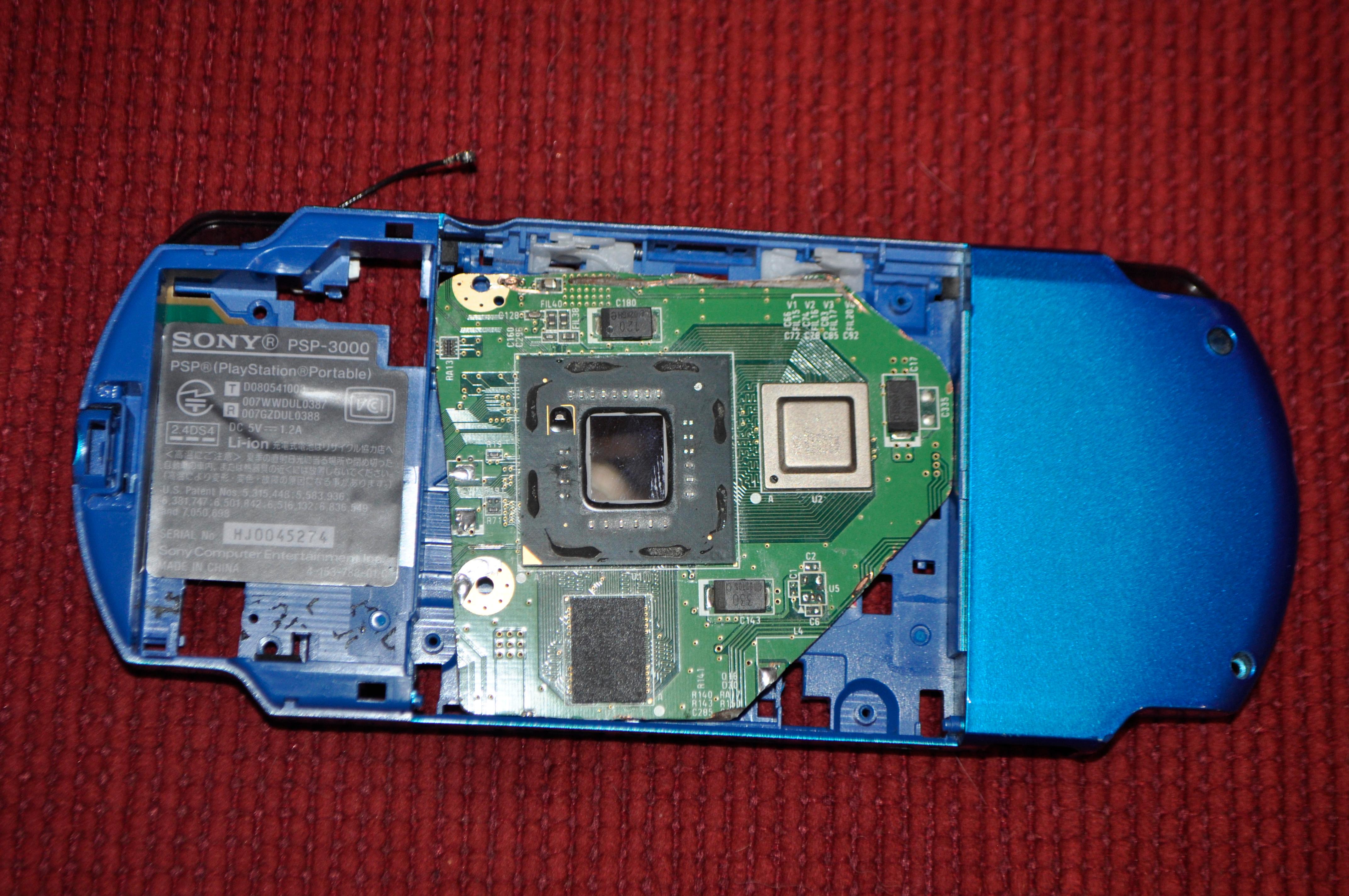

So my PSP-3000 kicked the bucket recently, much to my disappointment. (It may have been my fault, I am an idiot.) However, this prompted an idea: to put a Wii inside of the shell. At first I thought this would be an impossibly stupid idea, but then when I saw G-Man had done so a while ago, I figured I might as well take a crack at putting my own spin on the project.

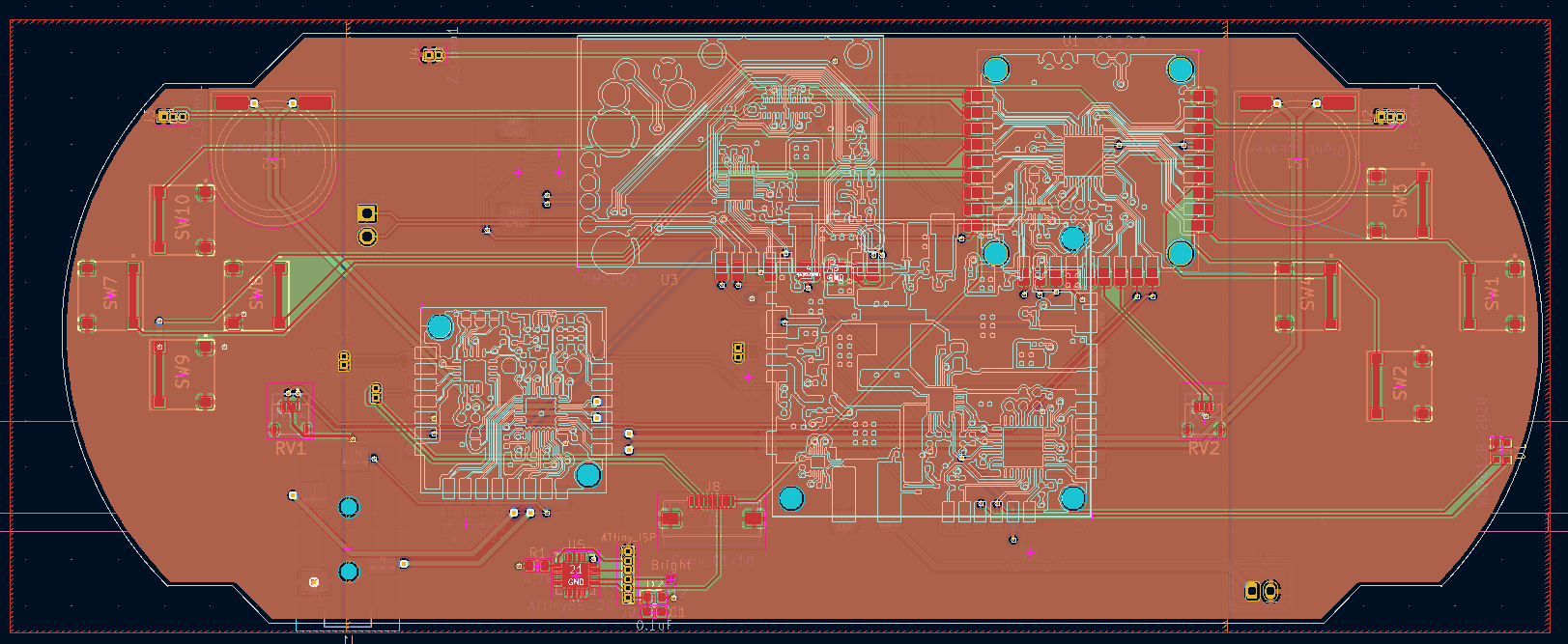

  • use of custom PCBs to help tie everything together

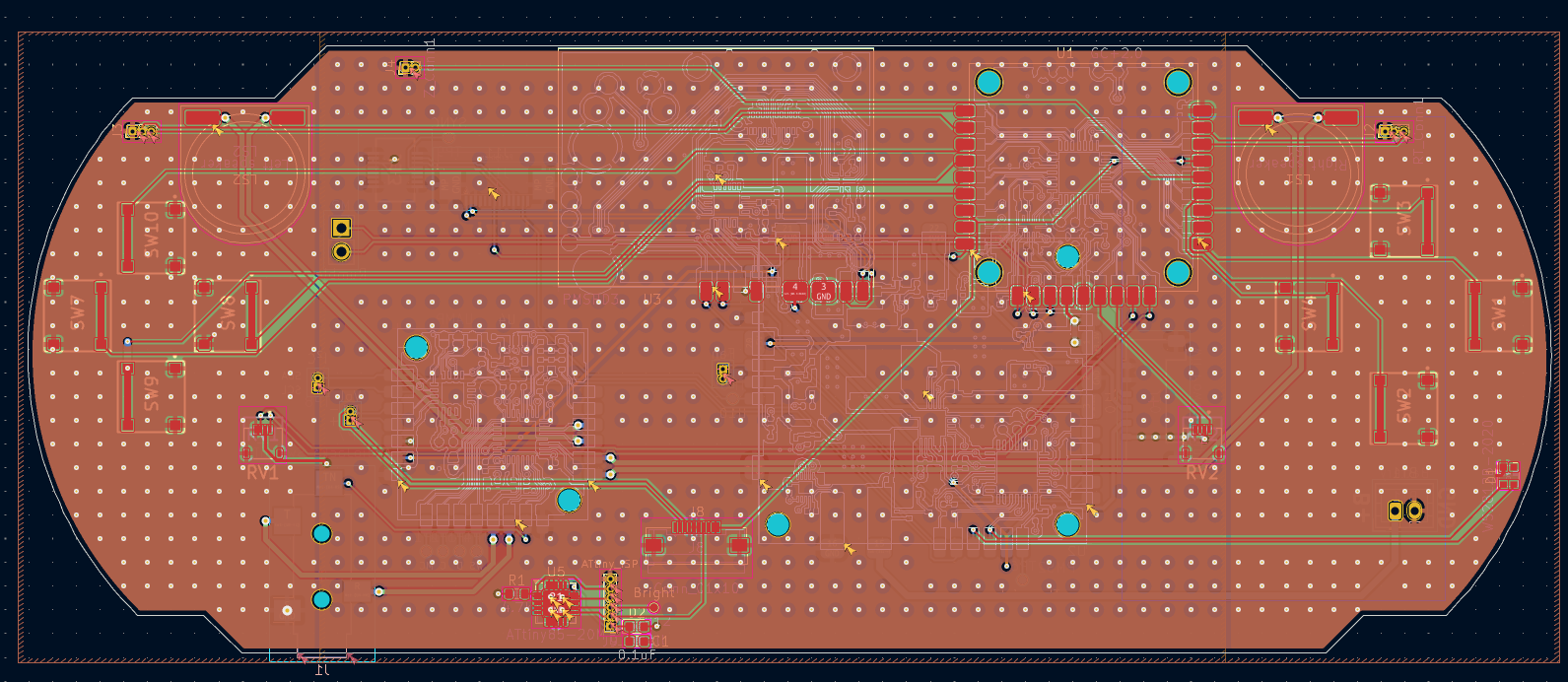

The PCB is made in KiCad, because I love FOSS and I'm a cheapskate Linux user. It's also the only thing I have experience with, and I wouldn't switch to another program even if I could. I want to put as much as I can on the PCB to avoid having to jerry-rig mounting solutions with hot glue and such.

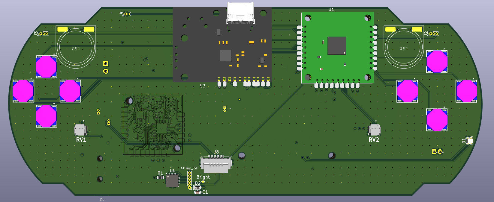

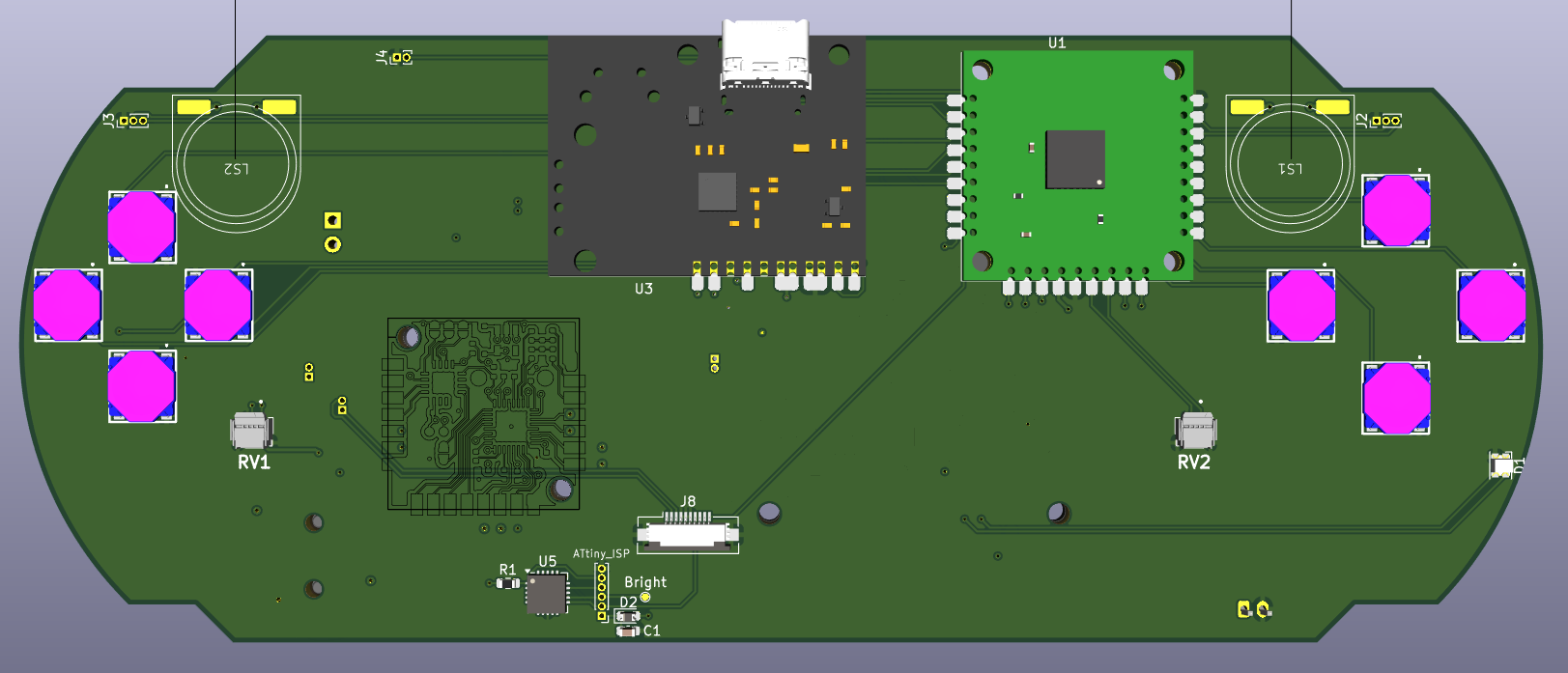

Next, I got to work designing my custom PCB. Huge thanks to @Y2K, @YveltalGriffin and others for all their help and support during this process!
Strangely enough, I started out with designing a footprint for the PSP speakers. While I believe the original PSP-1000 uses connectors and cables, the 3000 uses "spring"-ed contacts on the speakers themselves. I took some measurements, made a to-scale test print on a piece of paper, and refined the footprint until it seemed it would work well.
With that done, I downloaded the 4layer board symbols and footprints, and then spent a bit of time adjusting them to fix errors and improve minor things. Following that, I began laying out some basic parts. and it was mostly just improvements and fixes until I got to where I am now.
I intend to print out a scale paper copy of the PCB, to check for any major flaws, before I submit an order. The size of the PCB is larger than most, so JLC charges an extra fee for it, unfortunately. Given the price, I'd really like to get this as perfect as possible before ordering.

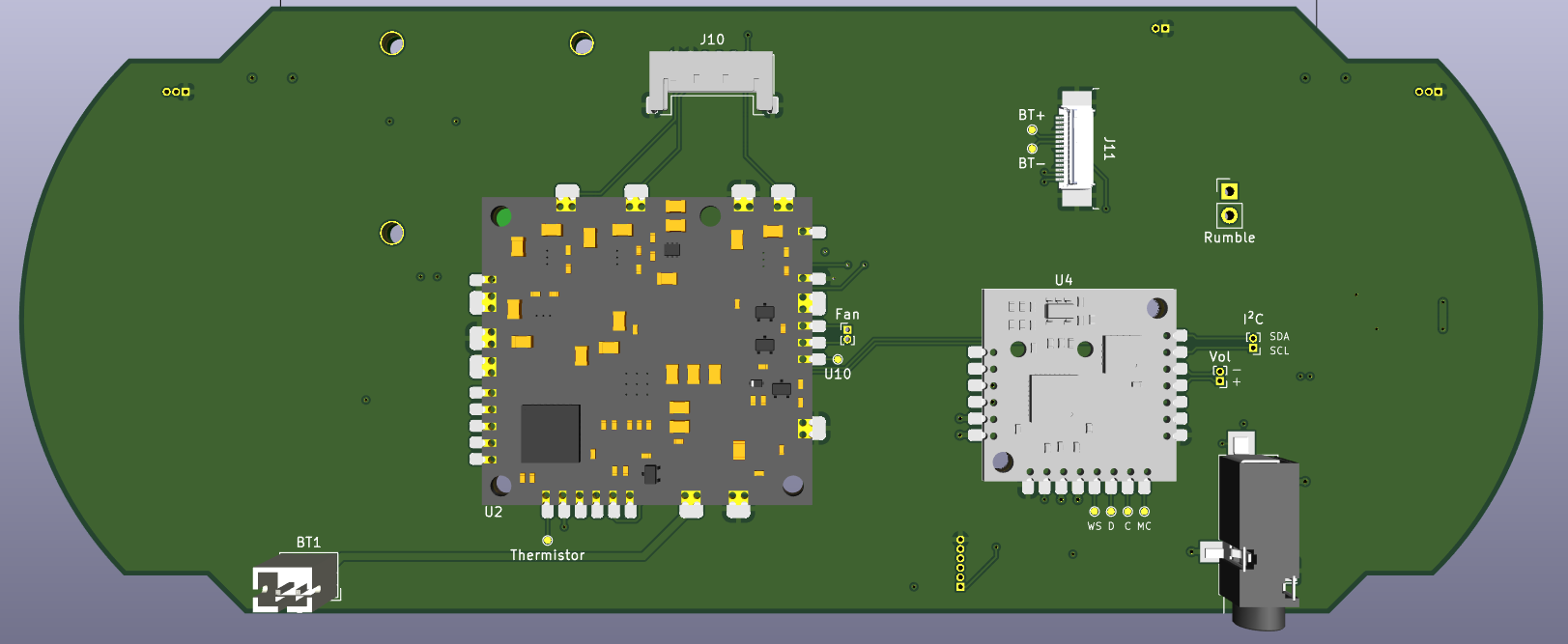

I'm getting closer to having this thing ready to be manufactured. Some of the main changes since my initial design are:
  • Using @loopj's periphlex design
    • Including connector for BT module on the board
  • Using @loopj's power strip board
  • Using flex cables for lots of things
Aside from that, not much has really changed. Everything's laid-out and set-up, and I'm mostly procrastinating to avoid having to pay the cost of board manufacture for this thing, not to mention all of 4layer's boards.

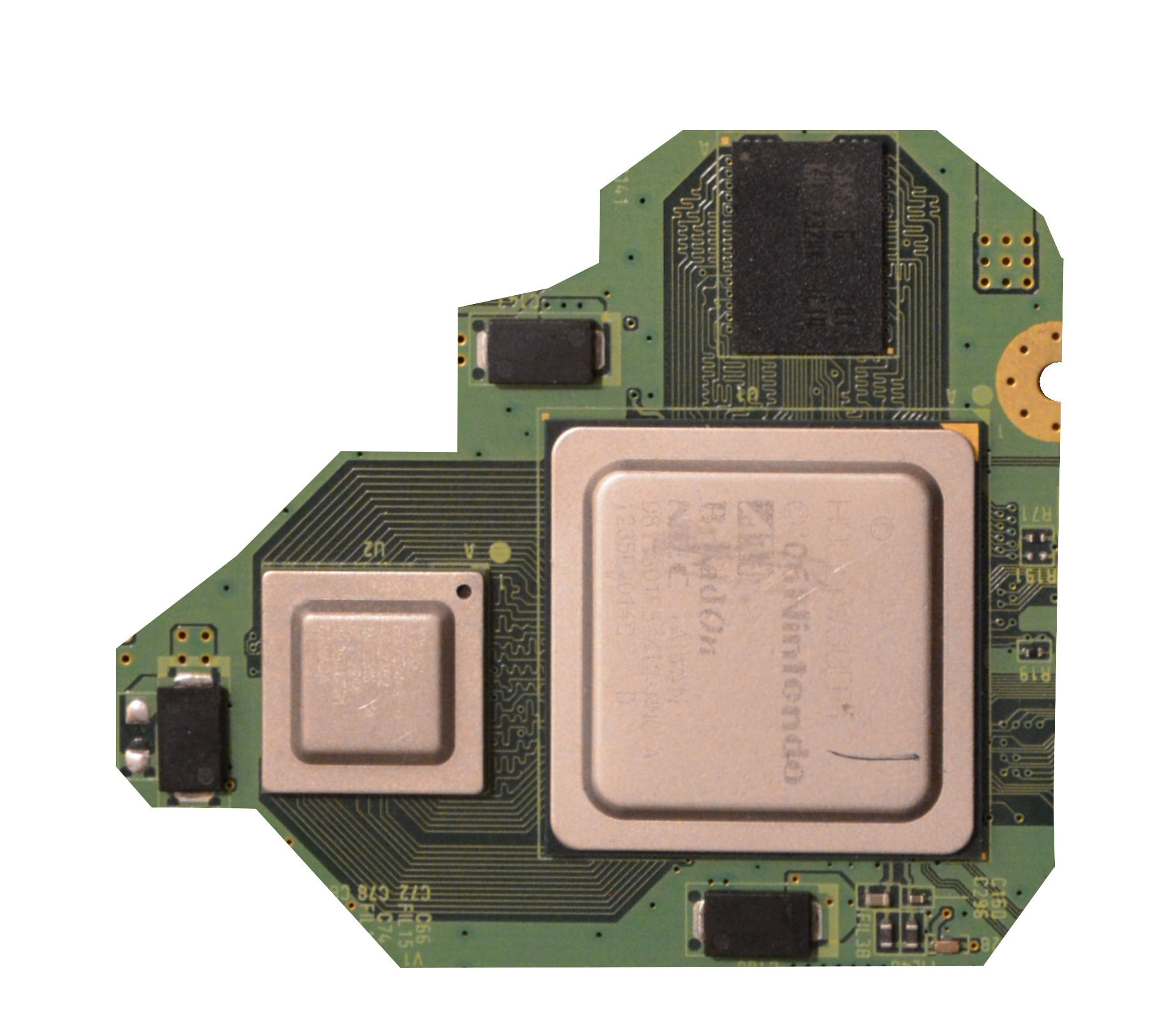

Note: this may not be the Wii mobo I'm using, this is just another motherboard that may be dead. If it isn't, though, I'll probably use it, given it's already trimmed and I wouldn't wanna risk another Wii.

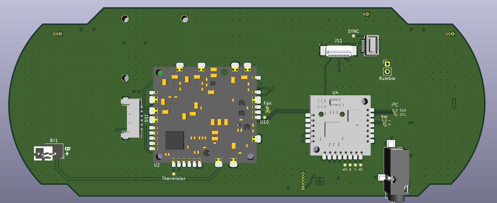

I'm also redesigning my custom internal PCB. With a full 3D model of the internals, designing the two to fit together is much easier. At the same time, the reduced space means I have to incorporate the GC+ and RVL-AMP into the board manually, making routing annoying.
